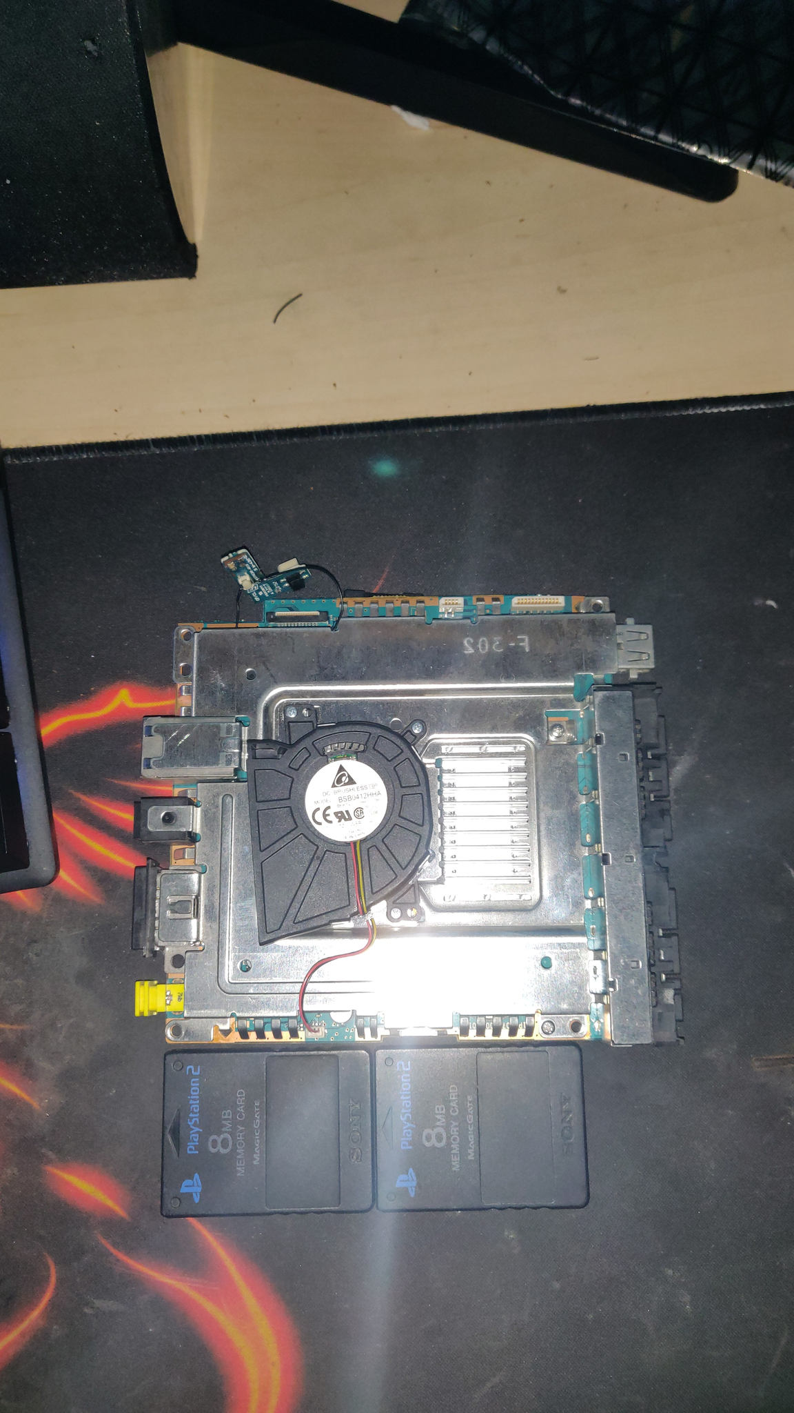

Hey thanks for the mod! I had to wire a switch in like you mentioned in an earlier post because there wasn't one on my motherboard haha (I'll upload a pic in case anyone needs a reference).

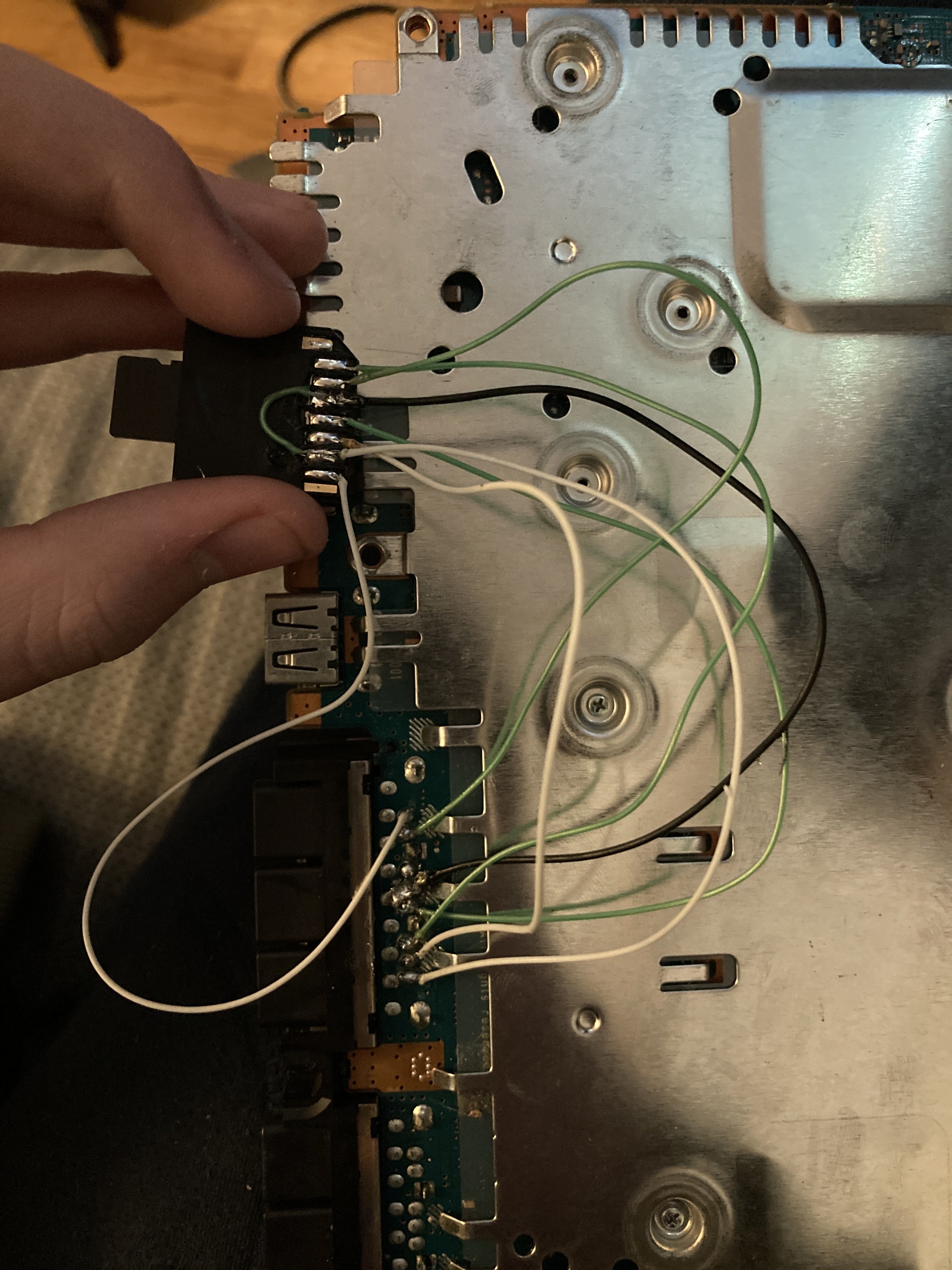

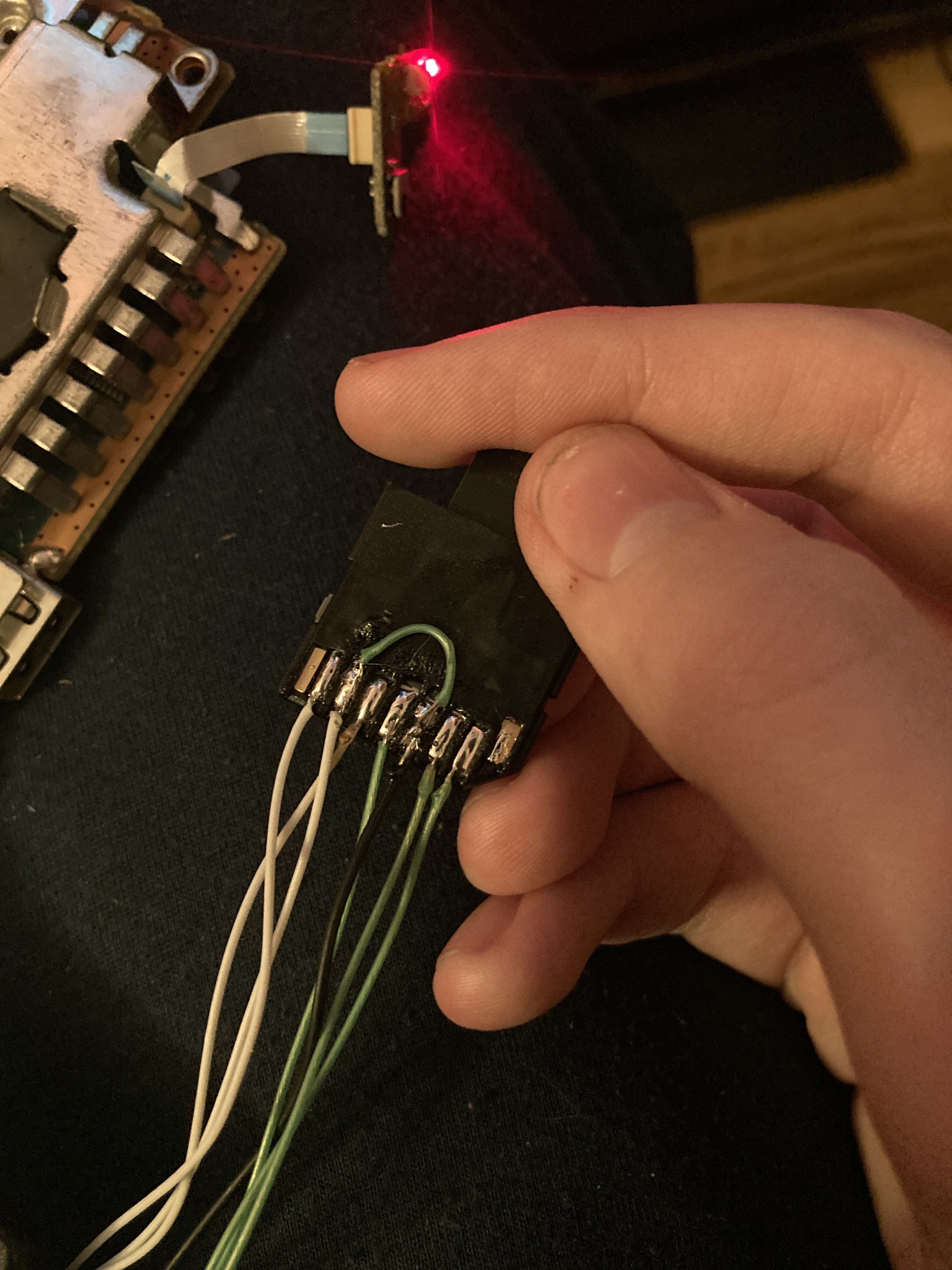

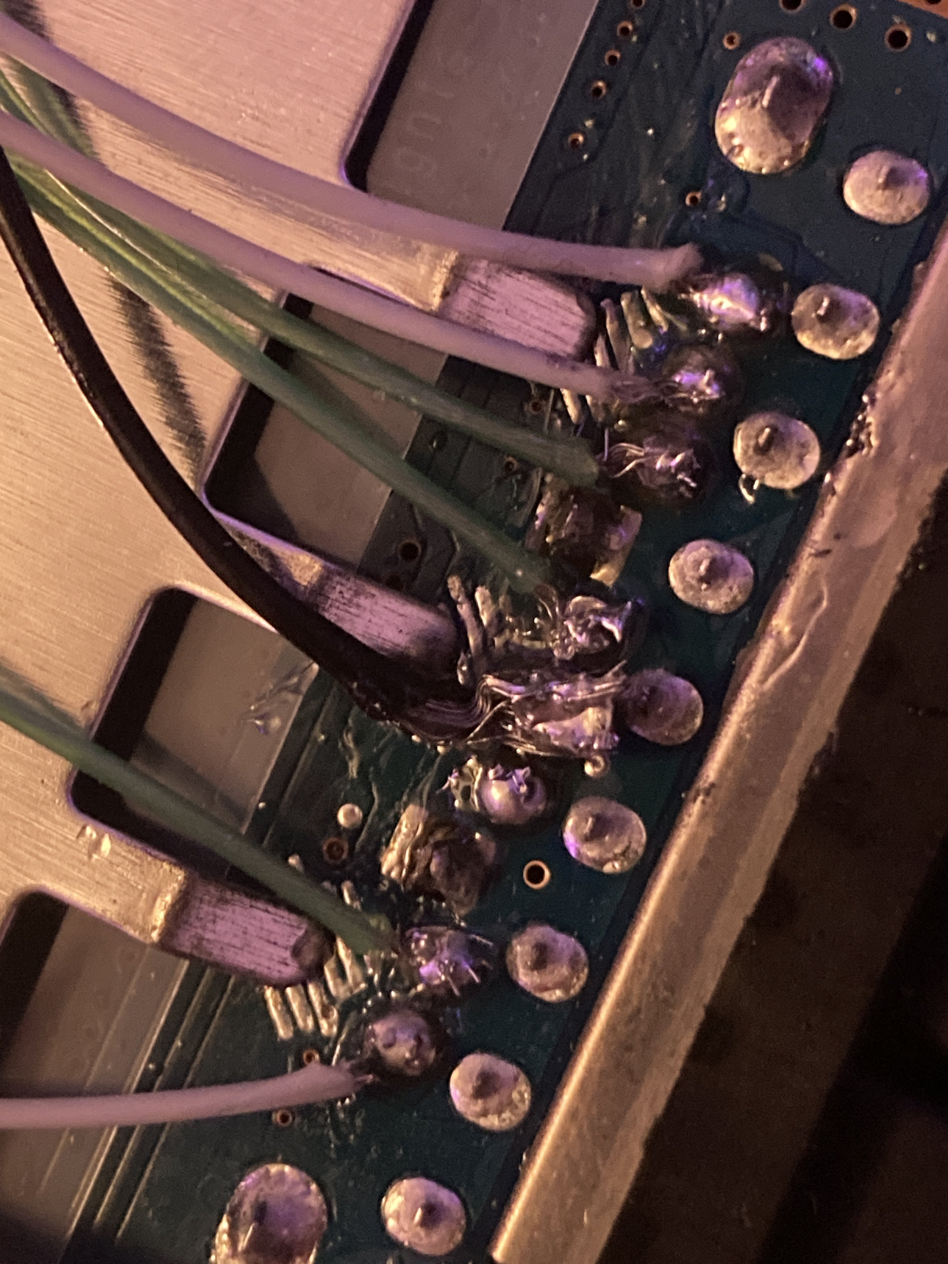

ok, idk if i did something wrong but i can’t get my ps2 to read the sd card, how do i install everything, i’ve looked through youtube for anything and haven’t found anything
You'll need to provide pictures of your soldering/wiring.
it’s not pretty, but i’ve triple checked that none of the wires are touching. you will have to follow the wire to see where they meet up, i didn’t have more colors
You also need to mount the drive in OPL, there is a setting in OPL called "automount" or something similar which will load the contents of the card when OPL loads.
If you need further help you'll need to start your own troubleshooting thread in the Sony subforum: Here
