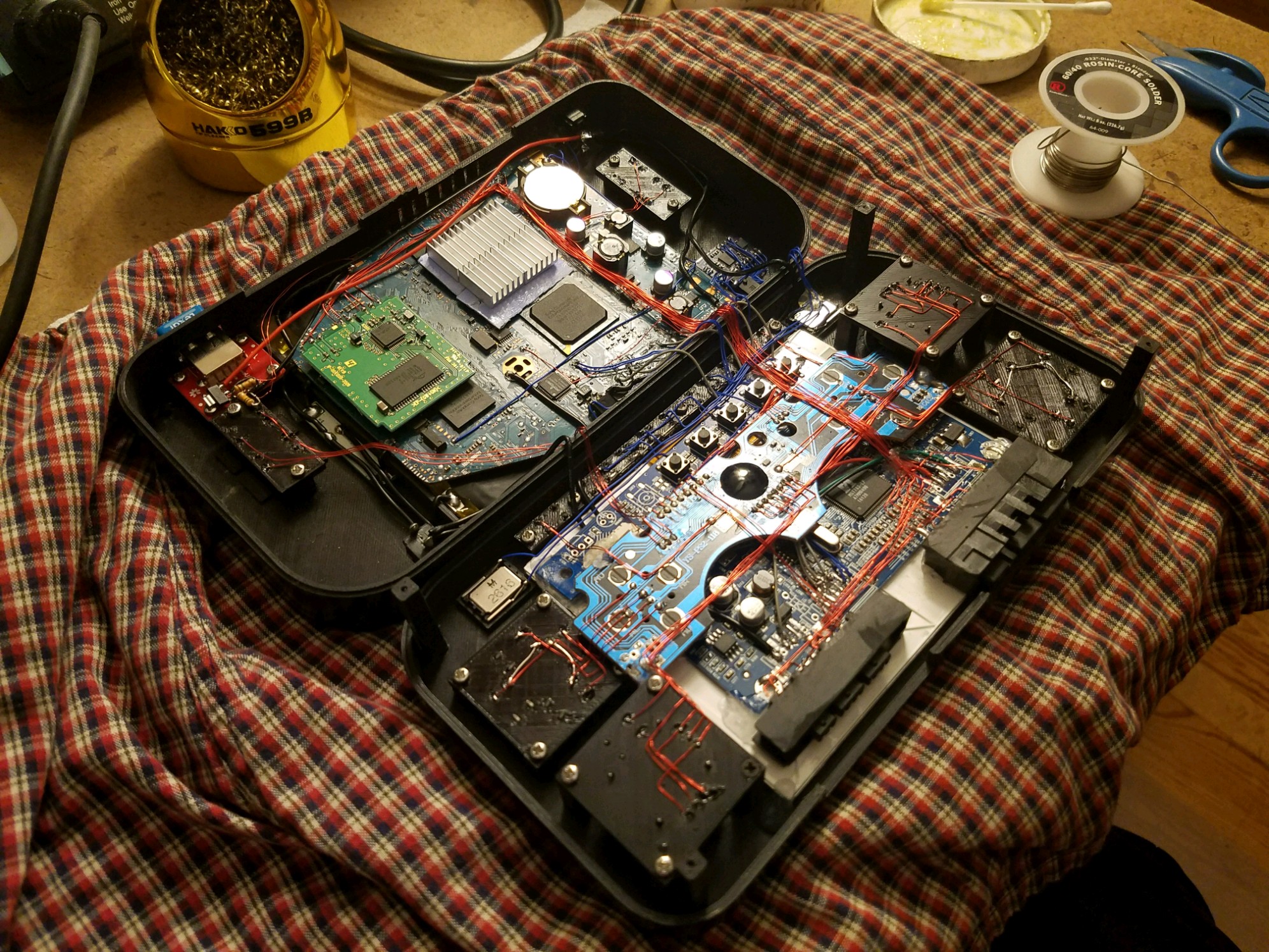

32 gauge for the majority of it. 38 gauge for usb and one controller trace where the pad was no longer.

Yeah, I just really don't like sparkfun. They make a lot of very overpriced stuff, IMO. It's less about the board and more about the fact it's from sparkfun, and the way they overcharge for pretty much everything.
Why no internal pics :p
Also im a bit of a noob why is getting the vga signal directly from the board any better then just jusing one of those conversion cabmes2
Seriously, just look at the previous page if you want to see the internals...
Also any color conversion (especially if done on analog signals) always causes noise/errors. Besides a converter cable would make everything bulkier

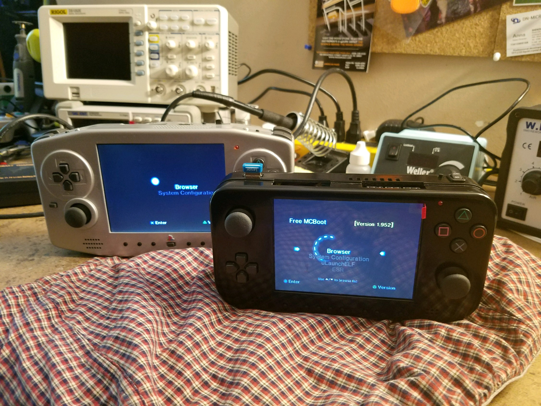

@Gman how thick is this portable? Do you find the flat shoulder buttons a bit of a pain? Toying with flat ones myself.
