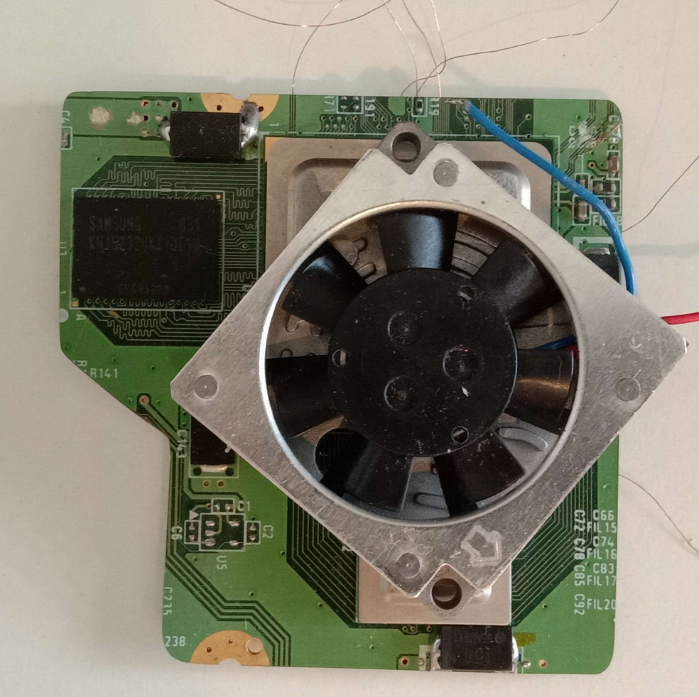

This is my first attempt on this kind of trim everything was going great until I trimmed the AVE section, after that the board doesn’t boot and my LDO gets super hot.
So I desoldered everything checked resistance and it looks like I have a short on the 1.8v line resistance measured 0.03 ohms.
does anyone with experience on these kinds of trims have any tips on how to troubleshoot? any help is appreciated.
also excuse my dremel slip on one of the ram vias :facepalm:
So you completely disconnected 1.8V and GND from the AVEflex, and the short was still there?
If so, take a look at the RVK Compendium to see where the 1.8V voltage plane crosses your trim boundary. That's the area you need to inspect / potentially sand more.
(Also, I'm eager to see whether the RAM bodge wire works!)
Yes also when everything was connected there was a short on the video out as well not sure why.

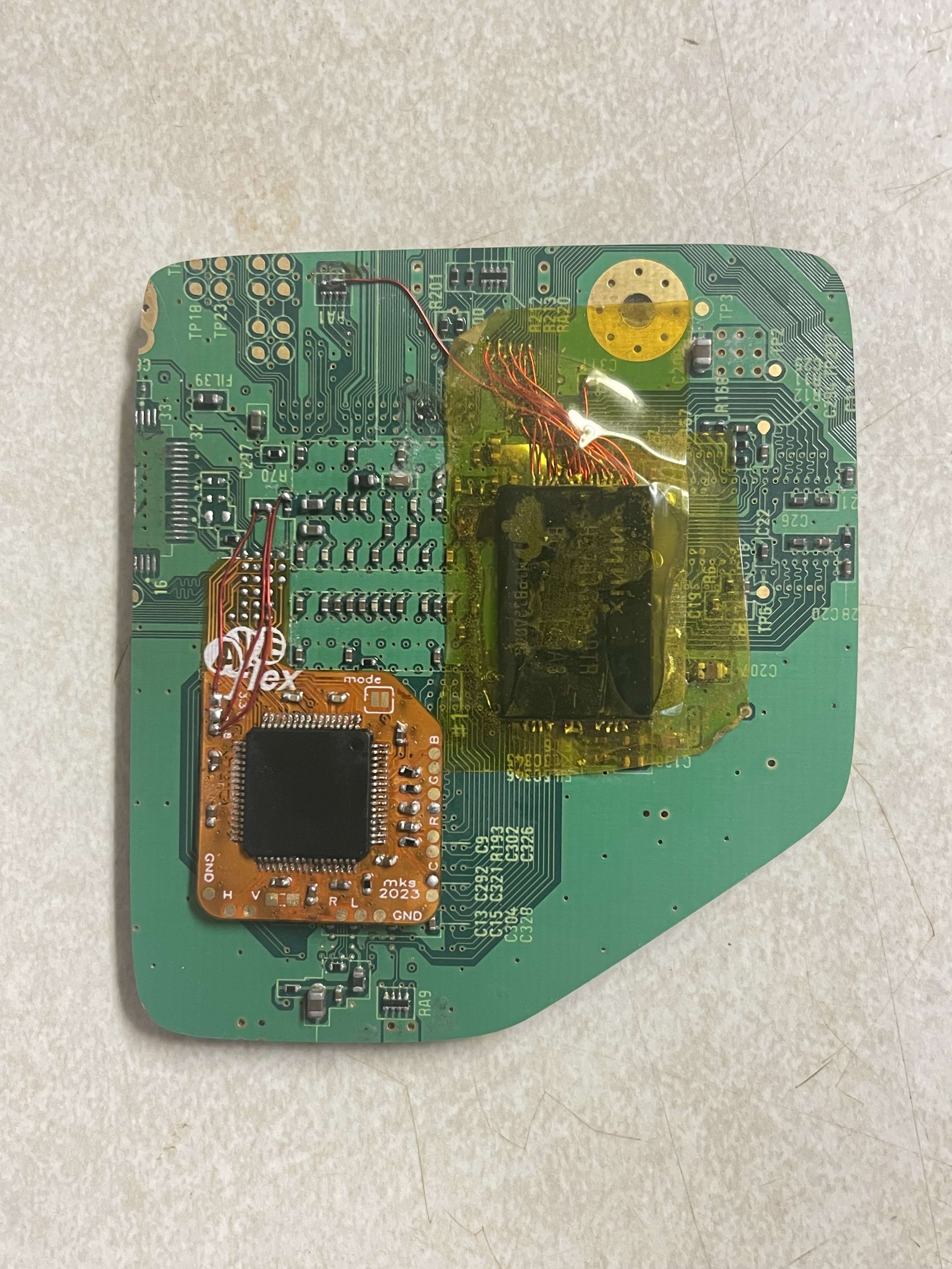

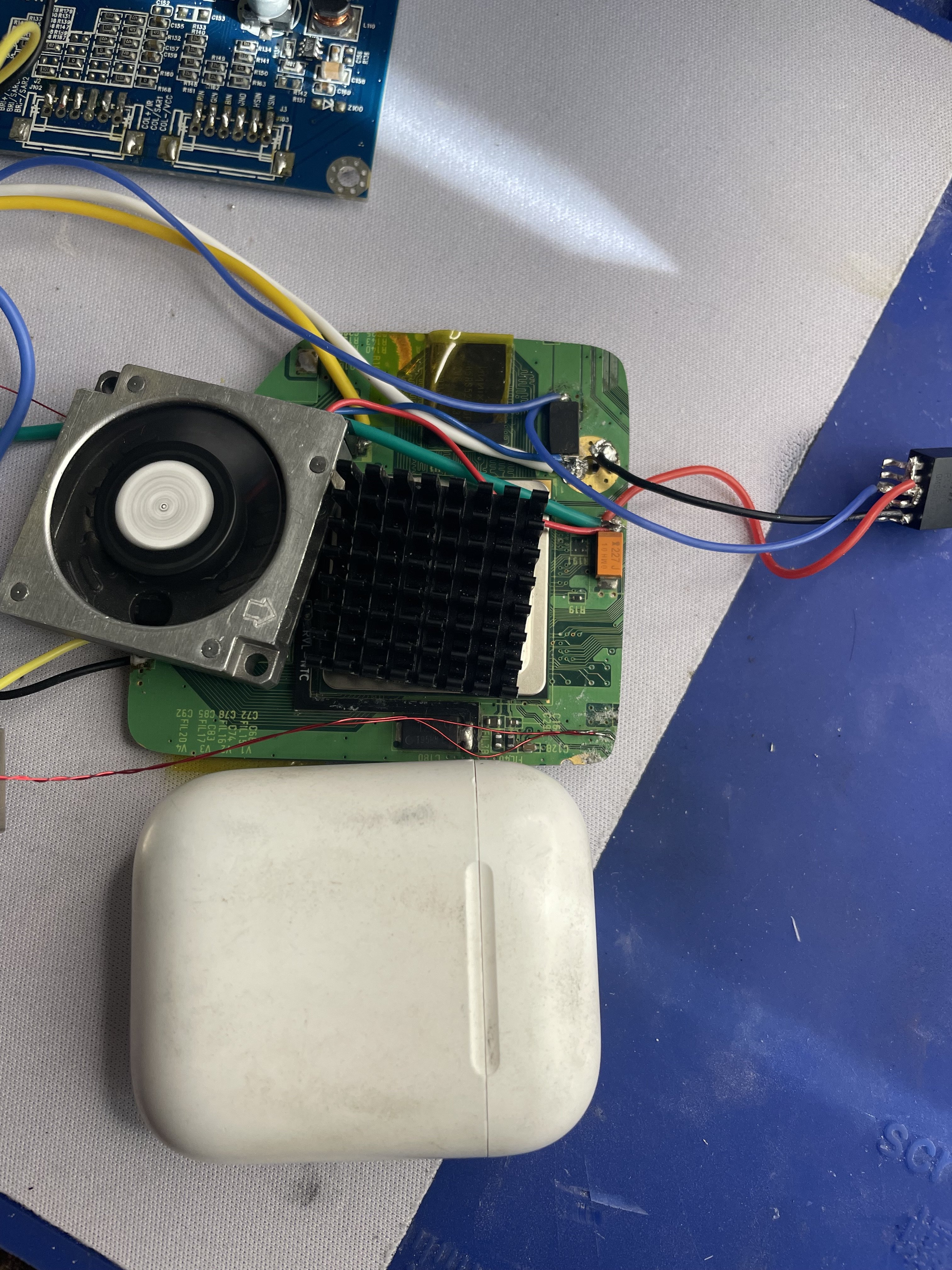

Thanks and for sure it will help a lot, also I really can’t believe how small it is lol for anyone wondering here’s a picture of trim next to my work AirPod case.

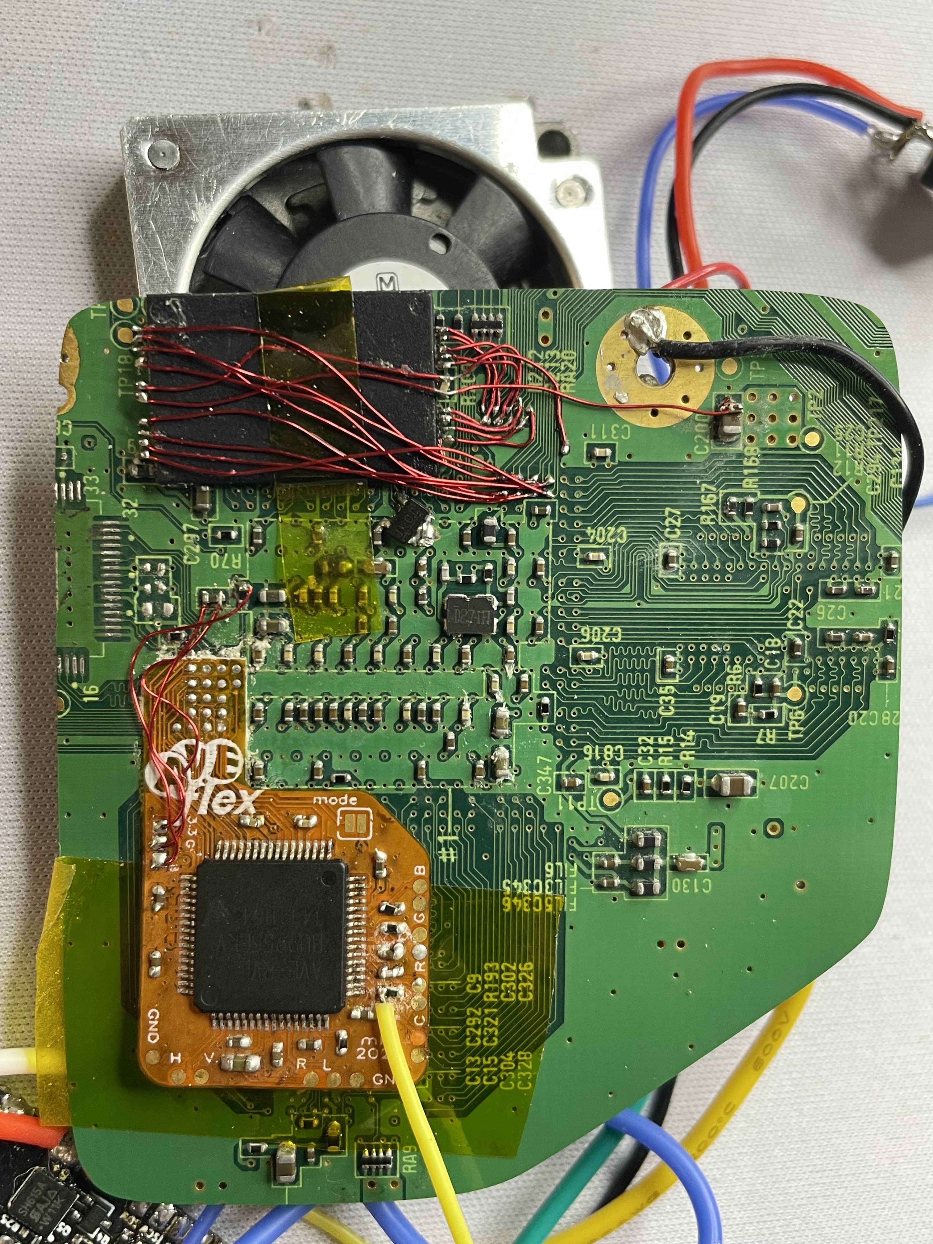

so I re re soldered my nand and moved it to a new location because I needed the space where it was previously.

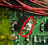

Can you explain me please your "wireless" U10 location? :ding!:
I know I need to take 3.3V and send delayed signal to CPU, but I don't know if the pins of the other side are only soldered together or must be soldered to another place
There's a GND via directly beneath the blob
It’s not a via, you scratch the solder mask off and there’s ground plane underneath. There is a via underneath the component you solder, you need to make sure it doesn’t bridge

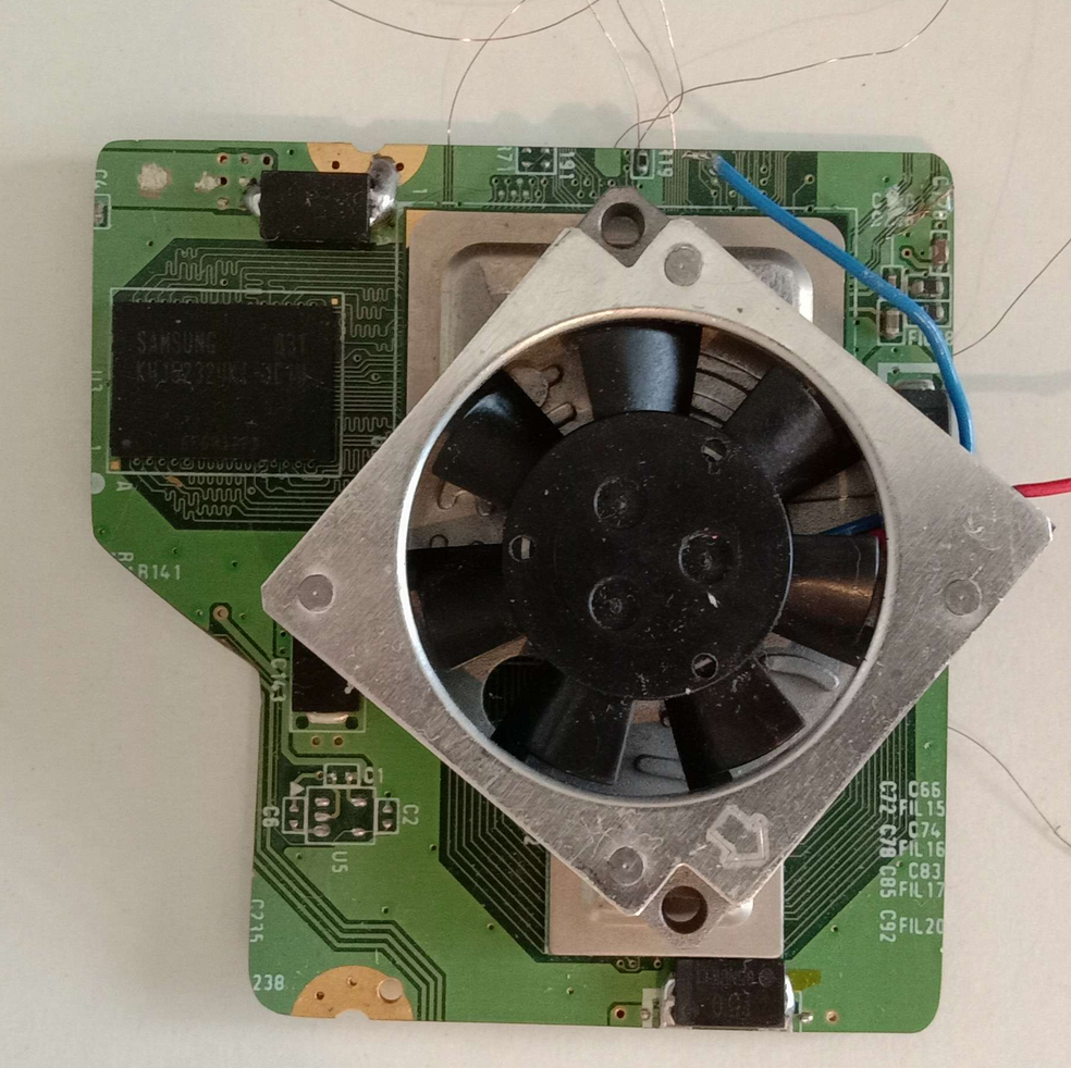

Nice work!, just a little pro-tip: you don't actually need a heatsink at all with the metal fan, if you mount the fan diagonally across both chips and use some thermal paste it will keep the temps well under control. Just an option if you're looking to save space.
Ohh nice that’s really smart thanks for the tip.
