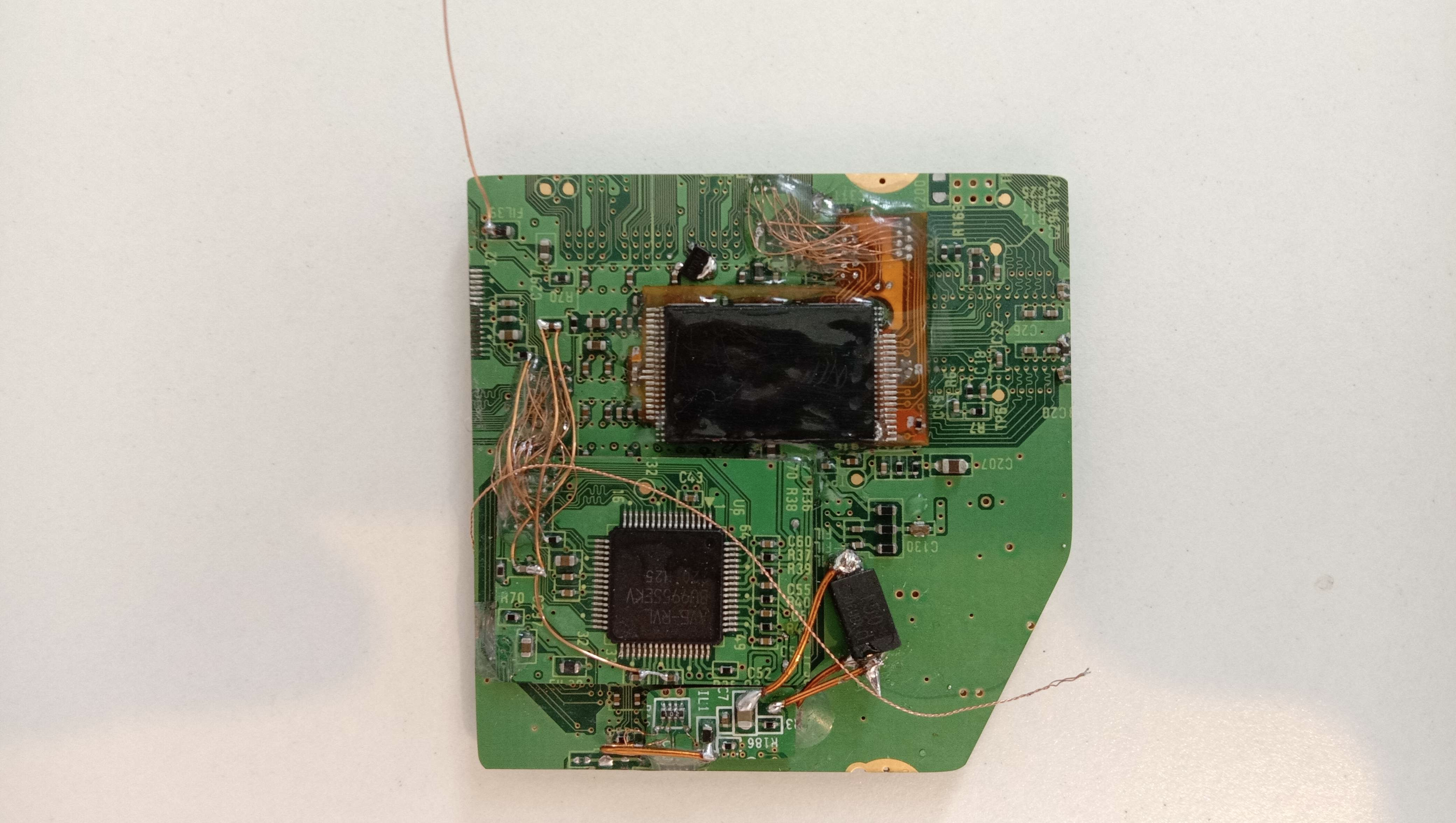

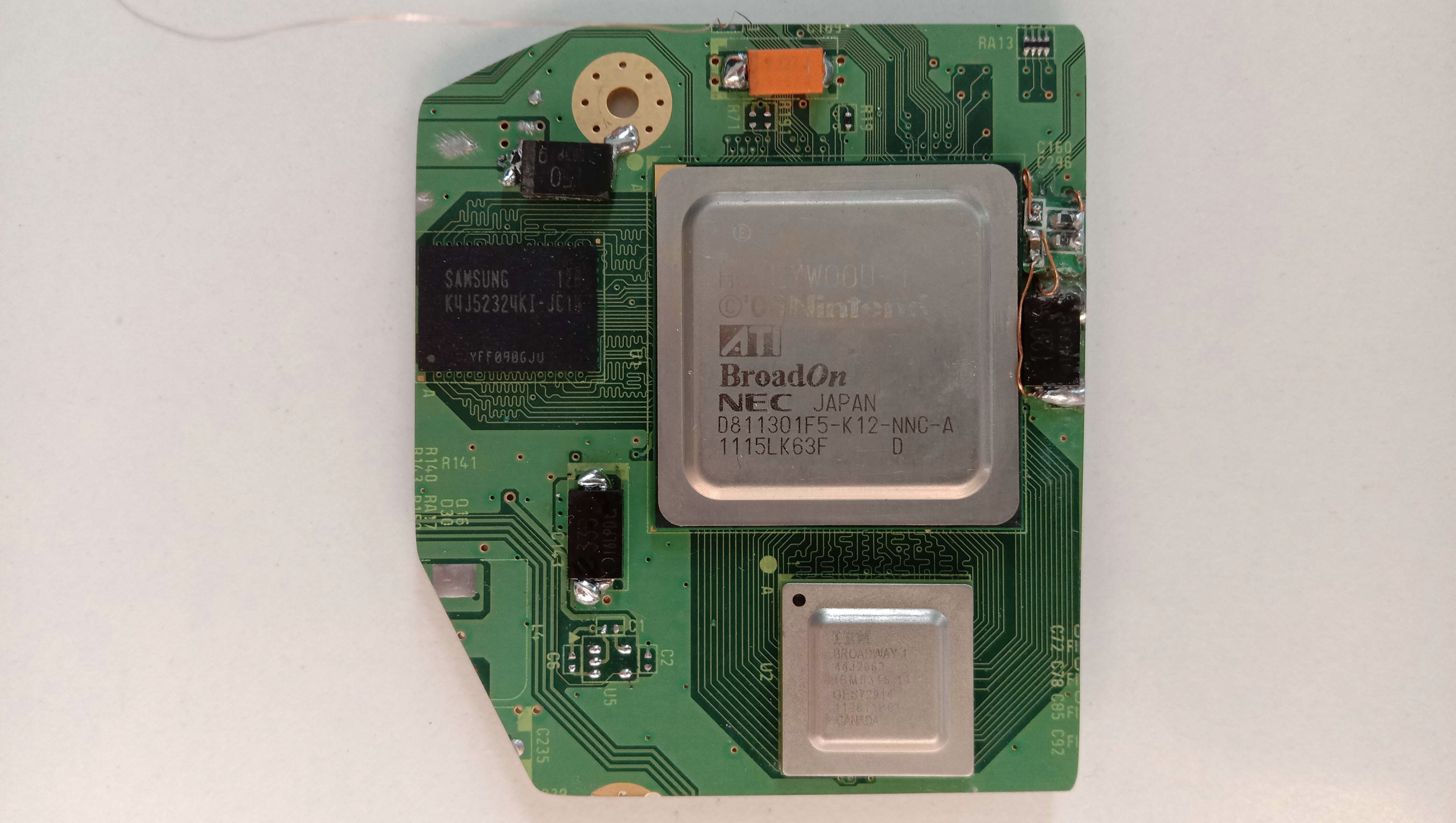

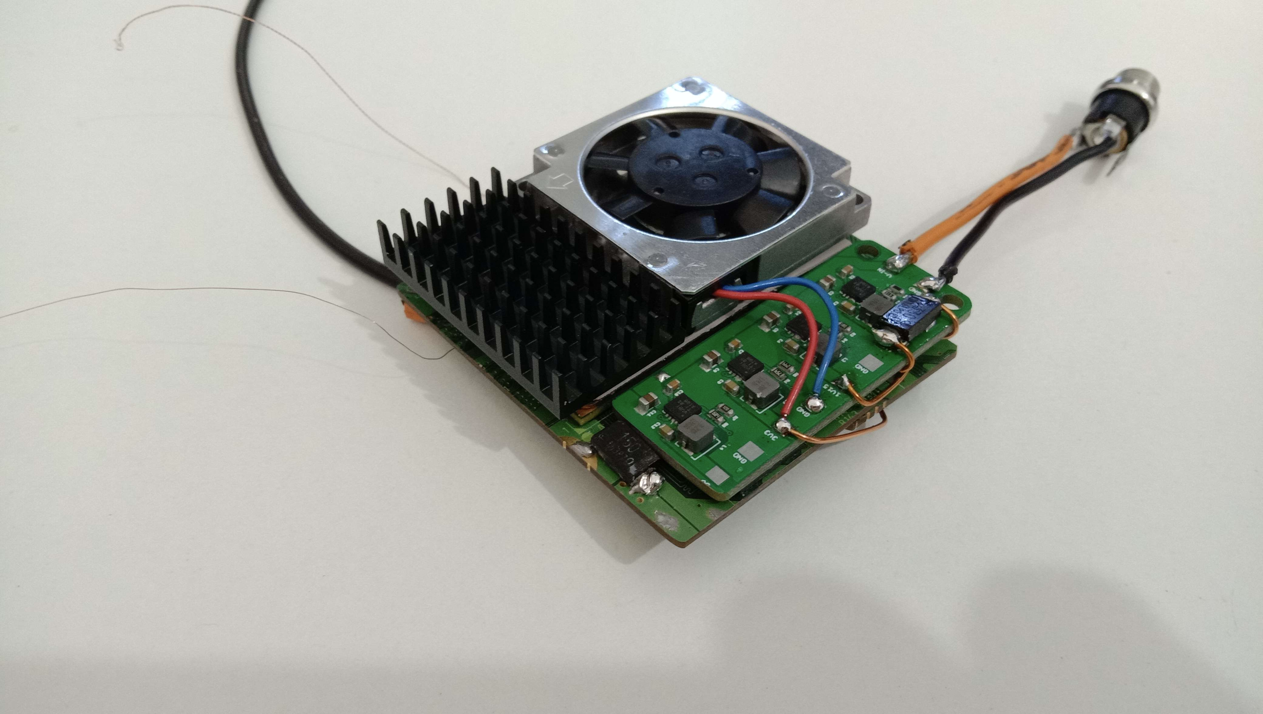

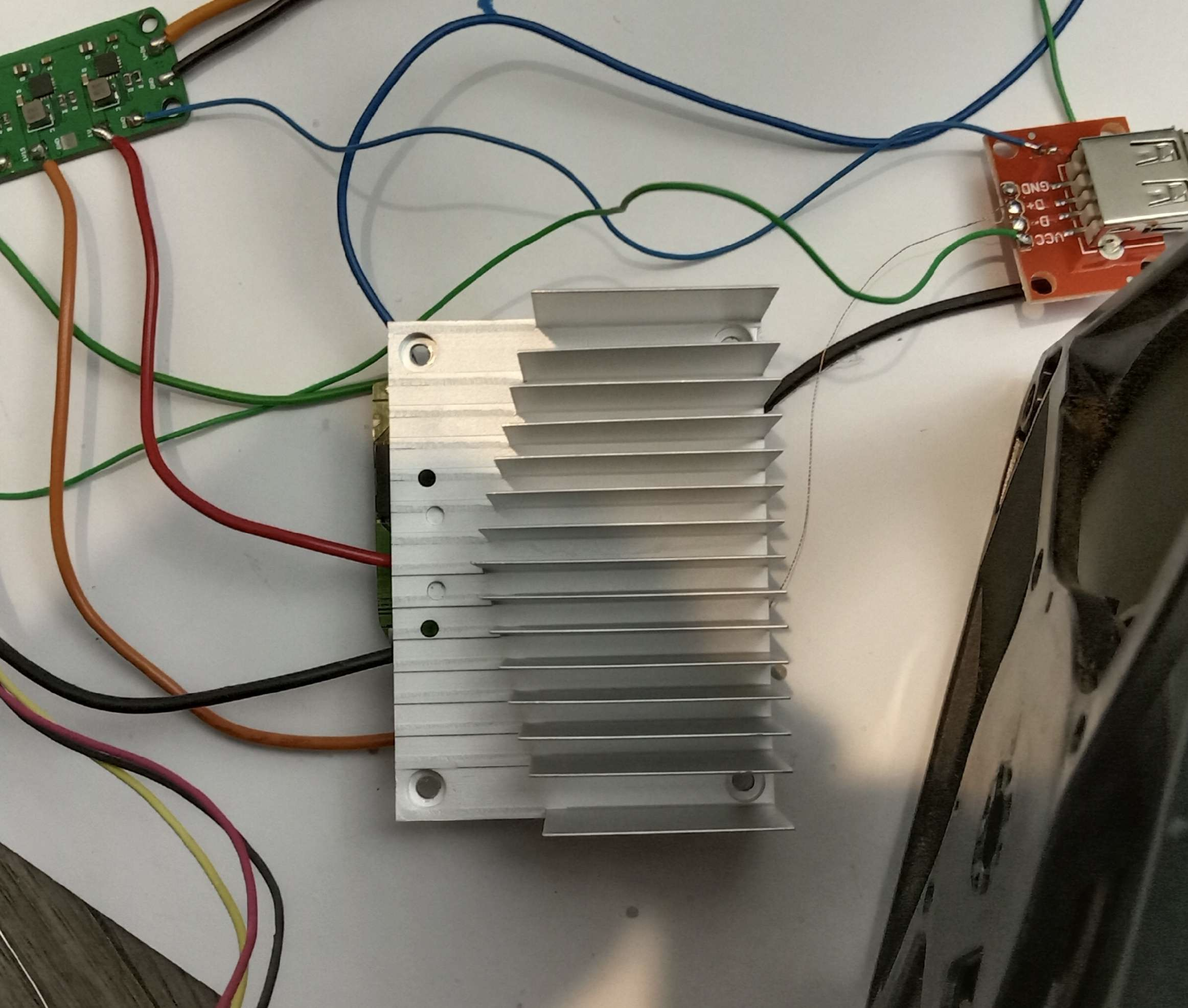

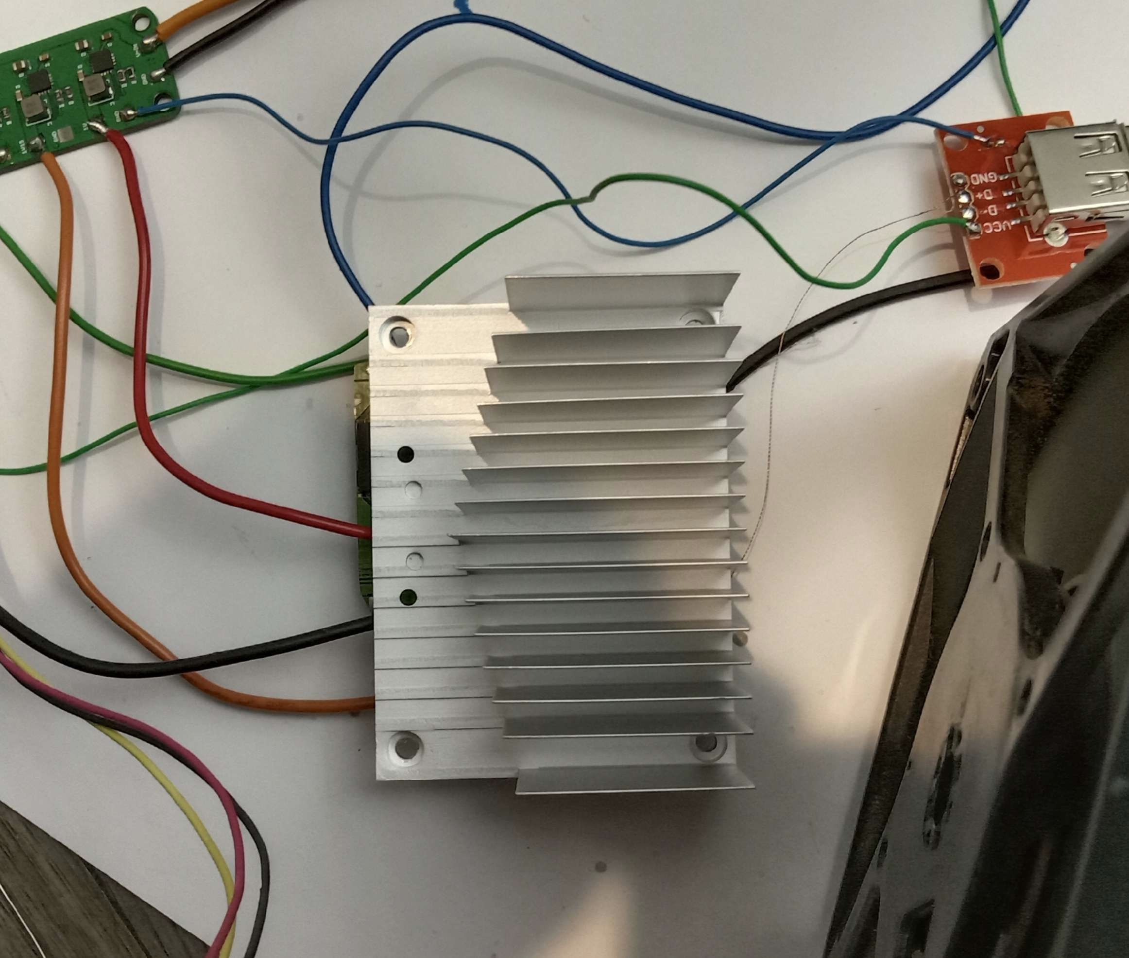

After trimming and tetris-ing the AVE and CPU filter components so that they fit nice and snug on the back I performed a 2 hour run-in to verify the system was stable.
Here's how she looked:

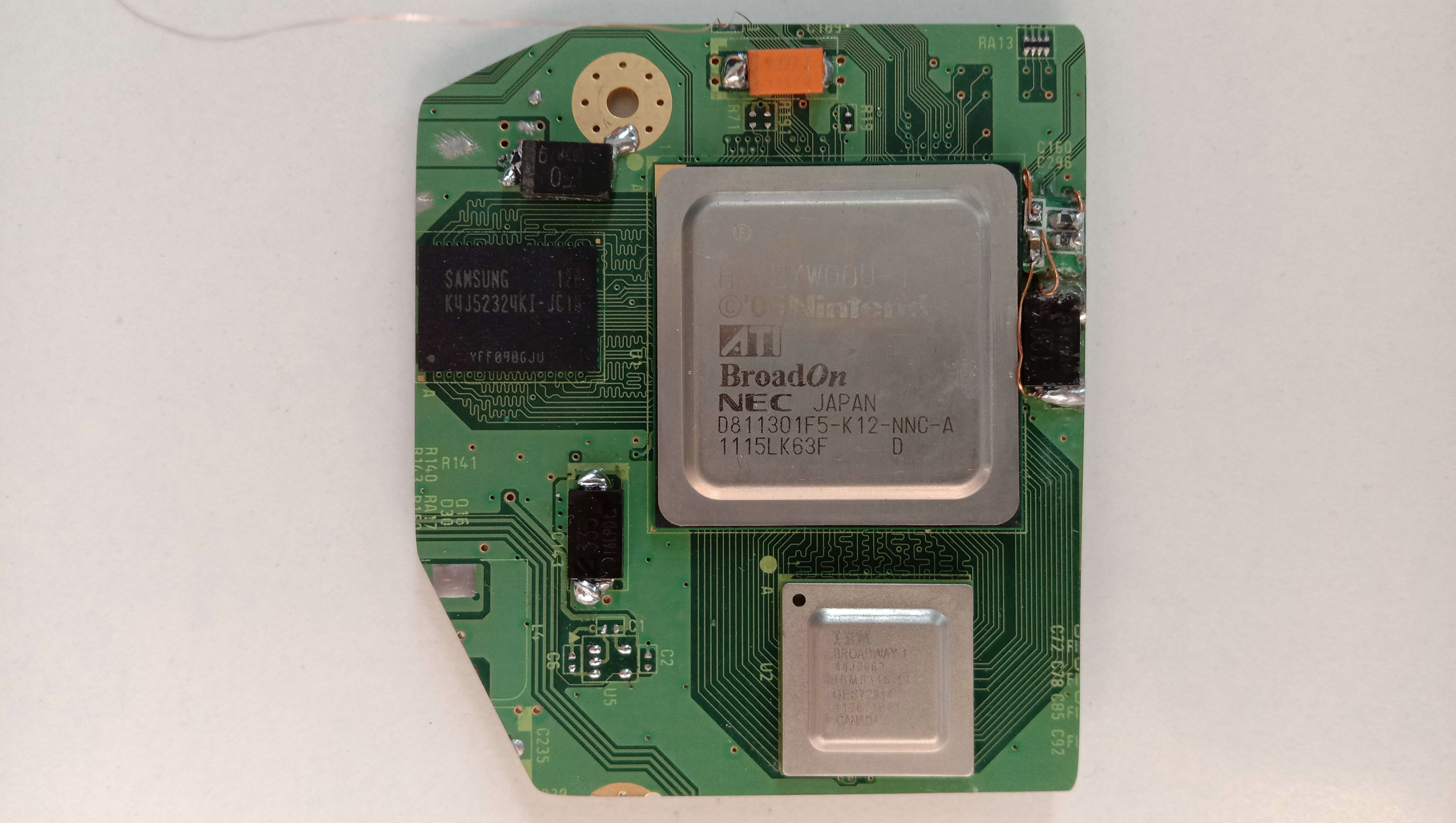

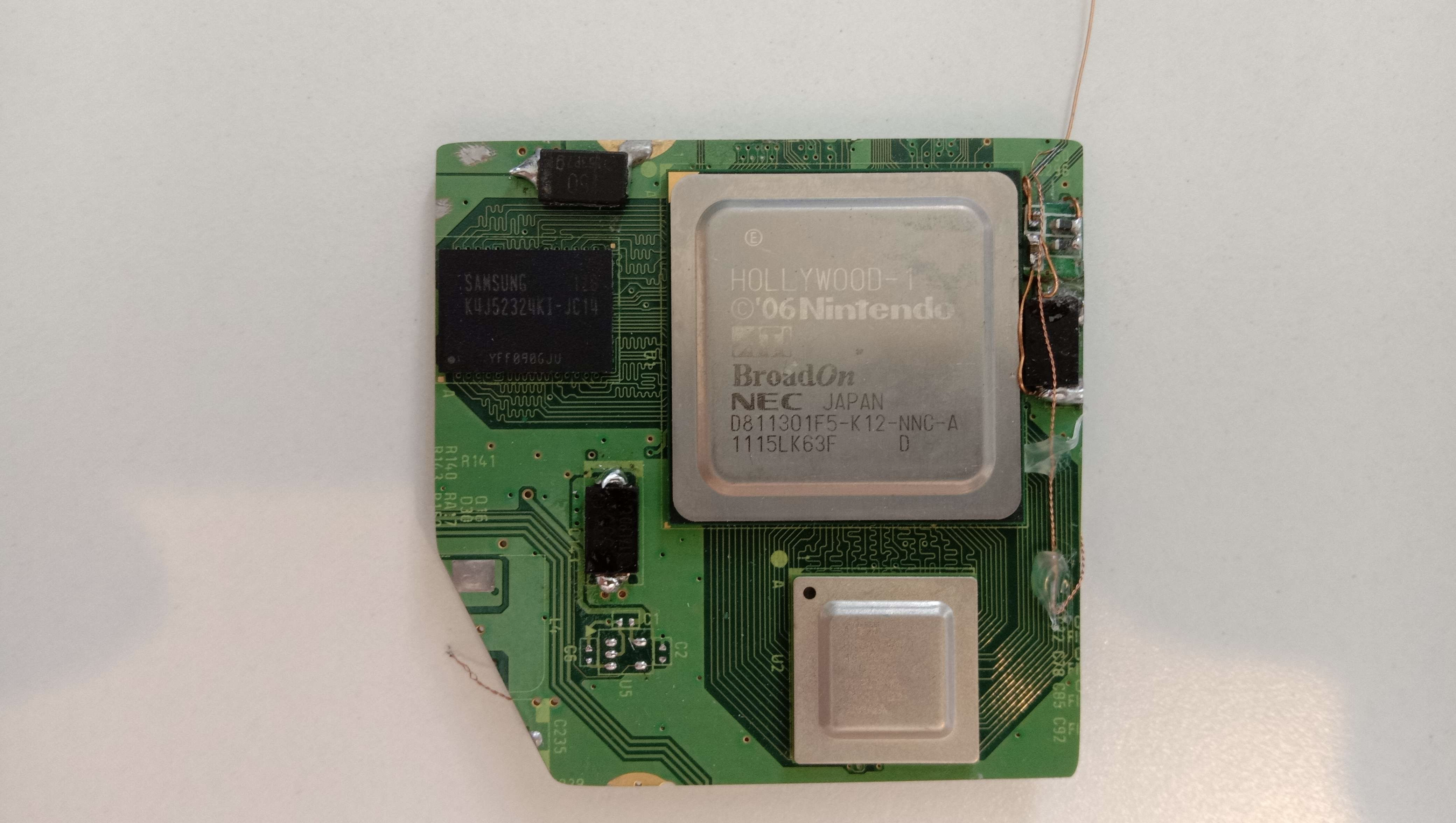

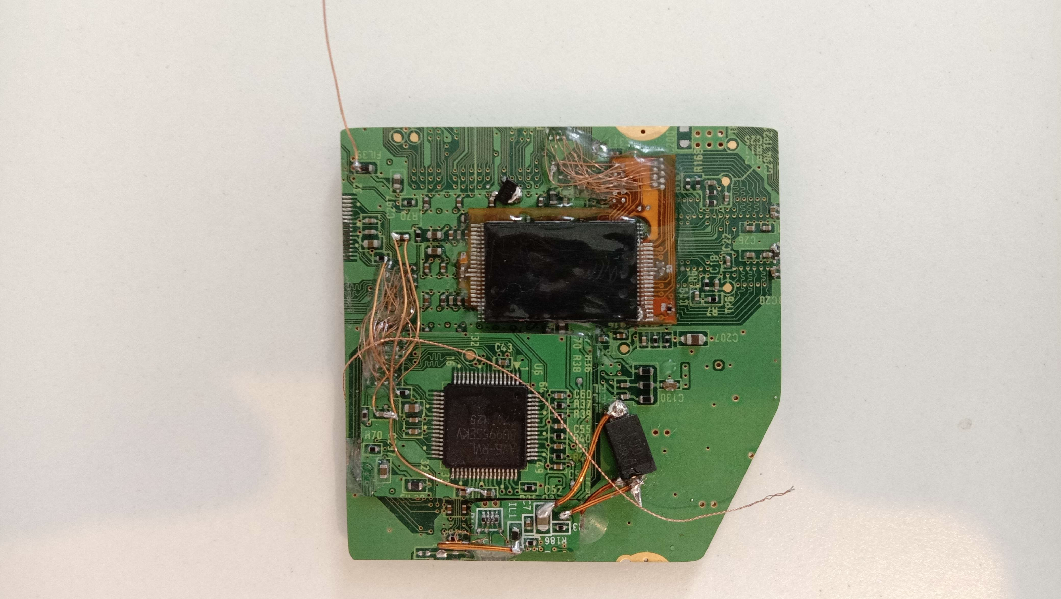

I've now trimmed the CPU side and have begun stability testing again, I'll verify that's fine before moving to the RAM side.
I didn't take it as far as I could (up to the vias) as that will be the final step of the build.
Once the system has been validated as stable I'll move on to the RAM side, then the AVE side before finally trimming the top.
This is looking far more promising than the previous trim.
It's done

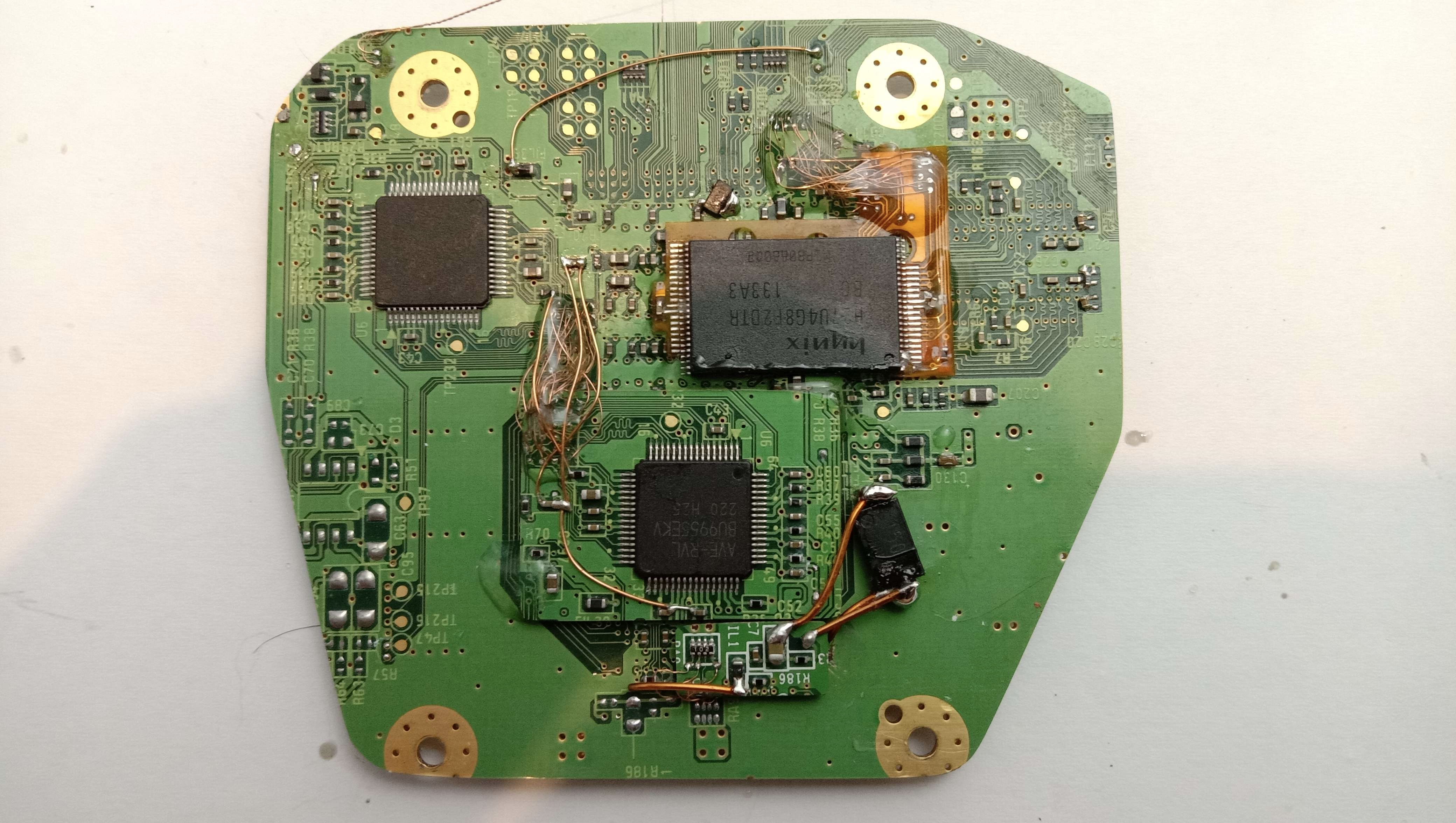

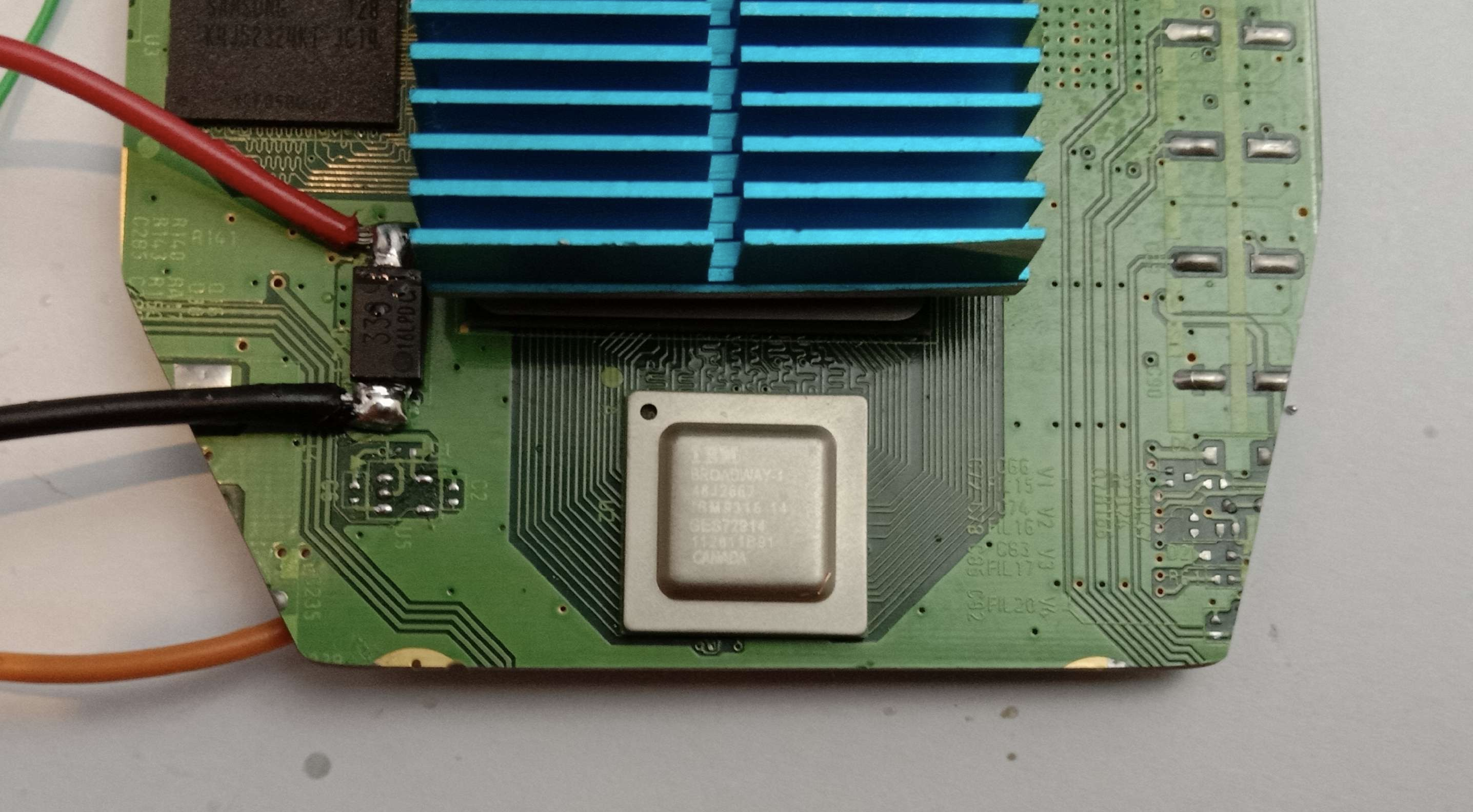

Here's a quick look at the most cursed looking trim before I had finished it:

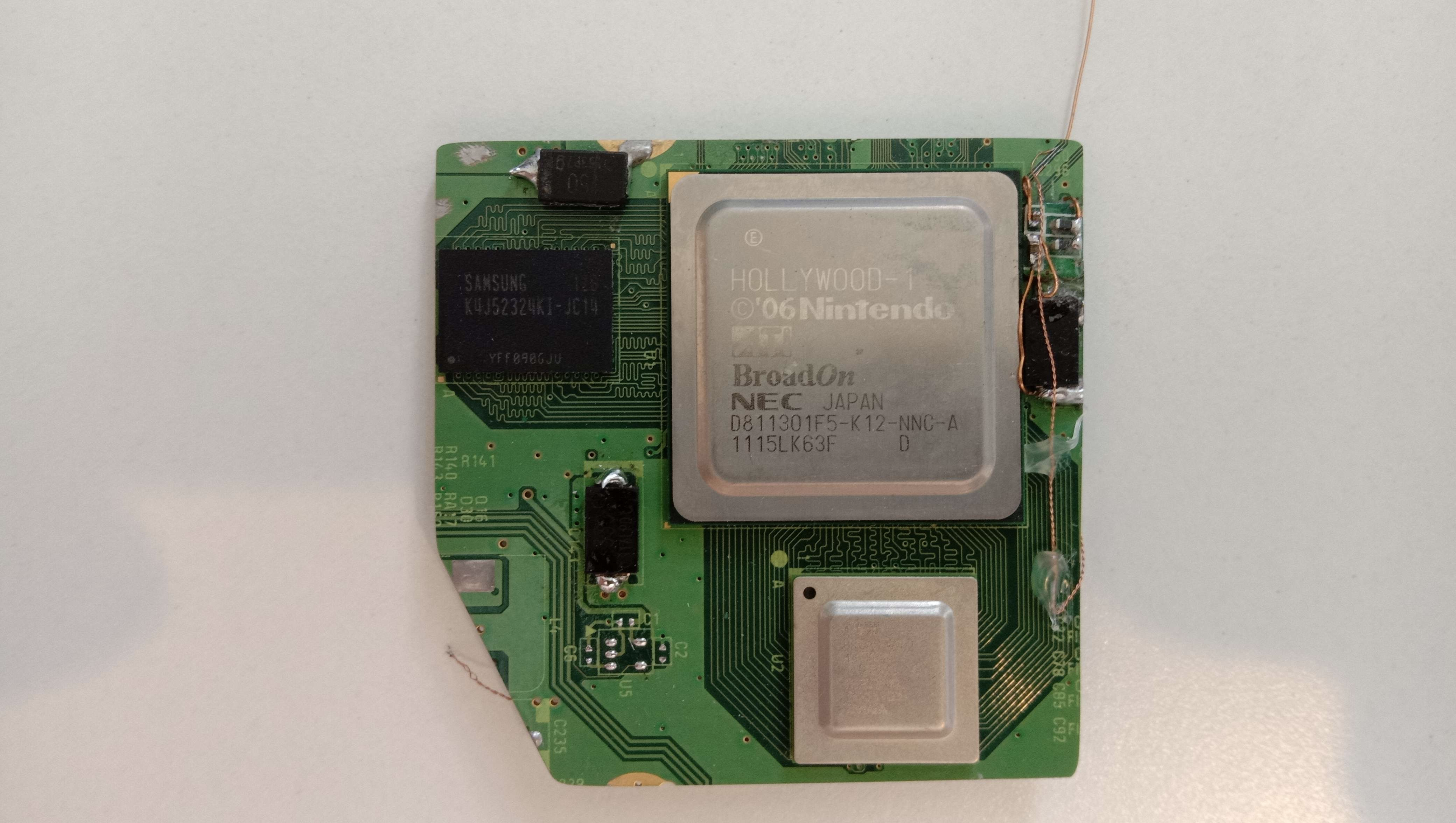

And here's a look at the *final* trim (an extra mm can be taken from the bottom but I cbf atm):
I've been running the system for about 3 hours now and it's running absolutely flawlessly, stability is rock solid

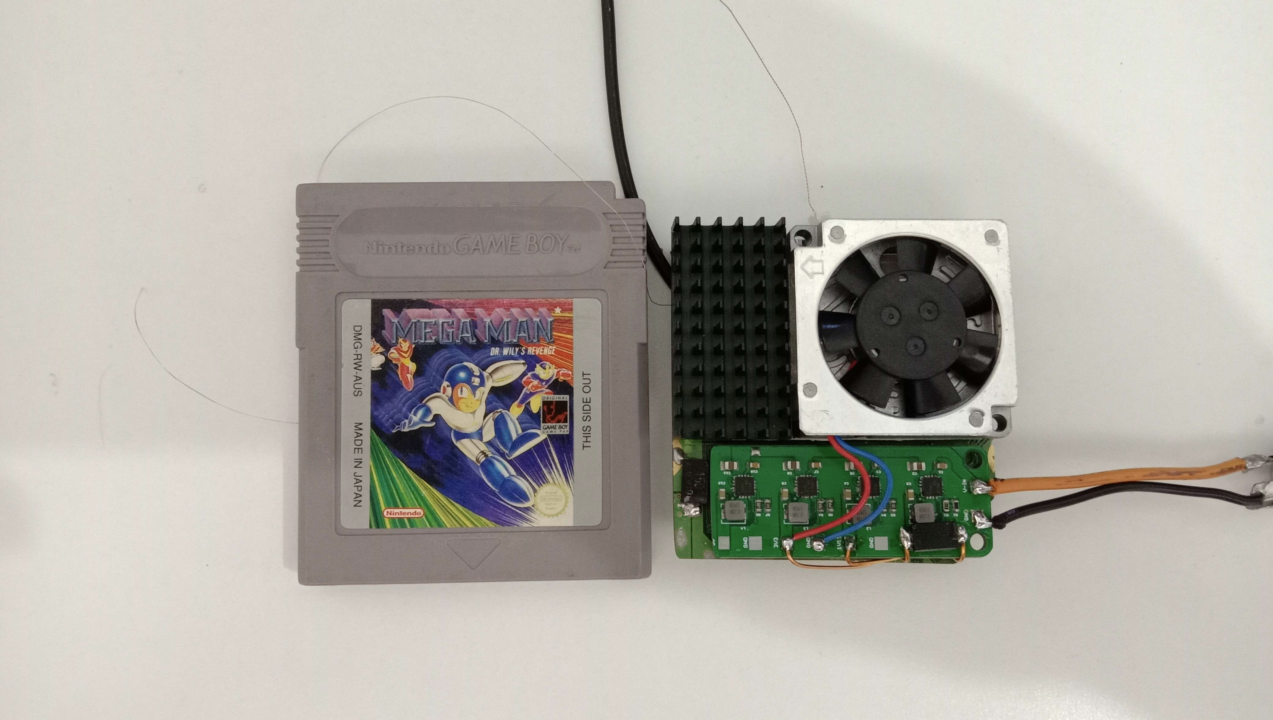

Here it is running in all its tiny glory:

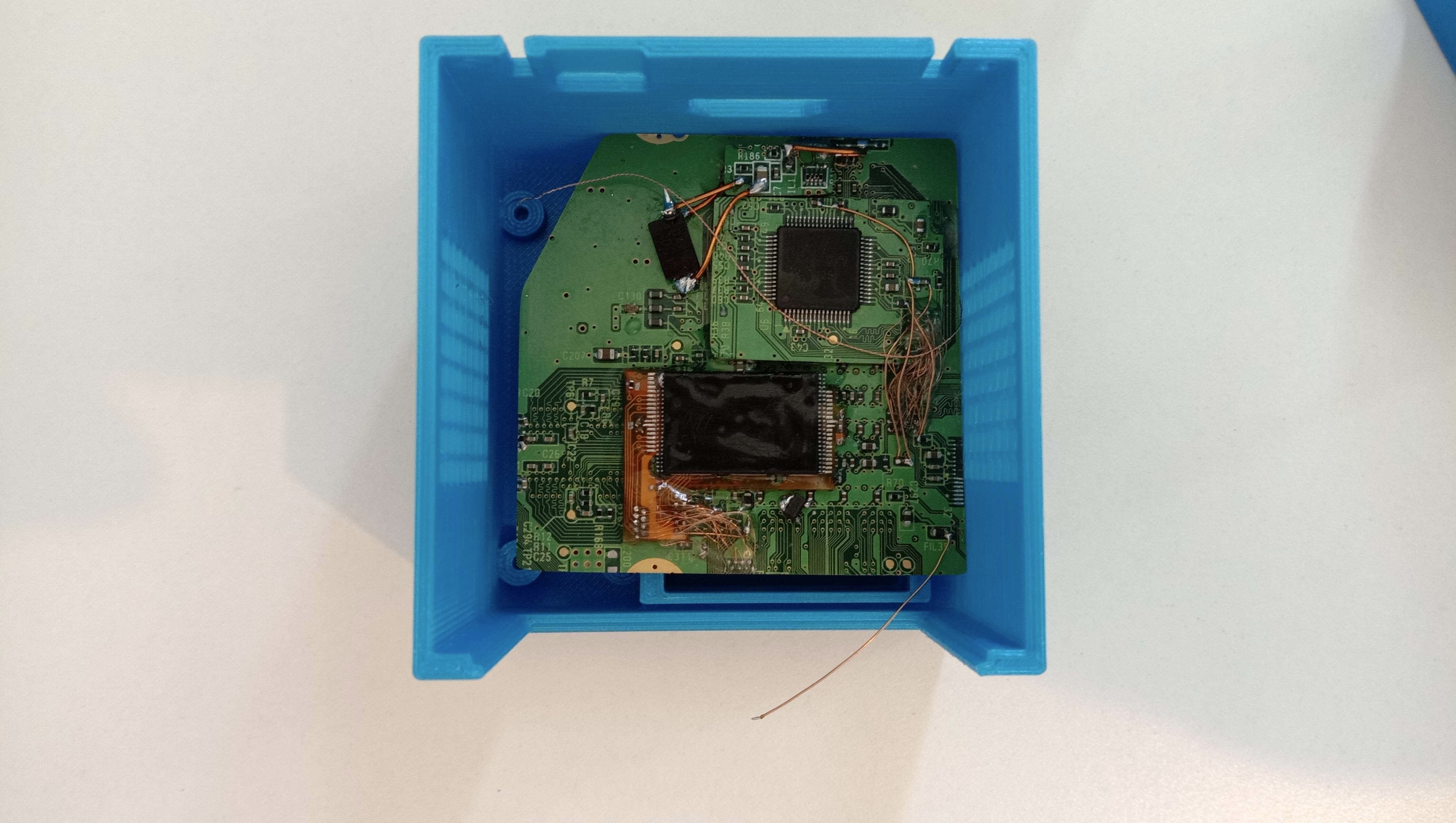

And here it is sitting inside the GC Nano shell:
Final measurements of this particular board are 52mm x 52.5mm
52mm x 51.5mm is attainable with slightly more trimming to the bottom but for now this is where I end my journey.

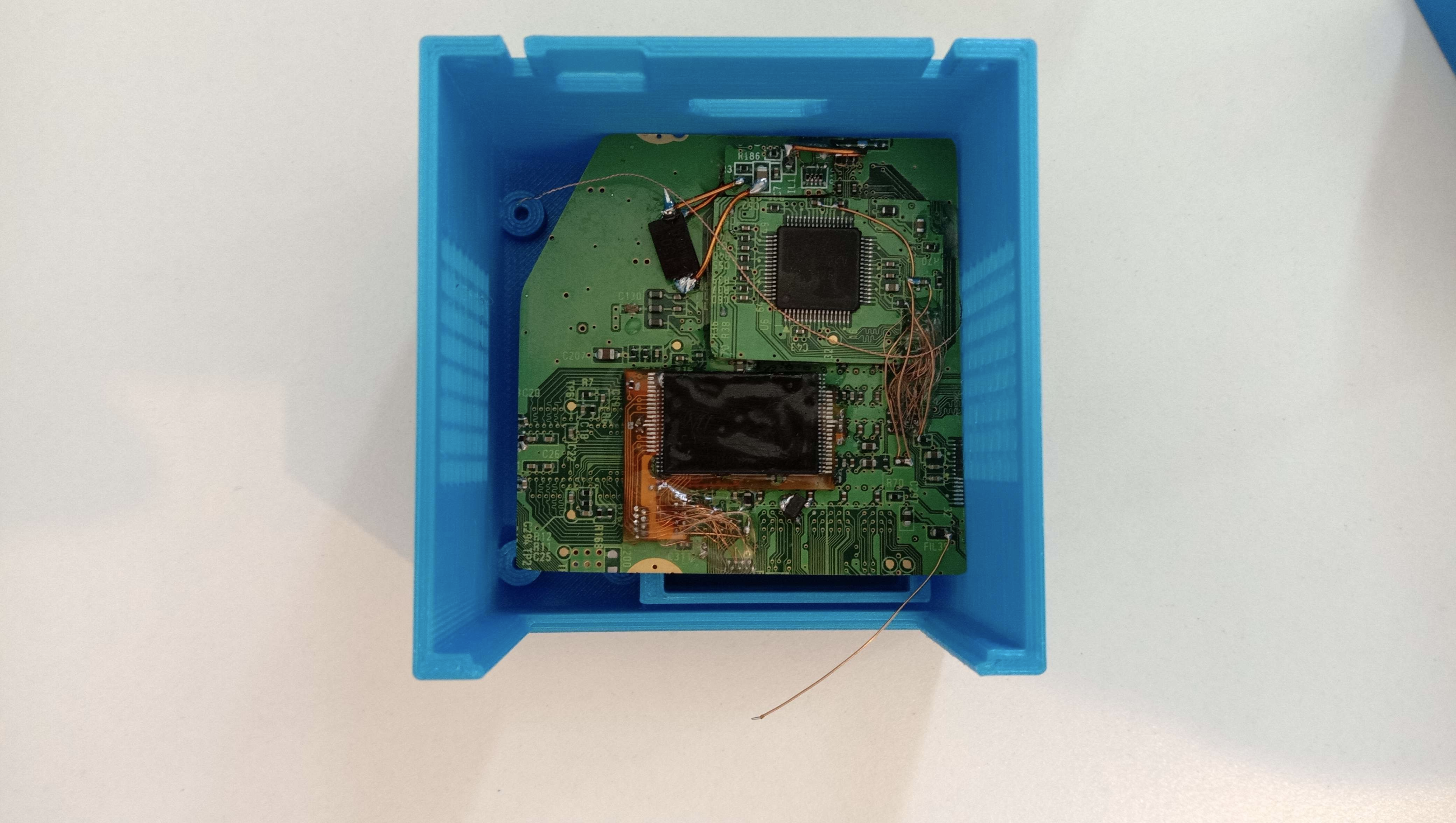

Final measurements of this particular board is 52mm x 52.5mm

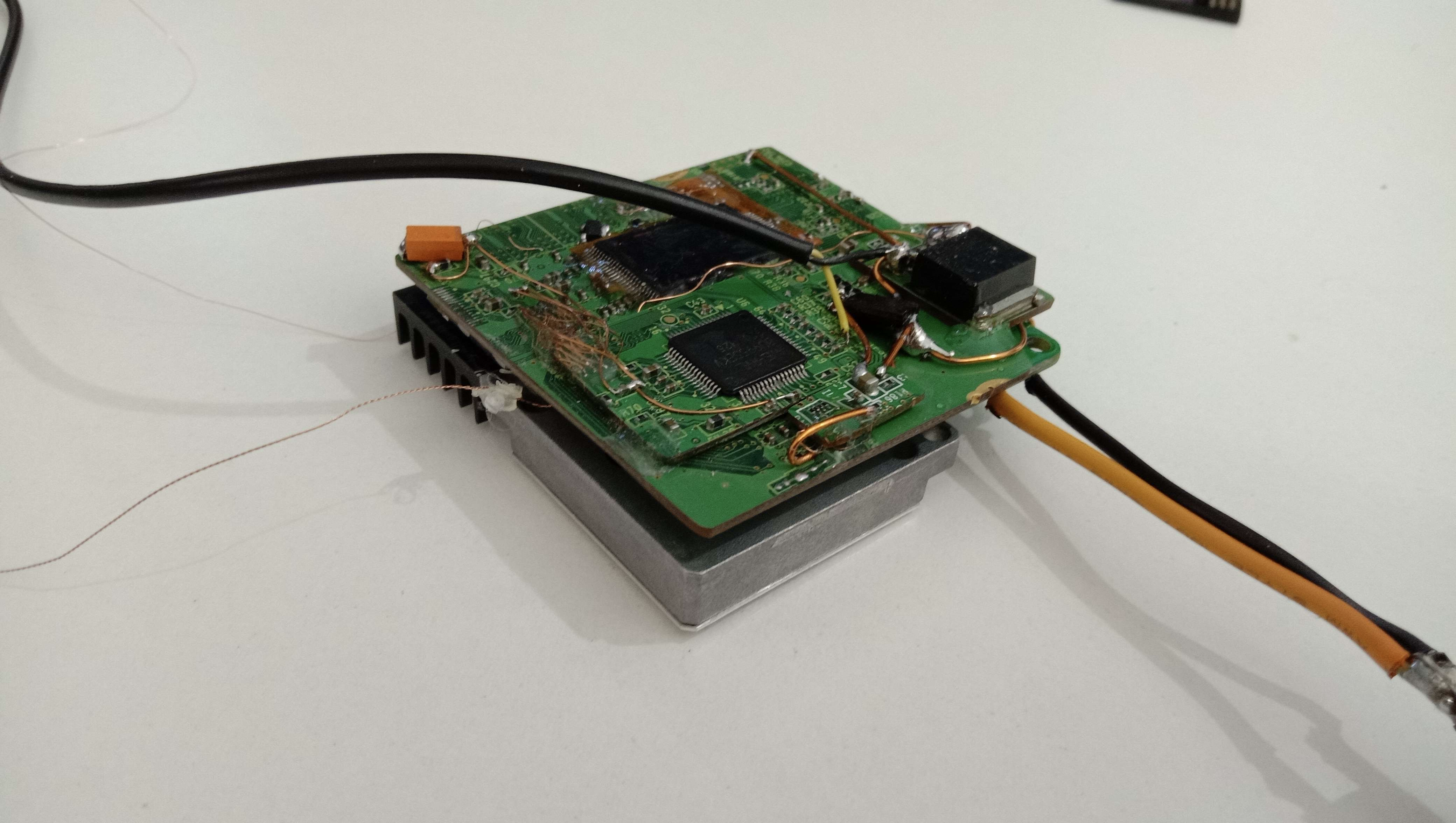

#OmegaIsDead
Today we pay our respects to the first FD Omega.
It gave it's life in pursuit of greater memes and it seems it flew too close to the sun.
After it's fourth/fifth overheat (somewhat deliberate) it decided it was time to move to the great beyond to join Yamauchi and Iwata in eternal bliss.
But do not grieve, for what we have discovered from FD's noble sacrifice shall lead us forward into a new age of impossibly small Wii's beyond what anyone could imagine.
