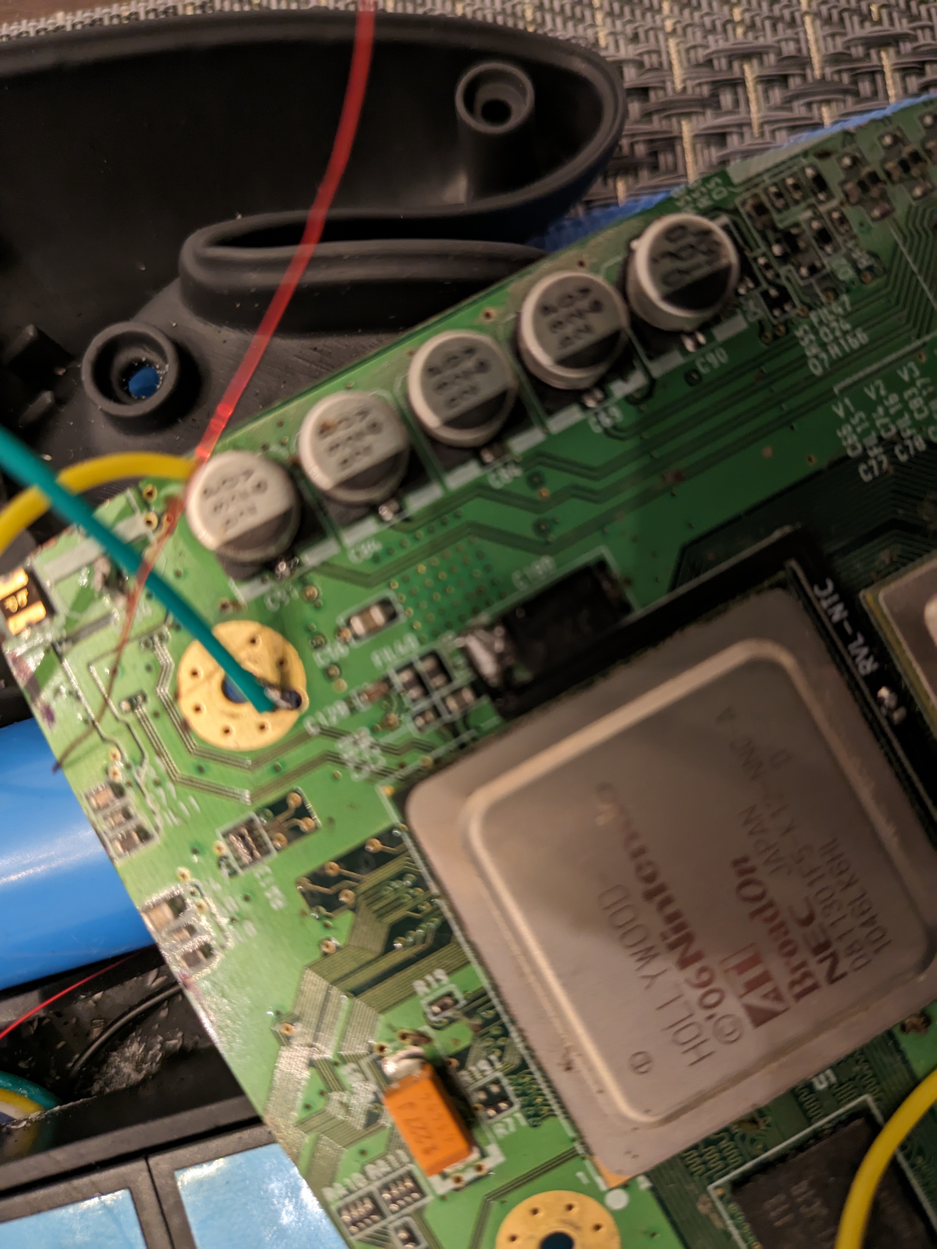

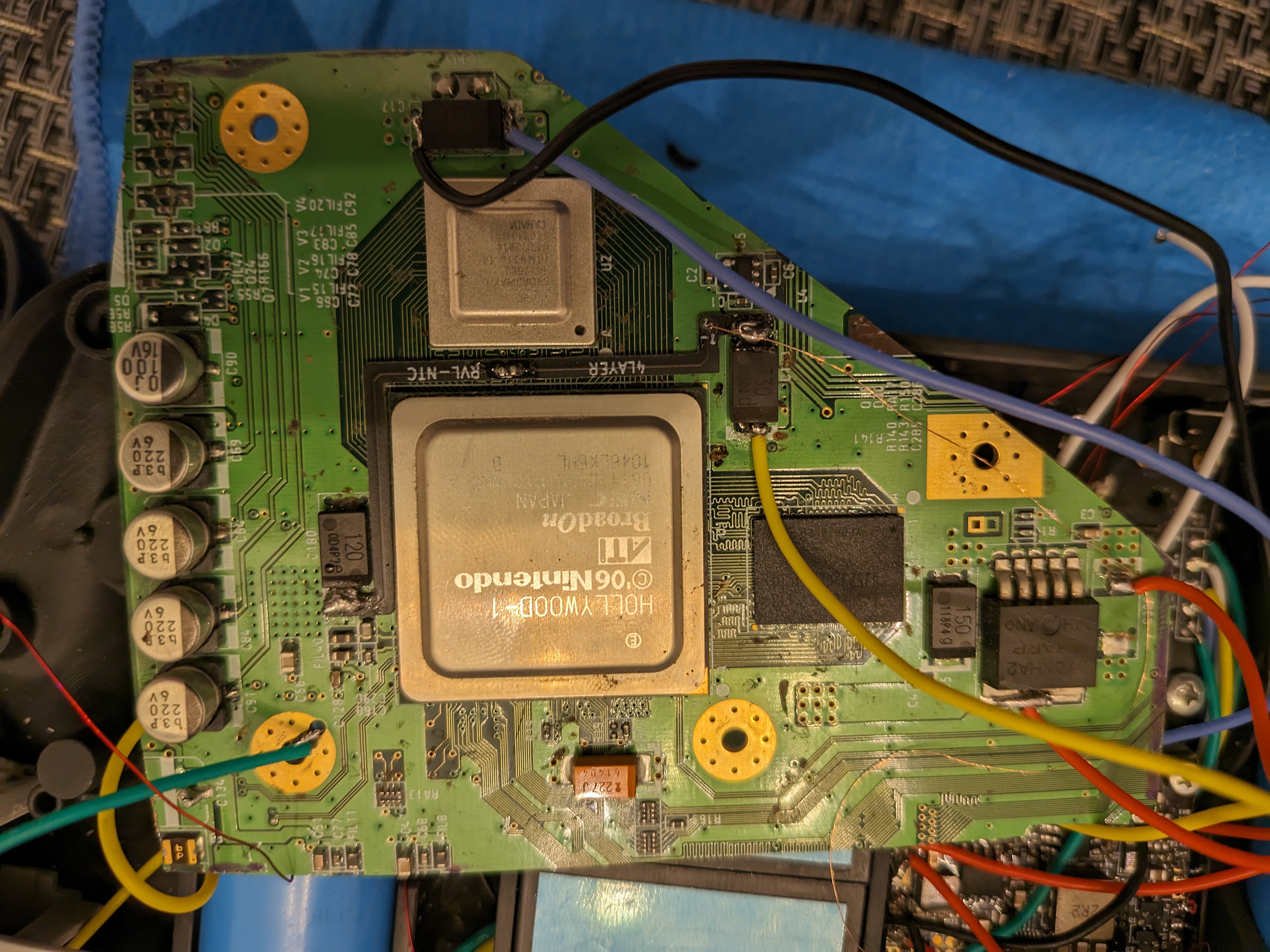

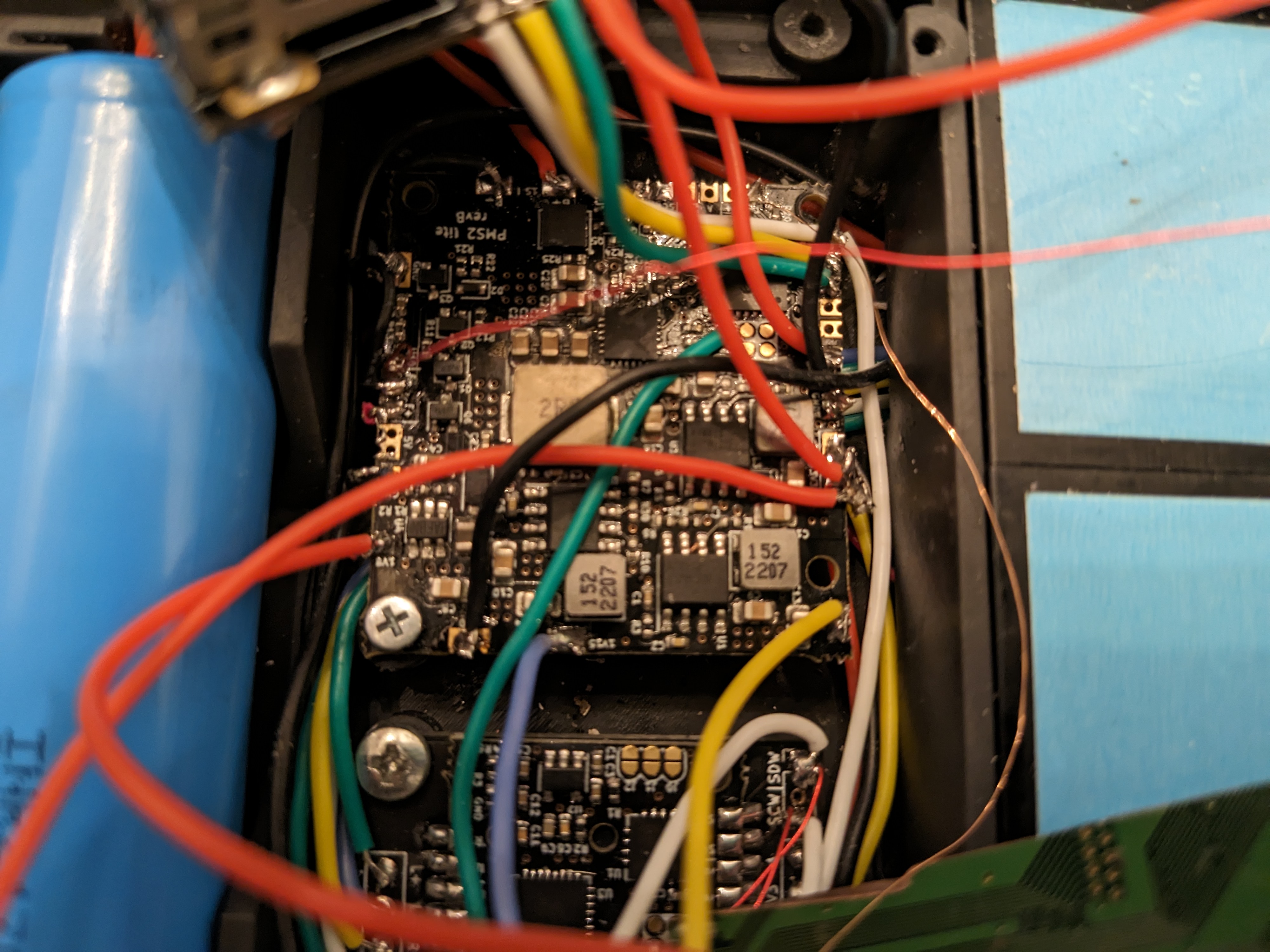

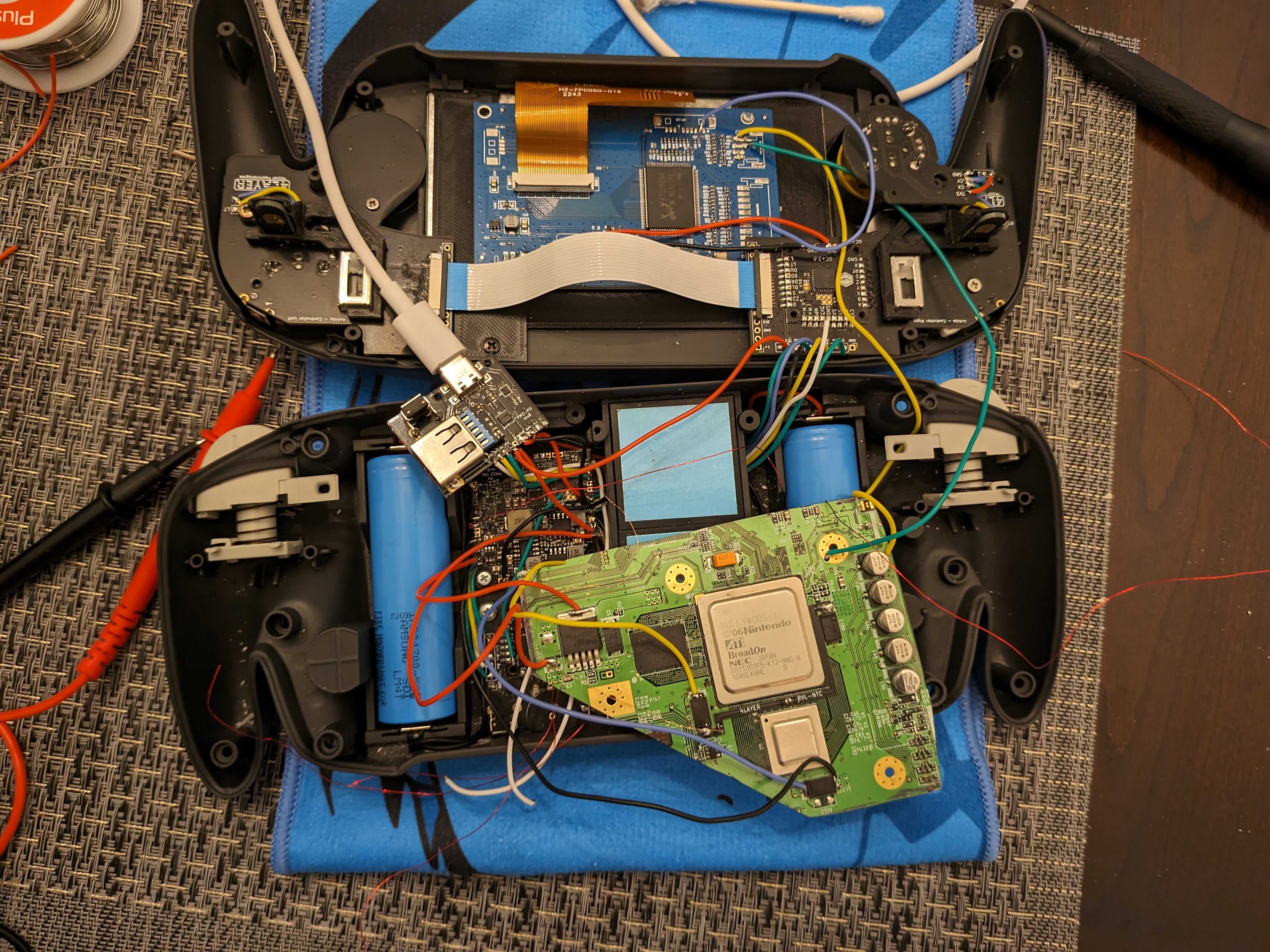

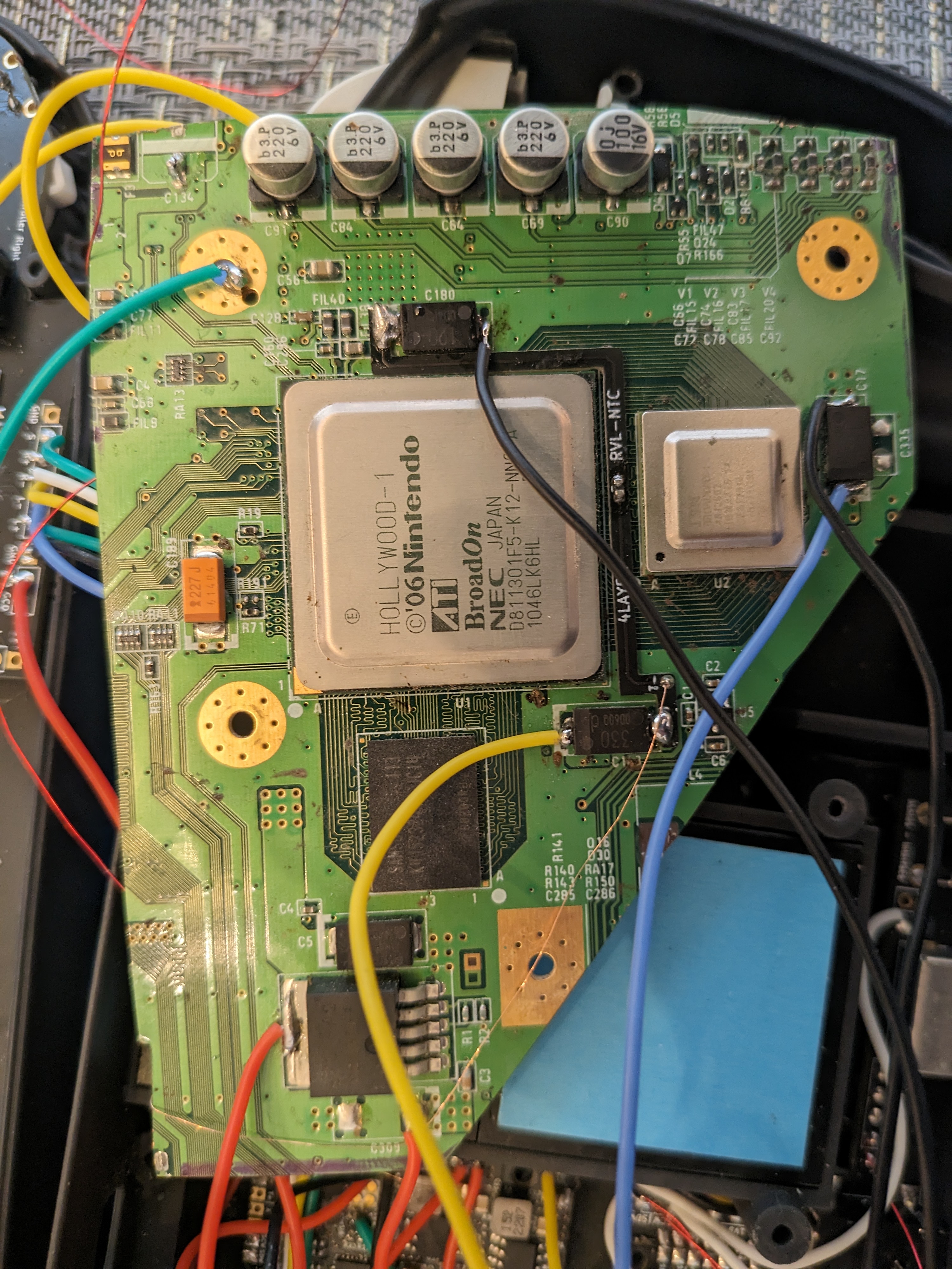

Alright, so I got a 4 layer board in. Setup RVloader, trimmed, threw it in.. but unfortunately still no display. I'm still using the PMS Lite, and checked output of all connections (all good), and CPU gets hot. I'm thinking it could be the component connection but not sure..
Pics of the underside will help.
I apologize, I will get a pic and send it over. Only thing wired up underneath is the u10.

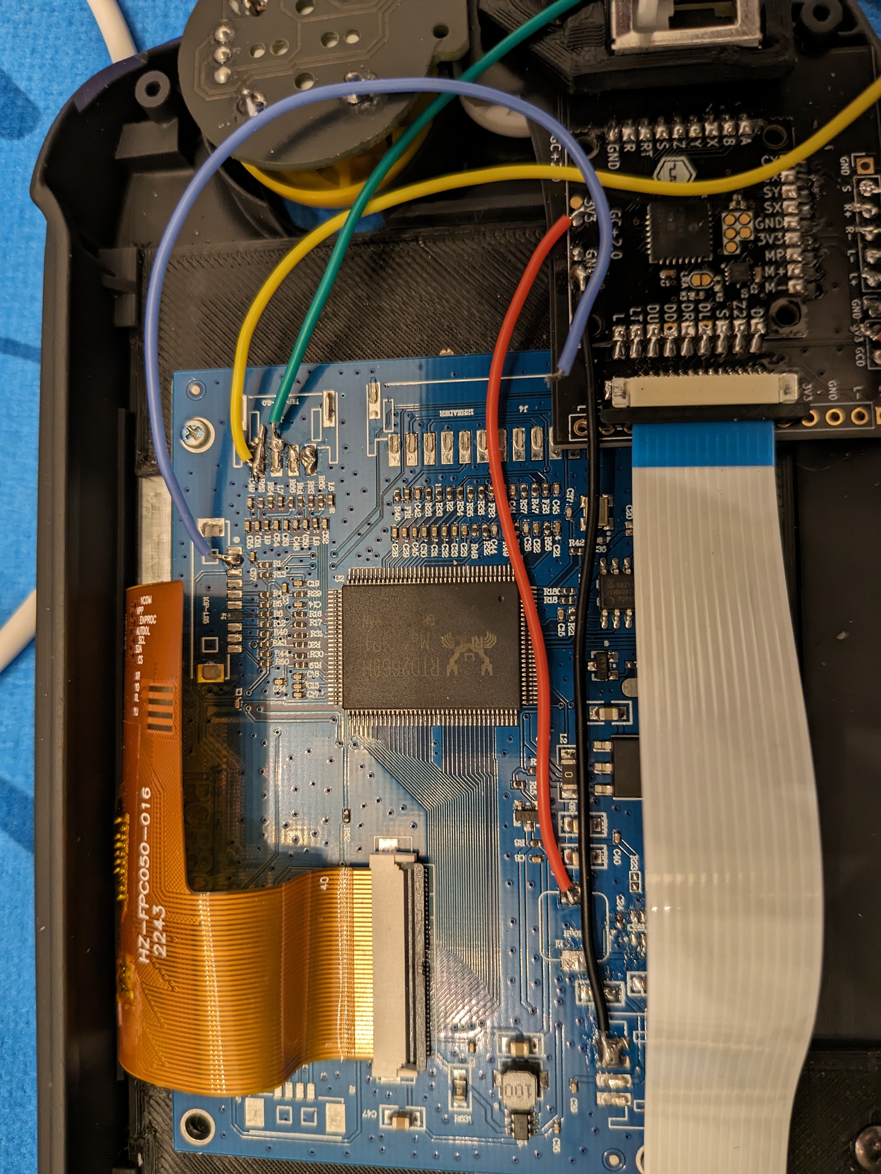

Try connecting an additional ground wire from the PMS to the Wii. Also, that ground wire for the screen doesn't look like it's very well secured on the Wii side. I'd redo/relocate that as well
Alright, tried the suggested with no luck :/

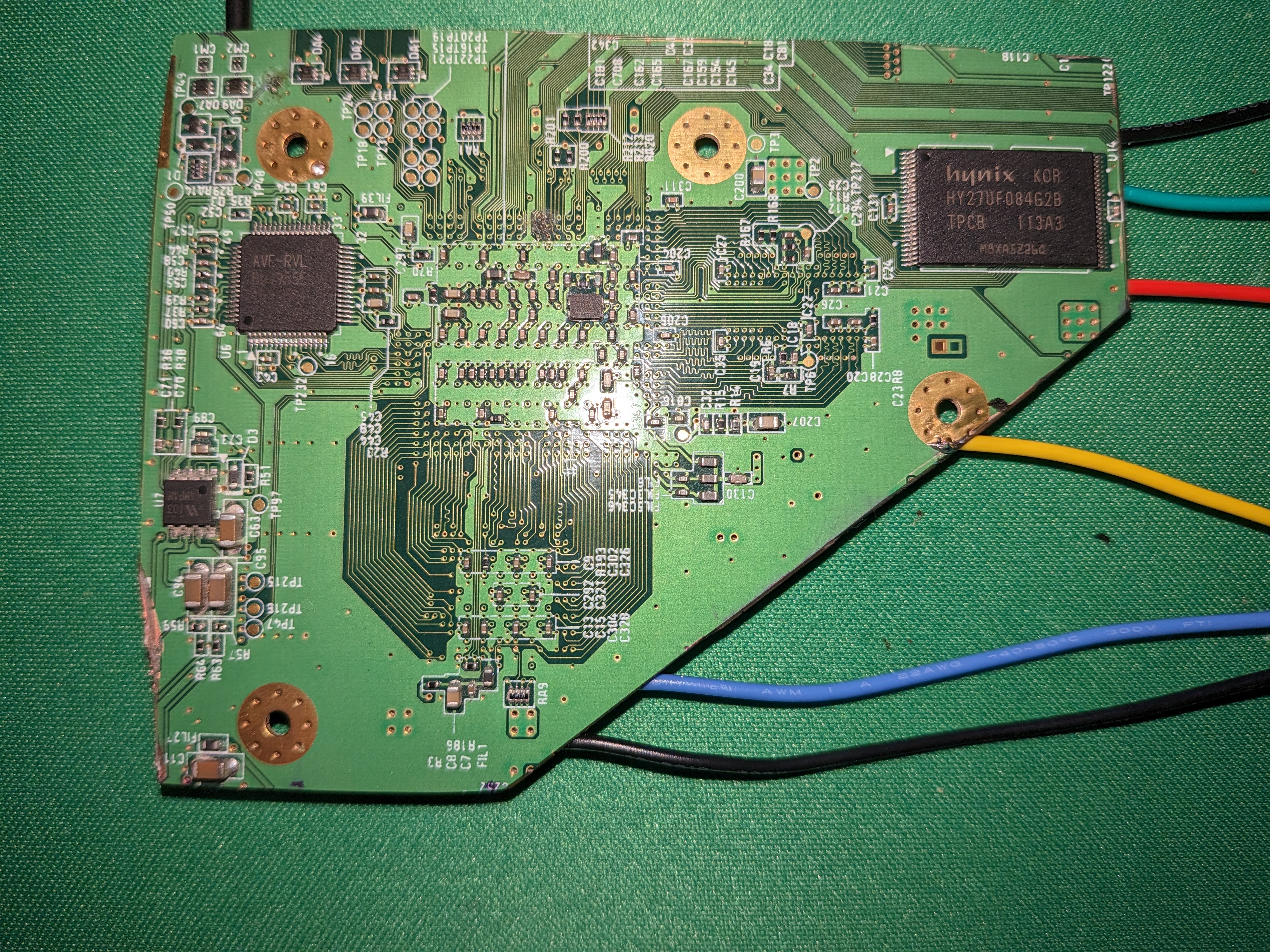

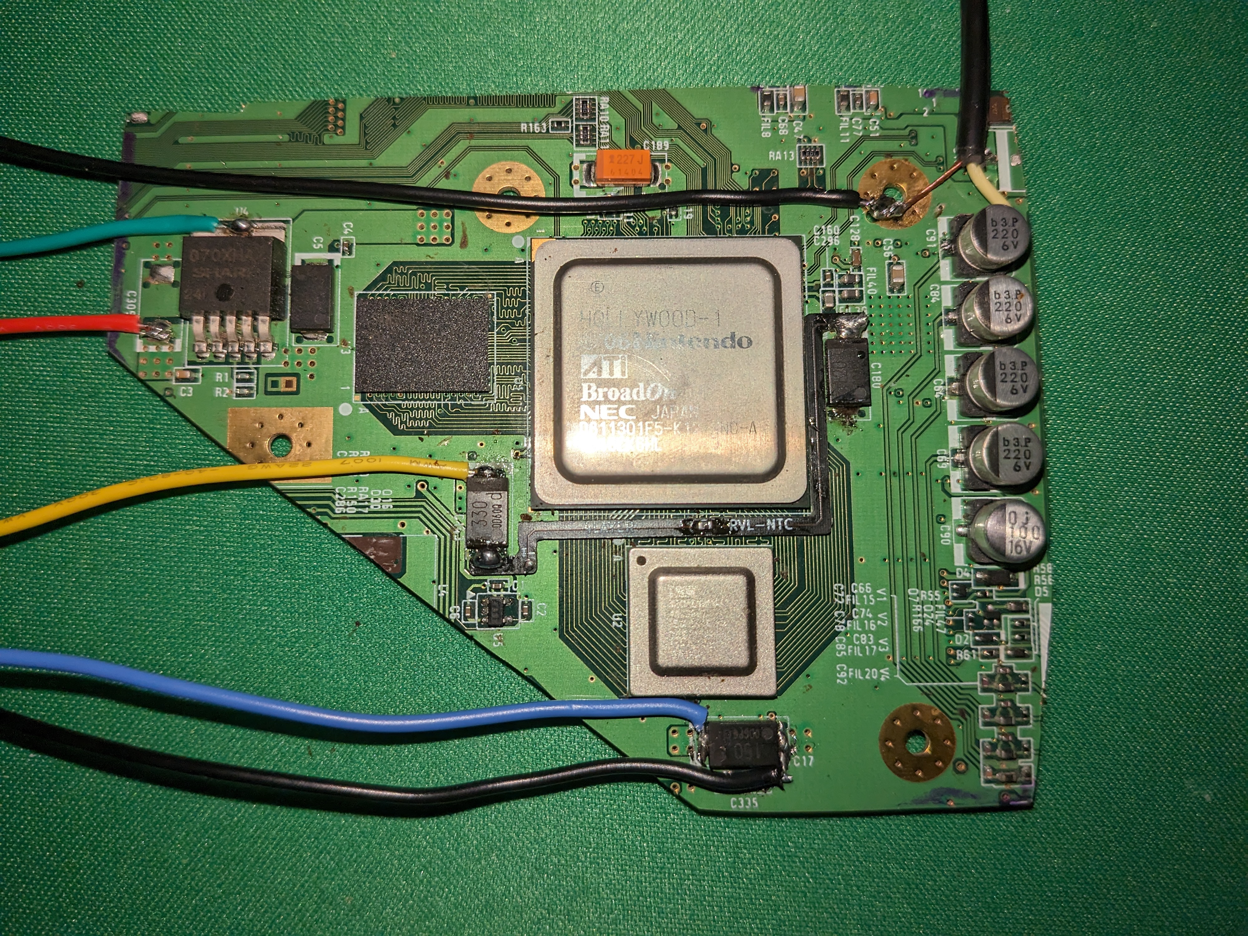

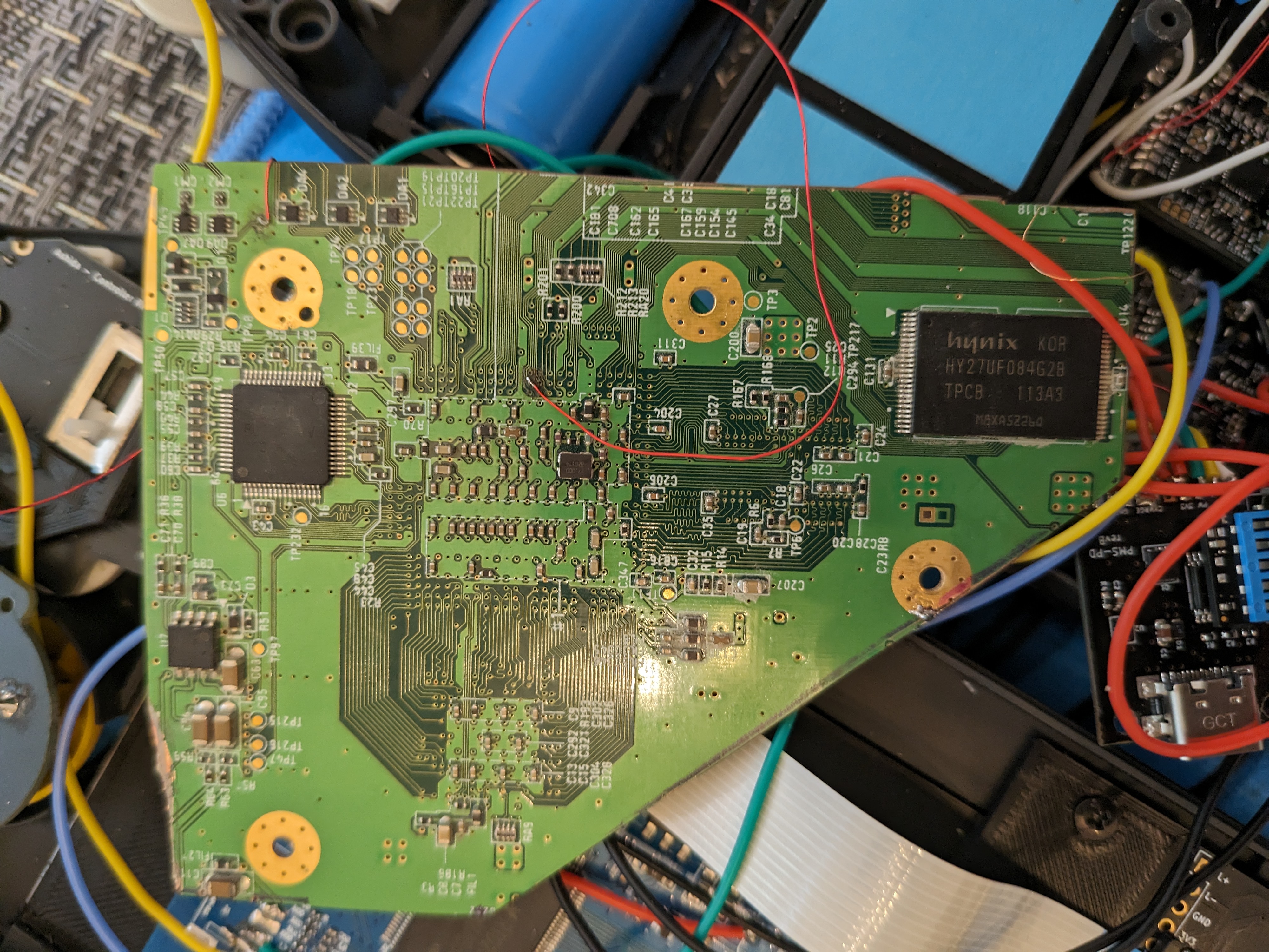

Here is a picture of the back of the board
There is a lot of conductive debris left on the board from trimming that might be causing problems. Give the whole thing a good clean off with a soft bristled brush and some isopropyl alcohol.

Just switched to 22AWG single core and cleaned the board as recommended. These are the readings.I noticed that the 1v line starts at 93 and slowly climbs to 119. Connected everything with the same result, cpu hot but no display.
1v - 93ohm
1.15v - 26ohm
1.8v -36ohm
3.3v - 553ohm
93 26 36 553
121 131 695
85 604
600

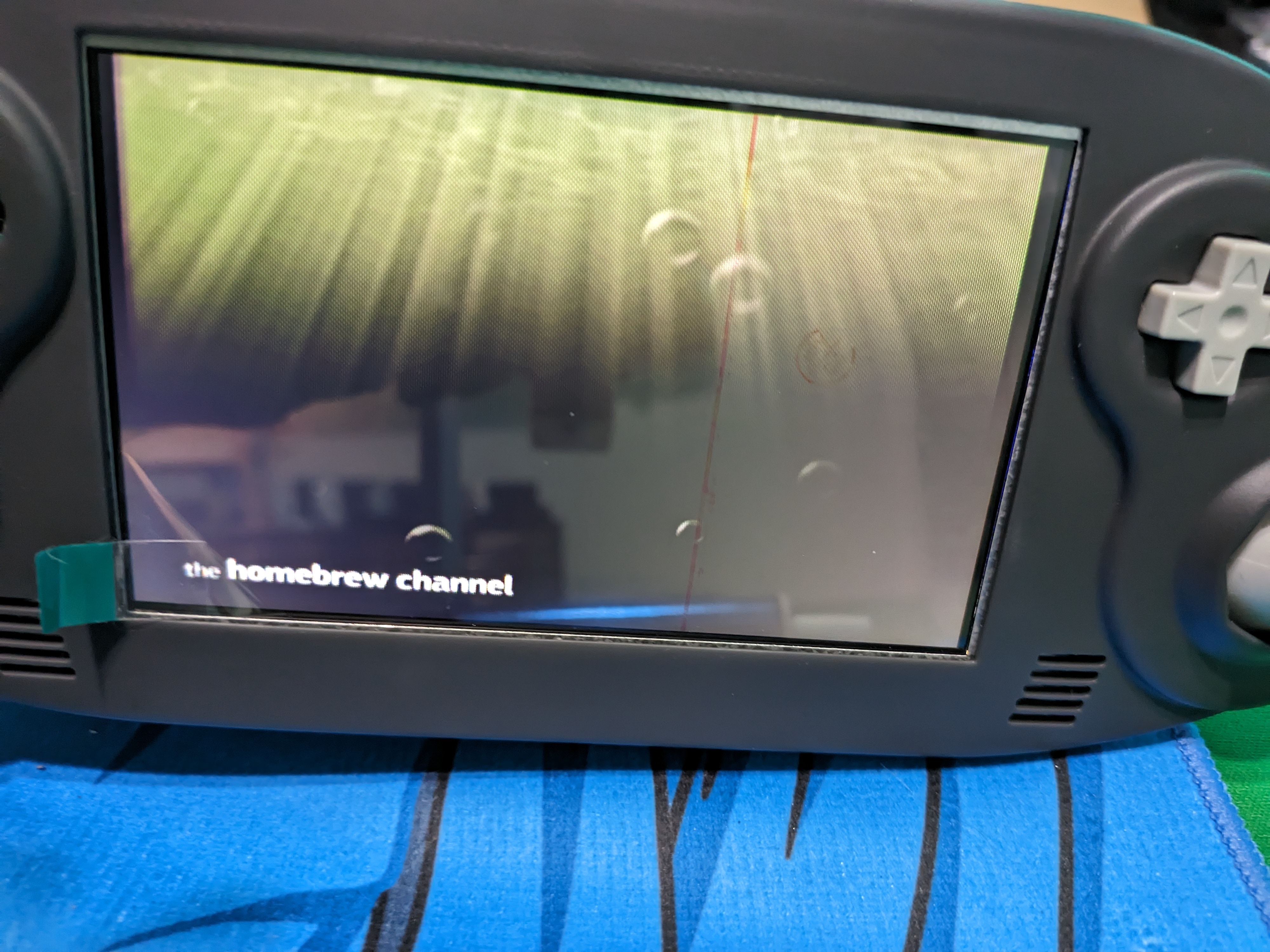

UPDATE
Soldered Reset to GND and it boots to homebrew menu, however the screen is upside down haha
UPDATE
That's normal. The HBC displays upside down when you modify a certain IOS module, which happens to be one that RVLoader replaces to make portablising easier
