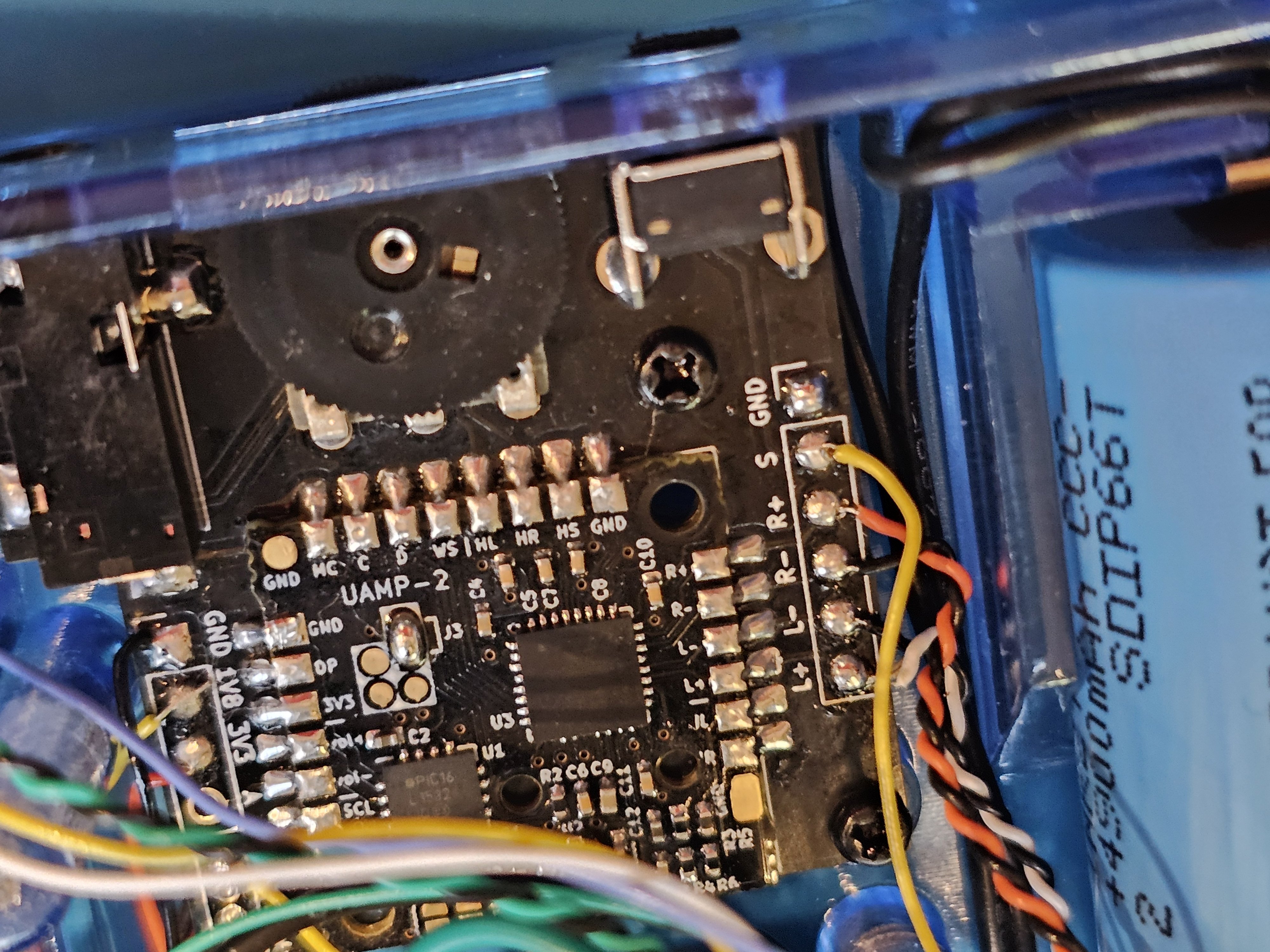

Q.

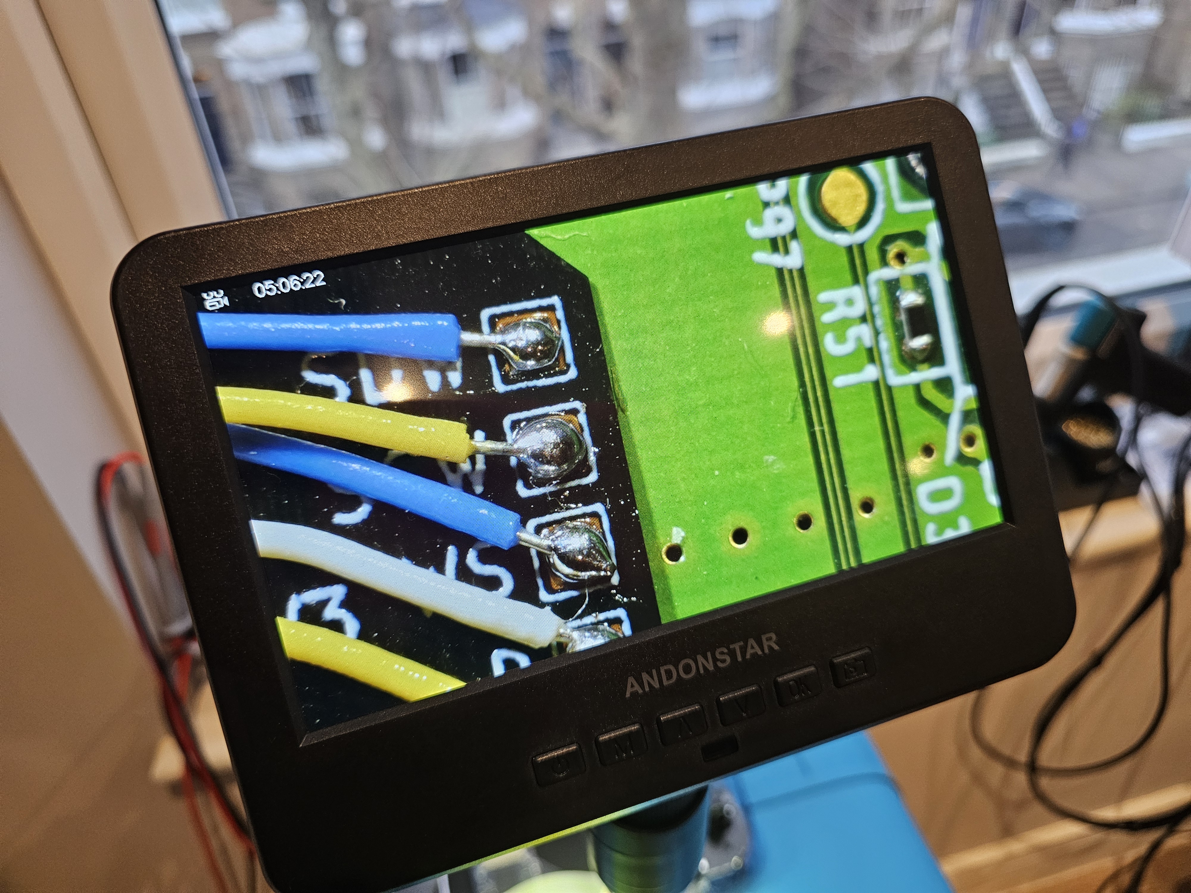

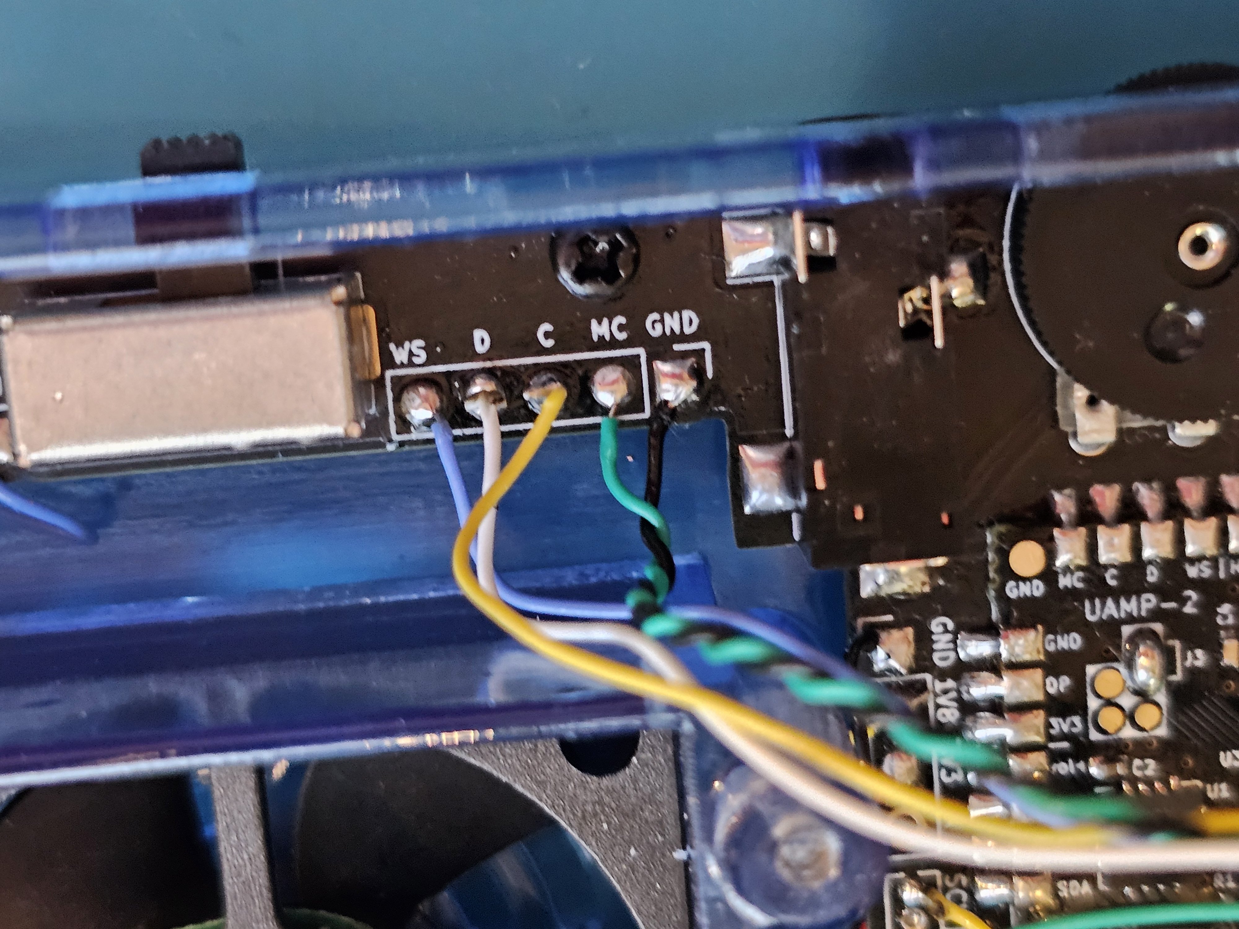

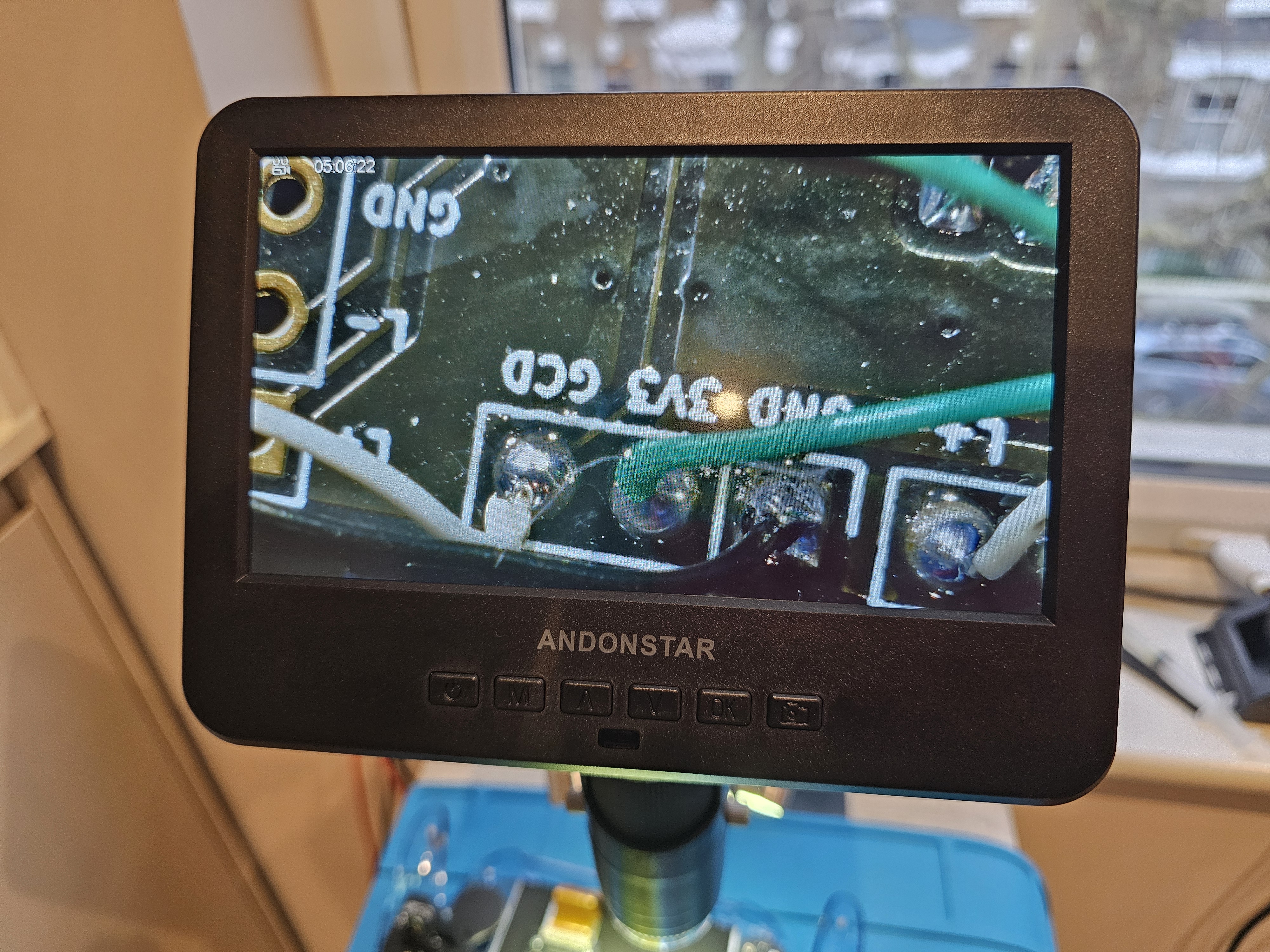

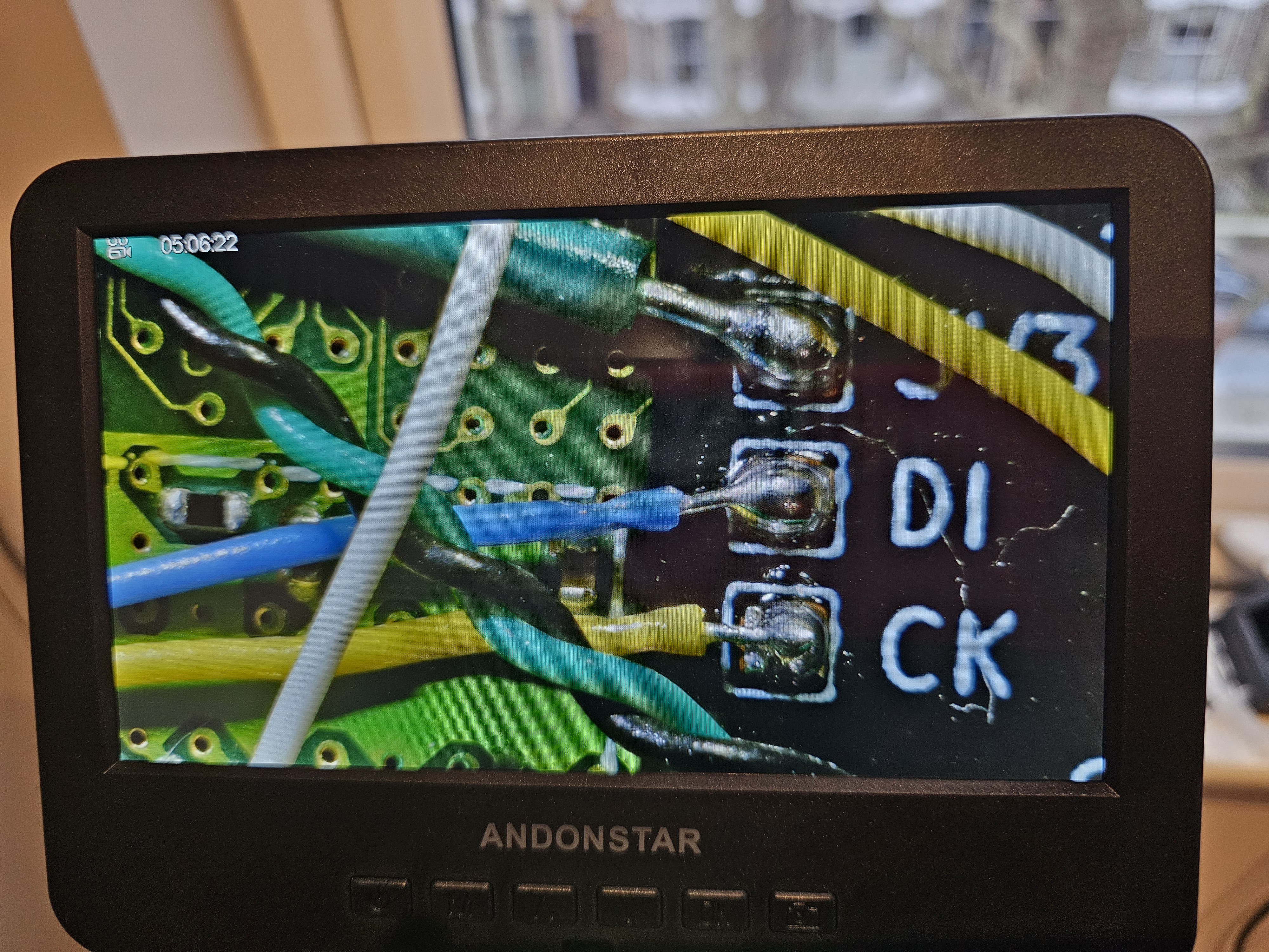

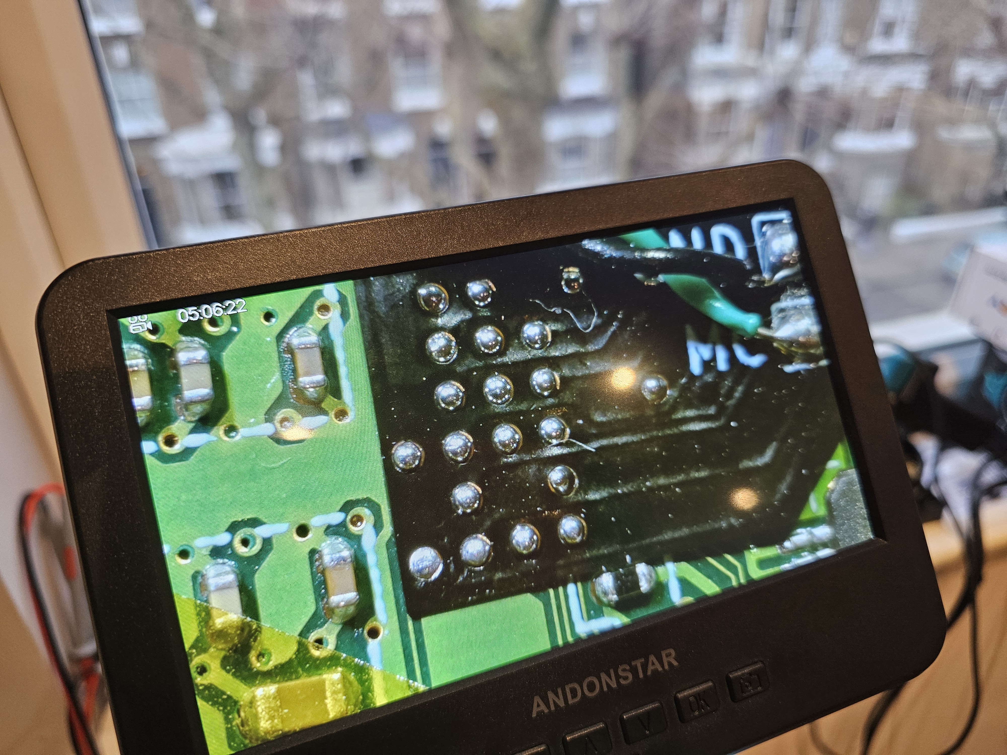

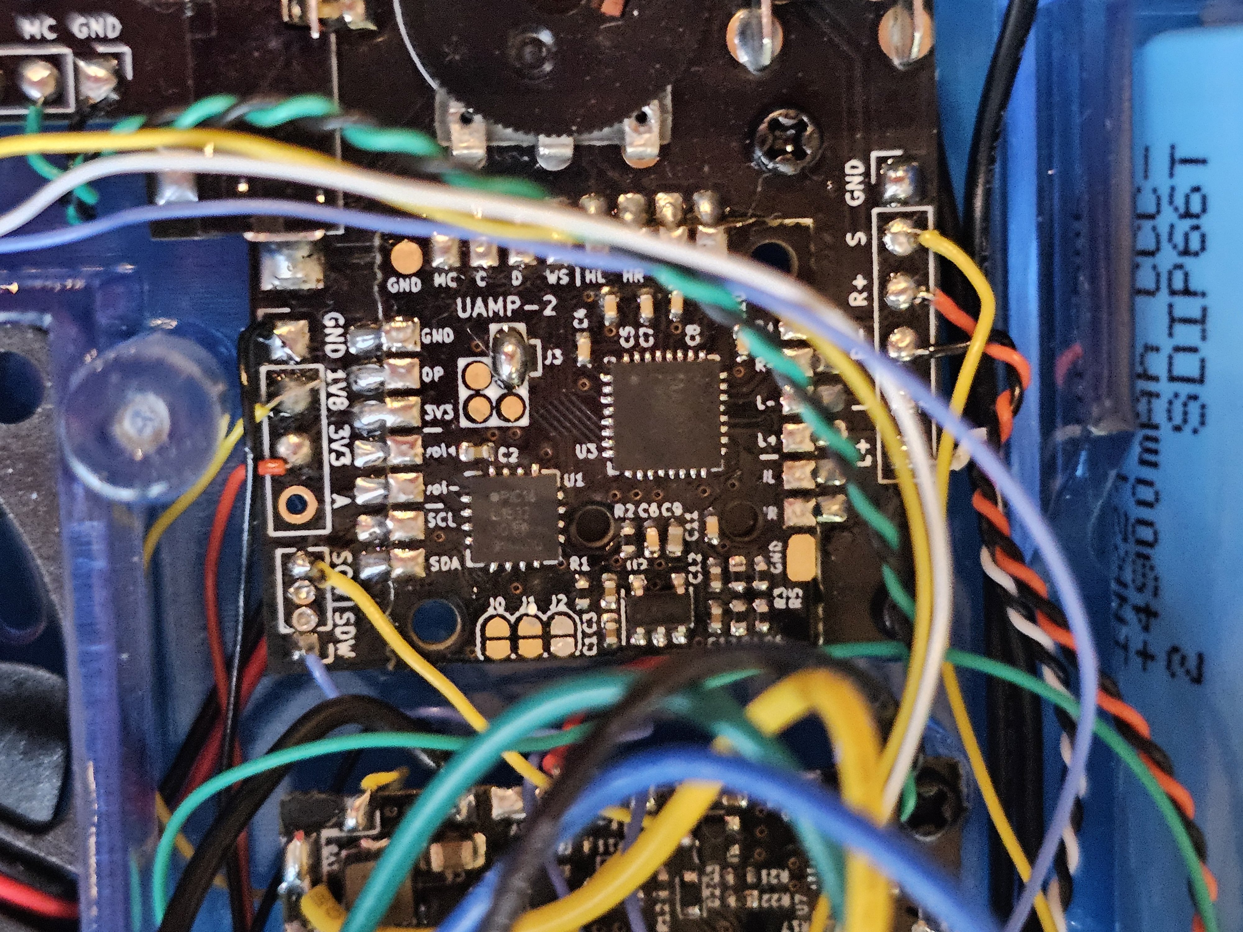

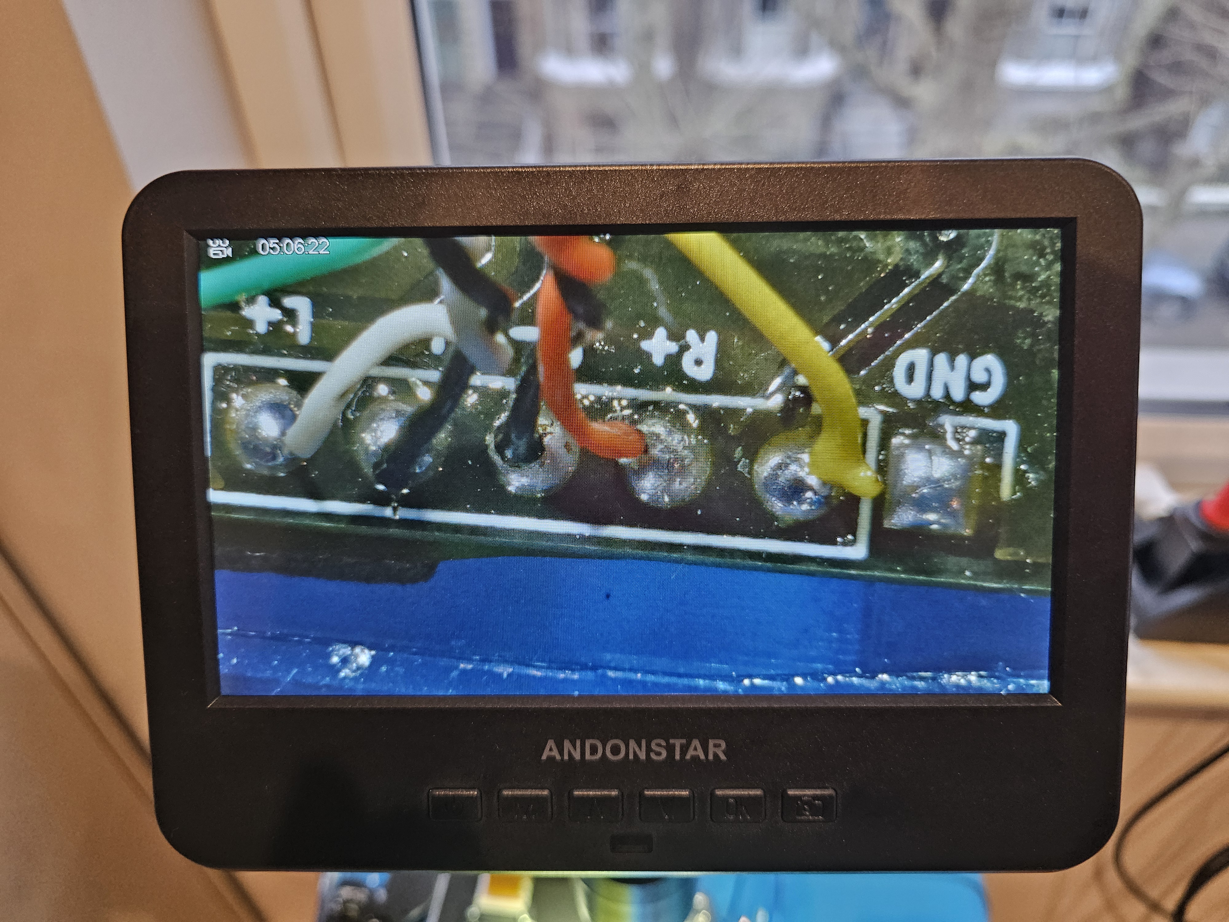

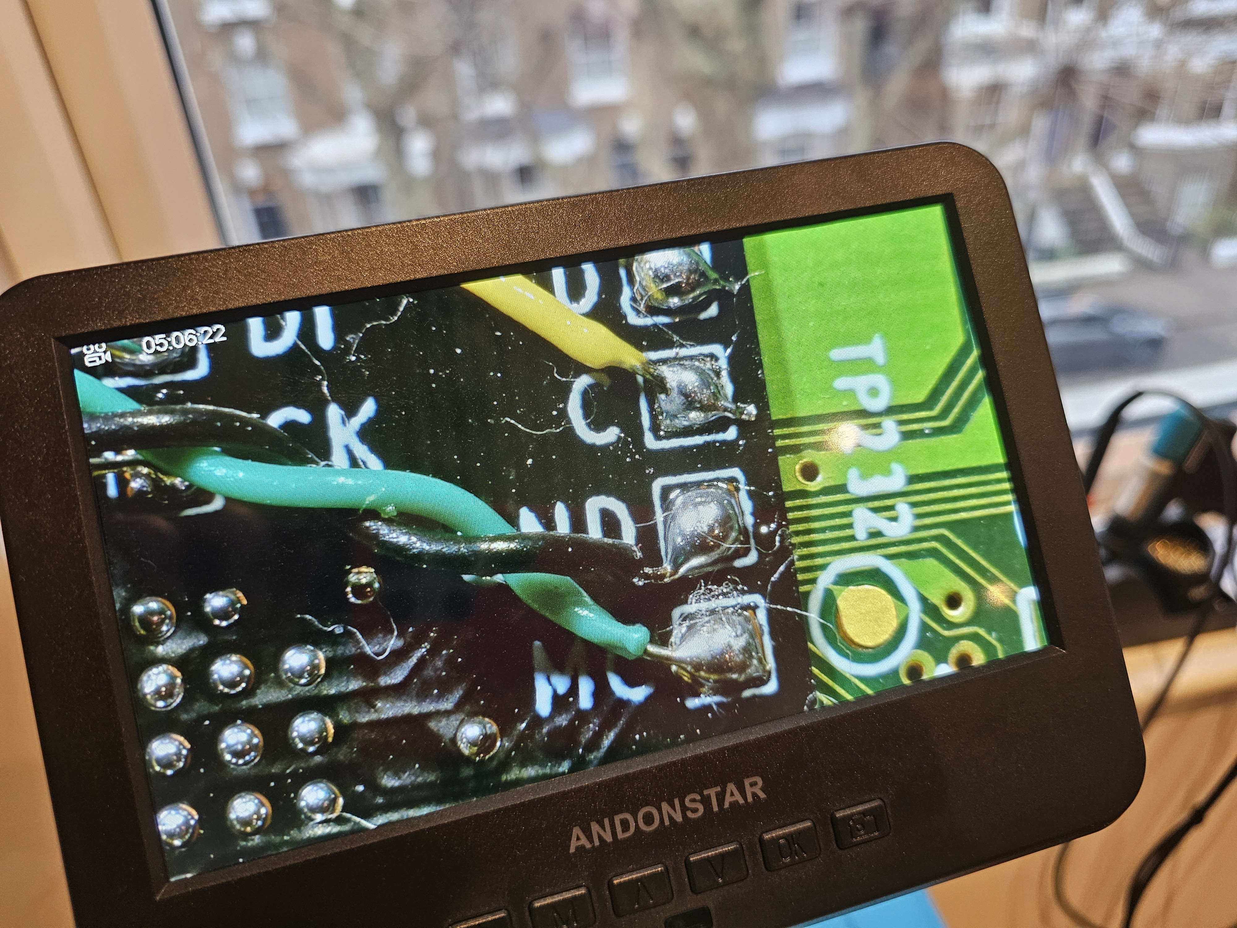

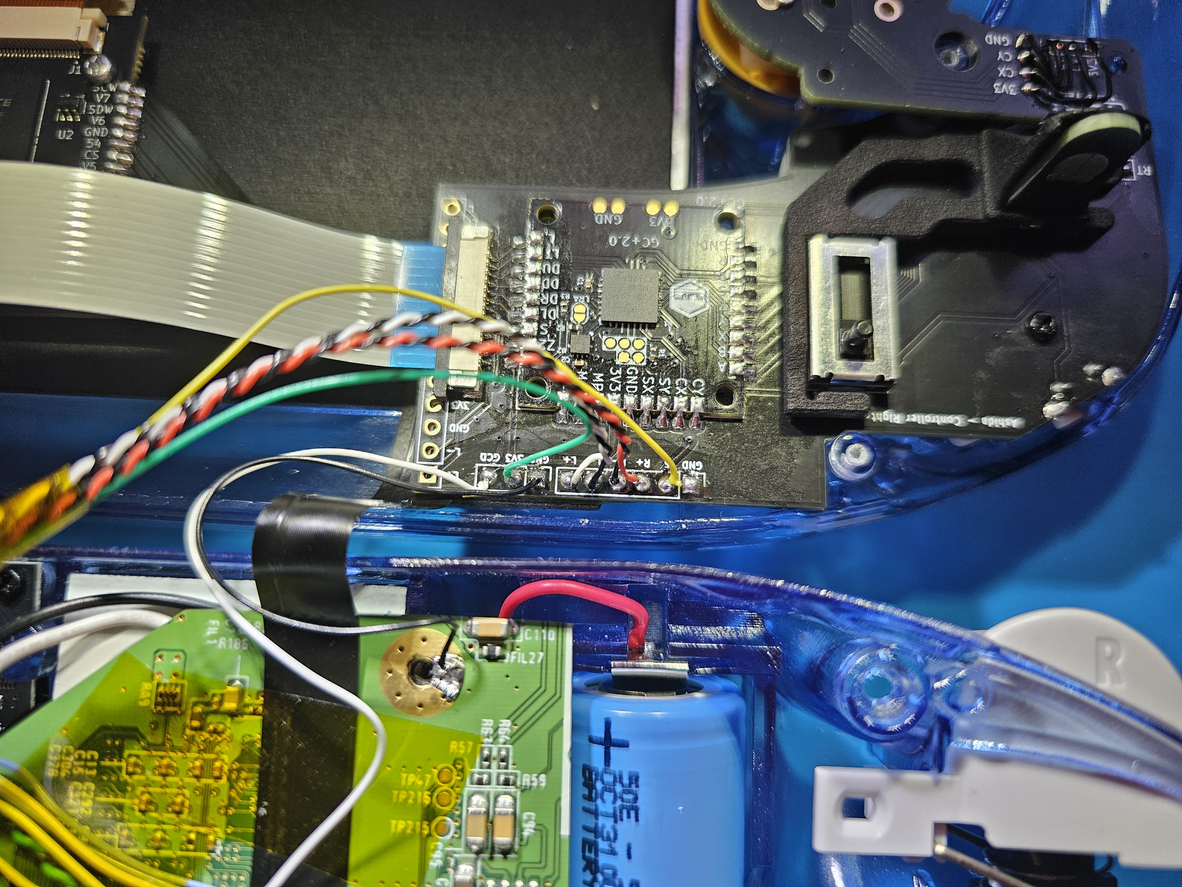

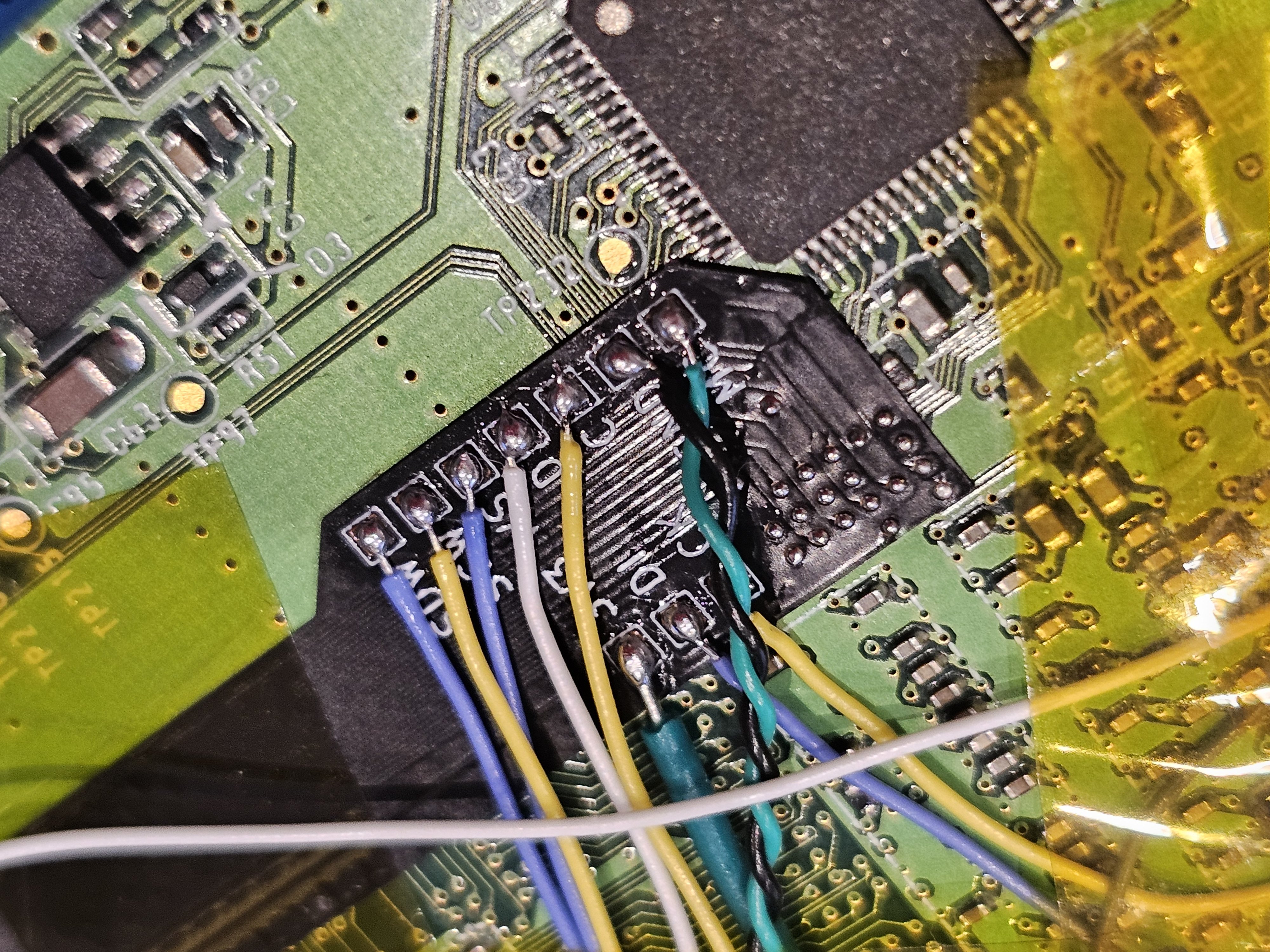

Can you provide clear photos of the U-AMP wiring and i2s audio vias wiring?
Hi Stitches,
Sure here they are (also included GC2 +):
Q
Looks good. The only thing I can think of is maybe there's poor connection between the flex and the mobo. Did you clear the soldermask off of the vias before soldering on the flex?
I did yes, and I prepped them with solder before soldering them to the flex.
Could it be the U-Amp itself?
Q
It could be the U-Amp or the Wii. I don't know a way to know for sure

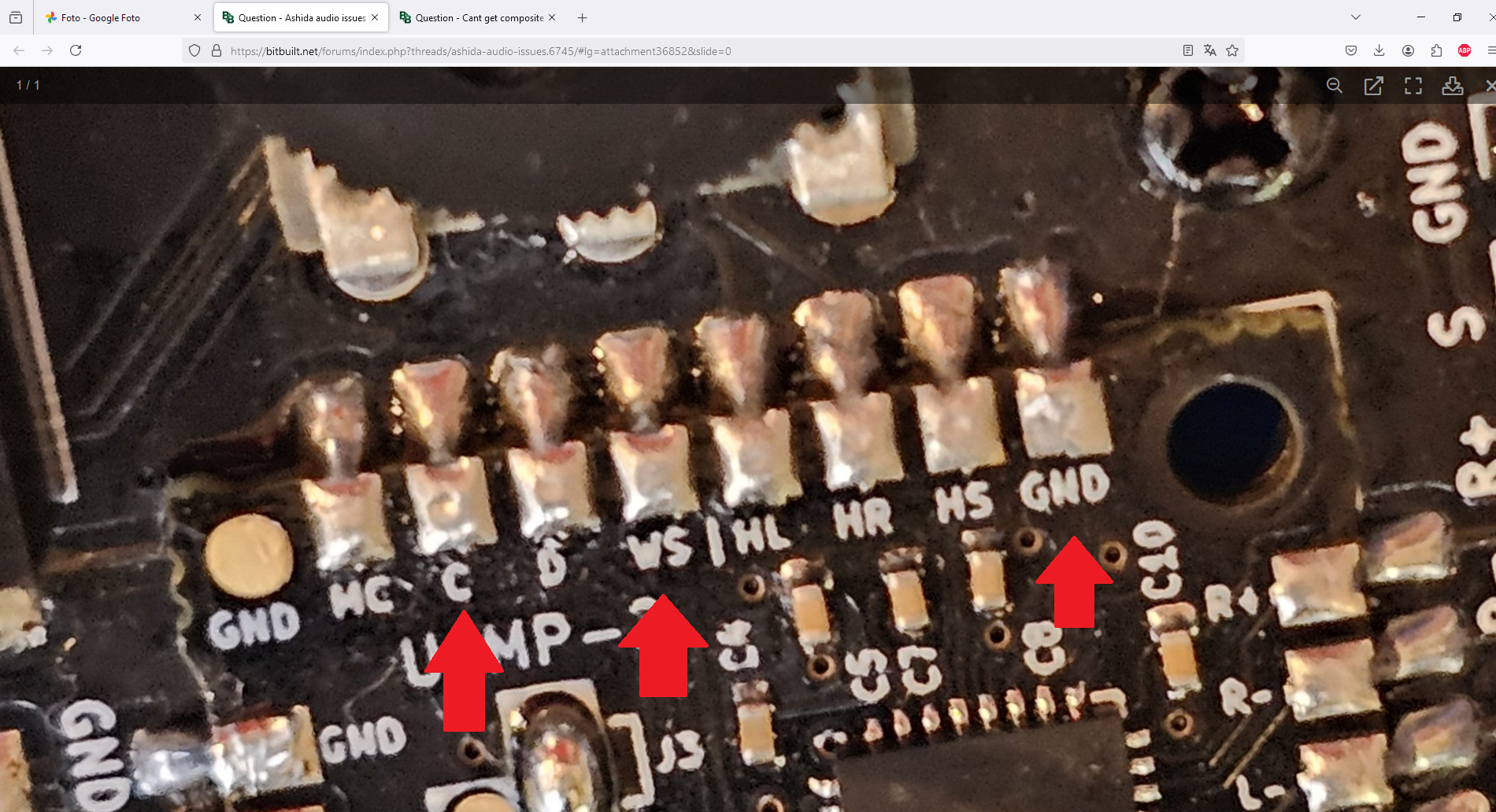

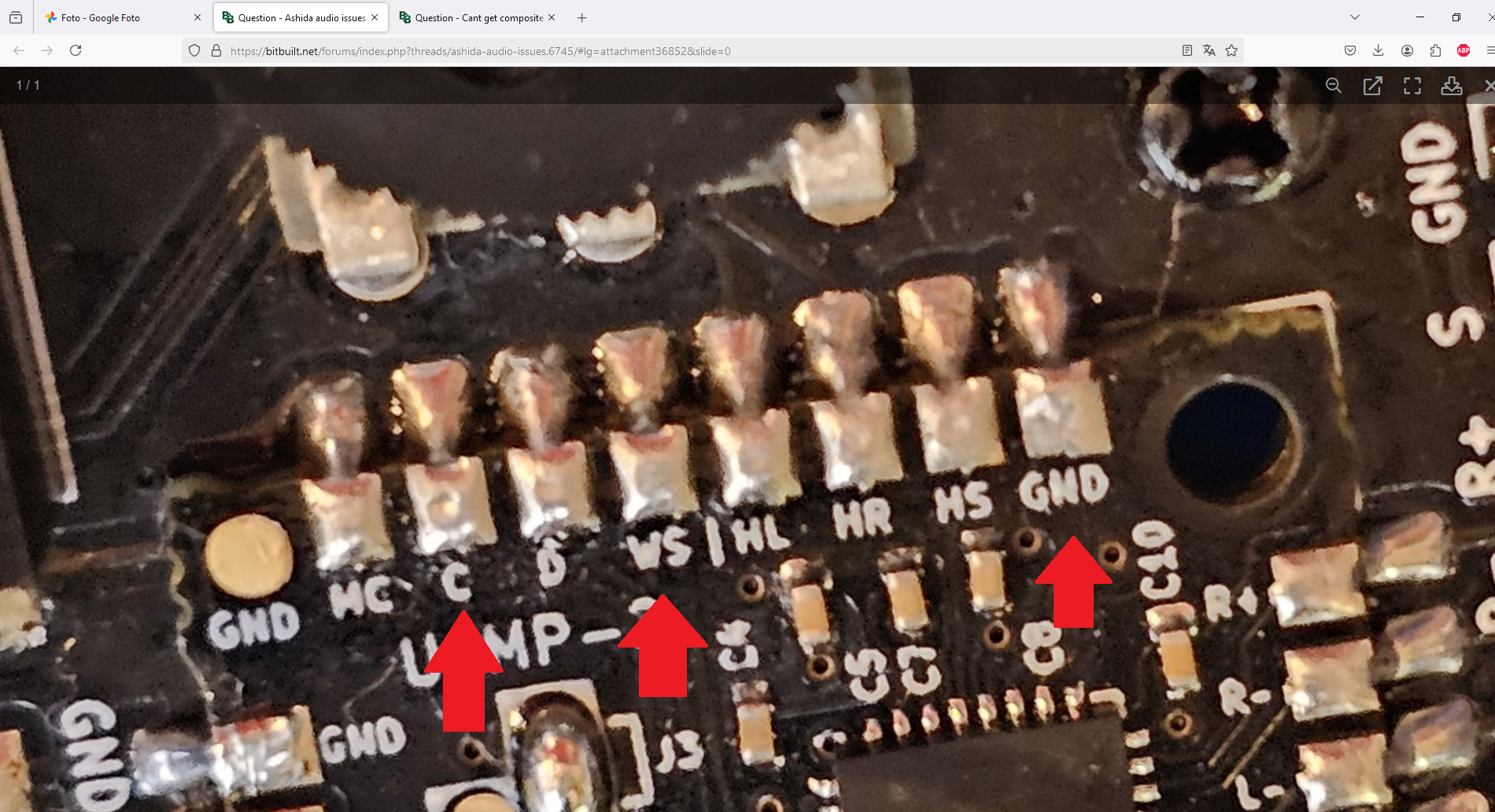

I had the same issue and it’s fixed by making the bridges on J0, J1, J2 of the u-amp
