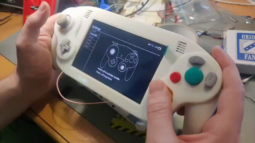

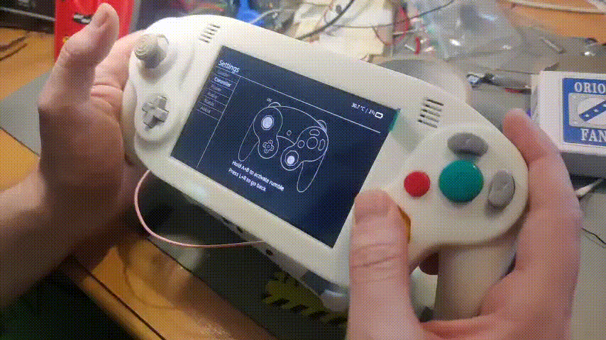

heres a gif! the c stick is mirrored in some way, the left stick only registers up and down and, besides both analogue triggers being inverted, the left analogue trigger registers as left stick right input. my wiring looks good and none of the points on the gc+2 short
which kind of analog sticks did you used in your build?
