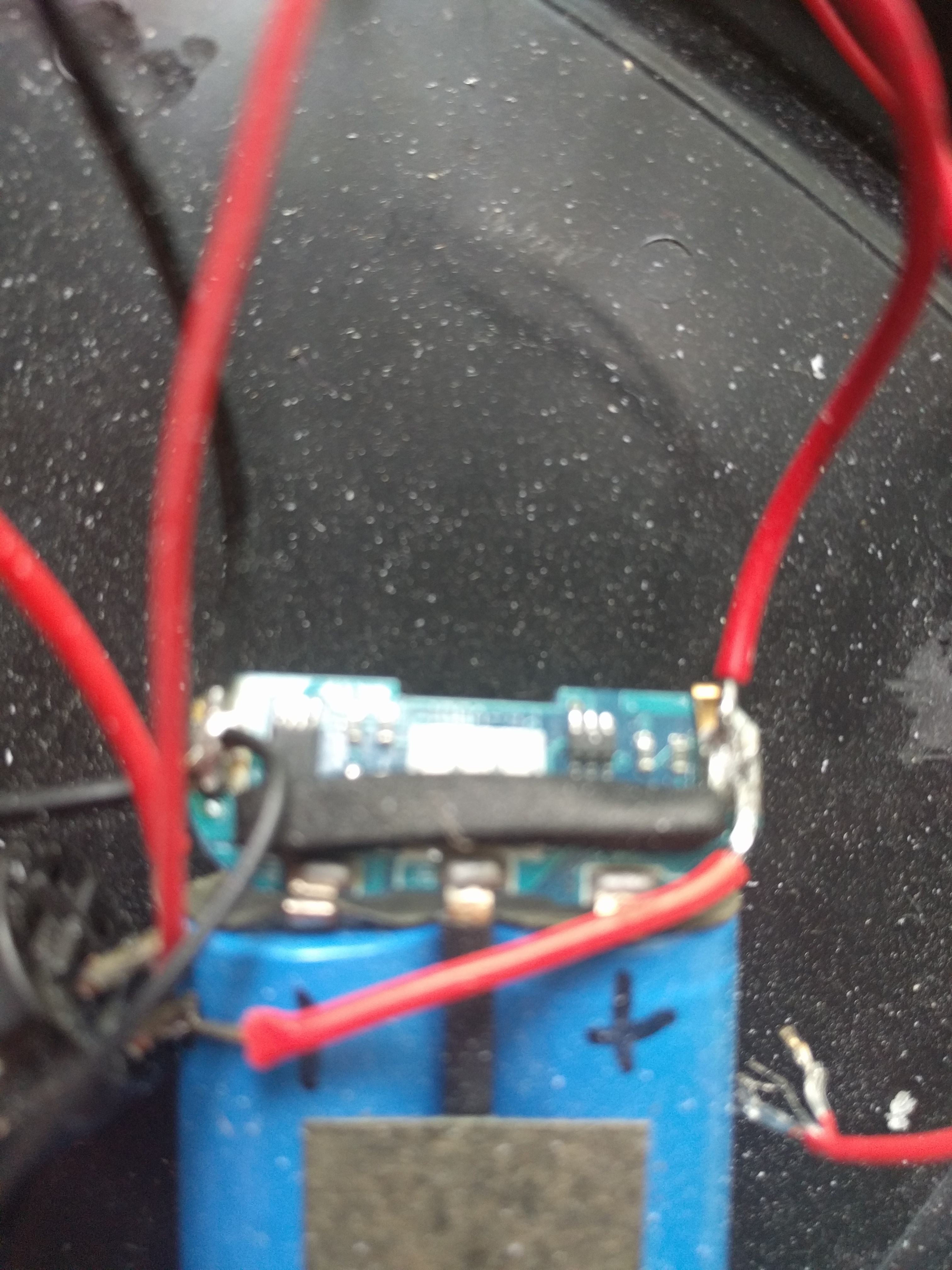

This guy on top (sorry for poor quality)
The cells I linked don't come with a protection circuit, so you'd have to get your own for ~$10. If you do buy protected cells, just make sure that the protection module covers all of them. Don't wire individually protected cells together, because that will cause problems!
Ah okay. I think the batteries I got come with a protection circuit. Whenever ive had a short in my board, they shut off and I need to plug them in to reset the circuit.

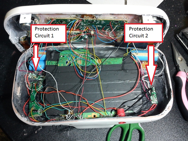

I did email bacteria directly and asked him about this at one point. he said it was cool to wire in parallel and he actually wires two protection circuits in parallel (the ones on the camcorder batteries) on his into64 (thats the popular orange one all over the internet)
That being said, you have a really good point. It kinda sketchy wiring two protection circuits in parallel...
Ill probably heed your warning and take them off and wire up my own protection circuit ;)
Now, just because I did something doesn't mean it's a good idea. But for the record, neither me nor my batteries are dead yet.

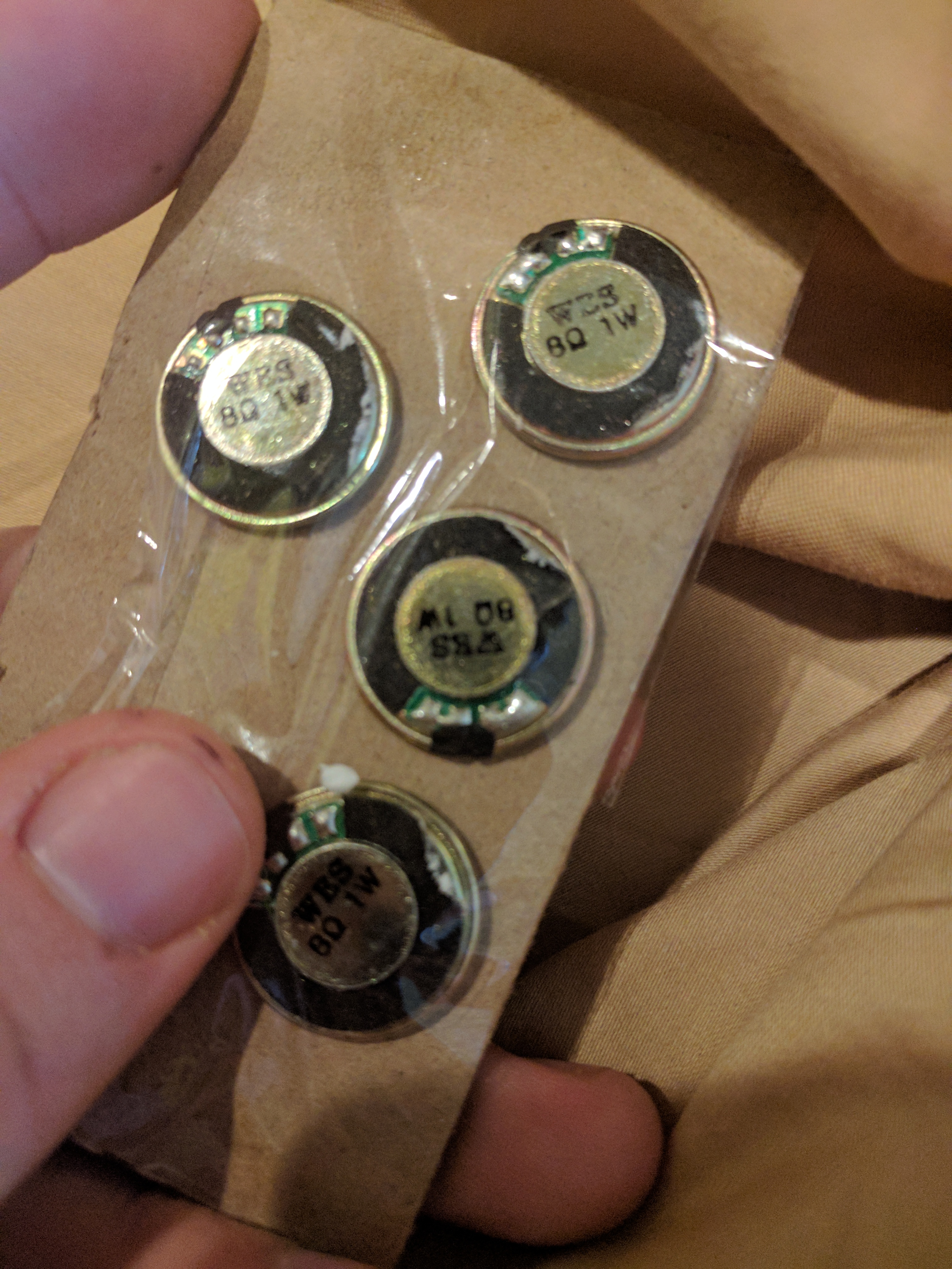

Just got my speakers and audio amp
problem is I have no idea how to wire up these speakers.. Can someone help me out?
Theres no marks indicating + or - so im not sure where to put that.. and there are 4 solder points so that confusing to me as well

I'd look up the datasheet for them. We can make guesses, but you're better off finding the information yoirself. Usually the place that you bought them from will have a datasheet in the description.

The four solder points, are only two.
Ask the seller for which is witch

The two outermost pads are positive and negative. Orientation doesn't matter, so you can just wire it.
Thanks for all the answers guys, its really informative! Ill wire them up and see if they work.
