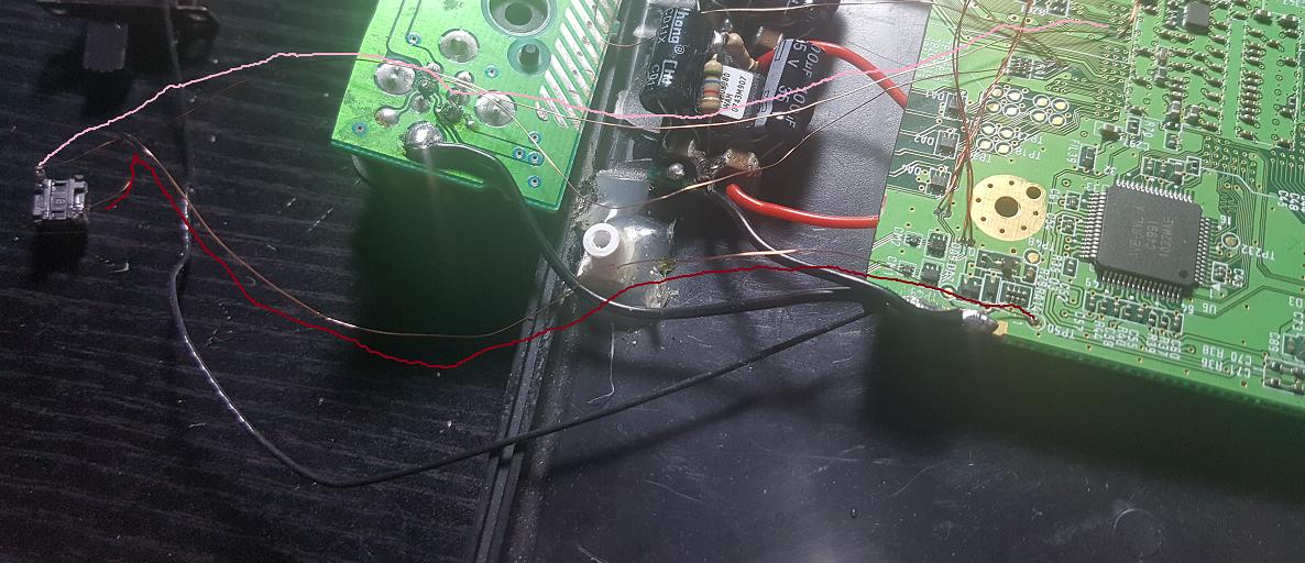

So I'm having an issue where wiring up my reset switch causes my wii to boot (like 80% of the time) to priiloader meaning it's acting like the switch is shorted to ground even though it's not. I'm using 34g magnet wire since it's wired to a via obviously. Removing the wire fixes it. I'm assuming it's some sort of interference issue but I don't have any shielded wire and I feel like I would be hard pressed to use any different kind of wire on the via. Anyone else have this issue/know how to fix it? Here's a pic
literally just making shit up but you could try a 10k pull up resistor on the reset line or something (IIRC you're supposed to ground it out to press it)

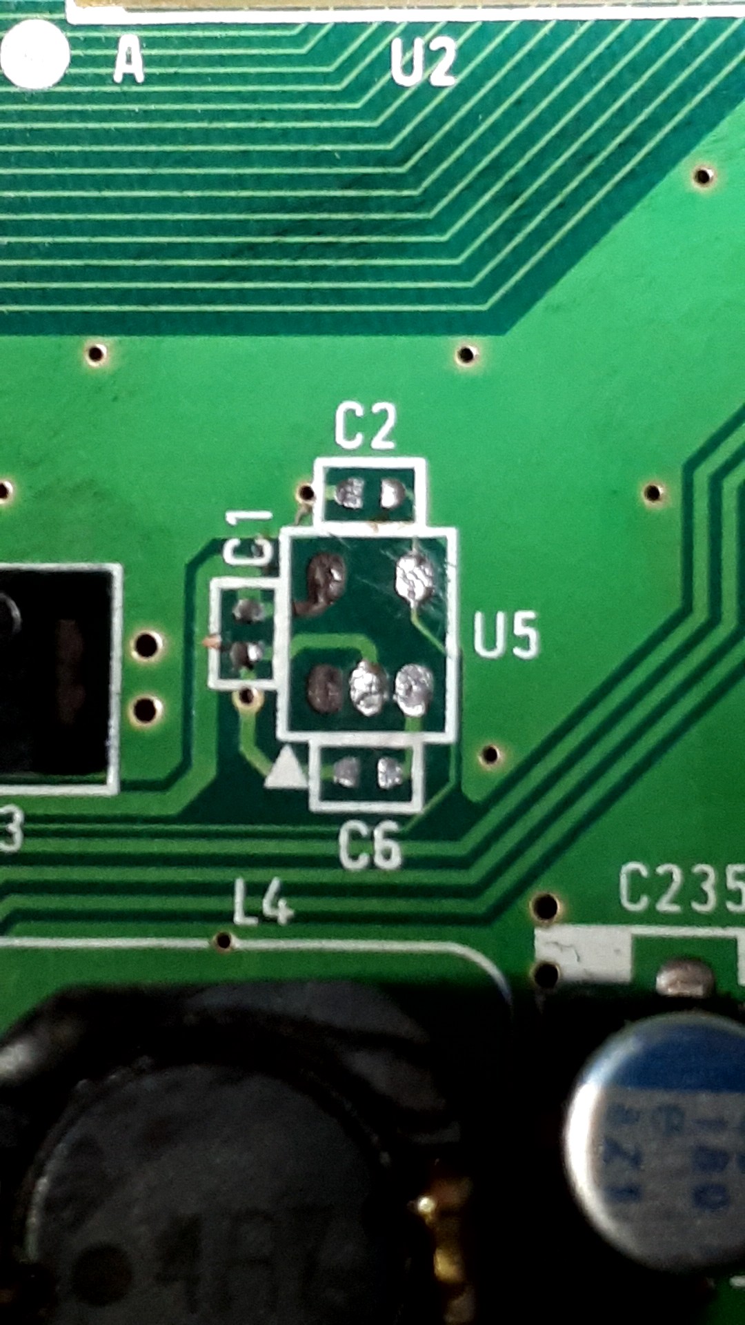

Did I make any unsalvagable mistakes when removing the u5 component. It looks like the two left pads peeled off.
While it's not unfixable, you'll need to connect pin 1 to 3.3v. Pin 1 is the one closest to where it says C1. Then bridge the bottom three pins and install it like in the guide.
