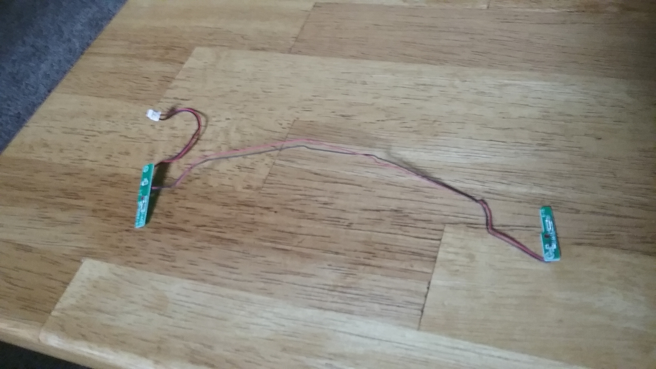

I was taking apart the faceplate of my wii. I found something that i didnt recognize. What is this? It was surrounding the disc drive.
Do they output infared? I know this is a weird question, but i was thinking about using them as a sensor bar
Ok. I am just going to put in infared lights to act as a sensor bar. I was just wondering if i could save money and see if these would suit that purpose.
I don't think those are bright enough.....
But try it, tell me if it works please
