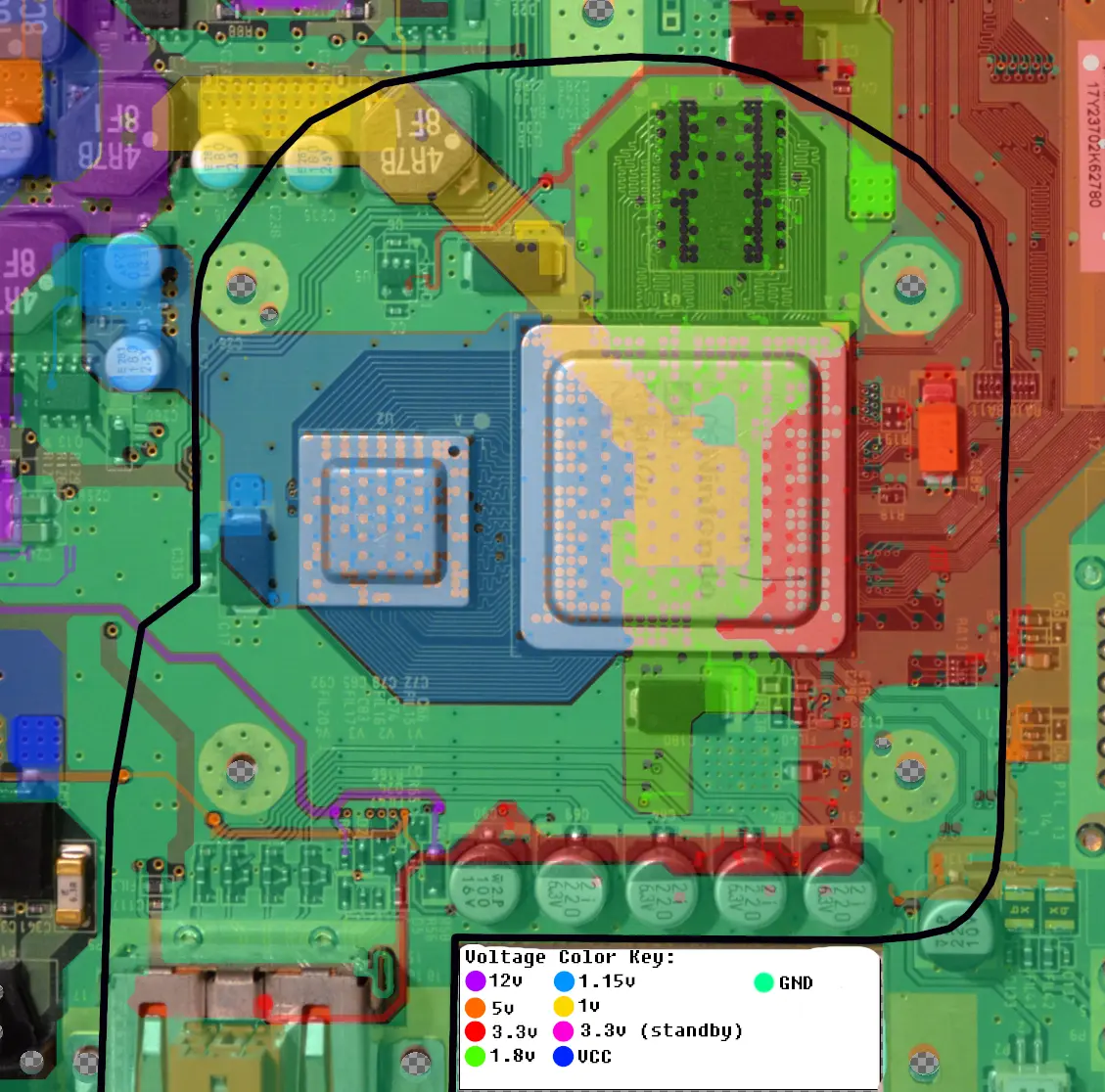

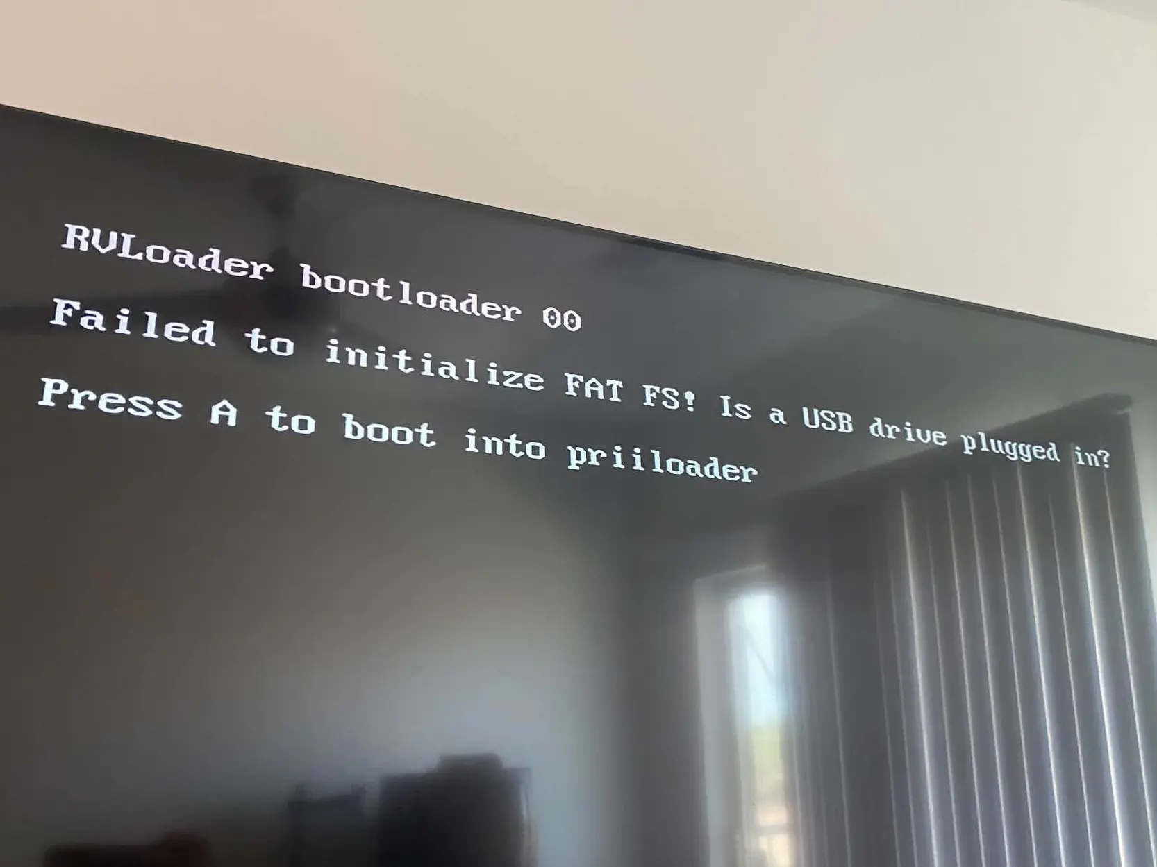

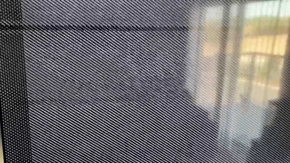

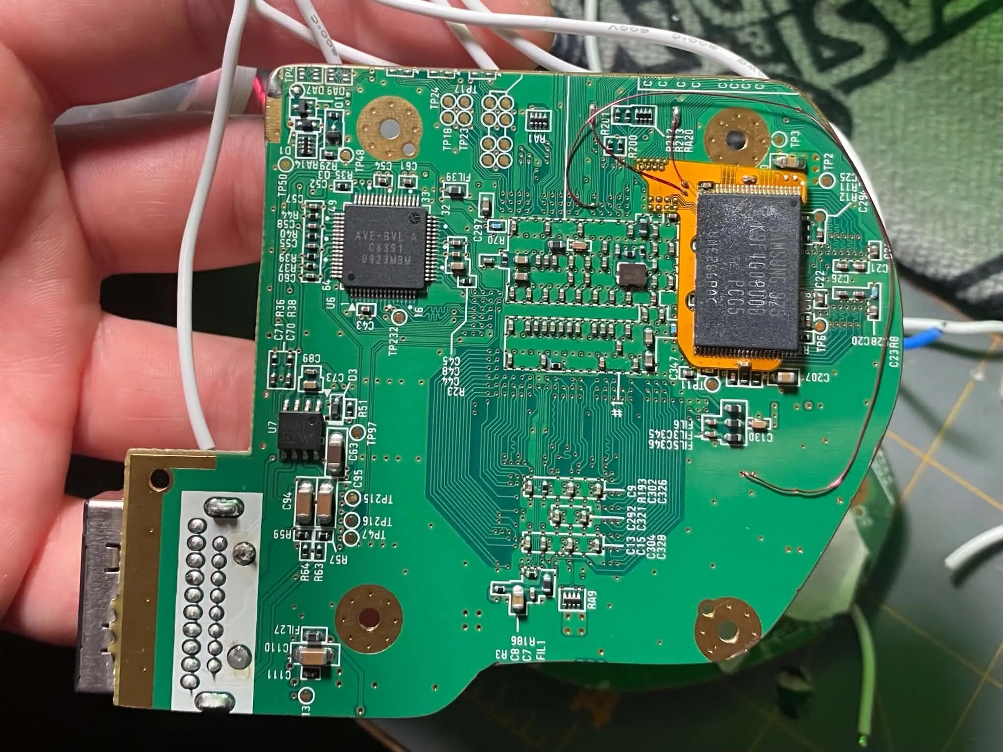

So here's the deal - this is a custom trim for a project I've been working on. Pretty LMAOv2-like trim with the exception of keeping the chunk with the AV port. All four boards worked prior to trimming w/ nands relocated. Out of 20+ trims of various other types, these are the only ones that I've had this issue on, so assuming something is in-common between them - They all display this exact screen:

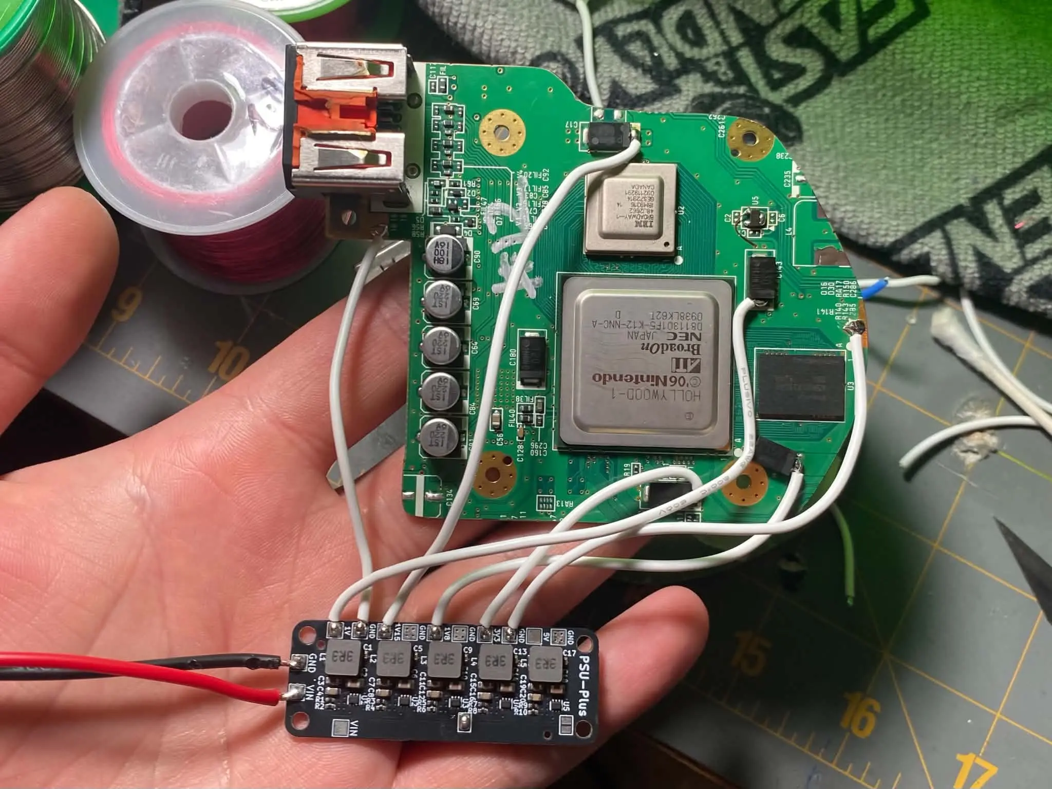

Edges sanded up to 1500grit. Resistances all checked out fine post-trim. Using PSU-Plus boards for power (also tried thundervolt), all rails checked out fine with and without load.

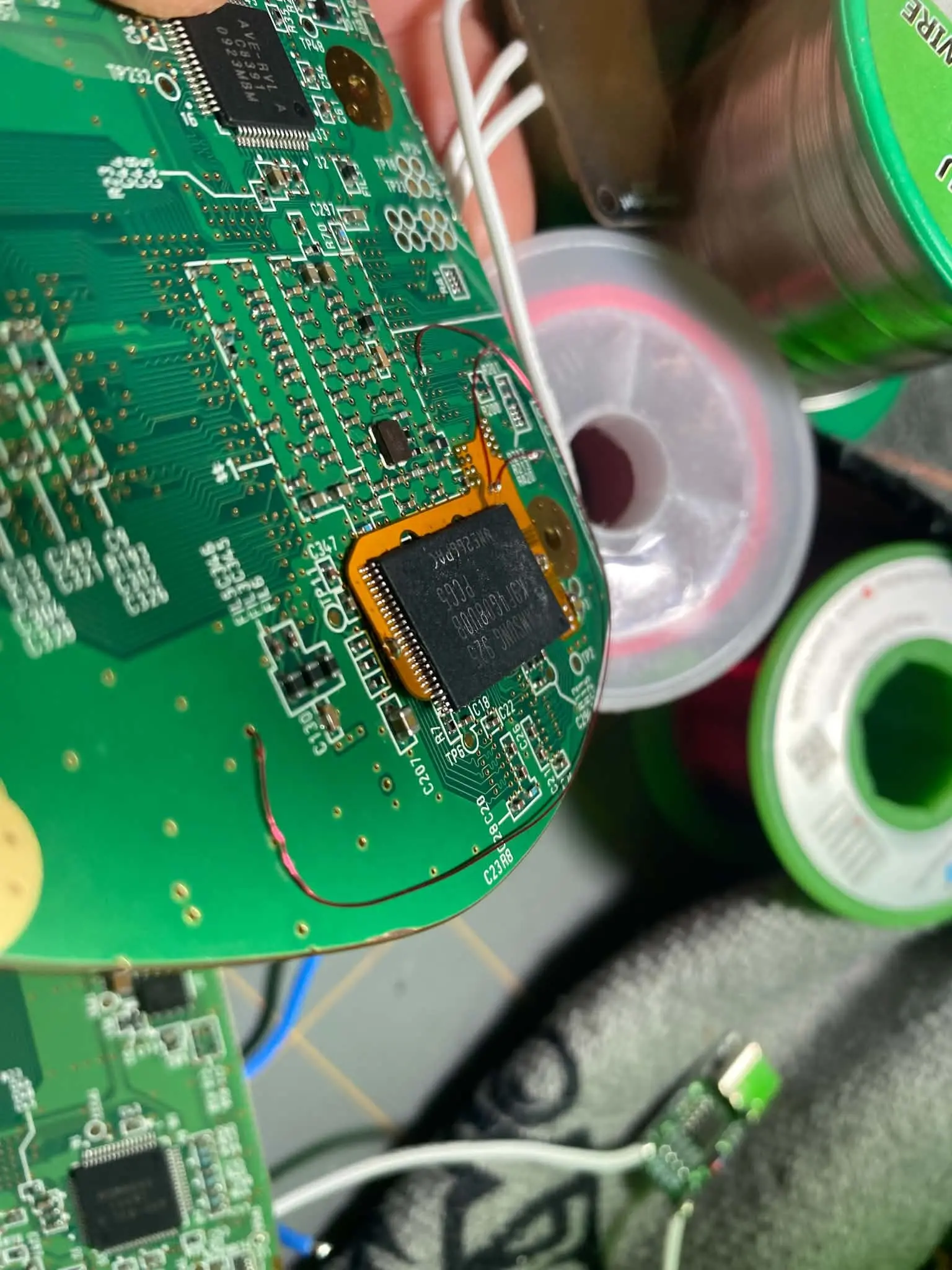

U10 output measures between 3.10-3.15v on all four boards (so maybe that's the issue? but I've replaced the U10s over a dozen times now, there's gotta be no way my whole pile of them is broken). Thundervolt U10 emulation also did not change anything. Tried running an extra 3v3 wire directly to U10 input as well since the trim cuts in close on that area, still nothin.
After talking with Yveltal, the wii should still pop out of reset mode >3v on the U10 though. Nothing different happens after disconnecting U10 completely, or alternating between GND and 3V3. Also tried all sorts of routing of the U10 wire incase there was interference or something.
All boards are region swapped NTSC-J to NTSC-U, RVloader installed w/ nowifi and without applying VGA patch (if that makes a difference). Verified boots into RVloader on all prior to trimming.

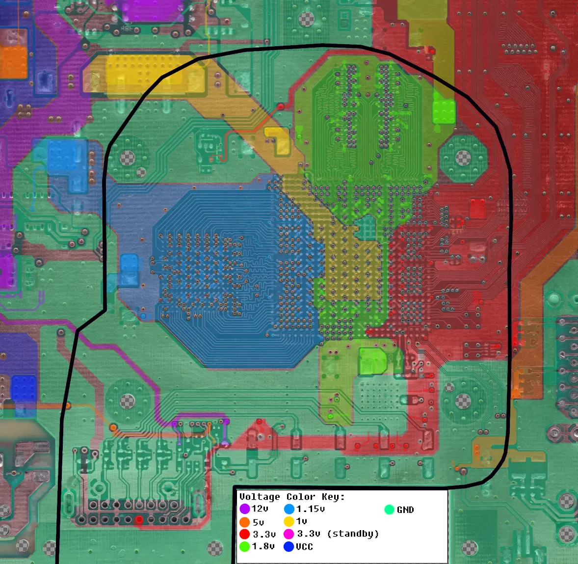

Checked out the compendium with my trim outline, anything that I'm missing or needing to be reconnected maybe? I still have the video caps installed and have not relocated 5v. Is that needed since I kept that part of the board? Figured composite signal would still output regardless.

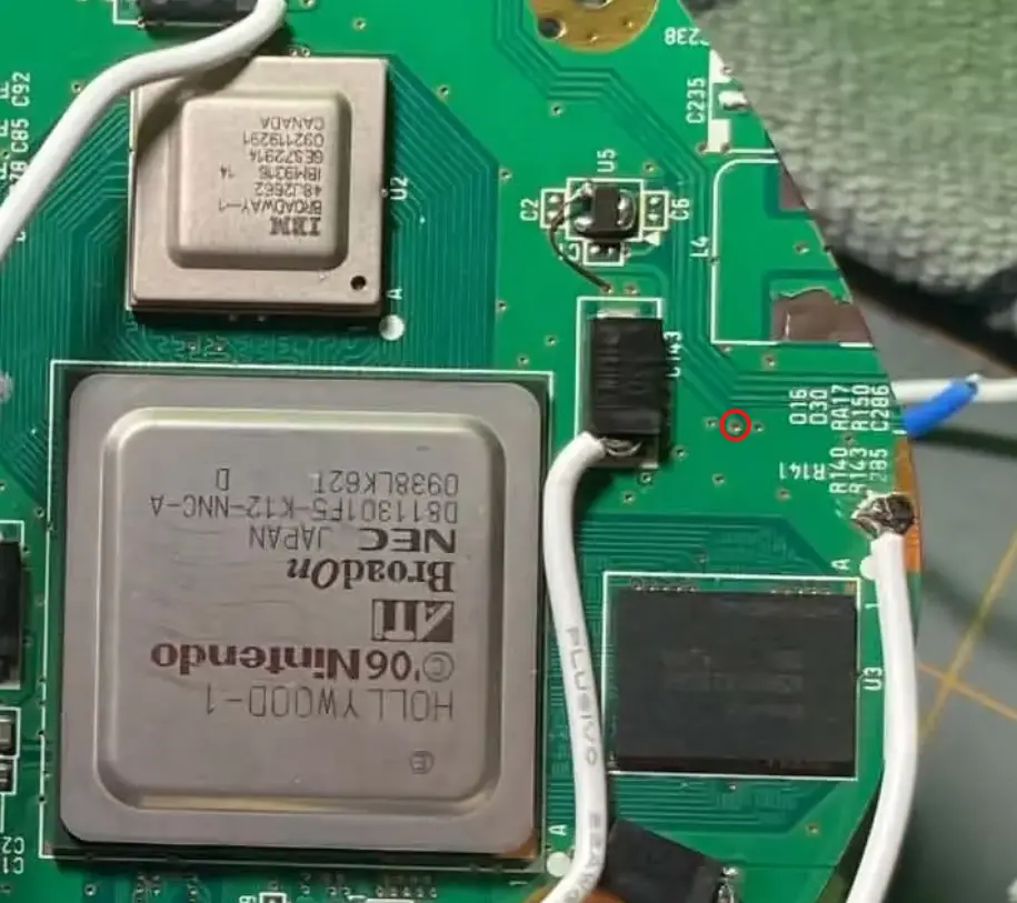

Check you have 3.3v in the point circled, according to your trimming outline that point needs to be reconnected, to power U10.
Also I would solder a 1K Ohm resistor in nandFlex R1.
Hope this helps.
Hope this helps.

All my board have still got 3v3 continuity to U10’s input trace, and have previously tried running an extra wire without success unfortunately
The resistor I believe serves as relocation for R71 directly under the big 3v3 cap on the Wii, which my trims still have intact. Adding another won’t hurt though I suppose incase it helps the signal path at all possibly

Have you checked that the U10's 3 GND legs have good connection to GND? Sometimes that fails.
Also it is worth probing the AVE to check that it is properly recieving 3.3v for power and 1.8v for logic reference. You could even do the old 6 layer 1.8v reconnect wire just in case the internal 1.8v rail developed a fault.

Yeah, also tried a wireless U10 on one of them and still got the same screen.
If I leave it on the TV long enough it has kind of like a small brightness surge and dims back down every so often, the black bar rolls from top to bottom, and diagonal lines move across. Really weird, definitely seems power-y or video related

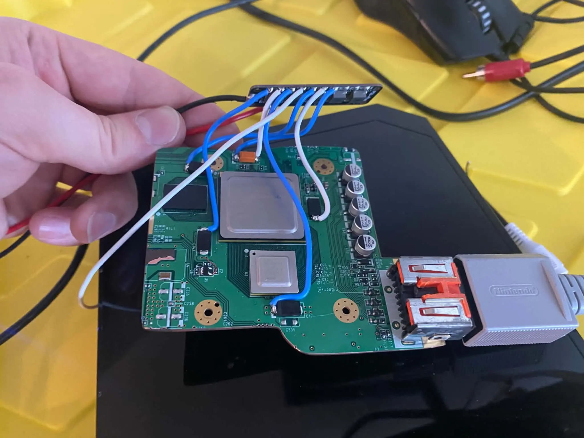

Charging up some batteries and gonna try and test one of them with a PMS instead to see if I get any luck!
Since it's happening on all four; have you tried the AV cable on something else? Maybe it developed a fault.
If you connect a USB with RVLoader and perform the needed inputs to launch a game, do you feel any controller feedback?
Tried a couple AV cables and also pulling directly from the composite via and still the same sadly
That’s a great idea! I’ll hook up audio too and see if anything comes through. That’d hopefully narrow things down possibly. I’ll try that when I get back home in a few days!

I was able to devise a new trim to fit my shell design that keeps more of the board intact. This one boots!
