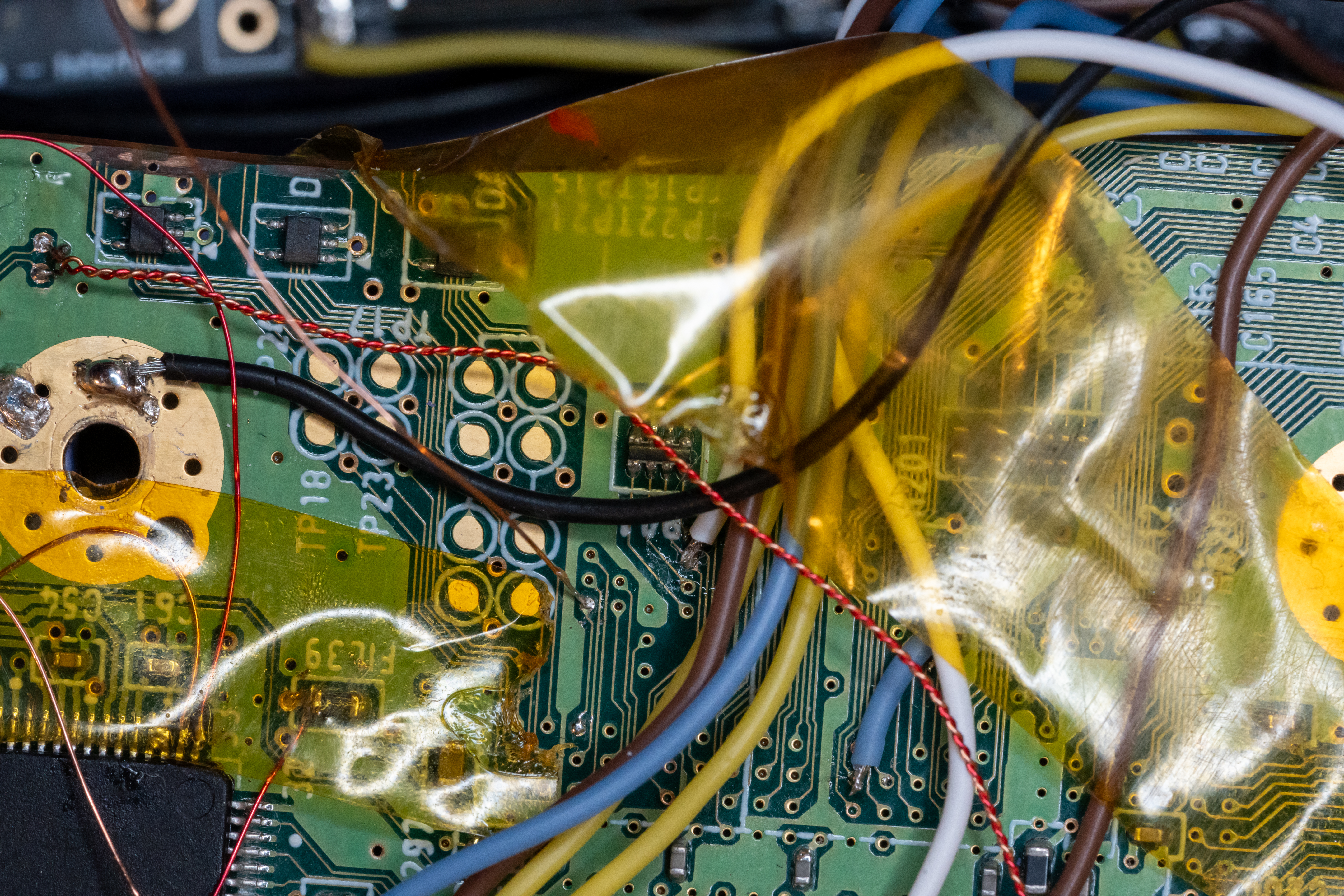

I've got an assembled Ashida that works *almost* perfectly, but one of the final issues to resolve is getting the speakers working. The headphones work fine, but the speakers don't, presumably because I haven't connected the headphone sense from the RVL-AMP to the Wii. Unfortunately, when I do this, the Wii doesn't seem to boot properly. In terms of observables, everything powers on including the screen, but the screen never gets a signal (it says blue for a second or so, then turns off). When I've got the headphone sense disconnected from the Wii (or disconnected from the RVL-AMP), everything boots just fine.
My first thought was that this is probably poor soldering on my part, but the behavior seems reproducible. I have tried leaving the wire disconnected from either end (e.g. soldered to RVL-AMP but disconnected from the Wii, and vice versa) and the issue only happens when there is a wire going from HS on the RVL-AMP to the Wii via. This seems to indicate to me that it's not as simple as a poor job soldering or a simple short in the parts I've checked. Originally I was trying with some of the thicker wires but I have switched over to magnet wire to see if that makes a difference (it does not).
For reference, I have attached an image of where I've soldered onto the Wii. It seems clear from the documentation, but I'd like to confirm that this definitely is the right place for it. I tried both of the vias (you can see them both tinned), just in case something was not right with that trace, but neither worked.

It does seem to be the correct wii via. Can you share pics of the rvlamp wiring too? Nothing comes to mind.. it's not normal behavior. It looks like there is a short on your AVE pins next to the H V sync pins.
For the shorted pins on the AVE, I checked the Wikibrew page on the AV_Encoder (avoiding the full link due to my less than 10 posts limit wikibrew/wiki/Hardware/AV_Encoder) and it looks like they're both grounds, so it should be fine. It does boot properly without HS connected, so I imagine this isn't the issue, but if we run out of other things to try I can always clean them up.

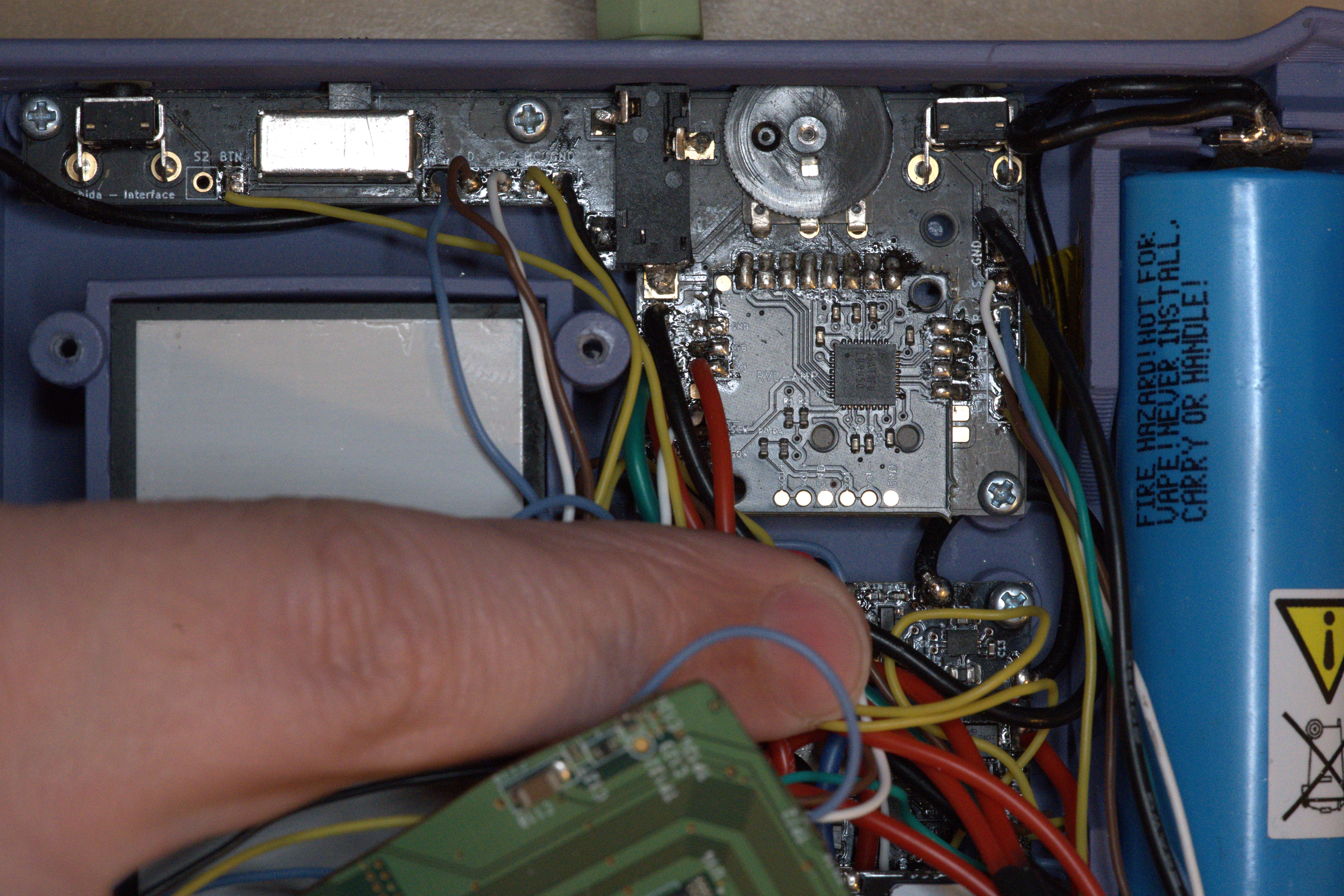

I have attached an image of the RVL-AMP installed on the Ashida PCB. There's an overhead light so you can see a lot of residue, but I've cleaned up a bunch of it since taking this photo just in case and it doesn't seem to have helped.
Since you suggested a short on the HS pin, I checked for dead shorts between HS and every other pin on the RVL-AMP and none were shorted, other than HL when no headphones are inserted, as expected.
