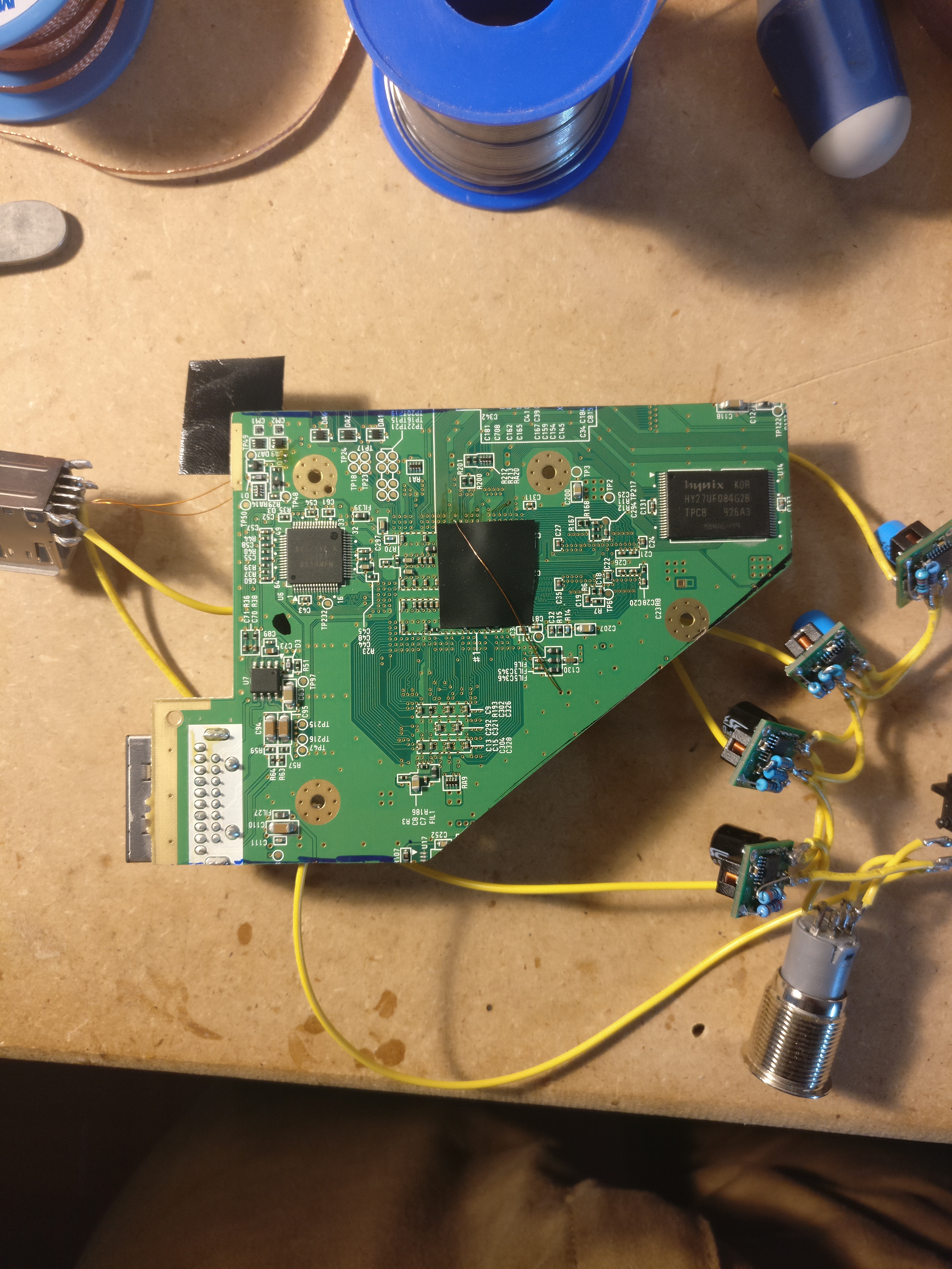

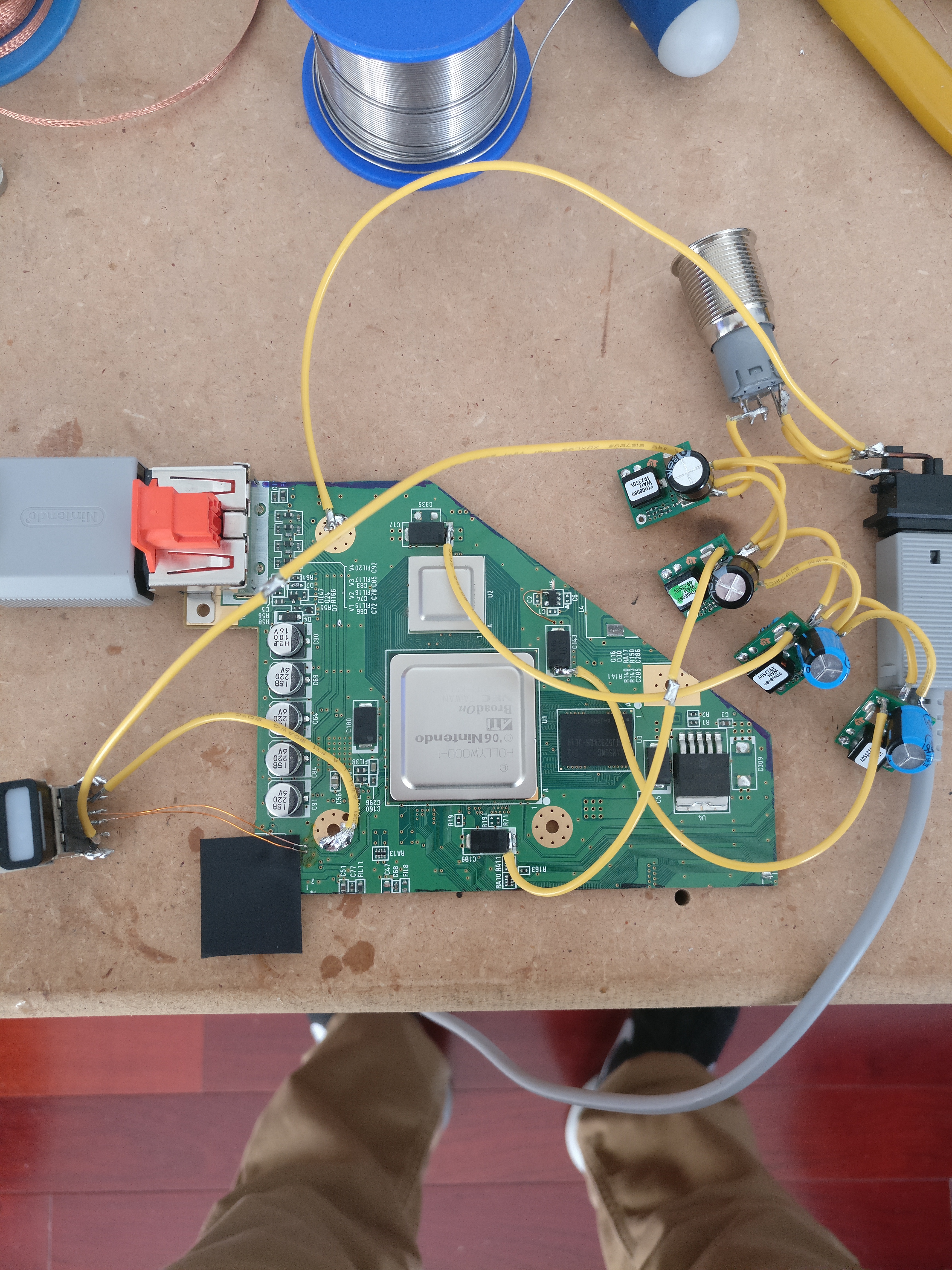

Well, just like the title says my trim isn't booting. The cpu and gpu both heat up slowly. The board worked just fine before the trim, and I have checked all of the regs multiple times. U10 is wired up with the trace cut and is receiving power. Nothing happens for a bit when I turn the power on, and then after ~20 seconds the flash drive will turn solid blue. Probably not a very scientific/conclusive test but I plugged the flash drive into a PC and it seems fine. I'm getting a solid blue screen on the crt. Is there something super obvious that I'm overlooking? There's a picture below. Thanks!

Got a picture of the bottom of the board? That may show an issue we can't see from the top.

No dice. Wired one up and didn't get anything again. I think I managed to take a step back somehow actually; the flash drive doesn't light up at all since I wired it.
Posting a picture of the bottom didn't occur to me, my b
Unrelated probably, but you can remove these:
and this spot could maybe use a little cleanup:
Aside from that, check that each line is outputting the correct voltage.

Spots removed and cleaned. Haha yeah portablizemii was installed and the av cable is fine. At the board I'm getting 4.99, 3.289, 1.124, and .971 volts respectively; maybe these just aren't close enough to the required voltage? U10 is getting 3.263. Also in the spot you recommended I clean up, those 6 filters can just be removed right?
The 1v and 1.15v seem a little low, but 3.3v and 5v should be fine. As for the filters, you can just remove them.
