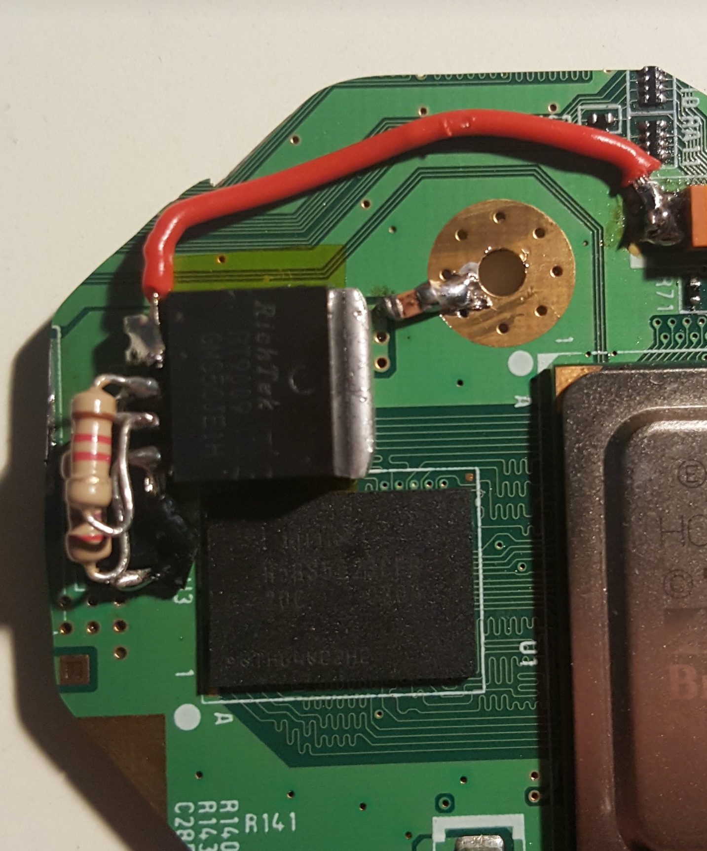

First make sure to grab the small resistors, those set the voltage output of the LDO, then just heat it with a heat gun until you can lift it upU4 is the LDO (sorry for being ignorant), but I don't know exactly how to rewire it

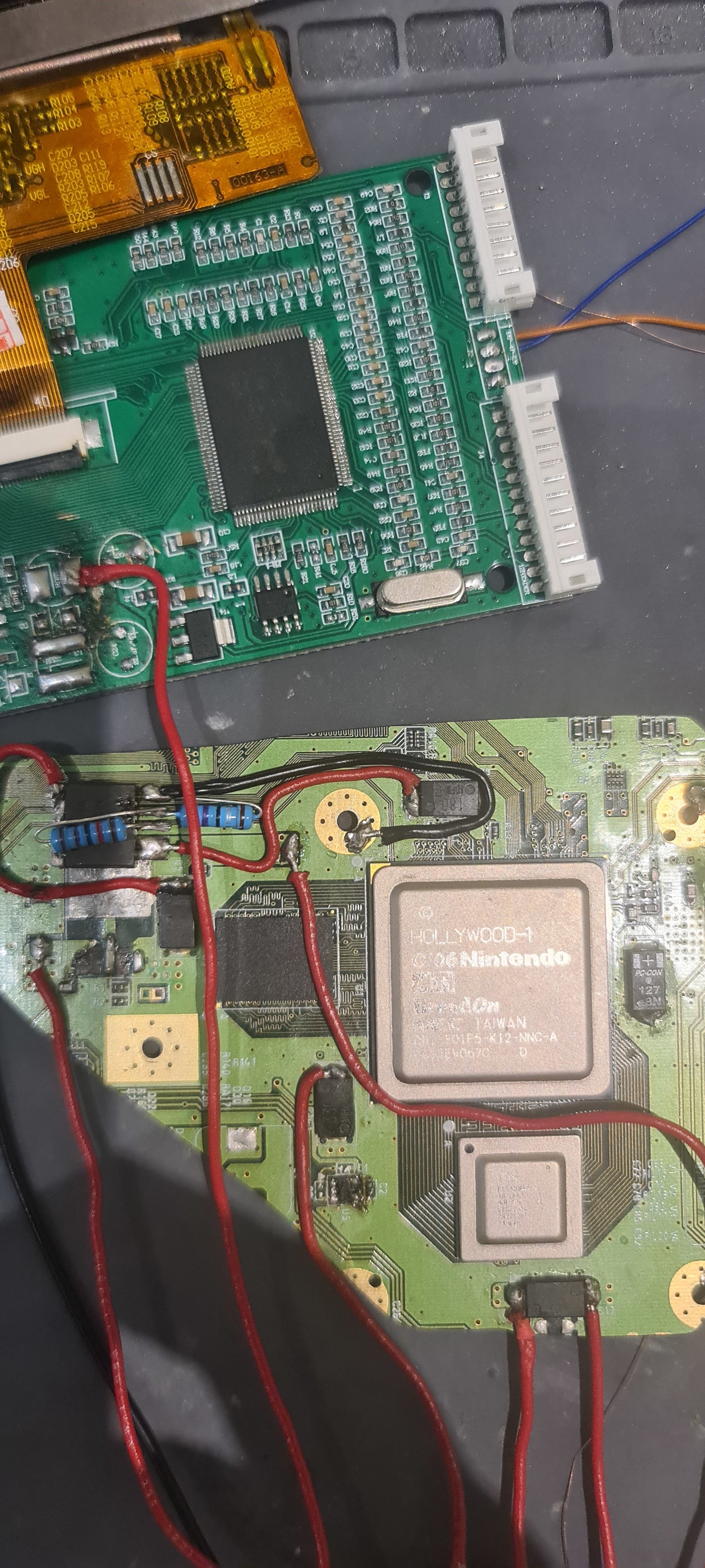

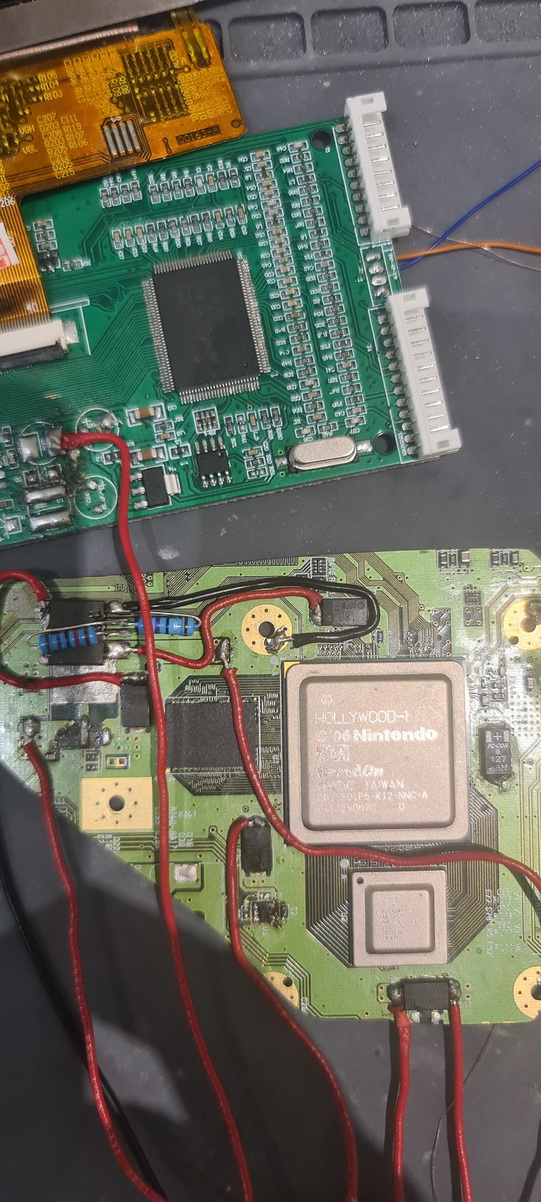

Don't necro old threads, and don't ask the same question in multiple threadsHi @jefflongo, wich resistors did you used? i have done the relocation but the output is 2.3v cant find any info about the relocation beside this Guide - LMAOv2 and NAND relocation "Guide" | BitBuilt - Giving Life to Old Consoles. thanks View attachment 22667
