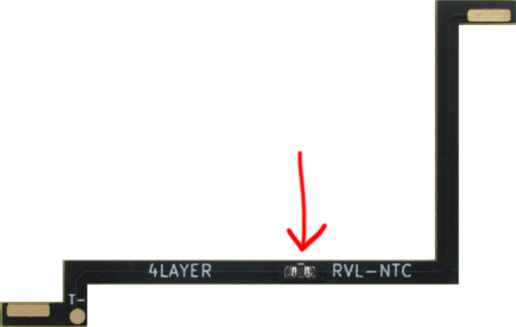

I was wiring up the T- connection on an RVL-NTC and I accidentally ripped the resistor off and cant find it. Does anyone know its resistance value? I'd rather fix it now and not wait for a new one.
The website stated it has a 10k ohm resistance with a B value of 3380k. Use that as you will.
You're right, but now that I'm looking at it again I think that was the thermistor itself that came off... so I can't just replace that. I'll have to reorder the part.
You did in fact bump off the thermistor. If you can't locate it, you'll need a new RVL-NTC

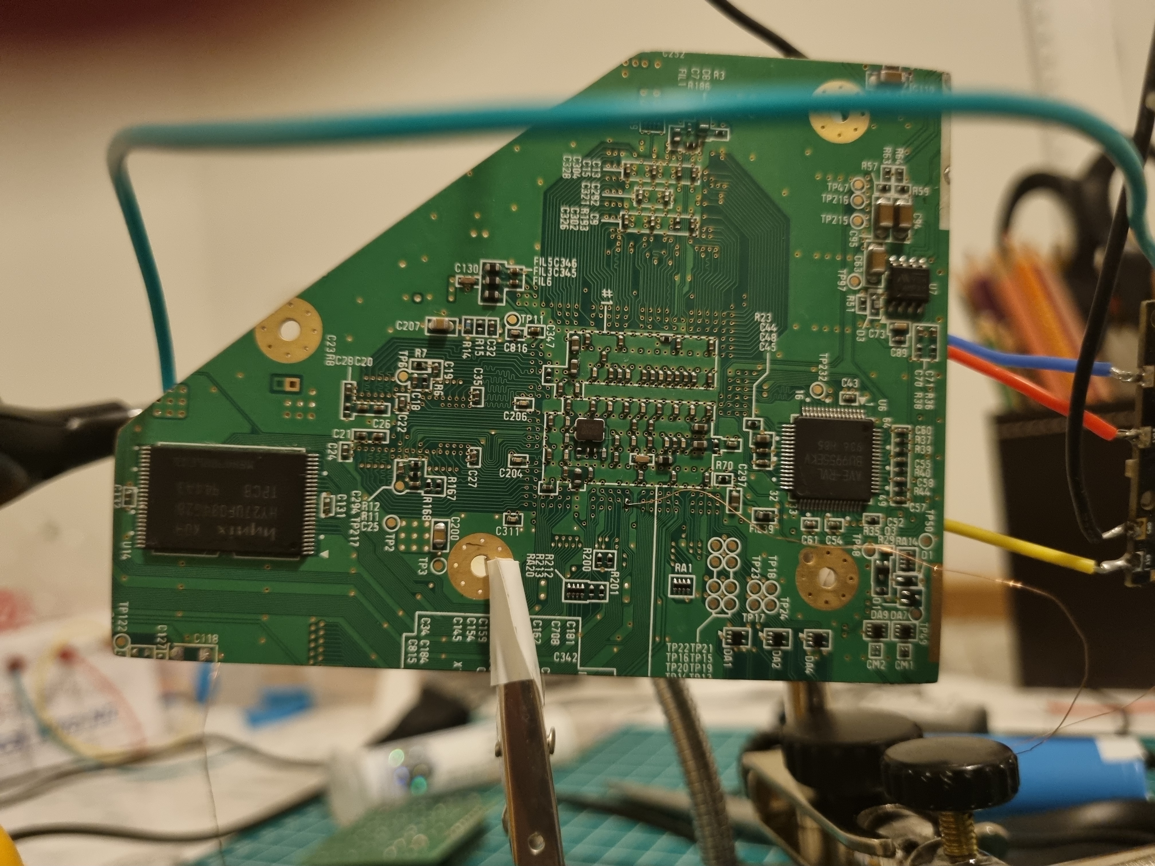

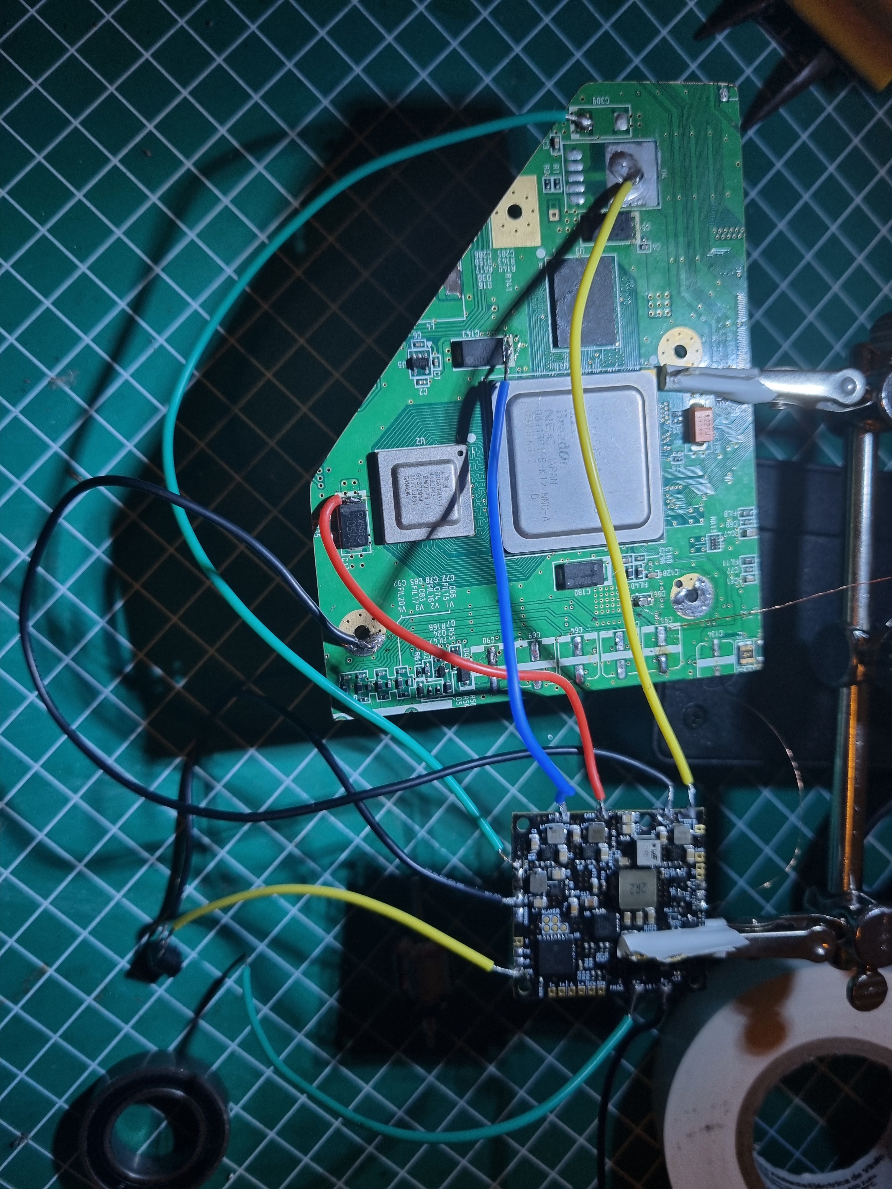

Hi, I'm also new and I'm having trouble testing a wii trim, I'm not receiving any video output and I don't know what the problem is.
