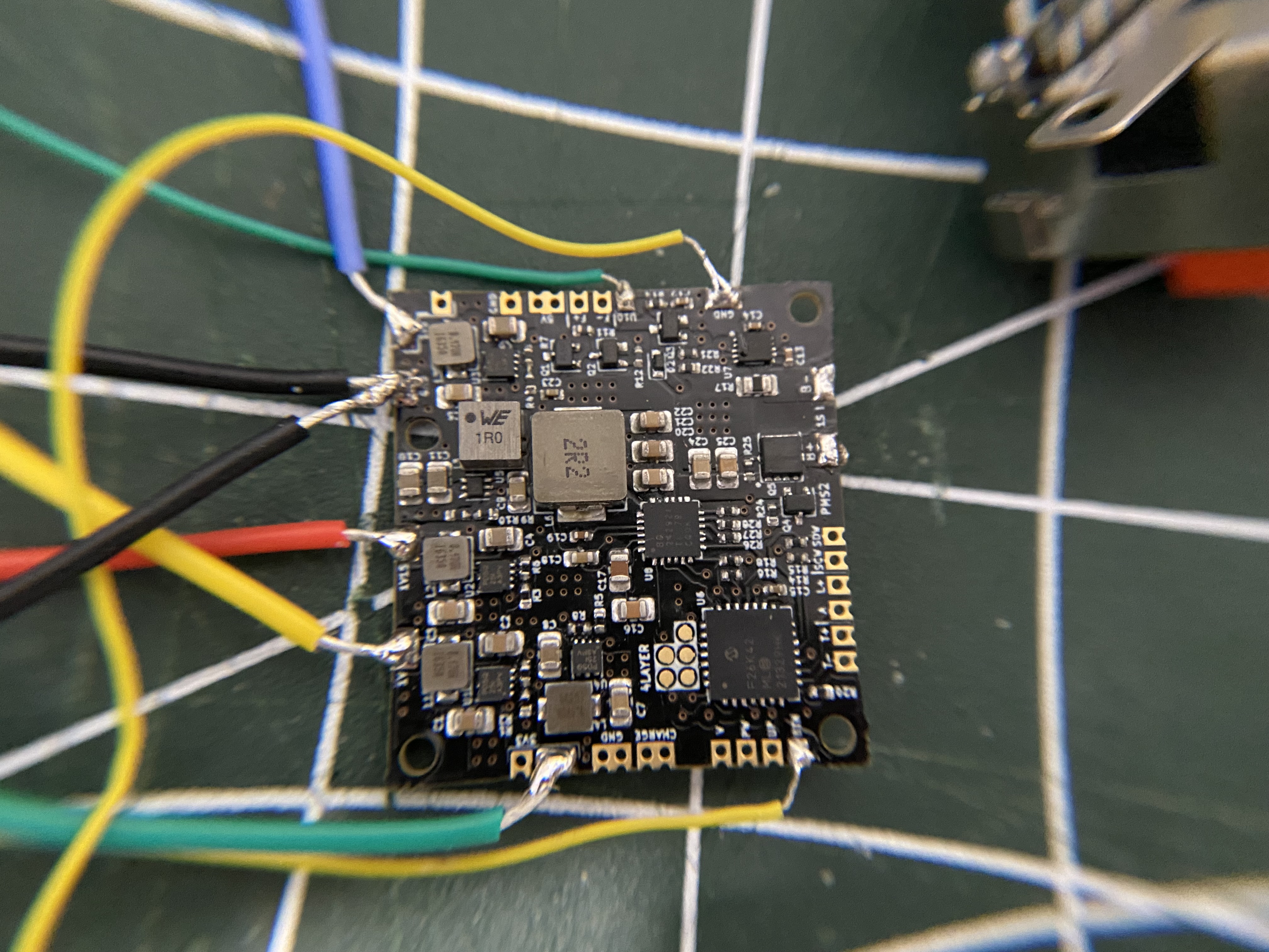

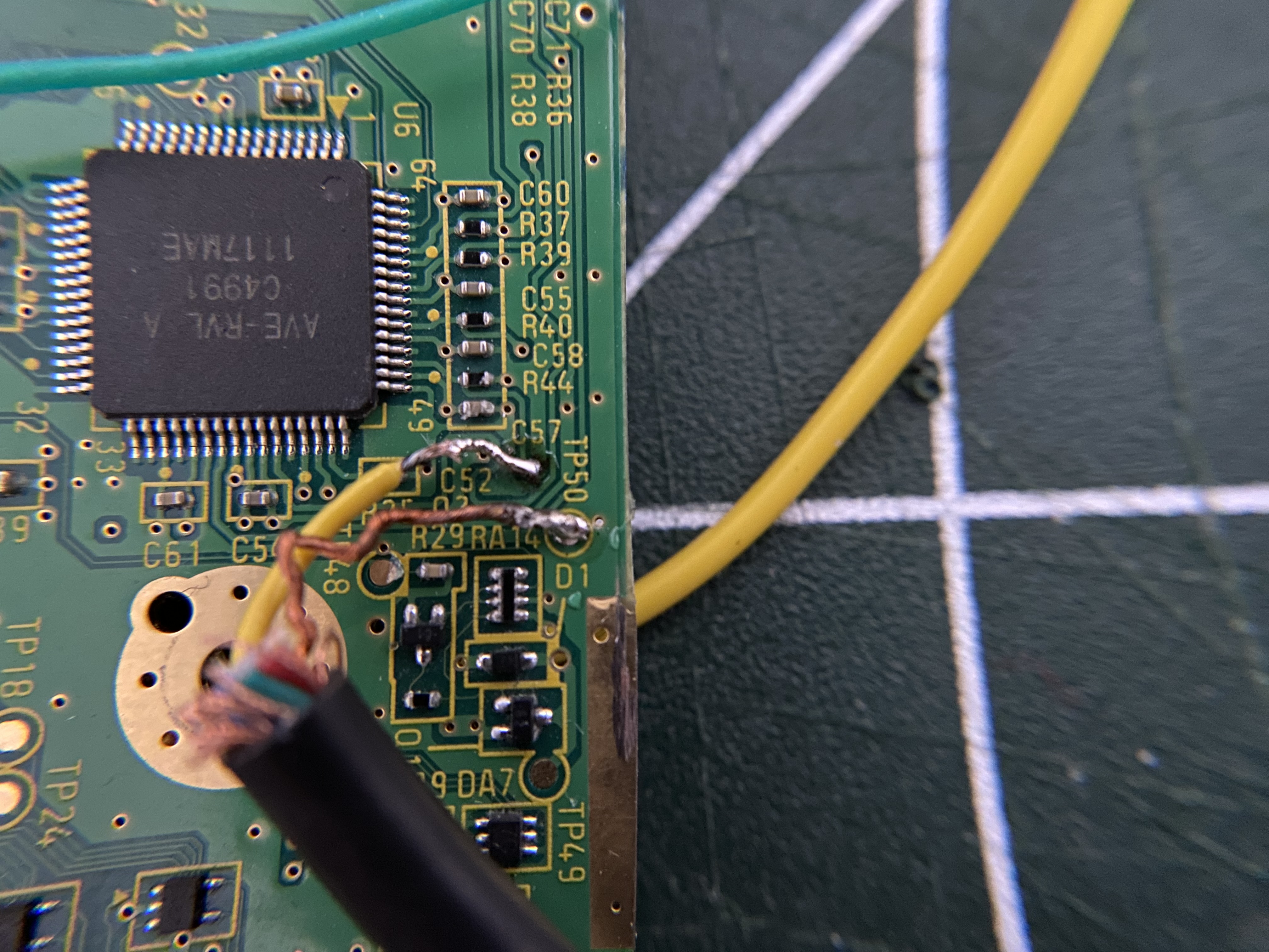

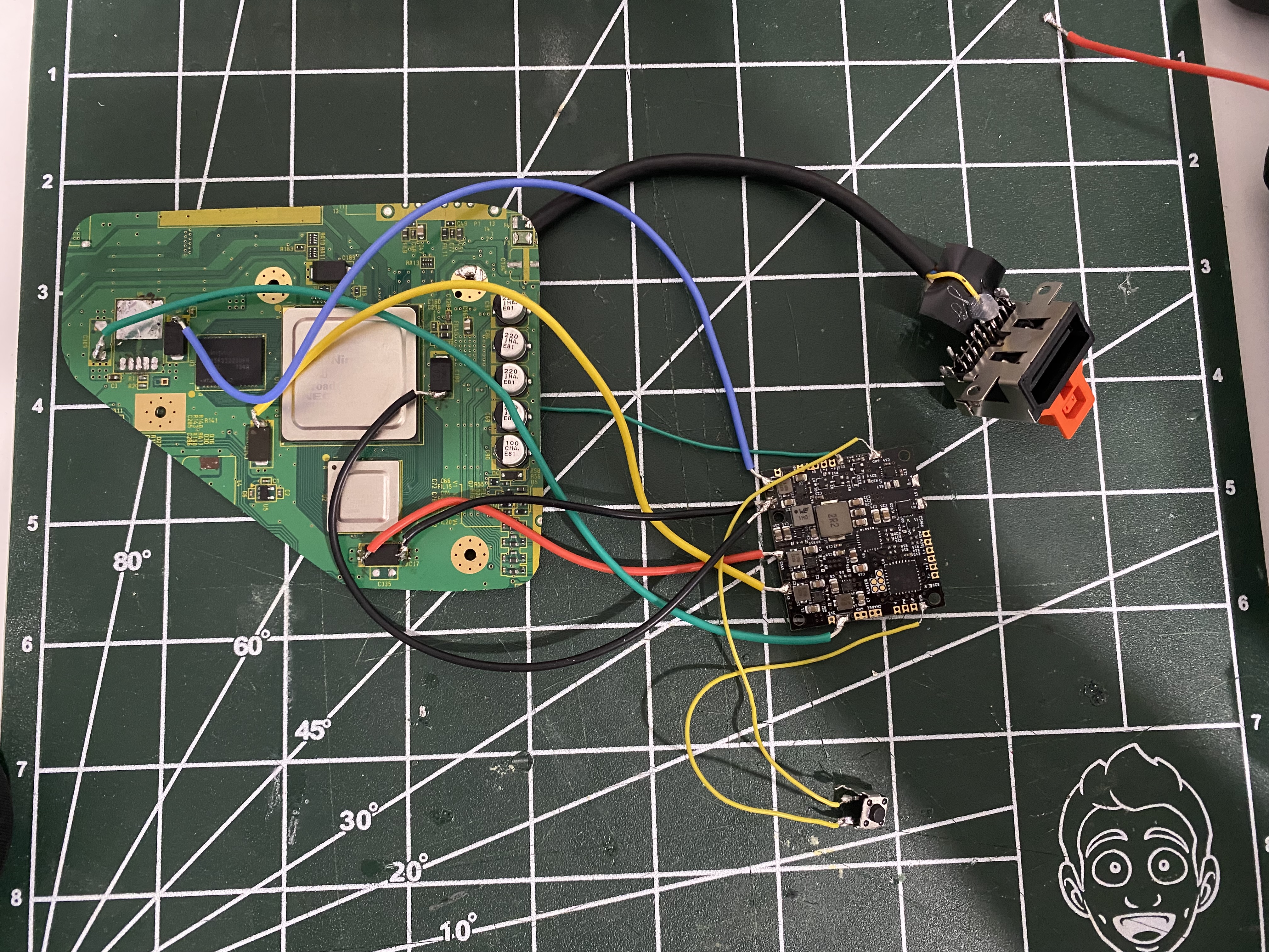

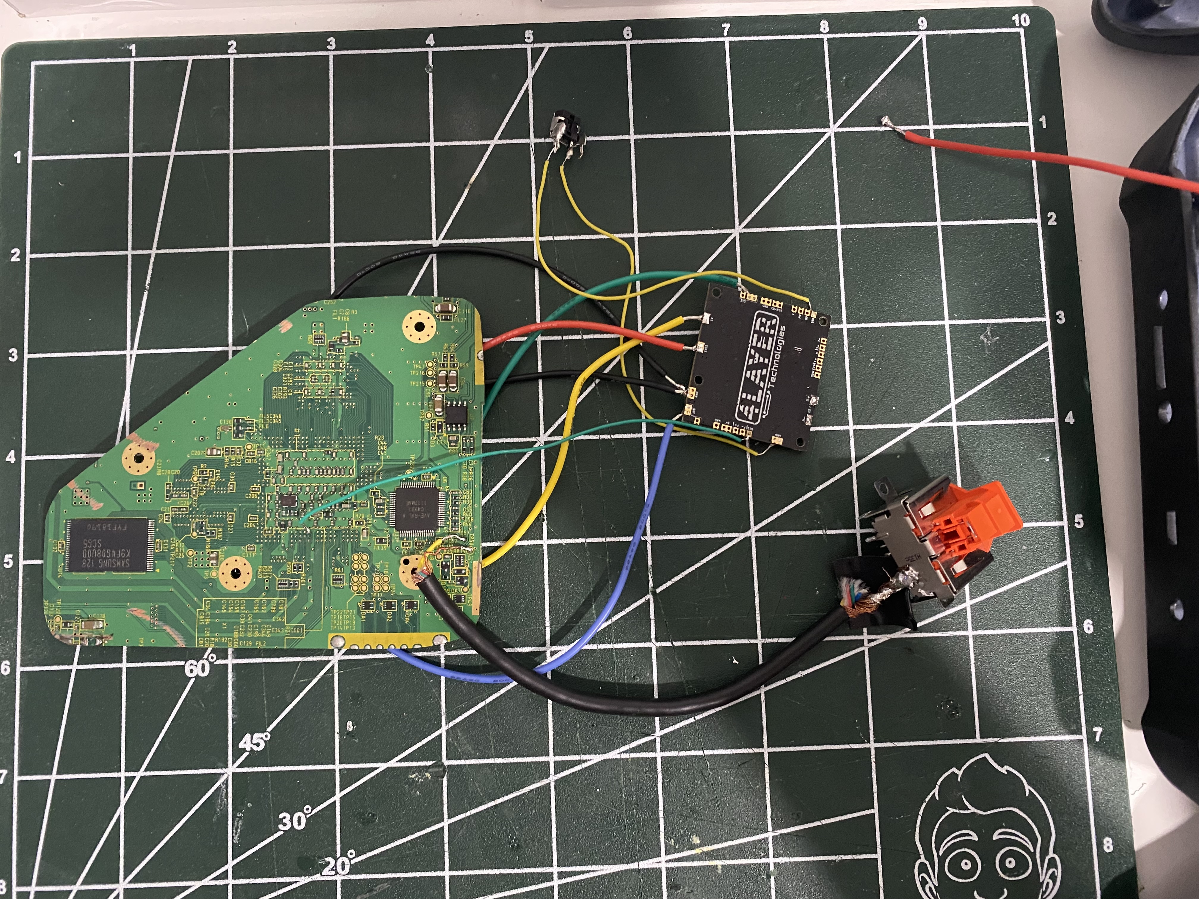

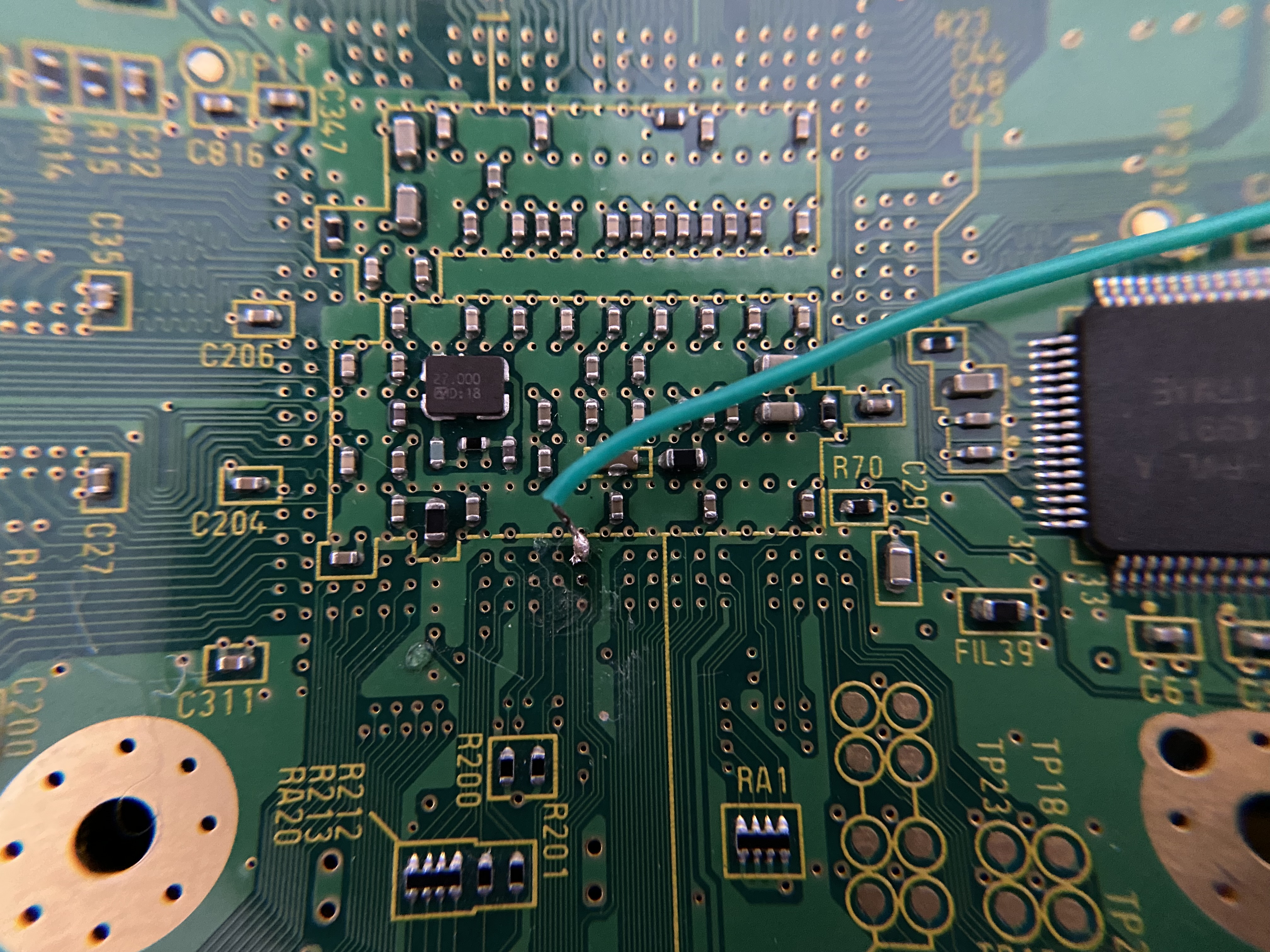

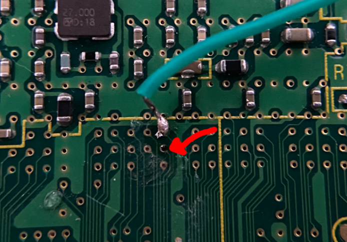

I got my Wii trimmed and cleaned up the edges of it. Then I tried to test it to see if I did it right but I was not able to get a video signal to show up. Also when I did test it I had the batteries for the Ashida build hooked up to it in the right spots, Plz help.
You have your U10 wire connected to the wrong via. It's meant to be the next one down
I highly recommend replacing that thick U10 wire with some 34AWG enamelled magnet wire. It'll reduce the possibility of breaking the via, which is a concern with the wire you've used here. Also you really should be exposing less wire to reduce the likelihood of causing a short

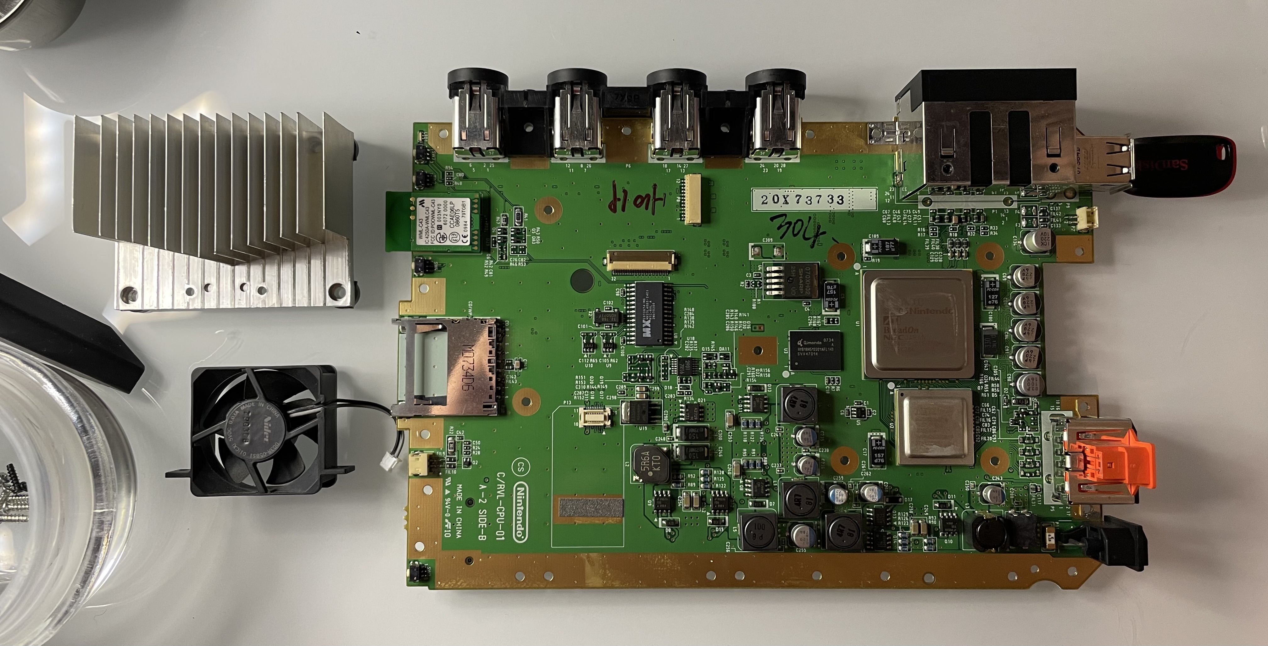

Hi everyone! I've just set out on my Wii Miicro journey, and I think I may have gotten a little bit ahead of myself. I began trimming what I thought was a 6-Layer Wii for a Noldendo Miicro, but now I'm not too sure. Researching other Noldendo builds has made me realize that my motherboard is slightly different than all the builds I've seen before. I'll attach a photo of my board, pre and post trim. Have I made a terrible mistake? Is there any hope for me? I'd really appreciate a little guidance if possible. Thanks guys! :blush:
