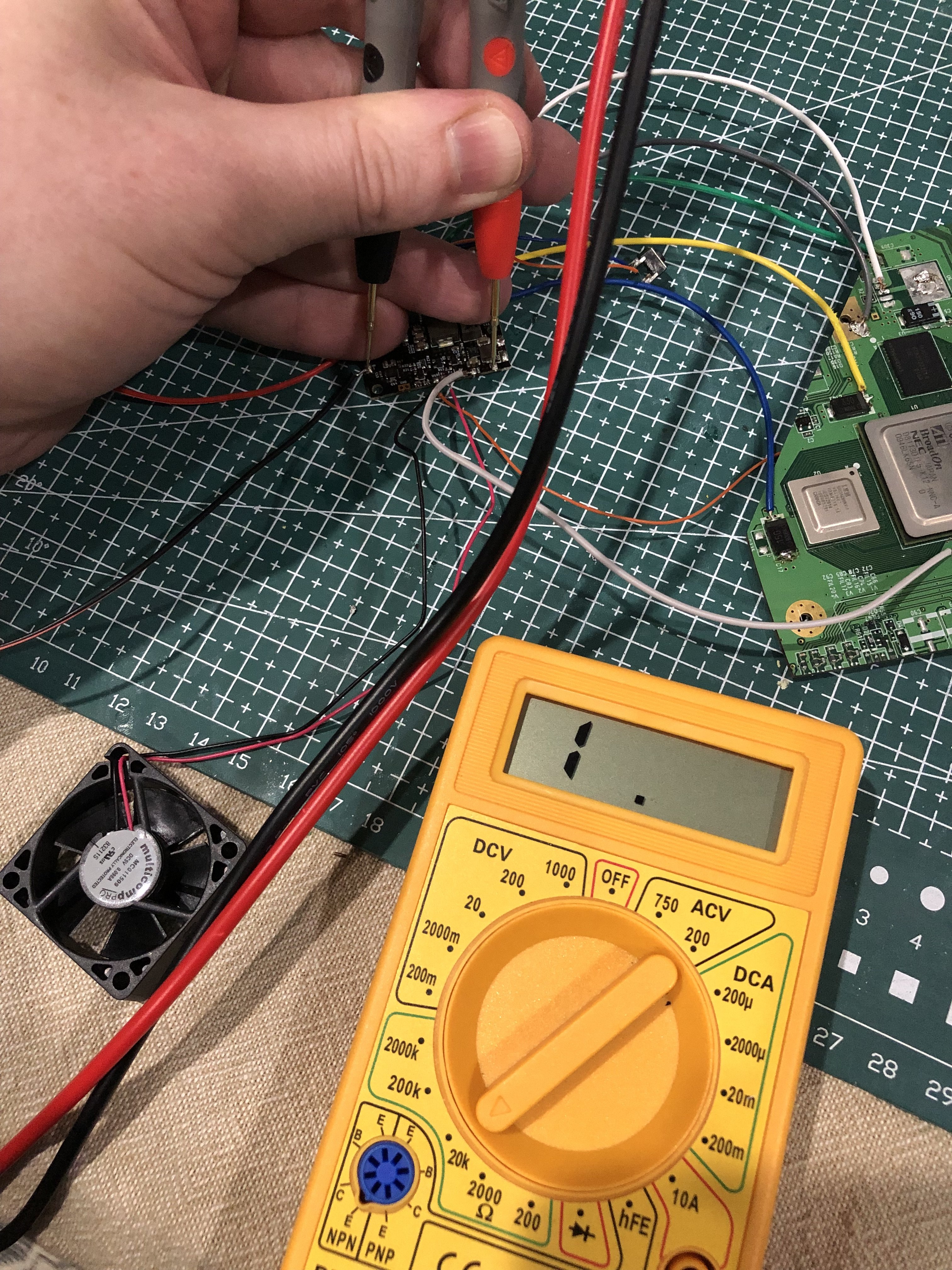

Just measured it then and the resistance is very high, above 20k Ohms.
Would this be evidence not of a short circuit, but something else then?

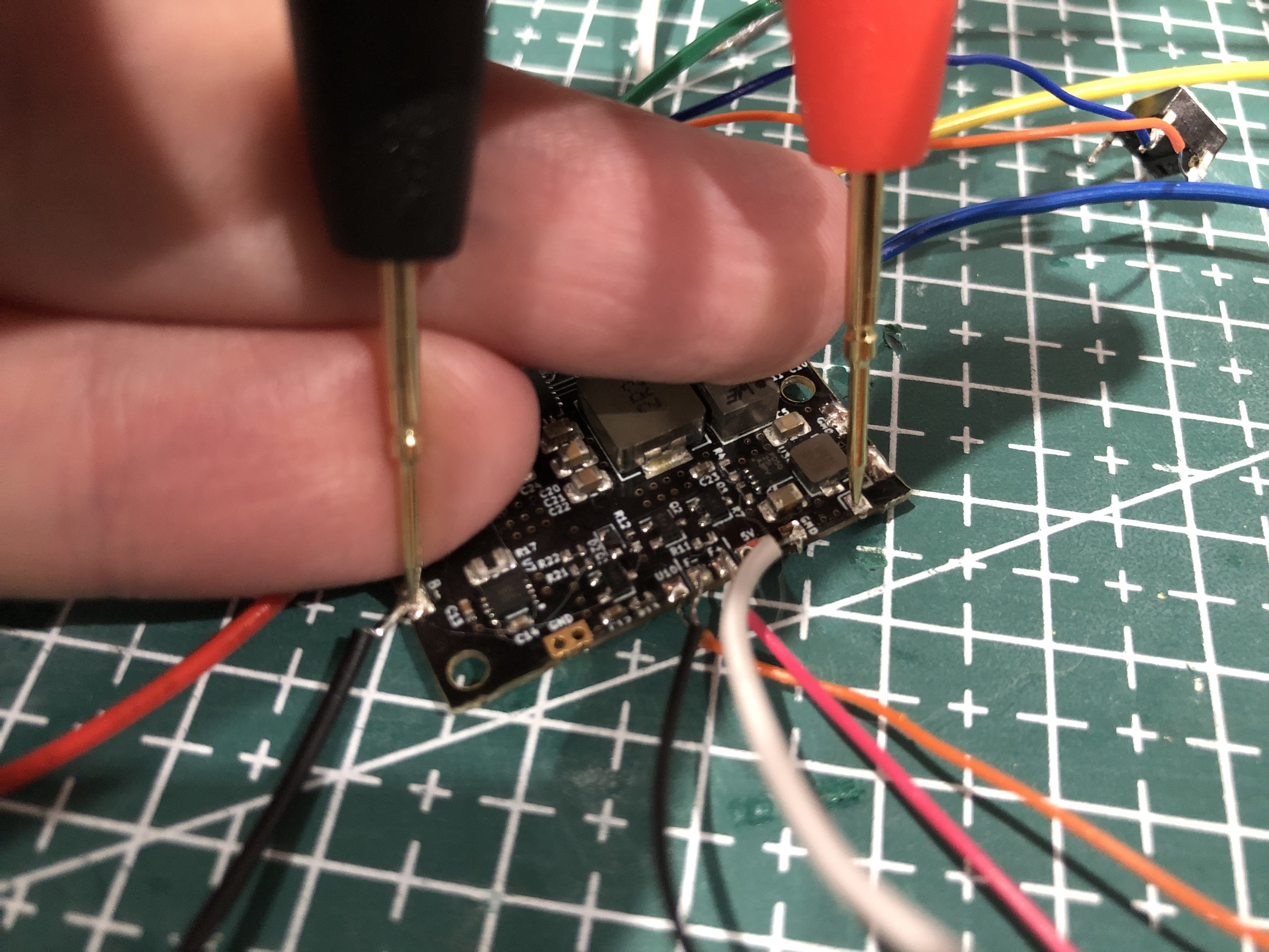

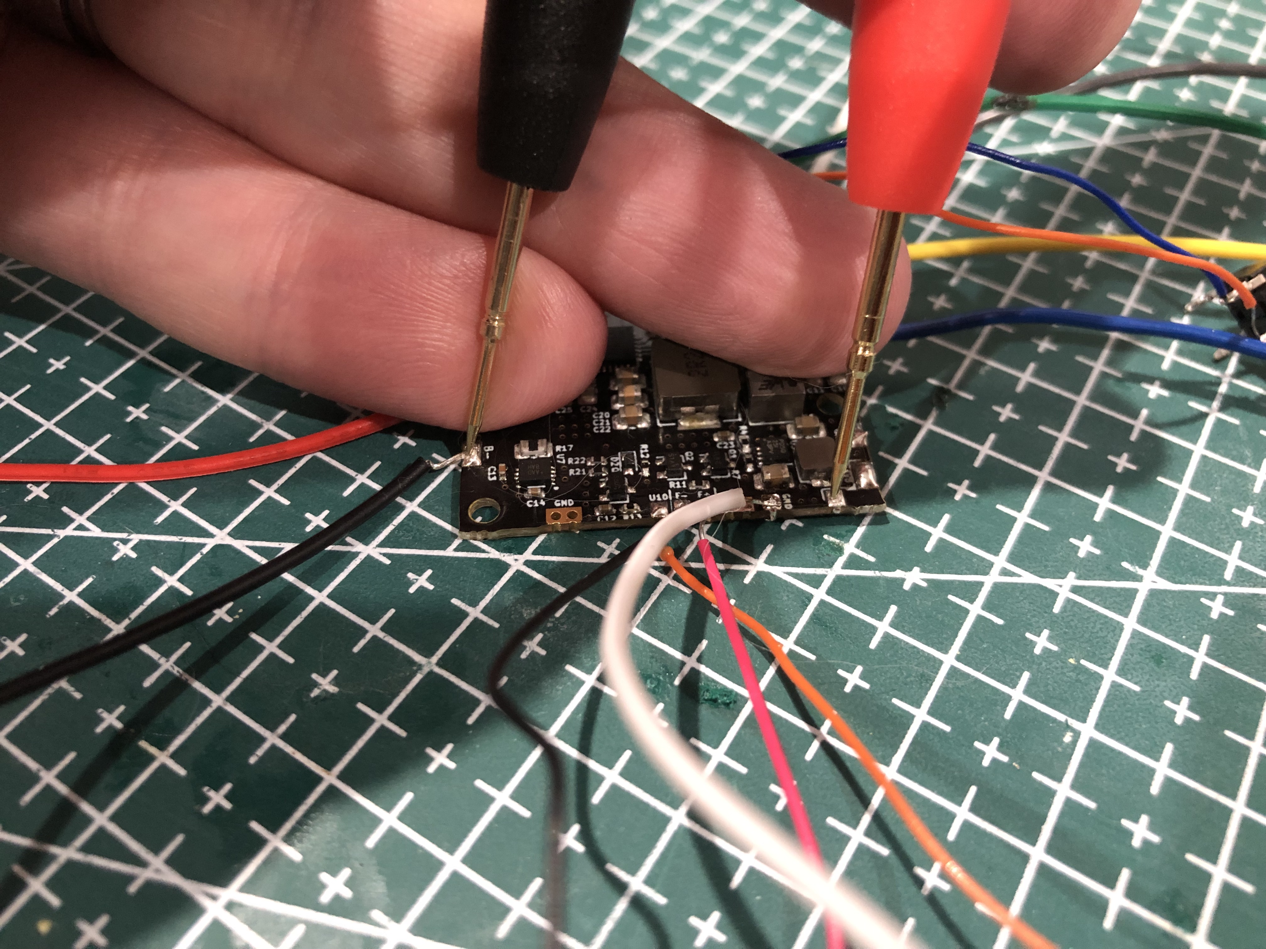

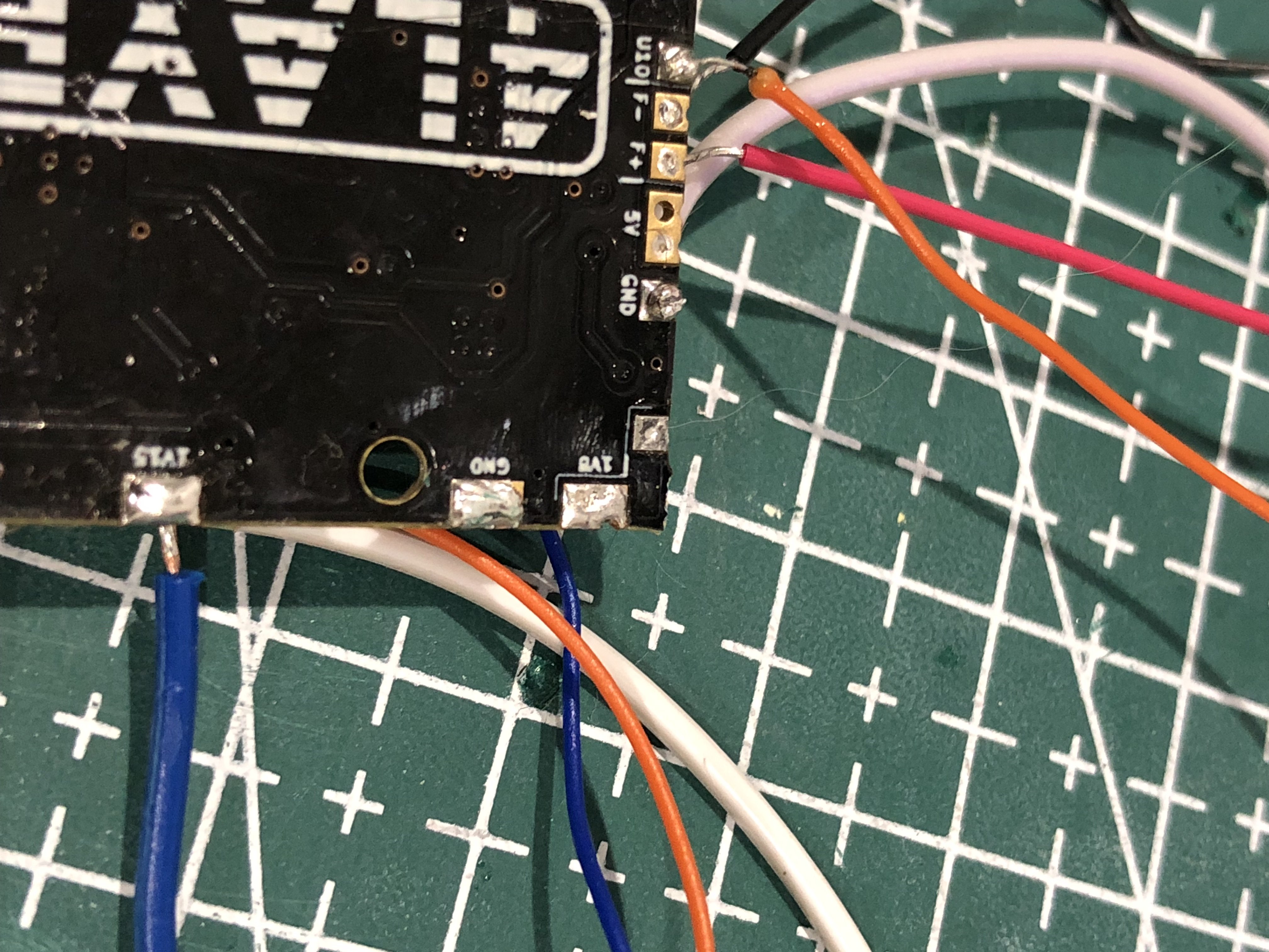

That's.... very strange. Can you post a picture of you taking that meausurement, like where your probes are on the board, and your multimeter settings?
I have taken and attached the below, showing the multimeter and the points on the board and some close-ups.
Even on 200k ohms, the meter kept rising until it hit 1.

Ah, I meant the resistance between 1v8 and gnd on the Wii, not the PMS. Also B- is not directly connected to GND iirc, you need to have your negative probe on a GND pad.
Ahh, well that does change the game. The resistance is 36.1 Ohms between 1.8V and GND on the Wii.
Thank you, i'll note that down for any further measurements; appreciate it.

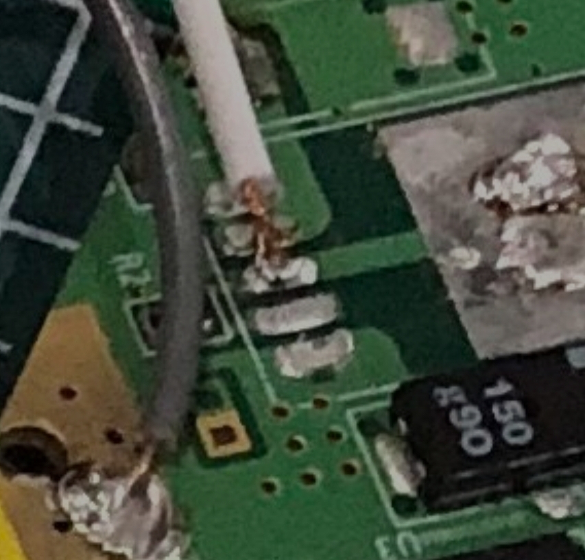

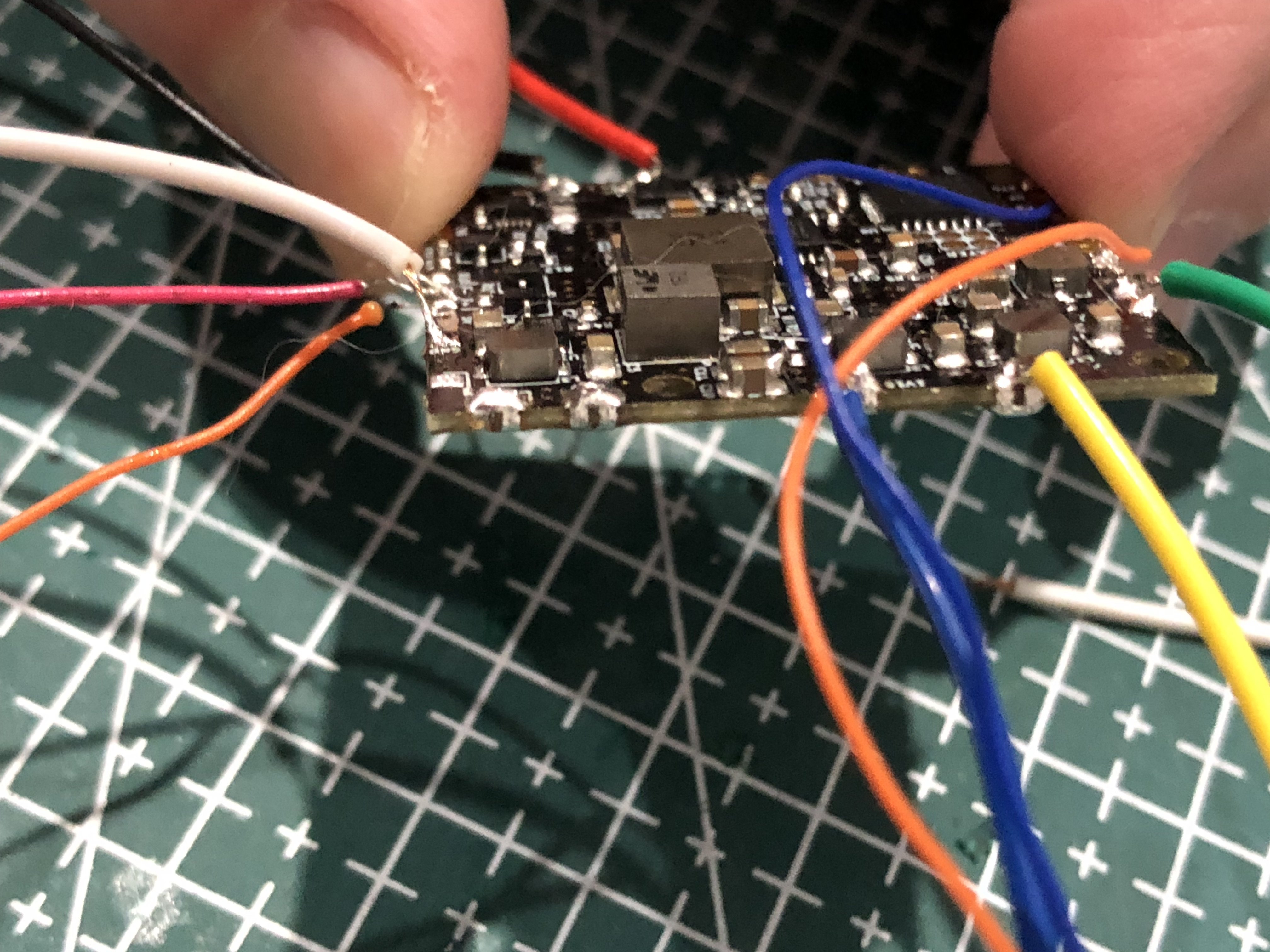

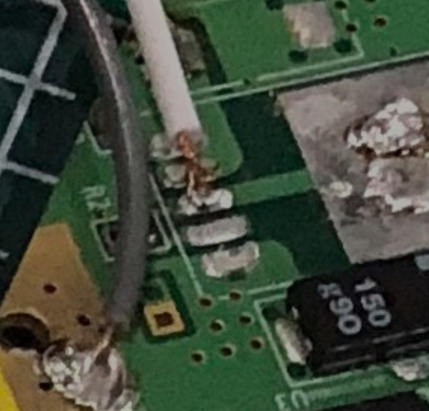

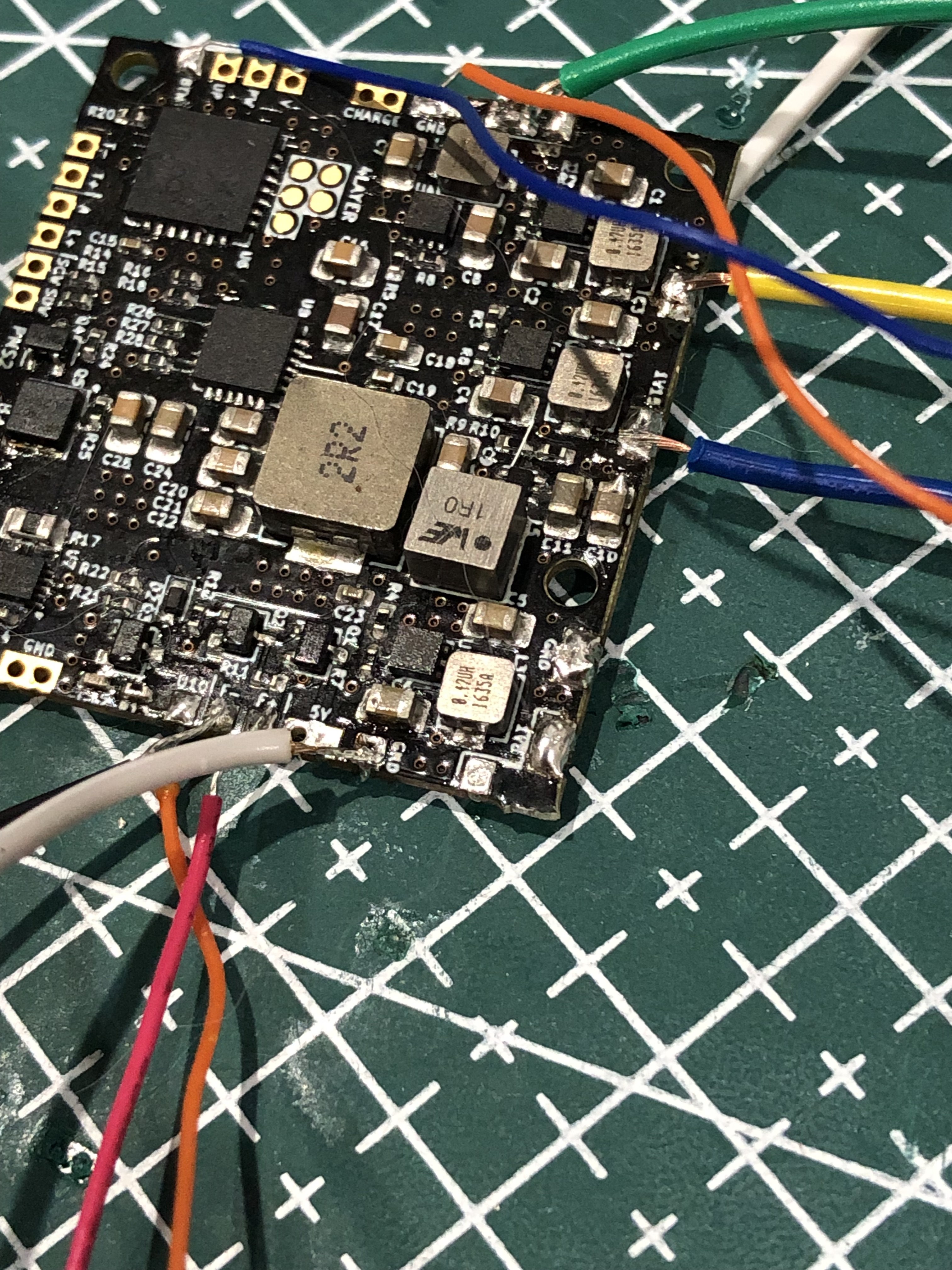

This is incredibly sus:
That could potentially be shorting the 1v8 and 3v3 rails together. Others have already said it, but I will emphasize its importance: you *need* to trim down the amount of exposed wire to just enough to cover the joint. Having an excess of exposed wire on a joint makes it *really* easy for shorts to happen. Even if these are just wires for testing, you don't want to risk damaging anything. In the same vein, you need to tin your wires and pads prior to soldering them together. Doing so will significantly increase the quality of your joints.
I think I am even more confused now than before!!
After removing all the cables from the Wii & PMS, shortened and cleaned 'em up, the PMS won't power on when I connect GND.
How can I attempt to locate a short? I can't physically see anything that would be causing it, but is there another way?
Flux residue can carry fine hairs of conductive material that cause transient shorts. Give a good isopropyl alcohol scrub to all of your soldering and see if anything changes
