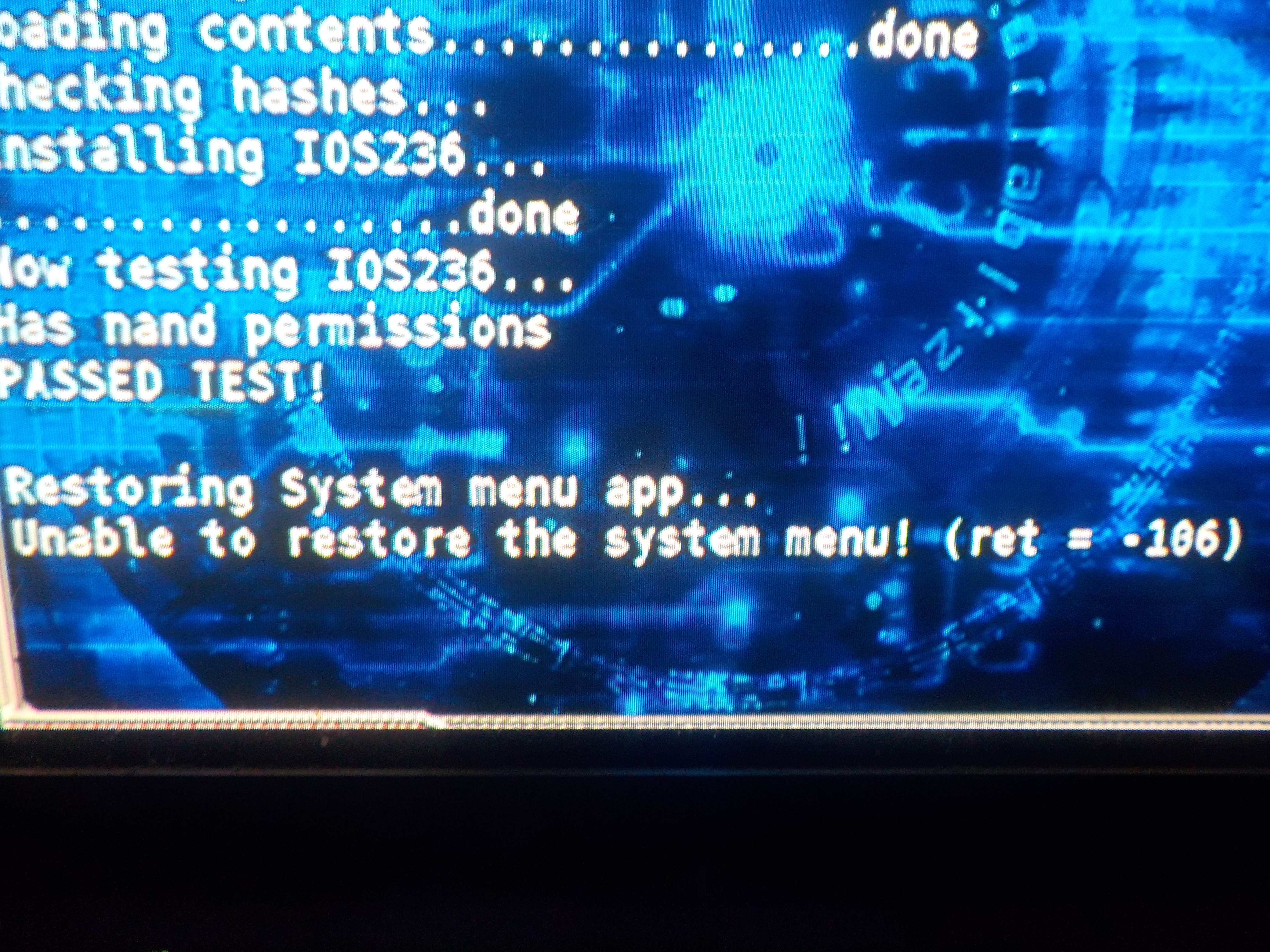

Uh oh.... I think something REALLY bad might have happened. The Wii System Menu stopped doing its whole existing thing; as in: It's gone. I can't load into it. PriiLoader won't load into it. Instead it tells me this:
Before that, I noticed this when finished with the Cheese Installer:

OK SO PortablizeMii does replace USB Loader GX and pretty much any other homebrew since they all require the disc drive for certain calls. PM does also require System Menu 4.3, since this version of priiloader looks for the system menu in a particular location, and each system update moves the system menu file around.
Since you were on 4.2, you system menu is probably either corrupted or just gone, and your flash drive is probably a little slow or formatted incorrectly. At this point you have two options, restore you system back to the way it was before PM, or repair your setup so that PM works correctly.

Use http://wiibrew.org/wiki/Ohneschwanzenegger to make a clean NAND and install that :)

Seems like the DLL files were taken down for that application. I'll see if I can hunt 'em down. somewhere Never mind, probably a bad idea to go fishing them individually. Someone has to have a package of them somewhere though.
Found a page that had an archive of the .dlls:
http://spawn.link/factory-reset-revirginizing-your-wii/
Alright. Wii's fully operational again (except for the disc drive -- obviously)! Thanks to everyone for helping me out, I really appreciate it!
