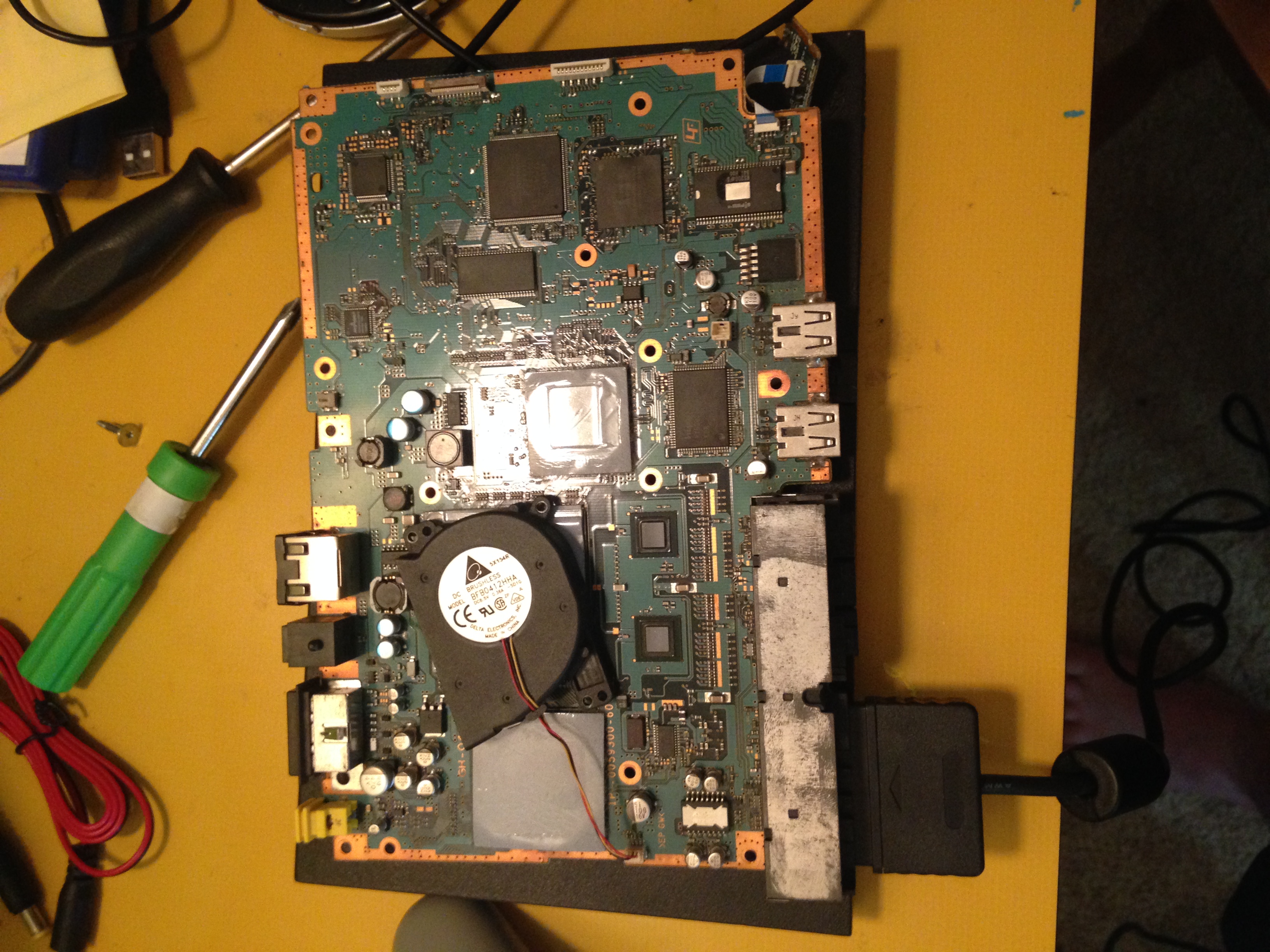

All the orange points are connected together inside the PS2 board. You are just grabbing the 5v from one of the points to power your screen. I'd suggest reading through our electronics guides

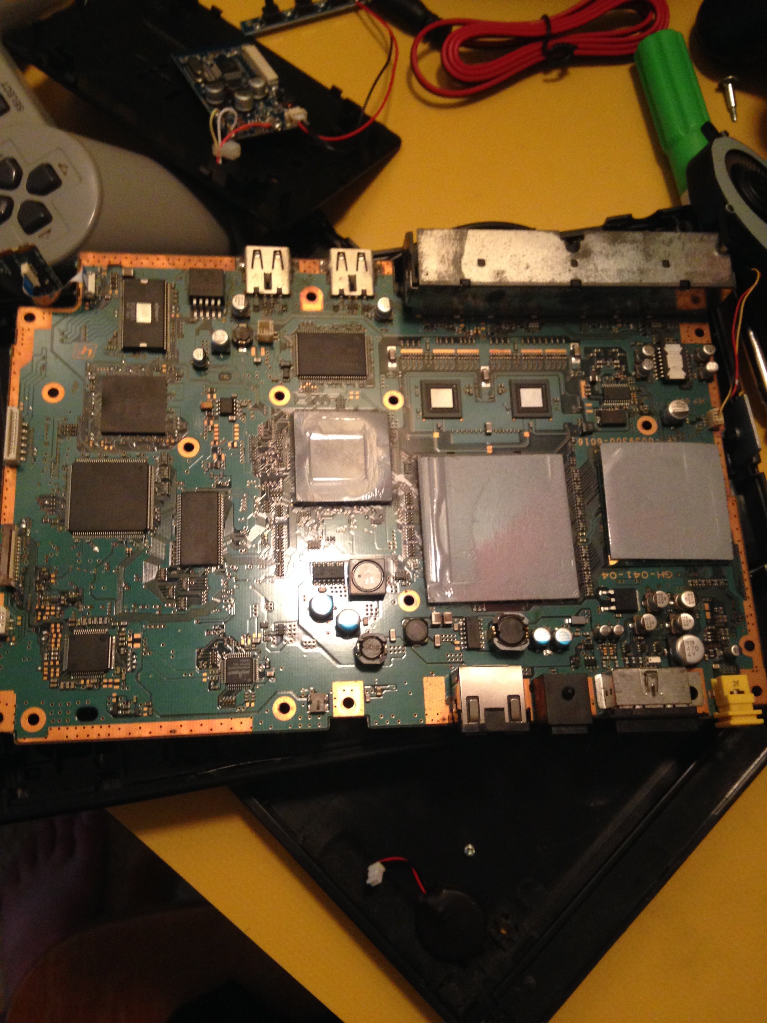

I took a look at my motherboard and could not find the regulator (5v orange area).
-merge-
Yes the ps2 will boot without a disc drive, free mcboot, or cmos battery.
Do you know where the PS2 regulator is? I need it to power my monitor.

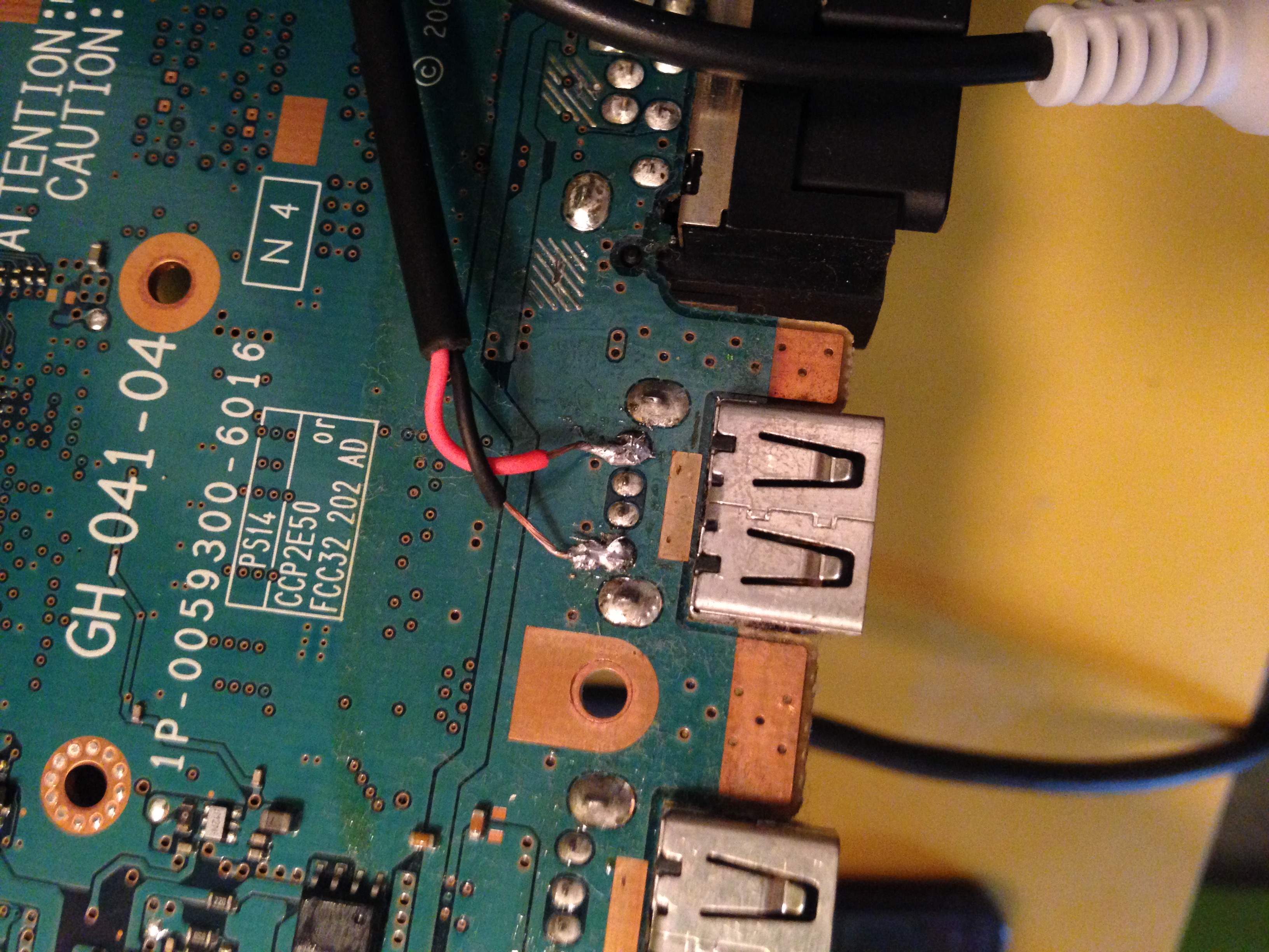

Also if you want 5v take it from the usb port its easier and safe in my opinion(that's where I currently power my screen)

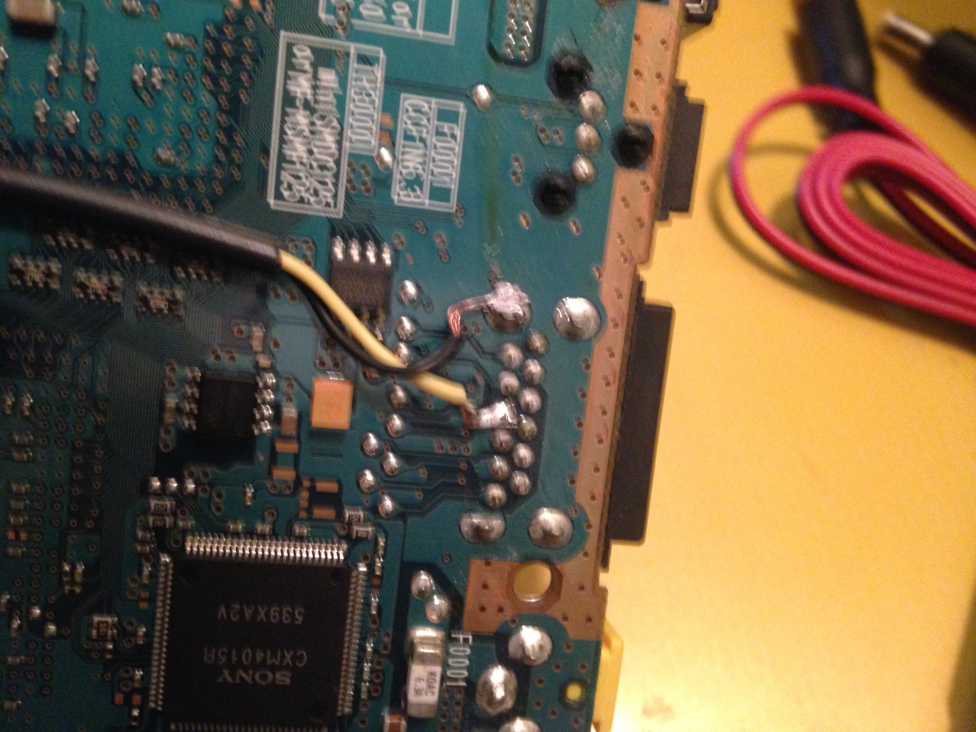

or take it from the av port setup (on the ps2) (that's where im powering my audio amp board from!)

I guess an official controller would be better for you. I will take 5v from the USB port, thanks (I will be able to turn it on today for a test :D)

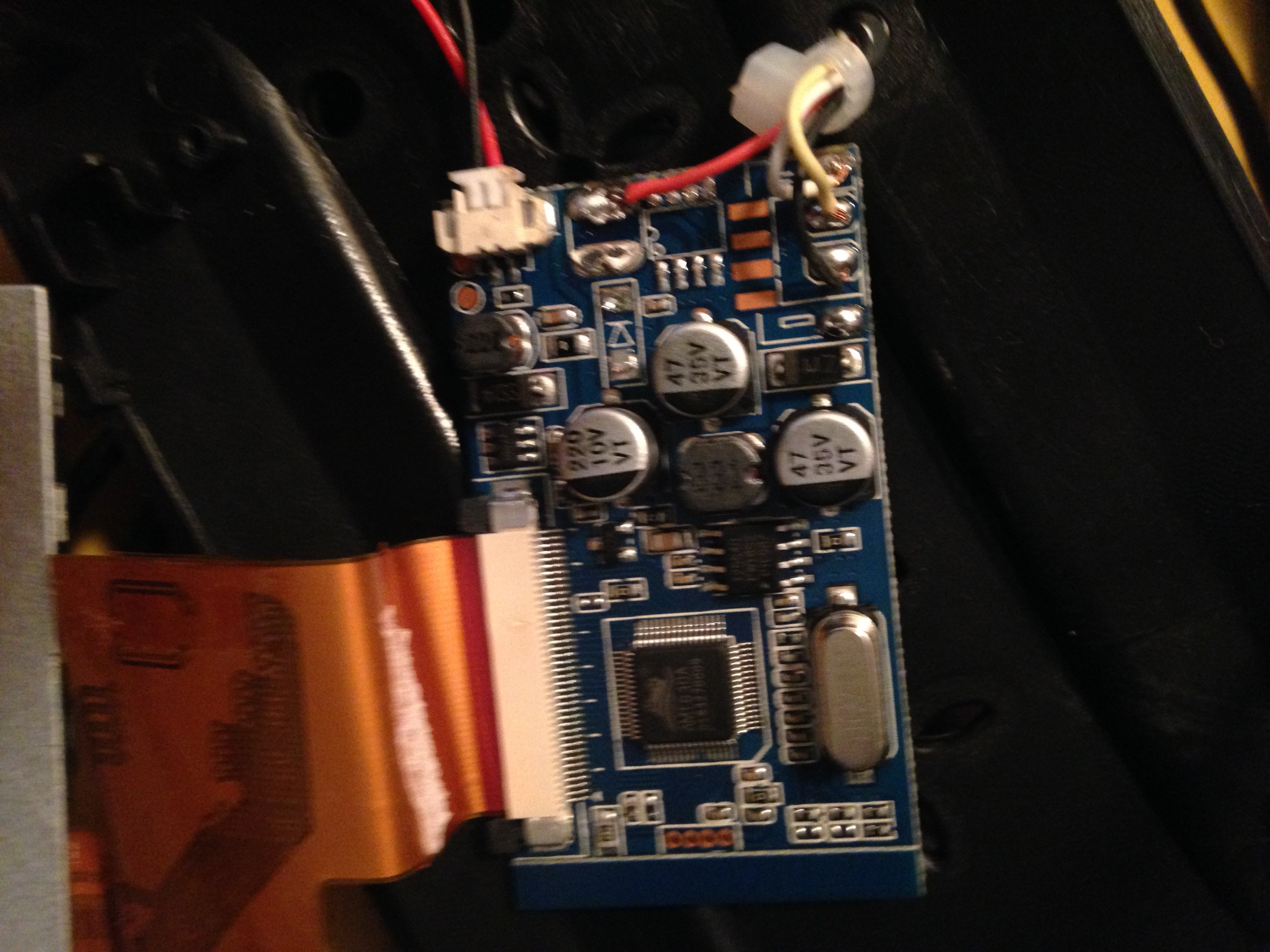

They didnt send? ok I'll try again. Is this ready to turn on? Ok I turned it on but the screen didn't turn on. Do you know what is wrong from the picture?

ever turned on the system before to make sure its working?
2) Your connections seem correct but reduce how much exposed wires you have that could short out anything.
3) the monitor turned on be fore attempting?
4) Also the monitor came with a control board (buttons for power, switching between input?)
1) Yes I did (before anything was hooked up)
2) I'll see what I can do with this (the PS2 turns on but not the monitor)
3) I never turned the monitor on beforehand
4) It came a control board for audio up and down and a menu (no power buttons)

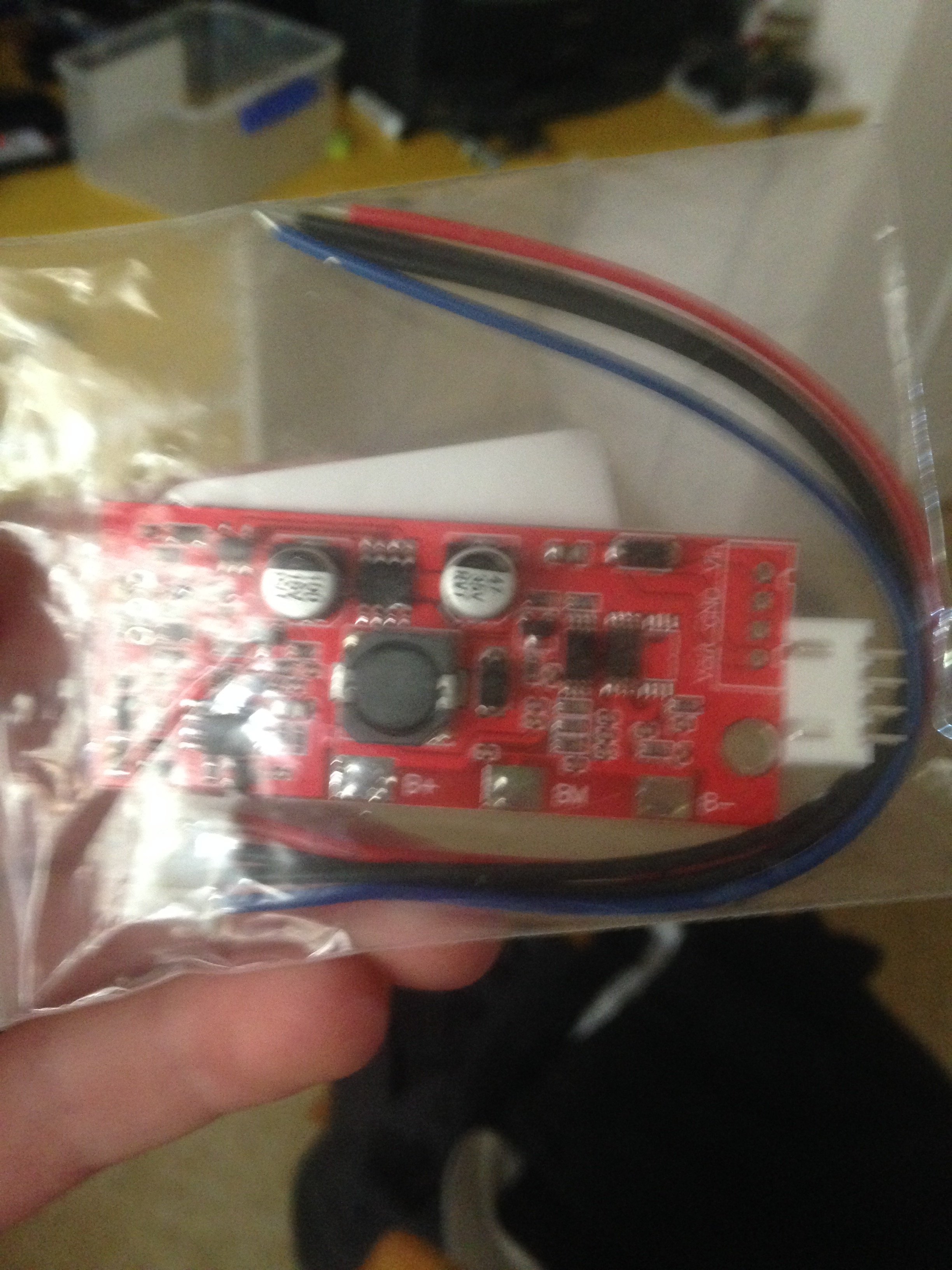

My red board also just arrived the other day. I need a bit of help wiring it up. I know I have to solder the pins to the board itself. But I am not sure about the power or charging

send a pic of red brd

vi is for the inout voltage (charger)
VO is for output (COnsole)
Both share a common ground

Thanks for this :D What kind of charger would work? I am not sure at all. If the portable runs on 7.4v total from two 3.7v batteries, would I need to get a 7.4v charger?

I wouldn't do that, you should search the data about the charging pcb and use a power supply that outputs between the minimun and maximun voltage recomended for it

I just found out what the voltages are of the PCB for charging. It is 9-15v charging and 5-8.4v for output.
EDIT 2:
Would these two be good for charging this?

For the holders you can go pretty much anything you want as long as you can make the desired battery configuration, it just depends on how you are going to arrange them inside your portable. If you order them make sure that the power cables are thick enough if not change them.
For the charger given the charging board input voltage a regular 12V adapter would be ok (so you skip some weird voltage adapters) and for current I think that 3A are enough for a charge and play solution. I'm not too sure about that last one but somebody else will correct me if I'm wrong.
