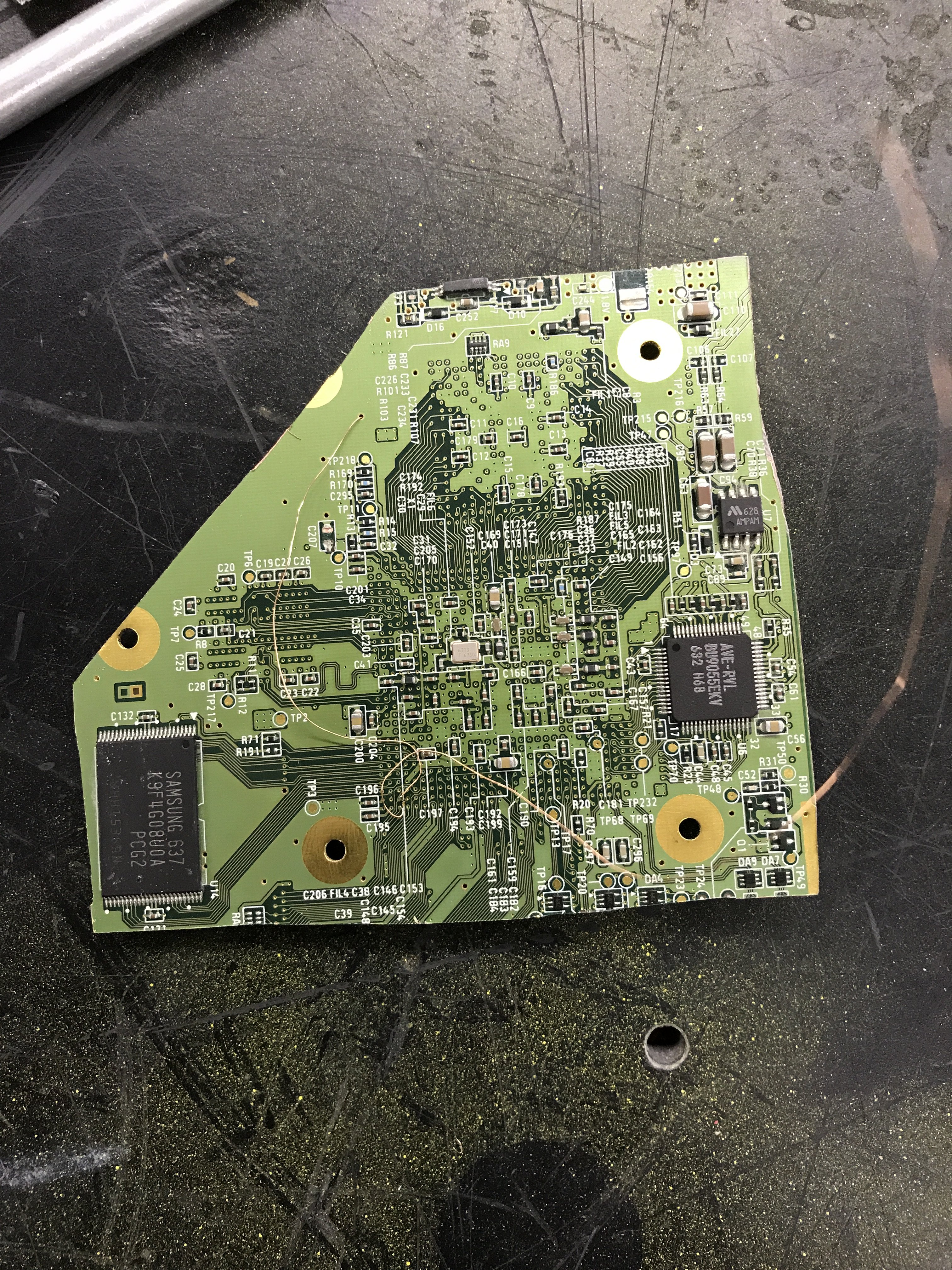

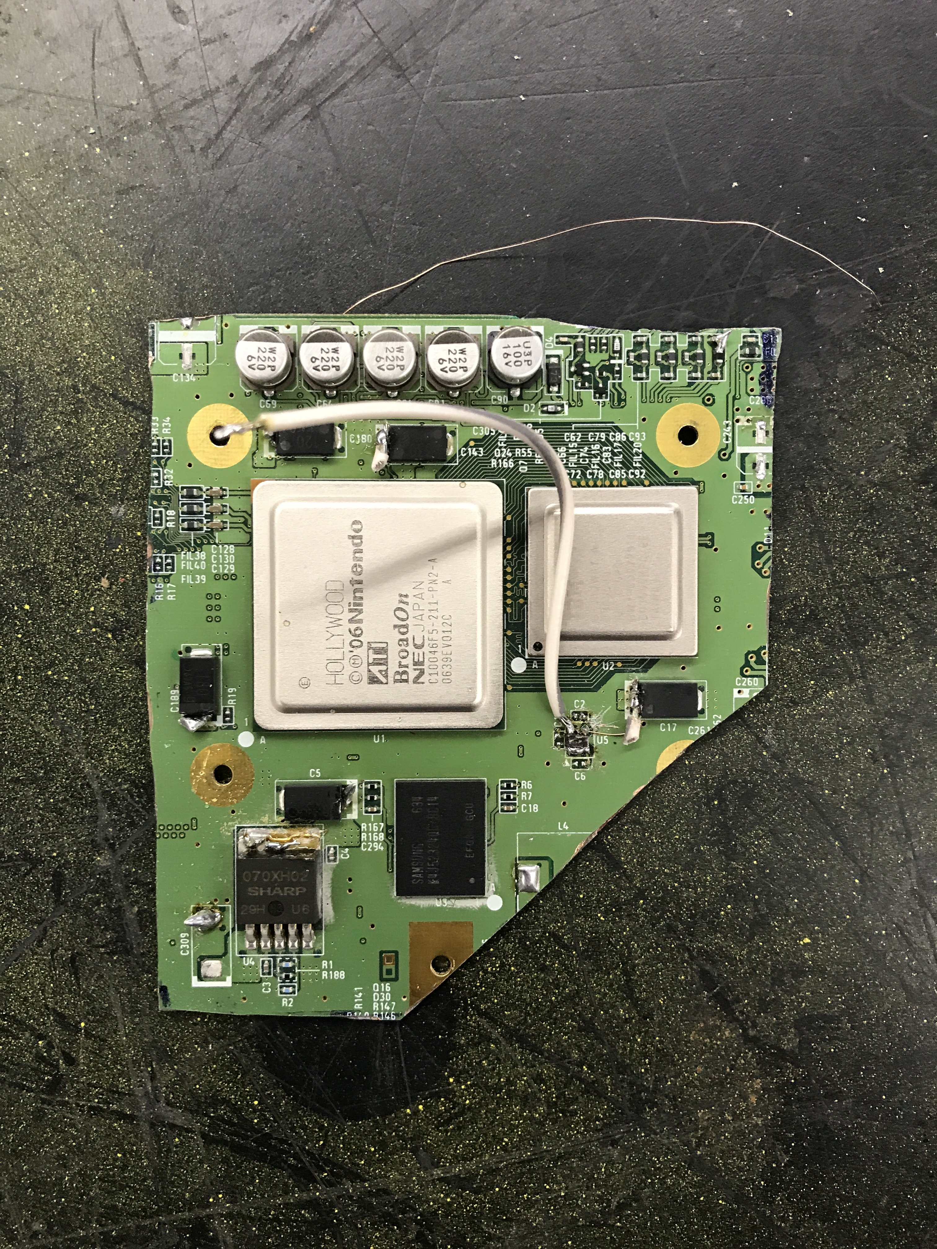

This is my first time posting sorry for anything wrong.
I trimmed my 6 layer Wii and relocated the U9 chip because my U10 broke.
The 1.15v, 1v and 1.8v lines are all reading as continuous to ground. 3.3v is not reading as continuous but has low resistance.
What do I do to fix this.
The gray wire is for the U9 3.3 lead and the floating copper one is for Reset

I have sanded down each side. They are very smooth but the lines are still shorted.
1.15v is 24 ohm
3.3v fluctuates around 9k ohm
1v is 7 ohm
What else can I do

Yeah, I covered it in duct tape. Is there any way to clean it just to be sure that there is none underneath
First I would check to see that they are actually shorted. 24 ohms might be normal, but 7 is iffy. I've never worked with a 6 layer board though, someone else would have to check theirs to see what the values should be. I assume it would be different than a stock board.
Would I be able to do that or do I have to wait for someone else to test theirs
I just checked with an untrimmed 6 layer, and I get 7 ohms from the 1v line, 21 ohms in the 1.15v line, and 29 ohms on the left 1.8v line, so you should be good :)
