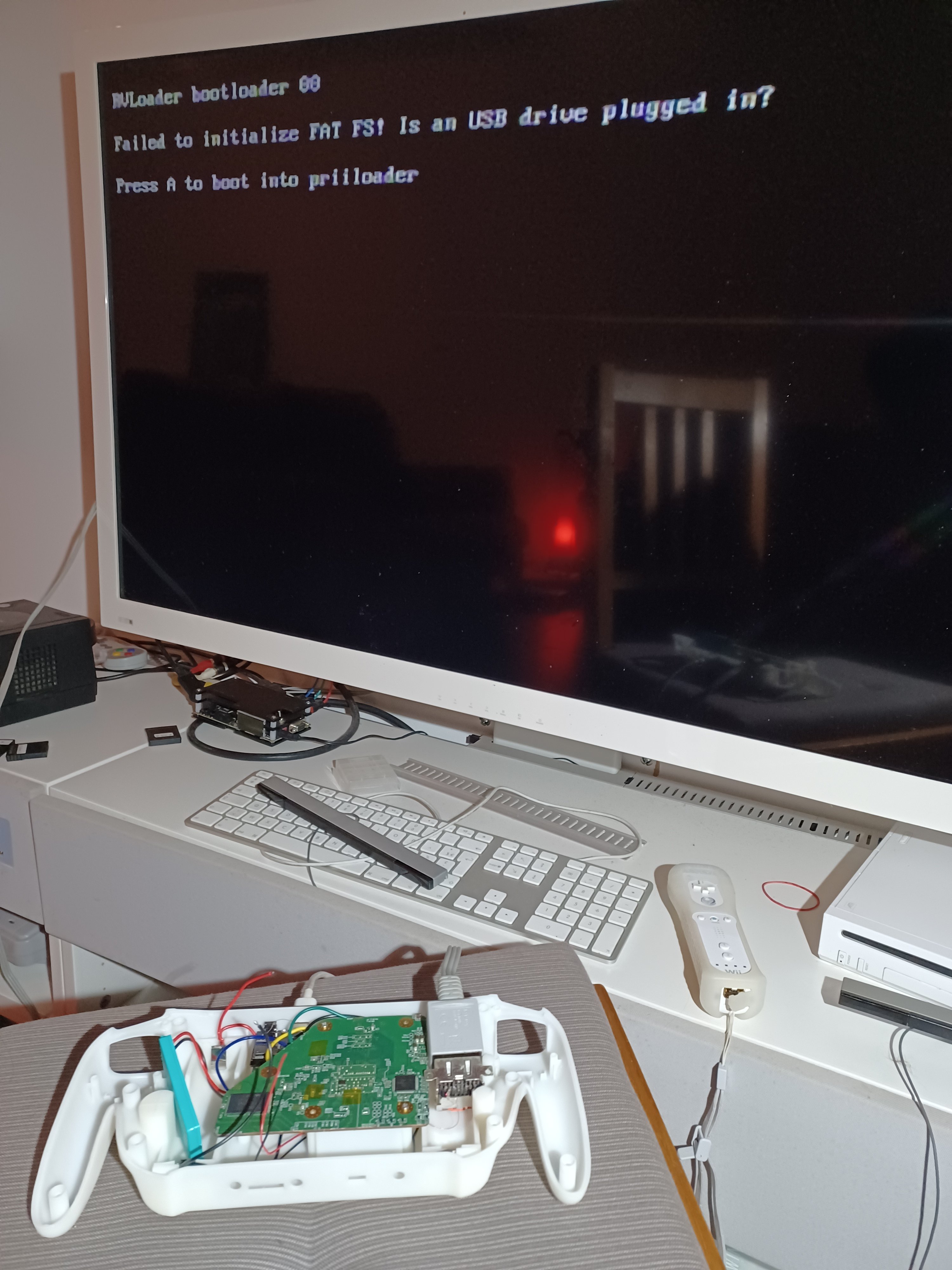

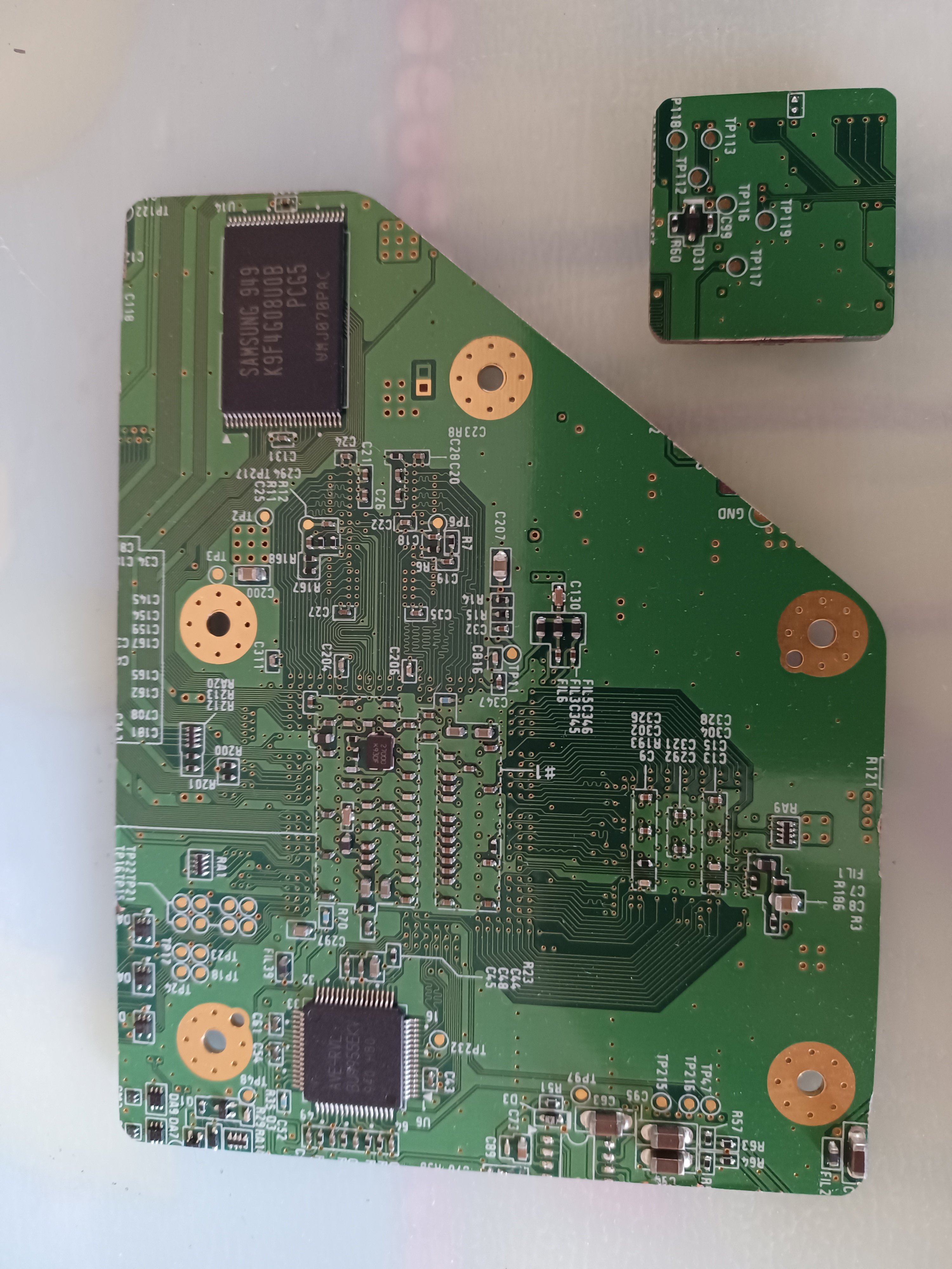

Hi there, 2 weeks ago I've trimmed my first wii motherboard as an introduction of my Ashida journey.
Here is the obtained result :
Then, after checking the resistance values between power and ground planes, which were as expected, I did the minimum connections with the RVL-PMS2 in order to check the boot, including the magnet wire dedicated to the U10 relocation.
At this point I had not received the Ashida batteries yet, so I sacrified an old GBA SP battery that still charges but does not withstand the load anymore. As expected, it did not whithstand the load at Wii power ON, so I also connected the PMS-PD power wires in order to get enough input power through the USB-C connector.
I also harvested the video output connector on the wii motherboard and connected a twisted pair of wires to the composite video pads.
I was so excited since my trimmed wii booted first try ! :D
Unfortunately, I guess I spent my whole beginner's luck at this point: after that success, I decided to complete the connections between PMS-PD, RVL-PMS2, and trimmed Wii.
After a discouraging no boot, I got back to checking insulation between power and ground planes : I found a short between 1.8V and ground that I missed during the check before power ON. I know the expected resistance is quite low, but I clearly have a short here (less than 1ohm).
Since then, I progressively disconnected everything following my investigations. I can now confirm that the short circuit is unfortunately located on the trimmed Wii side. Despite cautious inspection, I could not find the root cause, so I removed every wire from the board, as well as the original big capacitor at C180 on which I had soldered the RVL-NTC, but the short is still there.
From the regulator picture in the wii trimming guide, 1.8V appears only in a few places, and it's easy to visually verify that both 1.8V and GND planes/tracks/vias are not connected by a mighty solder blob.

First of all, congratulations for introducing you to the trimming world!! And with such a console as Ashida is
For your questions:
First you can remove EVERY component on the edges damaged by the trim, sometimes they cause shorts or malfunctioning
1- Did you use a heatsink or fan while you were testing your console turned on?
2,3- You can check for the Wii Compendium in this forum, using that you can see how the power and signals are distributed even between layers
If I’m not wrong, also there are some board scans with voltages on Shank’s Wii Super Thread, you can trace a line exactly where your trim is done and check if the edges have any 1.8V trace
Also I’m thinking but I’m not sure that you trimmed the board further than the trimming lines by watching your pictures (I think it’s only on the video port side), but this only can be confirmed by an expert on trimming. I see some damaged components that are safe on my trim, and it’s so close to the edges of the OMGWTF trim guide
Hope this can help you
Friend, you can measure whether 3.3V is also short circuited to GND. The solder pads at the 1.8V voltage regulator are not clean enough, at least from the picture.

I gave the photos a good old patented Stitches Scrutiny™, but I can't see anything visually amiss that hasn't already been pointed out. The LDO footprint pads are a little rough (personally I'd run my iron over them to clean the jaggedy-ness), and there are a few components on the trim edge that have been damaged and should be removed, but afaik none of those things should cause a 1.8v to ground short, and definitely shouldn't cause a short after allowing one successful boot......
If you have a can of compressed air available, you could try giving the underside of the CPU/GPU a good blast from all angles to dislodge any fragments of conductive debris that may have found their way underneath. It might do the trick, otherwise I'm not really sure what else to suggest here.

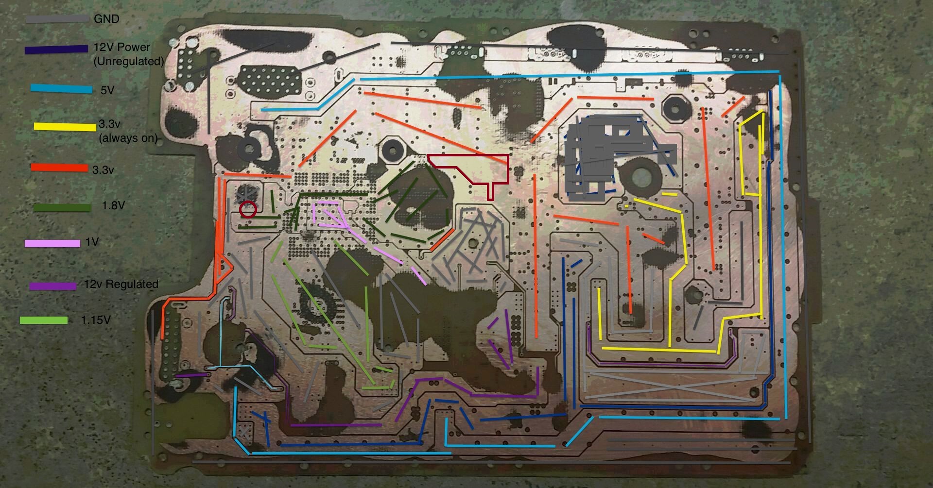

Meanwhile I started to analyze the board scan from Skank's Wii super thread, and I noticed 2 things (highlighted in dark red on the picture):
  • the C56 capacitor (red circle) is located between 1V8 and GND, and I've used the GND pad of the capacitor for my composite video wire. I can't see anything wrong here but I could remove this capacitor to check underneath. I already did it for C180 and found nothing wrong. Next to the 1V8 regulator, C4 and C5 are also concerned but I did not mess with them, so I don't intend to remove them for now.
  • I expect the red polygon to be 1V8 powered, but the scan shows that it is not part of the 1V8 plane, because there is already the 3V3 plane here. That means that this 1V8 red polygon is located on a track layer, and since the U4 regulator and C5 capacitor are on top side, I am convinced it is on the top layer. That means it is way closer from the ground plane (2nd top layer) than the usual distance between voltage and GND layers. The middle pad of the 1V8 regulator really does not look good: locally some board thickness along the edge of the pad is missing, so I wonder if I did not short the pad with the locally unprotected ground plane in my attempt to clean it, which I might have done between first boot and second failed attempt.
Since this 1V8 regulator is replaced by the RVL-PMS2, I think I'm safe to cut the track between the regulator's 3rd pad and the massive 1V8 pad on which we connect the PMS2, right ? I mean this track does not power anything critical other than R1 that is not required anymore once the regulator is removed, is that correct ?
EDIT : in the meantime I downloaded the compendium (incredible amount of work, congrats to the team and thanks a lot). It appears that I misplaced the C56 capacitor (red circle), it is between 3V3 and GND so forget my first point. I could also confirm that only R1 will be disconnected if I cut the track of the 3rd pad, so I'll go for it next, and keep you informed.
