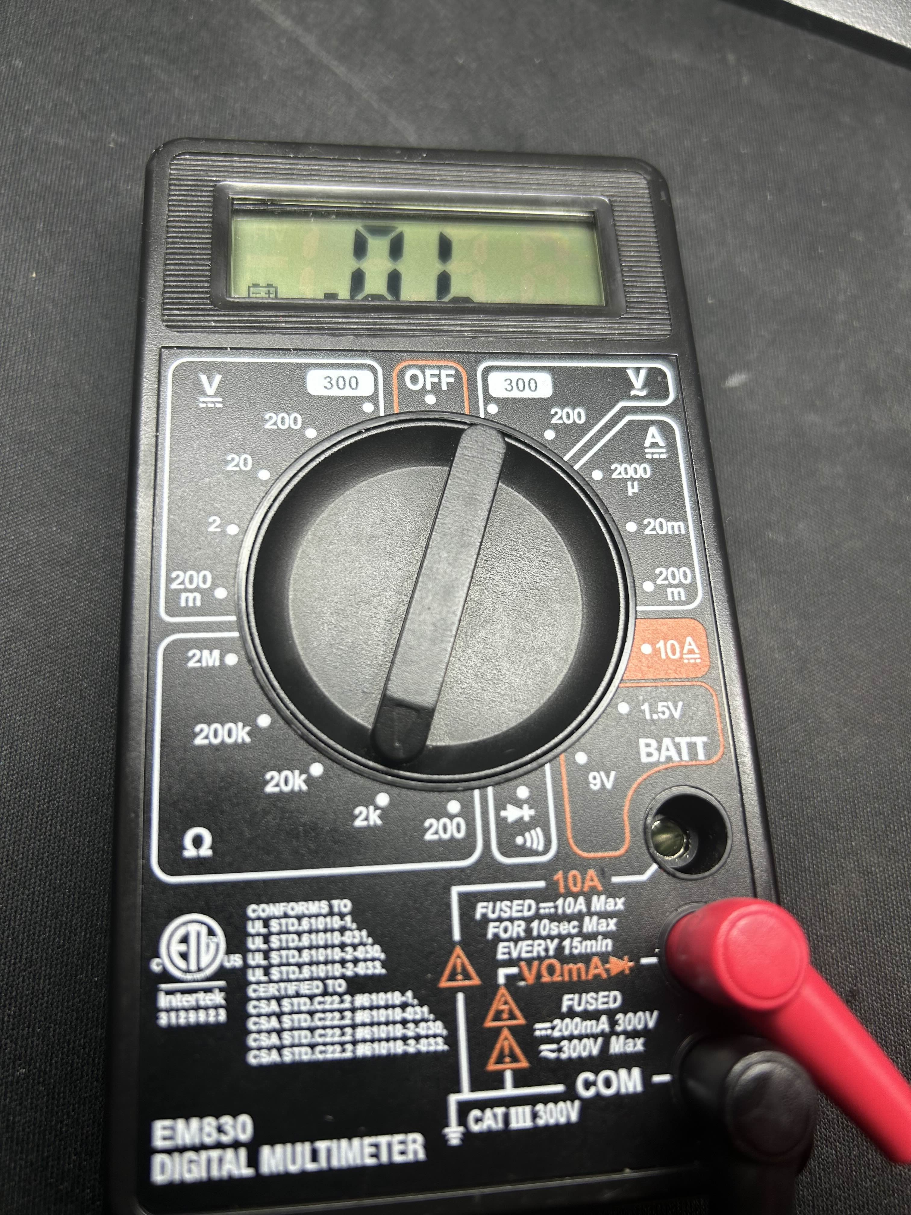

Resistance Readings
B- to 3.3v .202
B- to 1v .1
B- to 1.15v .031
B- to 1.8v .03
My Multimeter is set to the 2k setting in resistance. Picture for reference

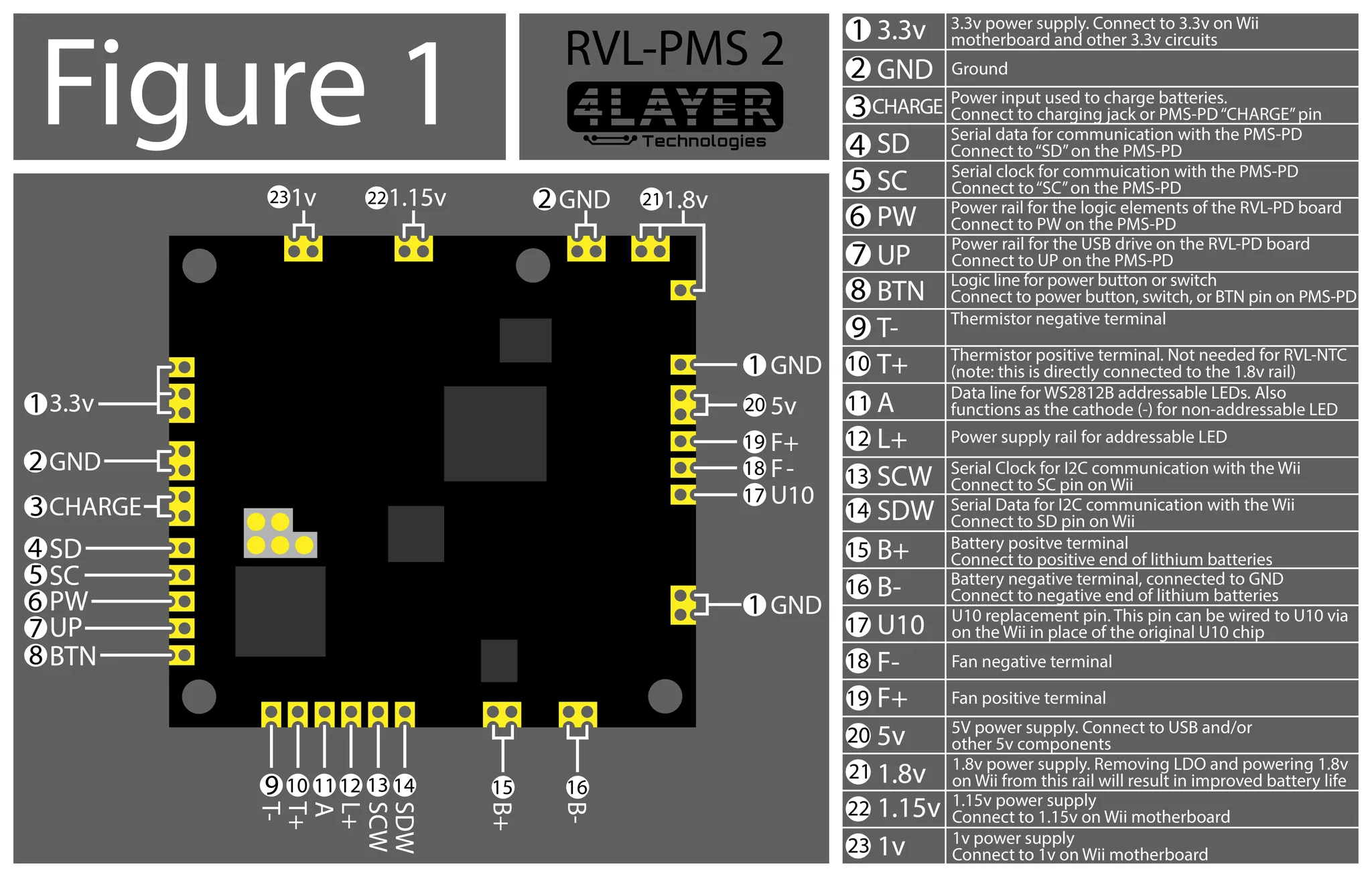

  • Figure_1_PMS2_downscale_5c8df517-3896-4c36-a507-e9276d3b3992_2048x2048.webp
