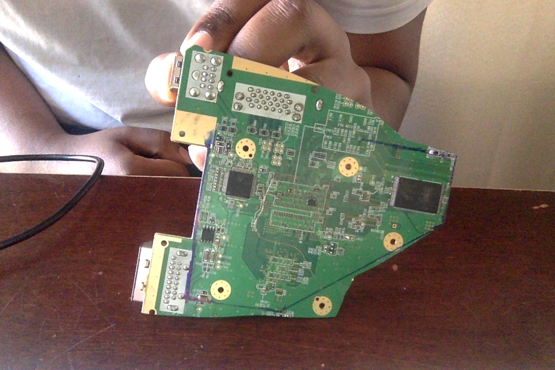

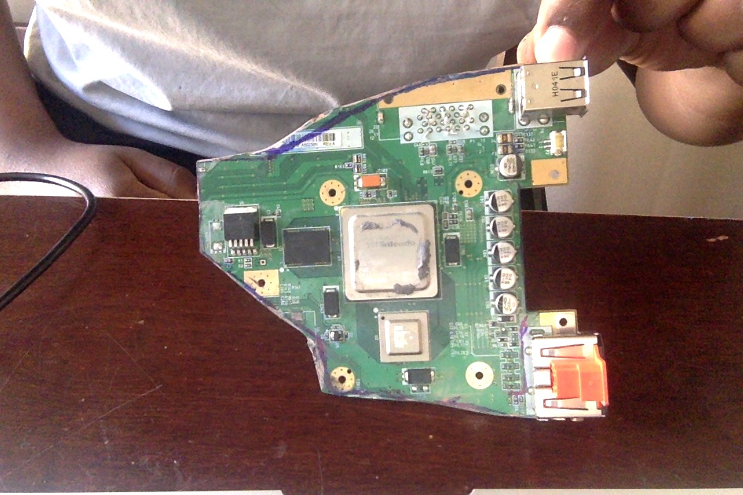

FInished my trim today. Gotta sand down a bit but looks good.
Looking good, make sure you have the CPU and GPU covered with masking tape when cutting and sanding, otherwise small bits of conductive metal can get in under the lid
