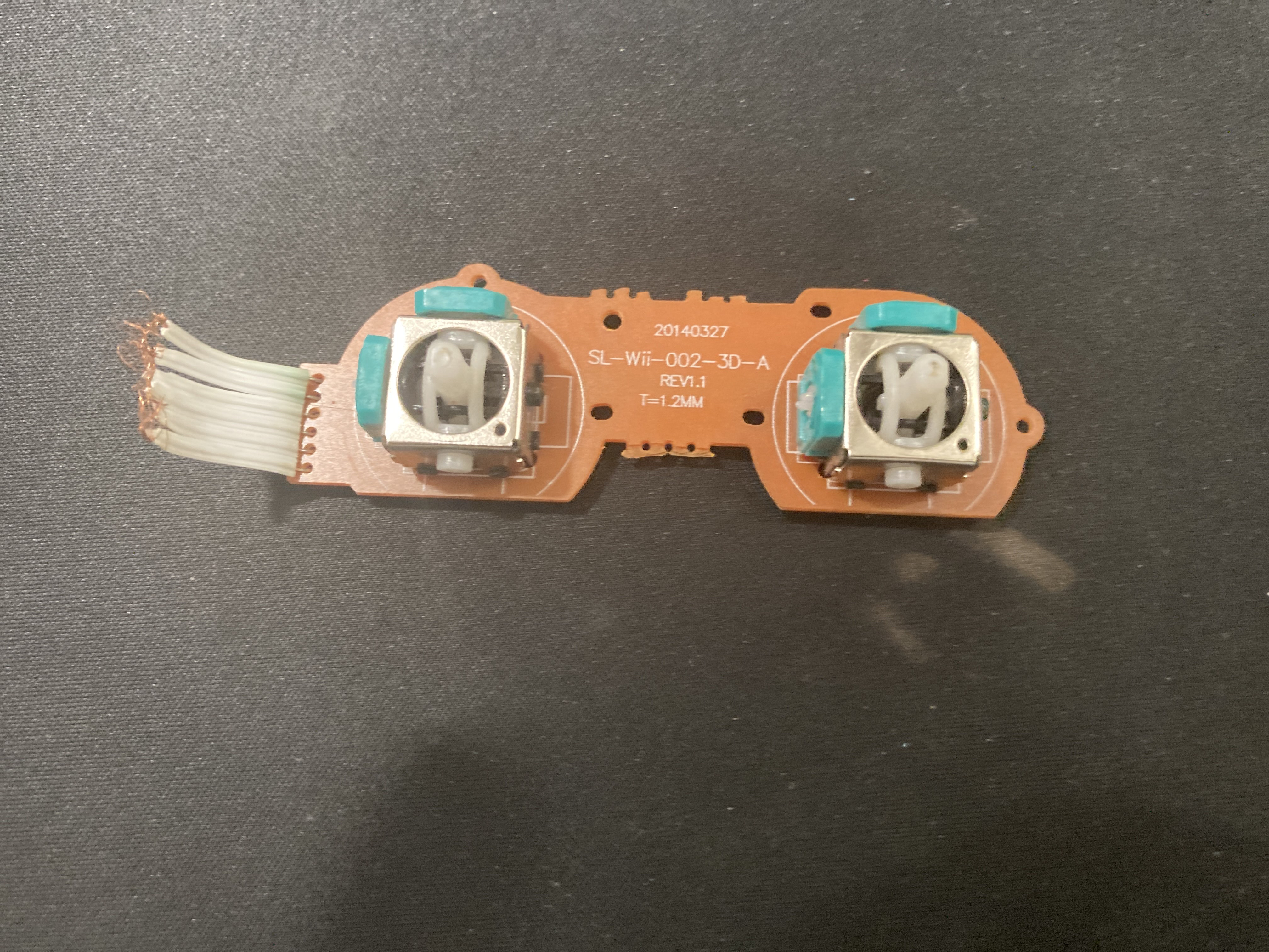

A couple questions I have are will these stickboxes from a knockoff classic controller work?

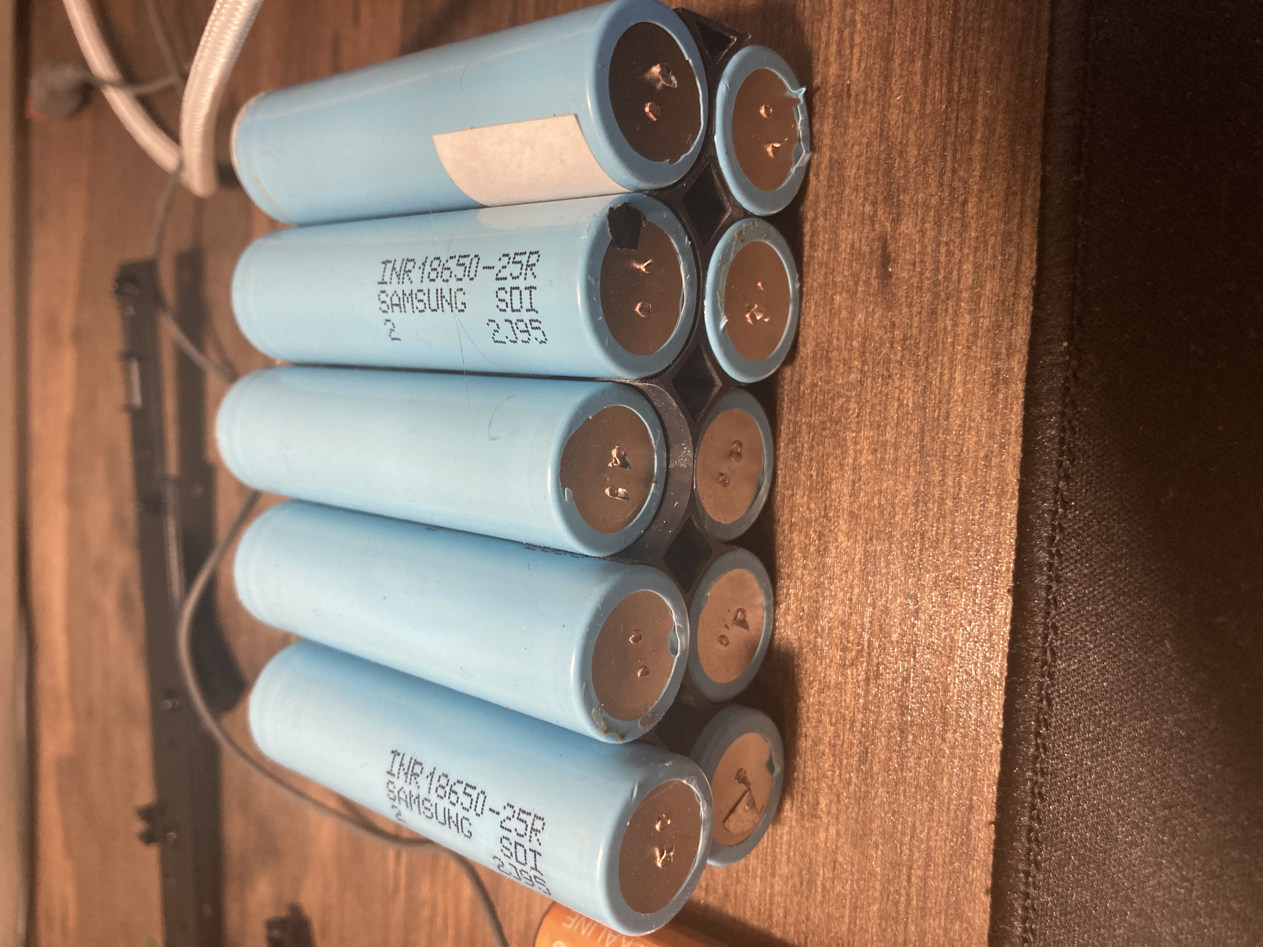

Another thing is I already have 10 18650 batteries from a ryobi battery, and is it worth the battery life to buy the bigger cells?

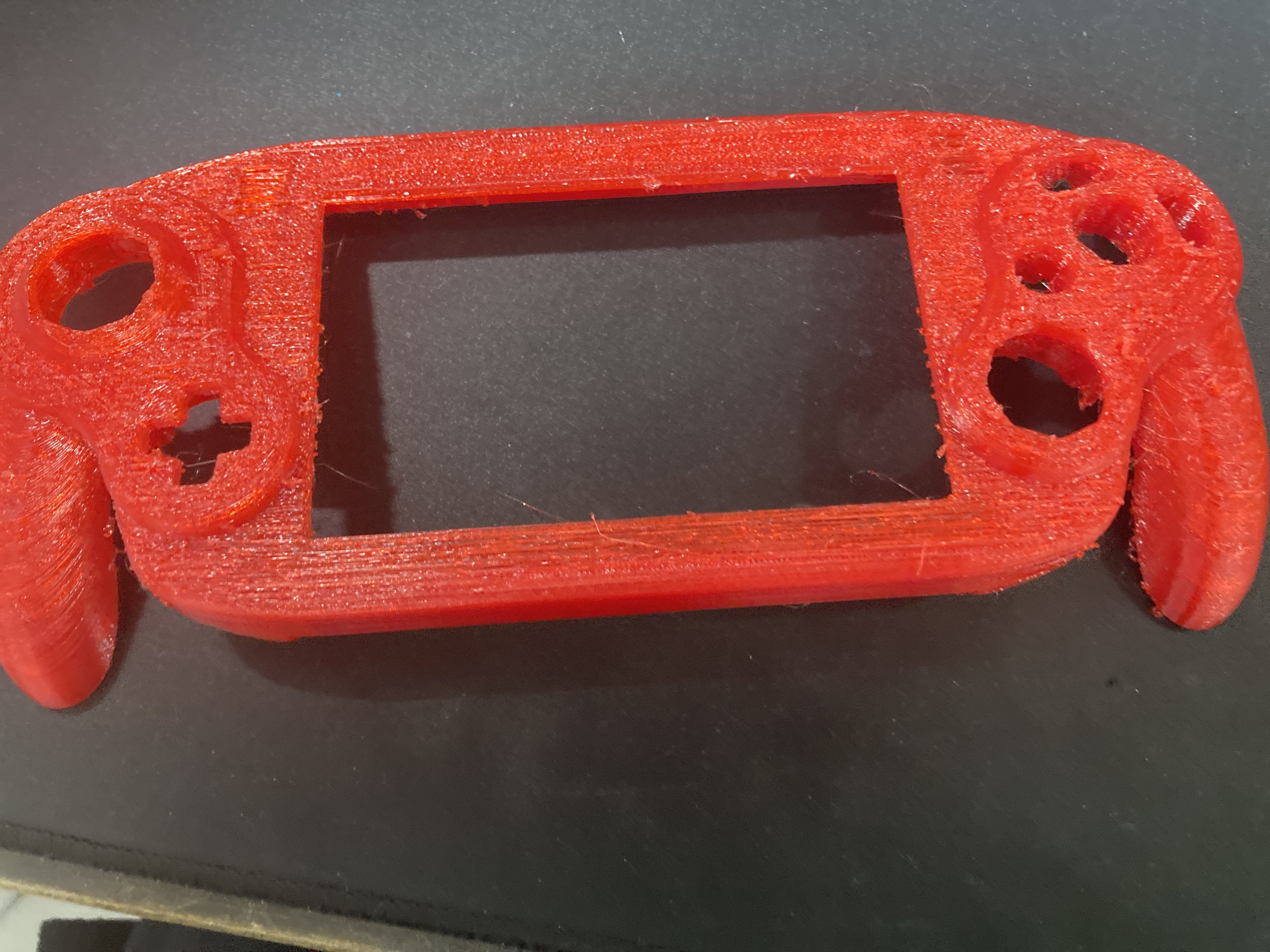

First try at a case print with PETG (went terribly):

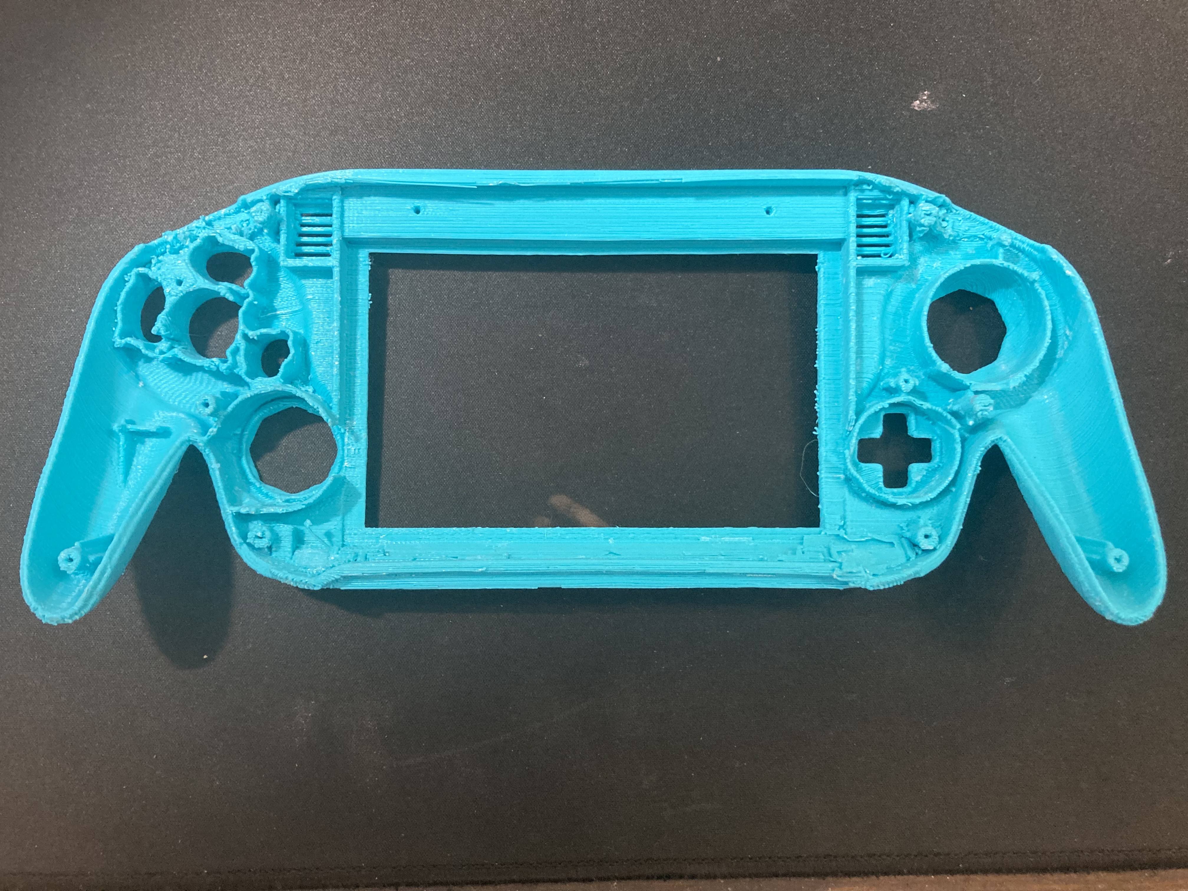

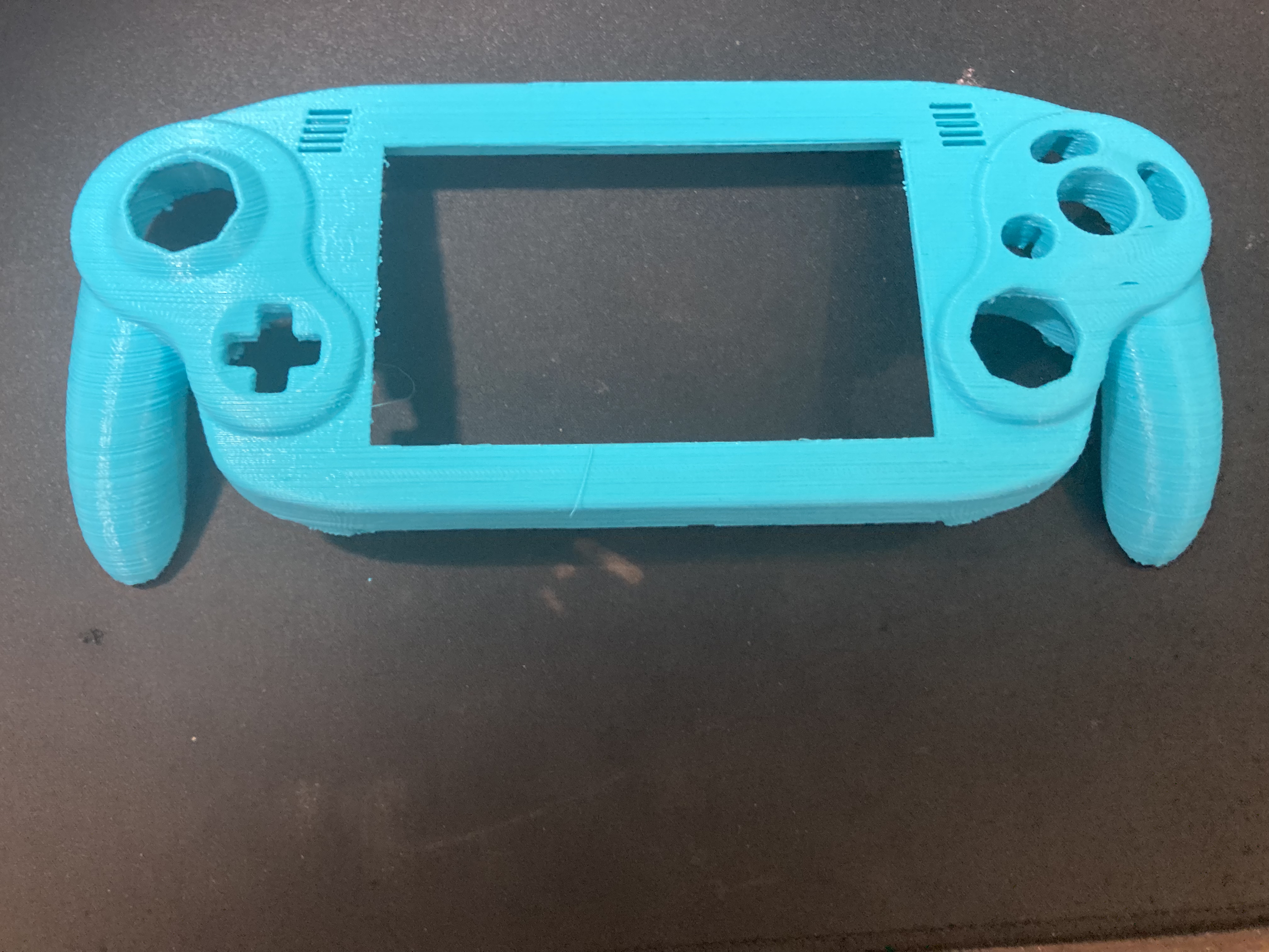

Case with PLA after a few tries and some tuning. (Before I print the rest of the case I am going to tune some more, and I have much sanding and clean up to do)
I broke the circle around the D-Pad while removing supports, but I think it should be fixable?

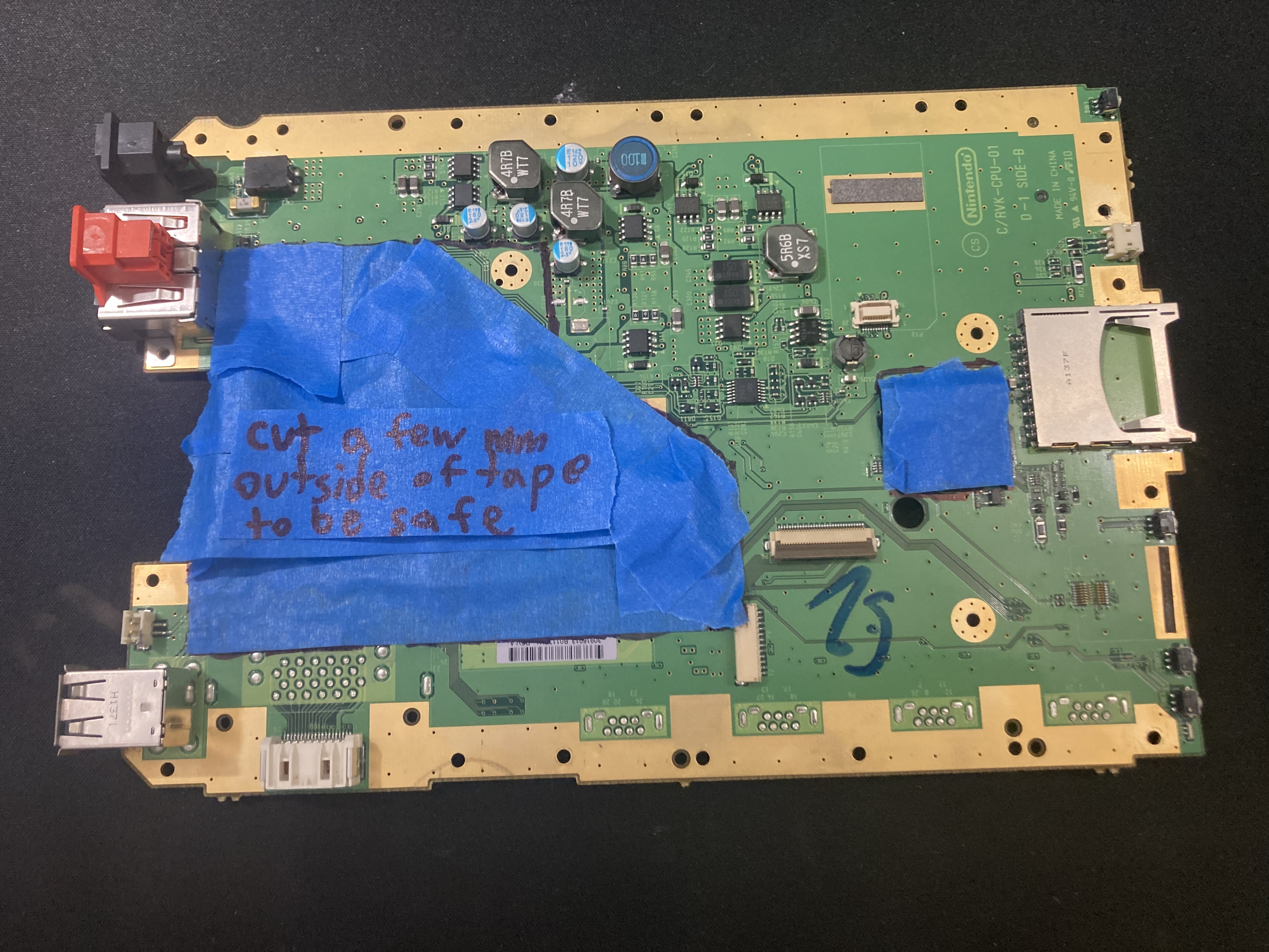

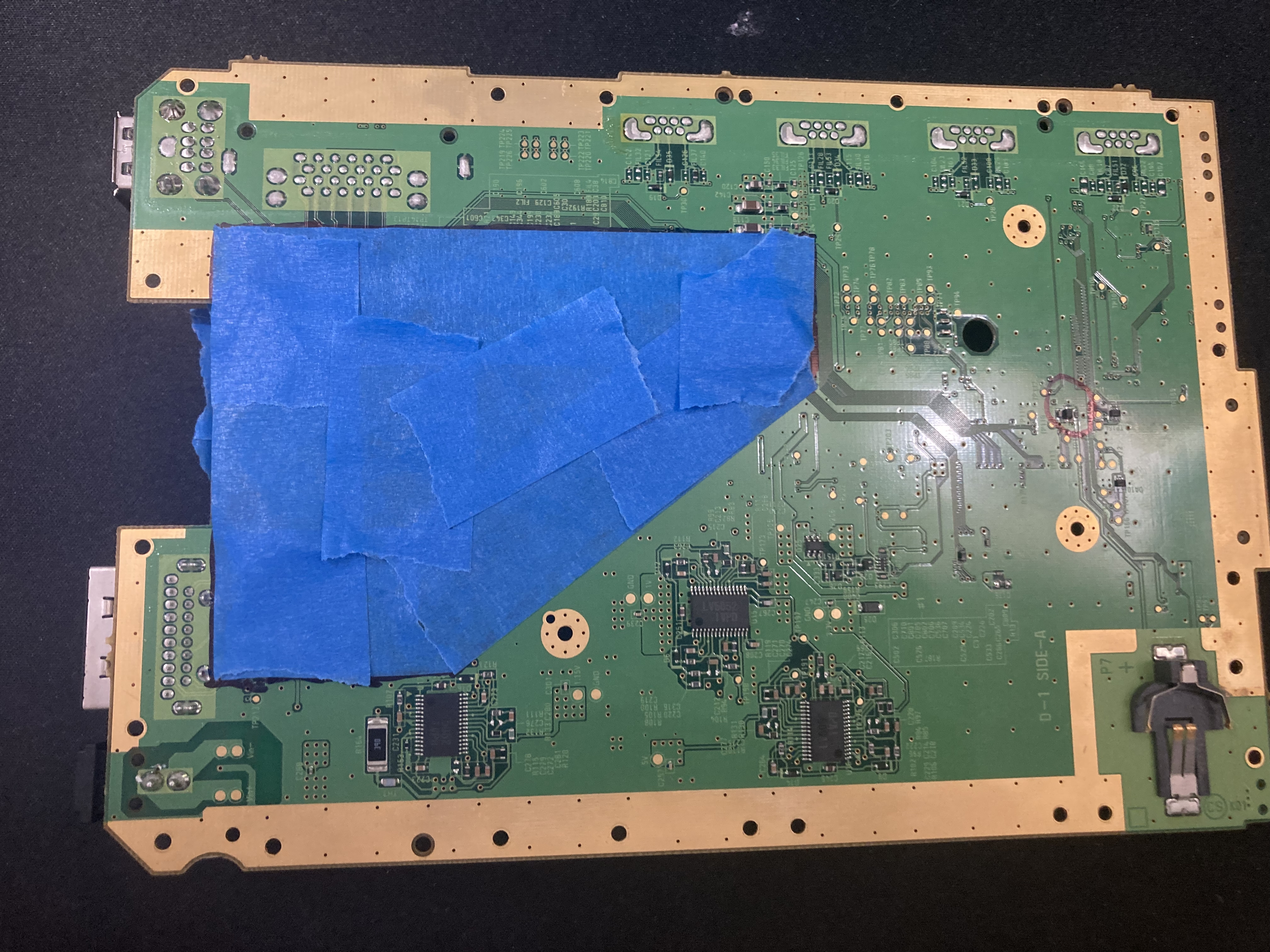

Lastly here are my trim lines:
The sticks will work, but they probably won't be the best feeling
Ah okay, I might just buy official stick boxes, official buttons, and the bigger cells. I don’t want it to feel cheap.
You'll thank yourself. Also the Ashida case is designed for 21700 cells, not 18650s. 18650s will not properly fit in the holders
My plan was to 3d print an adapter to fit the 18650s, but I think I'll just save myself the trouble and get the bigger cells.
