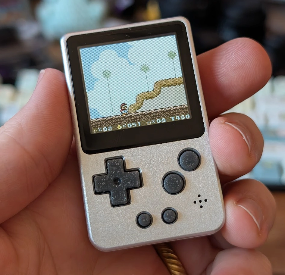

Hey all! I'm back for a second year, and intend to finish this time -- as a matter of fact, I've already made it farther than last year by posting a thread.
Setting the Stage

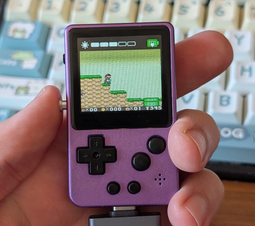

You may know me from my prior projects where I made custom form factor Game Boy Colors using original hardware:

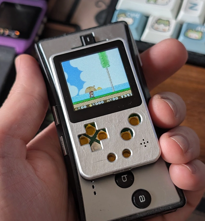

As my GBC mods continue to get smaller, and I approach the minimum possible size with the TFC, I think it's time to round out my ever shrinking amphibian themed family with the smallest practically usable GBC I can imagine. And so, I'm Introducing the Egg Boy Color: the answer to the question, "what if Benjamin Button, but Game Boy?"

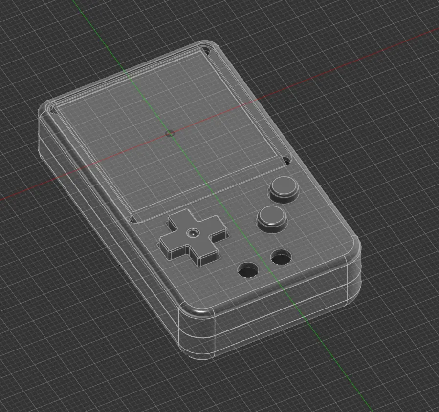

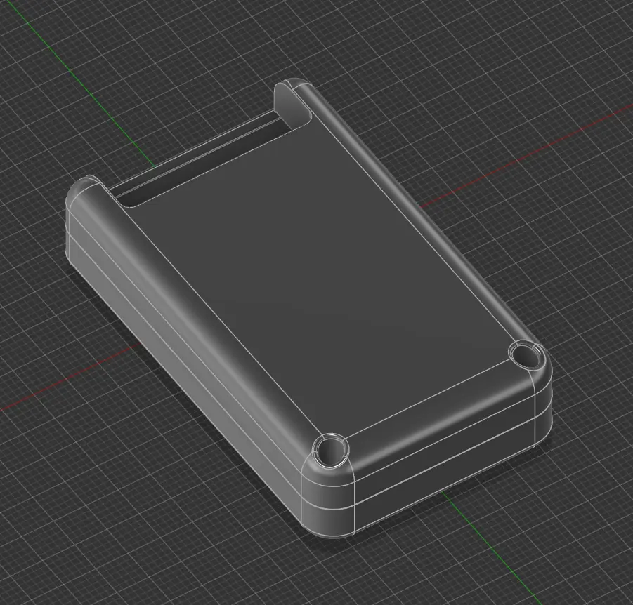

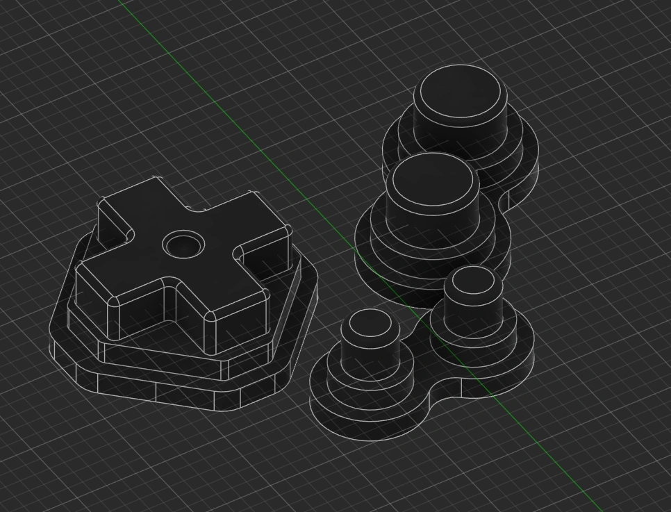

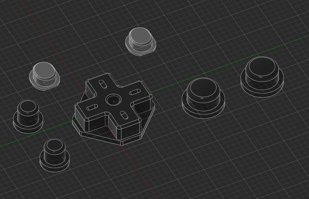

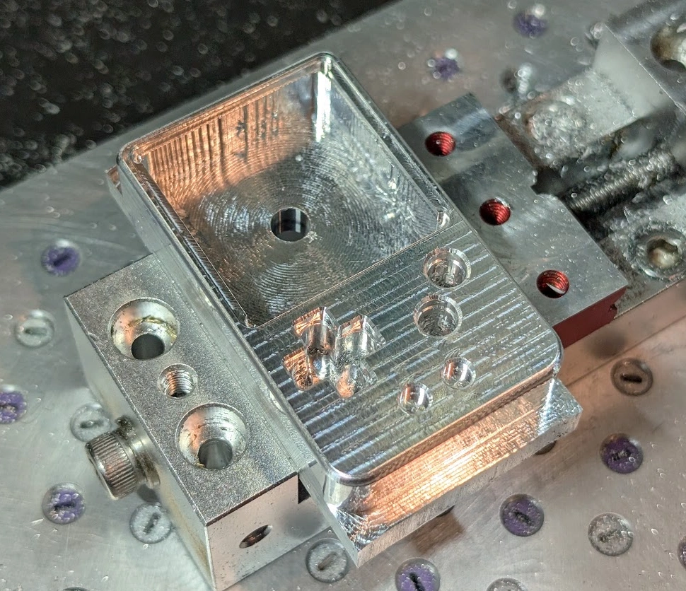

5/23/2026

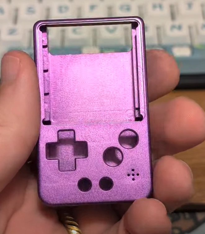

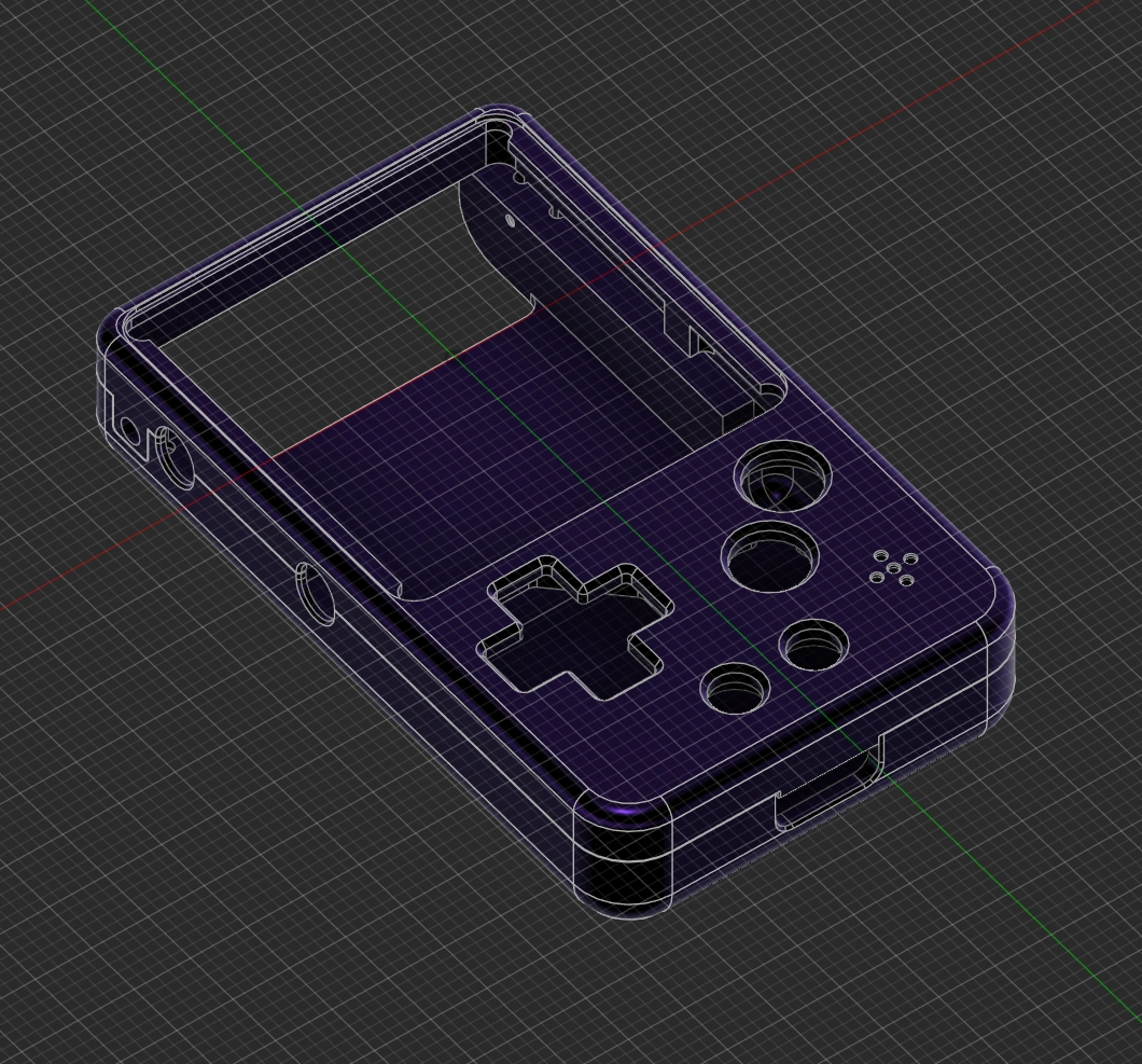

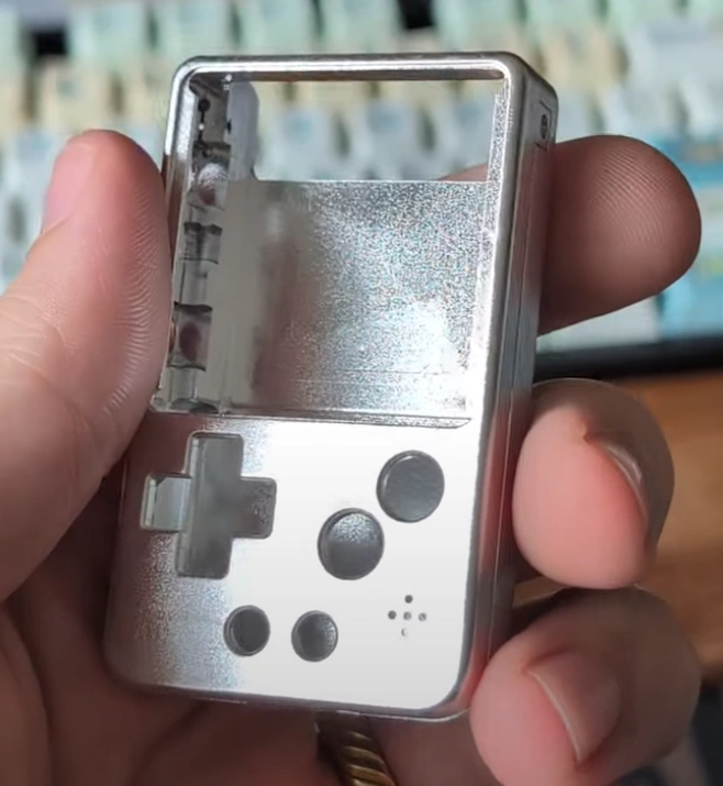

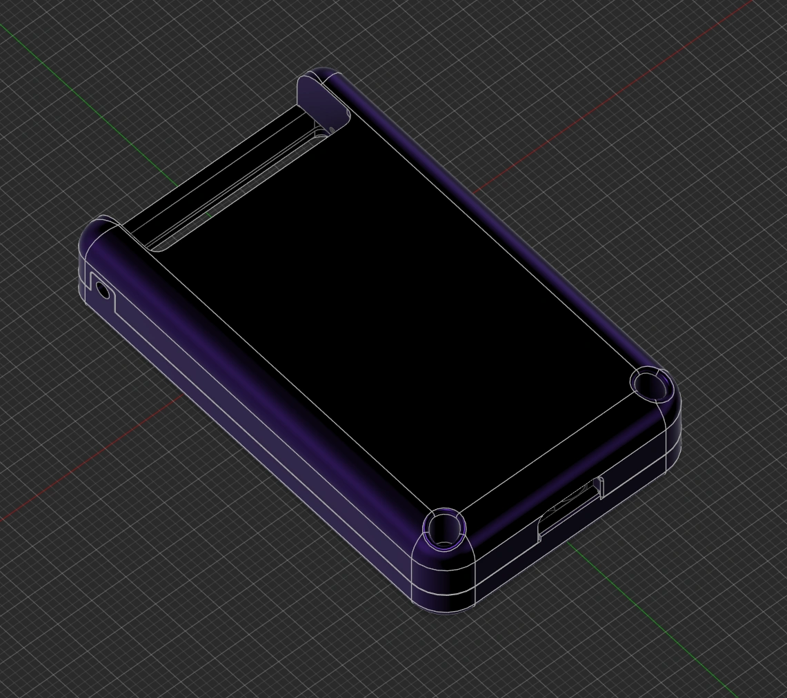

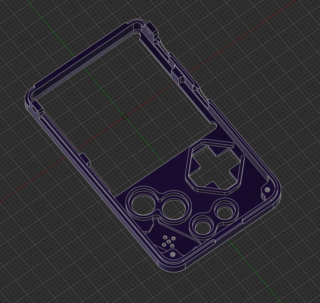

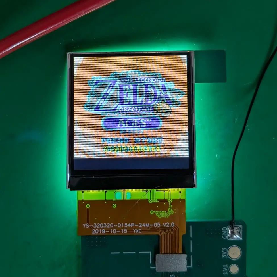

Project kickoff! Started working on the main shell design, both front and back. Front shell is designed around a 1.54" 320x320 IPS screen so I can get a clean 2x upscale on the GBC video.

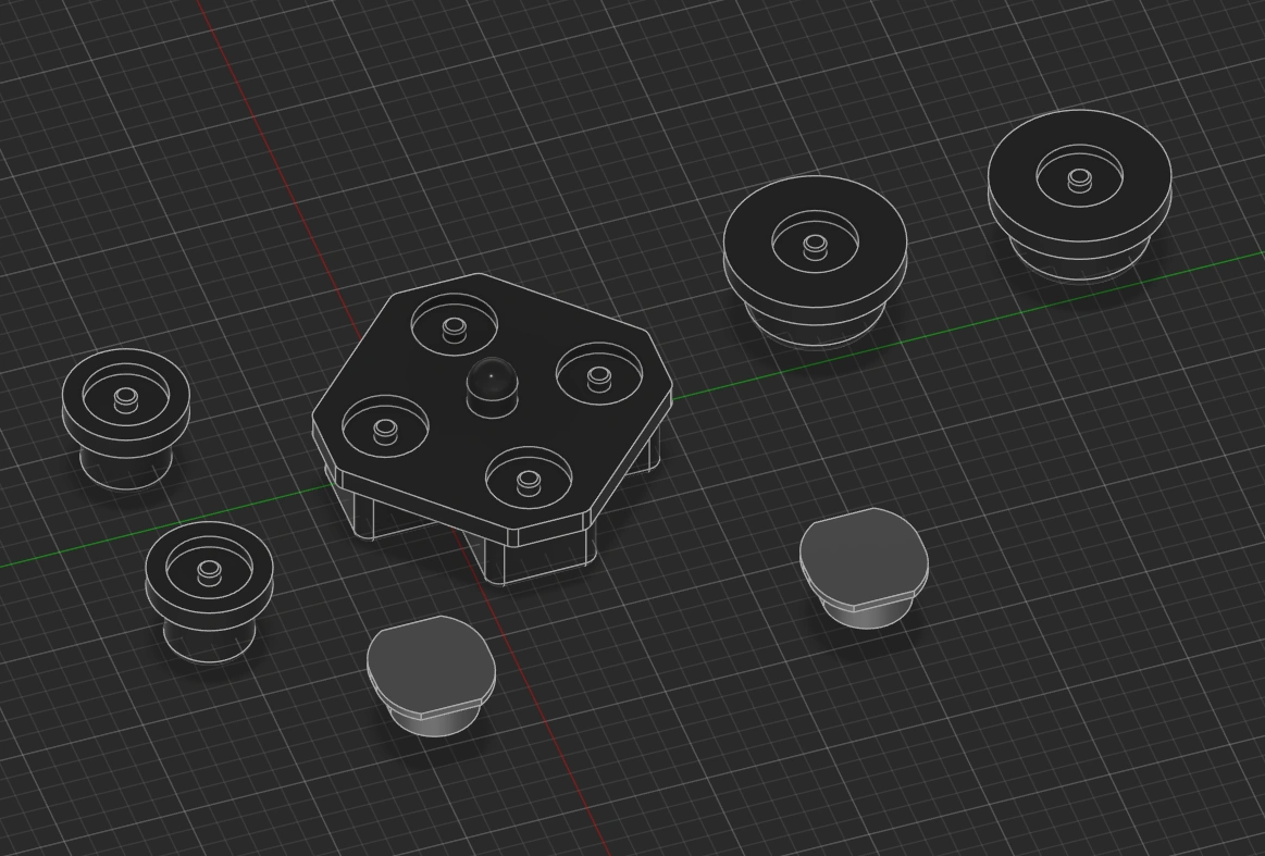

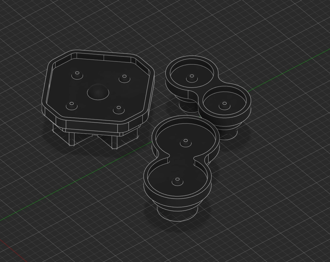

- Custom tiny buttons

5/23/2026
