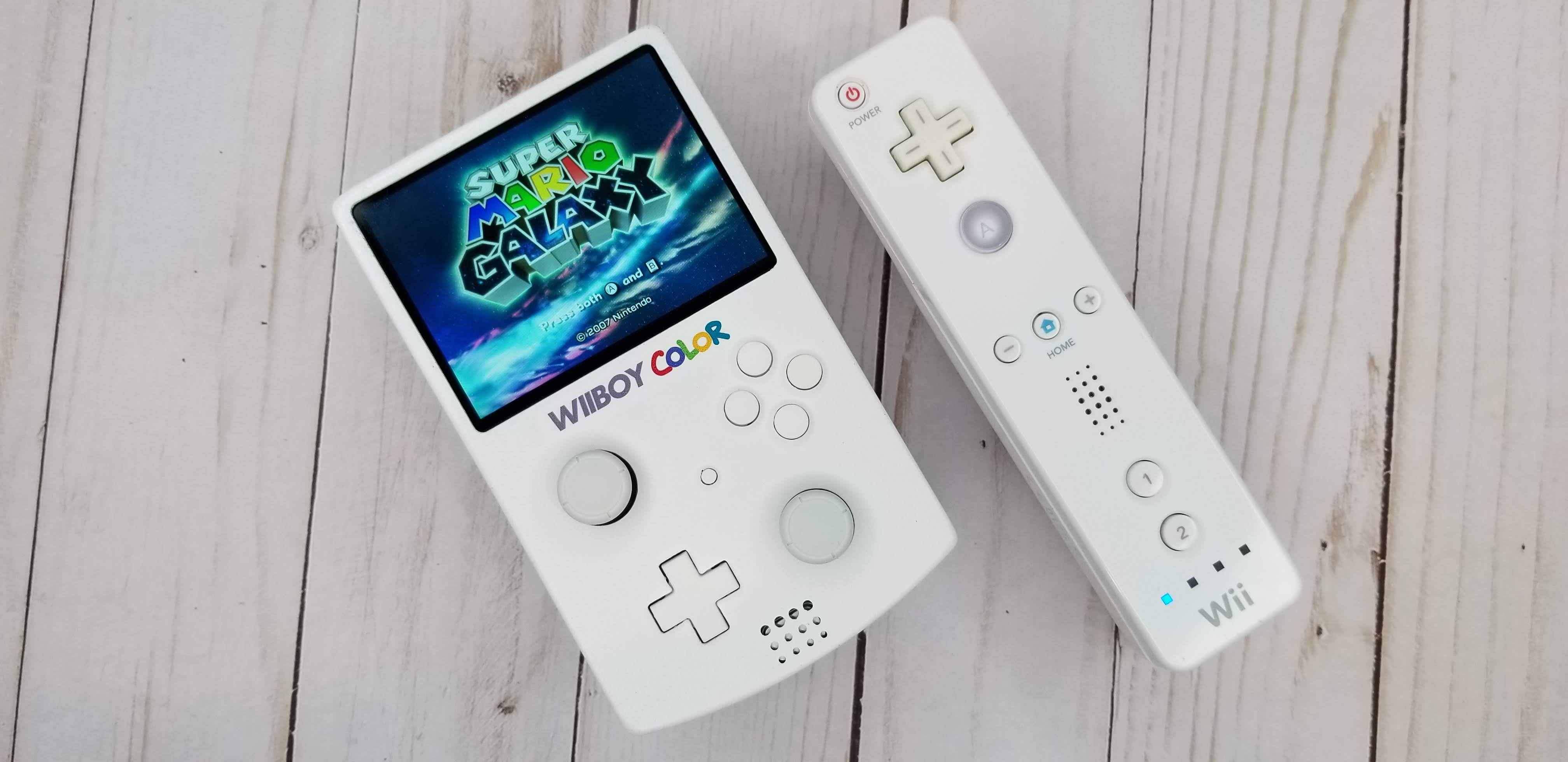

This is the Wiiboy Color.
It's a project I started way back in January, and have been working on it on and off ever since. It's my official entry into the 2020 Summer Building Contest.

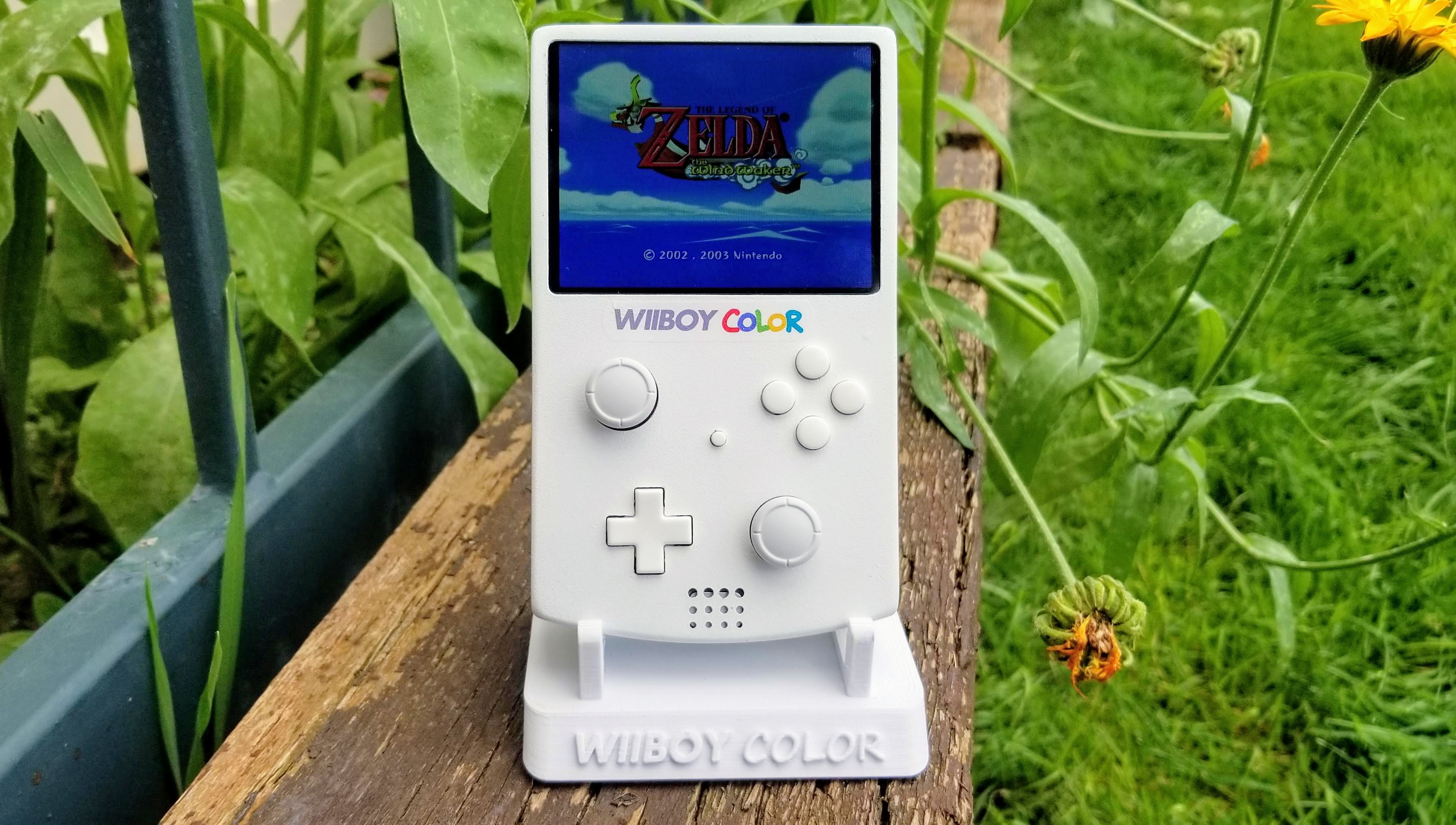

Features include:
  • 3.5" IPS 4:3 480p screen. Far and away the best screen I've ever put in a portable.
  • Custom molded Nintendo DS Lite buttons and triggers.
  • Nintendo Switch Joysticks
  • USB-C PD charging and data transfer
  • Digital audio via a custom U-Amp for headphones and a single speaker
  • BBLoader v1.1
  • GC+ 2.0
  • LMAO v2 trim

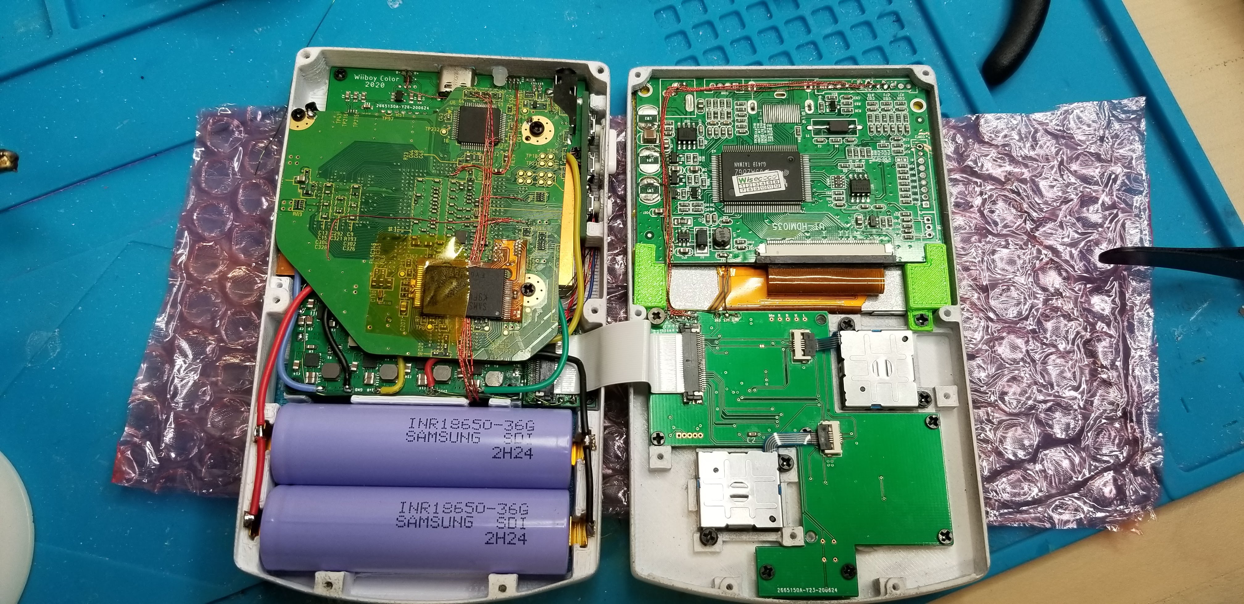

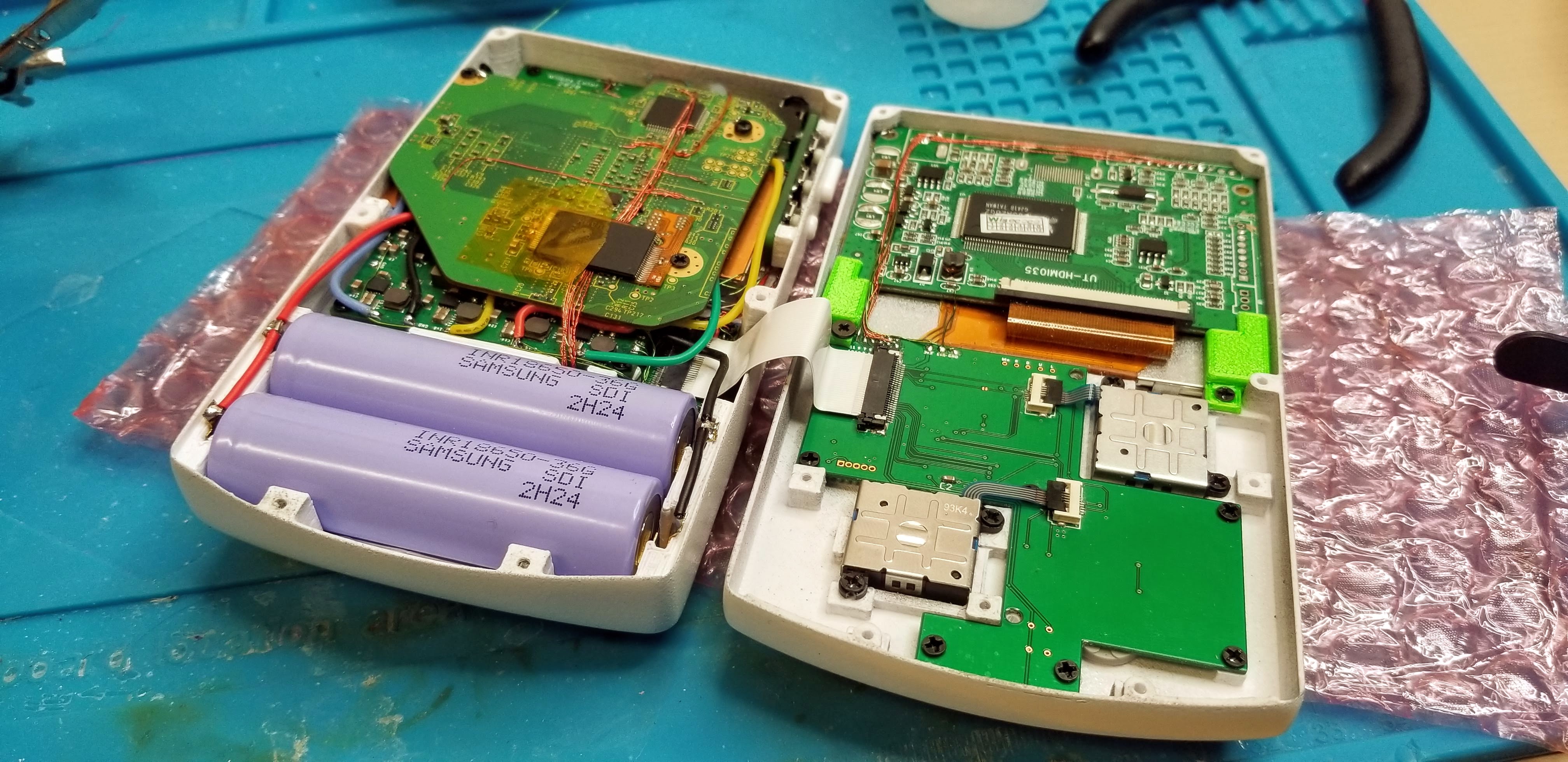

  • A variety of custom circuit boards to keep the internals as orderly as possible.
There are 4 significant custom PCBs inside of the portable. The features of those are as follows:
  • Front Controller Board:
    • Houses all components needed for GC+ 2.0
    • Has pads that fit DS lite rubber pads and the single speaker
    • Has a 30 pin FFC cable that connects to the triggers board. All voltage and data wires that would go between the halves go through this FFC.
  • Triggers Board:
    • Has the other half of the 30 pin FFC assembly.
    • Has spots for dual tact buttons and two Z buttons
    • Has spots for all MX circuitry to be relocated, including the RTC battery cell.
  • Custom PMS Board:
    • All regulators and battery management components
  • Ports Board:
    • Houses the USB-C port, headphone jack, and RGB LED.
    • Houses the USB drive, and handles all USB switching needed for connecting the portable to a computer.
    • Contains all the necessary circuitry for fast charging.
    • Has all U-Amp circuitry for that clear, digital audio.
The final internals ended up looking like this:
View attachment 13781View attachment 13777

Features include:
  • BBLoader v1.1
  • GC+ 2.0
  • LMAO v2 trim
View attachment 13780View attachment 13778
View attachment 13774View attachment 13773
