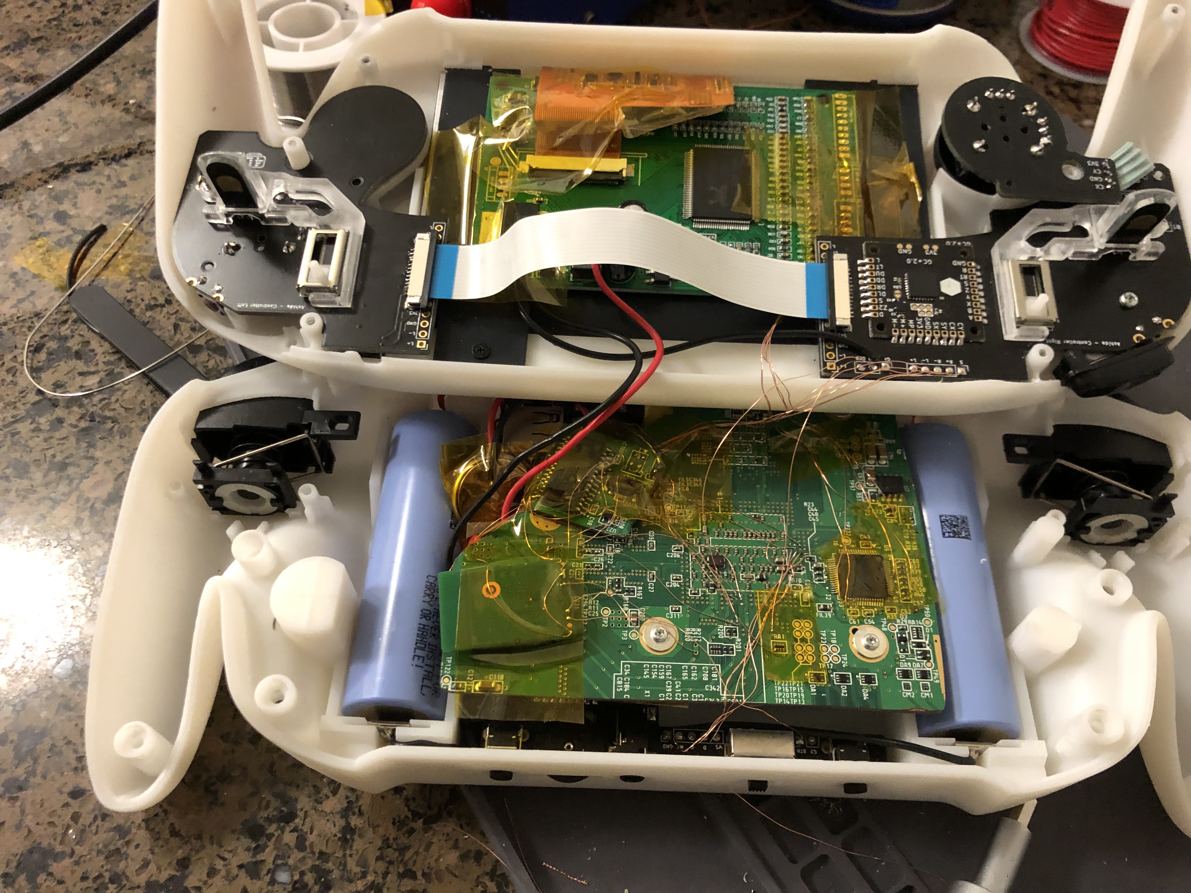

This is beautiful! Do you have a picture of the internals? Also did you twist your wore for the VGA connection? I only see the photo with them straight. Just curious!
Great job my dude!
Great job my dude!
Thanks @CalebPikmin! I might have a picture of the internals somewhere from a while ago but not anything recent but no I don't think I ever twisted them together because I only have one color of magnet wire I just ran them all close together. I'm not sure if that is supposed to help picture quality or if it only helps for organization (I'm no sparklebear) but everything comes out super clear and pretty on the screen so if it ain't broke...
Yeah I found this one but this was still early on - you can see the MX chip and bluetooth modules were not in very good locations and it still kind of looks like a mess because I was still in the phase of shutting it, making sure things worked, opening, tweaking, and then repeating.
