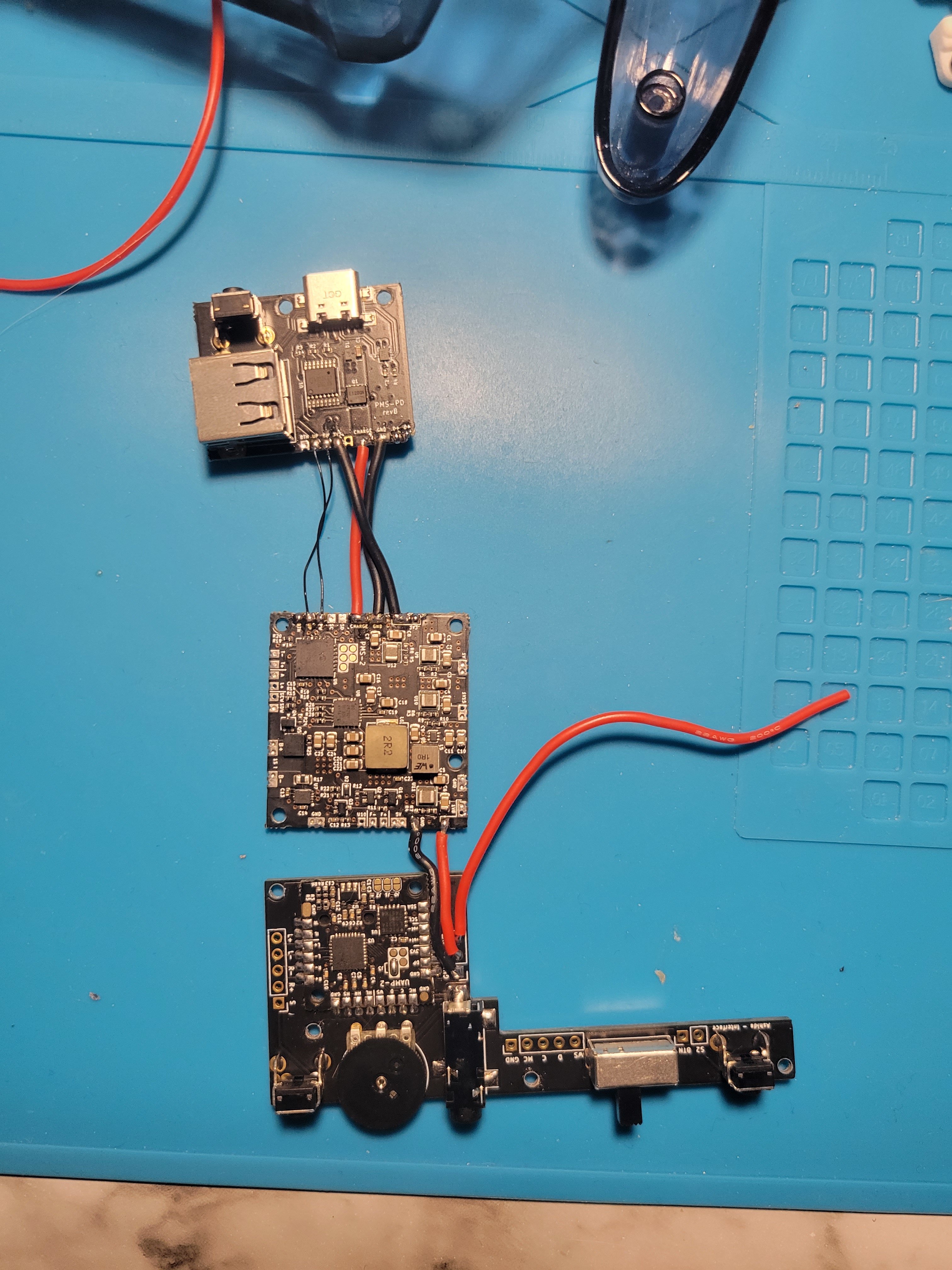

And of course I cant forget the Audio/ power switch/ sync/ start PCB lol
Funny story about this one is I was clearly too excited when opening everything that I missed that the headphone jack was loose in the bag my 4-Layer order was in. I promptly threw everything into the recycle bin outside and didn't think about it for the night until i went to assemble this PBC. Luckily recycling didn't get taken and I found it in the bag. after soldering that on and cleaning everything up with some IPA and a toothbrush, Ill be satisfied.

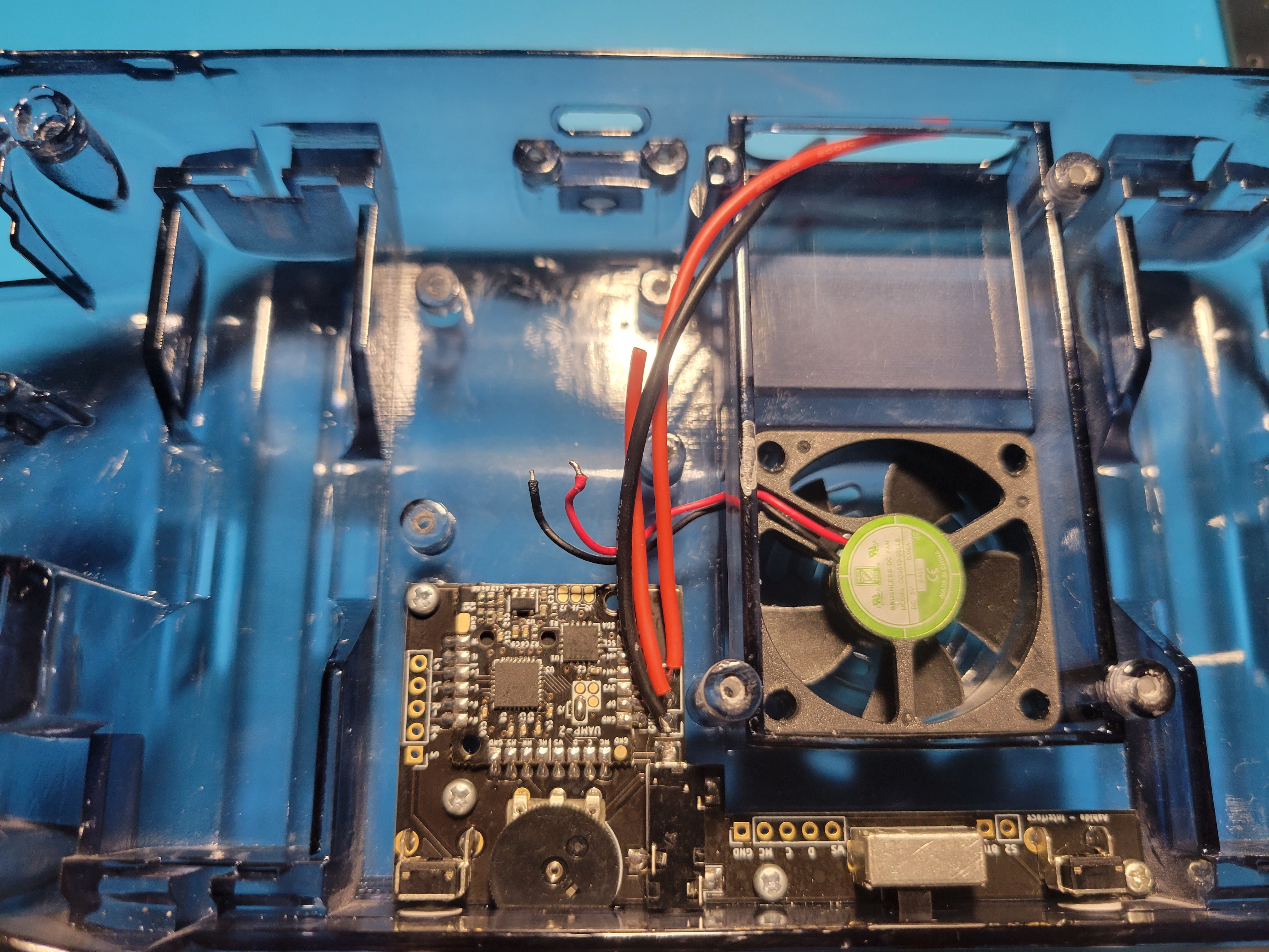

In the meantime I did get a little impatient (as always) and installed all the components I had into the case I have now to get an idea. Here it is:

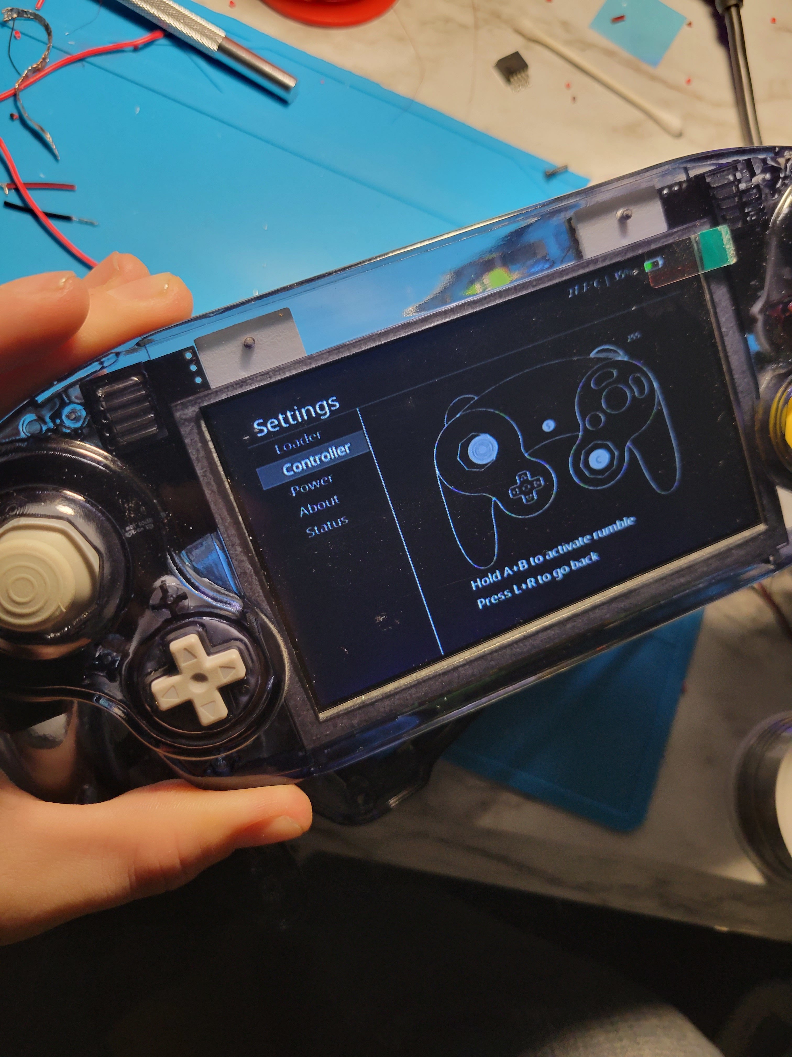

All while doing all of these different hardware changes, I was using the Stick Wizard within RVLoader but nothing was helping. Ultimately I ended up ordering some new ashida PCB's, another GC+, and some 22awg wire that doesn't have dollar store insulation. I disassembled everything and cleaned the case as it seemed it was already collecting some dust (I dont have a very good work station right now). So once everything comes in, I will be restarting the build and taking my time when wiring to be sure everything is clean, done properly, and just damn sexy as I need to do this expensive ass case some justice.

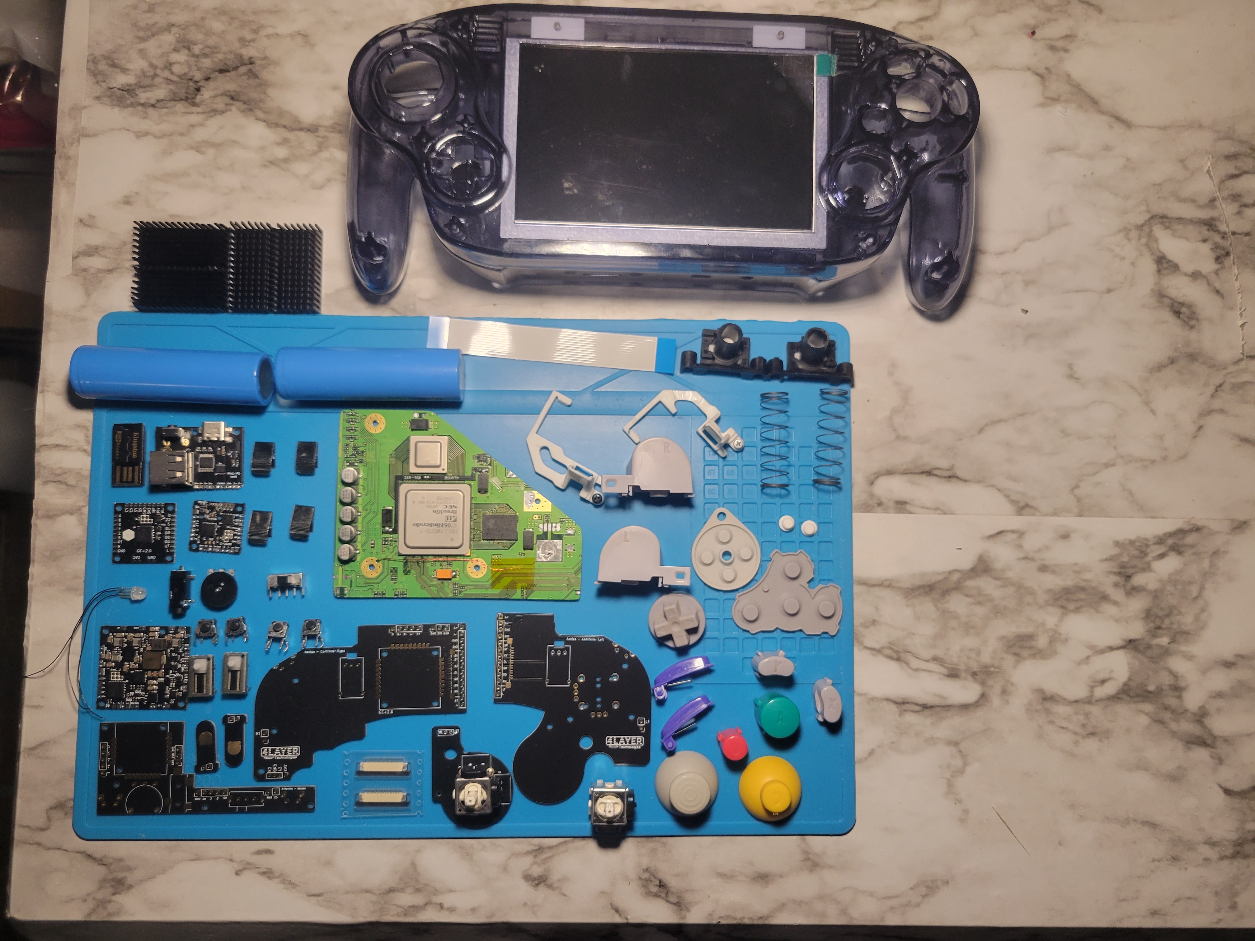

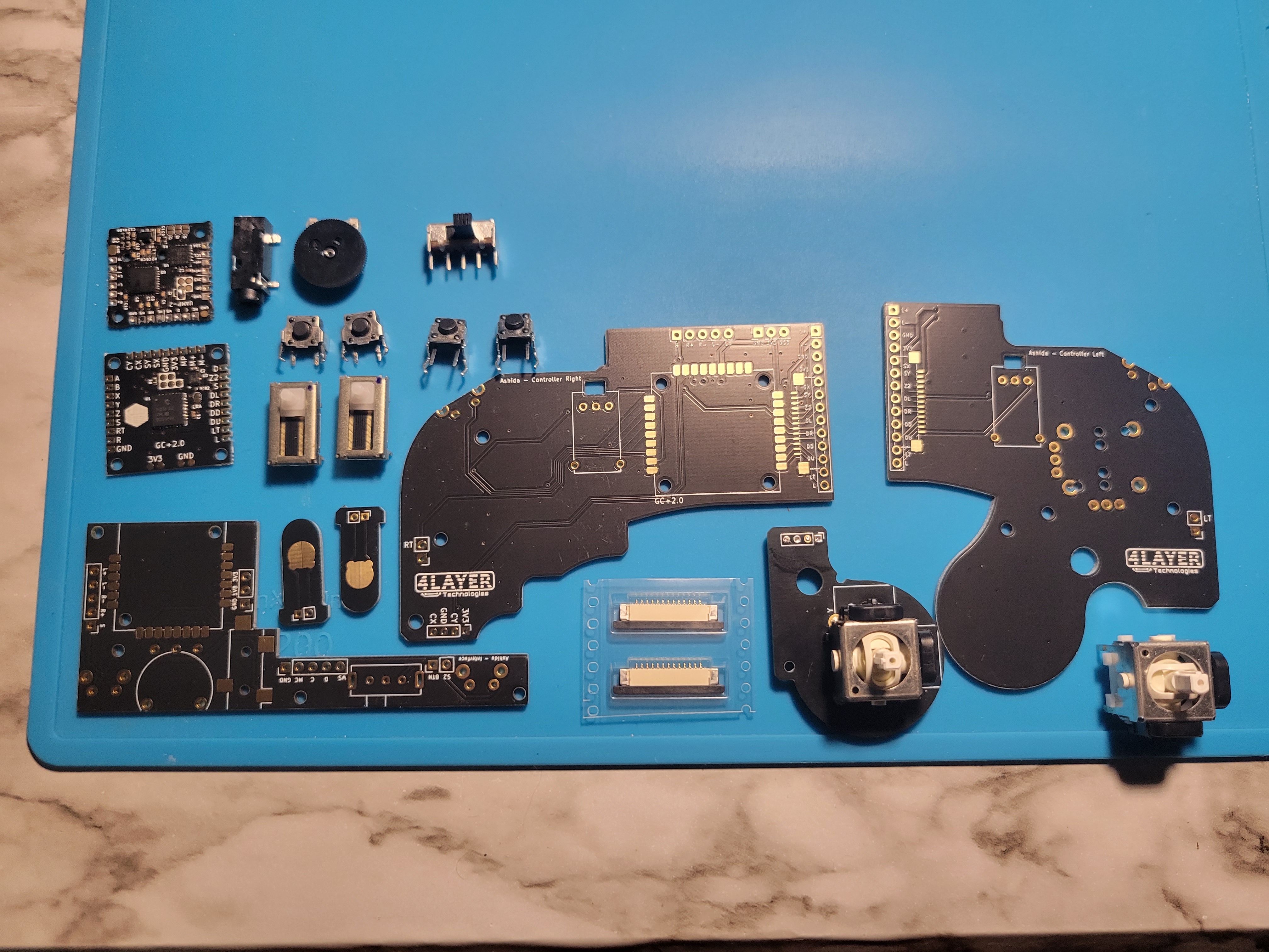

I had got my GC+, and Ashida PCB's in and had everything disassembled so I figured Id get a good snap of all of the parts.

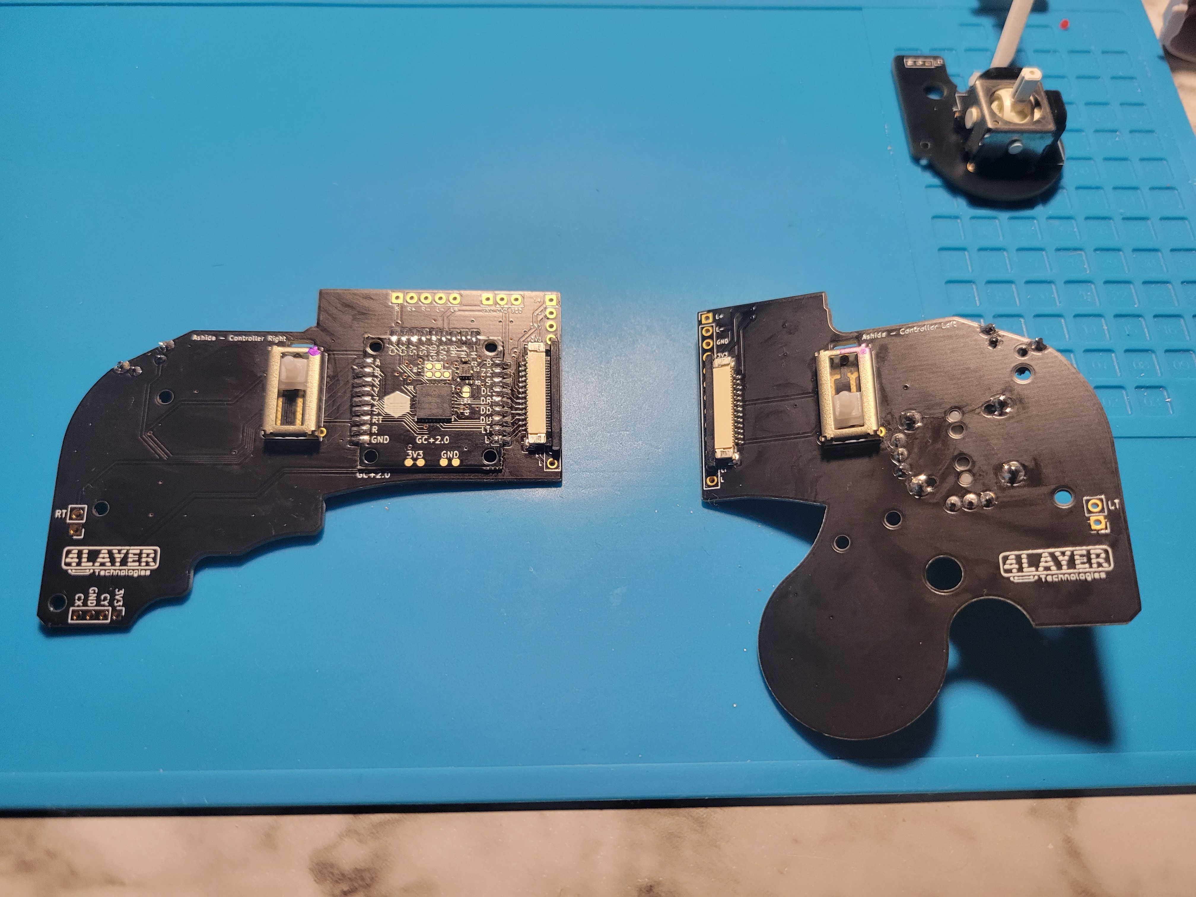

First thing I started on was the controller PCB's and Interface board.
The C-Stick from the first set of PCB's had no issues so I figured Id use it again with this set. I did end up figuring out that most (if not all) first party Wii controllers etc. have the same stick boxes as the GameCube controller, but just virtually newer, so I peeled open a nun-chuck and found a perfect box to use as my stick replacement. I didnt get a lot of good shots of the PCB's assembled but here is one at least:

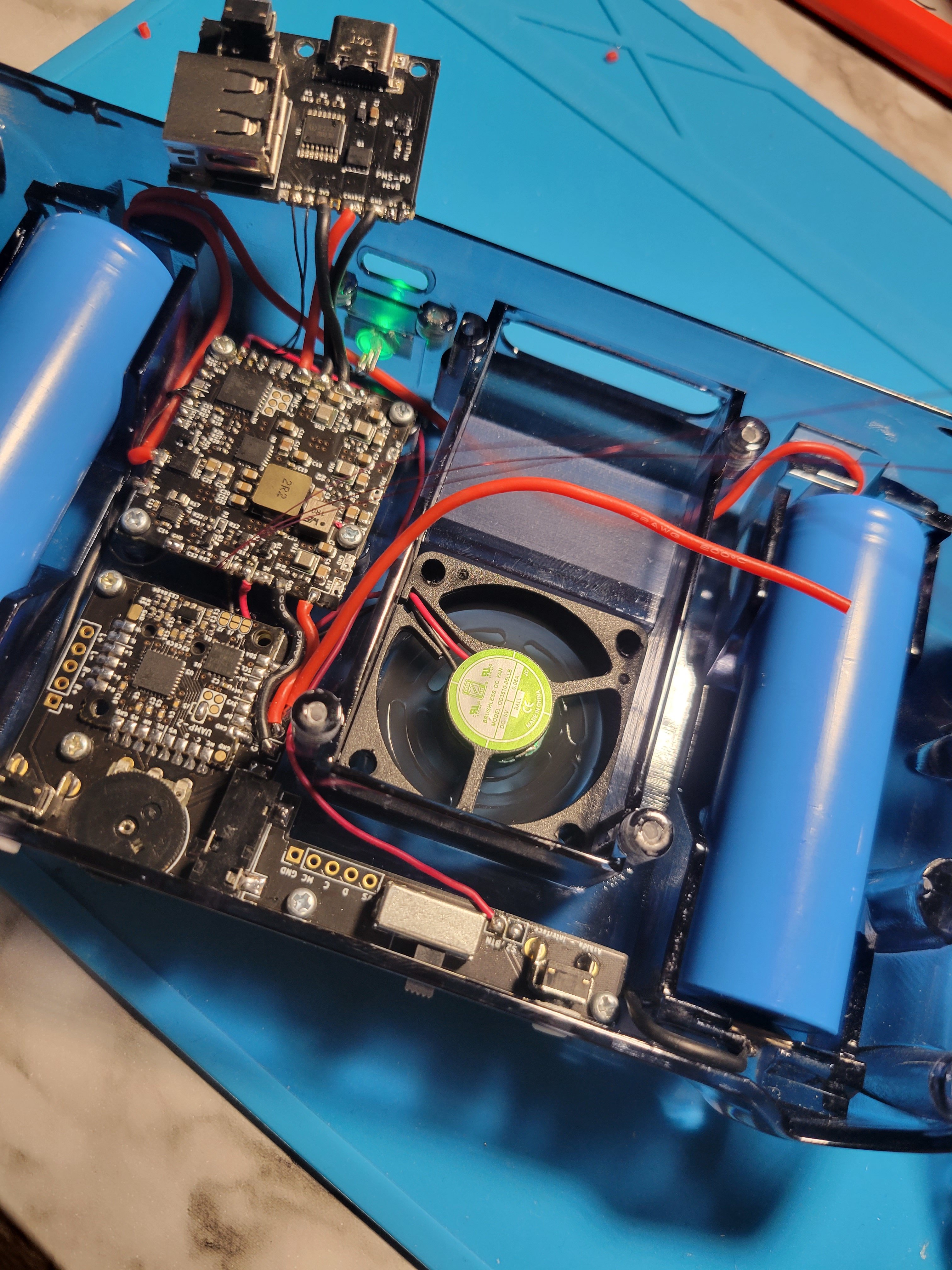

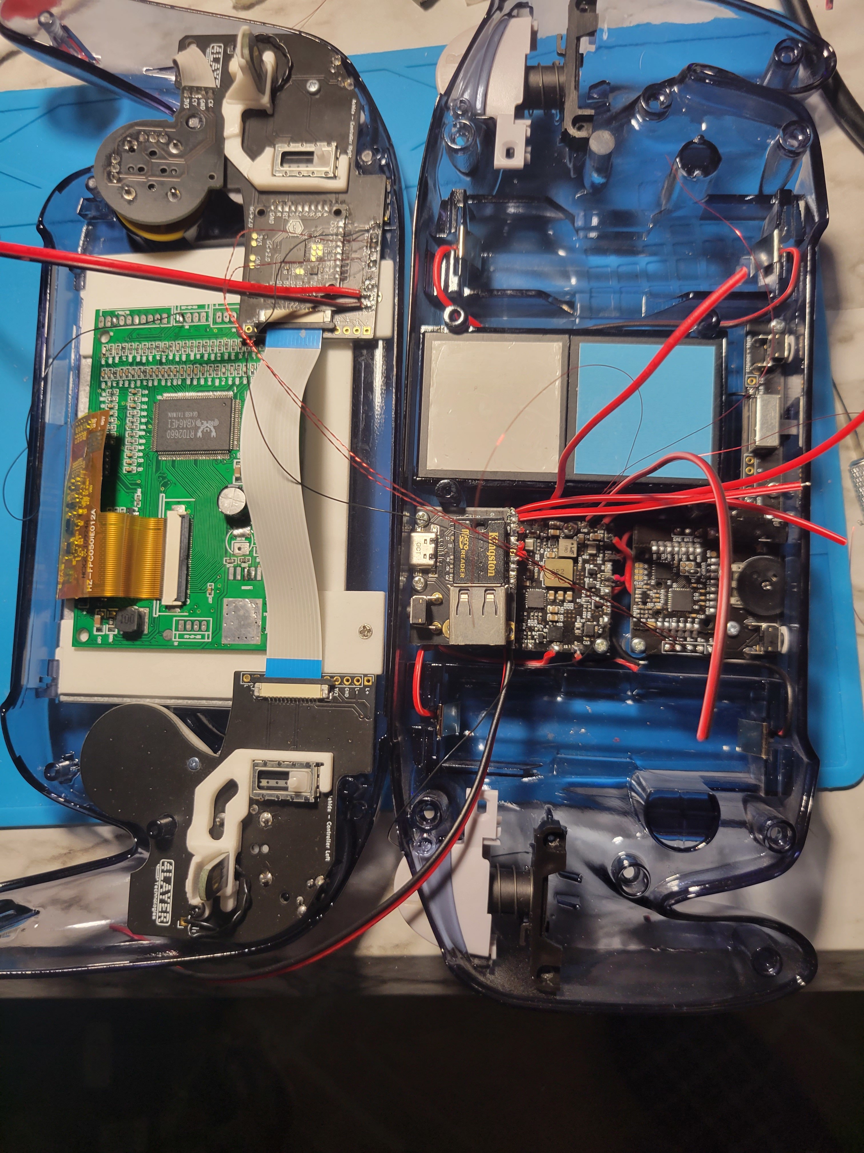

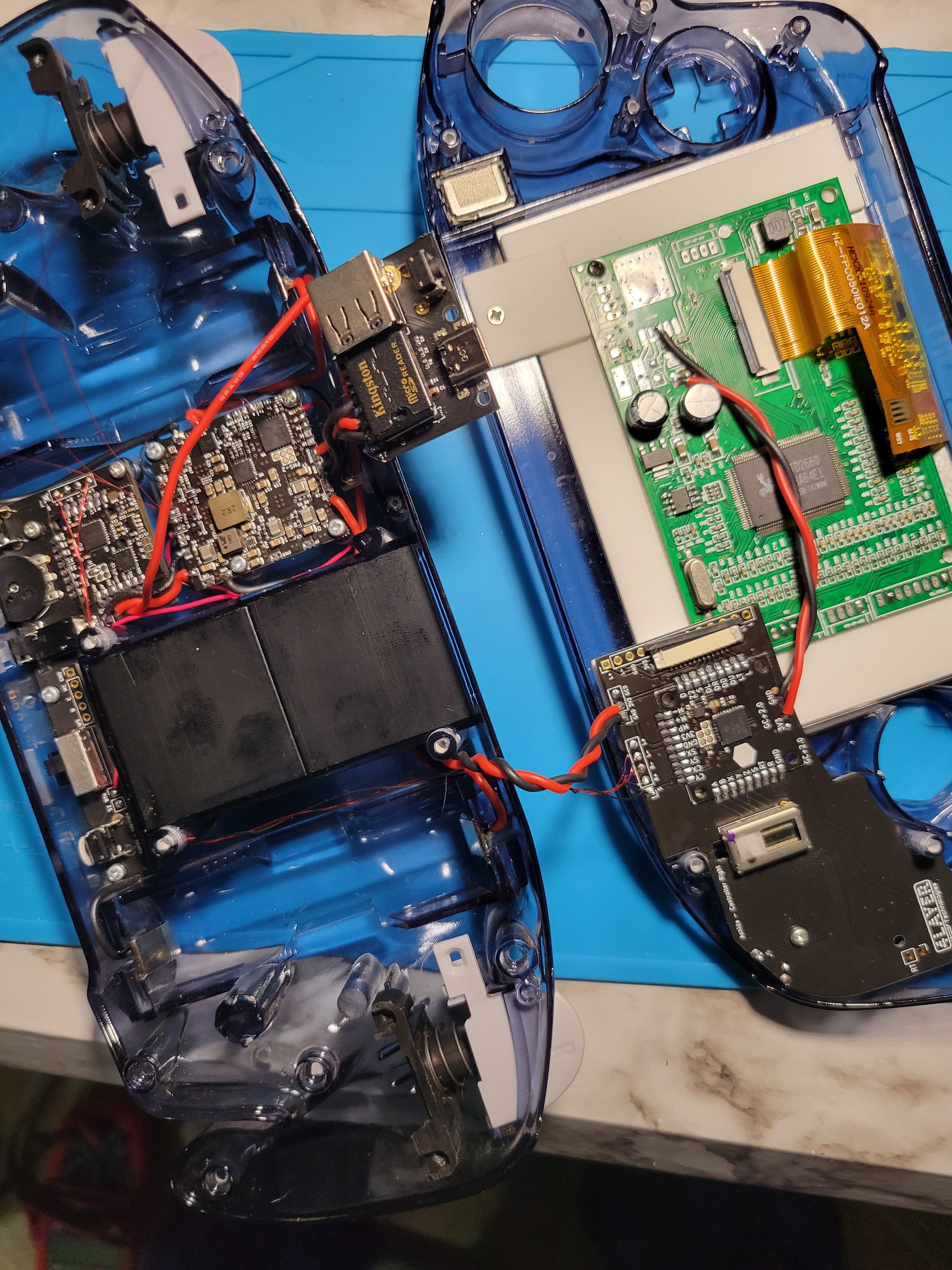

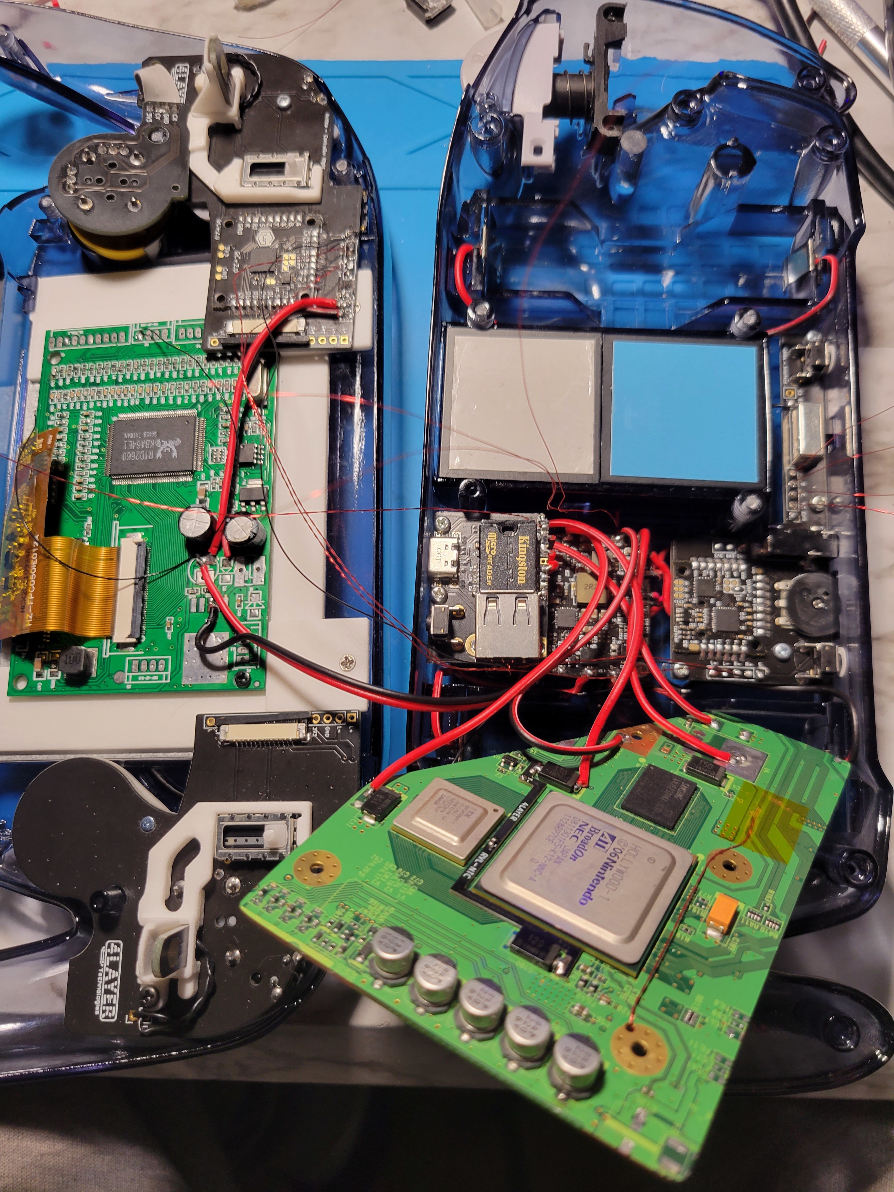

Next was trying to figure out the guts of the system and how I wanted things routed. Note: I feel like this was actually a huge issue for me as I wanted my wire routing to be good enough to look at through the transparent case, so I feel as if my wiring ended up being more spaghetti like in the end due to me trying to keep everything above the interface and PMS boards.
Now I had put this in and took a picture, but what I ended up doing was taking everything out, laying it out, and made sure I got some of the wiring out of the way. I then got my LED and battery clips wired up but opted for the 2 wires connected to the clip as to not have to splice into a wire or try to solder 2 wires to the PMS. I hit the power button and got fan spin as well as lights.

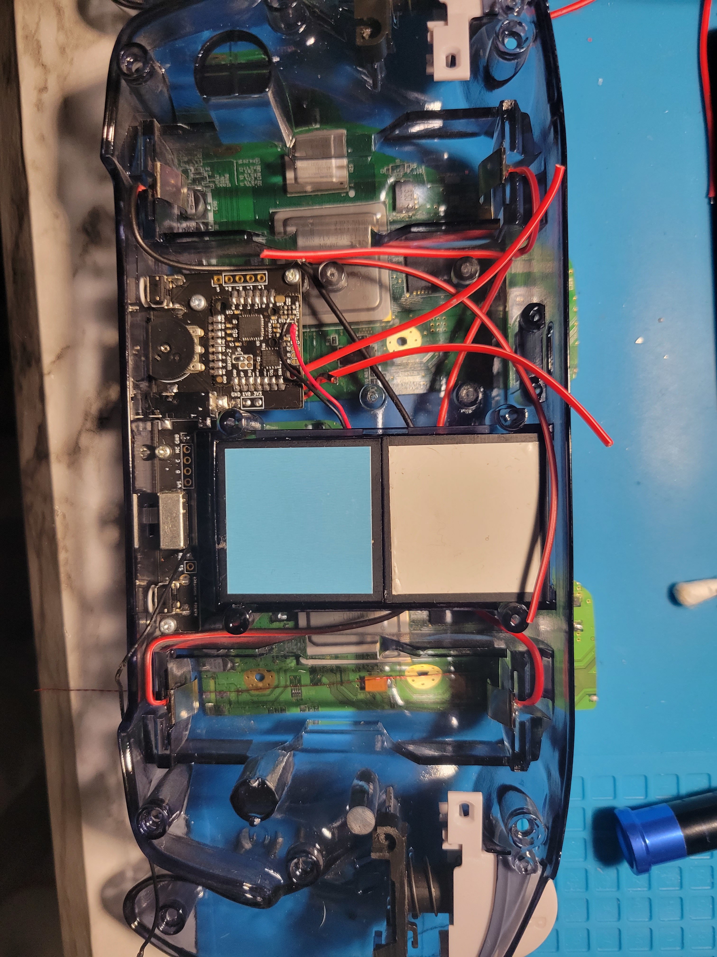

In this next picture I had kind of wired up the top half of the case by running 3V3 and GND under the heatsinks through the passthrough but later changed the wiring from the interface board from magnet to wrapping wire.

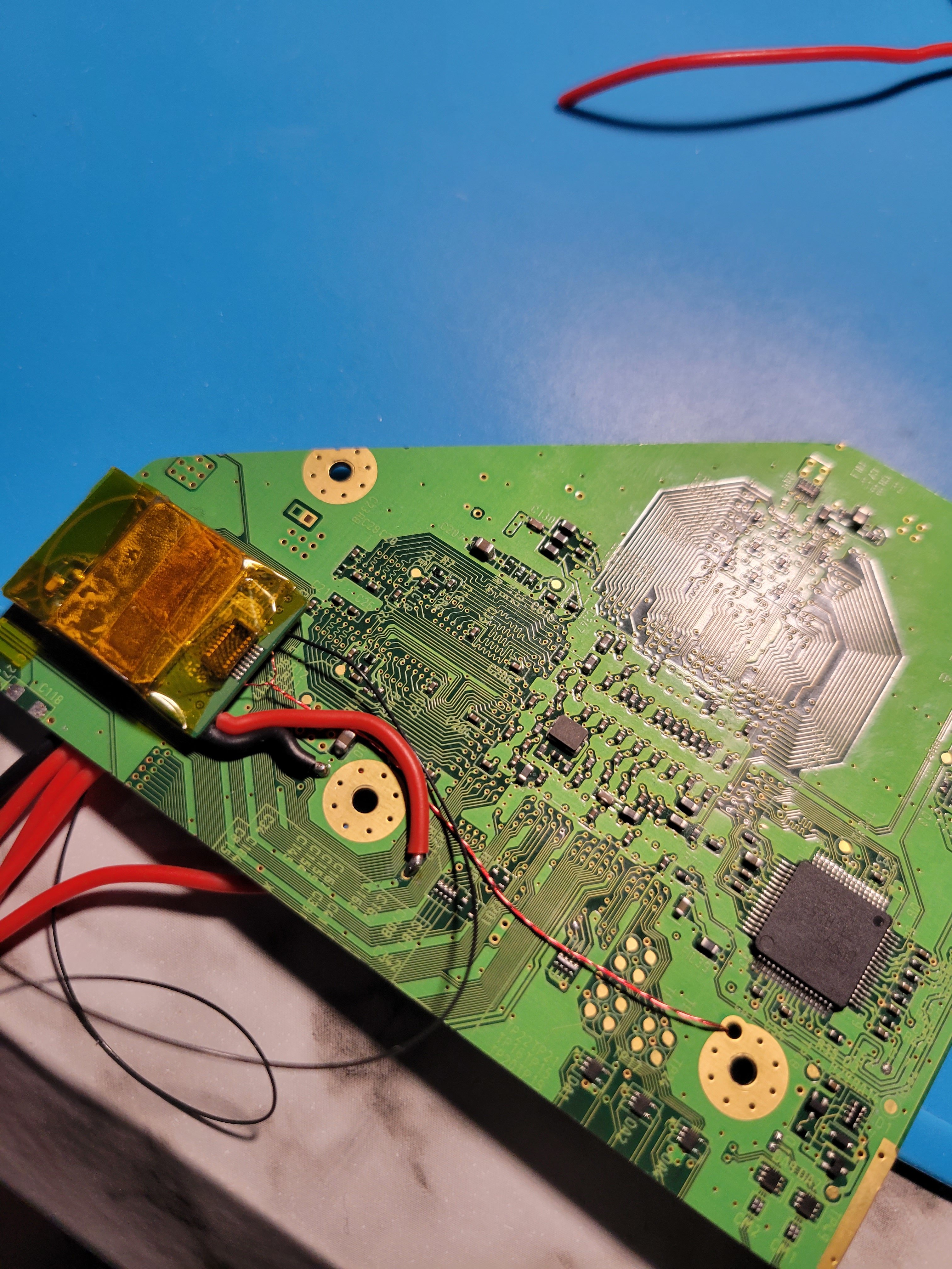

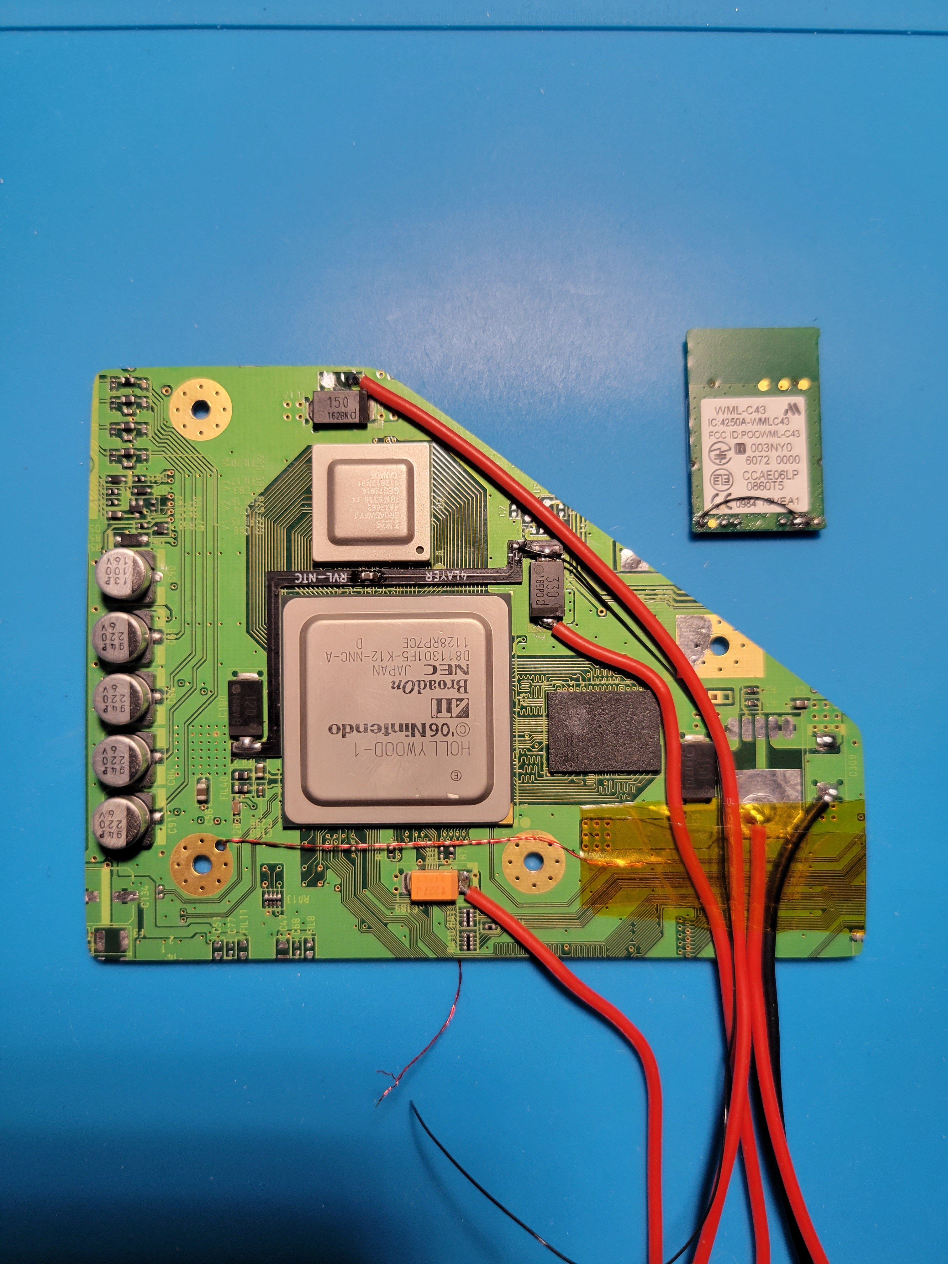

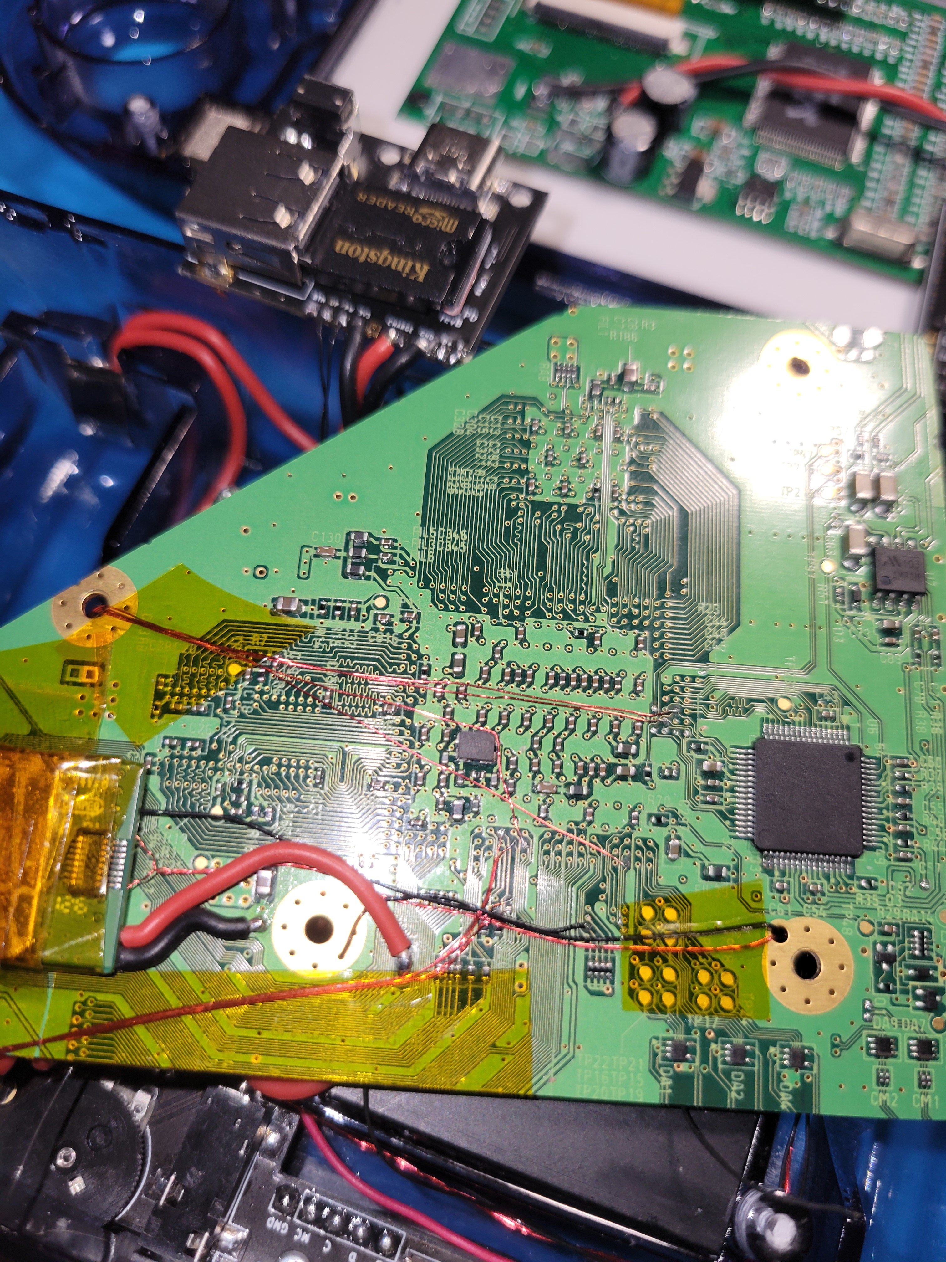

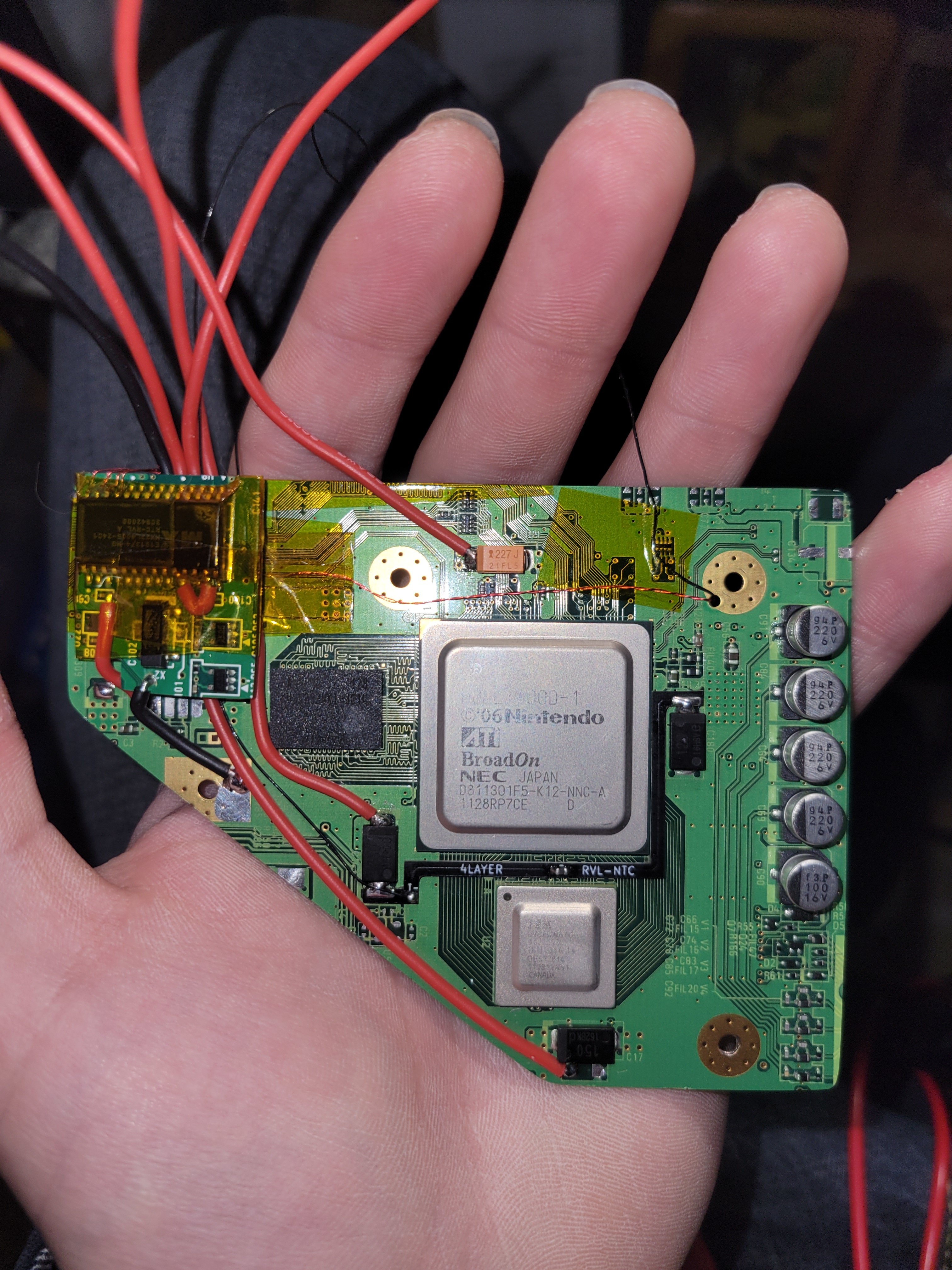

Next I was more focused on the wii side of things but do keep in mind once again: I was super confused on how I wanted to do the wiring as to keep a nice look from the outside, so I feel like that made things look worse in the end but regardless, I started by wiring all the voltage lines up, but did it in a certain way because I had decided I was going to mount the MX chip where the LDO was.

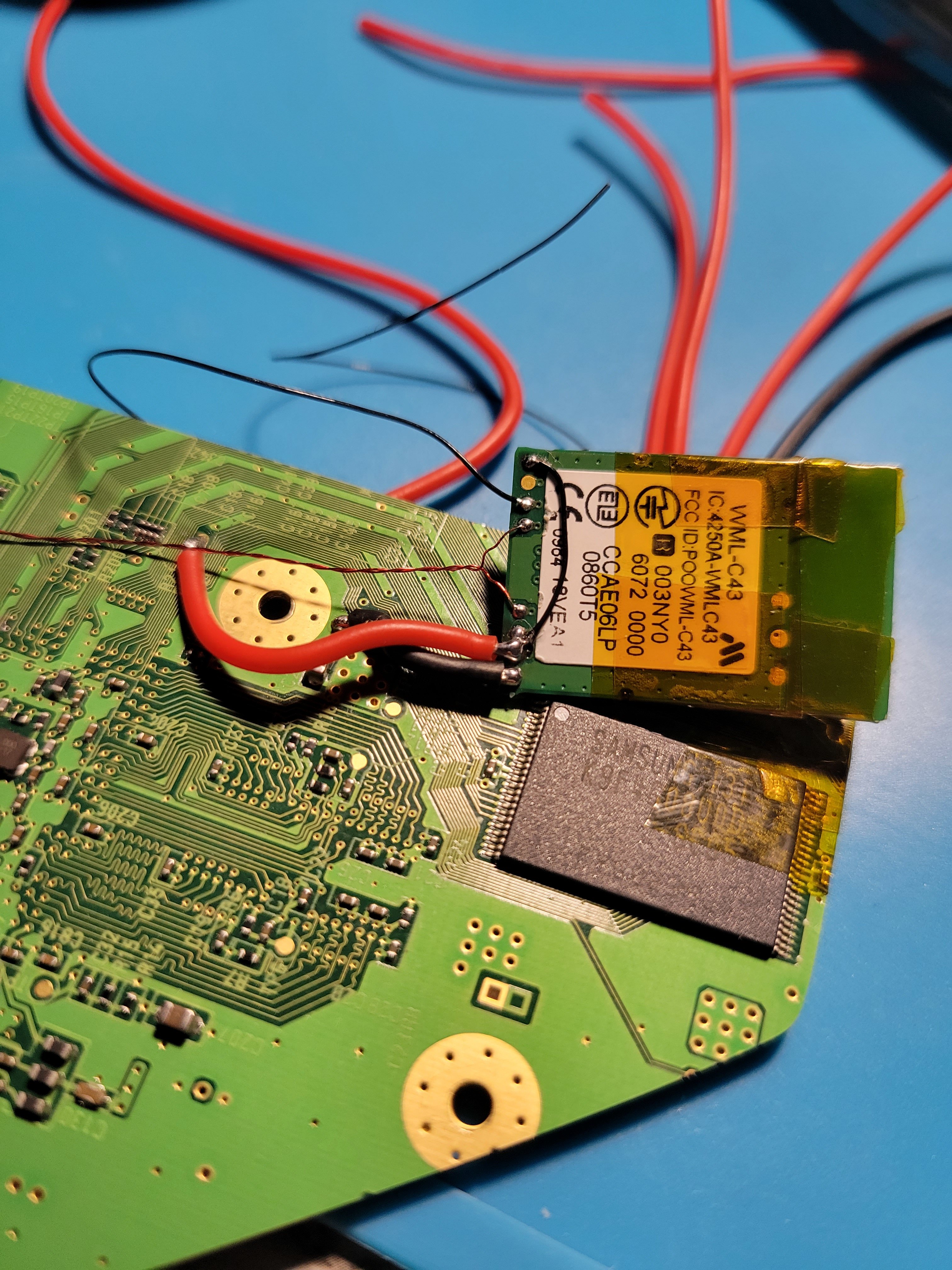

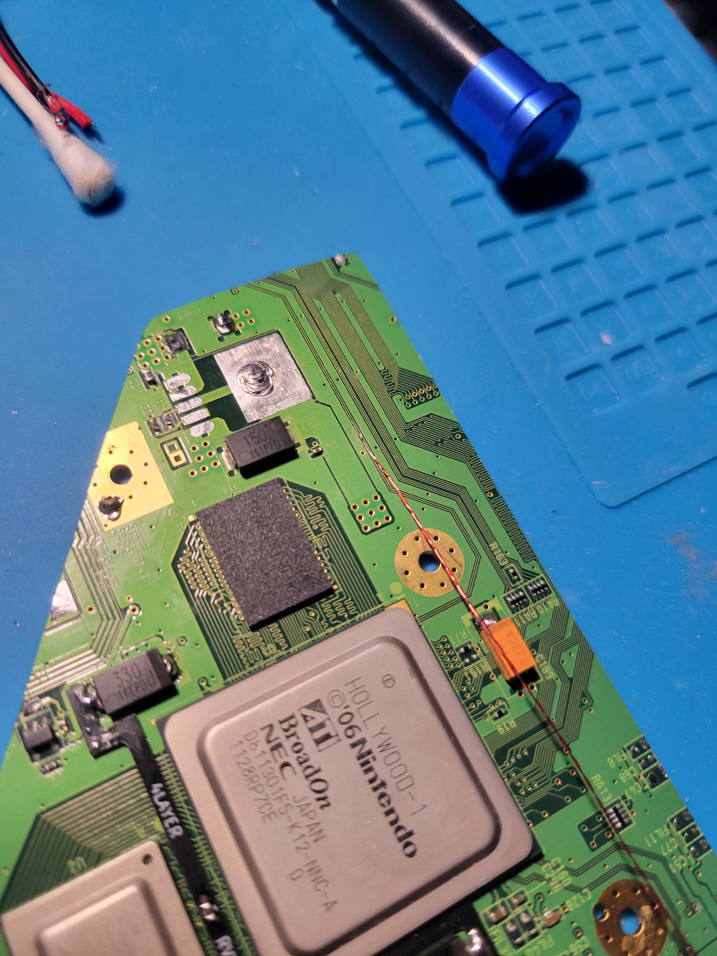

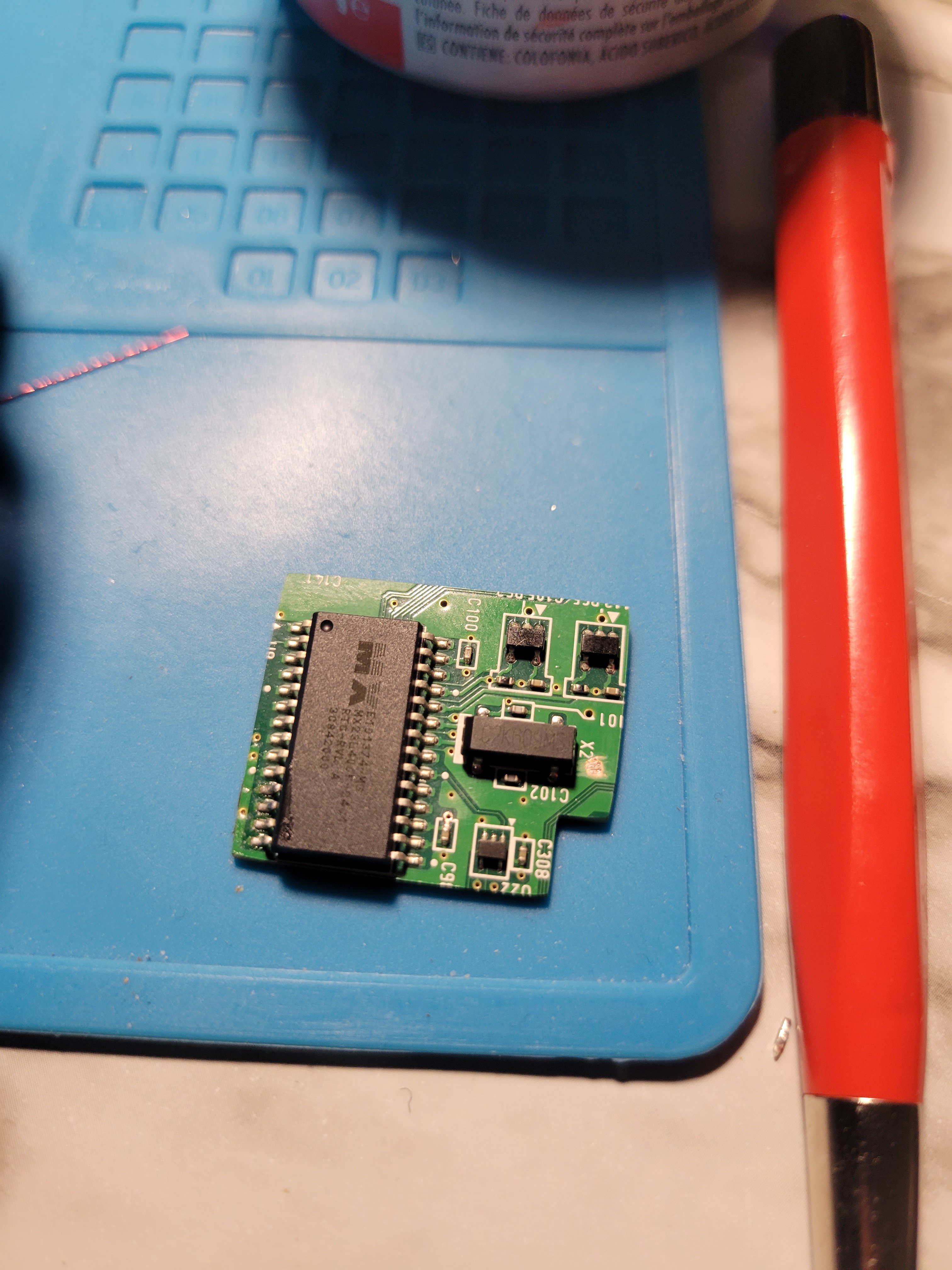

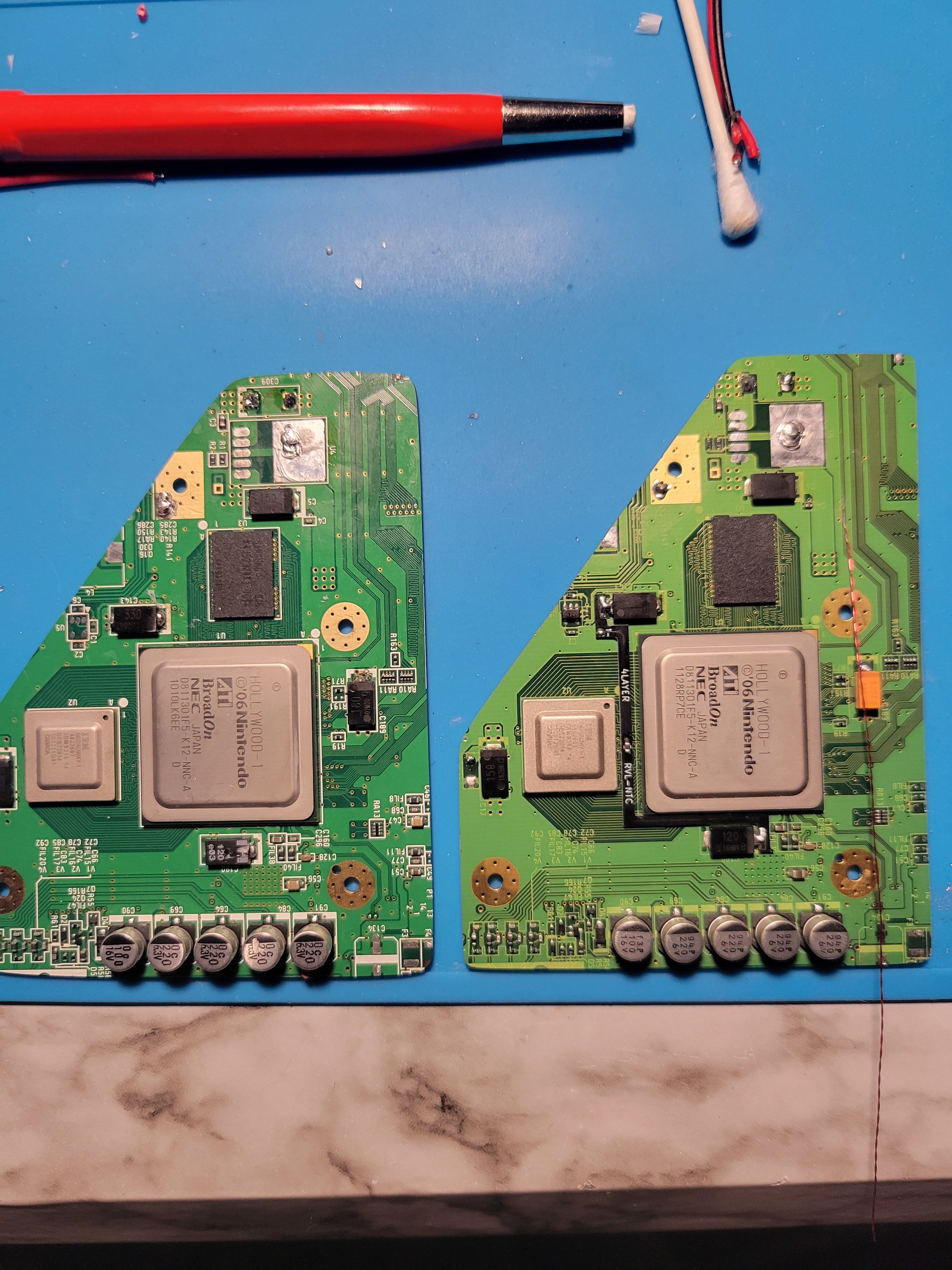

After doing the voltage I was started on the BT module. I had got it wired up nicely and mounted it on top of the nand as seen in other ashida worklogs. Next was figuring out the MX chip as I wanted RTC and whatnot. I had already had a cut MX chip from another board so I broke it out and started wiring everything up whilst trying to figure out how I was mounting it etc. I ended up mounting the battery between the fan wall and interface board and secured it down with some kapton tape. The last picture was the wii sort of in the ashida as I had it half assed in there to test booting it, and it worked!
