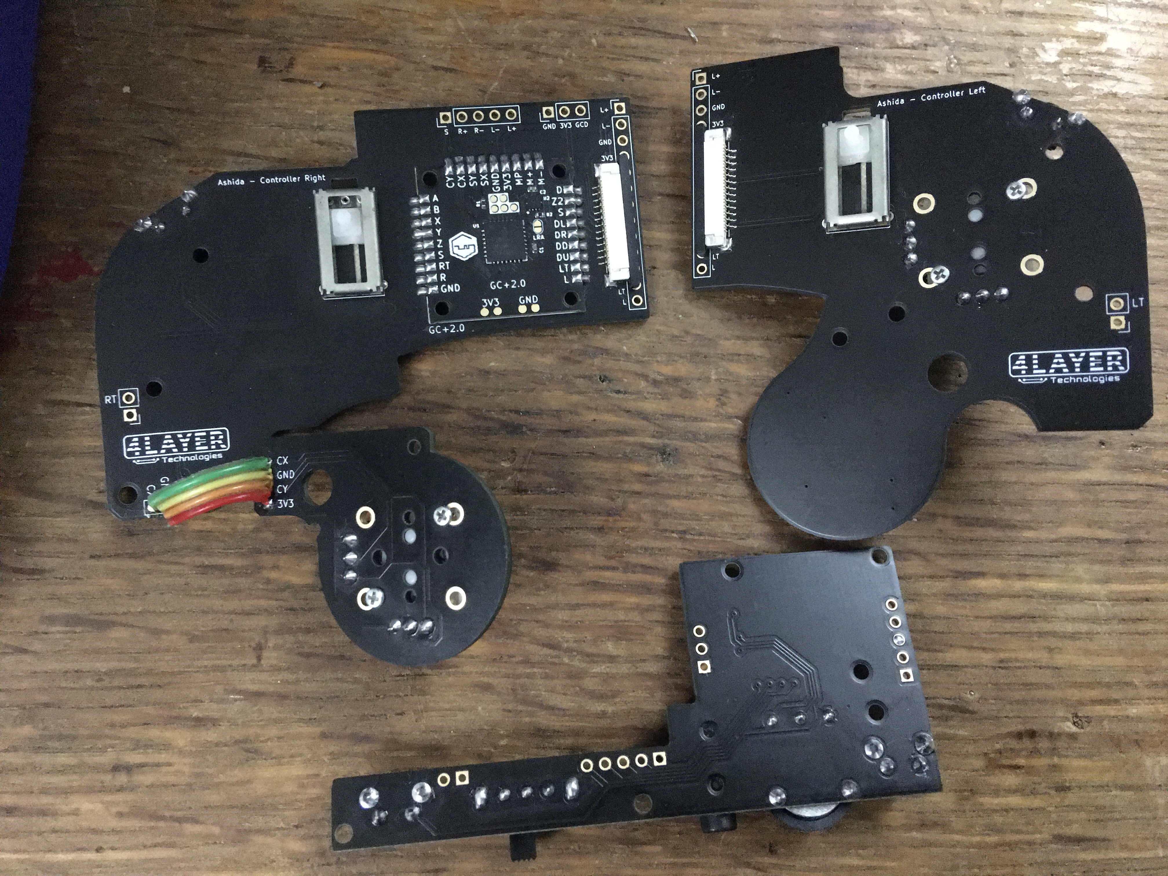

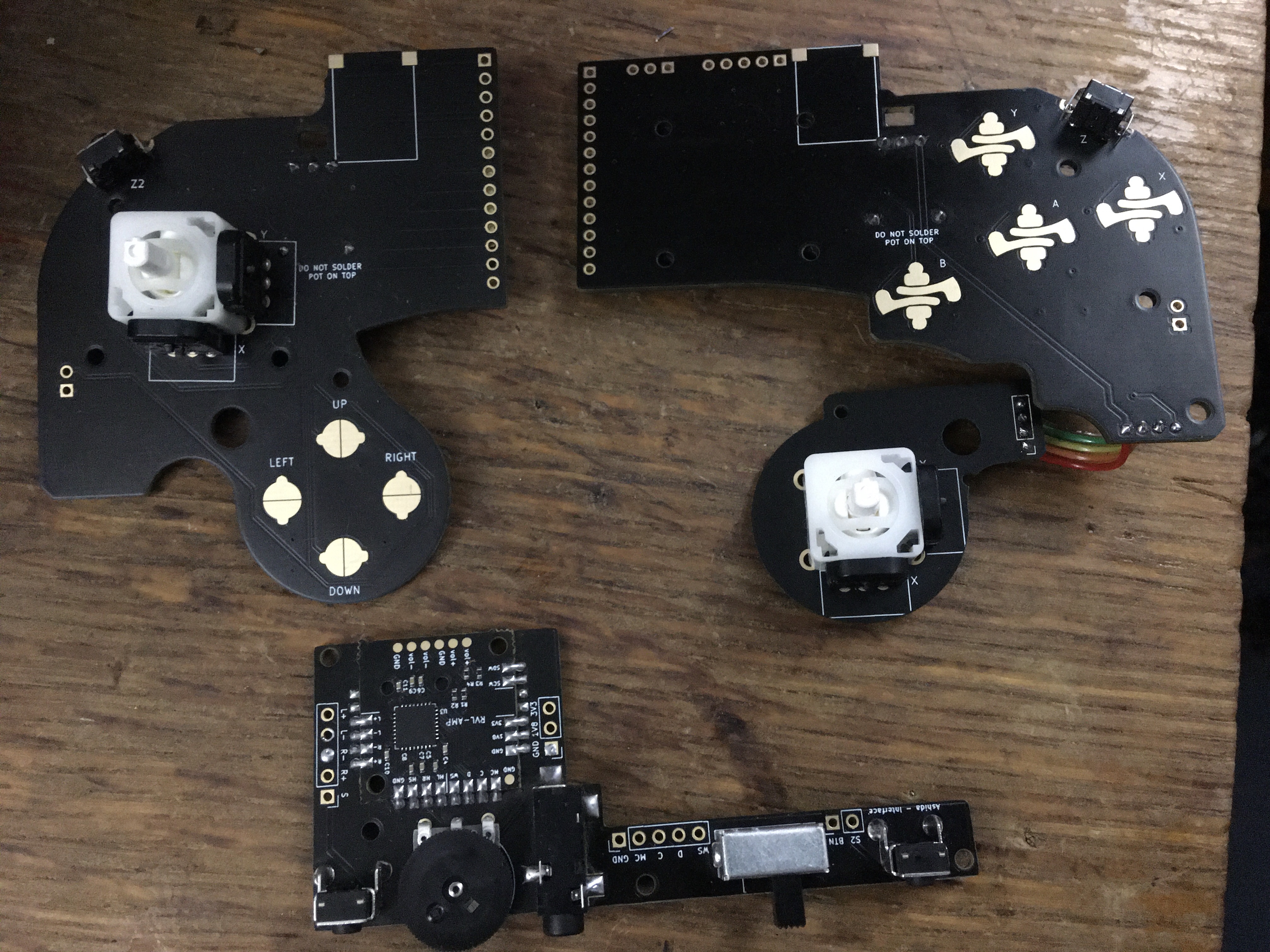

I'll likely add more questions to this thread later as they come up. In the meantime, I might as well post my populated Ashida boards that I've been able to finish up tonight. Really excited to attempt diving into the bulk of the build soon! I should be attempting to trim my Wii some time this week.
