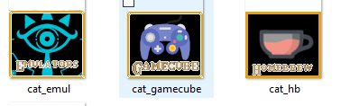

So while my Case is being 3d printed, I've decided to work on software stuff now. I've designed icons for the stuff in pm, and 99% of them are done. It looks really good, it's just the screen is eh
Looks really good on the wii
I don't know if I'll use this zelda theme, but I'll release it after I'm done, and then whoever can use it, It's really nice.

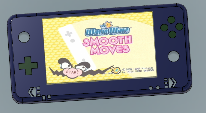

Howdy, I've done a lot of re-designing in the last couple of days. Here's a better Write Up.
My Wii portable dubbed "The *Classic* Squiifer" (Name still pending), This Portable has been in progress since 2018 Y i k E s. It has gone through many revisions I've lost count litterally, but here is hopefully the final Revision.
Key Features:
-Game Boy Aesthetic based off of the concept by rennerflorian who called it the "GAMEBOY 1up."
The Colors I'm not totally sure about, My main picks are Galaxy Black, White with any buttons, Baby blue with Black buttons, or some Vaporwave Color Scheme that I like.
-Approximate Thickness is about 26mm at the moment. If it does not work I will most likely either just make it thicker, or fall back onto my previous Revision (Posted Above).
-5 Inch 16:9 Screen Video through Aurelio's Direct Drive.* Video I hear is slightly better than VGA I think, Maybe not a whole step up, I don't know yet, since I don't have one yet.
-Digital Audio through Gman's U-Amp, I'm thinking of just having a Mono-speaker to fit the Gameboy aesthetic, with the pro of less wiring (like two less wires lmao)
- Will be powered using Gman's Power Management System straight from the store that's been sitting in my drawer waiting to power a wii. The Plan will be to use four 18650 batteries, which is like atleast five hours of battery life iirc.
-Gman
Pictures:
Notes:
This revision didn't take too long to model since I have so many assets made out already, It's mostly based on my last Rev with a lot of stuff moved around.
26mm is just enough for a little wiggle room with everything packed into this device.
The ABXY and Directional buttons are referenced from Joycons, inside and out. This means that it should feel about 1:1. The Green Circuit board ontop of the buttons is a simple button board I made that uses the same sticker domes from the joycons.
The Plus(start) button looks weird in the bottom left I think so it will also be moved.
The weird thing under the Start button is just a visual thing and shouldn't look like that when printing. I removed something at the begining of modeling this revision and it gave me that, later when working on it, I figured out how to remove it, but it messed up different stuff and so on, so I am just gonna leave it.
The Screwposts are recessed a bit, so they shouldn't stick out and scratch stuff when screwed into the case.
I'm not sure which Charging port I'm going to use. USB-C is hella nice, but costs more money than a regular Wii power port, so We'll see. I will most likely model both in, and then just 3d print it with which ever I have. I have to wait to model in the USB-C board because the one on the Bitbuilt store doesn't have their dimensions. I guess I could ask someone for them though oops.
The fan vent is based off of a Symbol from a Vocaloid music video, Props if you know which one.
The fan vent symbol looks kind of weird though so I will most likely switch it out for something that looks a tad bit better. I am missing the fan exhaust though.
I am also missing the Power button.
I hate posting just Fusion360 pictures so I'll try not to post any more updates until I've got money and bought another wii or something cool happens.
I do like the nickname DMGII, but I believe StonedEdge took it for his DMG wii portable clone, and I don't want to get those mixed up.
*I don't know if Direct Drive is the official name, but it's what it's been called in the discord.
