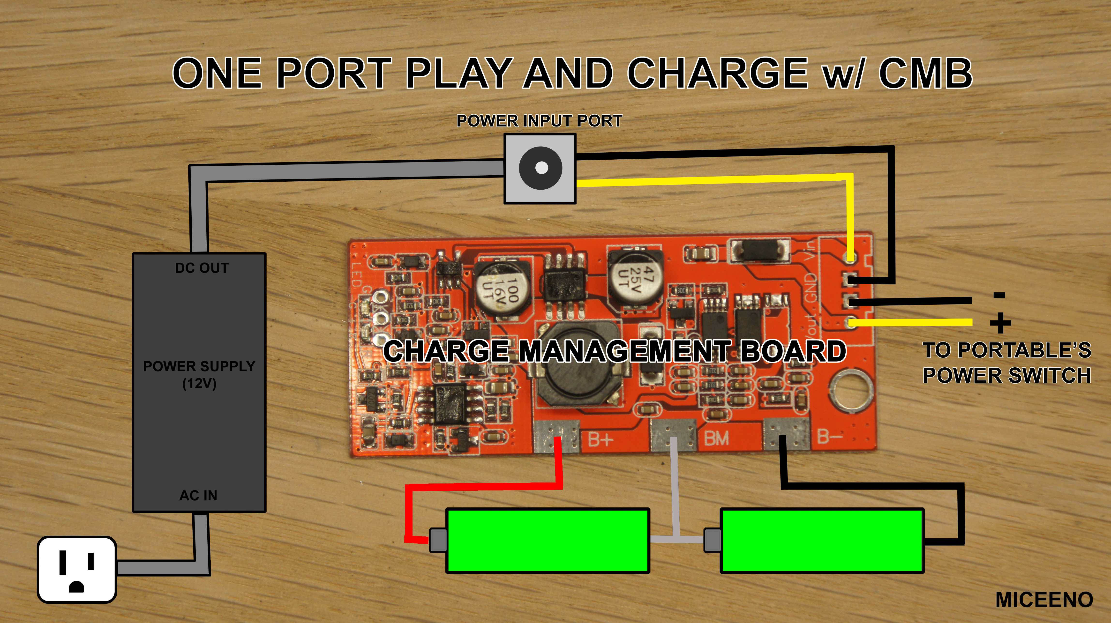

Miceeno, have you had a chance to test two Red Boards in parallel? I would imagine this would work just like two battery cells in parallel. I saw you mention this in your thread about your portable N64 and didn't even think to do that. This is a much better and cheaper option.

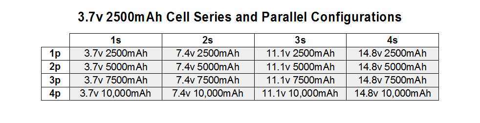

More current with a faster charge time. I would use a 2s2p configuration and one red board as Miceeno did but a charge time of ~6 hrs is not ideal. Since the red board can only deliver 1A of charge at a time, connecting multiple boards in parallel would yield the ability to charge in ~3hrs, but still double your current. One could indefinitely put however many red boards in parallel you want. Voltage regulators are commonly put in parallel, I would imagine this is no different.
Plain protection circuits yes, but the red board is more complicated. The rear board would be trying to pass power to the front board, which has a minimum input voltage of 9v so I don't know if it'd even accept the power in. It could just sit there doing nothing and wasting space and money.
@Space Puppy I haven't made it around to testing two boards in parallel, like I said I've been too busy for this. As for the theory behind it, I think it could be done safely but you are limited to one Red Board for every 2s1p set. So in your case you'd have two separate 2s1p batteries that you'd run with one Red Board per set. Then run these two Red Boards in parallel to the portable. The way the Red Board isolates a battery from load while charging makes me believe it can isolate parallel batteries from each other to while charging. I would NOT use this theory in a series set up because protection boards are dangerous to use in series.
Not possible, the smart chargers would confuse each other's CC/CV cycles.

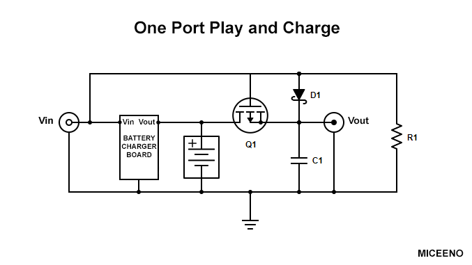

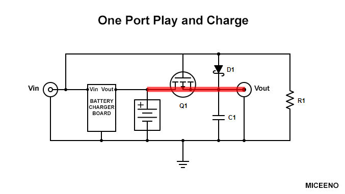

Here's an idea, use the Red Board because it can safely play and charge right out of the box. To get around the 1 amp of charge current limitation, build your battery removable. (They make very nice 18650 battery holders for this.) With removable cells you can fully "charge" your portable in seconds. When you connect external power to the Red Board it disconnects the battery from the portable. So you can swap the cells without even needing to power the portable down. And for the times you don't need a quick charge, the 1 amp charge rate is safe and sufficient.

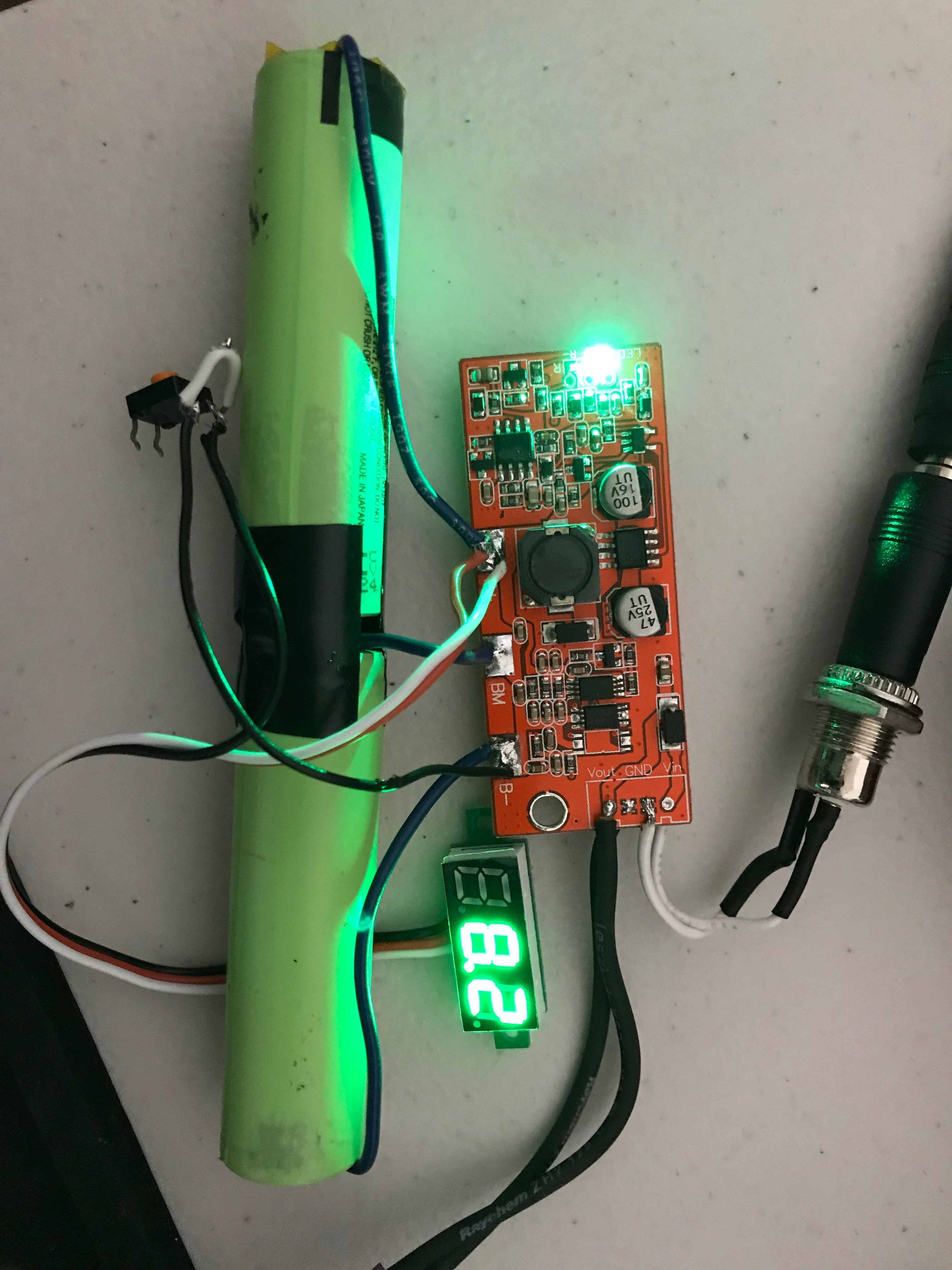

I have ordered a few red boards and will run some tests to see if they can be run in parallel. Not sure if anyone is still curious about the circuit that I was planning on making but I could post that if people would like.

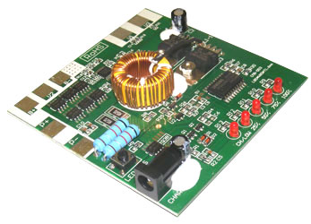

@Space Puppy before you try to hook 10 of these Red Boards of in parallel on one set of cells you need to stop and think about this from all the angles.
1. My primary concern. Even if the charging works flawlessly, the Red Board is also the PROTECTION circuit. The Red Board is rated at 3 amp max draw. If you use 10 Red Boards you've increased this to 30 amps before the short circuit protection kicks in.
2. MOSFETs are tricky to manufacture. All the specs on them are usually listed in ranges because they vary from batch to batch. So if you have 10 Red Boards with a variance in the MOSFETs they will switch from running off batteries to charging at different speeds. (This is why when repairing a large amplifier you have to use MOSFETs from the same batch.) You could potentially (for a split second) have some Red Boards charging and some not. You'd be applying power from both the battery and PSU to both sides of the charging IC simultaneously potentially shorting it out. This may not cause failure the first time but eventually it will.
3. The charging IC's may not play well together. They may cause a small voltage spike when they come on together. This will probably make them think the batteries voltage is high enough to switch from CC to CV. When the voltage settles they will switch back. repeat, etc. Or they could all have different tolerances on fully charged voltages causing some to stay in charging longer than others. Causing some boards to trip overvoltage protection while others are still charging.
4. If you run the battery low enough to trigger under voltage protection then the boards probably wont trigger together potentially causing more issues.
Do you kinda get an idea of what I mean? There's more at play here than simply increasing charge current. If you ditch the red board and build your own MOSFET switching circuit with only one protection board and multiple charging modules you'd be safer. I still don't recommend it because as stated above the charging ICs could be unpredictable when you have multiple in parallel. If you are going to build your own MOSFET switching circuit you may as well go the extra mile and build a higher output charging module.

Miceeno is right. Any small difference between the output voltage of the two regulators would cause a very high current flowing between the two. That’s given by Ohm’s law and the resistance between the two is only given by the wire that you would use to join them, which is going to be low.

I’m not saying it doesn’t matter in general, but it just didn’t in this case. Anyway, protection diodes still won’t work because then the regulator wouldn’t take into account the voltage drop caused by the diode.
Could you elaborate on this? Are you saying the voltage drop across the diode will cause too much of a drop in voltage for the load regulators (ex. 3.3V regulator for the N64)?

No, I’m talking about the voltage drop between the charger and the batteries
Oh I was talking about the output voltage of the red board so that it does not send current between each unit, should have stated that more clearly. The input would be better suited with some zener diodes and maybe some resistors, assuming the extreme case of course. Two in parallel shouldn't matter as there is less current.
Even if there were series diodes at the input, it would just drop the voltage by a little bit. You would have to account for this of course and ensure the correct power supply. Series diodes are commonly used as a reverse protection before regulators in case the wrong power supply is used. I wouldn't think this would cause any complications, but I could very well be wrong.
