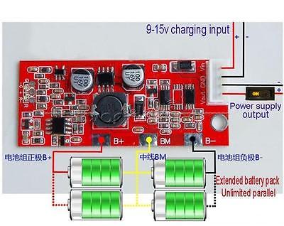

With the CMB listed in the guide for batteries, from my understanding I don't need a protection circuit? I'm thinking of buying the 4s CMB and using 4 7.4 clusters of the Panasonic batteries from the BOM. Also is my understanding that the Panasonic batteries in the bom are a total of 3400 for all 4 batteries ?

I think you are confused. If you are using a 7.4v pack that's 2S. You are correct that the CMB handles the protection of the batteries. You can connect as many parallel sequences of 2s battery packs to the board. Each battery is 3.7v 3400mAh. If you connect in series you double the voltage, if you connect in parallel (with the same amount in series) then you double the capacity.

Ty very much yes it seems I was confused. I wanted same volts more mah. So two batteries attached to the board will give me 7.4 volts and 3400mah per battery so 6800mah? Then if I want more capacity I hook more up in parallel

Two batteries in series will give you 7.4v, if you want more capacity you would have to add another set of 2 cells (in series) in parallel. So if you want 7.4v 6800mAh you need 4 cells.
Ok thanks, that makes sense. This photo is what you mean?
