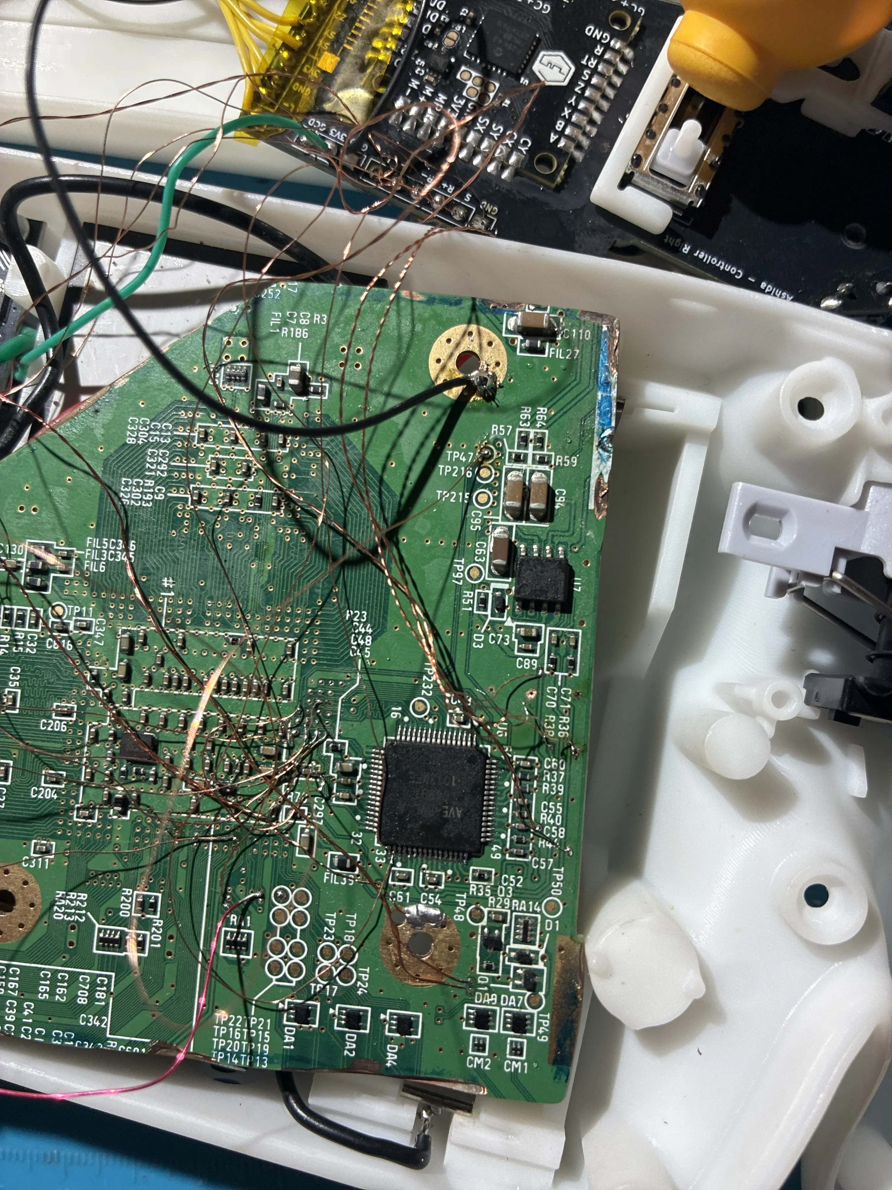

Can you provide some clear photos of your wiring so we can eyeball for any physical issues?

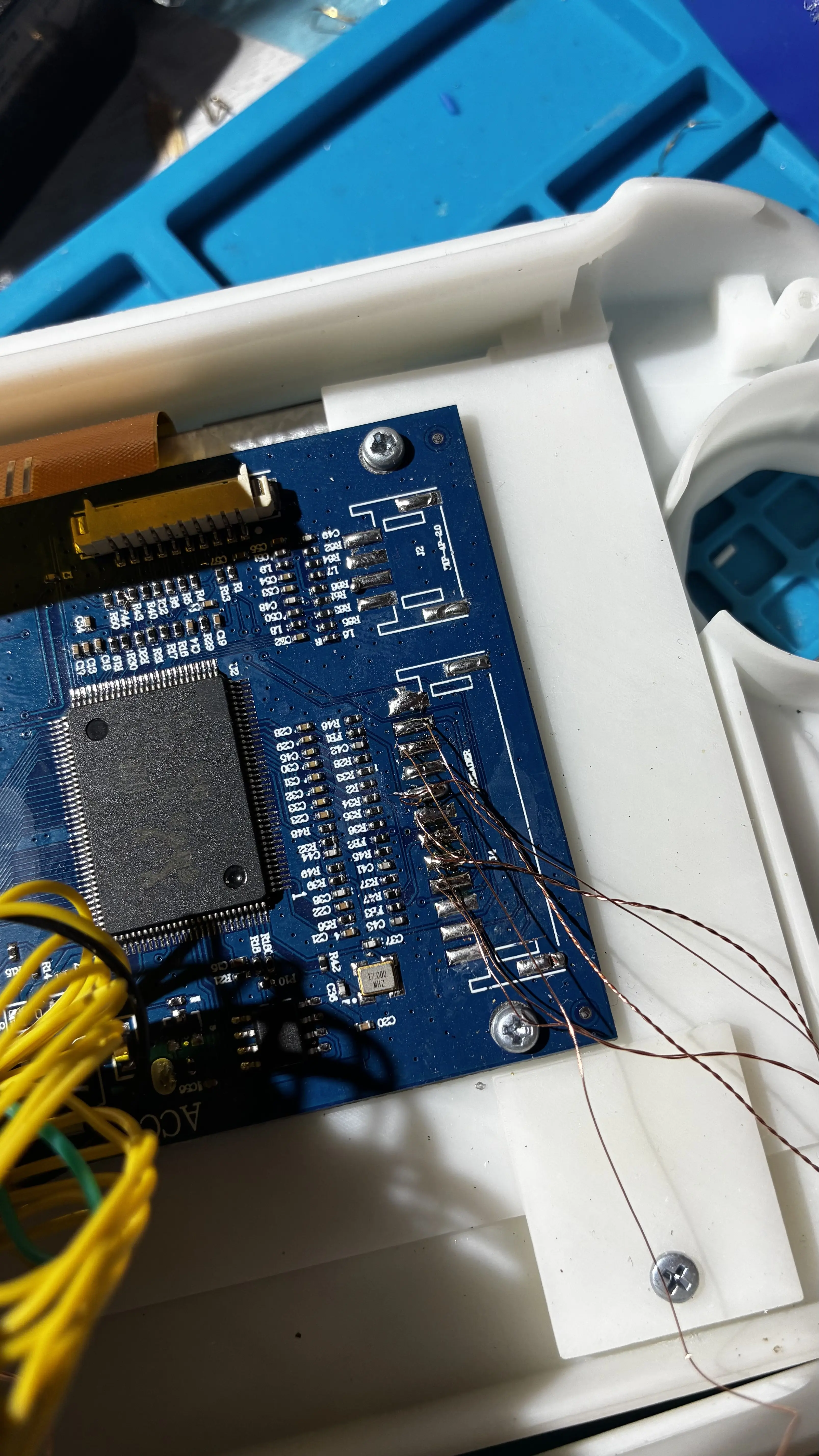

Here’s some wiring work sorry for the extremelylate reply

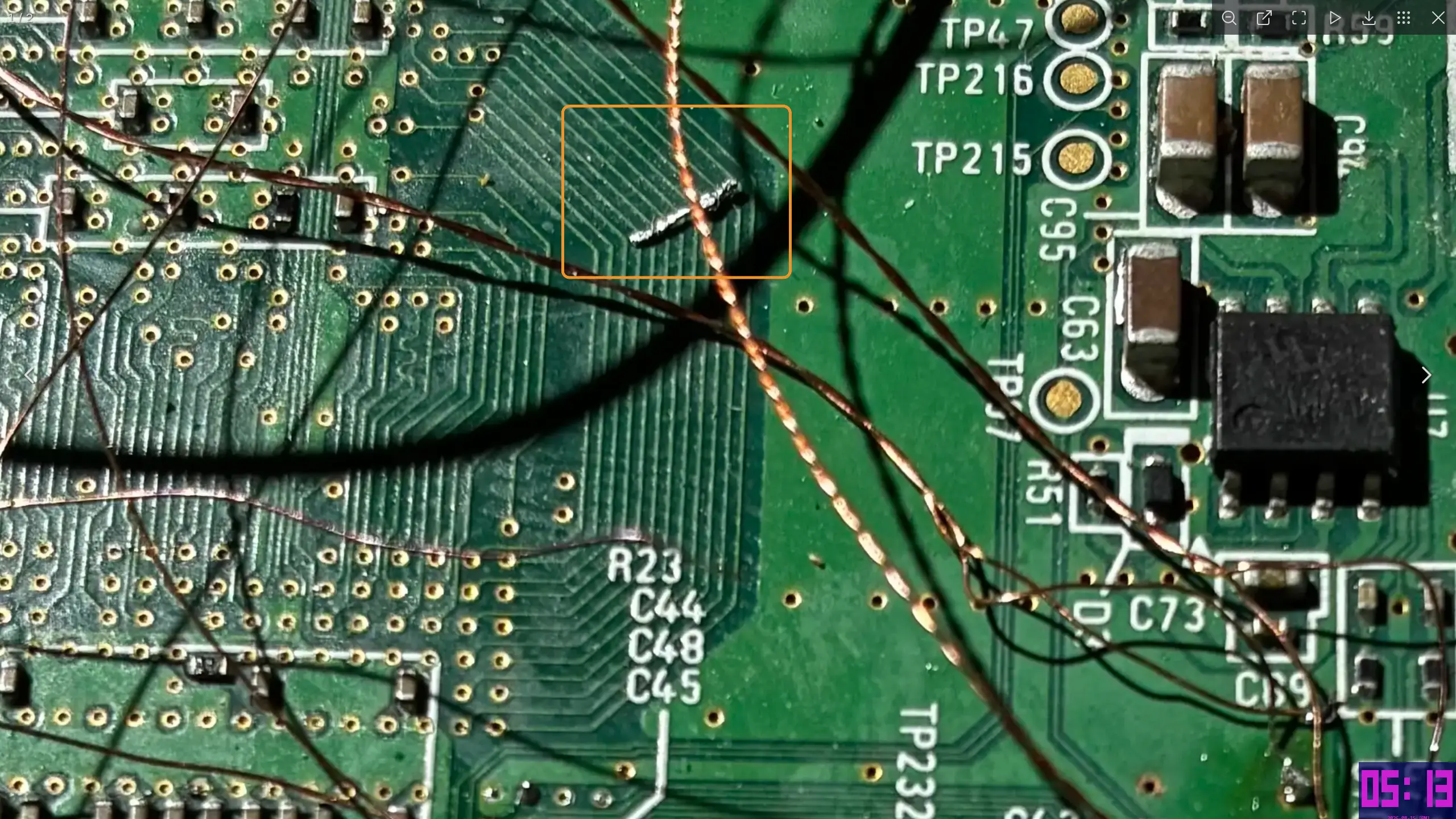

I see some solder debris here you'll want to get rid of:
You never know what sort of short this kind of solder/wire debris can cause, so please ensure you get rid of any that you find in your shell!
It looks like you have VGA enabled, but it doesn't seem like you have 3.3v soldered to mode like you're supposed to. IIRC you need to connect TP47 to 3.3v in order for the Wii to switch the video mode to VGA. The Gboy guide has a great reference image:
The green magnet wire above H-Sync and V-Sync is connecting TP47 to 3.3v. That's where the via runs to, and you can easily solder a longer wire for an easier solder joint.
It's also possible you've got the screen driver board on the wrong video mode. If you do, you'll need to plug in the screen control PCB and press the source button on it until you're on one of the VGA supporting modes. IIRC there's two of these modes, so annoyingly, you may need to toggle between these when testing until you find solve the problem. Hope this helps!

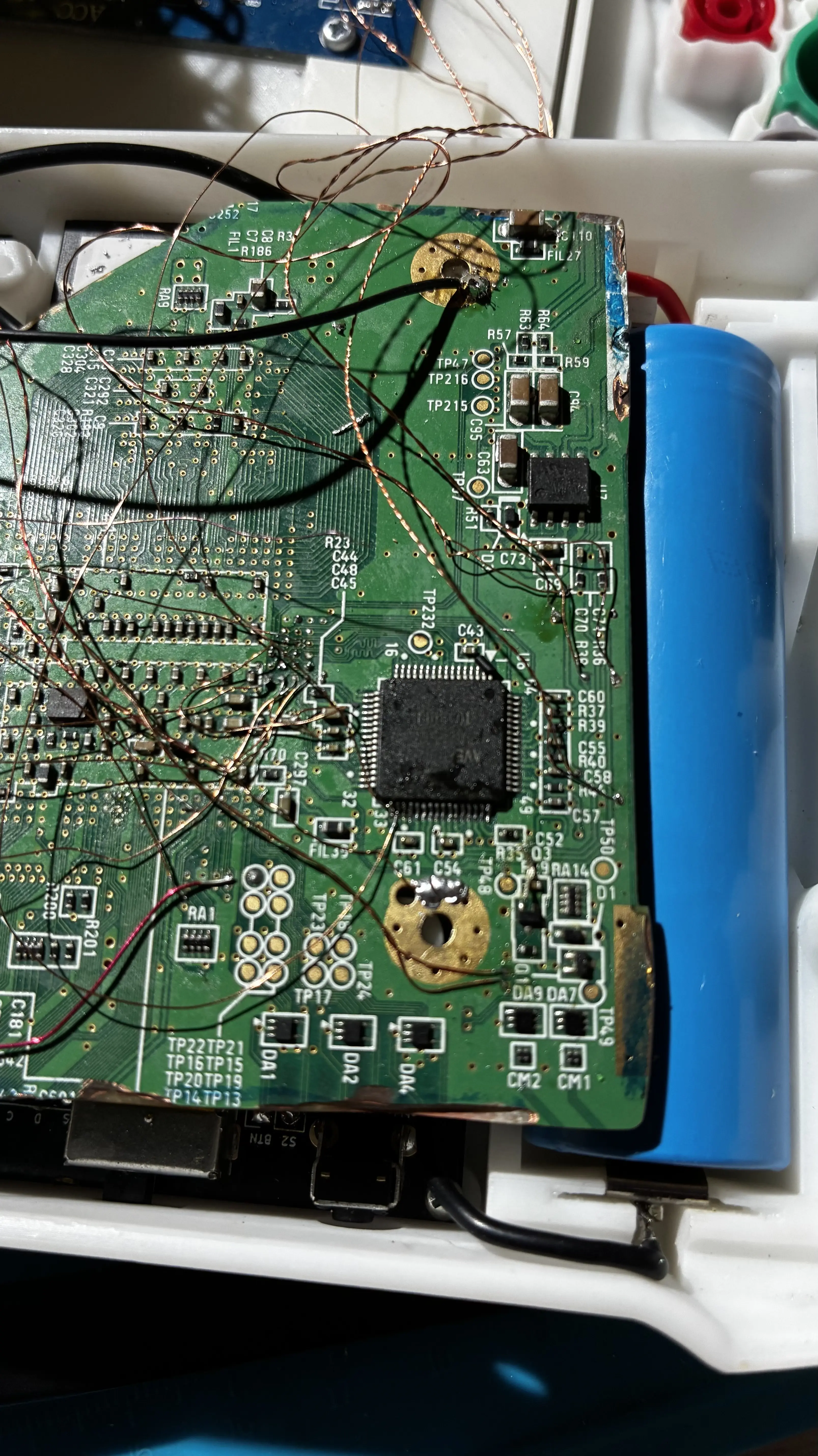

Thank you for the extremely detailed response! I never got a screen control pcb so i don’t know if that might be something you have to purchase separately? I cleaned up a lot of stuff and connected tp47 to a 3.3v source, but still no luck. I also think one of my problems might be the ground for the blue vga wire. I havent been super active on this project recently, but it looks like the ground via is really messed up (shown in picture). I can’t get a solid joint there. Is there a replacement nearby?

I have resoldered all of the voltage wires and the vga wires (besides the ground for blue) i have also rewired u10, headphone sense, and scw. I made sure the board was clear and clean and i will be testing once i get my blue ground situation sorted out.
The ground via for the blue can go to any ground point realistically. Ground is abundant on these boards, and you can find it by using a multimeter in continuity mode (something you should know how to use if you don't already) and probing around various components until one is conencted to ground. Realistically, if you scrape away a bit of green solder mask on the motherboard in an area near the via that doesn't have any traces, you'll almost certainly expose some of the ground plane which you can solder to.
