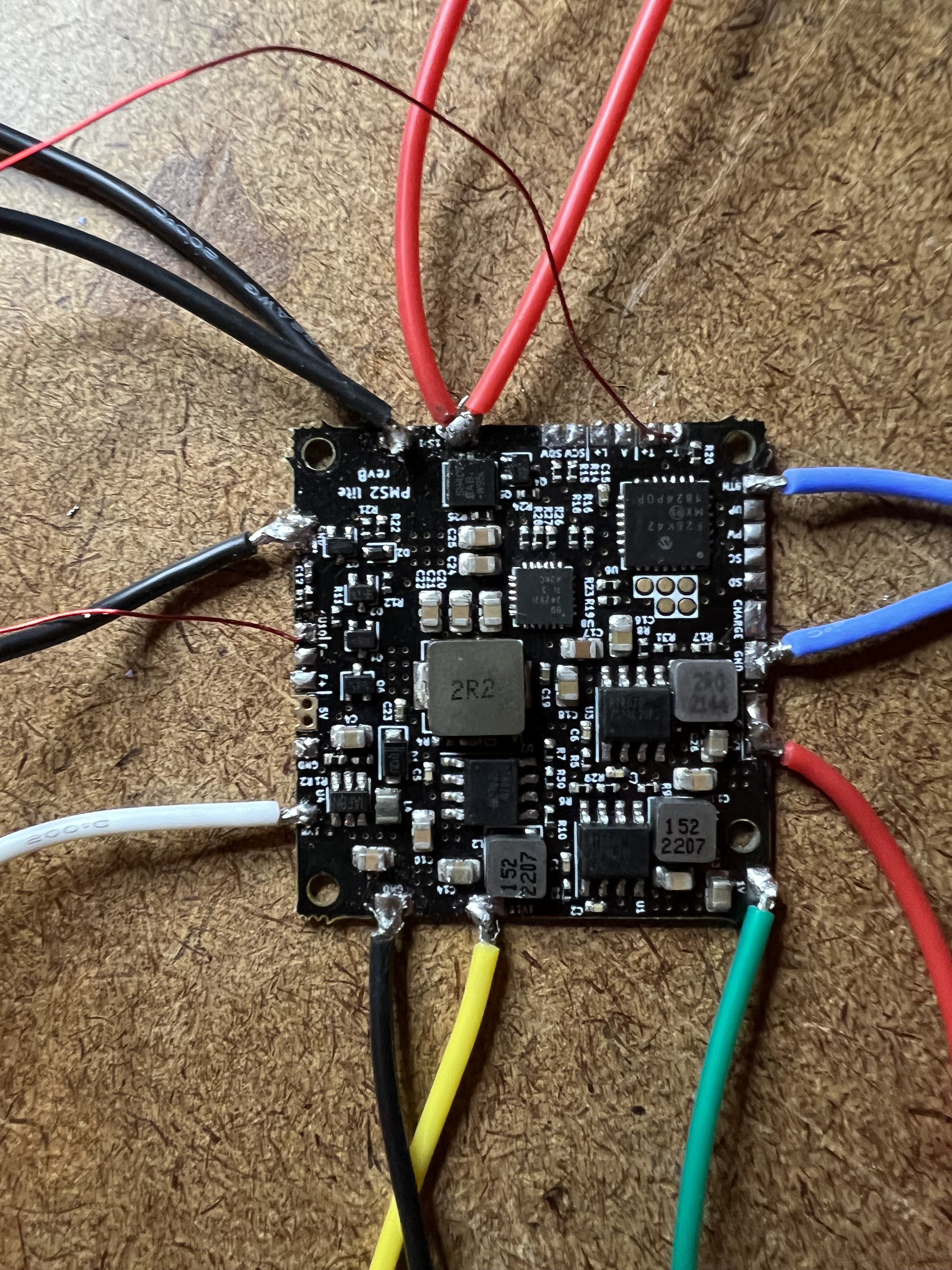

Hmmmmmmmmmmmmmm. Can you post photos of the current wiring?
Yeah
The only thing I see potentially out of place is that SCW and SDW look like they might be shorted. Aside from that, I see nothing visually wrong.
It could be. There are a couple more things we can check before calling it. The first that comes to mind is to try holding the power button down and see if the console boots. It's possible that the PMS was accidentally set to power switch mode instead of button mode.
