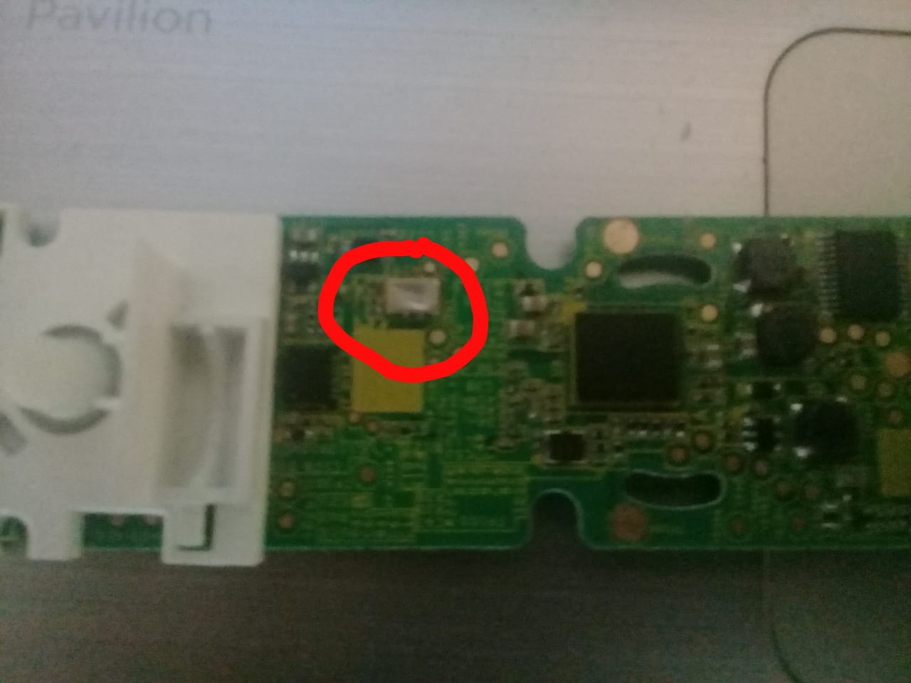

My wiimote one day just stopped working, i noticed that when I apply pressure on this chip, sometimes it works
Can you take a clearer picture? It's hard to tell what that component might be since most Wii Remotes are different.
Looks like a crystal oscillator to me. Can you read its label? It could be that its solder joints got loose maybe due to a drop or something like that.
@Aurelio I think you are right, that is almost the same sensor found in the Motion Plus accessory.
The pressure-sensitivity may be in a nearby passive component rather than the gyro sensor. Or the gyro sensor sensor has a short in it and pressure somehow relieves it. Either way, I think something is creating an unwanted bridge, maybe between 3.3V and GND.
Noticed that if i make pressure in the bluetooth (broadcom chip, under the speaker should be ) it turns on
It's possible that by reflowing the chip you might fix this then. Do you have an hot air station?
