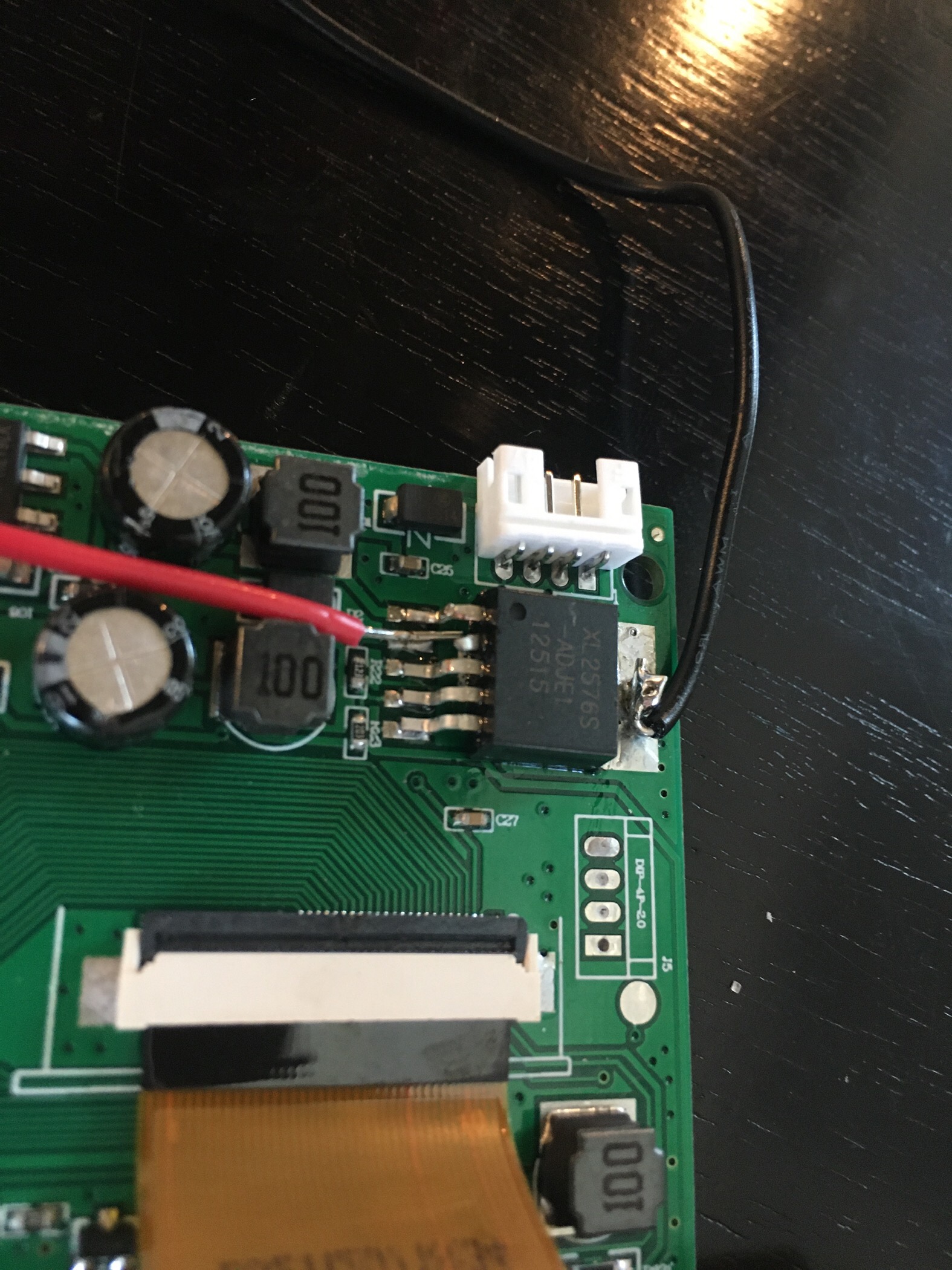

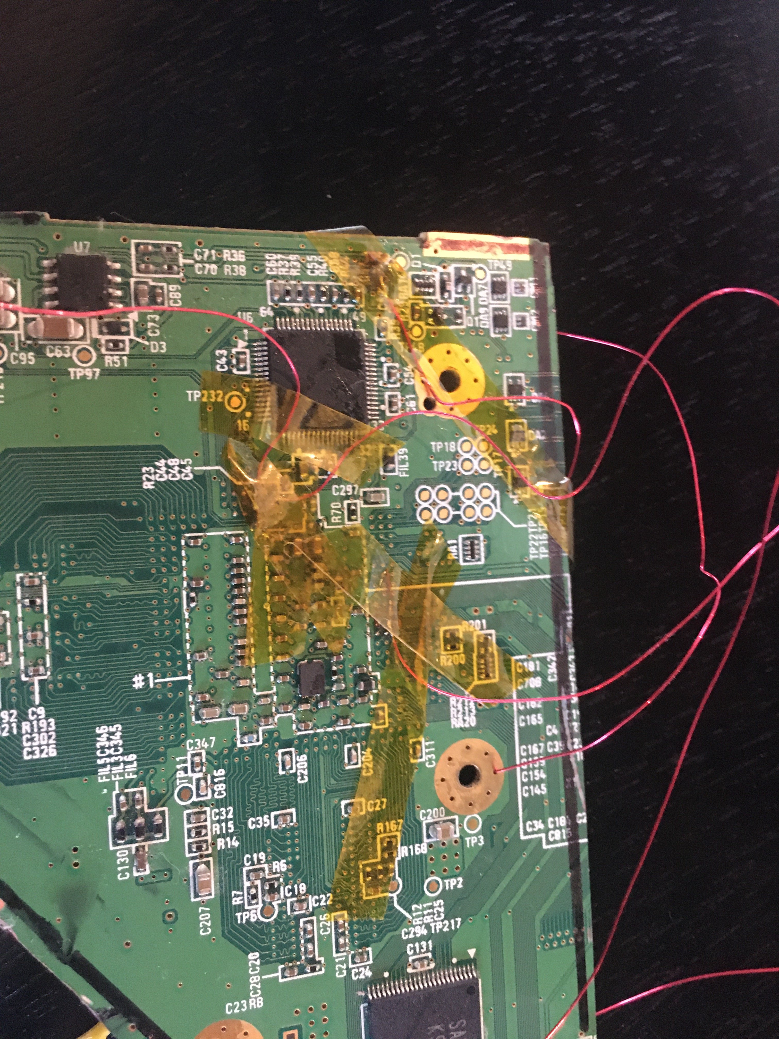

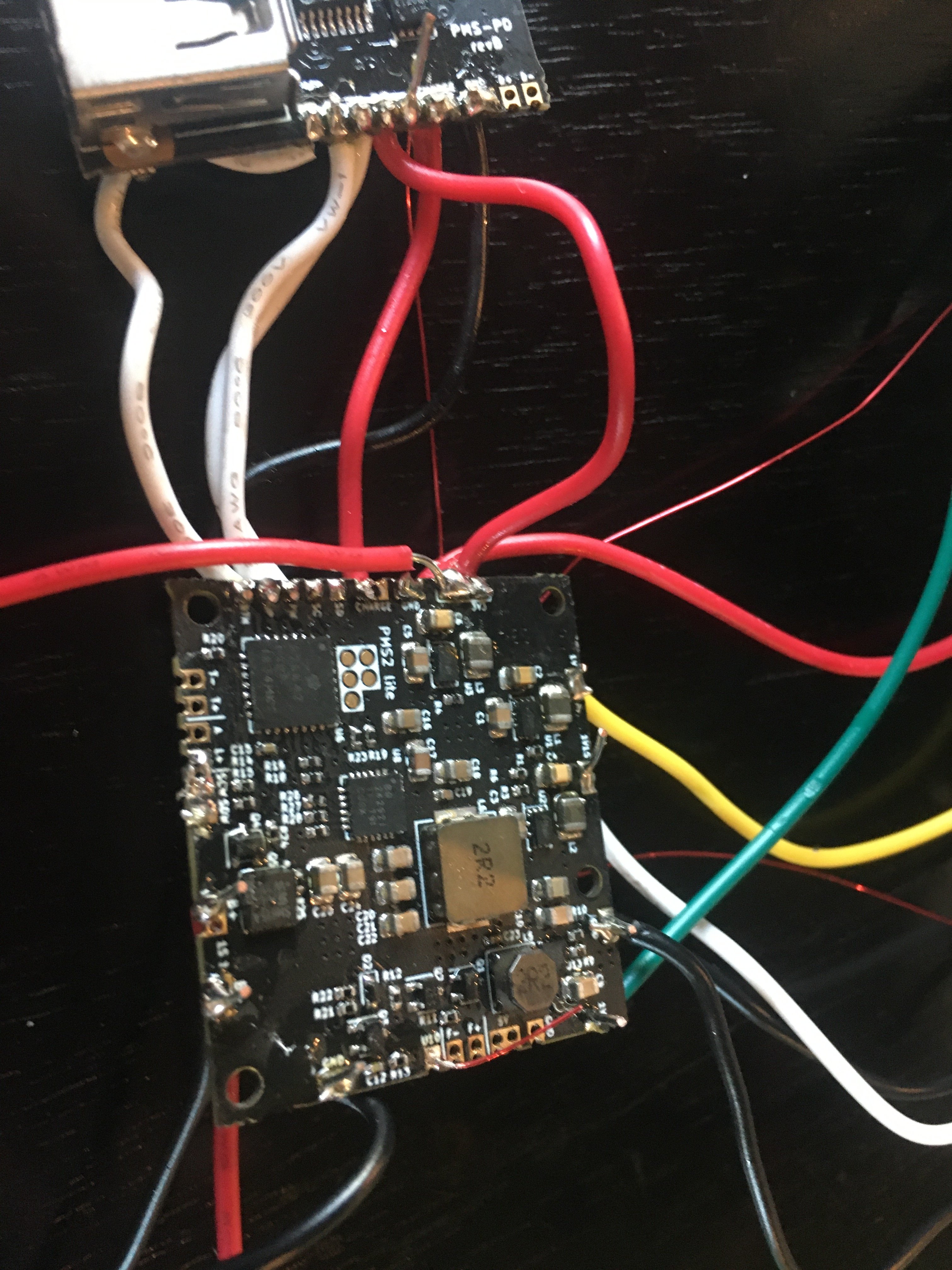

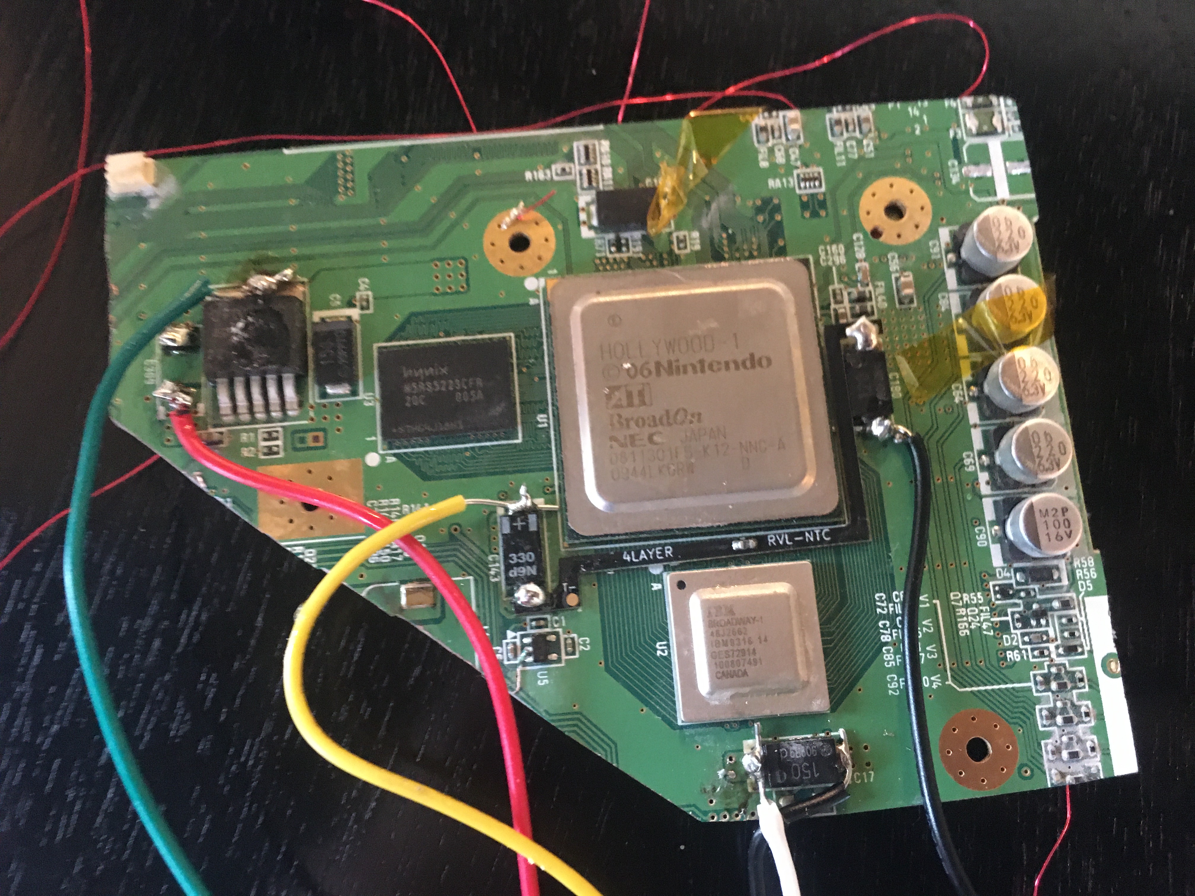

I was trying to make a wii portable, and I think I wired everything correctly. But when I went to test it the screen just stays black. The driver board and screen I am using are the ones from 4layer and I have done the low voltage mod to the driver board.

We need pictures of all of your wiring to be able to help you better.

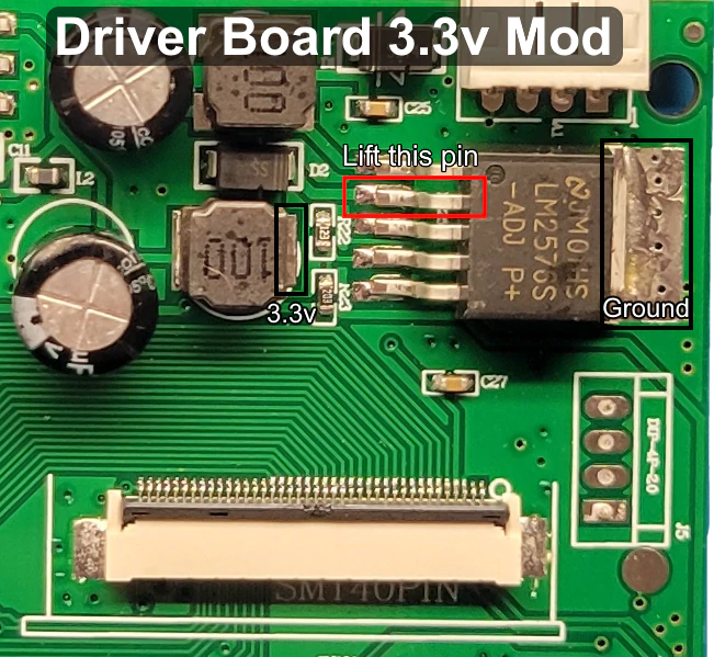

I was looking at the picture for the low voltage mod and saw a box that said 3.3v was i soposted to solder there and not were i lifted the pin
Update:
I put the 3.3v on the correct pad but still didn't work
Turns out the lcd connection to the driver board was the wrong way around. Fixed now
