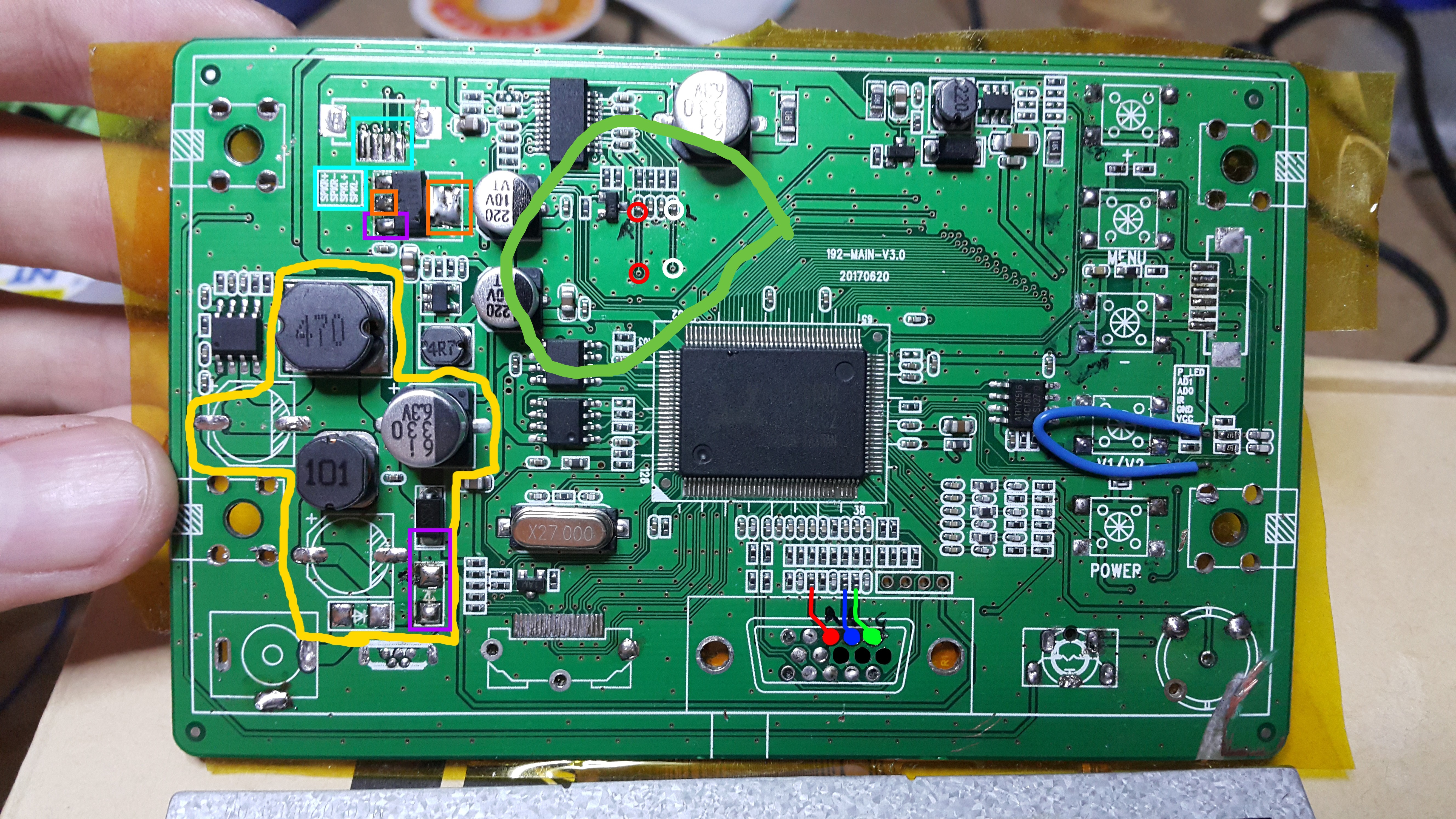

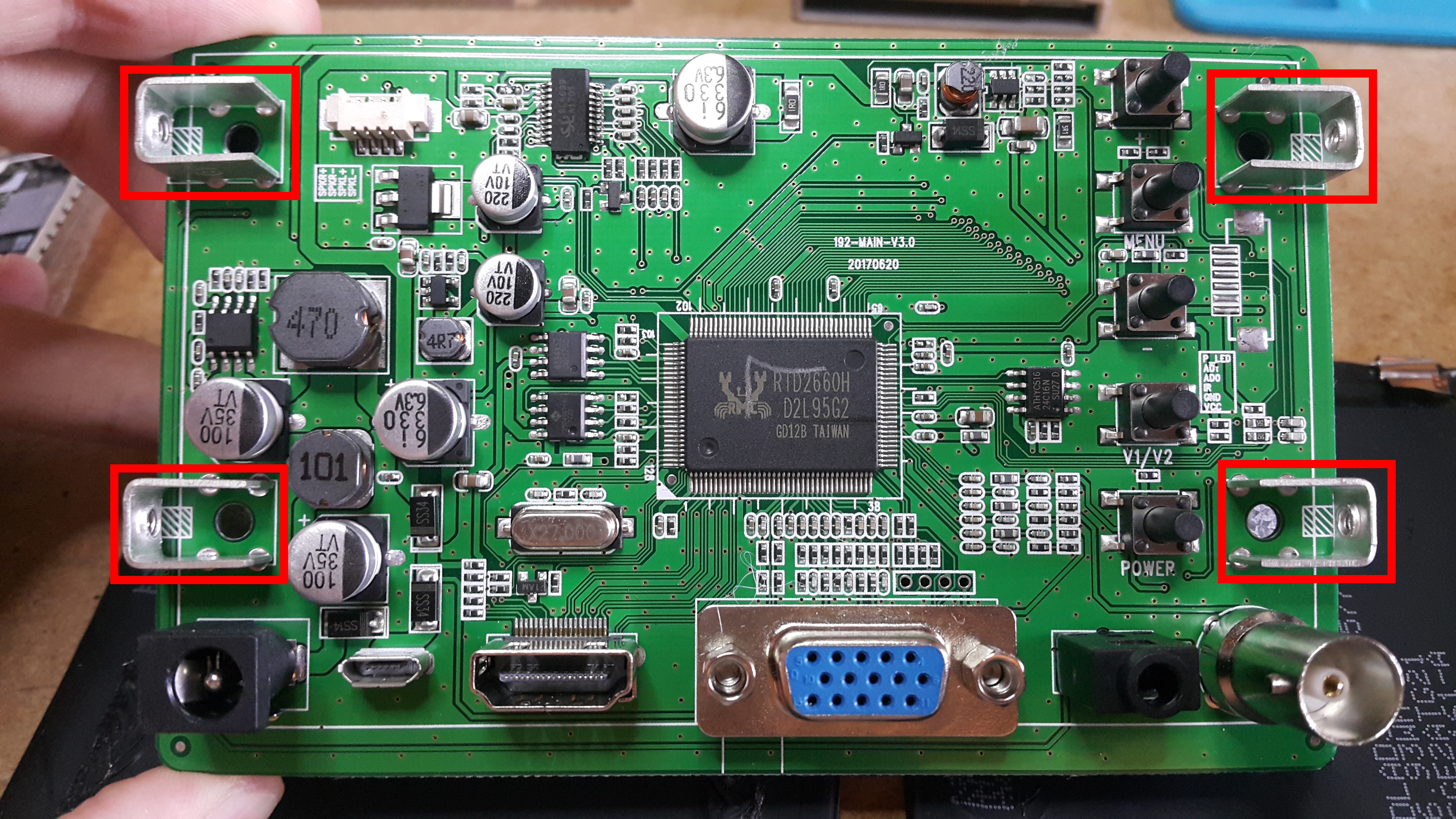

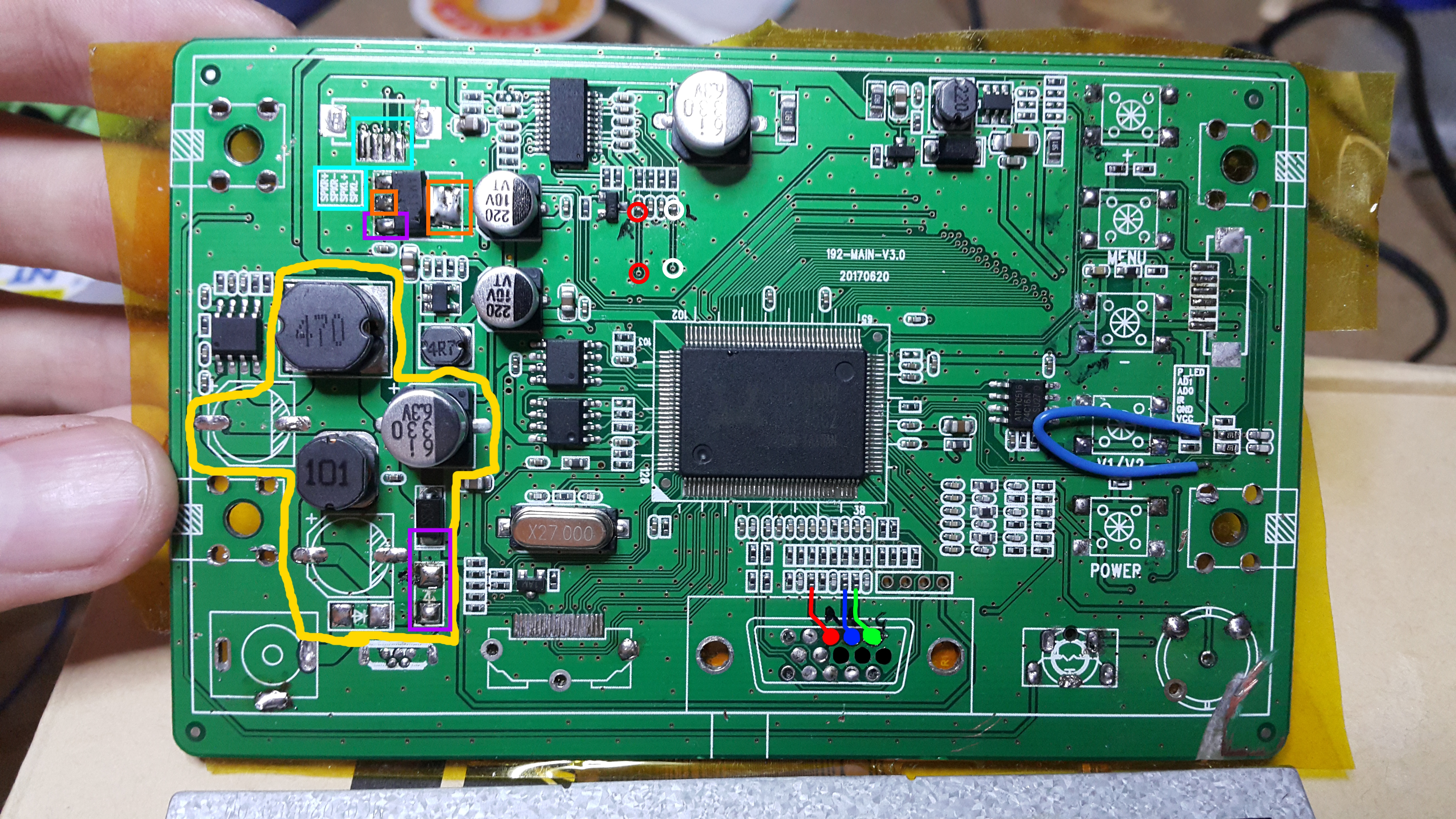

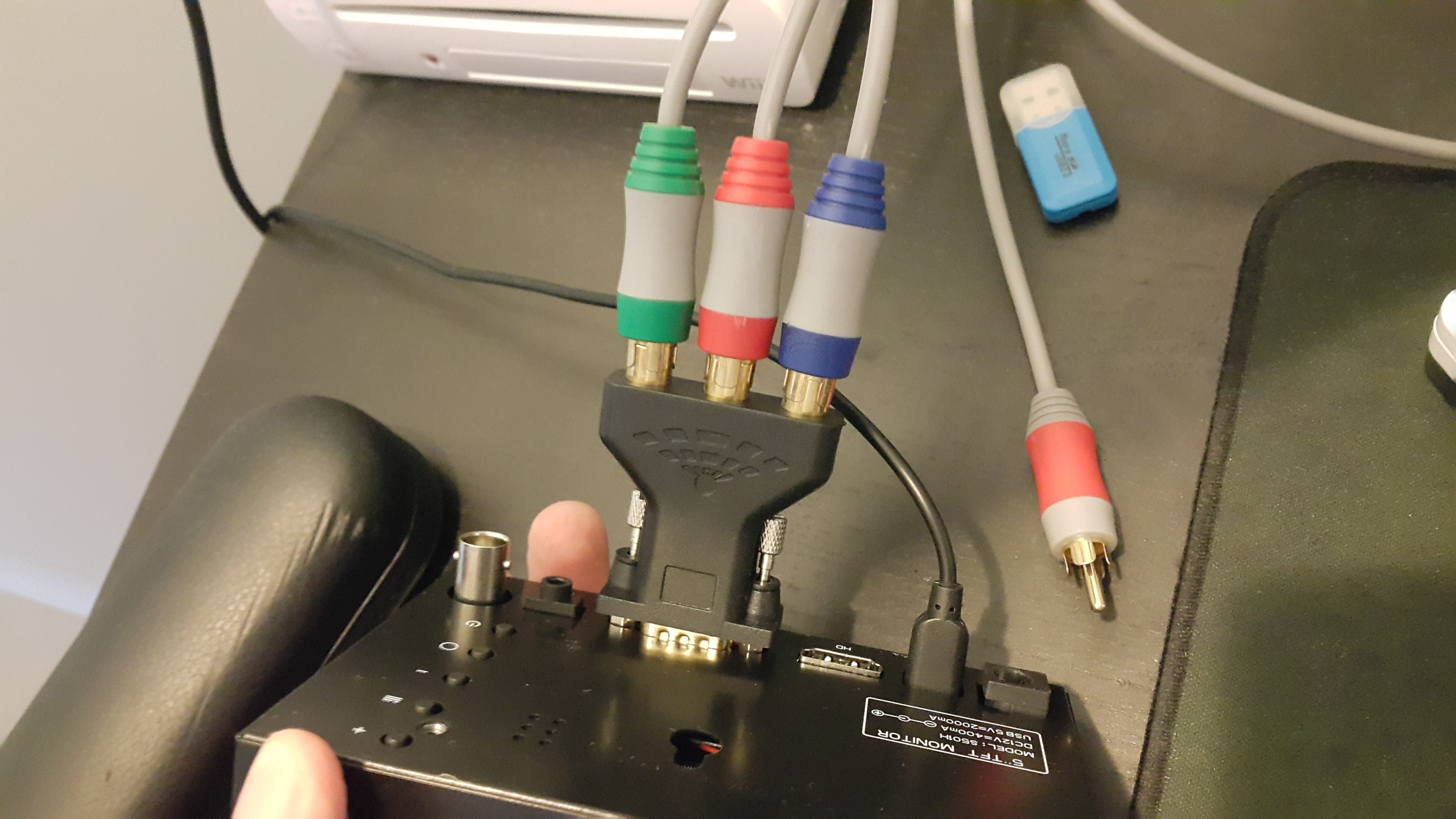

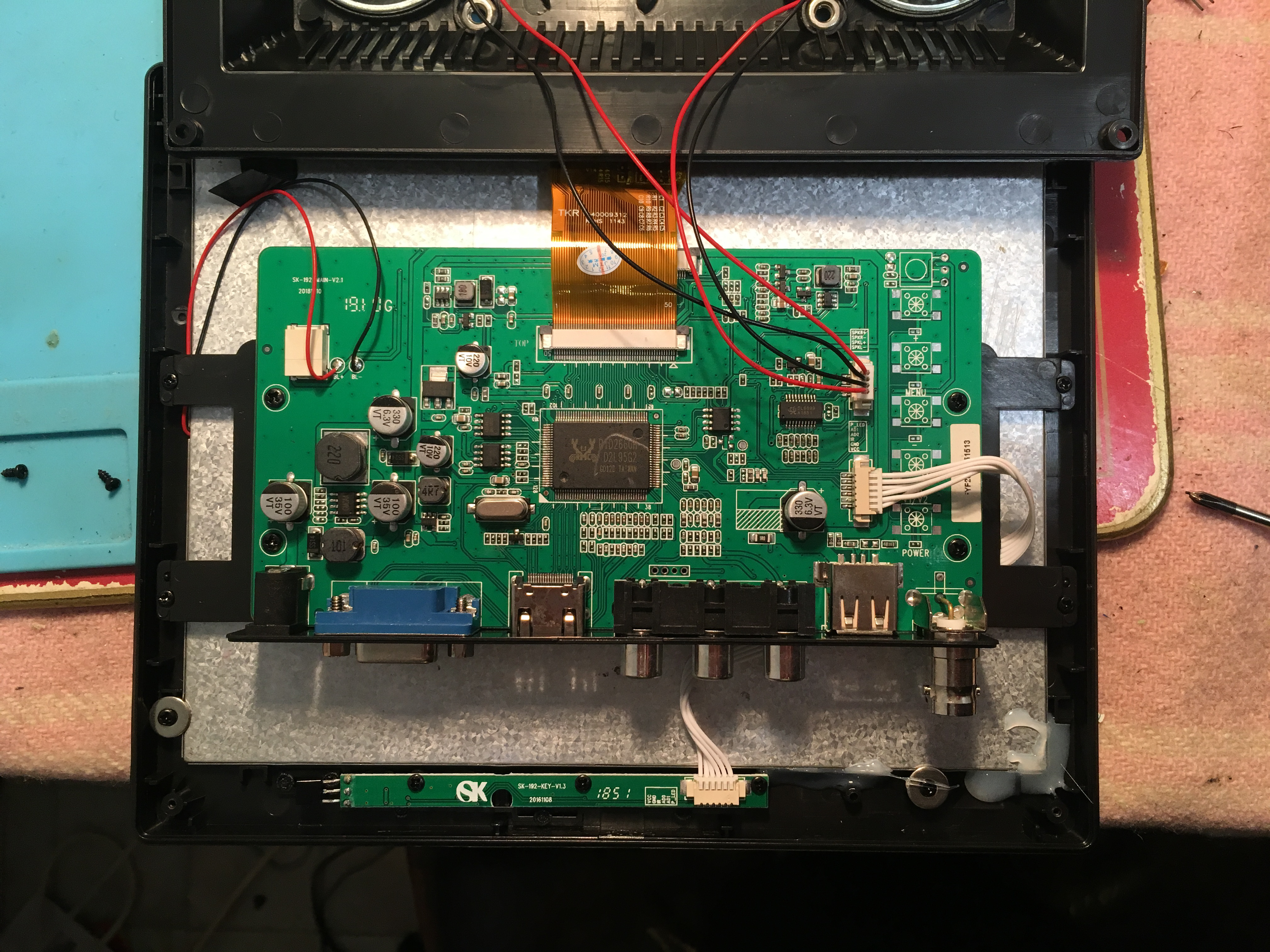

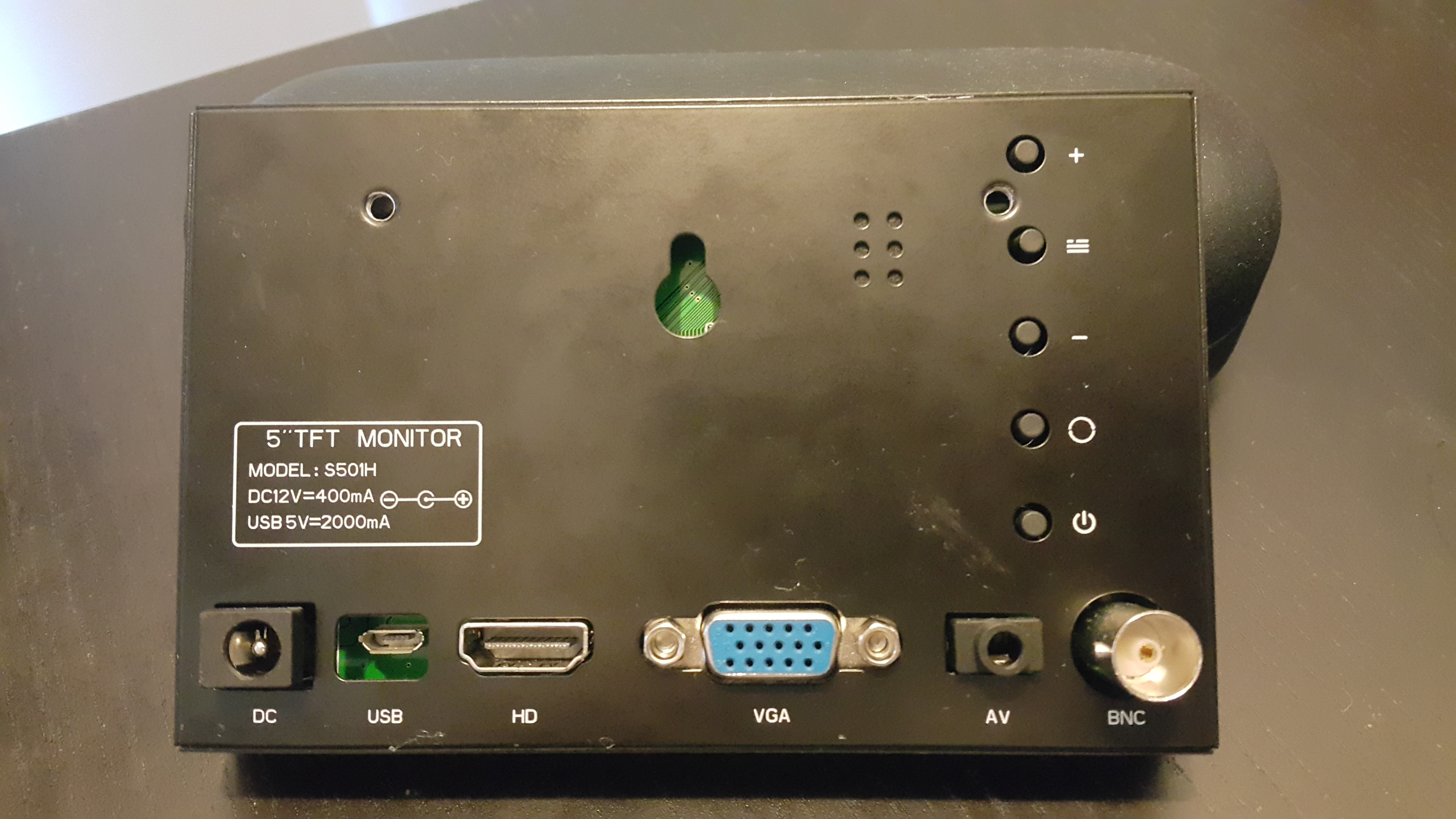

H and V sync are for VGA, you would connect to the VGA connector, or follow the traces back and connect to where they go. You'll also need R, G, and B if you want to get a video signal out of it too :P

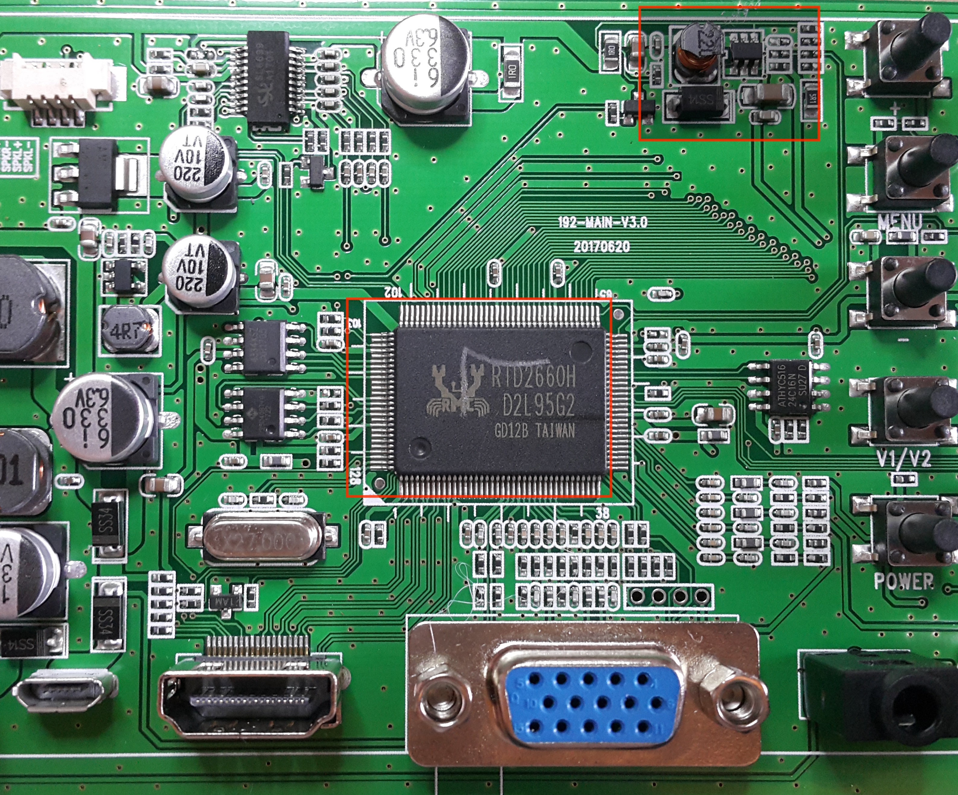

can i use this vga scheme on any board that has this same chip model?RTD2660H?
I'm wondering how to install component video on ps2 portable on controller board
This particular board apparently has a quirk in that the RGB pins are out of order, and what Cheese posted is the typical pinout.
If you had this exact board, Stitches picture is the one to follow.
But if as you say you have another driver that happens to use the same chip, it doesn't stand to reason that the driver would *necessarily* have the same mistake - I would default to using the correct pinout unless I knew otherwise.
Side note, you seem to be using the terms VGA and Component interchangeably and they're not quite the same, as Cheese noted, VGA uses H and V sync in addition to RGB.
Hope this helps!

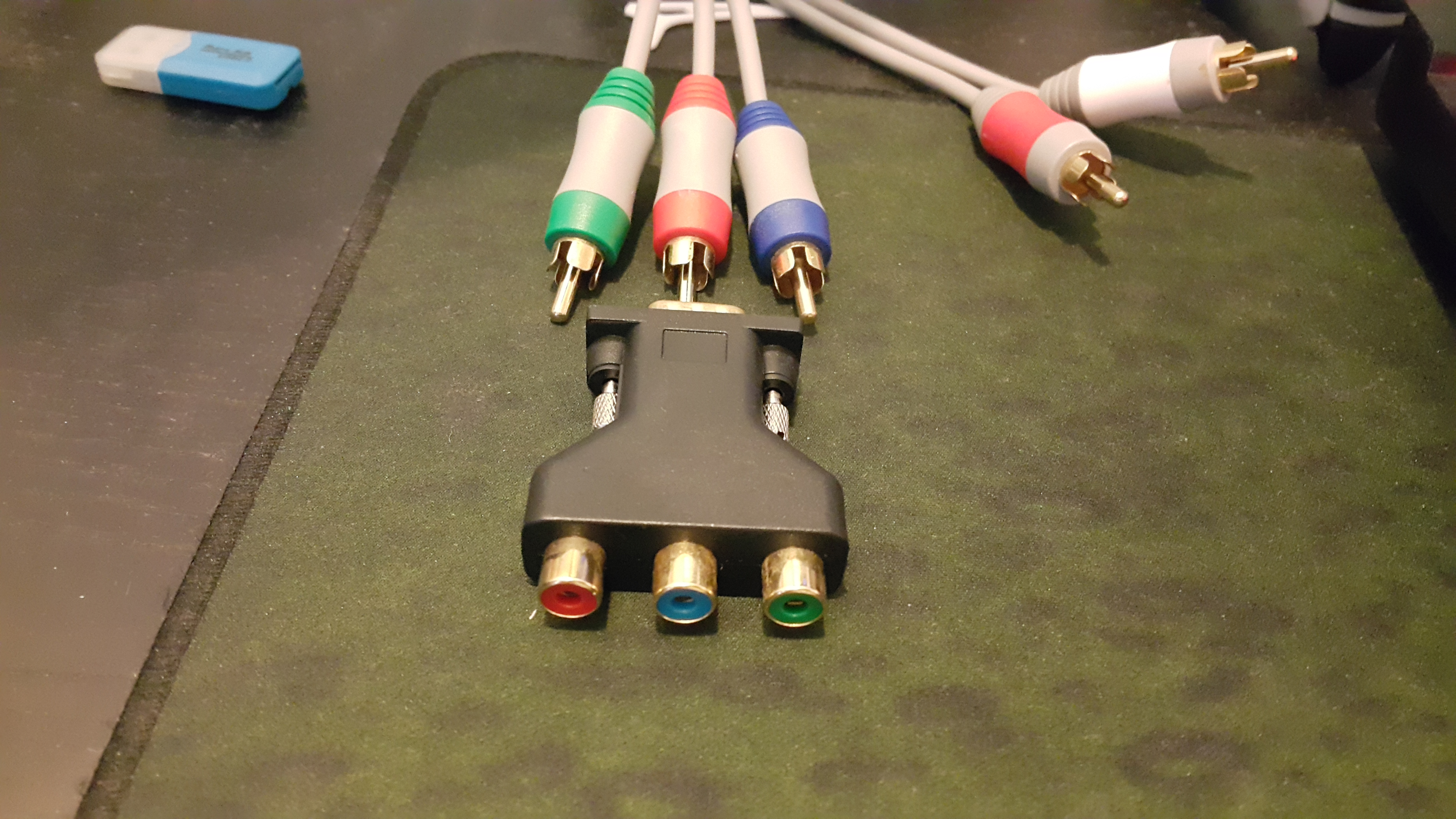

Just to confirm, VGA input uses the "correct" typical pinout as shown in any VGA diagram out there. It's just the component input mode that they for some reason set the pins out of order

thank you very much, I understand only this board has a different connection, so I can use the typical pinout on other boards that have VGA with a chip model RTD2660H
Chip model is irrelevent. If it has a soldered in VGA port, the pinout is always the same. If the board uses JST connectors, the pinout will be marked in the silkscreen on the underside of the board

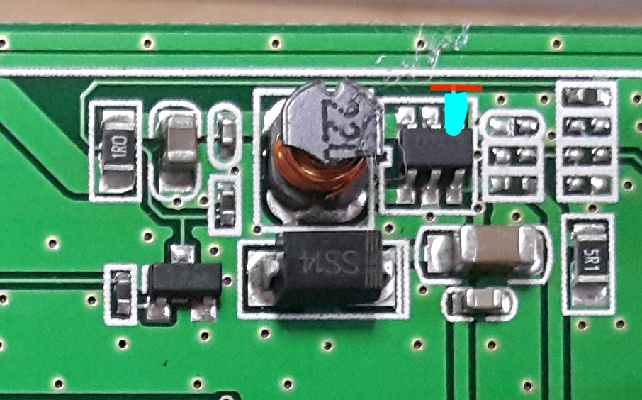

friend sorry to bother, but why did you circle that part in red and white?
I circled in green showing
Those are the right and left audio in points. Right is red and left is white, like standard RCA inputs
