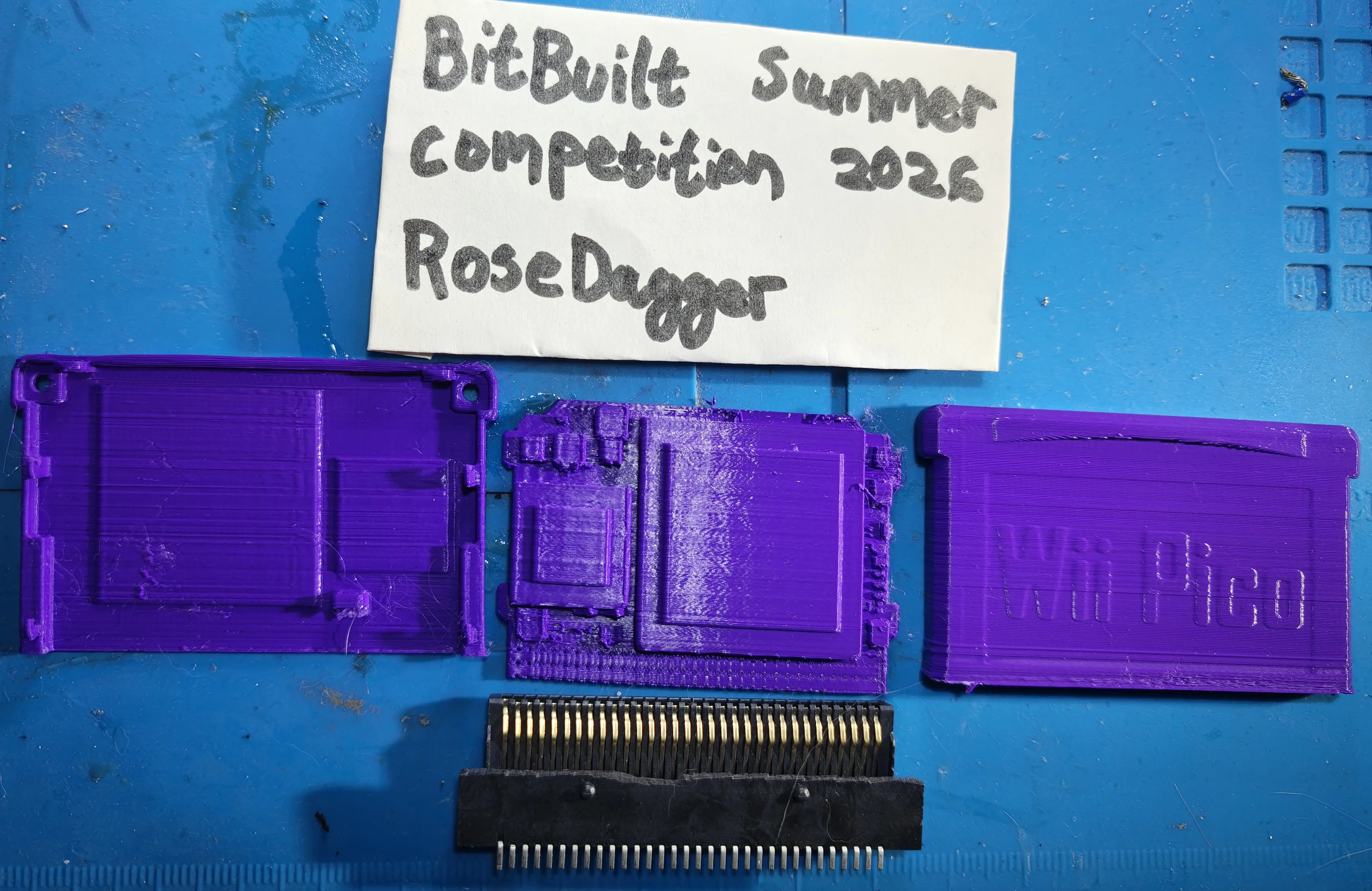

Completed [2026 Summer contest] GBAWii4 & Wii Pico, a redesigned Wii motherboard in a GBA Cartridge

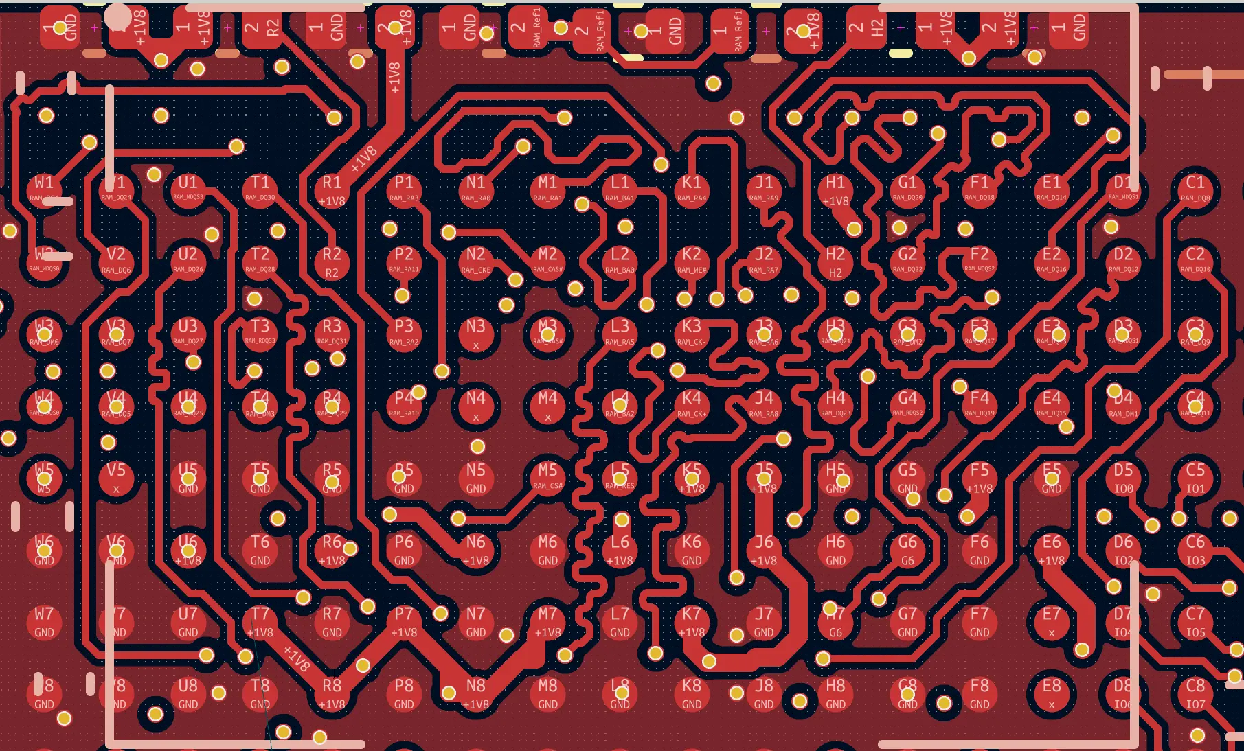

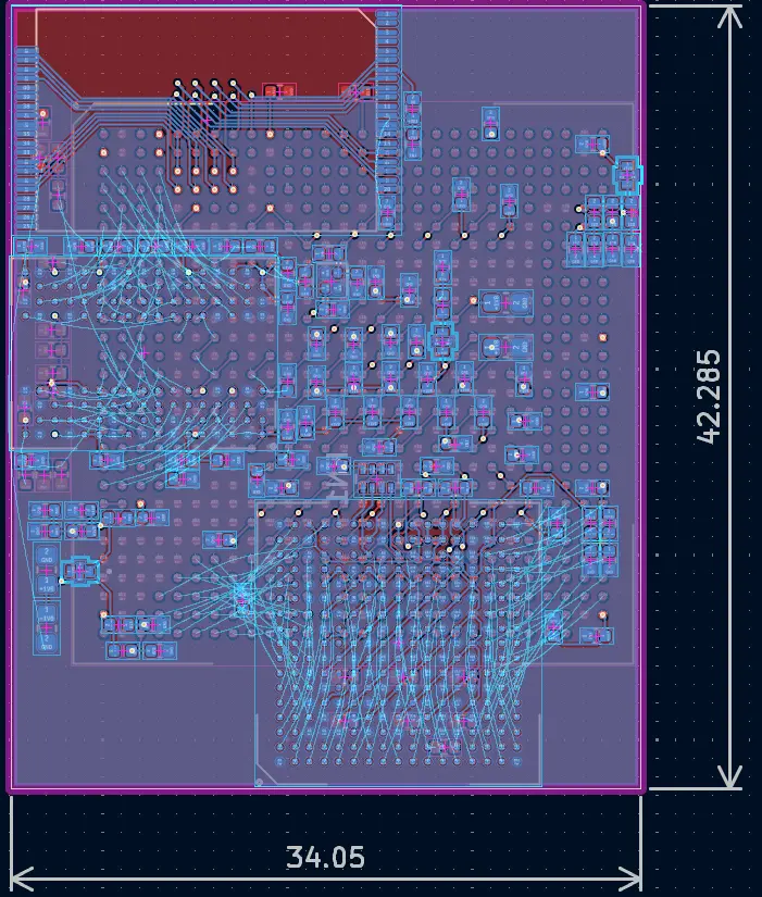

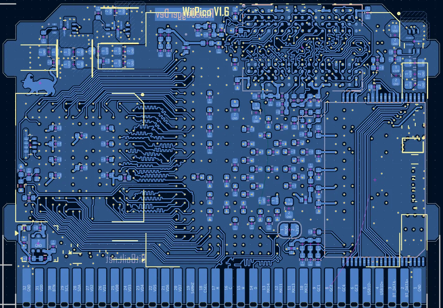

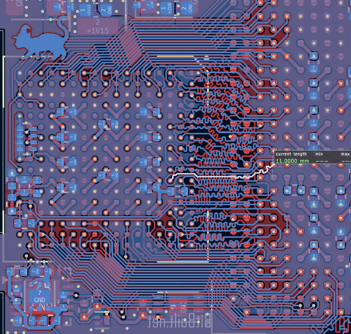

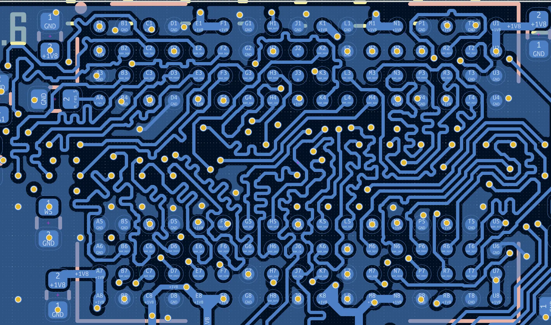

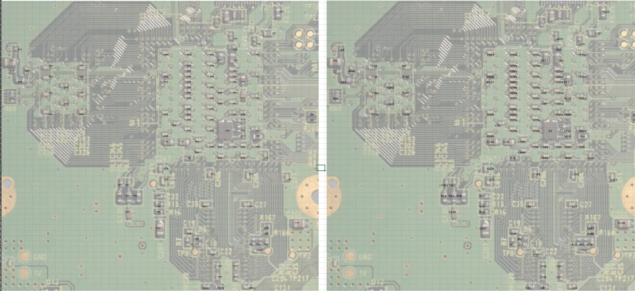

Quite a bit has happened since last time! First off after some back and forth I decided to make a version where the tracks were straight and not length matched. Primary reason being that skew would not be large enough to matter anyways, and it would let me spread some of the traces further apart to limit cross coupling.

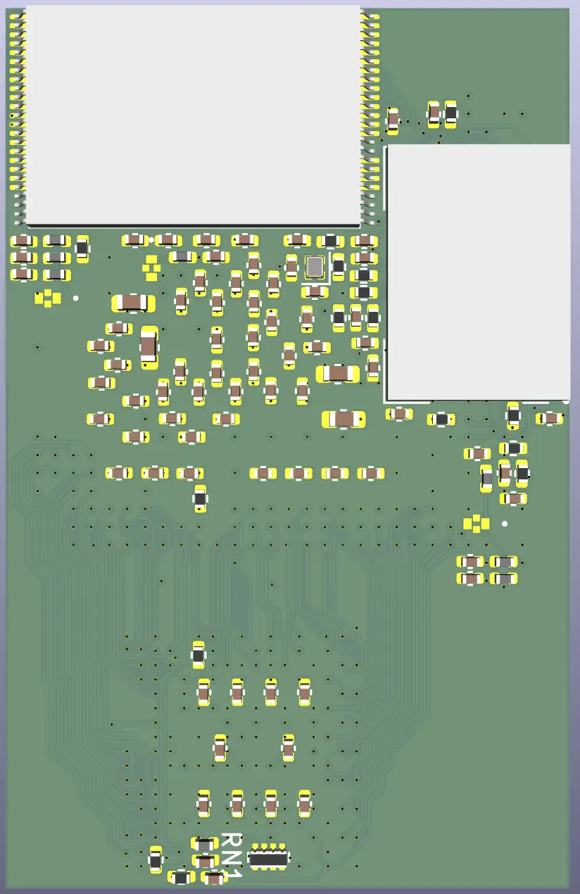

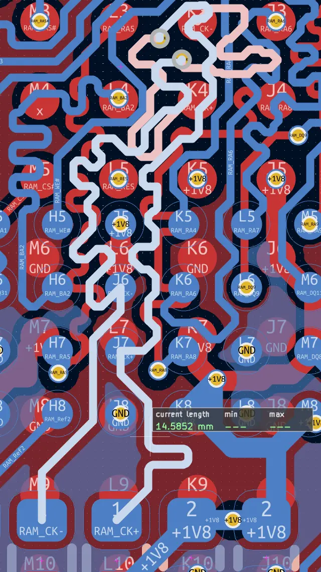

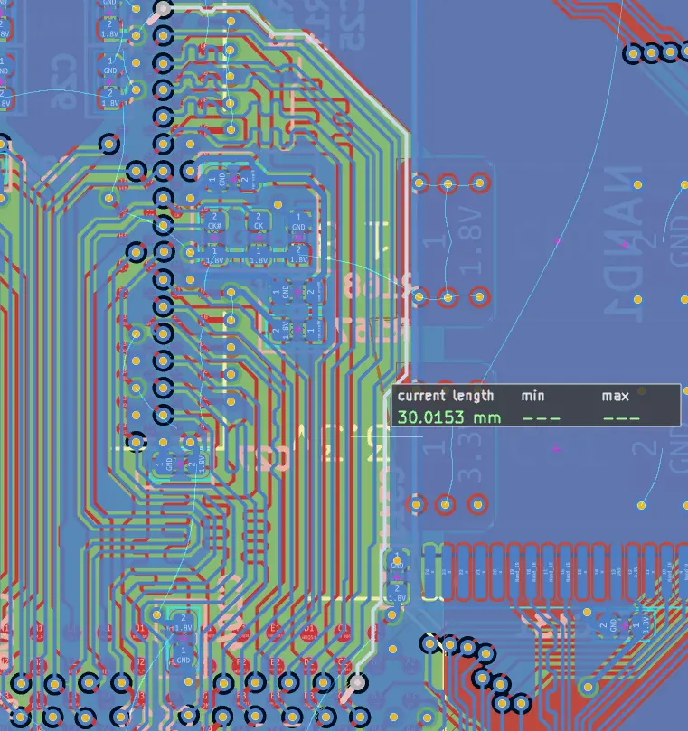

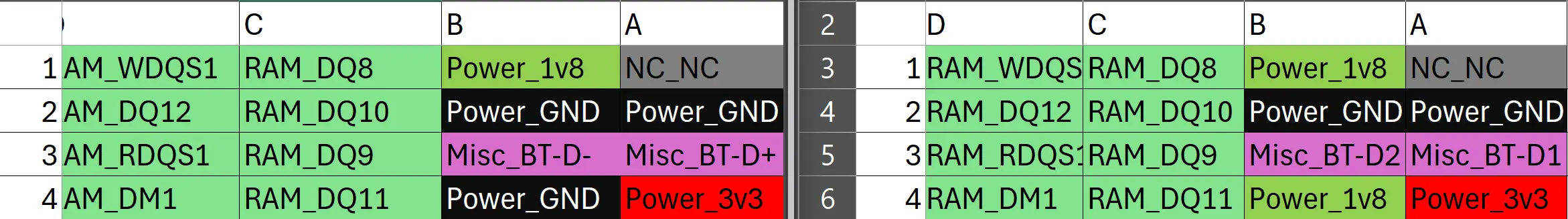

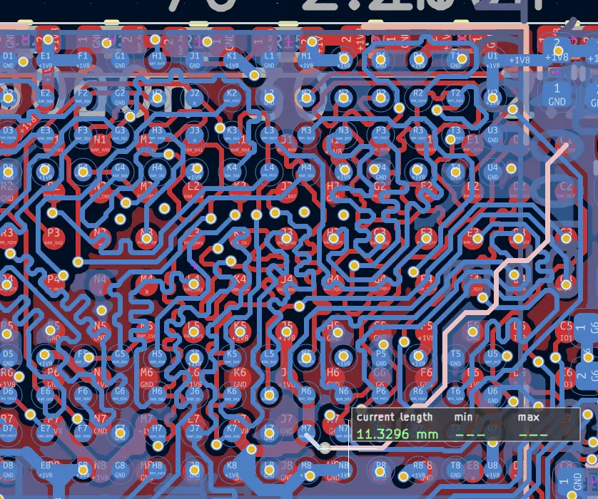

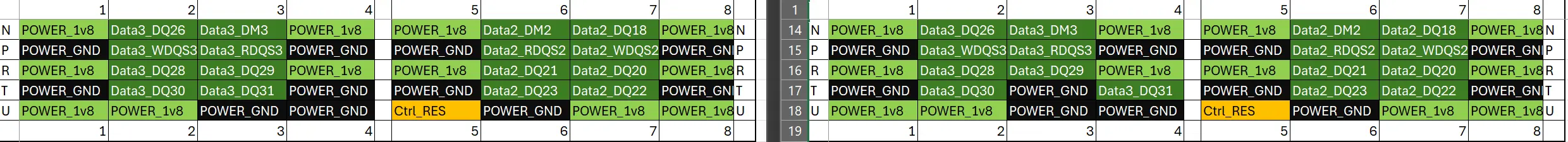

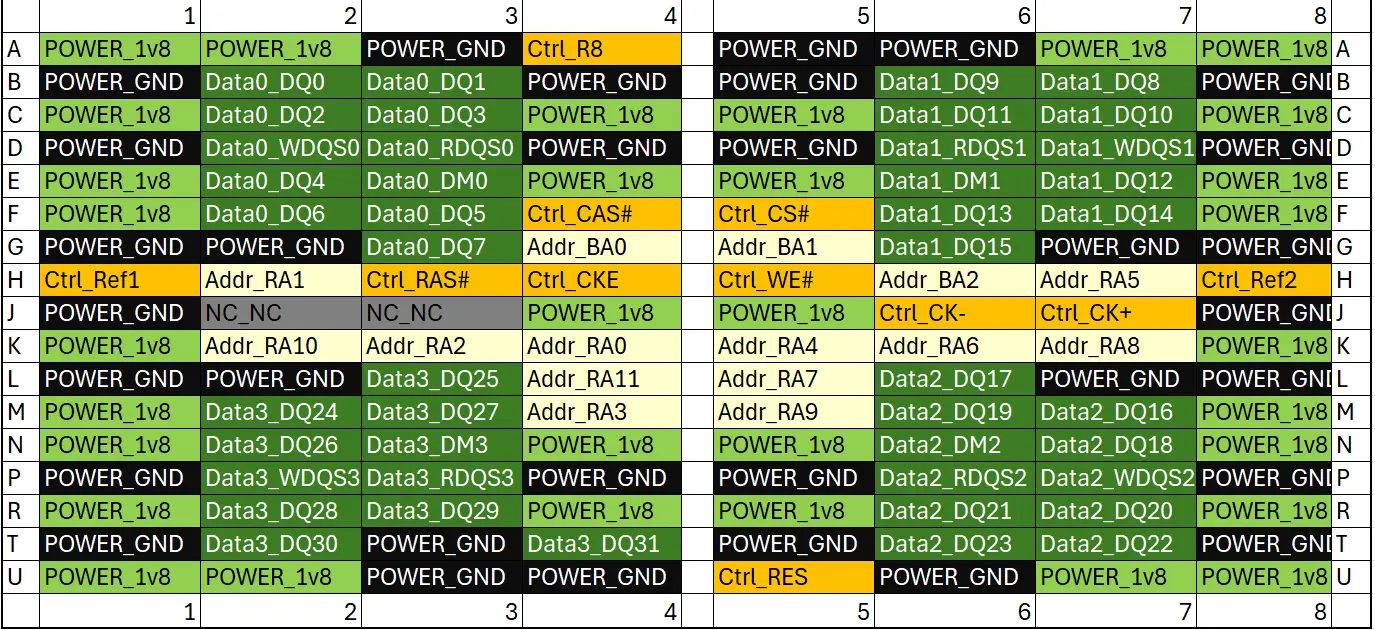

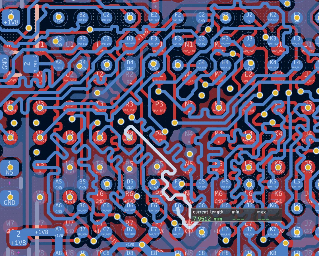

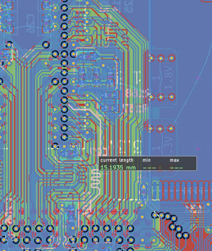

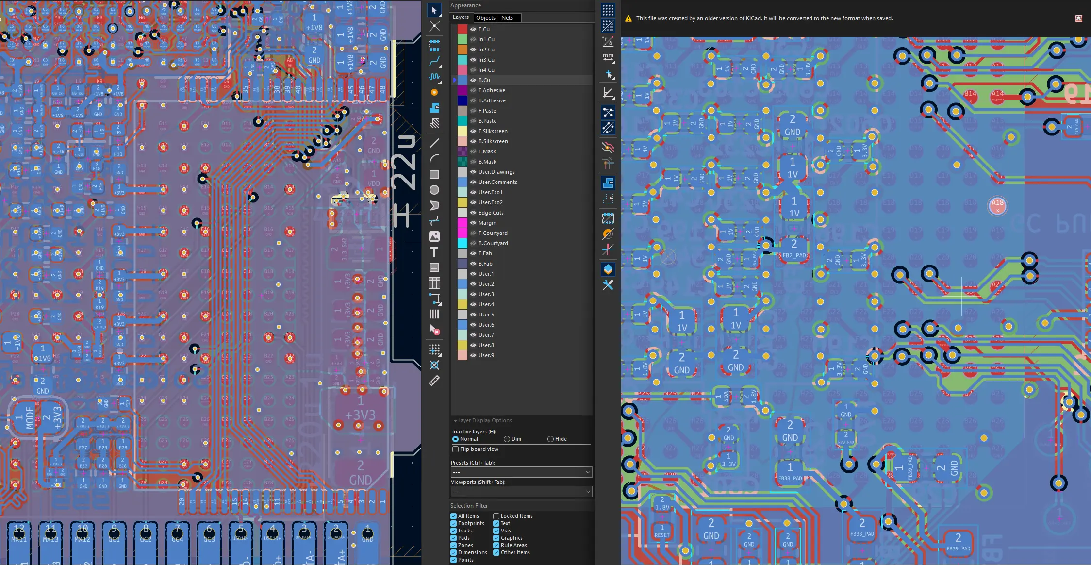

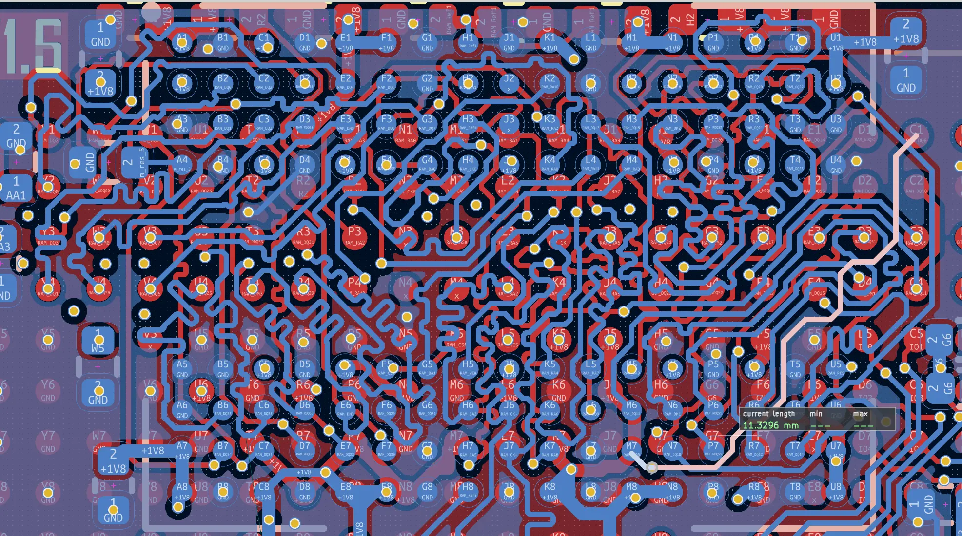

However, being stubborn and not wanting to admit all the time I spent length matching was a waste, decided to just make a panel with both the length matched traces, and the straight traces, so that I could test both XP

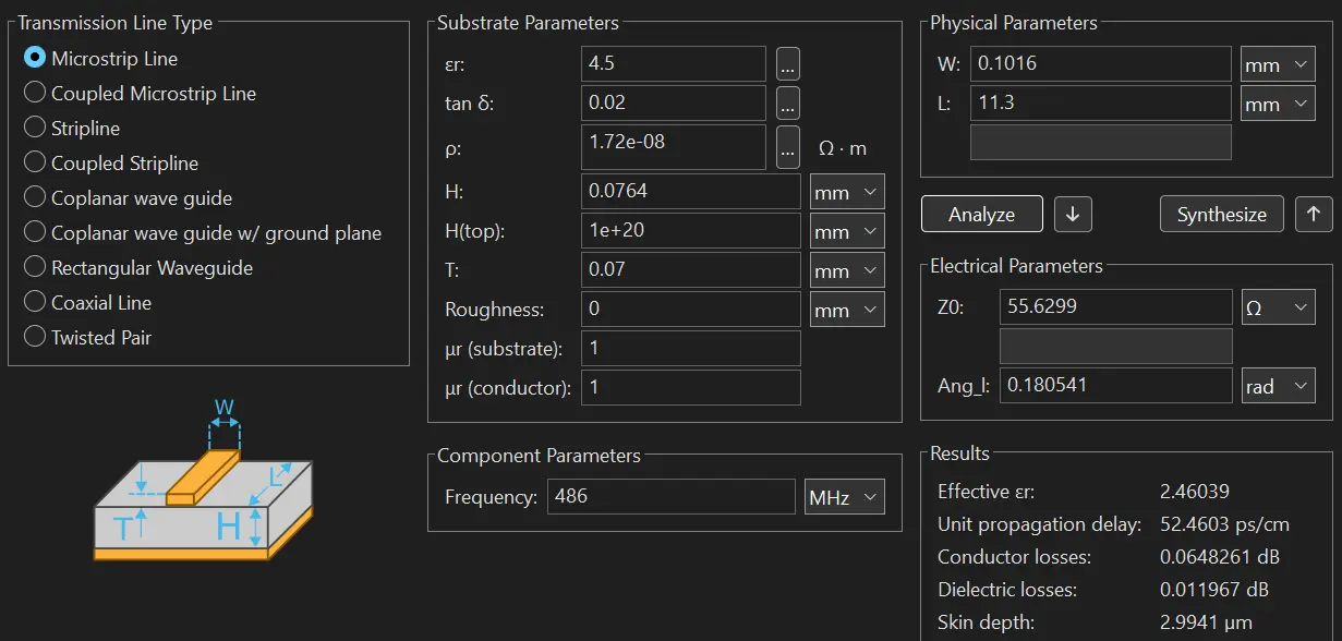

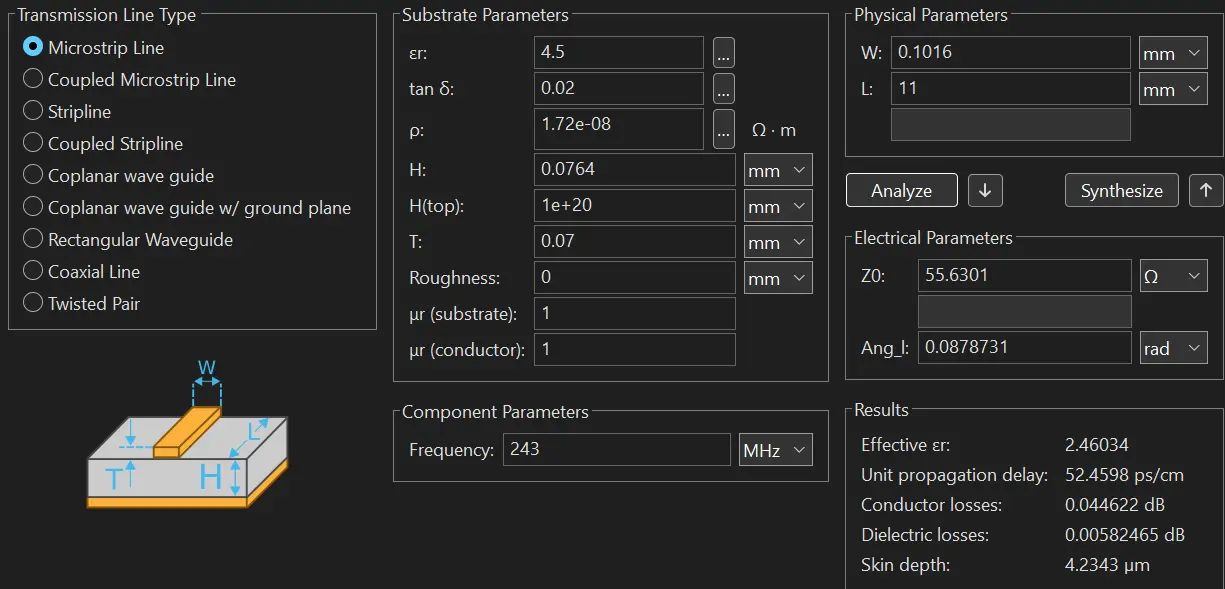

I’ll include a detour into impedance matching, that turned out to be irrelevant, and can be skipped if you don’t care XP

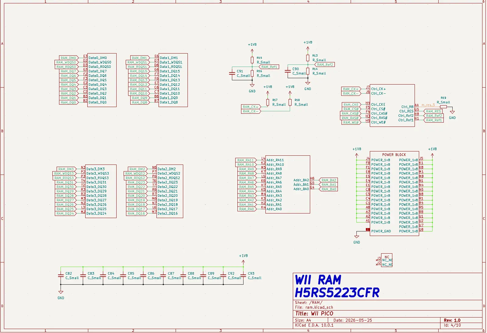

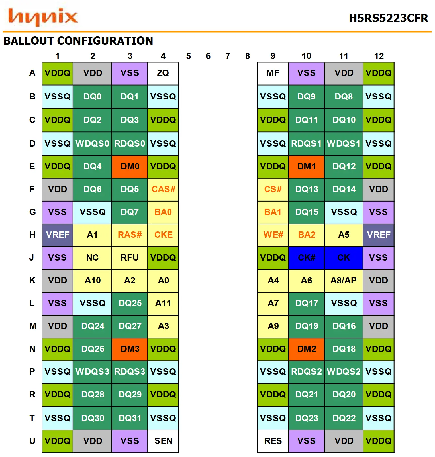

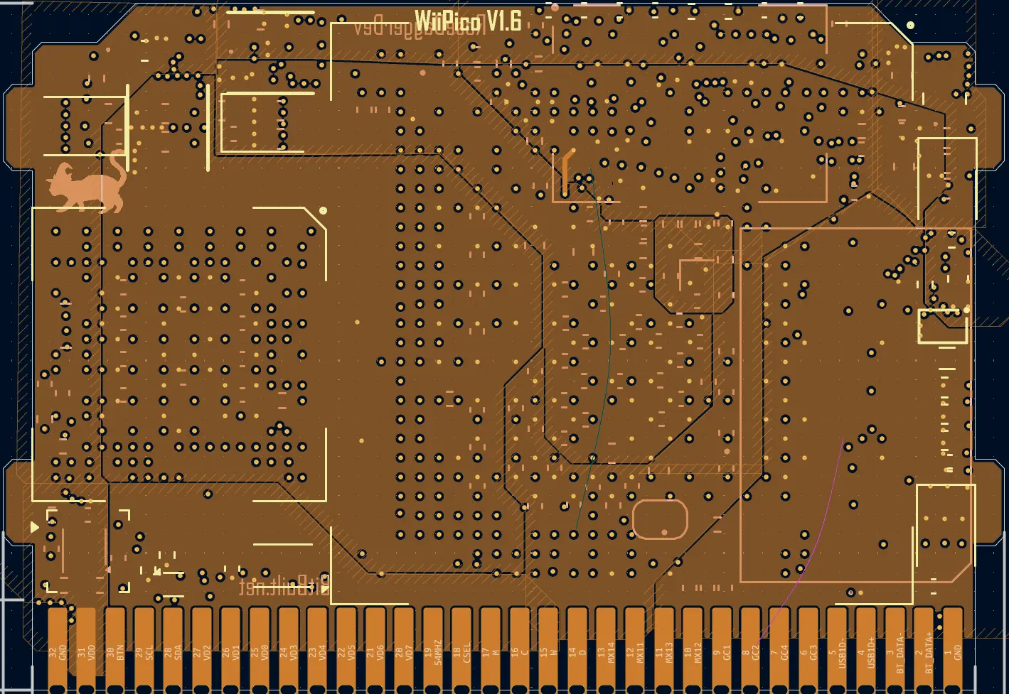

I found the calculations for the impedance for the ram, which was set to 45 Ohm +-10%. While the PPC750 which the CPU is based on also mentions an impedance of ~45 Ohm. So, I went back to the calculator in KiCad, and double checked that with a 1oz copper weight, we would get 65 Ohm impedance on the traces, while a 2oz copper weight would drop the impedance to 55 Ohm.
Stock ZQ on the Wii is 270 Ohm, so the impedance is 270/6=45 Ohm. ZQ should be between 210 and 270, which is an output impedance of 30-50 Ohm (using +-10% for the extremes). Changing the ZQ higher could increase the impedance, but it would go outside what the ram is built for.
Meanwhile the Power PC 740-750 also mentions 43 Ohm without any option to change it the way the RAM ZQ can be changed.

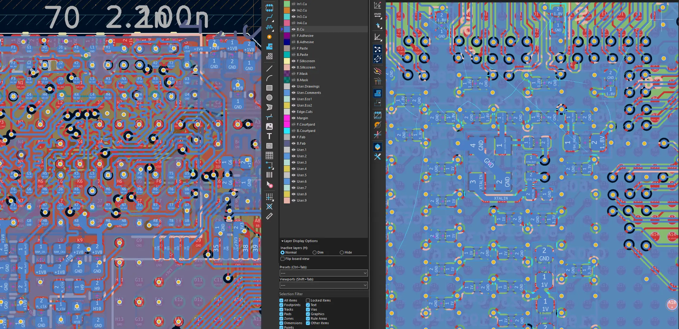

Rob’s recreation used 1oz and the same trace width, so he had it running with 65 Ohm impedance traces. However I got paranoid that since my design is so compact and deviates from the stock design so much, I though that maybe trying to go for a lower impedance might improve my chances, or at least not hurt them. Not that the lower impedance would change the cross coupling, but that if I had multiple noise factors, then removing the noise from signal reflection from bad impedance matching could improve the overall signal integrity. And it didn’t cost that much extra for the upgrade, so it seemed worth it.
However, I had forgotten a tiny little detail… Changing the copper weight changes the minimums… Instead of having a trace spacing of 0.1mm, I now needed a spacing of 0.15mm… Which would be completely impossible… That amount of spacing would mean you can’t snake traces out from the CPU pins. Maybe you can use lower minimums in BGA fanout, but I wanted to order the boards quickly, so I decided to drop it.

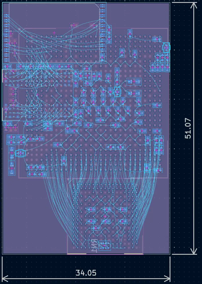

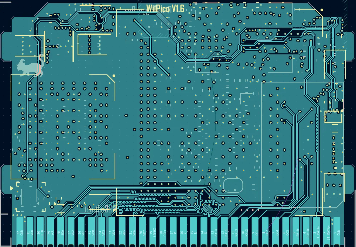

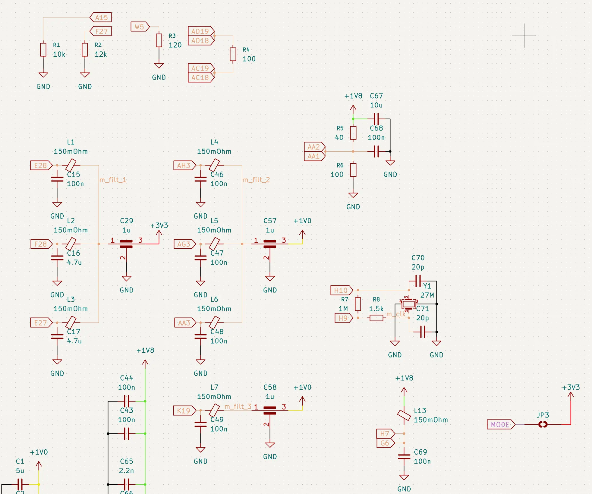

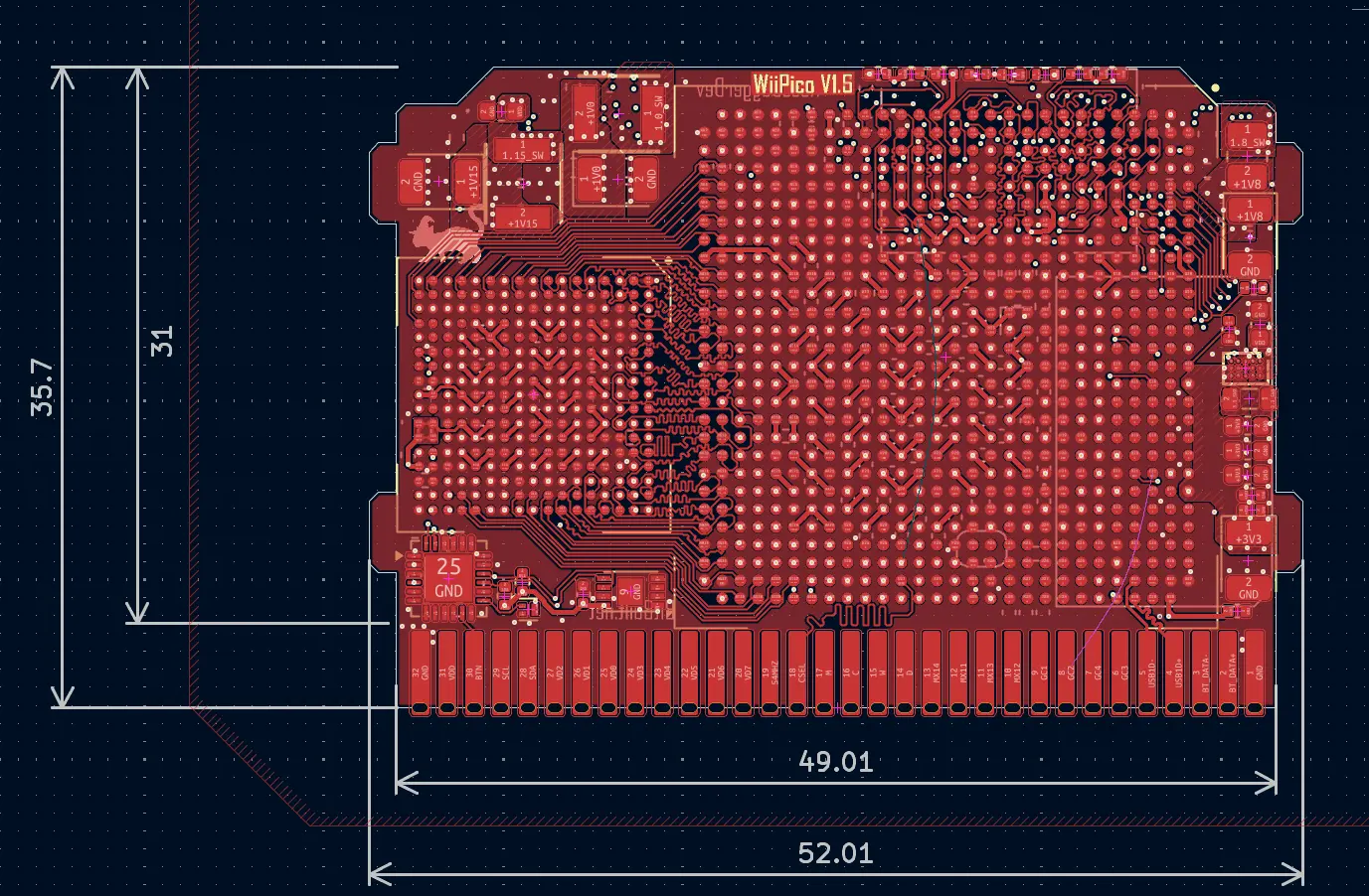

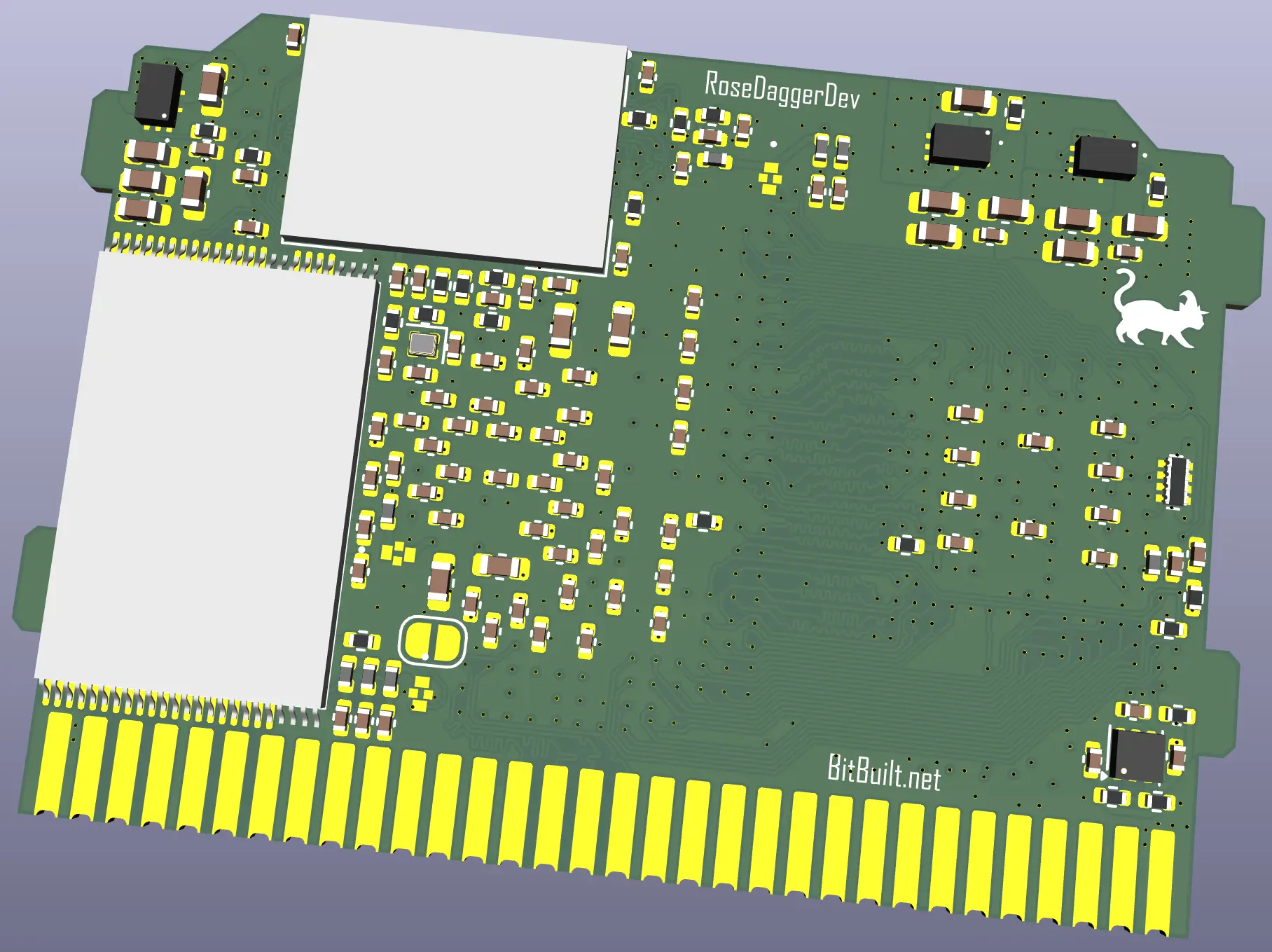

So, I felt ready to order, I had triple checked everything. Made both a length matched version and a straight version (during pride I know XP ), and made my own panel. I checked the design against the DFM tool for JLC, the uploaded the design and toggled all the important settings:
- 6 layer board
- 0.8mm board thickness
- 2oz copper
- The smallest vias JLC allows 0.15mm
- Castellated edges
- Color Purple!
And saw with dread how every option increased the price... But I decided to bite the bullet anyway!
JLC says their review should take between 10min to an hour… An hour came and went… Then two… I checked when they were supposed to be open, and they are supposedly running 24h during weekdays. So, I keep waiting, trying to busy myself with other things... It’s a complex circuit, it’s no wonder it is taking extra time… At the five and a half hours mark it finally went through, whoop! They up charged me more for the panel but otherwise seemed like I was in the clear, double whoop! So, I paid and went to sleep in the knowledge that everything would be fine.
Foreshadowing is a literary device...
Anyway... The next morning, I saw I had an email from their techs... telling me that with the 2oz copper I had ordered, I no longer met their minimums. This was apparently not caught in their initial review… I talked it out a bit on the discord before deciding to print a test print on 1oz instead and remove all the expensive options I could to bring the cost down.
So, I got rid of the panel, only ordering the straight ( :/ ) trace version, in 1oz copper, in boring green, and without castellated edges. It got the cost way down, and would make it easier to do a reprint in case I'm not a goddess of perfection XP , and there were any issues which slipped by.
Then in intensely waited for a week till the boards arrived on Thursday XP

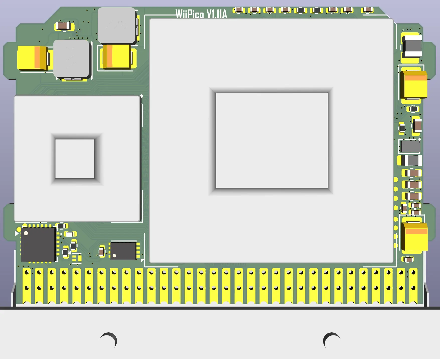

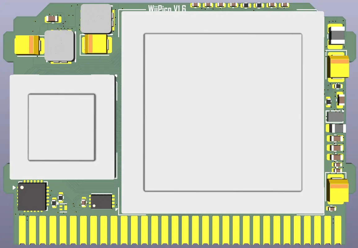

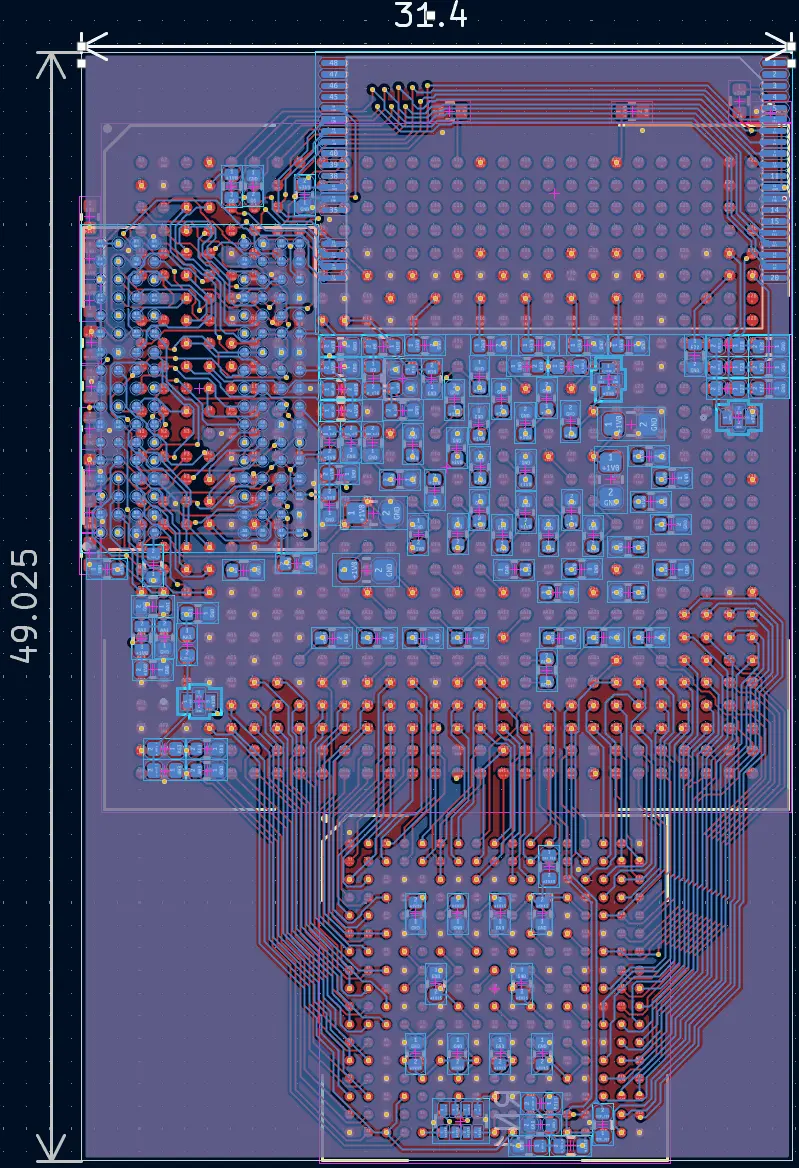

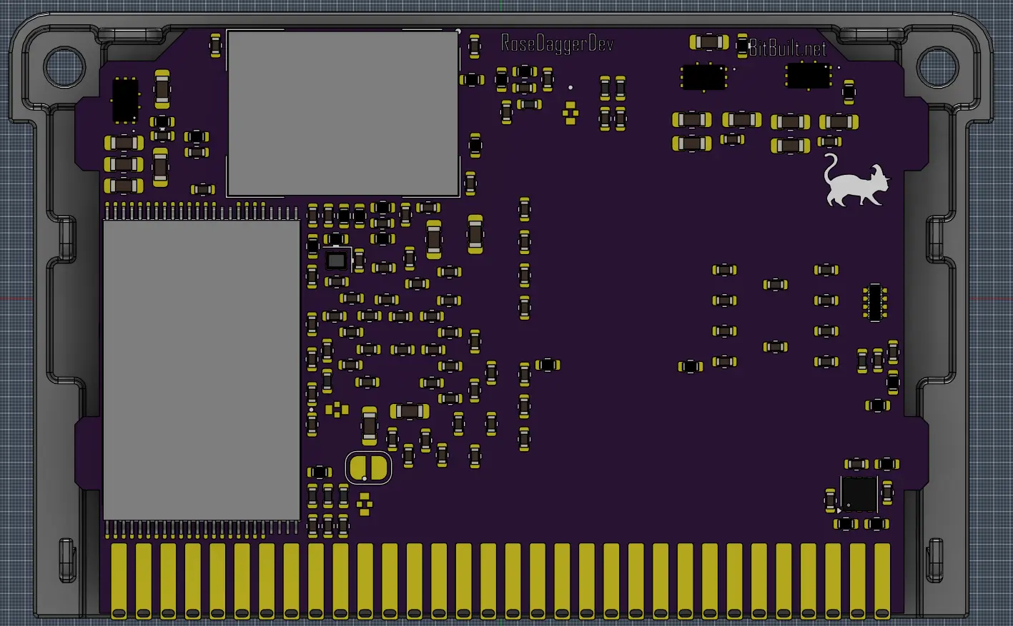

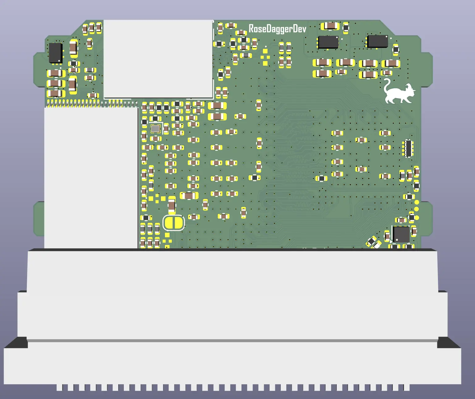

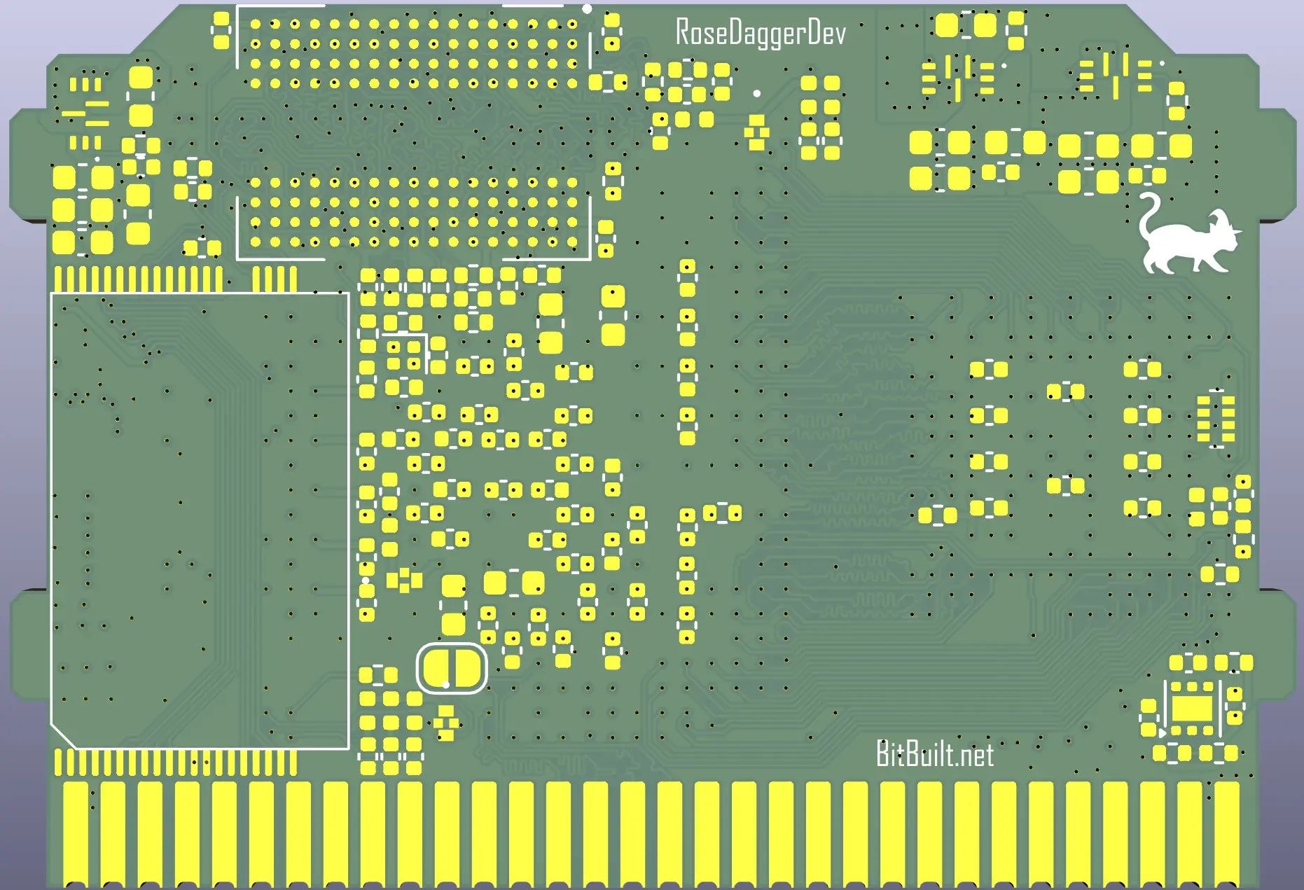

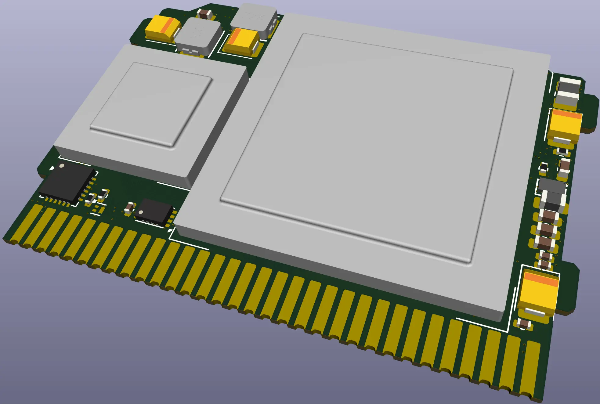

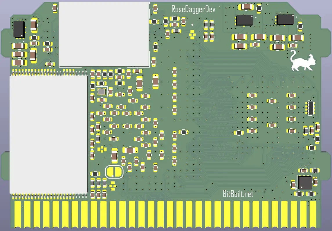

They are kinda scary small the PICO is! And it turned out quite well even if it isn't purple ^^ Though I missed out on putting “2026 Nintendo AGB-RVL-01” on the bottom silk screen. But maybe for a second print if I needed it.
This weekend I started soldering, focusing on the back. However, I discovered that I had ordered the wrong feedthrough caps, ordering 100pF instead if 1uF. I have no clue how I picked the wrong size that badly... So got to make another order and get the right ones this time. Good thing I almost never make mistakes XP
I had planned to be stubborn and just use the regular Hollywood 1 from the regular wii I just got for this. However I was convinced on the discord to not be stupid and to just order a Mini so I can get better thermals and better undervolting. Thanks everyone ^^ And thanks to flux_sniffer for helping me on how to source the correct mini version ^^

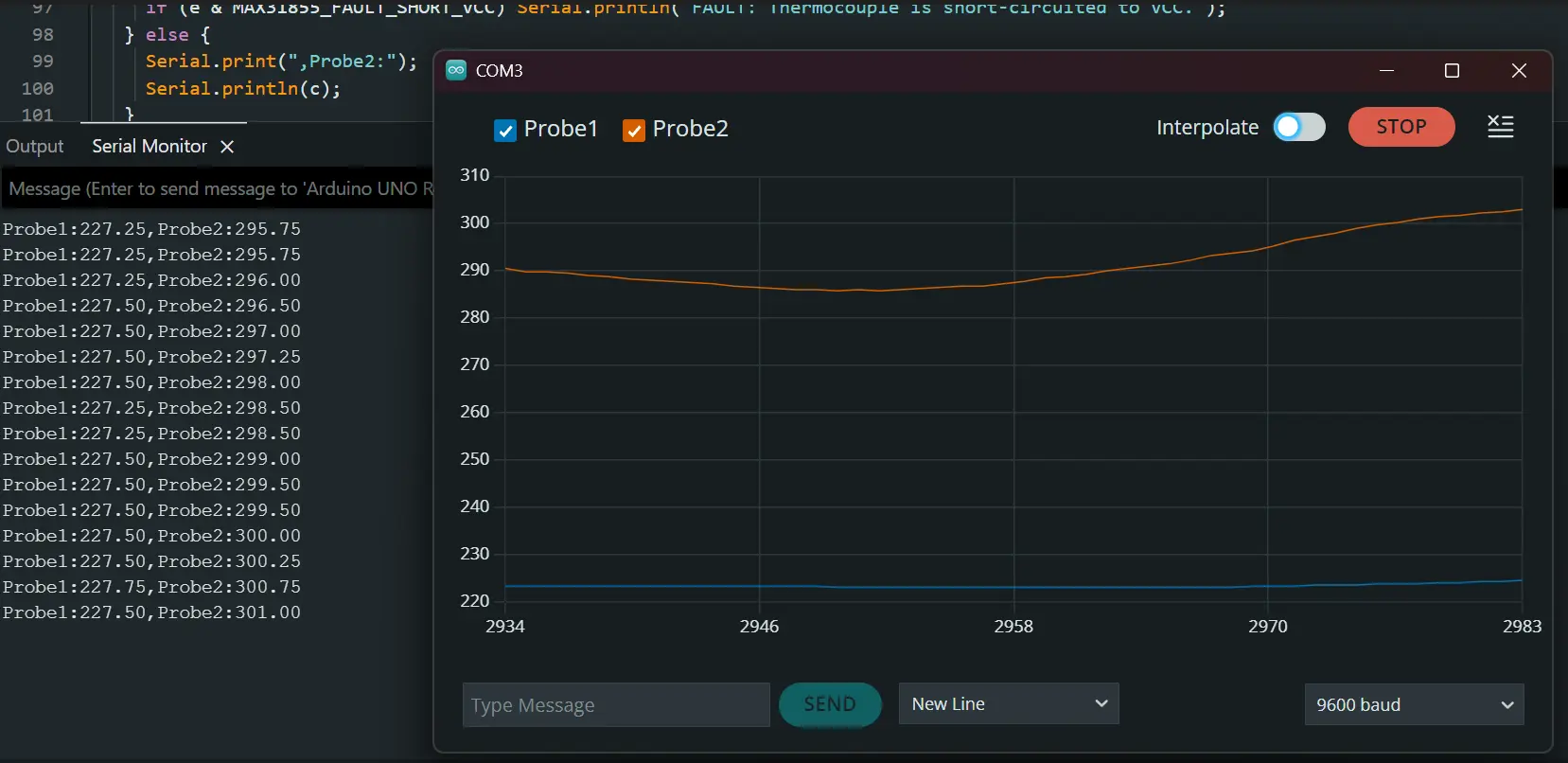

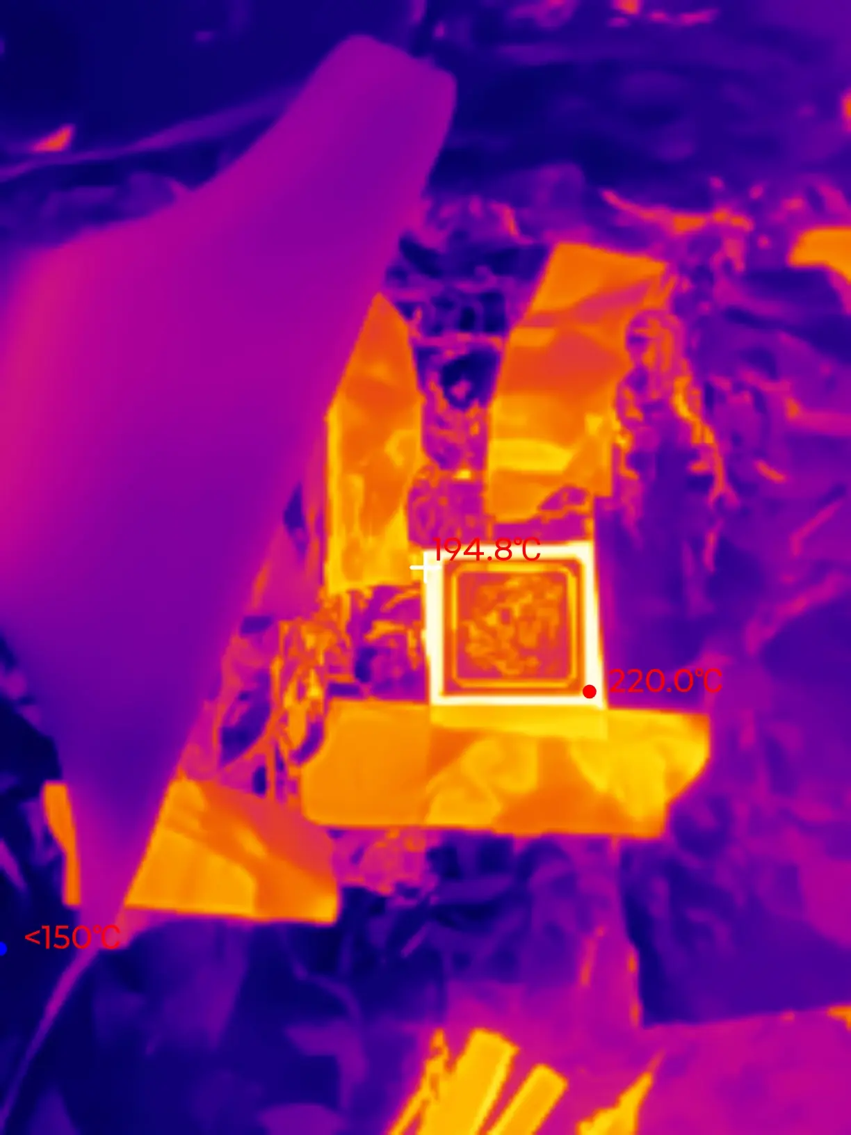

As for the actual reballing process… Lining up the balls is fine, but getting them to melt into place without moving using hot air is kinda a pain. So I decided to cheat XP I decided to try and build an IR top heater so that I could melt the balls into place without hot air. I found a guide, the components, some aluminum extrusions to make a thing to hold it, ordered everything, and felt quite clever about myself finding a way to avoid doing something really difficult XP And I do a lot of smd soldering so it felt like an investment regardless, just putting my boards under the IR top heater to melt everything all at once as if I were baking the board.
However… The IR top heater never arrived… Ali Express says it did, but it ain’t here :/
So, I guess I have to keep practicing with hot air till I get the skill down...

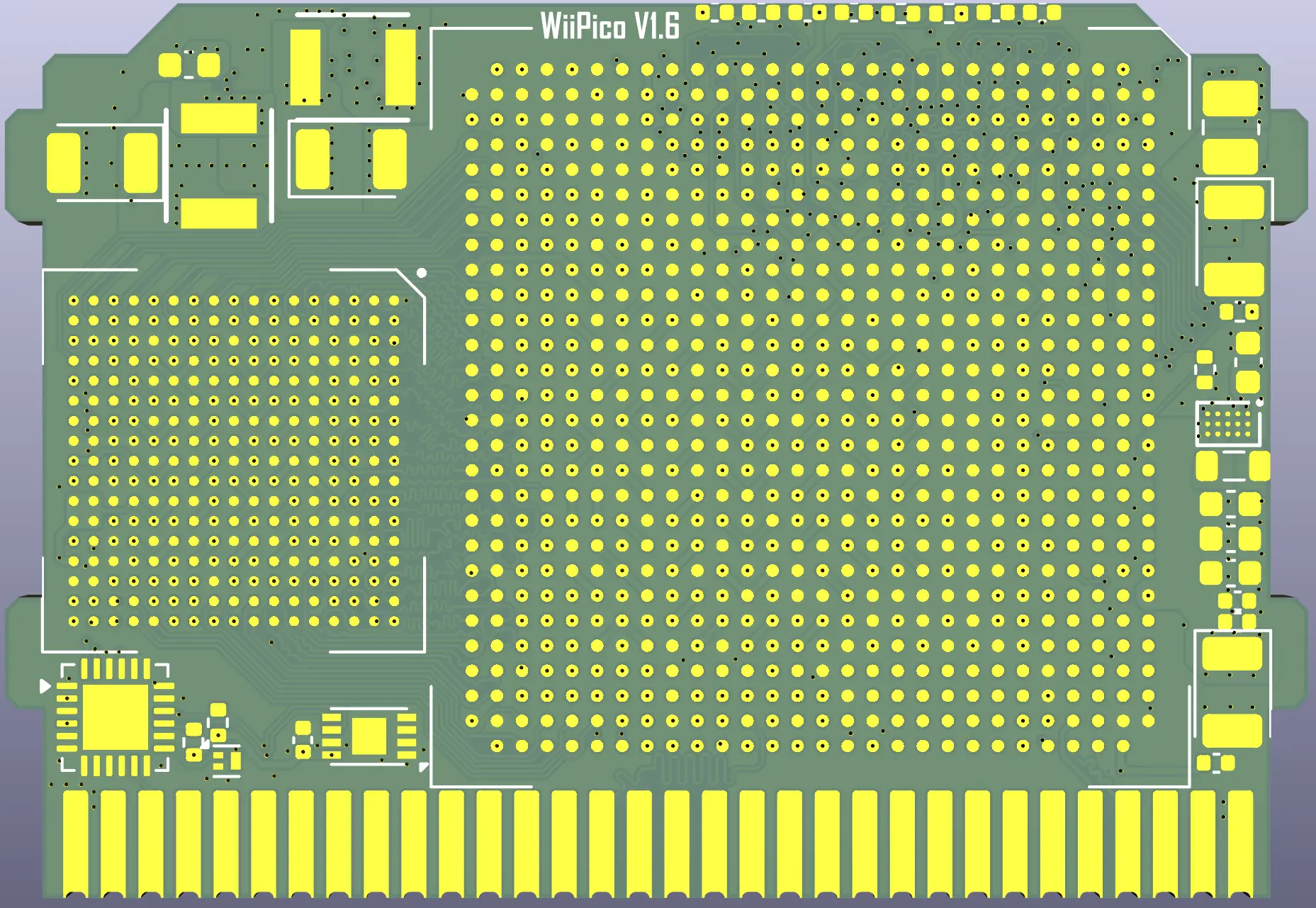

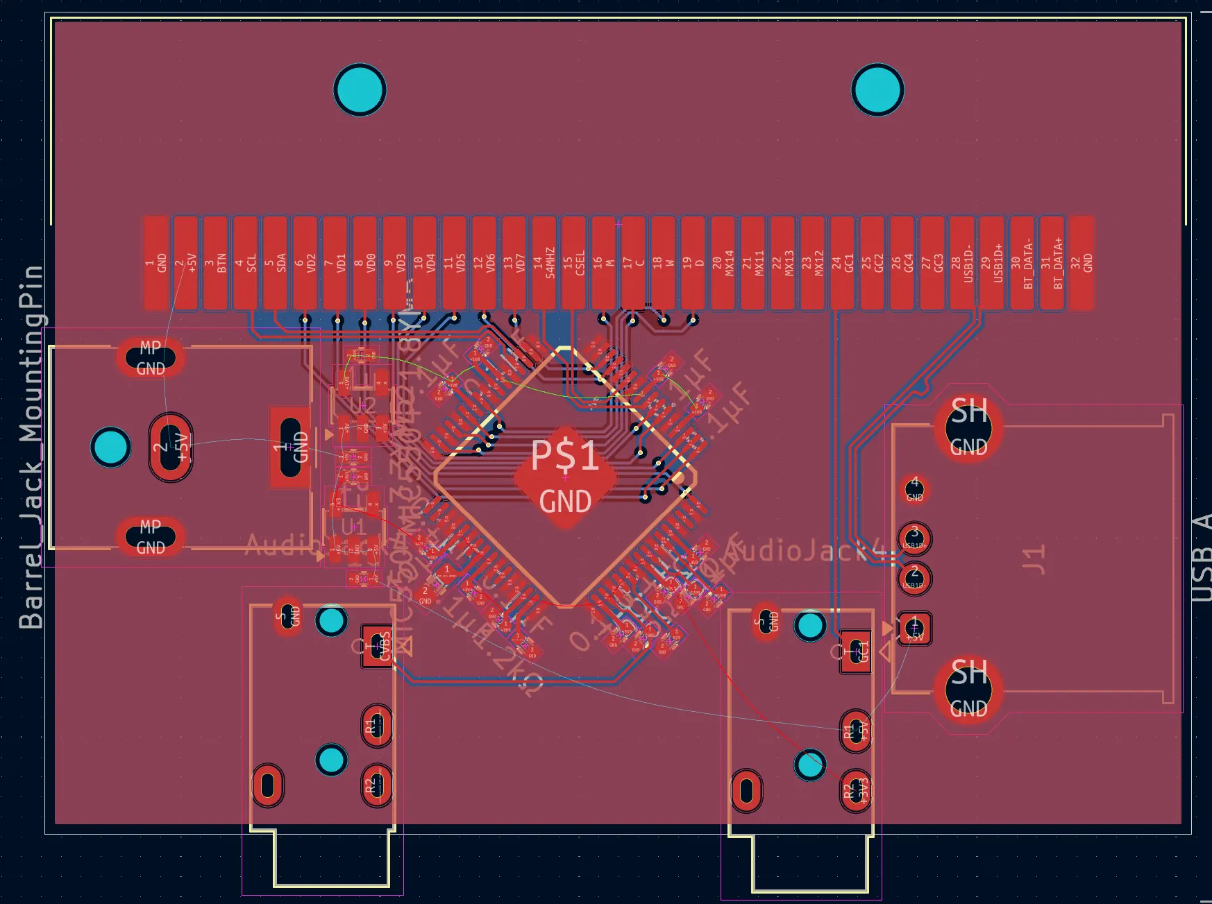

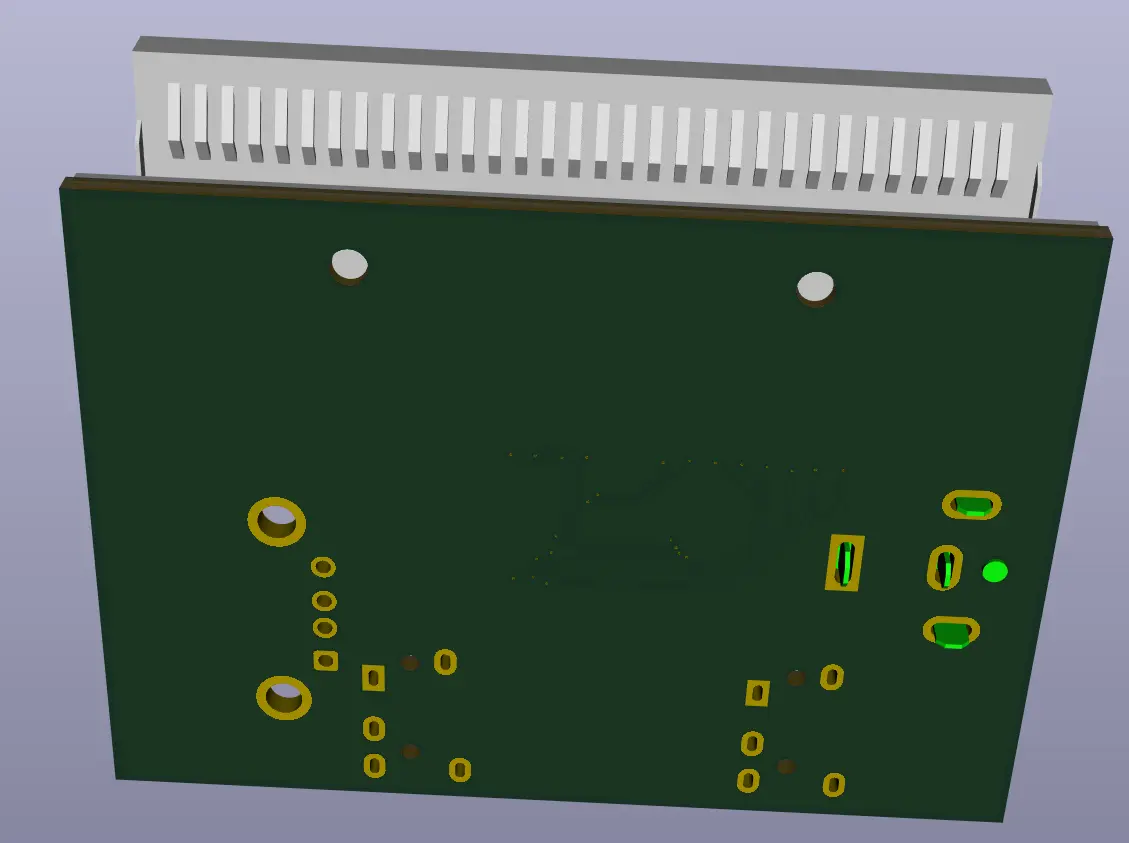

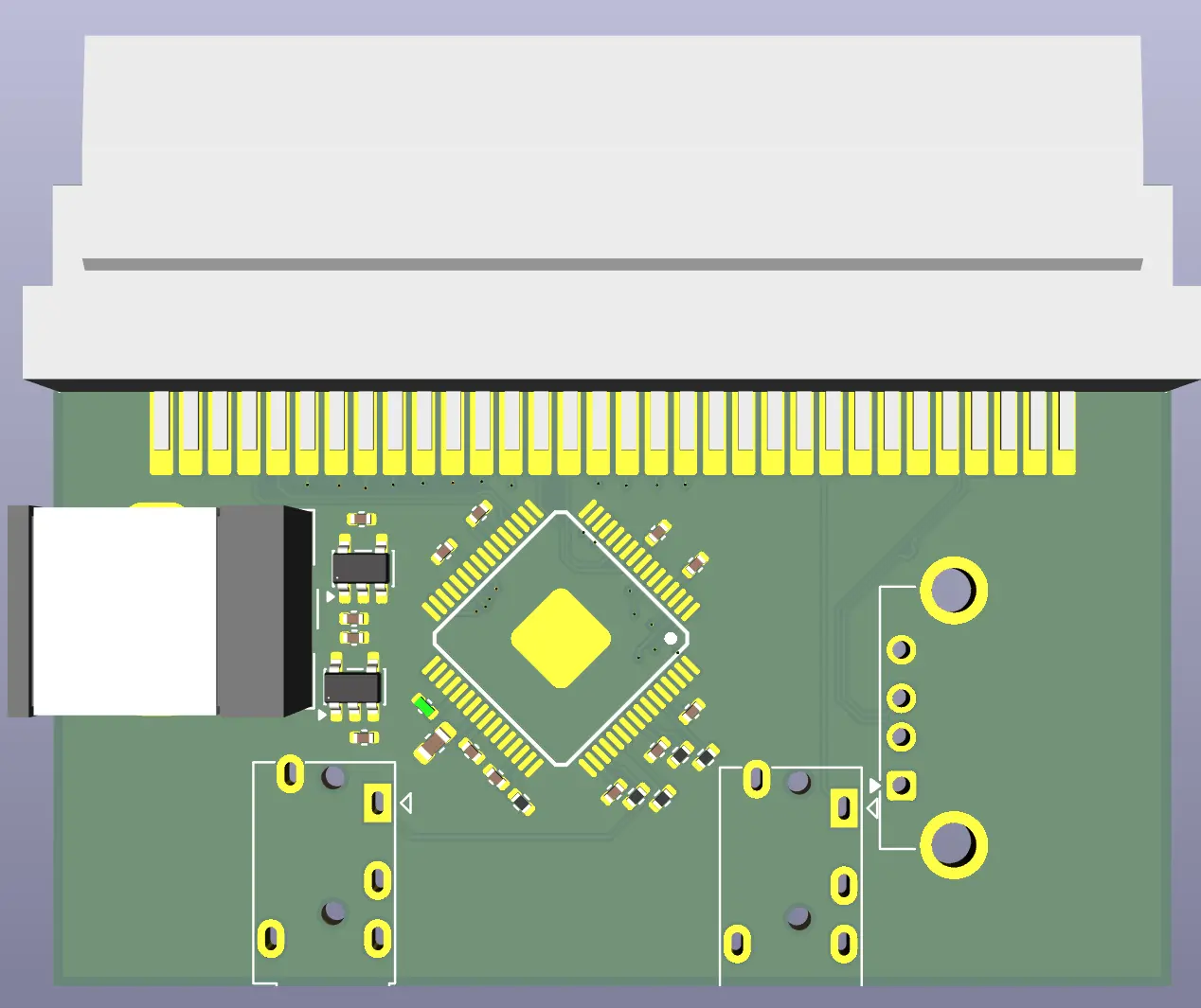

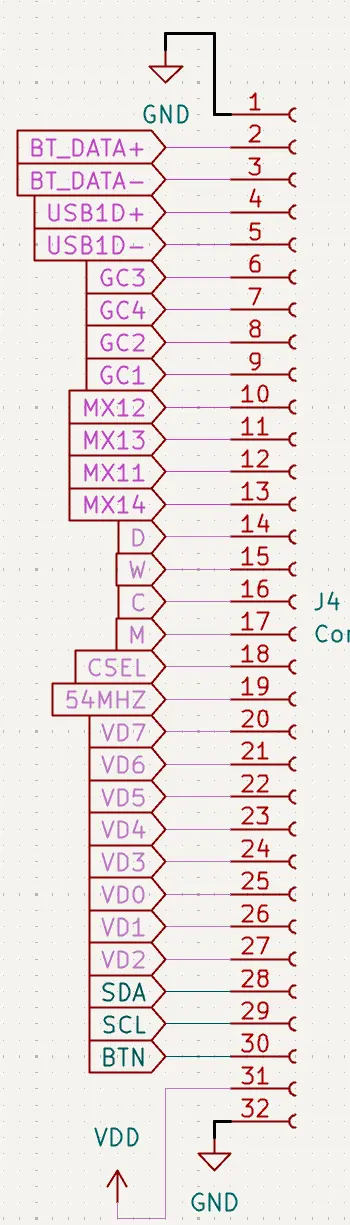

Along with the main PICO board, I also ordered some cheaper 2 layer boards, including a simple test dock which fits the AVE, and some regulators, and other simple features. It’s there to power the PICO and to get the graphics data out, so that I can test if the boards works when I finish soldering it.
I plan to make a nicer TV dock, and the GBA handheld dock later, however I first need to test if the PICO even works to begin with.

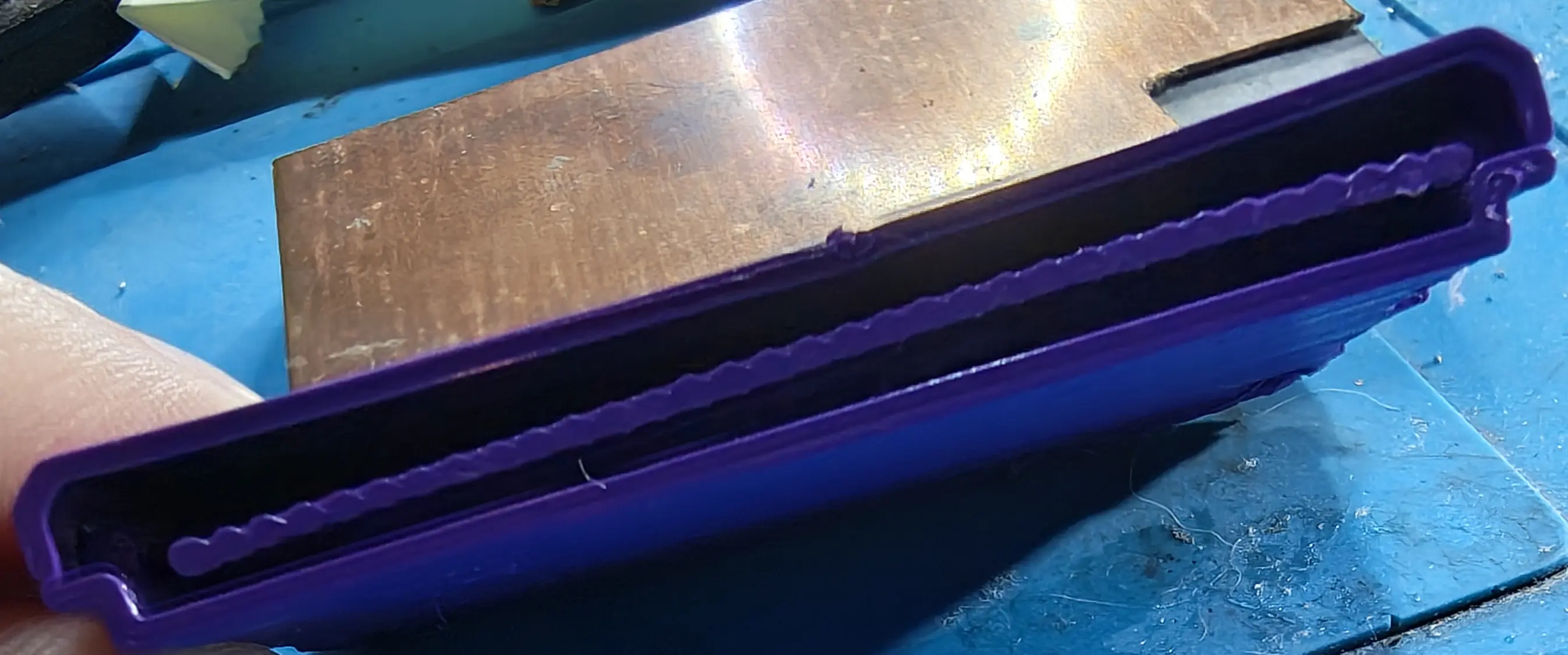

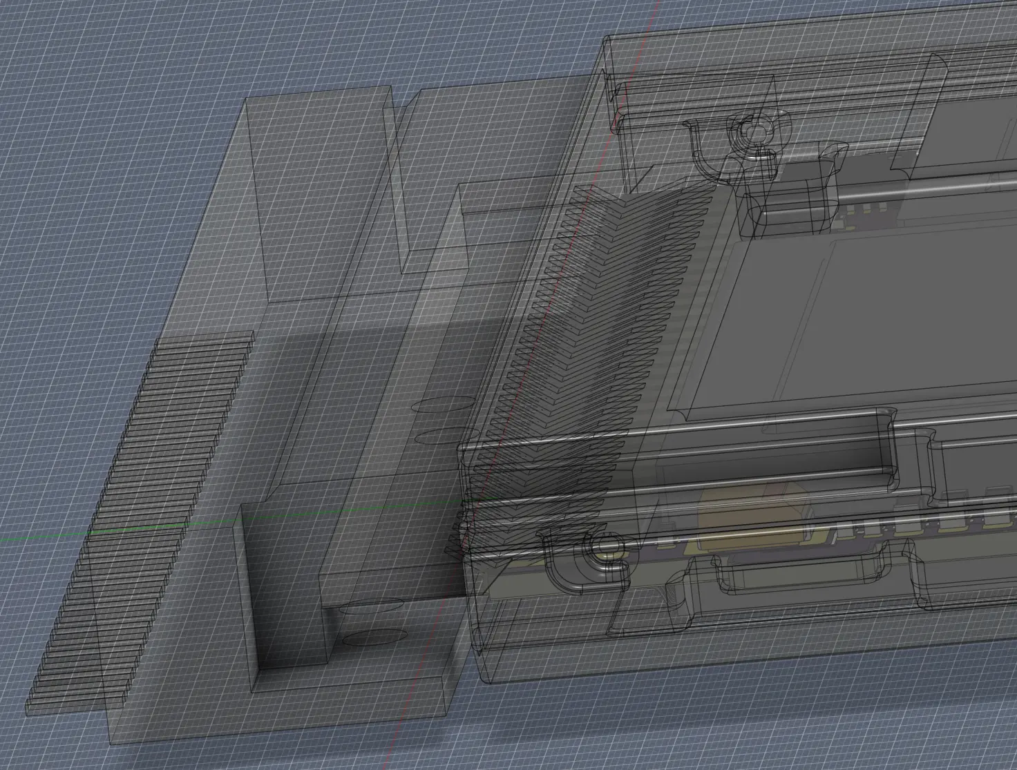

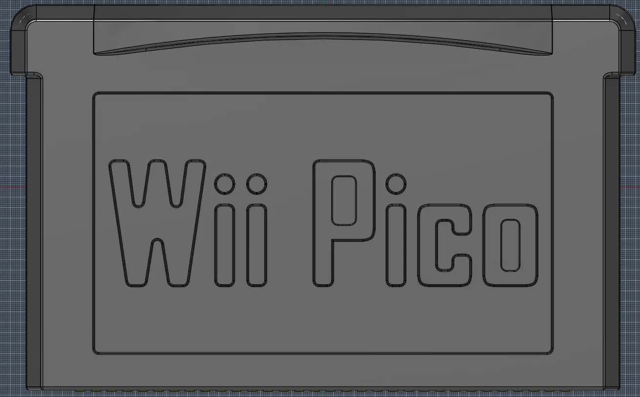

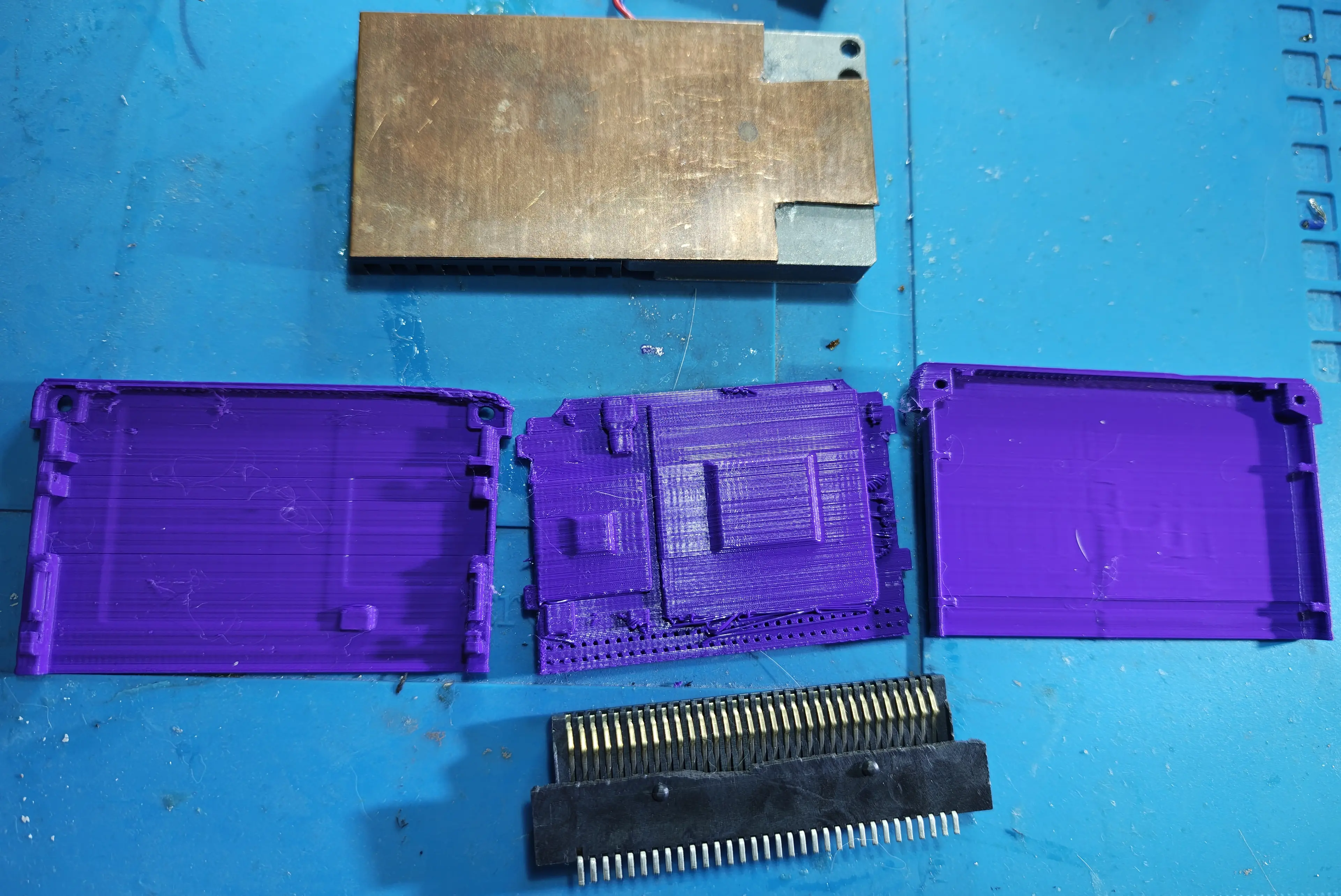

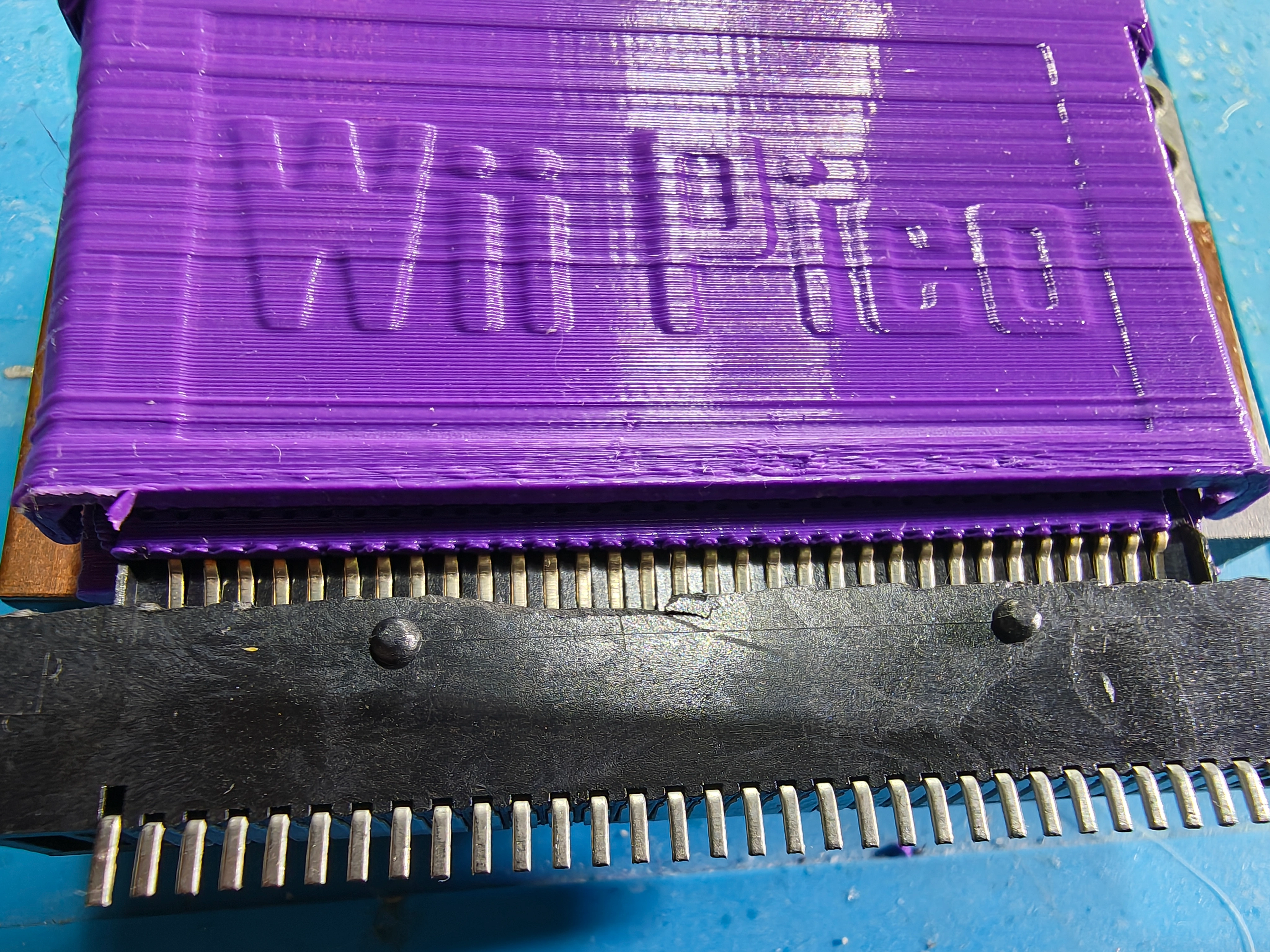

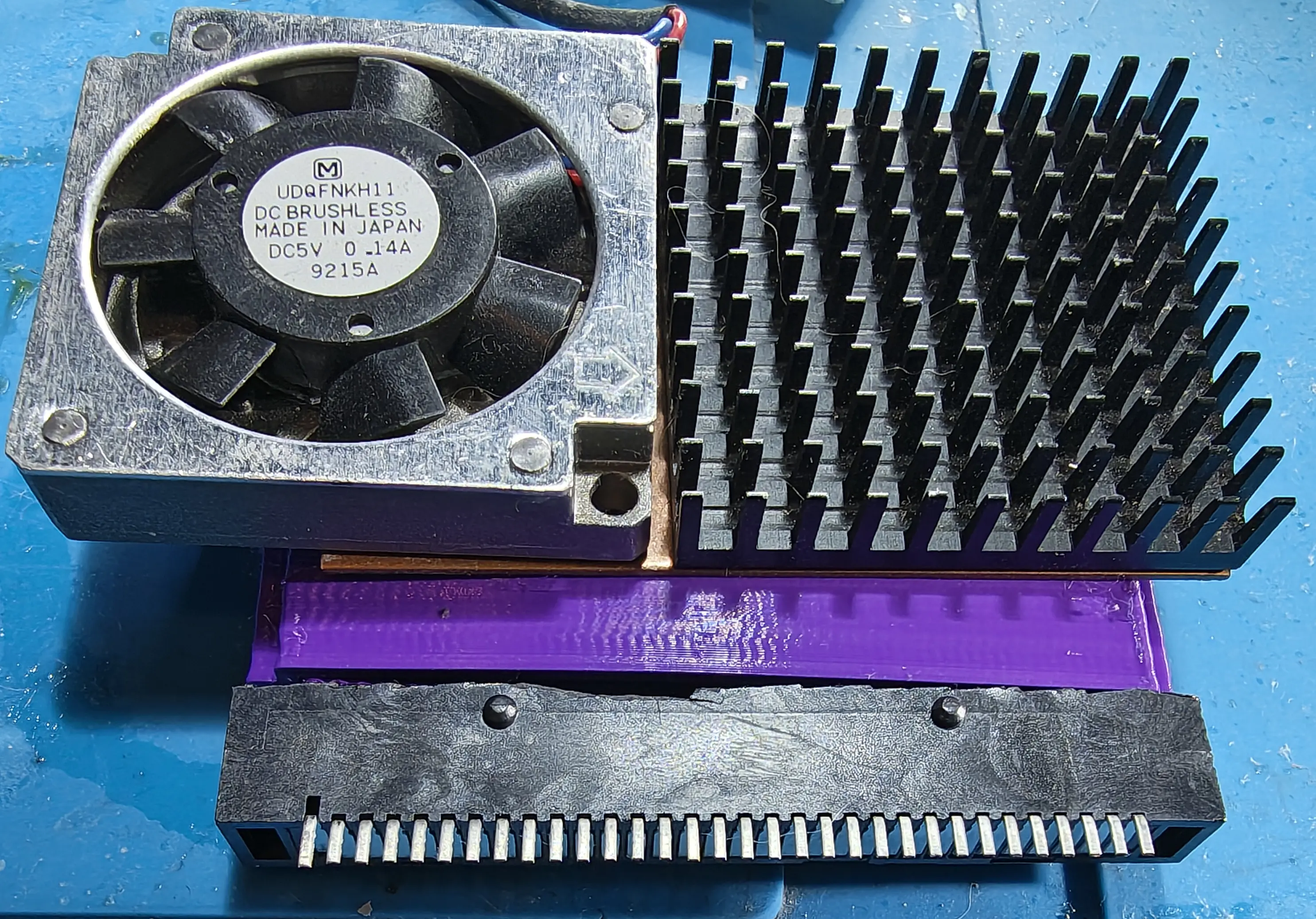

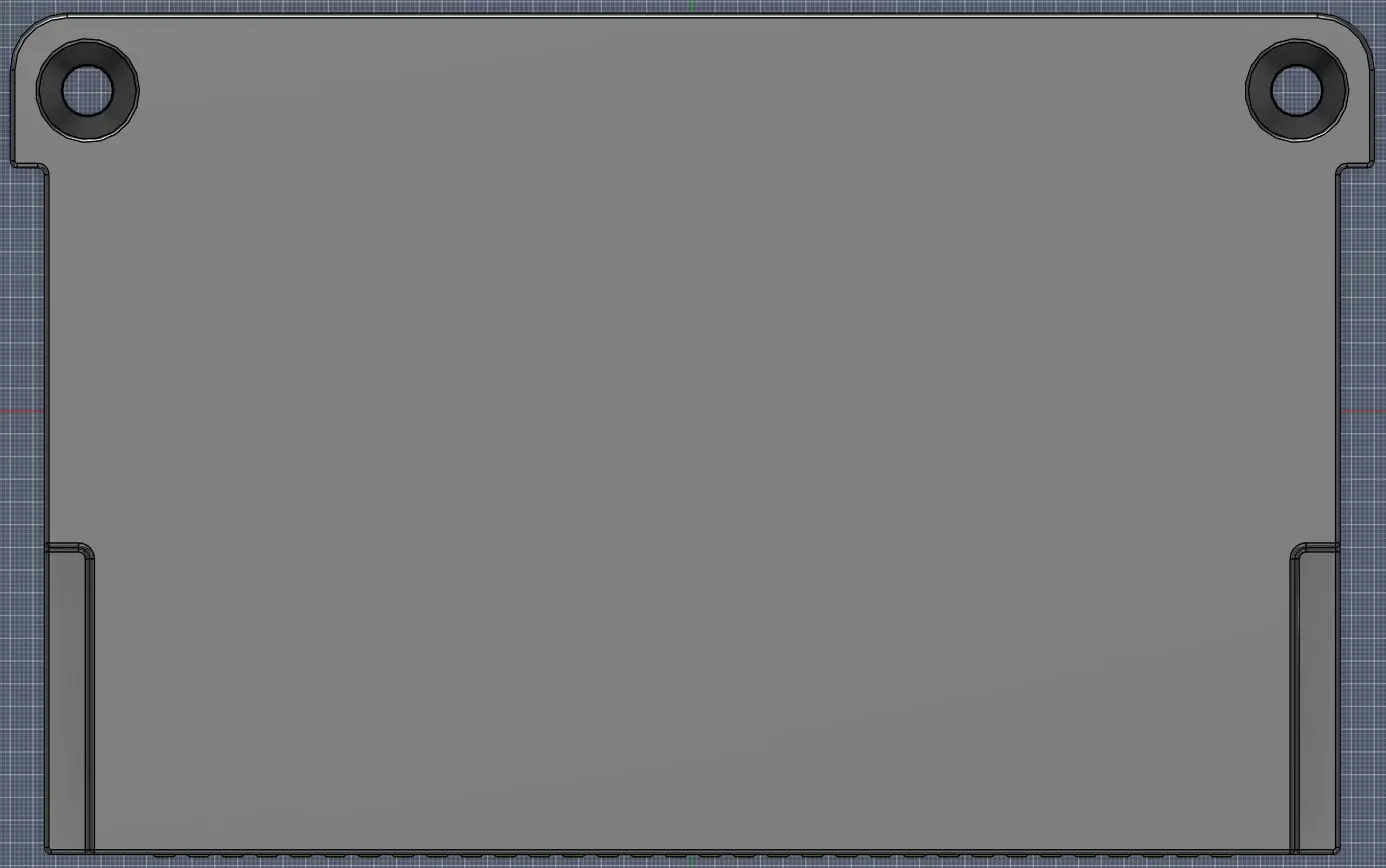

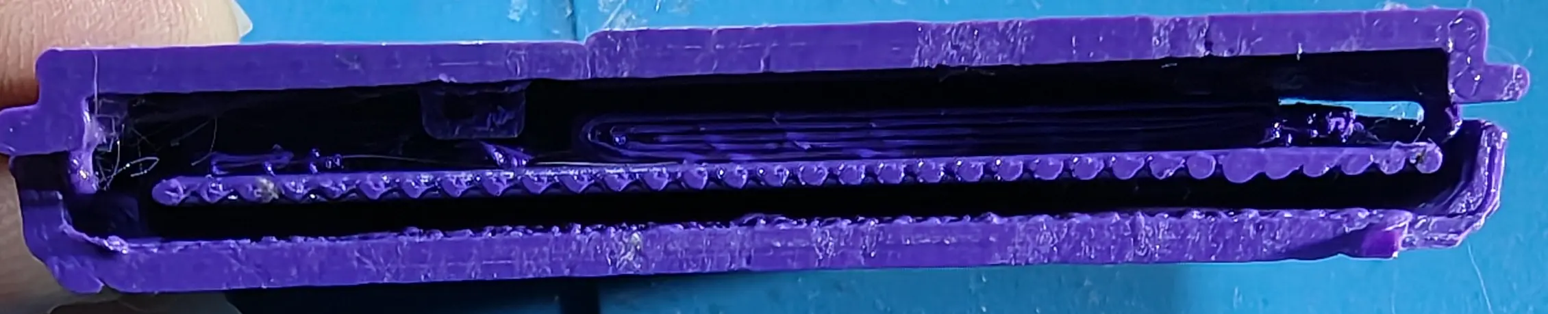

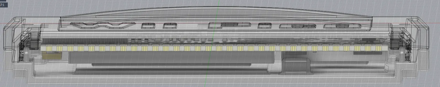

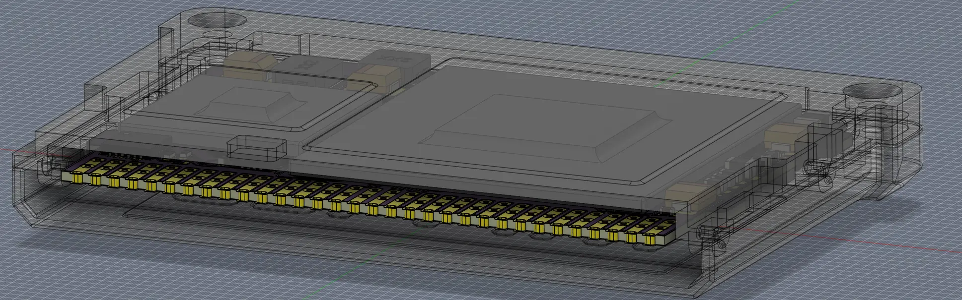

I also modelled the full shell in in fusion, trying to keep it as accurate to the stock GBA as I could. Even managing all the painful curves on the backside using lofs. (Apparently there's an option to change how the loft's connect, letting you use tangents or curvature, which helped with the smoothness)
1781470057545-webp.43579

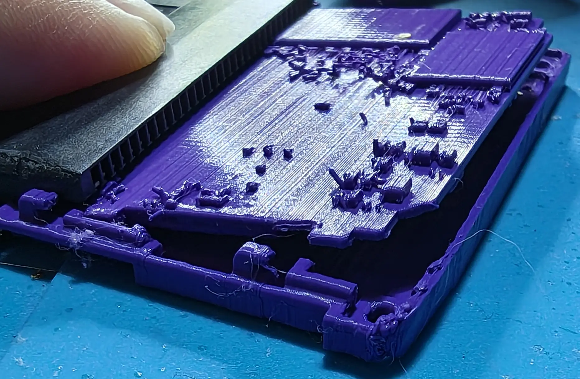

I had planned to print it today so that I could include it in the update, but half of the print came loose early on and turned everything into a mess… And I didn't realize in time to start another print today :/

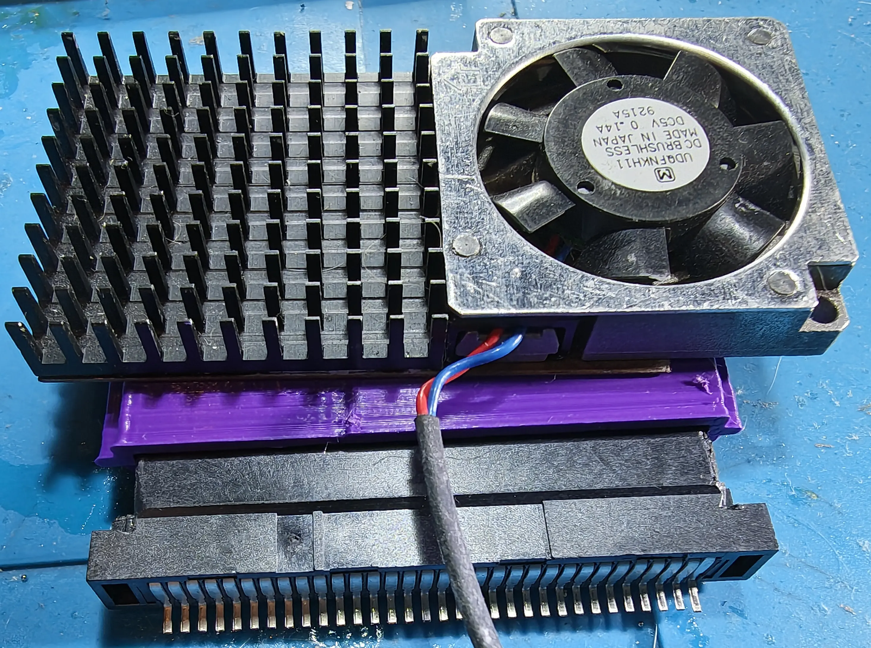

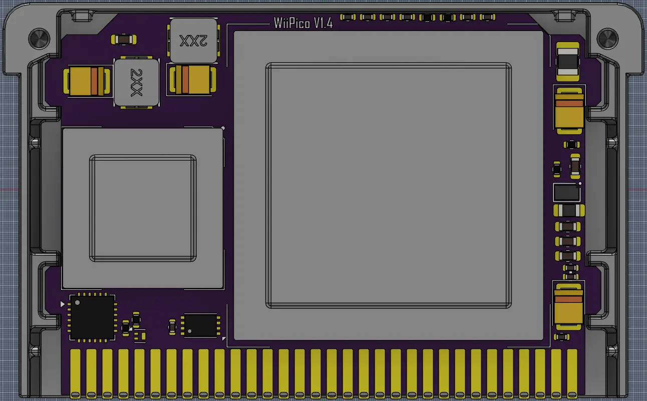

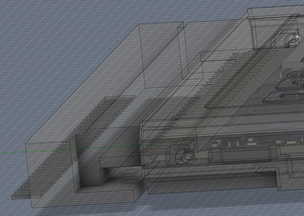

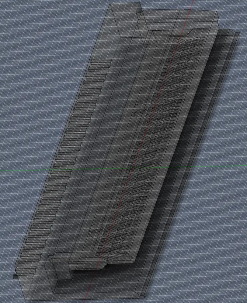

However, with 3D models in place, I also started looking at the internal layout and how to cool everything! Even though the Wii uses very little power, having no cooling while being this small feels like a bad idea XP
Though, with the Wii being in the cartridge, and the cart being removable, we meet the problem of how to attach a heat sink to it while it is inserted?
My current plan that I like is this:
  1. Put the heat sink on a cammed track.
  2. While the cart is not inserted the heat sink will be in the down position, held in place by a spring.
  3. As the cart is pushed in, it will push against an arm on the heat sink, pushing the heat sink forwards with the cartridge.
  4. As the heat sink moves forward, the cammed track pushes the heat sink upward into the cartridge, with a bit of force to allow for good contact.
  5. A thermal pad on the heat sink, will act as the thermal interface material, and a soft buffer.
Removing the cartridge will do the same in reverse, the cart and the heat sink travels together outwards till the cam track pulls the heat sink down and free from the cartridge. Then a spring pushes it the rest of the way to the down position.
Are there better ways of doing this? Yes probably. I could get rid of the interlinked system and use an external button to do the same. I could also use springs more to give contact pressure. I could use graphite for thermal interface instead of thermal pads. But this is my plan for now, I want to make some tests based on this to see how well, or how badly this will work before I abandon it.

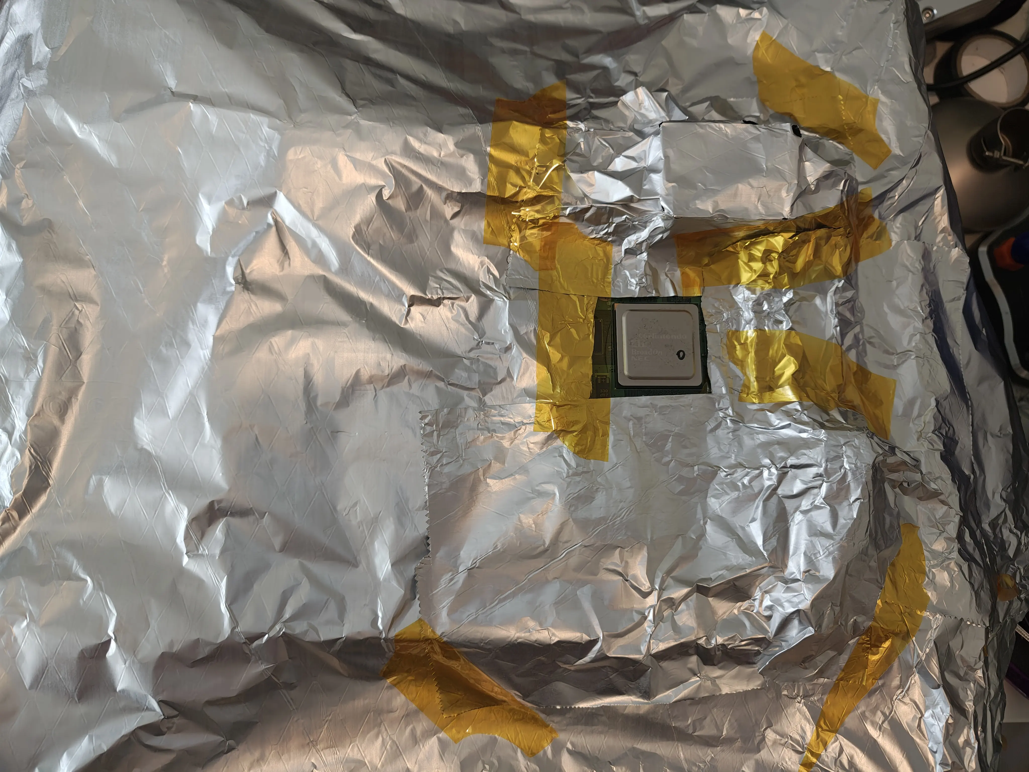

So, the first Wii mini arrives, however, before anything else, I’m going to give it a name, I already have a few Wii’s laying around, and spoiler, I’ll get a few more. Names will help separate them.
  • Alpha – The first regular Wii, which is the one I cooked dead
  • Bravo – The second regular Wii, that I got, but didn’t use as I wanted a Wii mini.
  • Charlie – The first Wii mini, the one I’ll be detailing in this section. (Also sorry for anyone name Charlie here…)
More will be added to the cast as I go, with a summary at the end.

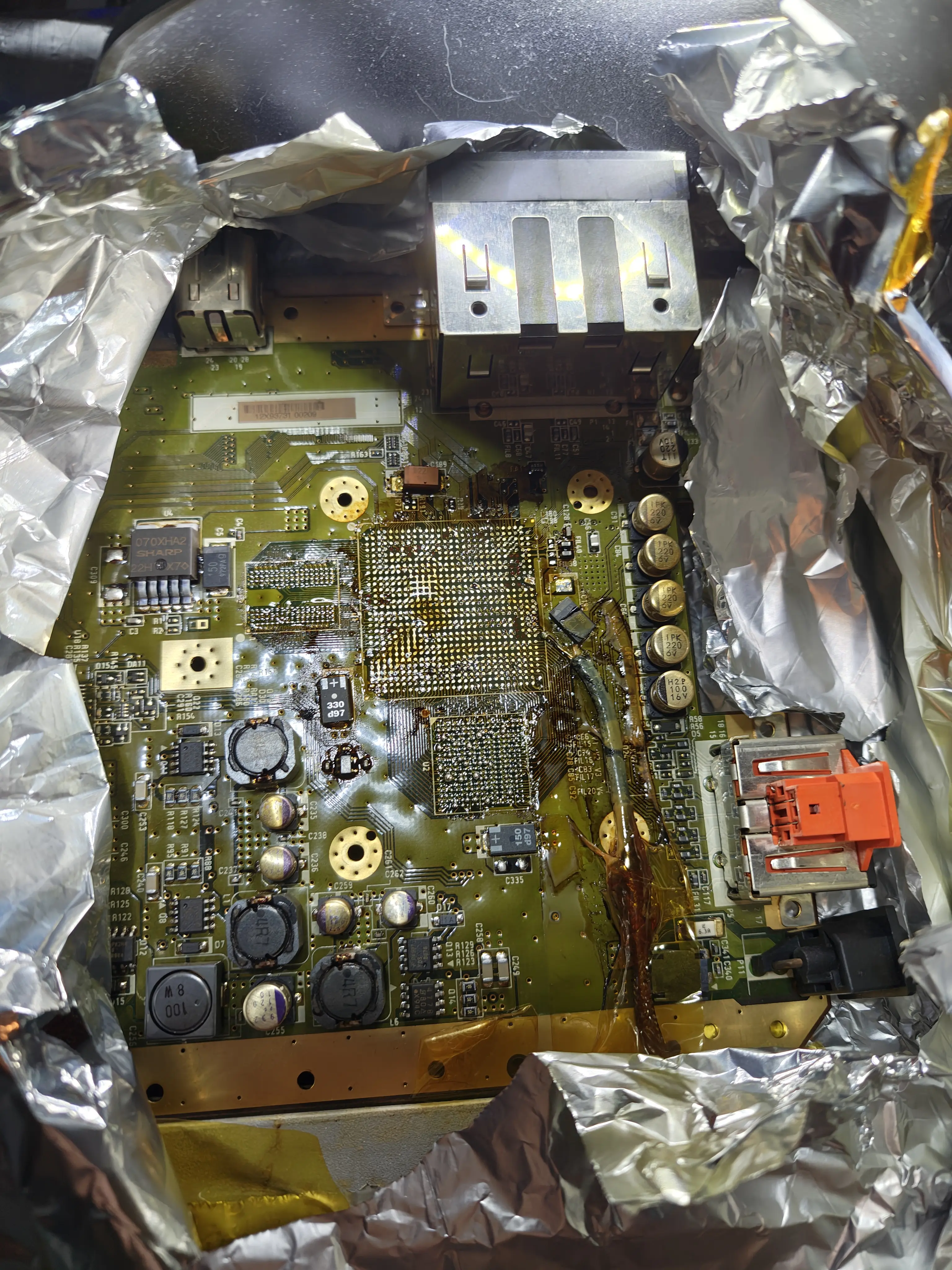

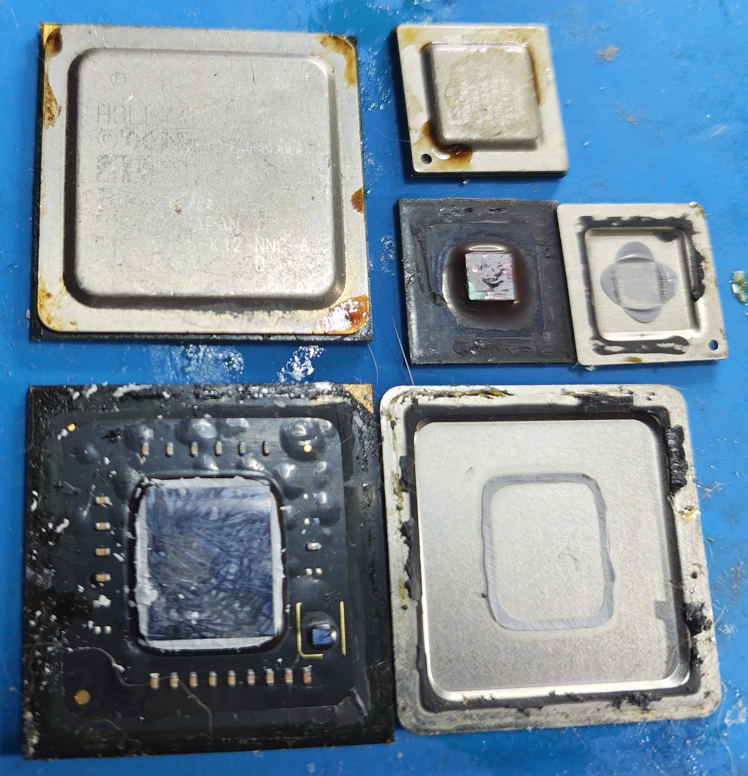

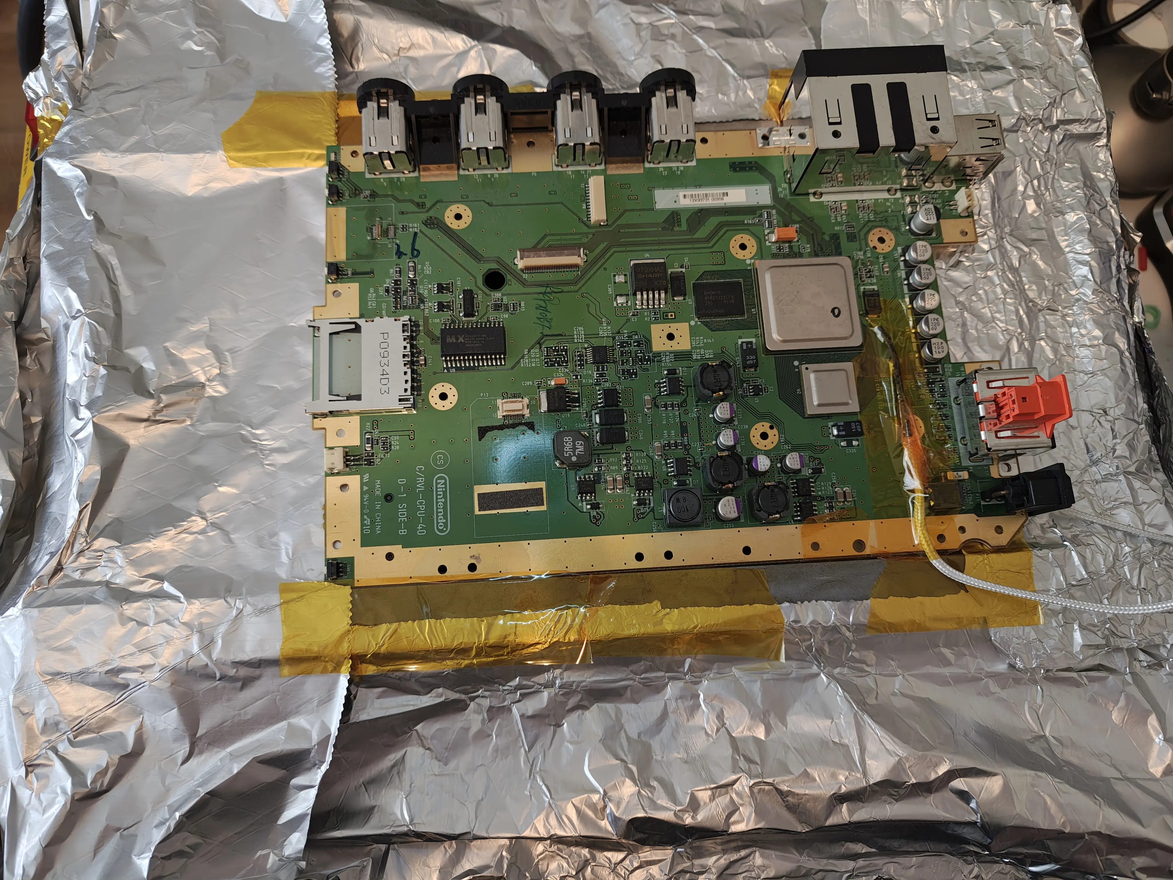

So, I check that Charlie boots, install RVLoader like I’ve done on a half dozen Wii’s before. Then bake Charlie. Unfortunately, I don’t have a PCB oven, so I decided to use my preheater. I put Charlie upside down on the preheater, so that the CPU and GPU gets baked, and let him sit for 6h. I was recommended 100C for baking, and using some temperature probes, I saw that there was about a 20C difference between what the preheater was set to, and the board temperature, so I set the preheater to 120C, so that the board was 100C.
After those 6 hours, I flipped Charlie around and baked him for another 6 hours the right way up. I really didn’t want to take any chances after the last board, Alpha, turned out very very very very very dead.
Once Charlie was sufficiently baked on both sides, a full 12-hour process… I started bringing him up to temperature. Last time, with Alpha, I did it right after being sick, and had a massive headache, and rushed without thinking and without checking what was reasonable, even though I had harvested chips from PS3’s a few times before then. So, my dumb brain had done the dumb thing of: “Well I set my soldering iron and hot air to 320-350C so that’s the temperature I should reach…” Solder starts melting at around 220C… The reason the iron and hot air is set higher it to overcome the heat loss from radiating heat elsewhere, and to overcome the losses from needing to heat up the ground plane and pcb acting as a heatsink… I reached a bottom temperature of 290C… which is slightly above the solder melting point of 220C… Delaminating Alpha, making it go all discolored, delaminating the GPU, and components on the bottom side had just fallen off due to gravity… So that was slightly sub optimal…
This time, with Charlie, I checked… A reasonable bottom temperature is 180C, then you bring it the rest of the way up with hot air and start checking if the chip is floating once the top probe reads 220C. The technique I ended up using was holding the hot air nozzle very close to the GPU, counting to 30, then gently poking the GPU with a tweezer that I gently held in the far end. If the tweezer bent, then it was not ready, if the GPU moved, then it was floating, however I let it heat up for another 30 count, to be sure it was fully floating and that I was not ripping any pads, and that it would not solidify as I removed the heat to lift it up. And that seemed to work well, I got the GPU and CPU and RAM off without issue, there was no popcorning on Charlie, and checking the resistances one the GPU and CPU they turned out fine. (I’ll post about the resistances in a later segment.)
However, I was not yet quite done, so after spending 12 hours baking Charlie, then more time carefully heating him up to temp slowly and harvesting the chips, I decided to do the next step right then and there before going to sleep. Because the best work you do is while tired before going to sleep… So, what did I need to do? Well since I needed every fraction of a millimetre of space for the PICO, I needed to delid the GPU and CPU, so their height would be slightly smaller… So, I did as last time, I took a razer blade and carefully cut the glue around the edges of the IHS, making sure to angle the blade slightly upwards so it would not scratch the substrate. I did the corners first, careful about not going too far in. Then I did the edges. Then after working it for a bit, the IHS popped off, and I could see the silicon die, and the caps around it, and the tiny silicon die which others in the discord identified as the EEPROM. Everything looked great! There were no popcorning visible, no scratches, no defects I could see. So, I posted it in the discord, and we looked at some of the differences between the HW1 and HW2, along with the empty slots for caps. Then just as I was about to sign off, Rob noticed something, a potential defect, just from the image below. Can you spot it before I point it out?
If you zoom in to the EEPROM, there is a slight discoloration which looked off to Rob.
So, I took the chip out again, and adjusted my microscope to try and get a better image… and fuck me sideways, he was right… A tiny piece of the EEPROM had gotten chipped…
It’s shallow, but it might have taken out something important…
So, the HW2 from Charlie was potentially dead, and the only way I could check was to test it… But I had just removed the GPU, CPU, RAM, and NAND from Charlie, and I really didn’t want to put them back on. Though from the discord I got the suggestion to put the GPU onto the working regular Wii I had, aka Bravo, though as the NAND and GPU are married to each other, and I didn’t dump the keys, I needed to transplant both. Though as it was Sunday, and I had work the next day, and baking takes a long time, I needed to wait till the next weekend. There was also a risk in transplanting the GPU, as according to Rob, the vias on the stock Wii makes it difficult to transplant a GPU back onto a stock Wii without creating bridges… You need it to sit perfectly and not shift… So, it was mostly a hail Mary (good movie and better book btw) to see if the HW2 from Charlie was still good. So, I ordered a second Wii mini (Delta), just in case the HW2 I had from Charlie was dead.

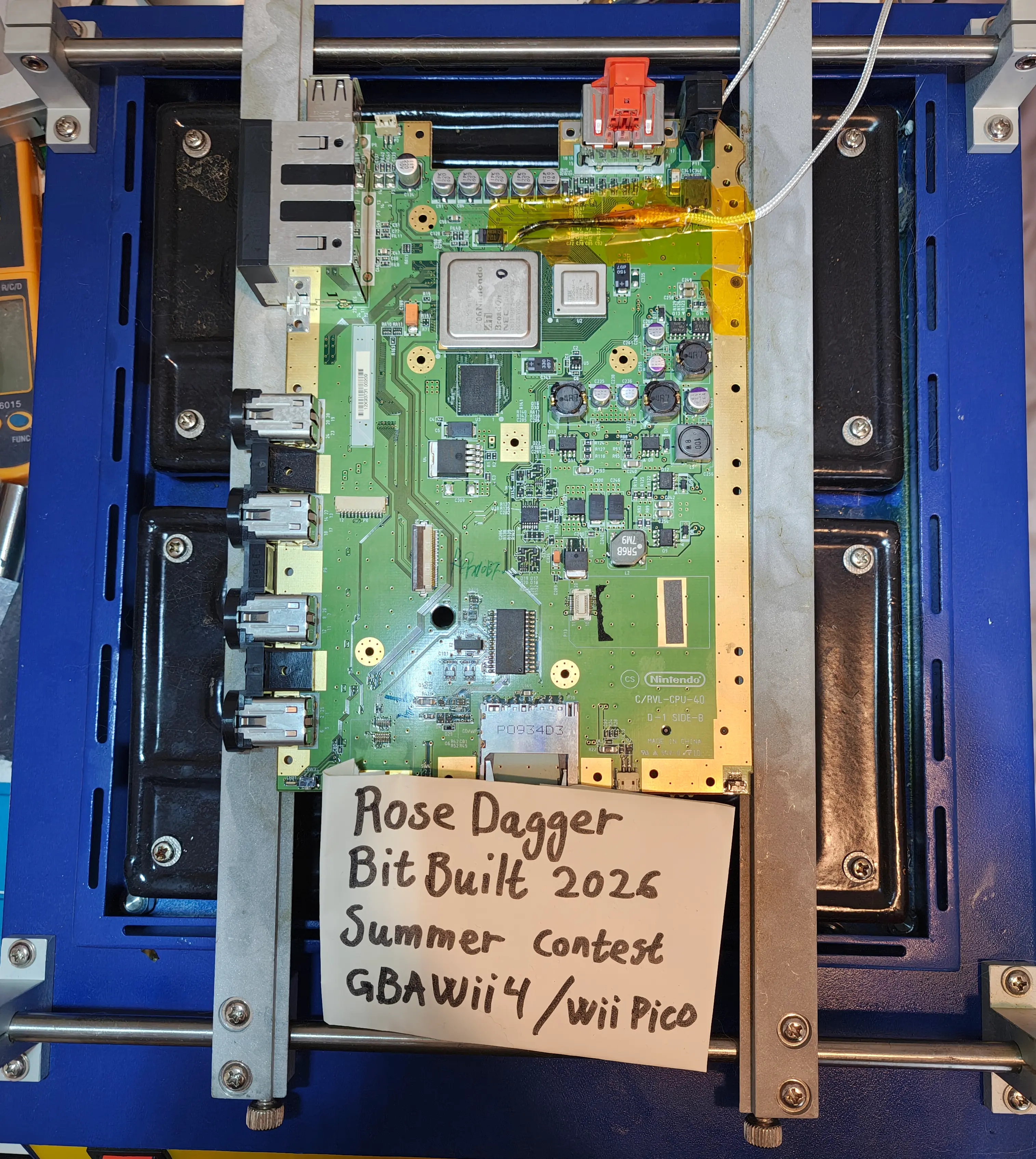

During the week I had, I spent my afternoons practicing reballing on the very dead GPU from my first attempt aka Alpha, and I got better and better at it. The first proper attempt. I had about 10 solder bridges (error image not found). My second attempt I had 1 solder bridge, which merged into a big ball, I tried to rescue it with solder wick but just made a bigger mess. My third attempt I had issues with the balls not wicking down, so after I was done, I found several balls who were not seated, so I heated it up again… and managed to bump into a bunch of the balls with the hot air nozzle… The fourth attempt I used more flux so the balls would wick better. I had to stop a few times as the balls started floating together, and I needed to separate them before they formed a blob, but I got a perfect reball!
Then I did the exact same thing to the to the chipped HW2 from Charlie and got it on my first try!
Then next weekend come around, and I start going through the procedure again with Bravo. Last time I did 6 hours on each side, however as the temperature probes on the top and bottom were relatively close, I decided to do 3 hours upside down, then 6 hours right side up, so it was only 9 hours of waiting on Bravo. Then I bought Bravo up to temp, and started blasting the GPU with hot air, this time being even more careful to not rip pads. It had gone well last time, but I really really needed it to go well this time. I poked it gently till it was floating, then waited a bit longer, then lifted it. No ripped pads! I cleaned it up, using leaded solder then solder braid, before I put down fresh flux and placed the Charlie HW2 down onto Bravo. Then I started blasting it with hot air, waiting till the probe reached 220C, and repeated the same procedure to check if the balls had melted and that it would bouncing back into place. I removed the hot air, and let Bravo cool down, and turned off the preheater. Then flipping the board while it was still hot, I removed the Bravo NAND and placed down the Charlie NAND.
I needed to clean up the legs of the Charlie NAND, but then it was time to see if it would boot. I checked the resistance which seemed fine, no shorts. I plugged in the power, and the power LED turned on. I pressed the power button, and the LED switched color. All great news! So, I kept looking at my monitor to see if I would get an image… No image… I checked the boot debug pins, and I got a flashing 0xF1… Which is EEC or RAM issue… That is step 1 of the boot process… The EEPROM is step 7… Maybe there were some bridges on the RAM side of the GPU… Maybe I had accidentally bumped the RAM chip while transplanting the GPU… I remembered what Rob said about transplants on the Wii was difficult and that it was a long shot unless I got the alignment perfect, and my method to check if the chip was ready was by poking it… My work bench is not big enough that I can have the preheater and the reballing jig out at the same time, so I would need to spend a few hours heating the board up and harvesting the GPU again, then let it cool down before I move the preheater away and try to reball the GPU again, which could take a few more hours, then I would need to move the preheater back and heat it up again, to try and transplant the GPU back… That would take ages… And I had a new Wii coming for the next weekend. So, I cut my losses and put Bravo with the Charlie HW2 aside, I could come back to them late and try again if needed.

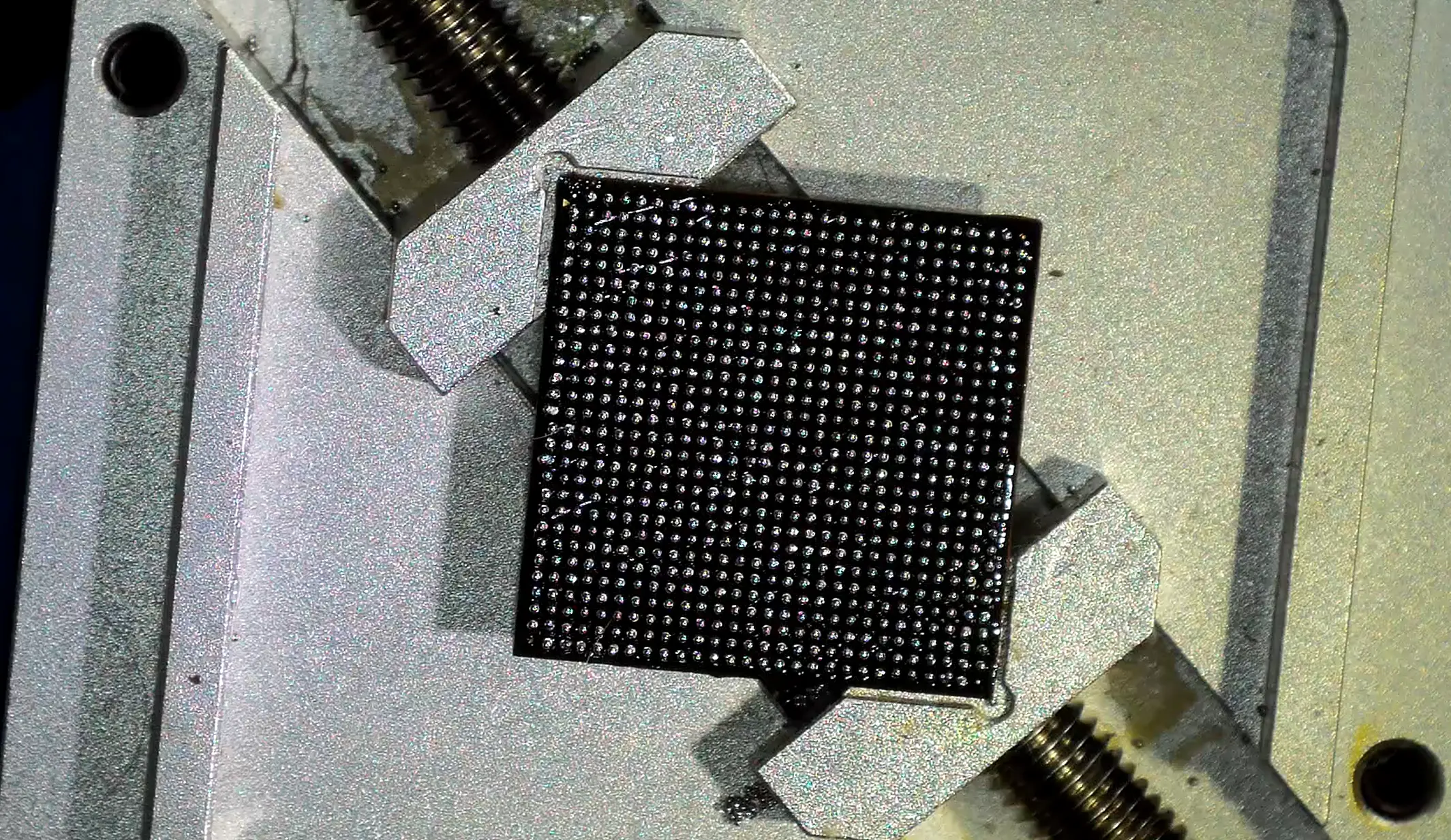

3.1 Why the fuck did reballing get more difficult again?

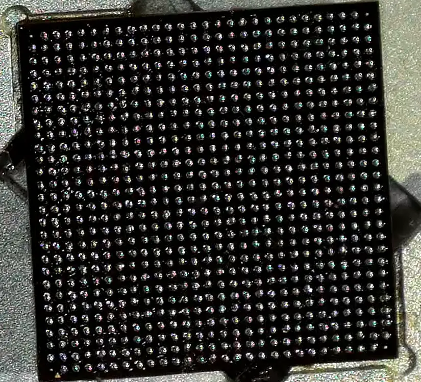

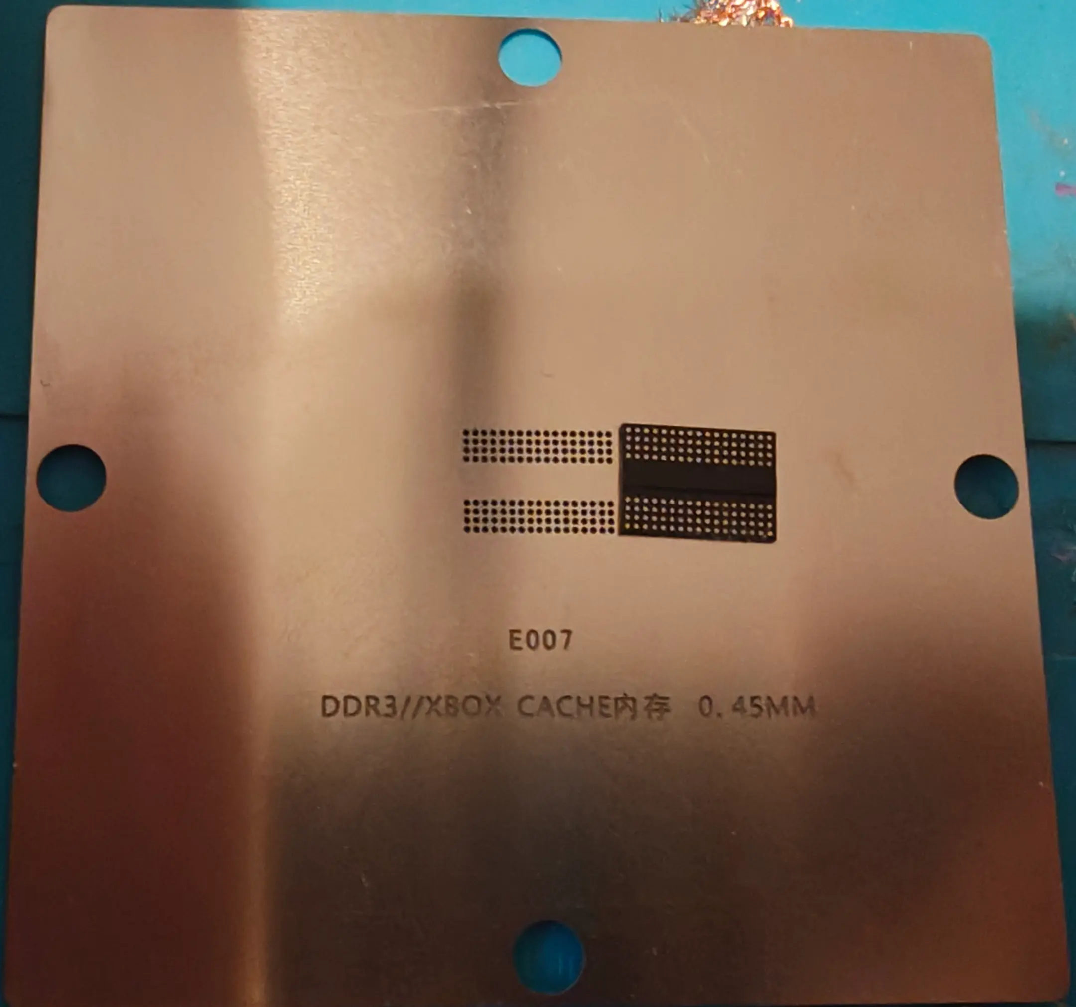

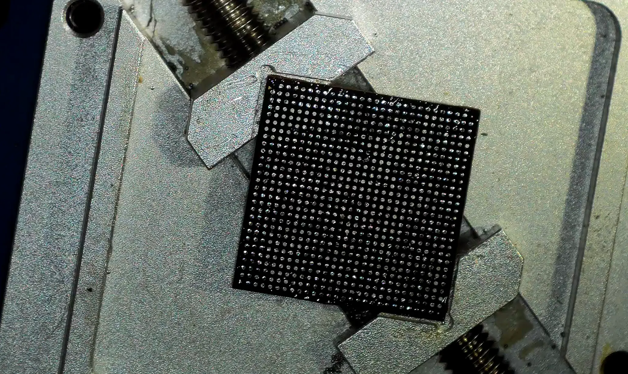

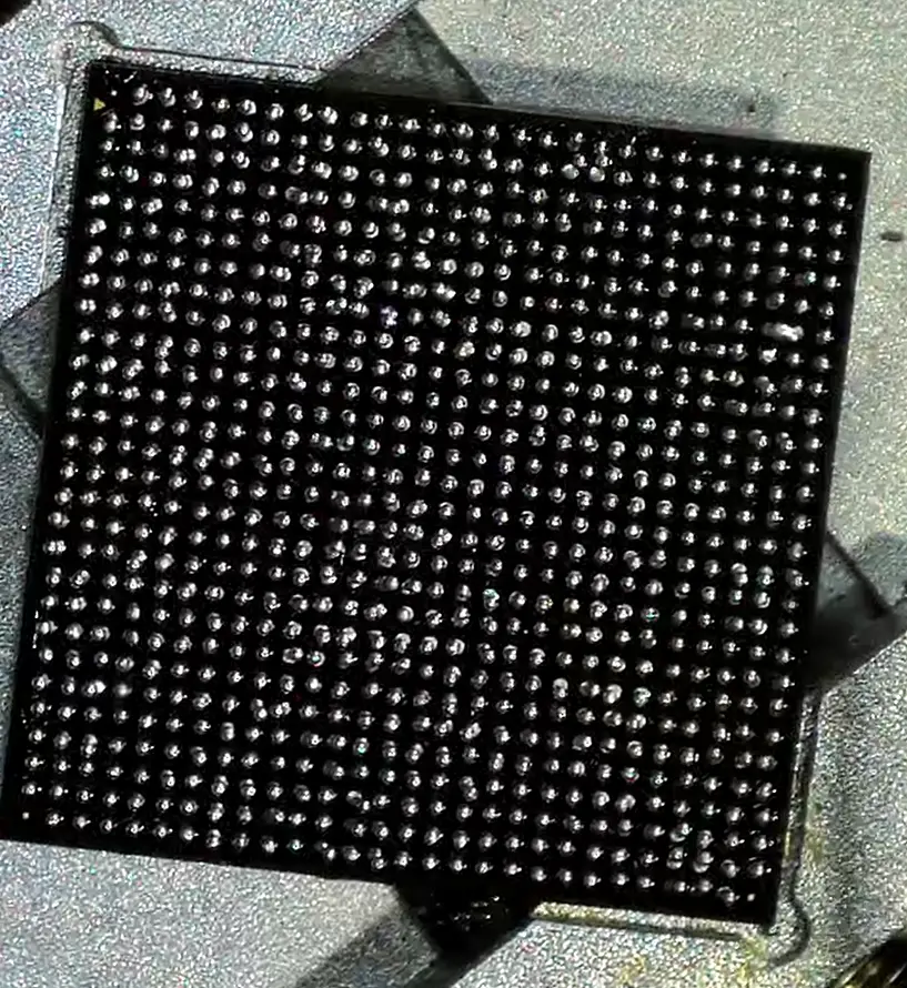

So I have the HW2 from Echo, along with it’s CPU and NAND. I had ordered some fresh RAM from Aliexpress, so that I would not need to reball the RAM myself. So, all I needed to do was to reball the GPU and CPU, and place down the NAND, easy peasy right? I’ve already gotten a technique down for reballing the GPU and didn’t have much issues with it once I got it down. Sure, that was 3 weeks ago, and I’ve not tried again since, but surely, it’s not that hard, right?...

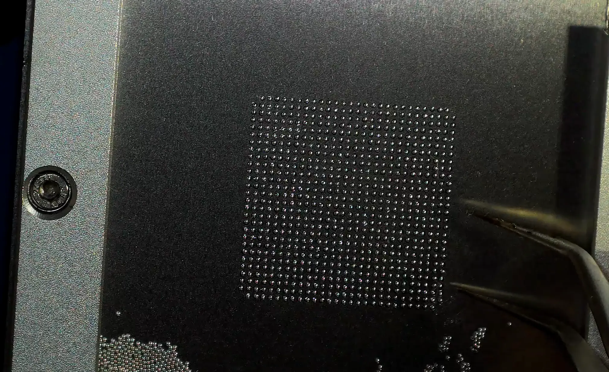

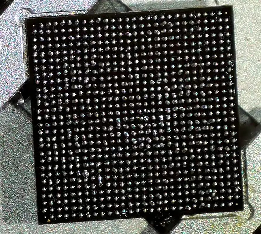

On my first few attempts on the Alpha GPU, I had not used enough flux, and it led to the balls not wicking down, and I burnt the GPU even more trying to get the balls to melt. As I preferred to not burn up my good Echo GPU, I decided to use more flux just to be sure. However… More flux means that the balls float more and want to clump together… So, I spent the next few hours heating the chip up, carefully watching for when the balls started clumping together, then immediately stopping, and separating them. Over time the flux would evaporate, and the balls would clump less and less, until I could finally reach the temperature needed to melt them and have them wick into place. I did it zone by zone and realized that the areas where the GPU was clamped into the jig was struggling to heat up, so I took the GPU out and rotated it so that I could heat those two corners.
Nicely placed down solder balls
Literal hell, each ball cluster must be separated manually. Why do I do this?
An eternity later, and it's a perfect reball...

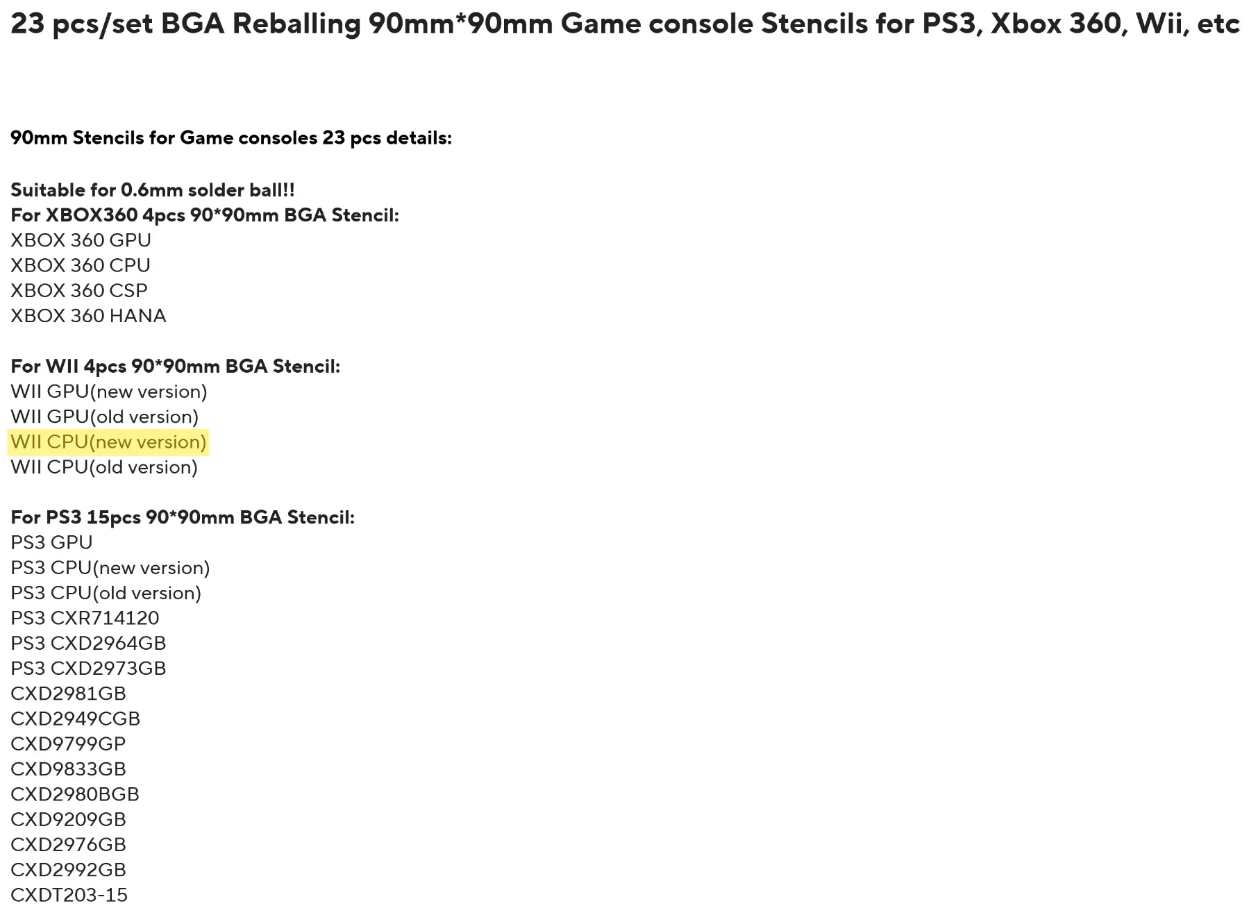

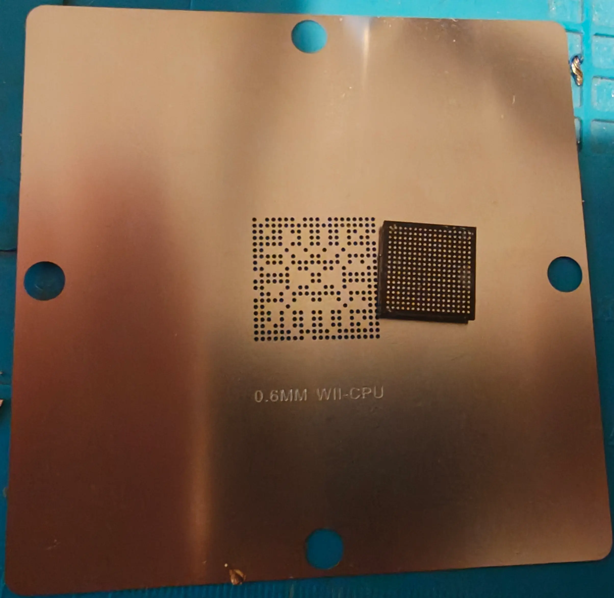

Then over to the CPU… So, I had twice tried to get the stencil for the Wii CPU, however, even though both listings I tried said they had the Wii CPU in them, neither did… So, I ordered some generic stencils and found that the 0.4mm stencil fit, all I needed was to mask off all the excess holes. And as there’s no complex patterns on the CPU itself of where the balls should go, that turned out quite well.
Balls are placed.
Had to take the CPU out of the jig as it was soaking up all the heat, not letting any of the balls melt.

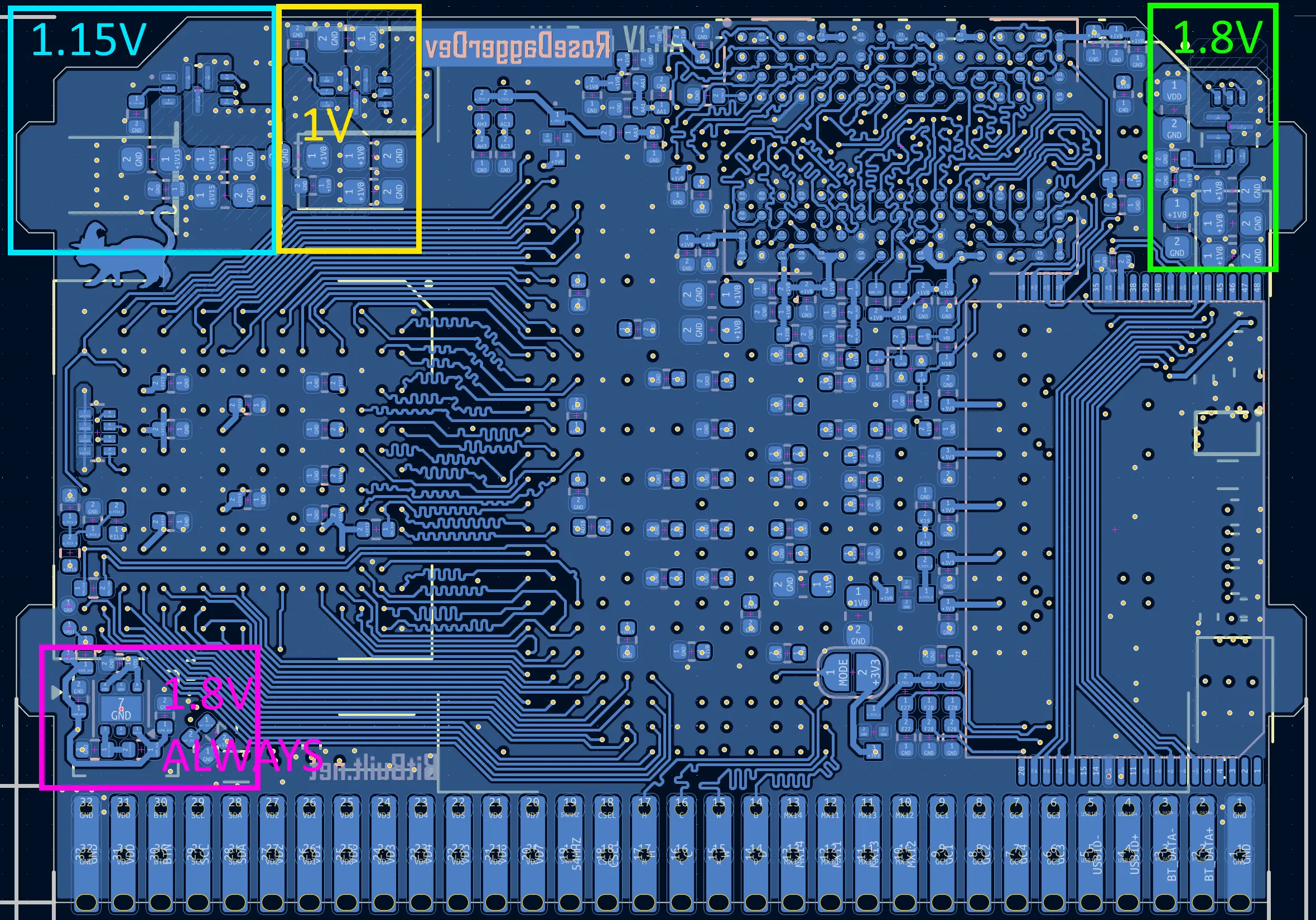

I checked the resistance on the PICO first, just to be sure… and found that the 1.8V rail was shorted… I checked a few things, but I had my suspicions on the RAM. I had not used flux when I soldered it, as I had not realized how important it was to making the solder balls wick into place, and it had not had the same jiggle when I poked it. So, I removed it, cleaned up the area, checked the resistance, no short, fluxed up the area, and placed down a fresh RAM chip. It went into place a lot better, and I didn’t have any shorts anymore. However, the area under the RAM has started getting a bit scratched up from the solder braid...
With that fixed I moved back onto the CPU and GPU. I had prepped the area before hand with leaded solder, then removed it with solder braid so that there was only a thin coating on all of the pads and fluxed it up. Then I carefully placed the CPU and GPU down, aligned them, and placed the hot air nozzle above them. The nozzle was big enough that it would hit both at the same time, and honestly the entire board as well. I blasted hot air, while squinting in from the side to look at the GPU to see if I could see with my eyes if the GPU seated down. Then after a while I did my poke test… First poke, nope, not jiggling… Second poke, nada… Third poke, oh there it jiggled the way it does when the balls are melted, great. I just need to remove the heat and look at my amazing creation.

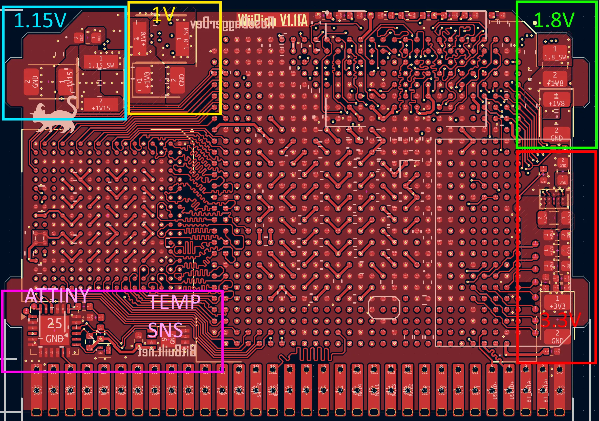

Hmm the 3.3V buck boost is clearly not positioned well, it’s a micro-BGA component, but I have a replacement. And the NAND desoldered itself.
Hmm is that a damn solder bridge? How? It didn’t move! There were no bridges when I place it down… Damn it… But lets take a closer look just to be sure.
Hmm from an angle the bridge disappears and it looks more brown than metallic… It might just be flux… Let me check what pins that’s supposed to be… I know there’s a lot of ground in that area. It’s Ground and 1.15V… Let’s check resistances… Not a short! The resistance looks fine! Let’s check the other rails as well… They are also fine! Maybe I did it?!
I just need to fix the NAND and the 3.3V regulator and I can finally test the PICO. We are almost there! (Don’t look at how much is left in this work log…)
3.2 I HATE micro-BGA!

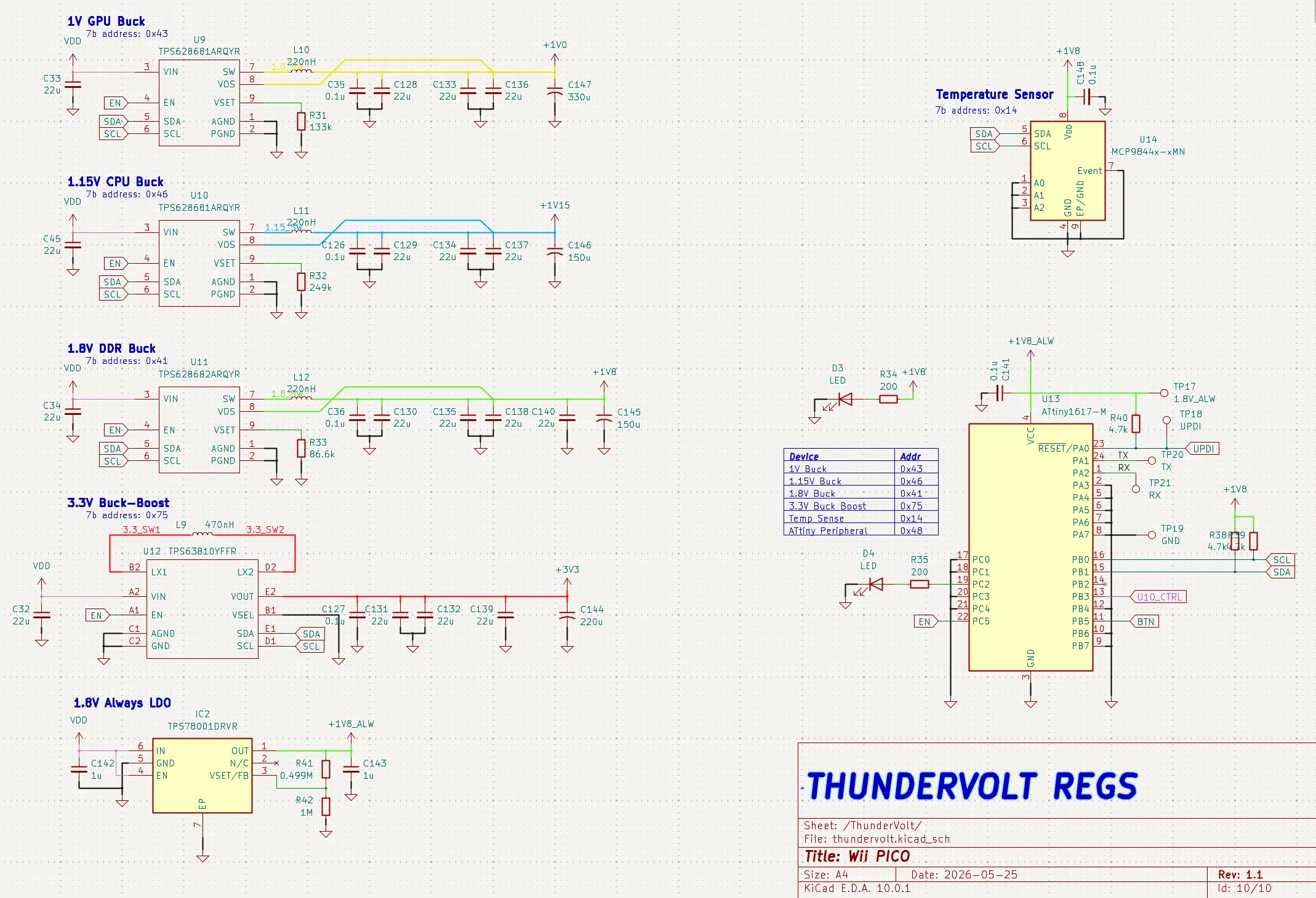

So, I used the same regulators as the ThunderKILL which used the same regulators as the ThunderVolt, which used a tiny micro-BGA buck boost for 3.3V. These micro-BGA components use balls that the size of a needle point, and the pad’s are not any larger… I had one unused backup of this regulator, so I heated it up to remove it… The regulator would not budge… I keep waiting for it to heat up enough… But the point never comes… I up the heat on my hot air, and finally it want’s to come free. So, the solder balls they use are apparently very high heat… I clean up the pads and put some flux down, then place the regulator down and start heating it. The silk screen outline around the chip is taller than the balls, so I can’t really look in from the side, though I probably should have tried. I heat for a good long while, at a higher temperature than normal, just to be sure the high heat solder balls will melt, and I don’t poke it. Once it felt like enough, I let it cool down, then poked it to see if it would stay or if it would come loose. And it stayed in place, so some of the balls stuck down at least.
I connect up the wires for the ATTiny, so that I can flash the firmware to it, and do some modifications to make the ThunderVolt firmware fit the picothunder (I used some different pins and components, and moved the LED, the Thundervolt has a dimming LED, I don’t as I didn’t realize the LED pin mattered, or that that was a feature). Once that’s done, I connect the test dock I made and give it power.
The plastic bits are there to make the PICO thicker so it will press into the contacts properly.
On the Thundervolt, the LED will breathe when everything is fine, and it will flash an SOS if it fails somewhere. My version will blink regularly if everything is fine or do the same SOS if something wrong. I check the LED, and it’s blinking steadily. Great! Awesome! This is really coming together! Let me just check the voltages to be sure. 1V? Yes! 1.15V? Yep! 1.8V? Right on! 3.3V? Hmmm… why am I getting 0V on 3.3V? That’s not great… Let me check the code again. Hmmm it will SOS if it can’t find and can’t talk to the regulators. But it never checks the voltages, or what the regulators has to say. So, the 3.3V reg is present, is answering I2C, but is not converting… Hmm, let’s look at the datasheet for that regulator, let’s see what status registers it has, I’ve use different regulators before which had a lot of telemetry and status I could access. Hmmmmmmmmmmmmm… It only has Power Good, and Temperature Good… Let’s check those… Okey it’s reporting Power Not Good… Great it is aware it is not working, but won’t tell me why…
I double check that the inductor I have has the correct ratings and that I didn’t mess up the size of it. The datasheet, and the ThunderVolt Schematic says 0.47uH, checking Digikey, the inductor I ordered was a 0.47uH inductor. So, it seems fine. I keep checking some more stuff, but it feels like it mostly comes down to the regulator, which has those cursed micro-BGA pads, and maybe it’s not fully seated, or something is wrong with the inductor… The inductor is easier to replace so I do so. I add a bit of fresh solder paste just to be sure it will stick down, the solder which is there currently has been heated and cooled a good few times now. I heat it up… And the solder paste starts spreading around as it becomes more liquidy… And some of it goes under the regulator… Just absolutely perfect, that’s exactly what I wanted… Fresh solder getting stuck under the micro-BGA regulator that I don’t have any spares for… I check just to be sure… And the switching pins and vout are shorted…
So, I desolder it… clean up the solder… then try to reball it using the solder I have. I tin the pads on the regulator and on the PICO and try to get them to merge. SOS the Tiny can’t talk to the regulator… Off with it again… Only tin the chip and not the PICO… Hey it’s talking again, and I’m getting some voltage on the 3.3V rail! 0.5V is some voltage… but not the right voltage… I’ve been probing the everything with my oscilloscope, both before I had to replace the regulator again, and after, and it never properly converts. On the 0.5V it tries to convert for a little bit, then gives up… And so do I…
This 3.3V micro-BGA regulator is the bane of my life, I just wanted to see if the PICO would work, why does it hate me so much? Fine, I’ll just get rid of it, and replace it with an external regulator, I have a few of those laying around. And I swear for the future to never using micro-BGA for any projects I need to solder myself ever again!
I change the firmware to not look for the 3.3V regulator, then I try one regulator I have. Out of circuit I adjust it to 3.3V, then solder it in… The 3.3V rail is only supposed to draw about 0.25A, so it’s not massive, surely it can handle it… Nope… I don’t get the voltage I need… Fine I have another slightly better regulator that I’ve use before which should work. I solder it in, adjust it, aaaaaaaand 3.3V!!!!! I check the other rails, AND…. They are still good!!!!!! It’s alive!!!!!! Mwahahahaha!

Okey according to this, the CPU is supposed to be 243MHz and the RAM is supposed to be 486MHz
Let's check CPU clock... 237MHz! Great, close enough! The GPU and it’s clocking and PLL systems are working! And the CPU gets an appropriate clock.
Now let’s check the RAM, most of the traces are hidden under it and under the GPU, but I have access to the terminating resistors for the clock, which is supposed to be 486MHz. And I measure… Garbage… centred around 1.8V
Well that’s not what I want to see… Let’s check to stock Wii… Hmm I’m seeing something there, but it’s not very clear… What’s going on? It’s centred around 1.3V…
Why is the signal on the stock Wii so weird? Hmmmmmmmmm…. My Rigol DHO914s oscilloscope is rated for 125MHz… the DHO924s is rated for 250MHz, and uses the same hardware, just a different firmware… Those who are good at math might have notice an issue… 486MHz is slightly larger than the 125MHz or even the 250MHz that my scope is rated for… XP Though I could at least see something of the waveform for the 486MHz on the stock, even if it was very distorted. The PICO is not even showing that…
I checked the Vref for the RAM, which is supposed to be 70% of VDD, which it was, for both the vrefs.
Also checked there is no activity on the datapins for the RAM.
I'm not sure what else I can poke to investigate...
Next step might be to desolder the RAM again? It was hanging upside down while I was soldering the GPU so it might have started to desolder itself? Though it looks fine from the outside...
There is also the risk that the scratched solder-mask under the RAM is causing issues and something got bridged? Though then I either need to get lucky when I solder a new chip on that it does not short... Or start over on a new board... Which would be hell, I don't have a lot of backup components, so I would have to order more, or harvest from the current board...
Or me moving the DQ groups around messed it up so much it wont initialize? Or the interference from the compact traces makes it give up and not not initialize? But I would expect the 0xF1 boot code if the GPU came alive enough to test the RAM and it failed. So it fails before even reaching Boot0...
Maybe the RAM is a red herring and it's showing no activity as the GPU has not tried to initialize it? But then what else might be wrong to the point the GPU does not even reach Boot0? And never tried to initalize the RAM or start the RAM clock?
And that's about where I am. Unsure of what is wrong or why. And mostly poking and prodding stuff to see what behaves as expected and what does not.

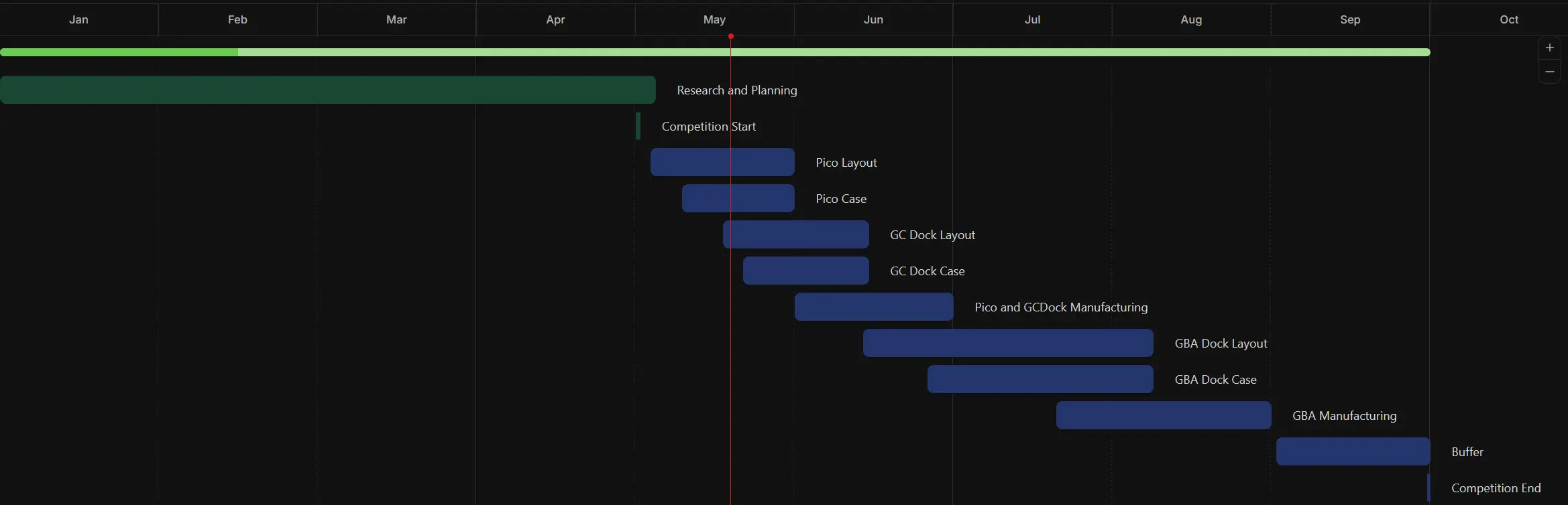

So, when I started this project, I set out a few goals and made a rough gantt chart/timeline to see how much time I would have for each step. I had planned to update that chart as I went, but of course I kept forgetting about it. But now, with two months left, and having lost one and a half months to trying to get an HW2 GPU I could use, it might be time to return to that overall plan.
As Loopj said in the discord:
Which is true, but at least for me, it gives me a visual indicator of how much time I have left and what is left to do in that time, so I made another one, updated to how things actually went.
As you can see, I failed to deliver on most of those shaky promises, and the full month buffer I had made is completely gone. There might still be a small chance that **IF** I get the PICO working in the next week or so, I **MIGHT** be able to finish, as long as I don’t need to do any reprints or revisions… Something that I failed to accomplish last year…
Of the original goals I had I’m going to have to cut down on some of it to have any chance. Mainly the TV Dock. I don’t have the time or motivation for it. It was supposed to be my shot at the smallest Wii ever made, smaller than the Kawaii, but I had no ambitions or wants for it beyond trying to claim that title, so it’s best to just… not do it. I’m also not gonna mess with MIPI and just stick to the HDMI driver board which came with the display I got.

I’ve had a lot of connection problems between the PICO and the Dock… I wanted the PICO to be as small as possible, while using the normal GBA connector. However, the GBA connector assumes a much longer wiping/insertion distance than I’ve given the PICO, meaning that the contacts only connect at the very edge of the PICO, and any misalignment would make one side not fully connect…
After fiddling with it for a bit, I managed to align it perfectly and insert it at the perfect distance so that the pins made contact, and the USB could be read. Though this connector design is not great for what I need…
But it works! It fucking works!! Hallelujah!!!

I fucking did it! I have a working Wii on a PCB which is only 52x34mm! I moved the RAM to the backside and changed the DQ groups around and it fucking worked! I moved the CPU closer to the GPU and squeezed the traces together and the cross coupling didn’t kill it! The passives were moved around, and large sections are blocked off by the RAM and NAND so I could not place the passives optimally where they should go, but it still worked! It’s kinda insane that it actually worked with everything I changed at once XP
So I’m gonna call this conservatively a massive success as a prototype!!
Glory pics!
The testing setup:
Yes I ended up holding the heatsinks down with magnet wire and thermal pads
The Pico in the dock, with the 3.3 external regulator on the side. And plastic shims under the connector to give it enough force to mate properly.
I had planned to make the Video out and GC out into mini jacks, but then I forgot to order solder-able mini-jacks, so I just soldered directly on the terminals.
I had a handheld fan running over the setup to ensure it was cool enough to run.

  1. The GBA connector really isn’t working well for the PICO. I have two possibilities:
    1. Extend the PICO by another 1-2mm to get the correct insertion distance to make good contact. That would bring the total height of the PICO in the cartridge to 39mm… The GBA cartridge that I’m trying to squeeze it into is only supposed to be 35mm tall, so I would be going quite a bit beyond that…
    2. Drop the GBA connector, and find something different, such as using pogo springs. It would let me reduce the height to 36mm, and it would let me add more pins.

With the success of the Pico prototype, I needed to kick my arse into gear. I had only a month and a half, to pull this off, on top of doing work. So, I down prioritized getting the update above out, which is why it comes half a month late XP
Now, however as I’m still busy, I’m gonna lightning round this:
  1. Connector: Pogo pins, and shortened the Pico by a bit
  2. Regulator: Replace with a tiny analog buck-boost
  3. Silkscreen: JLC said no, they don’t want me claiming to be Nintendo… Replace it with “2026 RoseDagger AGB-RVL-02”
  4. Component cleanup: Rewired the Tiny to align with the ThunderVolt more, changed the chokes, fixed the 100pF caps to 1uF caps, changed some inductors, etc
  5. Purple: Yes
I got a tip from YveltalGriffin to use a tiny non-I2C buck-boost he knew about and used that to replace the DSBGA and then use the DAC on the Tiny to adjust the feedback node. I had used that trick before on a different project, but didn’t think to use it here, and would have overlooked the absolutely tiny regulator he found. So, all praise to him for saving me from DSBGA hell XP
Also Pogo pins and targets are expensive as hell… I’ll not use them again if I can avoid them... Damn I really hope they work as I intend…
However, the Pico wasn’t the main work, I just wanted a minor revision on it to fix some issues and the connector. The dock or GBAWii4 was the main issue. I had a mock-up of it, the shape of the PCB was done, and most of the main components were added to the schematic. But I needed to go over it to fix any missing components and validate it. And then lay it all out and trace it. And I had a deadline… I ended my internship Friday last week. Uni starts up Tuesday next week. I have one week where I’m not in my final year in uni or working, so I got to make the most of it. Which meant that I needed to get the dock ready as quickly as possible.
And with a lot of blood, sweat, and exhaustion, I did it! Here is the GBAWii4 dock!
And inside the GBA shell: Yes the bottom cutout was for some larger fans and I didn't bother resizing the PCB after changing the fans.
And the copper looking thing on the bottom is the flex PCB from the display and display board.
With batteries:
There is a small riser for the pogo pins, I needed to lift them up. But it will also allow me to mount the pogo pins to the back shell where the cart sits and then connect it into the GBAWii4 PCB with the regular connector.
The routing could have been neater, I didn’t have much time to refine it or go over it again.

  4. Tuesday 1st: Reball the HW2 and CPU, and prep for the Pico to arrive
  5. Wednesday 2nd: Pico rev 2 arrives, solder all passives and small components
  6. Thursday 3rd: Solder the HW2, CPU, RAM, NAND, and check resistances.

Easy peasy, as long as nothing unexpected happens, I don’t cook or chip Foxtrot, I didn’t make any mistakes in my rush to finish, and nothing else goes wrong or takes up more time… And I get time to do all of this while starting my final year at uni and starting my final year project… Then everything should be just dandy, and I should get all of this done in time. Hopefully. Maybe. Perhaps. It would actually be really neat if I had a working project at the end for once XP (Though I have the Pico Rev 1 as a backup if my bad luck kicks in and everything else decides to burn to ash XP )
Well, that’s enough for today, wish me luck. (*Pling*) Oh what’s that? DHL says they will deliver my package from JLC today instead of Wednesday like they had predicted?!
It does not change much as I need to finish baking and harvesting Foxtrot, but had I done that yesterday, then I could have saved a day off my timetable XP Ah well, Stellaris was still fun, so it’s fine XP
Edit: Forgot about the index card for my post, so here is Foxtrot after harvesting the chips. And I've learned I'll wait till tomorrow before I delid it XP

  4. Tuesday 1st: Reball the HW2 and CPU, and prep for the Pico to arrive (Complete)
  5. Wednesday 2nd: Pico rev 2 arrives, solder all passives and small components (Complete)
  6. Thursday 3rd: Solder the HW2, CPU, RAM, NAND, and check resistances. (Complete)

PICO Rev 2
I finished soldering it up during the week off I had and it looks amazing if I say so myself ^^
Now as for how to test it. It was still my week off, and I didn’t have the new dock… But I wanted to test if it worked… The old dock used a different pin spacing and connecting interface so I can’t just plug it into that now, can I?
Hmmmmmmmm… Even though the pinout changed the main features remain the same, what if I just solder some magnet wire on the video and power pins and hand wire the Pico Rev 2 to the old test dock? That should work, shouldn’t it?
Hmm that worked surprisingly well! Now let’s see if it boots?
Do I get power? Check!
Does the GPU and CPU heat up? No…
Do I see any reasonable activity on the data or clock lines? Nope…
Let’s check U10 reset? 2.3V… What?
Okey I know what’s going on here, and I’ll explain.
So while changing the ThunderVolt source code to work with the PicoThunder (aka my implementation of the ThunderVolt on the Pico). I discovered that there was an option to emulate U10 without using a MOSFET. It would instead wire the reset line directly into a pin on the Tiny, then it could pull the pin low to reset, and set the pin to high impedance to let the GPU pull the line up to 3.3V. It seemed brilliant, I loved it, and since the MOSFET on the Rev 1 had been one of the things I failed to solder initially, it would remove a potential fault source. So of course, I removed the MOSFET for Rev 2 and used this emulated U10. However, there was one aspect that I had not considered. The Tiny runs on 1.8V, the reset line is 3.3V, the voltage protection on the Tiny is VDD + 0.5V. 1.8V + 0.5V is for those who are good at math, less than 3.3V. It’s 2.3V to be exact…
Now this is a tiny little bit of an issue, as 2.3V is apparently not enough for the GPU to go out of reset…
The obvious solution is to place the MOSFET back. Don’t fix something which isn’t broken. However I had removed the footprint completely, so my other option was to cut the trace, solder some magnet wire to the traces, and solder on a MOSFET. The trace width is 0.1mm, my magnet wire is 0.25mm in diameter, the MOSFETs I had in my backup pile is a tiny 1x0.6mm MOSFET with tiny pads… Yeah no I don’t feel like soldering that XP
(Now that I think on it, I could have used the U10 MOSFET from the Wii, that would have been easier to solder, but I didn't think of that at the time.)
Now the other option was to increase the VDD on the Tiny. The voltage comes for a small LDO which uses a resistor divider to set the output voltage. The 1.8V is only to make it use less power, while the tiny is fully capable of going higher. Checking my book of 0402 resistors, I can make the LDO output 3.04V. 3.04V + 0.5V is in fact greater than 3.3V. I could have gone a bit lower, but it would mean replacing both resistors, and this worked, so (shrug). It will use a little bit more power, but it should be fine, everything else connected to it is 3.3V tolerant so it does not really matter.
For the public release I’ll put the MOSFET back, and call it Rev 2.1. XP
Now does it boot? Nope, it does not seem to be able to maintain the main clock. Last time I replaced the caps on the main crystal. But didn’t this time. A quick swap of load caps and the clock is running. I’ll fix that for the public release as well.
Does it boot now? Ish… It clocks are running, it heats up, but the video clock is 27MHz… I’ve seen that before, so I poke each leg on the NAND to see if they are soldered. Don’t see any of the legs moving… I measure again… 54MHz! I connect the monitor, and behold:

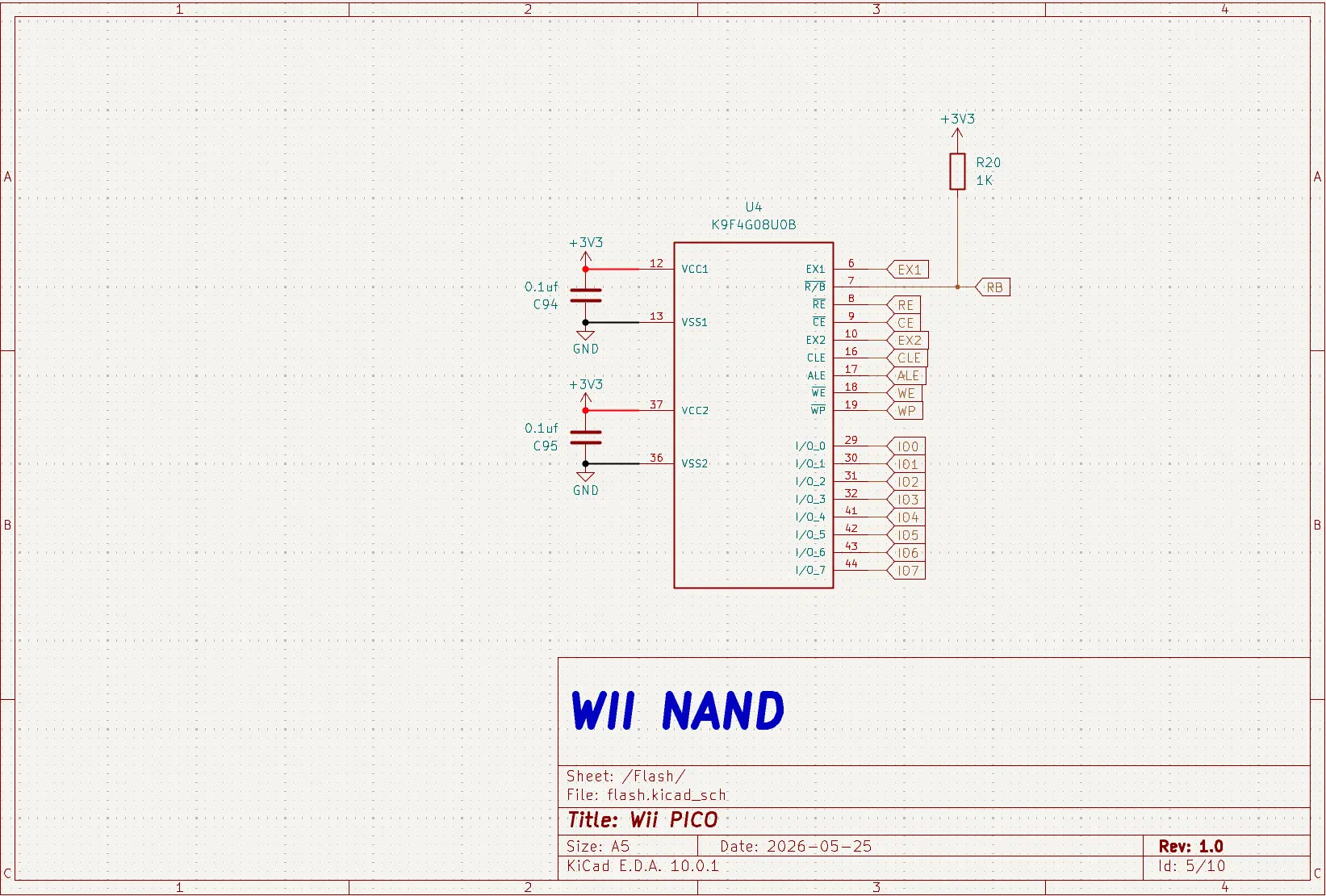

It seems of all components on the PICO, it’s the NAND I struggle with the most XP
But I’ve proven that the Pico Rev 2 works and only needs some minor fixes which I don’t need a new print for. Whoop!!!!
Pico Pak
Did you know the official name for the Gameboy cartridge is Gameboy Game Pak? As such I named the cartridge for the Pico, the Pico Pak.
Now I had done most/all the design a lot earlier, I just wanted to measure the final Pico to be triple sure the dimensions would be correct, then go over and round all edges.
I had fought for every fraction of a millimetre of space in the height direction, so that the GBA connector would fit, even delided the chips just to get slightly more clearance. And I had cut into the top and bottom to the maximum thin wall limitations for JLC.
I had also made this really cool locking mechanism, where the two pieces would slide together and the hooks would interact with the pegs. Locking it in all directions, and the screws were only needed to make sure it would not slide apart. And it worked well 3D printed!
So with all finishing touches done, I sent it off to JLC for CNCing to see if they could machine it.
Nope. They didn’t like the pegs at they could not give me undercuts. And they didn’t like that all wall thicknesses were in the “thin wall” range. Apparently, you needed some normal walls to provide enough support or something XP They wanted the main top/bottom surfaces to be 1.5mm thick at least… They were 1mm thick with some parts recessed to 0.8mm… All my efforts to gain every bit of height were wasted. And the GBA connector would never have fit XP Good thing I had switched to the pogo pins, right?
Shit… I’m getting squeezed and it does not fit… Fuuuuuuuuuuuck… I ask JLC if they will allow some cutouts in the main surfaces below 1.5mm as long as most of it is 1.5mm? And they answer that yes that is allowed. Okey cool, maybe I can save this? What if I flip the connector around to the top? There it would have more space…
Yeah, that would work! Hallelujah, the main design will still work!!! It would cover up the AGB-RVL-02, but that is fine. Though there was a second issue… All these changes would of course mess up the height of the riser for the meeting pogo springs. But that is a cheap 2-layer board, so I can have that reprinted. But it means I can’t test the Pico with the new dock when it arrives… But oh well, I already know that it works due to testing it with the old dock.
Now over to the second issue… No undercuts… My hooks and pegs won’t work… But I want some more support than just the screws… Guess I’ll just make some tabs which goes down and meets surfaces on the other side, locking it in all directions except straight on? And then the screws hold it in in that direction?
Well that seems to work!
Now… Since I was already changing the design… I figured maybe I’d add some more details? I had added the Wii Pico as a raised section in the area where the GBA game label was supposed to be. Mostly due to that cutting the letters into the area where Gameboy Advance is supposed to be, would have been too small for the cutting bit. And I didn’t know how to make a technical drawing for lasering. But to tap my screw holes I needed to learn to make a technical drawing… So why not laser? XP
Now it was fully done, so I sent it back to JLC, and they approved it! Whoop!

One night I lay thinking about the title for the smallest Wii in the world. The Pico in the Pico Pak would be the smallest Wii motherboard, in the same way that the Kawaii is the previous smallest. But both require a dock… And I have more stuff in the dock… So my claim to be the smallest always comes with an asterisk… The TV dock was supposed to fix that, but I abandoned it… But maybe I could unabandon it?
I took a look at the test dock… It’s very sparsely populated, and about the same size as the Pico Rev 1. I have the Pico Rev 1 still laying around and it works. The main issue was the connector and the 3.3V regulator… What if I quickly made a new dock for it, which I could hard solder the Pico Rev 1 to? It would not be in a GBA Pak, but it would let me stack the PCBs. And if I feed 3.3V into VDD on the Pico, then I can remove the 3.3V regulator completely and just solder a jumper between VDD and 3.3V.

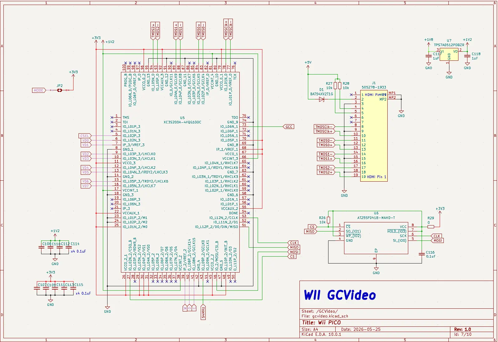

So, I got up and made an ultra-quick mock-up. Using the footprint of the Pico Rev 1 as my max PCB size, and tried to see what I could fit in.
So, this fits inside the bounds of the Rev 1, and it is GCVideo, straight into MelonHD. For USB C DP out. It gets PD in and feeds it through a 3.3V regulator. It uses WavePhoenix for controllers, and the Bluetooth module for Wii motes. And the GL827 for SD to USB. The only ports on it are the USB C for power and video out, and the SD card slot. And it all took about 24h from I thought of it, till I was ready to order XP It’s mostly just reusing parts from different projects and then playing Tetris for a few hours.
Now why did I do this when I’m already swamped with stuff to do? I wanted to fully claim the title for the smallest Wii in the world without any asterisk or caveats. The Kawaii, the smallest Wii which requires a dock is 60x60x15.8mm. This Wii Zero, would be just 52x36x7.2mm! Sure, I would need a case and a heatsink, but I would still, without any question be the smallest Wii in the world! And that was kinda the point of making my own PCB and moving the RAM around to the backside.
The Pico Rev 2 will be the smallest Wii motherboard which requires a dock. While the Wii Zero will be the smallest self-enclosed Wii in the world! Yes, I’m greedy and want to steal all the titles XP
Can we go smaller?
There was a small discussion in the discord about JLC adding HDI vias, aka buried and blind vias.
And if it was possible to make the Pico even smaller… So of course, I made another ultra quick mock-up XP This is the CPU also flipped around to the back. And all passives as 0201. It all fits within the footprint of the GPU XP It would be hell to trace it all and would need to use HDI which would be even more expensive than what I’ve done so far. But it is technically possible to fit it all. Will it work (shrug) all the passives would be in the wrong spots, and all traces, lengths, and impedance would be off. But maybe. I proved that it worked for the RAM, and that is higher speed than the CPU.
Though I’m not gonna make that any time soon. So, when I release the public version of the Pico, feel free to make the Wii Femto. Or whatever you decide to call it XP
GBAWii4 GBA shell
So, I’ve been working on the shell. The Fusion file is a complete mess, and I’m still not done, and am adjusting and printing and adjusting and printing… I’m trying to make the insertion of the Pico Pak work with the new riser after it arrived yesterday. And I’m trying to make the shoulder buttons work. And for it all to feel nice to hold and use. And I’m adding details which are too small to print…
I don’t feel like going through it in details as it’s still a work in frantic progress. So, here’s some images of it all

So where are we? And what is left?
I need the latest order of parts to come through. It got stuck in clearance, but it seems to be moving now. So, I should get the PIC for the GBAWii4 dock. And the parts for the Zero.
The Zero and riser arrived yesterday, and I soldered up the riser. Waiting on said parts for the Zero to solder and test it.
The Pico Pak is stuck in clearance currently, and I just got to hope that it goes through soon. It’s in my city, so it can be delivered as soon as DHL and the Irish customs agree that I’ve paid what I need to.
Then it is just finishing the case, putting everything together, and hope that it all works… I have one weekend left to do it. If the parts arrive, and I didn’t mess up anywhere else, then it should work. But if I mess up somewhere, or I break the screen last minute, or something else catastrophic, then I have no time to recover… So, it’s going to be down to the wire XP
And as soon as I’m done, I’ll need to work on my final year project for my EE bachelors, and spoiler, I’ll need to make a worklog here about what it will be XP
Anyway, that is me finally finished with my long-awaited update, and me signing off to be even more busy XP
Final upload videos. Didn't get done, but here is where I ended.
Edit 1: These were shot at 5am, after an all-nighter with 15min left before the end. So they might not be great XP
I'll write a proper end worklog later of everything that happened
Edit 2: I'll include the goals set out in the beginning and which ones are cleared
Main goals:
  1. Fully redesigned Wii motherboard with transplanted CPU, GPU, RAM and NAND. (COMPLETE)
  2. Putting the redesigned Wii into a GBA cart. (COMPLETE)
  3. Create a simple dock to test that the redesign worked. (COMPLETE)
  4. Create a handheld dock in the shape of a GBA. (90% Final fixes and assembly missing)
Strech goals:
  1. Create a TV dock, which should hopefully be the smallest Wii ever made (so far). (80% Need to fix a bug, and create a case for it)
  2. Actually, having something work at competition end for once. XP (Eh, the Pico worked, but a final console using it was not complete)
Nice to have:
  1. GBAWii4: MX, GCVideo, MelonHD, MIPI display and redesigned driver board. (90% Done, to everything except MIPI which was changed for HDMI)
  2. TV Dock: MX, Bluetooth, AVE/component out, sensor bar plug, 4 GC controller ports. (80% Done, this became the Zero, which has WavePhoenix, BT, USB C DP out)
