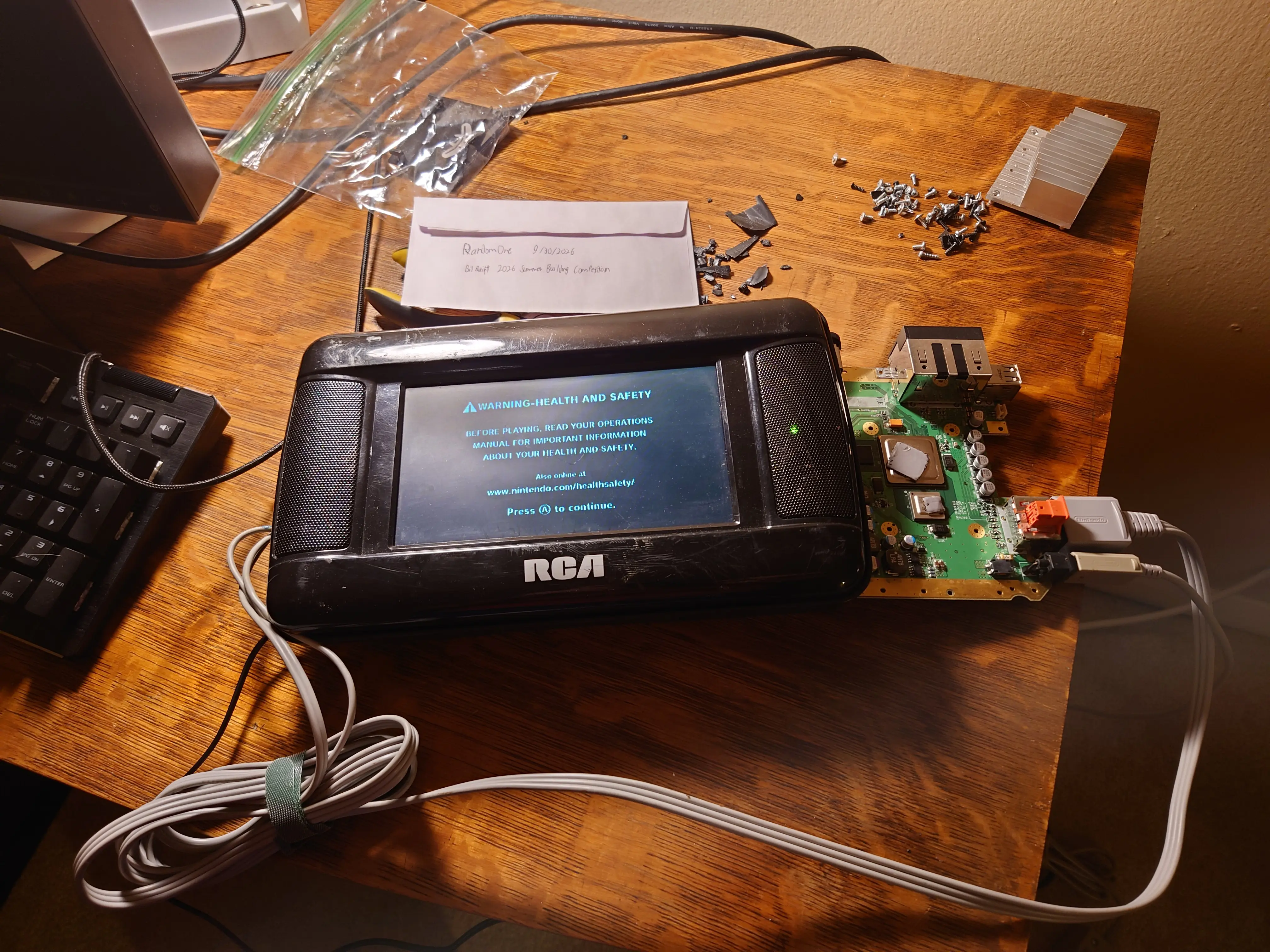

Introducing the DiiViiDii, a terrible and hacked-together Wii-stuffed-into-something-else kind of project. Specifically a crummy old portable DVD player.

The Wii is an RVL-CPU-40 with a dead drive that I got on ebay for $18, and the player is an RCA DRC97873i, which is a dual screen model that i got at Goodwill for $6 or so a long time ago. I'll be using the second screen as I've already killed the backlight on the main unit. :( At least they're fancy enough to have a kickstand!

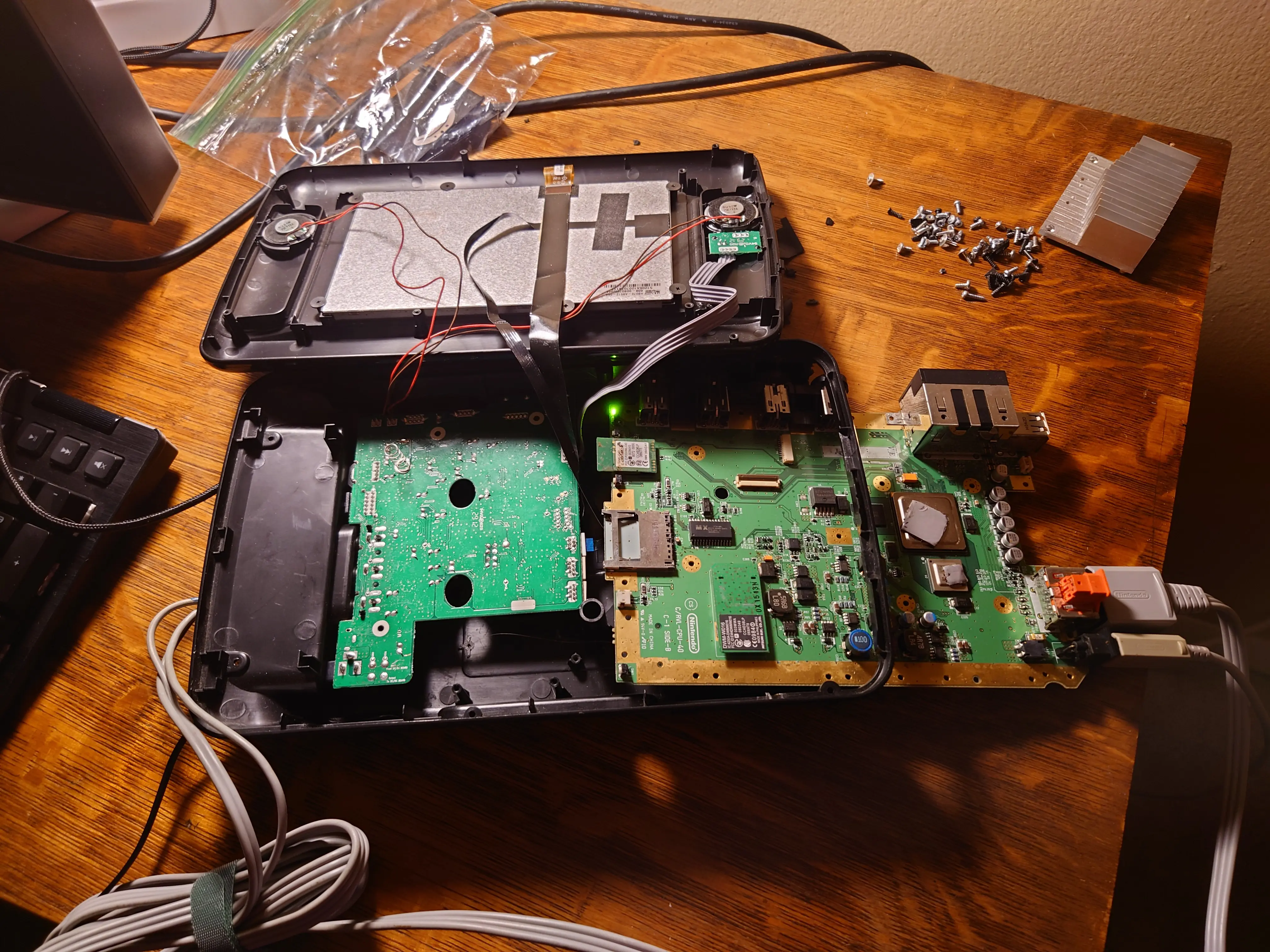

Current plans are to use the stock VRMs and power system of both the Wii and the player, as they just take 12V, and I want this to be a quick and dirty "just get it done" project. If I have loads of time left over, I'll look into a custom power system. If not, I'm having a hard time choosing between 10-12 AA batteries, and a 12V lead acid game cam battery. Both are very stupid, and therefore funny.
The player is rated for 9-12V, I tested it down to 6V with a cheapo universal power adapter and it seems to work okay, but the switch between AV and iPod dock mode stopped working. At 5V it doesn't boot up properly. The Wii probably doesn't have that kind of tolerance, I'll have to test it when I get a proper bench PSU.
I'm hoping I don't need to trim any boards, maybe I even have room for the stock Wii heatsink. I'm only worried about where I'll put the batteries. If I go with the AAs, they should hopefully fit in the shell. If I use the lead acid battery it'll be external.
I've already trimmed all the useless plastic bits out of the shell, apart from a big pillar that seems to be there to put pressure on the cable on the back of the display. It's very much in the way but I'm not sure if I should remove it.
