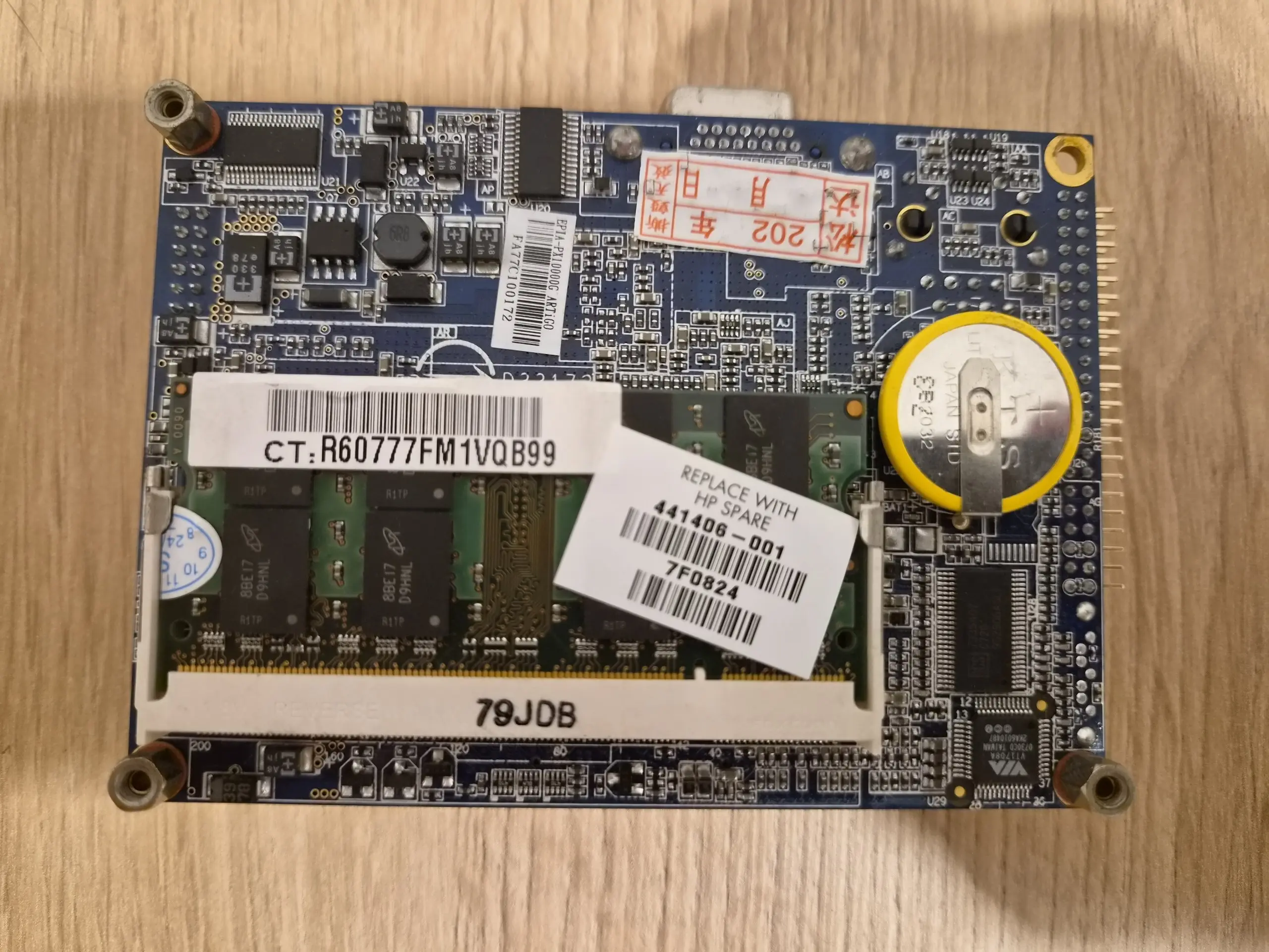

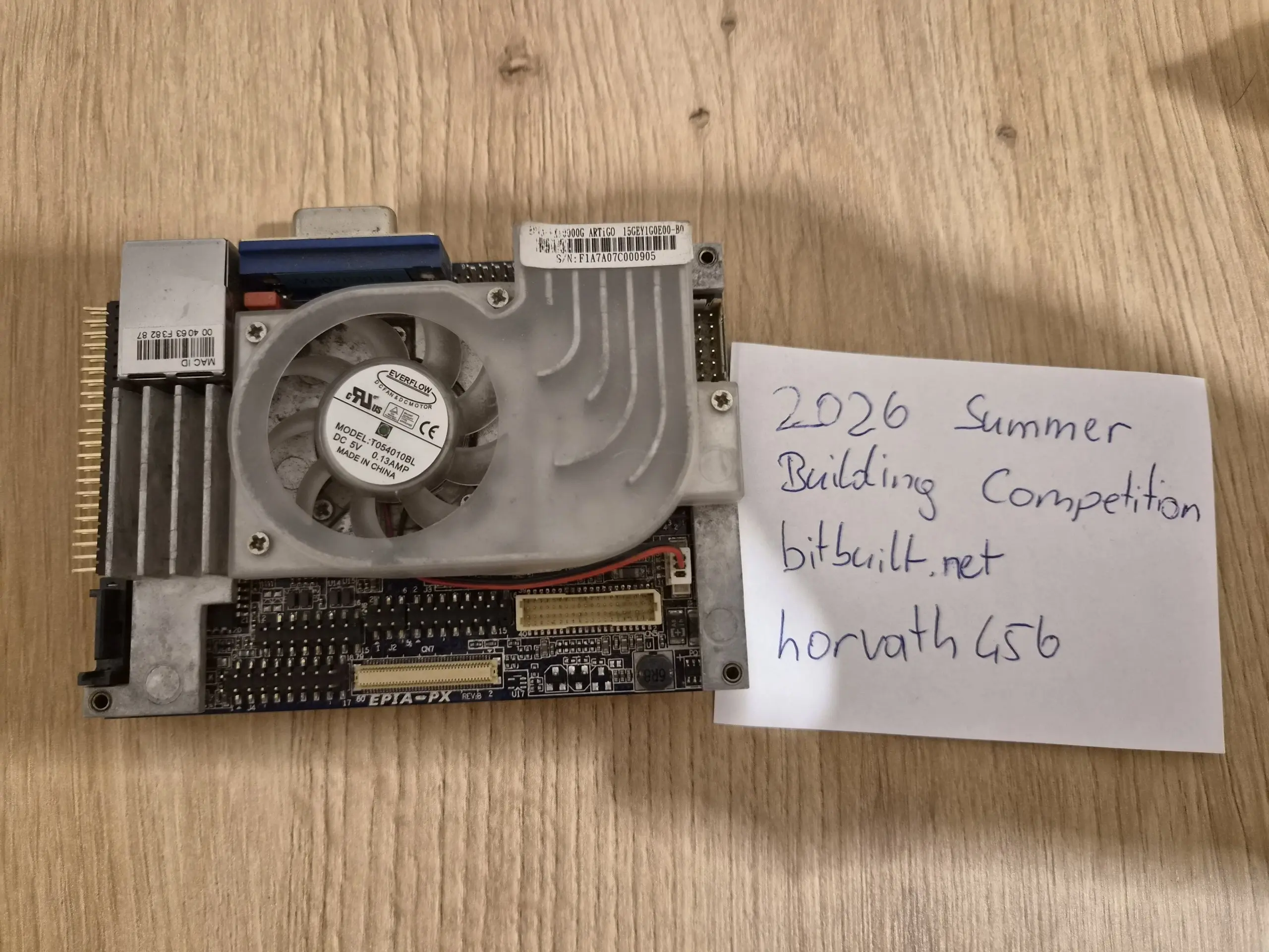

The main reason for starting V3 was finding the VIA EPIA-PX10000G. It is a complete 100 × 72 mm Pico-ITX PC with proper Windows 98 support, while being considerably smaller than the Nano-ITX board used in V2.

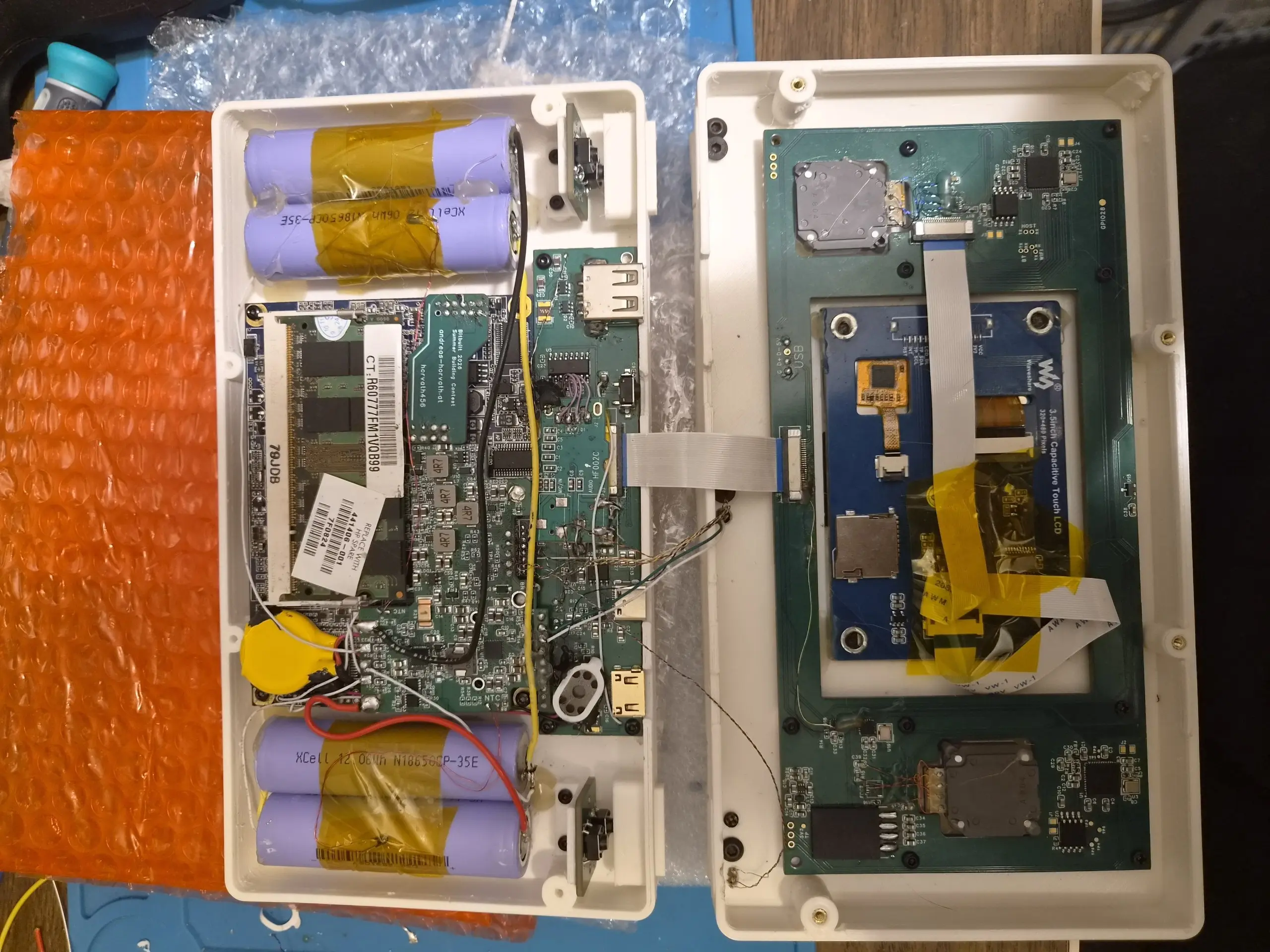

The 6.5-inch main display will be mounted in the lid. The lower half will contain the motherboard, controls and a 3.5-inch touchscreen for additional controls and system information. The two halves will be connected using two Nintendo DS Lite hinges.
I am aiming for a footprint not much larger than a 3DS XL and as little thickness as possible.

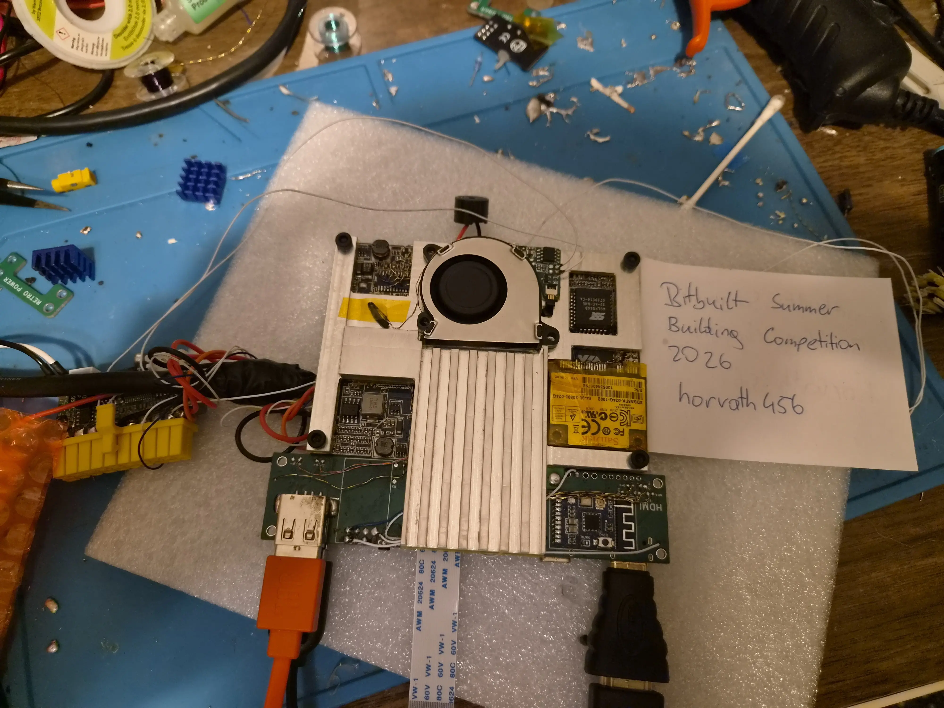

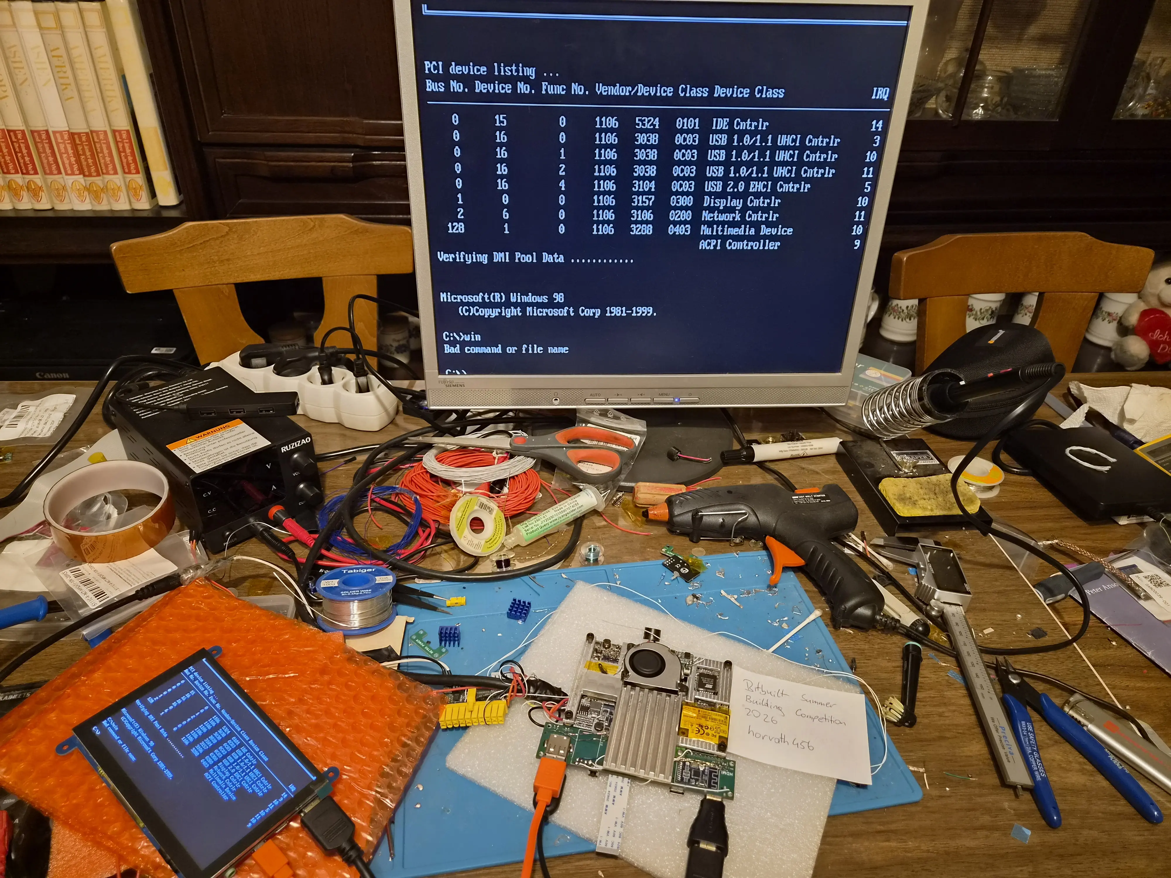

The PX10000G arrived today. I have not powered it on or tested it yet though.

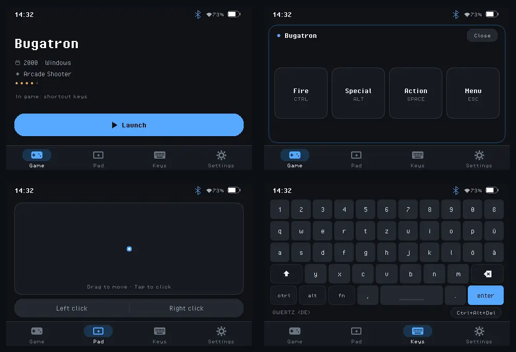

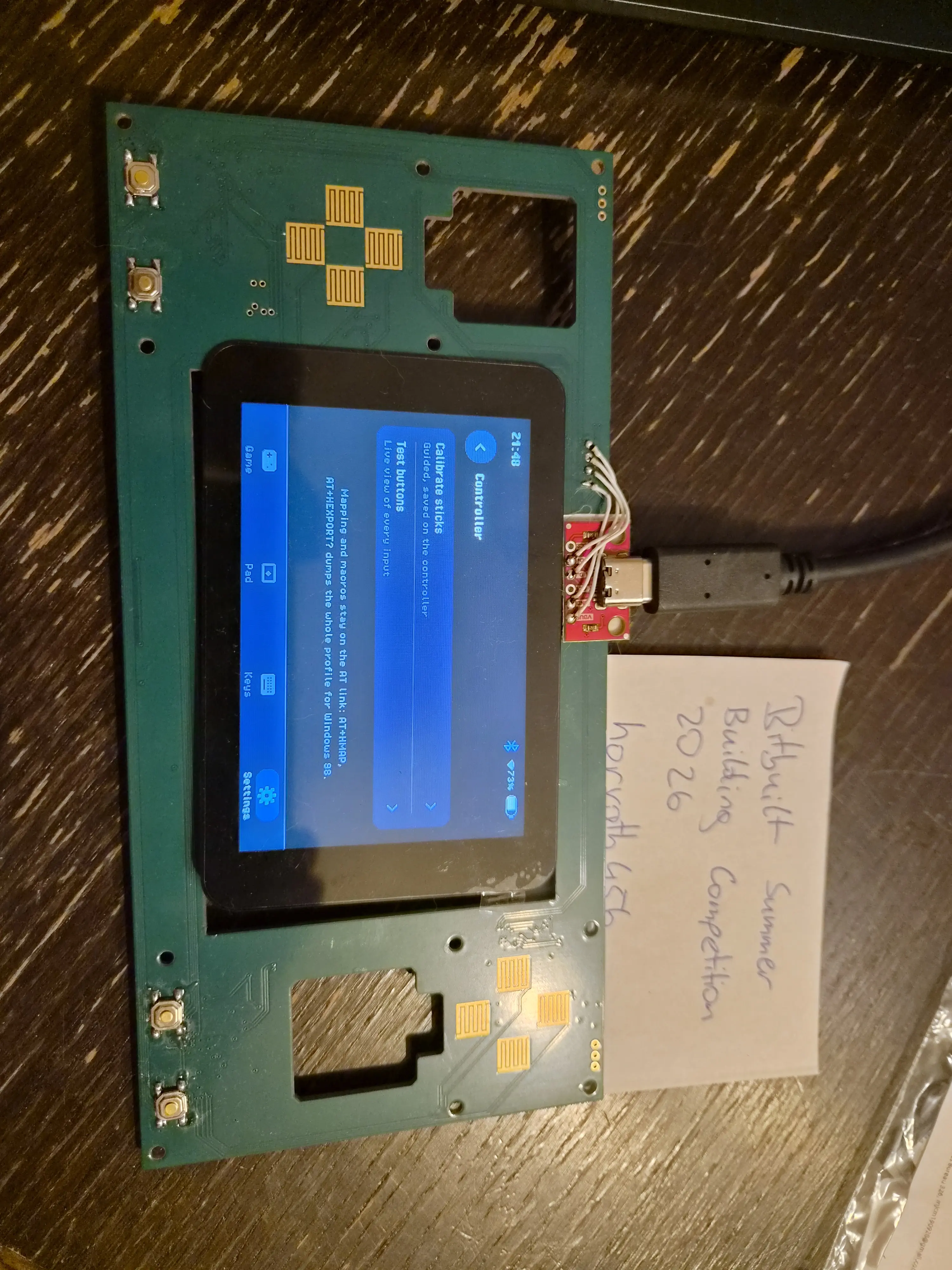

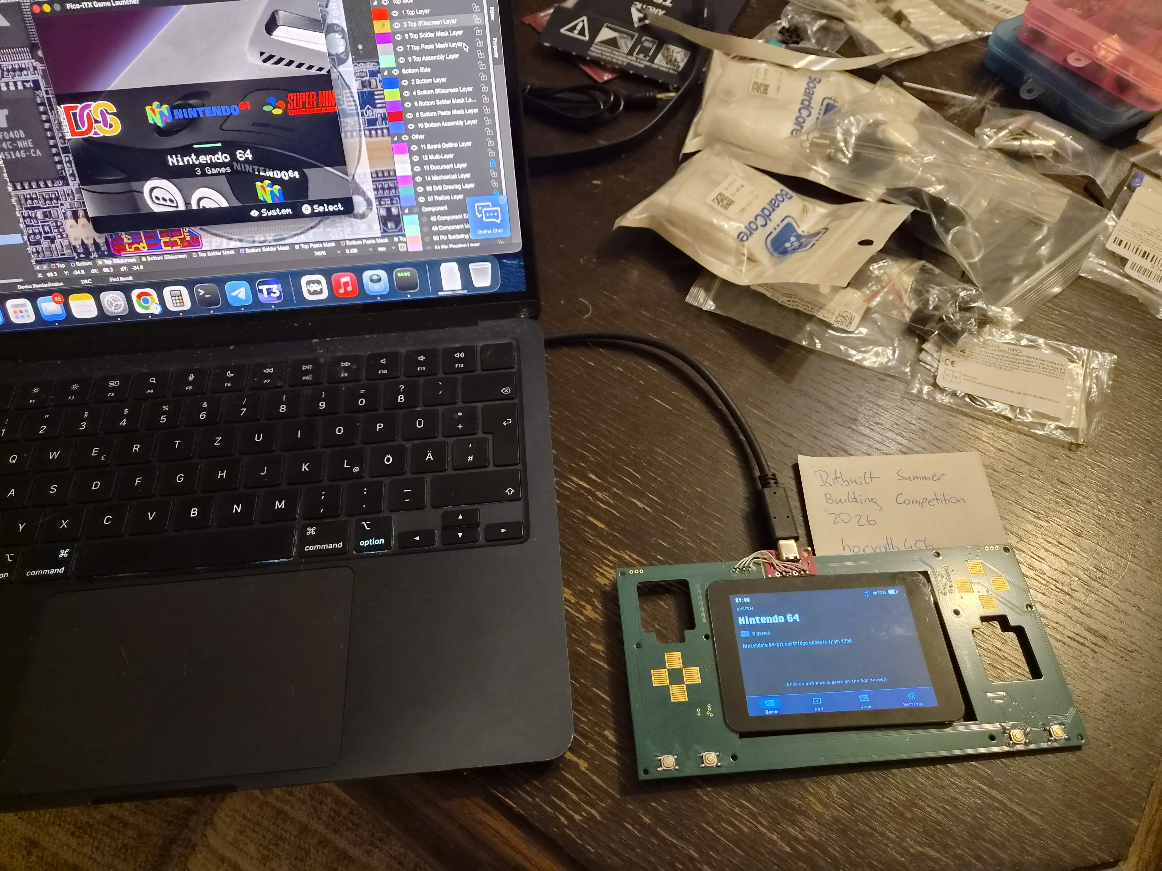

The upper screen will be the normal Windows 98 display. The lower touchscreen will be driven by one of the RP2040s and used for game information, shortcuts, an on-screen keyboard, touchpad controls and system settings.
The second RP2040 will handle the physical controls and appear to the PC as a USB gamepad, keyboard and mouse.

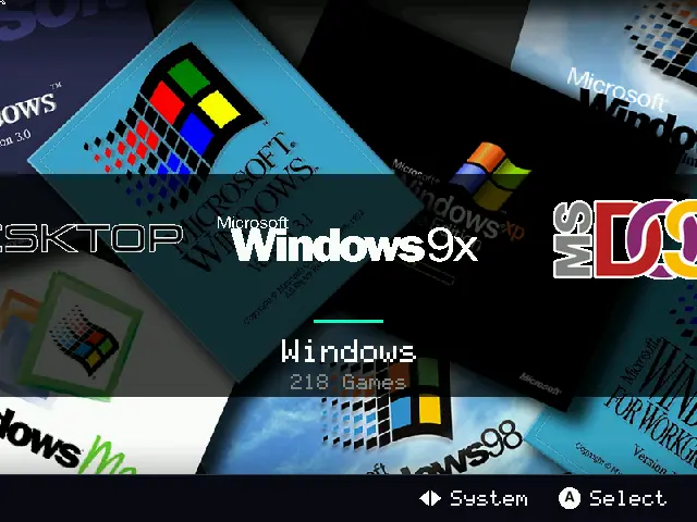

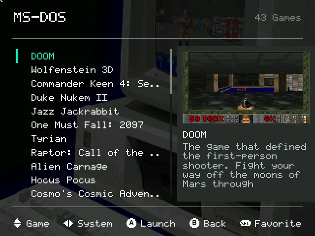

  • Custom launcher and companion interface

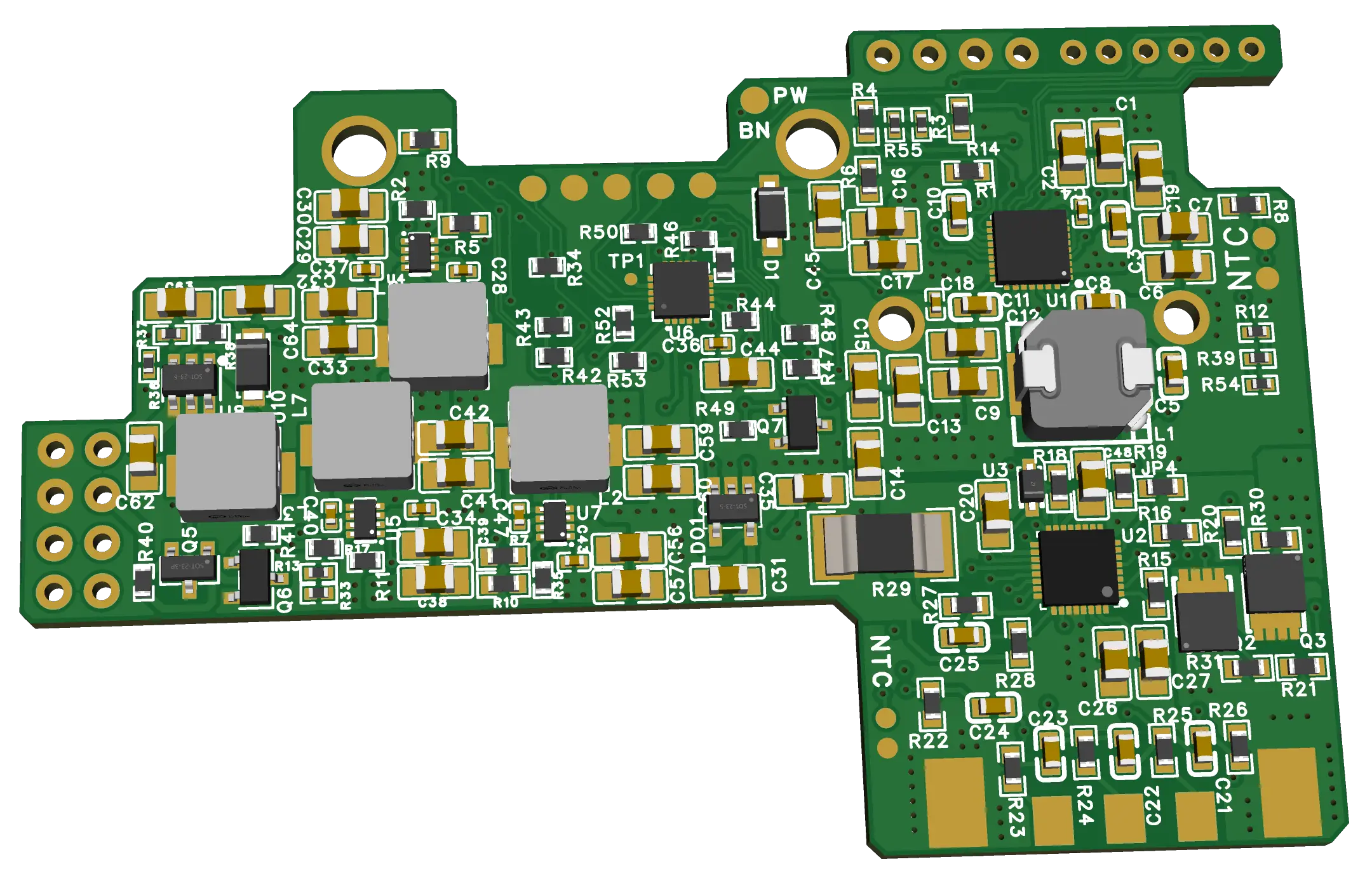

Power board
The power board replaces most of the individual power modules used in the previous handheld. it will be glued onto the bottom side of the pixoITX board and secured with 4 ground plane solder connections.
Main parts:
  • BQ25798 buck-boost battery charger
  • BQ41Z50 fuel gauge, cell monitoring, balancing and battery protection
  • ATtiny1616 for power sequencing, power-button handling and status communication
  • ATX PSU control circuitry and power converters built in
  • Connection for the four-cell battery pack
The board supplies the 5 V, 3.3 V, 12 V and 5 V standby rails required by the PX10000G. The ATtiny controls the startup and shutdown sequence and communicates the power and battery status to the rest of the handheld.

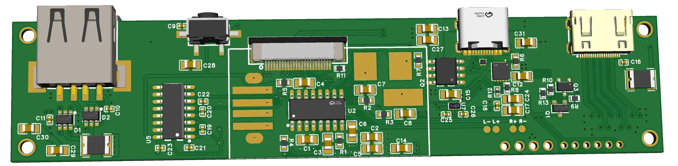

I/O board
The I/O board will sit along the rear edge of the lower half. It combines the ports, audio circuitry and optional radio modules on one long board.
Main parts:
  • HUSB238A USB-C Power Delivery controller
  • PAM8406 stereo class-D speaker amplifier
  • USB sound card connection
  • MAX3232 interface to the PX10000G serial port
  • ESP-01 footprint and control circuitry for Wi-Fi
  • KCX Bluetooth audio module connection
  • USB-C connector
  • External USB connectors
  • Mini-HDMI connector
  • Power button
  • Speaker connections
  • 24-pin FPC connector to the lower touchscreen/controller board
  • Resettable fuses for the USB and HDMI power outputs
The USB-C port will be used for power input and will also connect to the companion RP2040. Wi-Fi, Bluetooth and external HDMI are already included in the board design, even though they remain stretch goals for the finished system.

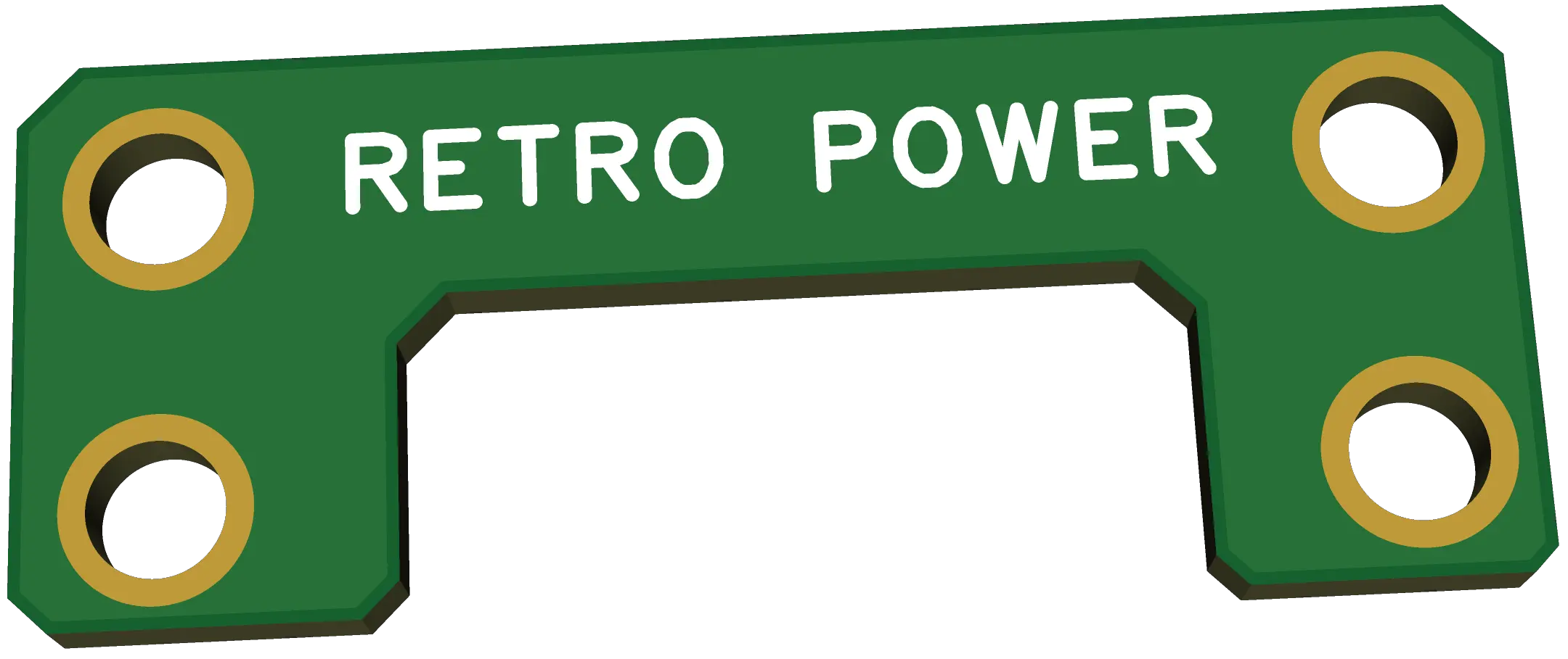

Power connector board

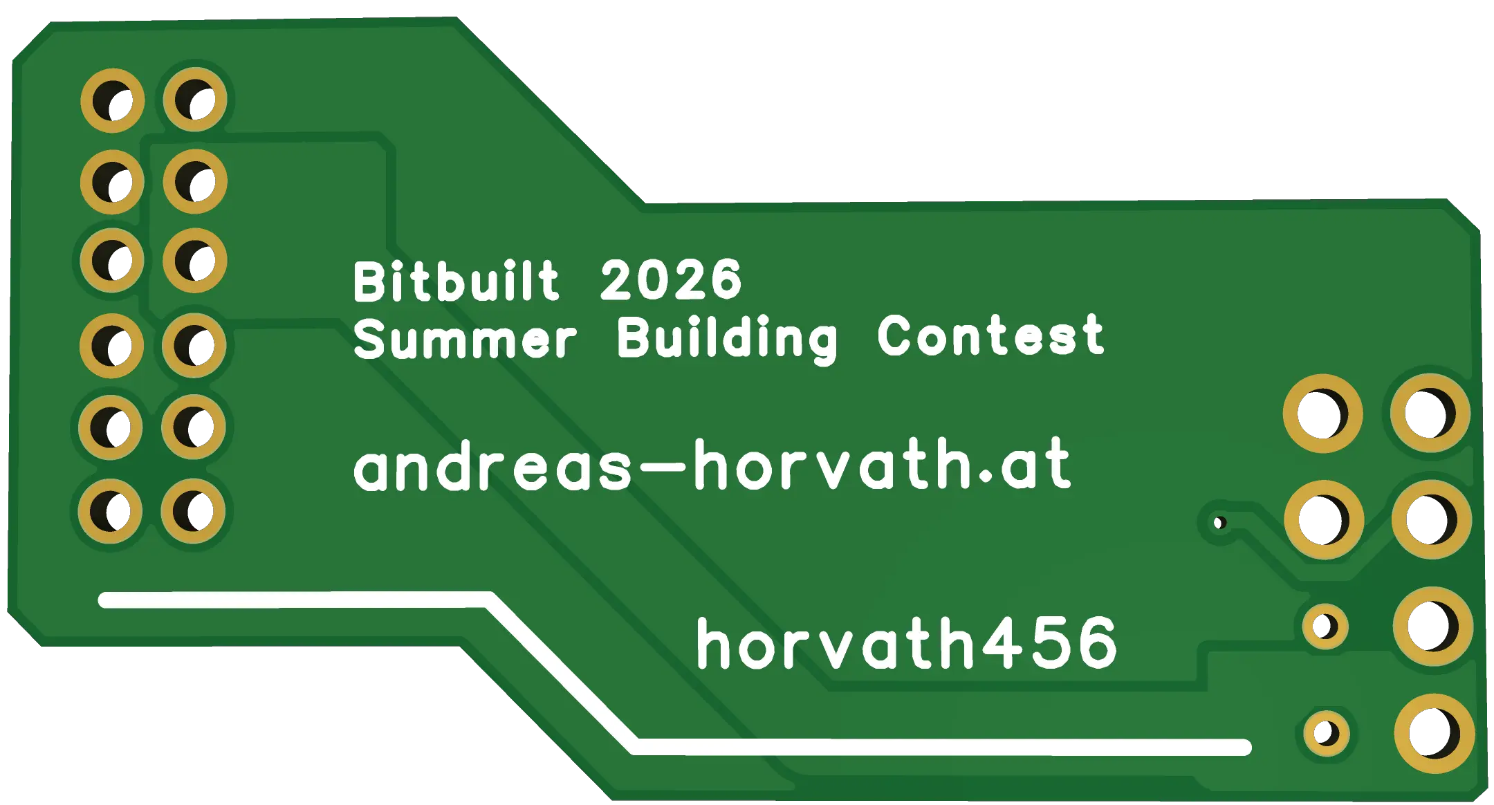

This is a small passive 4 layer board that plugs into the original 12-pin power connector on the PX10000G.
It connects the custom power board to the motherboard without needing a large bundle of wires.

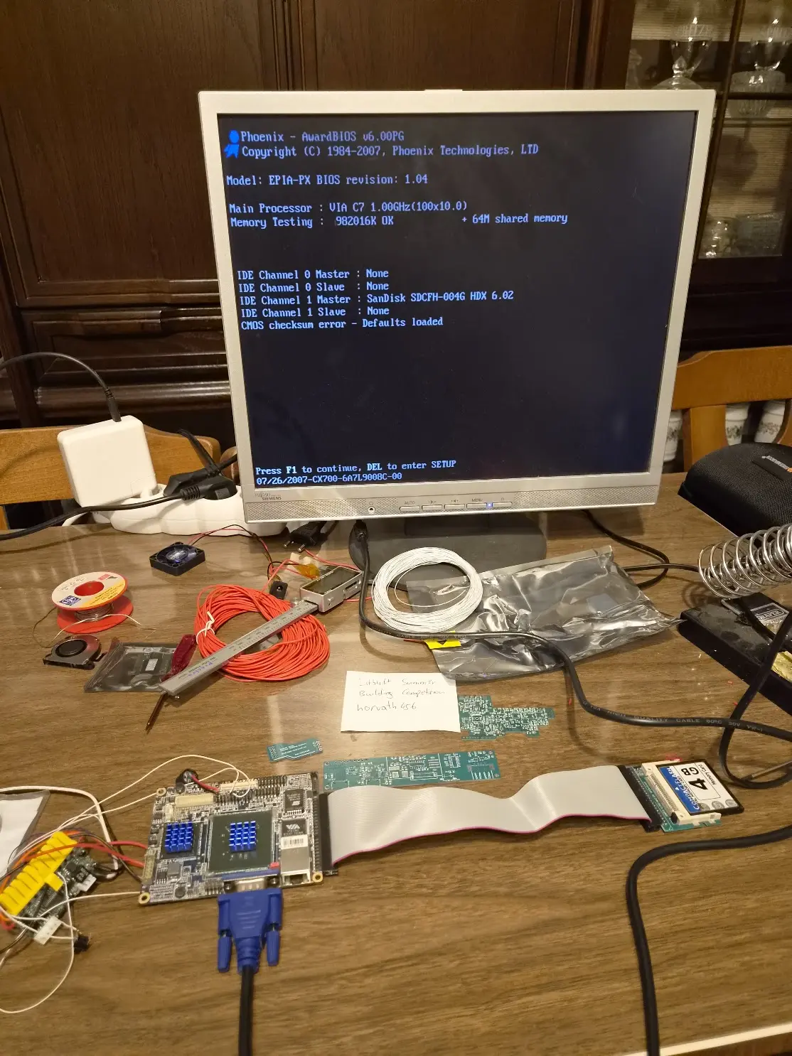

The next step is to power up the PX10000G, install Windows 98 and test its graphics, sound and power consumption.
The ordered PCBs should arrive shortly afterwards. They will come mostly assembled by JLCPCB, but still need to be tested thoroughly. The BQ41Z50 needs to be programmed and configured using TI bqStudio, I need to determine the correct register configuration for the BQ25798, and I still need to write and test the ATtiny1616 firmware. It will handle the soft power button, ATX power logic, NeoPixel status LED and serial communication.
I also need to design the custom controller PCB for the lower half of the clamshell. It will carry both RP2040s, the FFC connector for the lower touchscreen and the button contacts for the conductive rubber membranes. The two analogue sliders will sit in dedicated PCB cutouts and connect through separate 4-pin FFC connectors.
Once the motherboard and the first PCBs have been tested, I can determine the final internal layout and begin designing the clamshell enclosure.
