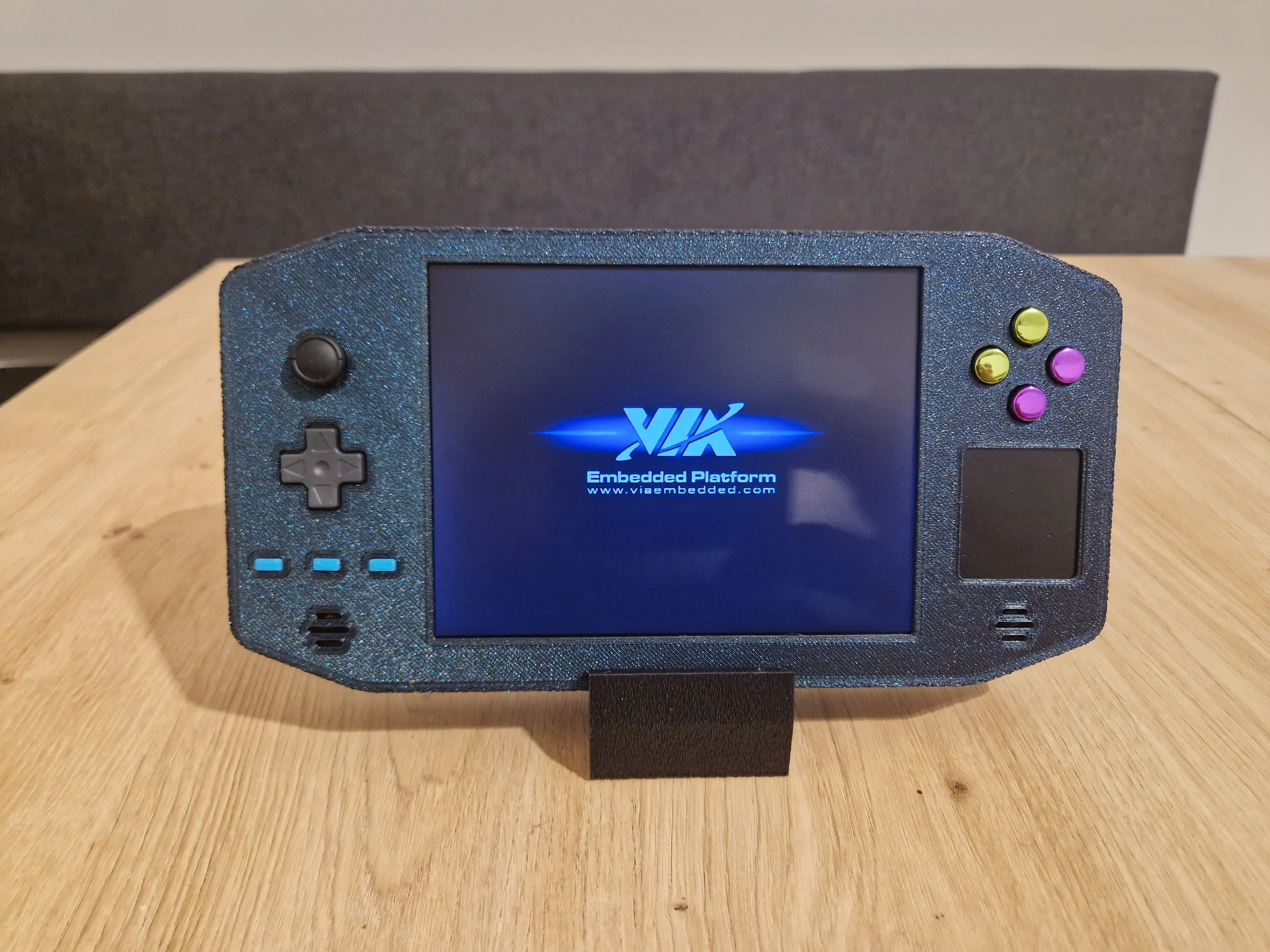

I started looking around for nano ITX motherboards and old single board computers, looked into PC/104 and the tinyllama, and what I ultimately came up with was the VIA EPIA nano ITX motherboard NL10000G. It has a really small form factor, excellent driver support for Windows 98 and has somewhat low power consumption (still 24W - which means battery life will be kinda poor but whatever - after all I could still use a PD capable powerbank)

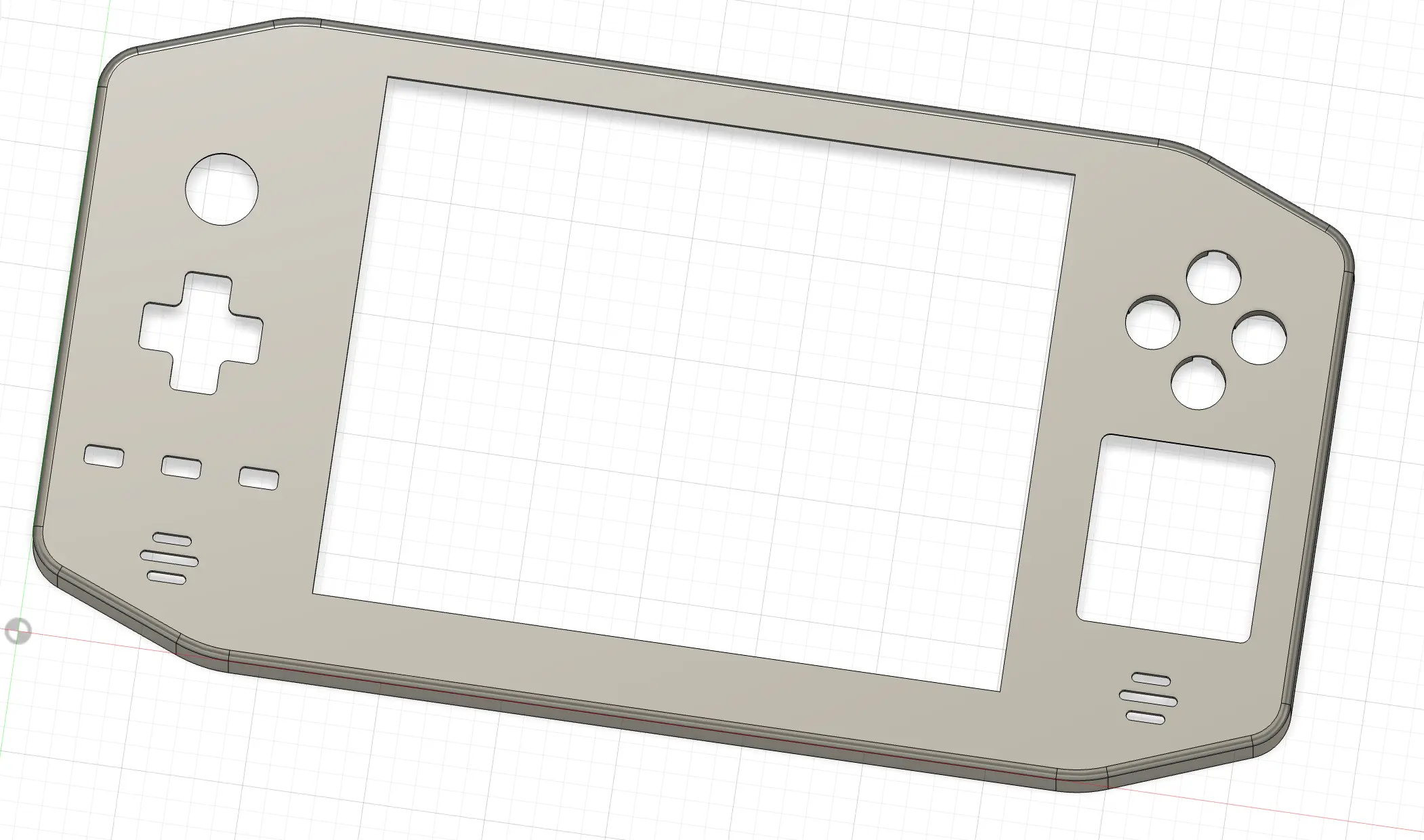

Case Design​
This is an initial case concept to establish placement and spacing of the display, the buttons, the analog stick, the speakers and the touchpad. It is a first version and will evolve as I validate mounting points, airflow, and cable clearances. The priority is clean internal routing and serviceability rather than chasing the absolute thinnest shell.

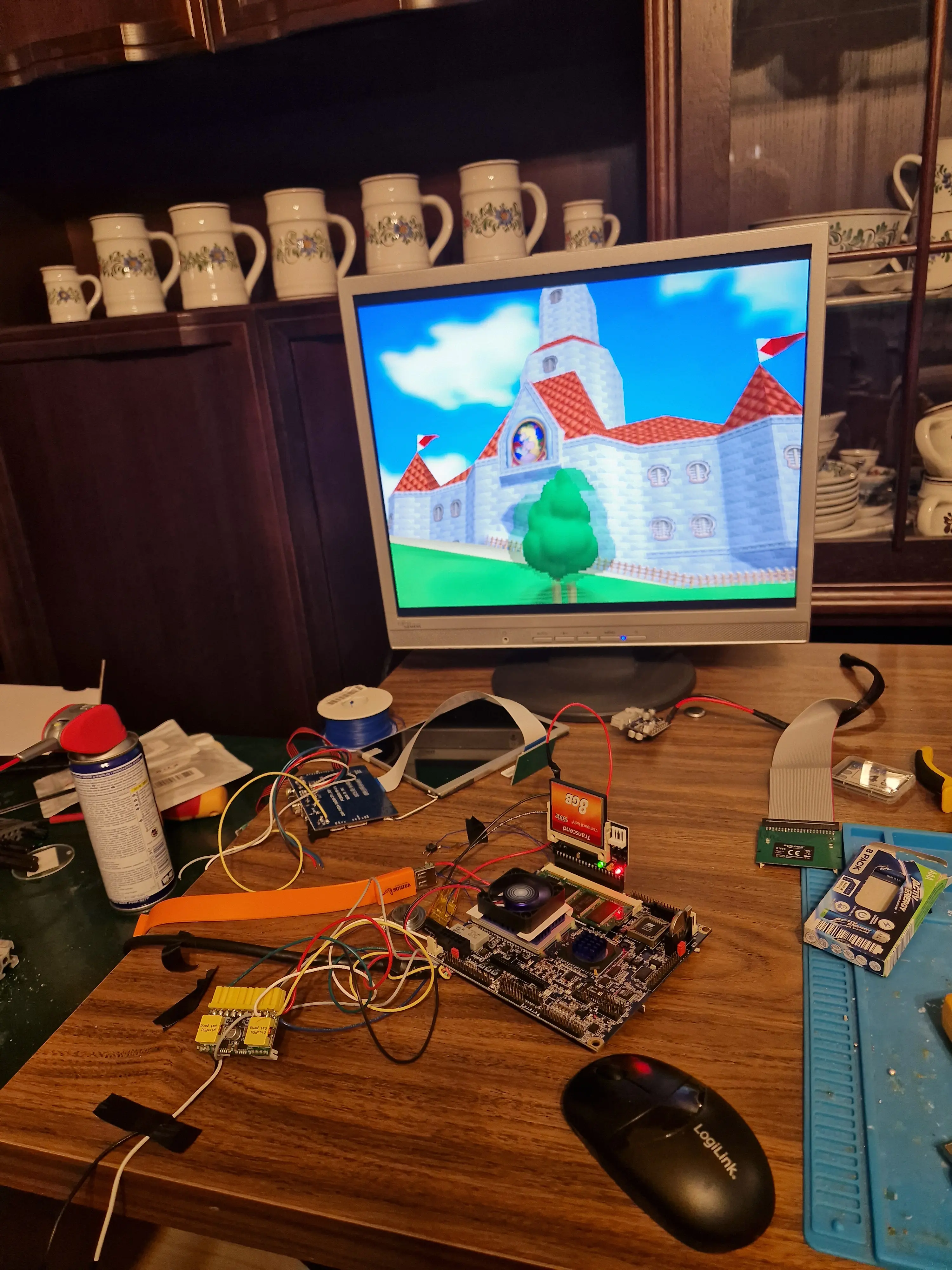

Upon the very first boot, the 12 V to 5 V converter that feeds the onboard audio section of the motherboar released the infamous magic smoke, so I removed it and decided not to pursue the onboard audio any further, as it did not even have proper MS-DOS support. The practical solution is an old USB 1.1 sound card that works under Windows 98. For DOS titles the built in sbemul.sys from Windows 98 emulates a Sound Blaster style interface for all DOS games that run under Windows. There is no OPL/AdLib FM synthesis, but digital SB effects and MIDI work reliably, which covers most of titles I care about.
I thought the board was toast, as even after removing the faulty converter the board had no POST beep(s) and no VGA or composite video output. I was about to give up on the board, when another boot suddenly just worked. I tested DOS games and found out that the PC speaker output is veeery quiet. I figured maybe the broken audio chip caused it to behave this way; I tried different speakers but ultimately just used a PAM8403 audio amp board to amplify the sound. Subsequent boots failed about 80% of the time and at first I could not figure out why. The beep code suggested a RAM issue, so I tried turning down the RAM clocks in the BIOS - which made it work reliably, yey!
This is a picture of me playing Super Mario 64 with Project64 on Windows 98 earlier this year:

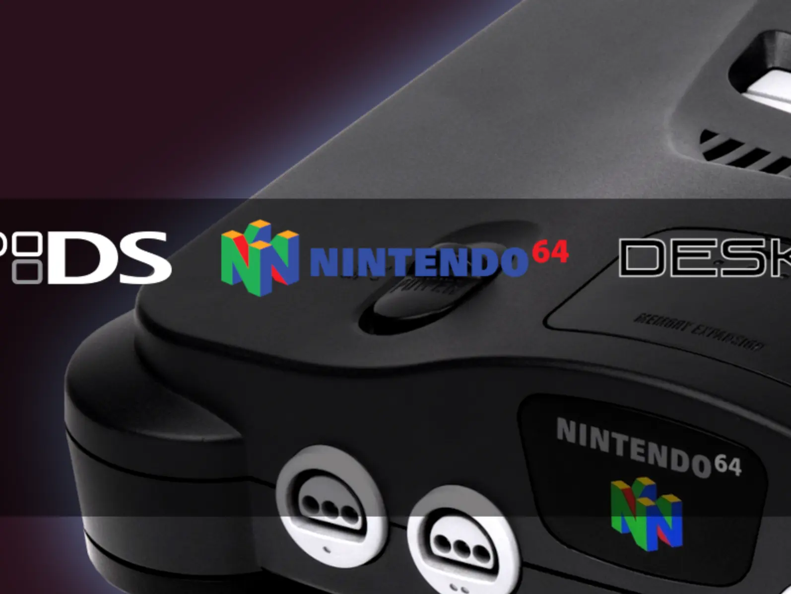

For launching games originally I planned to use the Windows 98 Active Desktop features which would allow me to customize the Desktop somewhat and allow single click launching of Applications. But ultimately I decided to quickly code my own launcher, inspired by early emulationstation versions. The first version is almost finished, and games can be configured using json files.

In the meantime I also finished the case design, right now doing a final test print of the front and the back.
The handheld will be 39mm thick, which is a bit on the high side, but I couldn't make all fit if it were thinner. The motherboard will sit in the back side of the case, in the center with the CPU side facing down to achieve some cooling with an active fan. Left and right of it will be the battery cells as well as the power circuitry on the left and the CompactFlash card on the right. There are also cutouts for an rgb pushbutton and a dual USB port.
The front side has the screen along with its driver board, the buttons, the touchpad, the speakers, the USB-C power input board, the arduino pro micro, the USB sound card and the audio amp board. Also it has cutouts for an external VGA port to connect to a monitor as well as a headphone jack.

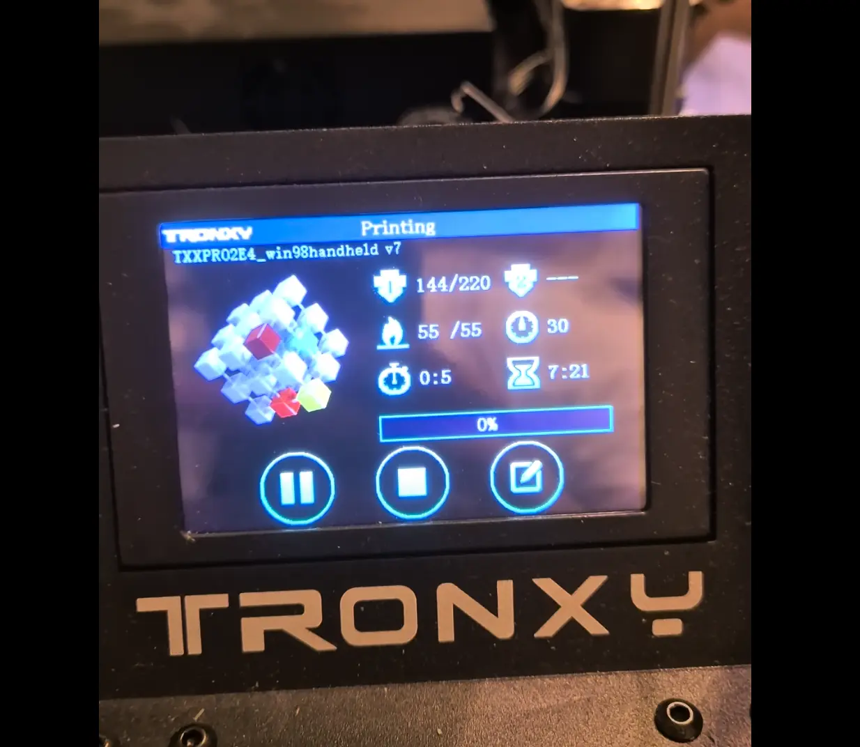

I had a lot of problems with my (cheap) 3d printer, which I spent one and a half days fixing. The hotend temp was just dropping mid print for some reason, and what fixed it was a firmware update and a good cleaning of the clogged hotend.

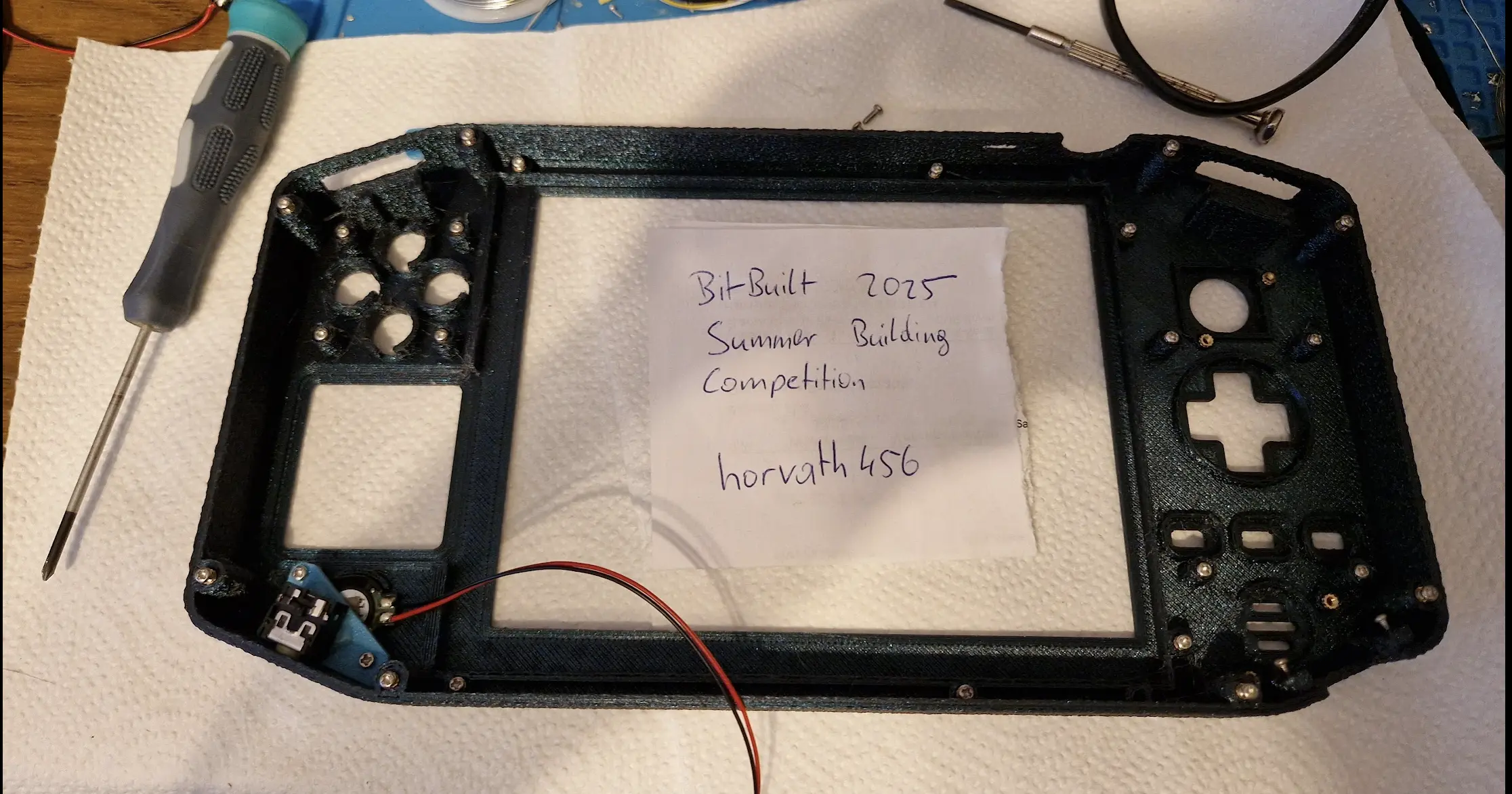

In the end I decided to skip my planned test print and got straight to making the final front half of the case. I fitted all the screw posts with brass inserts for easier assembly and durability. Most of the things will be mounted with screws in the case, except the touchpad and the tact switches for the shoulder buttons.

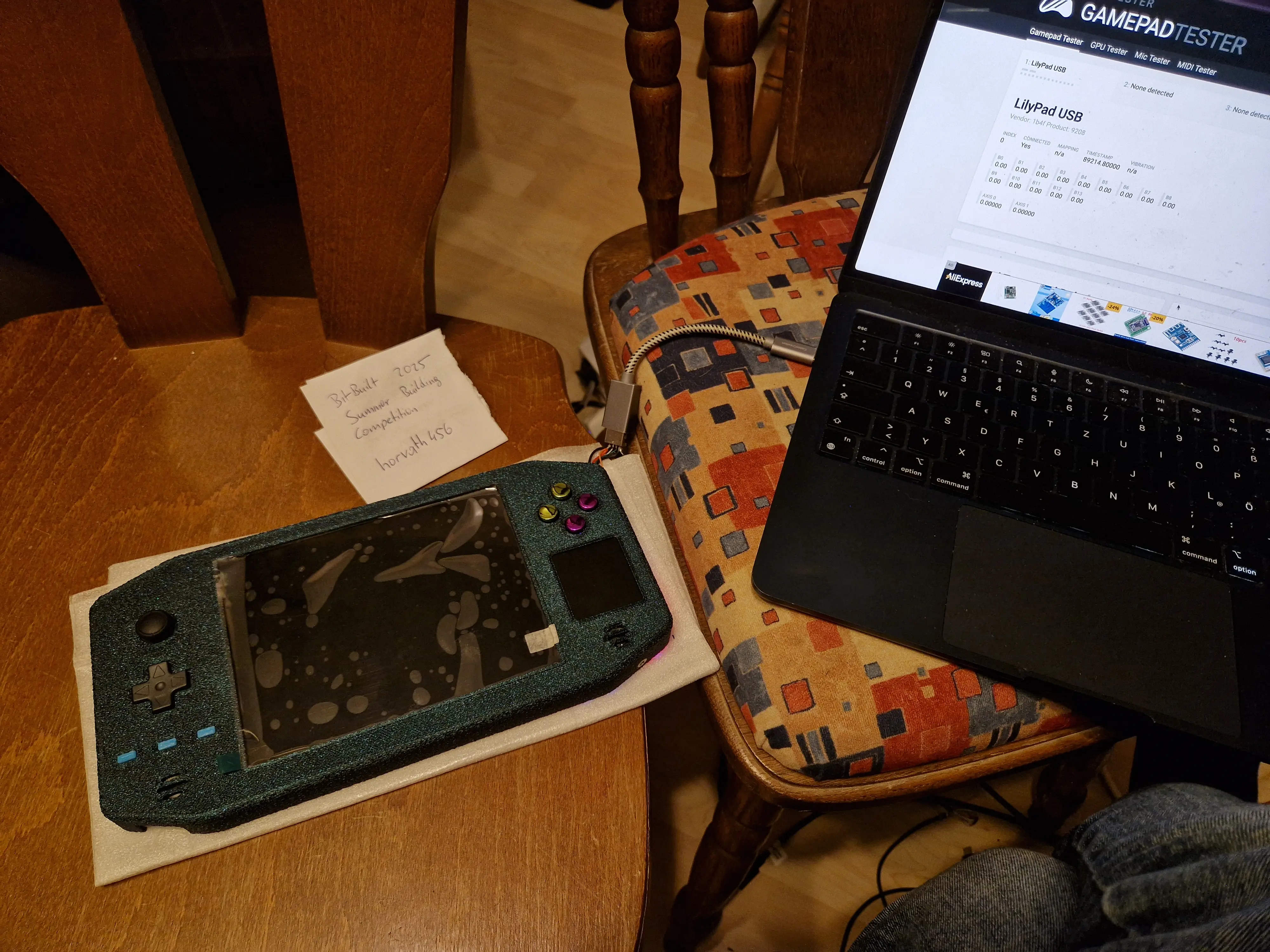

Today I started fitting all the components:
And tested the gamepad with my macbook:

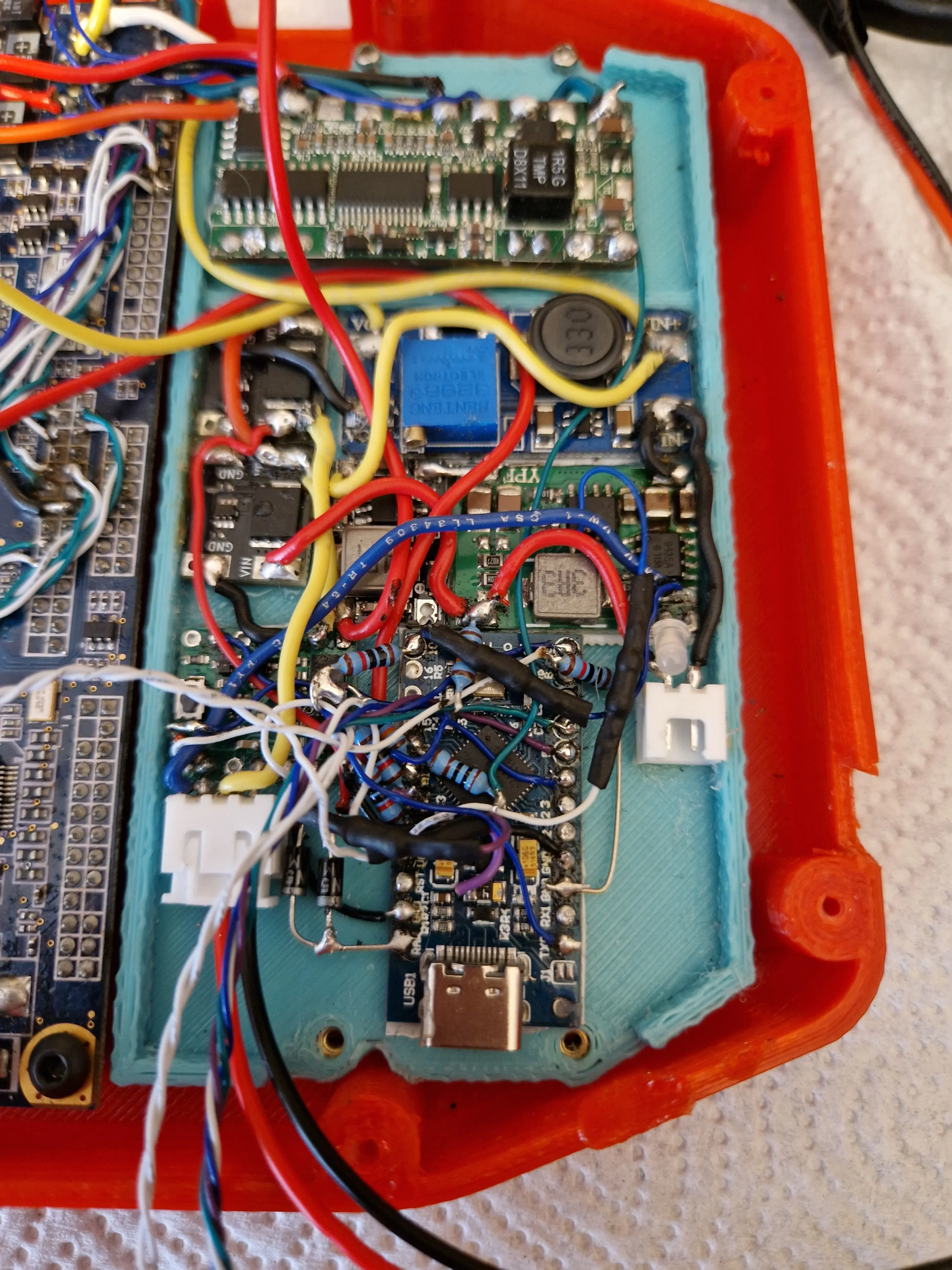

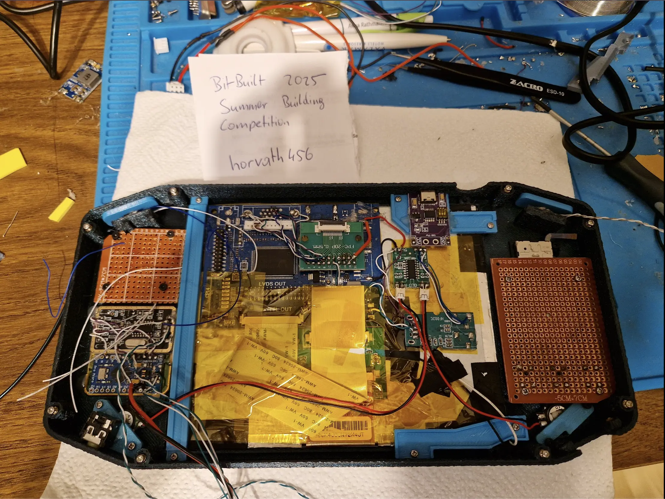

While the back half is printing, I mounted the PCB in an early test print of the rear case, and got to work on the power circuit.

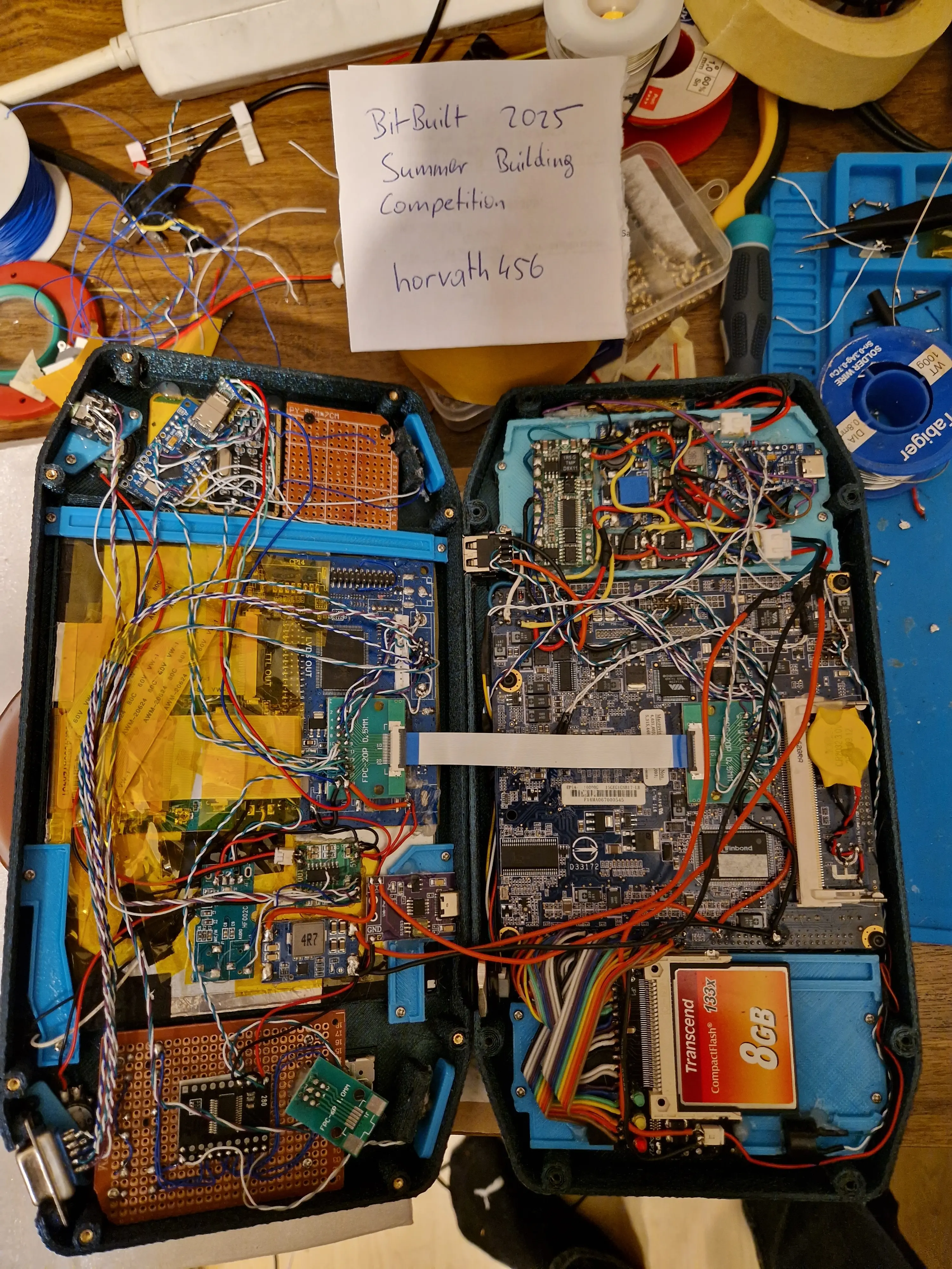

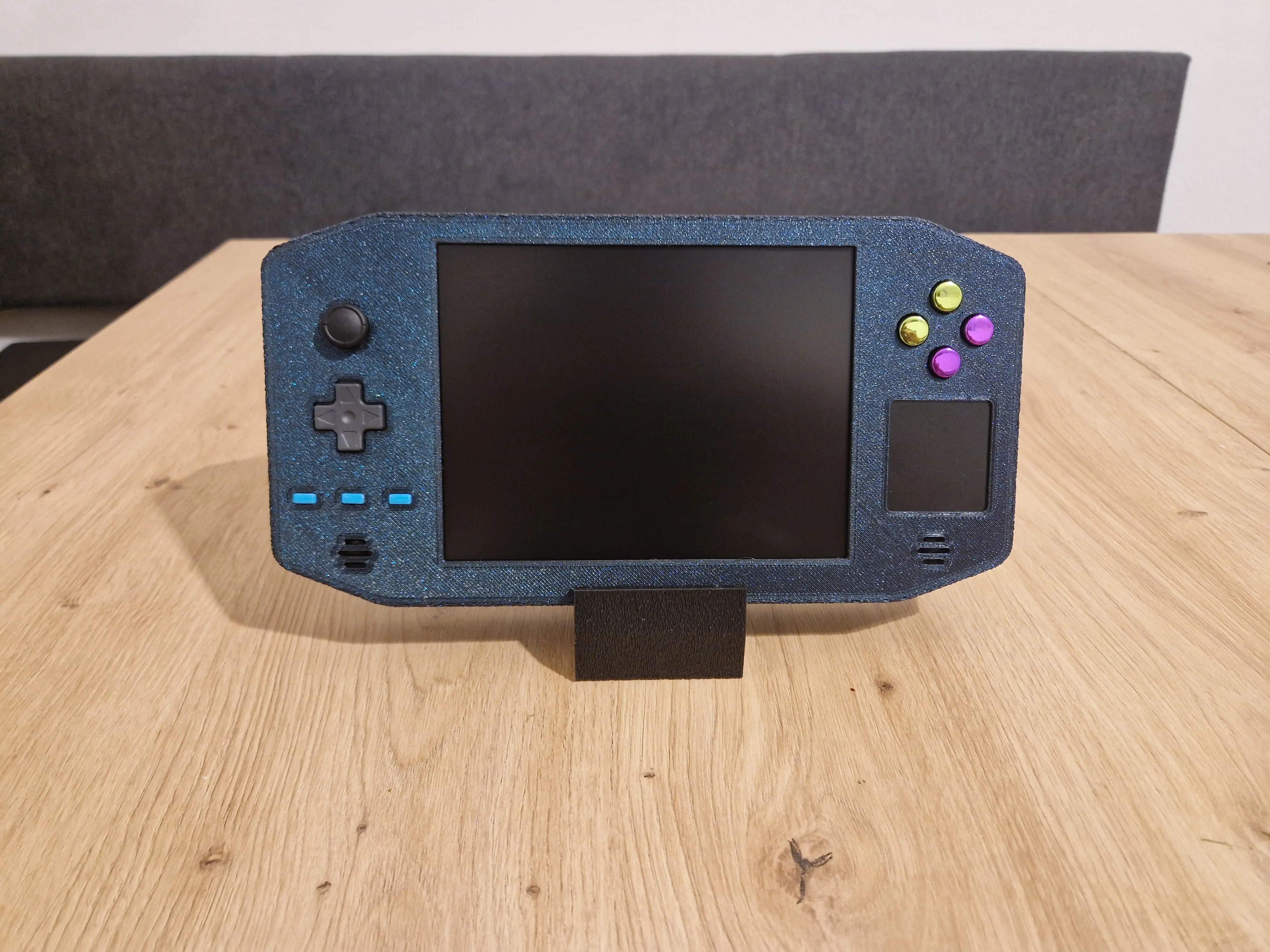

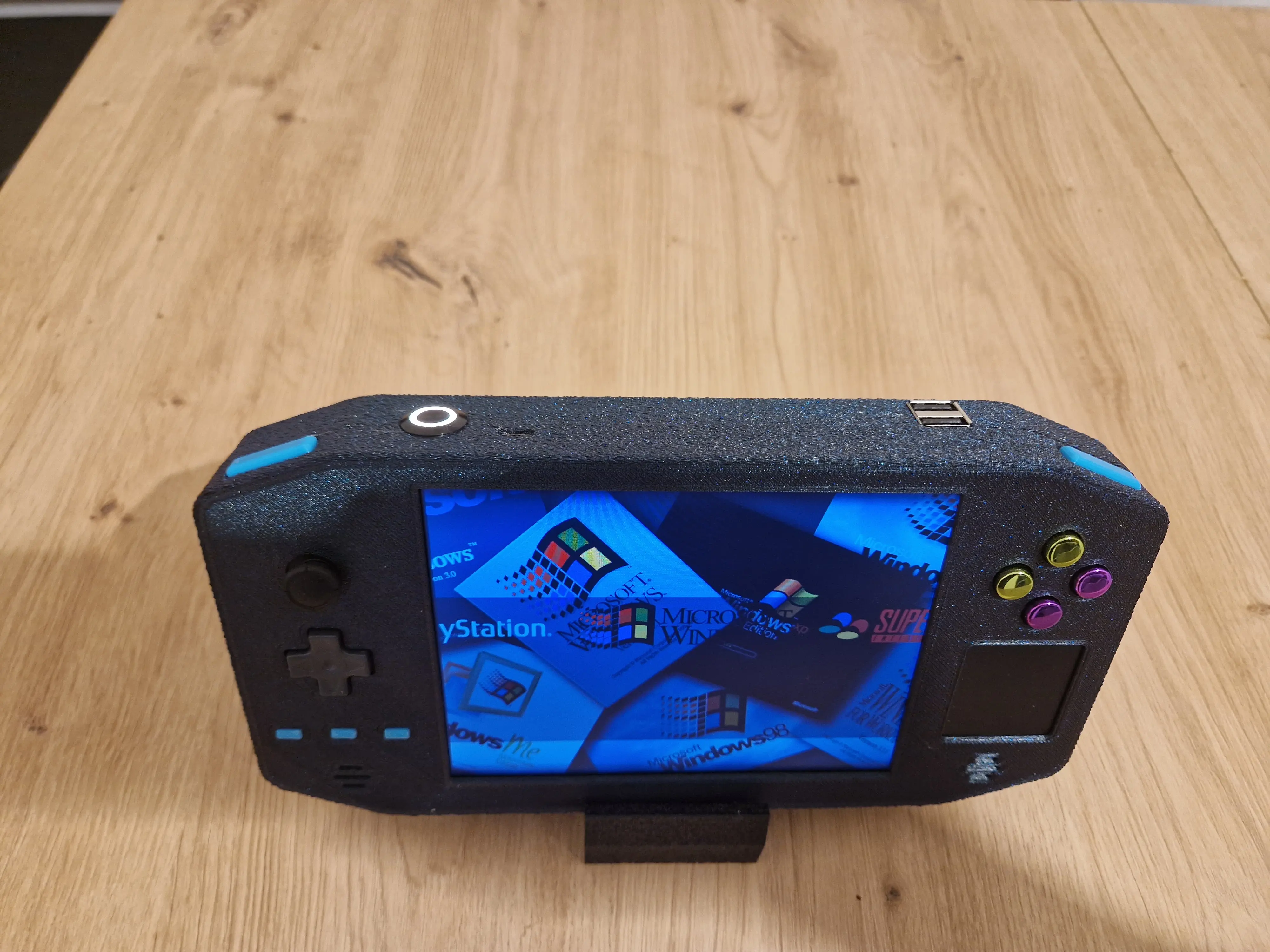

ITS DONE​
I just put the last screw in. These were very stressful days, but I finished building my second portable x86 handheld!
Features:
  • 7 inch 4:3 VGA screen
  • analog stick, dpad, 4 action buttons, left and right trigger buttons + a mini touchpad
  • fully remappable controls with an arduino pro micro acting as joystick + keyboard + mouse
  • VIA nano ITX motherboard running Windows 98 natively
  • DirectX support
  • USB PD charge and play
  • soft latching power button with RGB led indicator
  • dual USB jack and external VGA out
  • Stereo sound with switching headphone jack and internal PC speaker
  • 7.4V 5000mah lipo for 1.5h of runtime
  • custom explorer.exe replacement shell to launch games and configure the controls optimally for each game
  • tray app for Windows 98 classic desktop that shows battery percentage
Internals:
Closed up:
I set this as complete, I will edit this once my video is uploaded.
