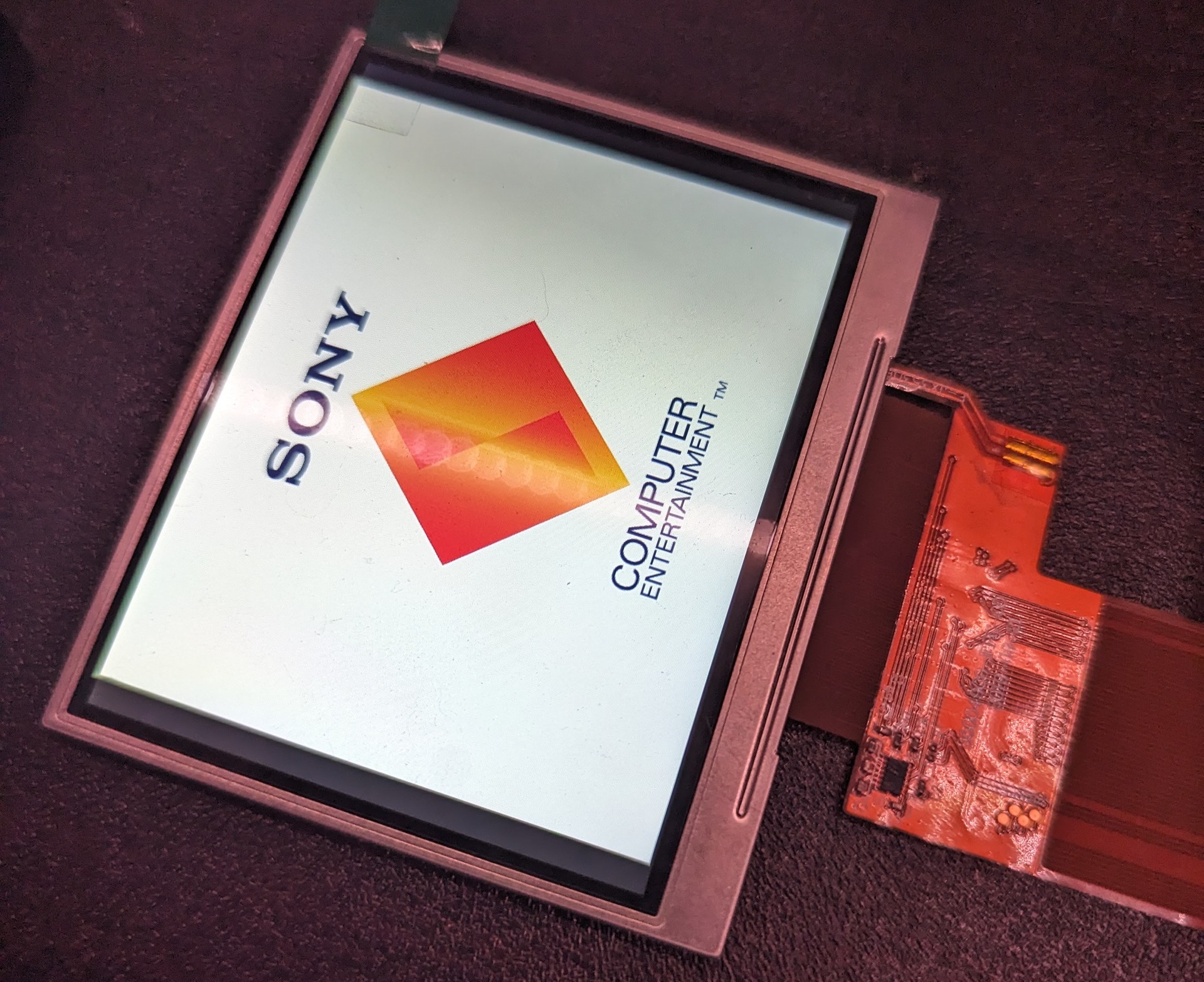

3. Display: After playing around with the 3.5in 4:3 txwei/wisecoco screens I purchased through Yveltal's group buy, I've determined that this is the display that I want to use. Combined with the theorized trim, we're looking at a pretty small footprint overall! If you're familiar with the scale of the 3.5in screens, this image may give you a sense of the overall size of the trim we're working with.
Pretty small, ey?
With PU-23 however, it seems like it does *not* provide HV sync right on the board. The GPU instead will generate a CSync signal instead, which gets fed into the video DAC. We unfortunately can't just tap into the CSync signal, as doing that messes up the analog video outputs, so we'll get into the solution for that problem later in this post...
Unfortunately however, the driver board for the 3.5in display does not support 240p over VGA. It does kinda support it over HDMI for some dumb reason, but VGA gives a red "Not Support" screen. So, we're gonna have to do this one of two ways. I can either build Shinobi Scaler into the project, or I can hand roll an FPGA based line doubler that will spit out the 31kHz 480p RGBHV signal that I need for the display driver. Shinobi Scaler is great, however the TVIA chip on the GBS-8220 boards (and subsequently, Shinobi Scaler) gets really hot and can draw upwards of 2.15W! Yikes! I think the best approach will be a FPGA based line doubler tailored for the project, but I'm worried about time. I'm going to pick up a Tang Nano to start some development work and see if it will at all be a viable approach, but I might be able to come up with something.

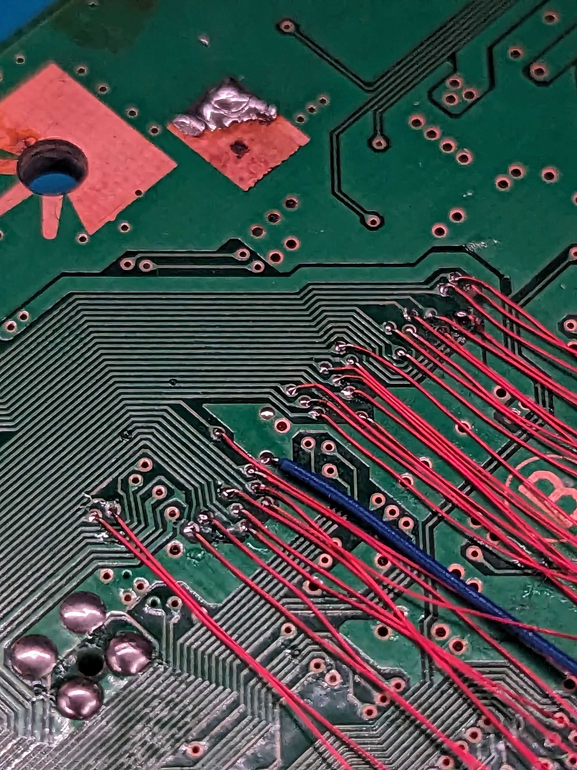

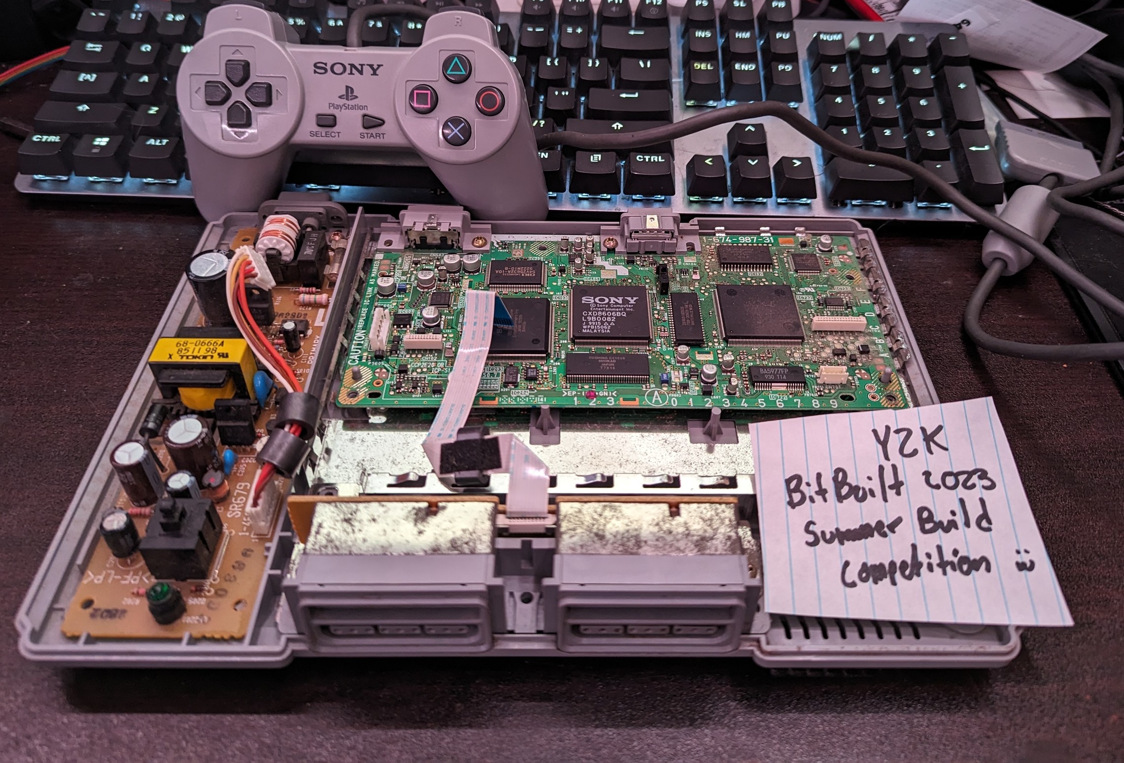

Initially I started out by performing a hand wired BIOS relocation on a PU-18 board I had received from @RegDogg. Unfortunately however, I ended up killing that board. That was probably one of the major reasons I went ahead and moved to PU-23 instead of sticking with PU-18, but fortunately enough that ended up being a blessing in disguise. I'm still not even sure exactly what went wrong, but that board's sacrifice will not be in vain!
So, after waiting a few days, the new sacrificial lamb arrived, along with a controller since I didn't have one already.
I was a bit worried when I ordered this board, since the unit was untested, and the top shell was not at all the same one that originally came with this revision, mainly because it still had the cutout for the parallel port. Fortunately though, this board works perfectly, and even the drive was able to play audio CDs!

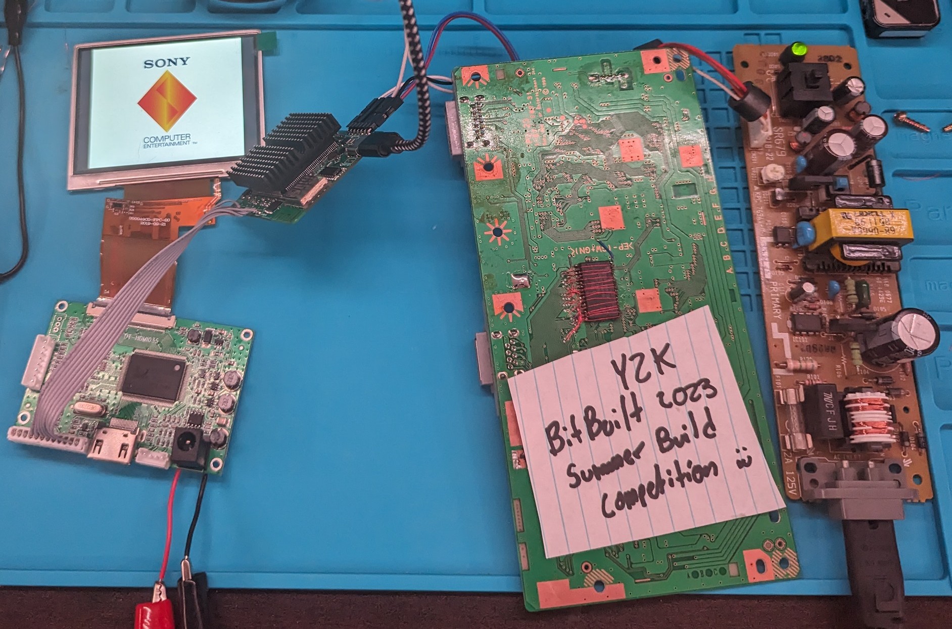

In any case, for future testing I decided that it was just going to be easier to get the 3.5in display hooked up. The driver board's firmware doesn't support CVBS though, so I'd have to hook it up via VGA. Shinobi Scaler came in super handy here, and fortunately enough was able to accept the Luminance part of S-Video as a sync source, so I was able to get a pretty damn good looking image out of the PS1.

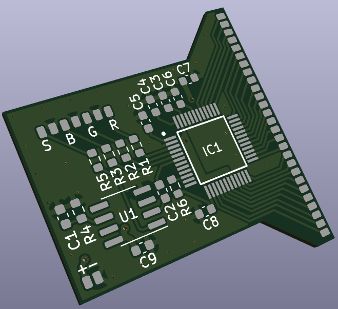

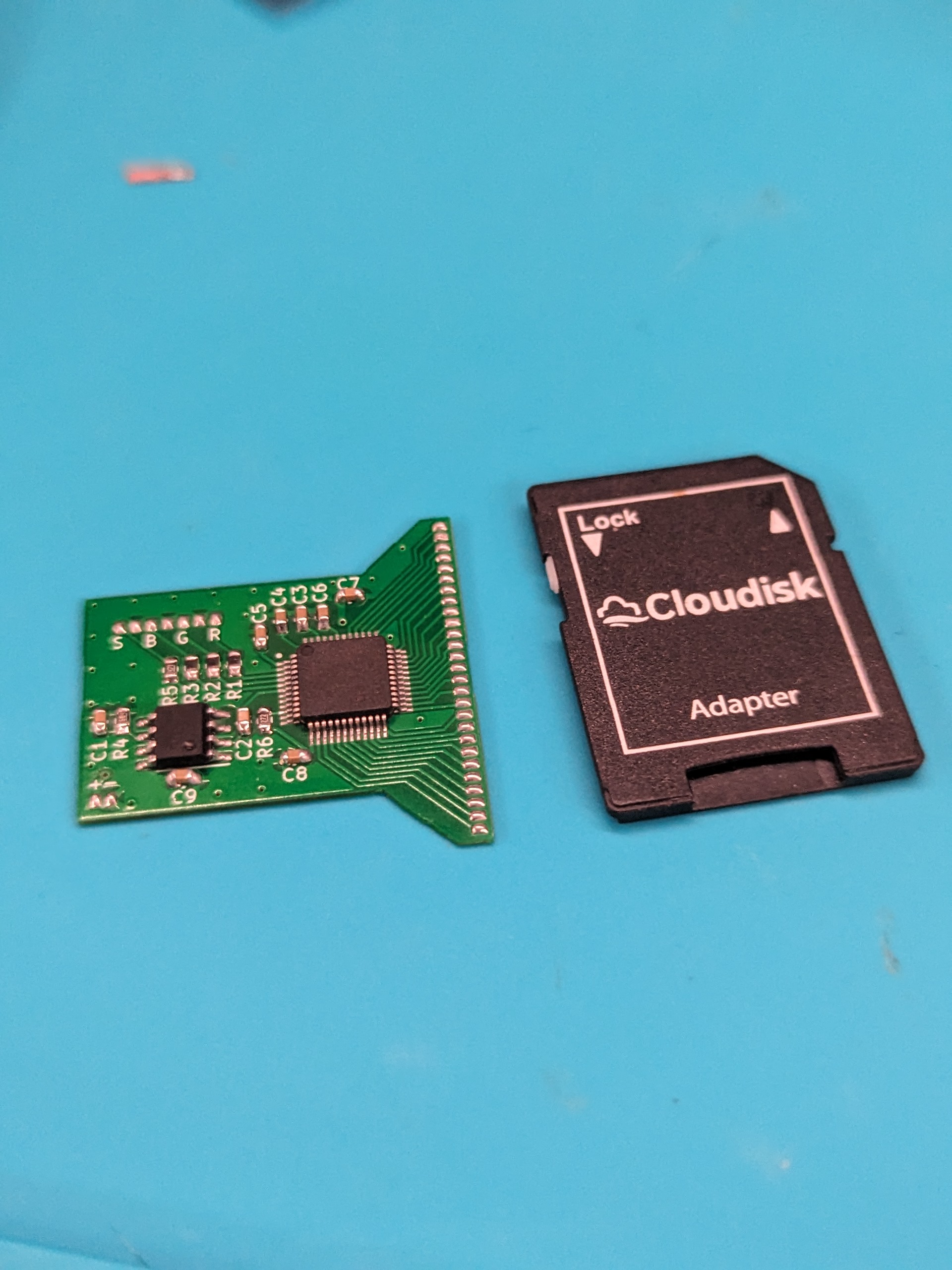

This is the video DAC relocation board, and will be crucial in obtaining the small trim footprint that I'm aiming for. I was initially wanting to make this a flex PCB that connects to the digital RGB vias on the back of the board, however I found that to be way too much of a hassle to get the routing done correctly, so I made it a rigid PCB that you magwire the digital RGB connections to it, along with power, and it spits out hopefully clean 15kHz RGBS video. We'll still need some line doubling solution, but that will come later.
A quick overview on how its able to spit out CSync - U1 on this board is actually the trusty LM1881 sync separator IC! It takes in Luminance from the video DAC's S-Video output and spits out a clean CSync signal! I believe it can also spit out H/V sync too, but I haven't looked too closely into that, and CSync should still serve my purposes nicely.
I'm very happy with how this turned out, and will likely open source the design for anyone else to use, once I can confirm it works. Hopefully by the next update I'll be able to show it off!

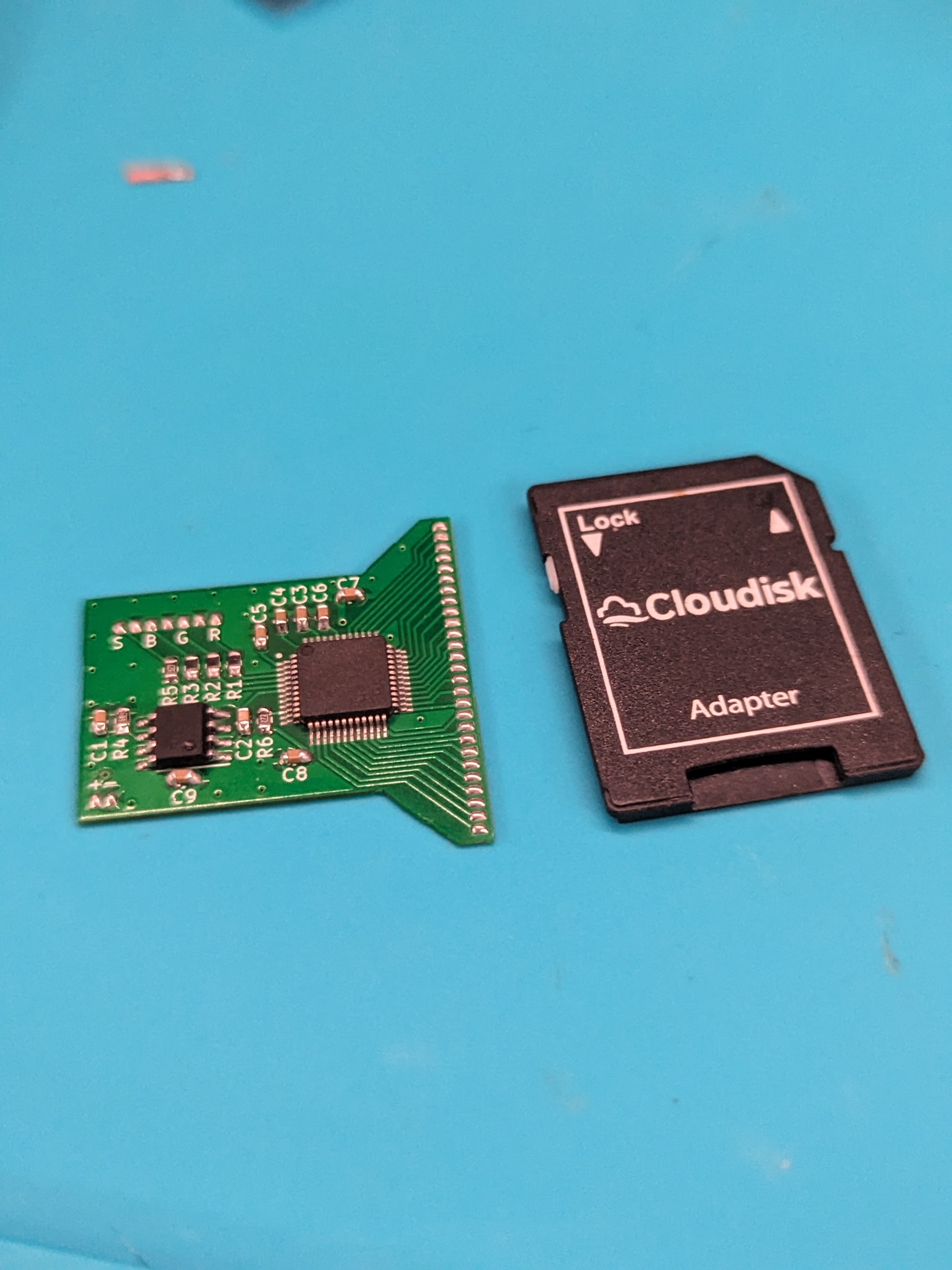

First thing's first, I received the VDAC relocation boards from JLCPCB, and they work better than I could have ever hoped!
I'm fairly certain the artifacts in the video are a result of my Shinobi Scaler being wonky, and not because of the VDAC relocation. Otherwise, I can tell that the image is going to look fantastic in the final build!
In terms of how I'm actually going to get the display to play nice with the 15kHz RGBS signal, I'm currently looking into RTD2662 firmware mods - I've spent some time writing definitions for the screen & driver board, but have not tested anything yet, so stay tuned for that! Theoretically, though, with a modded firmware, we should be able to enable 15kHz support for the 3.5in display driver, which would be pretty great! The driver board is fairly low power and doesn't generate really much of any heat, so it should serve as a better alternative to Shinobi Scaler for my build, where the MO is no heatsinks!

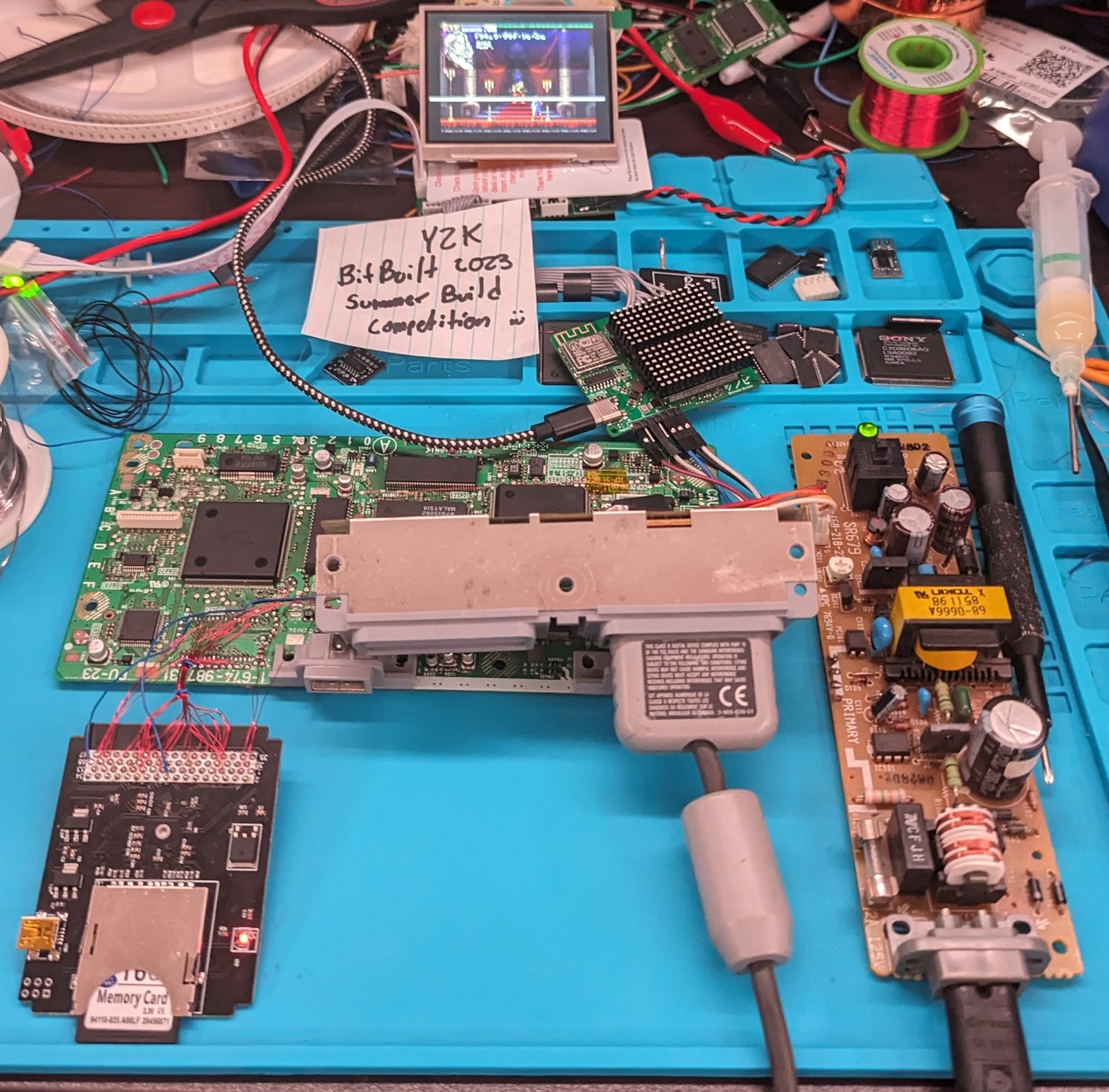

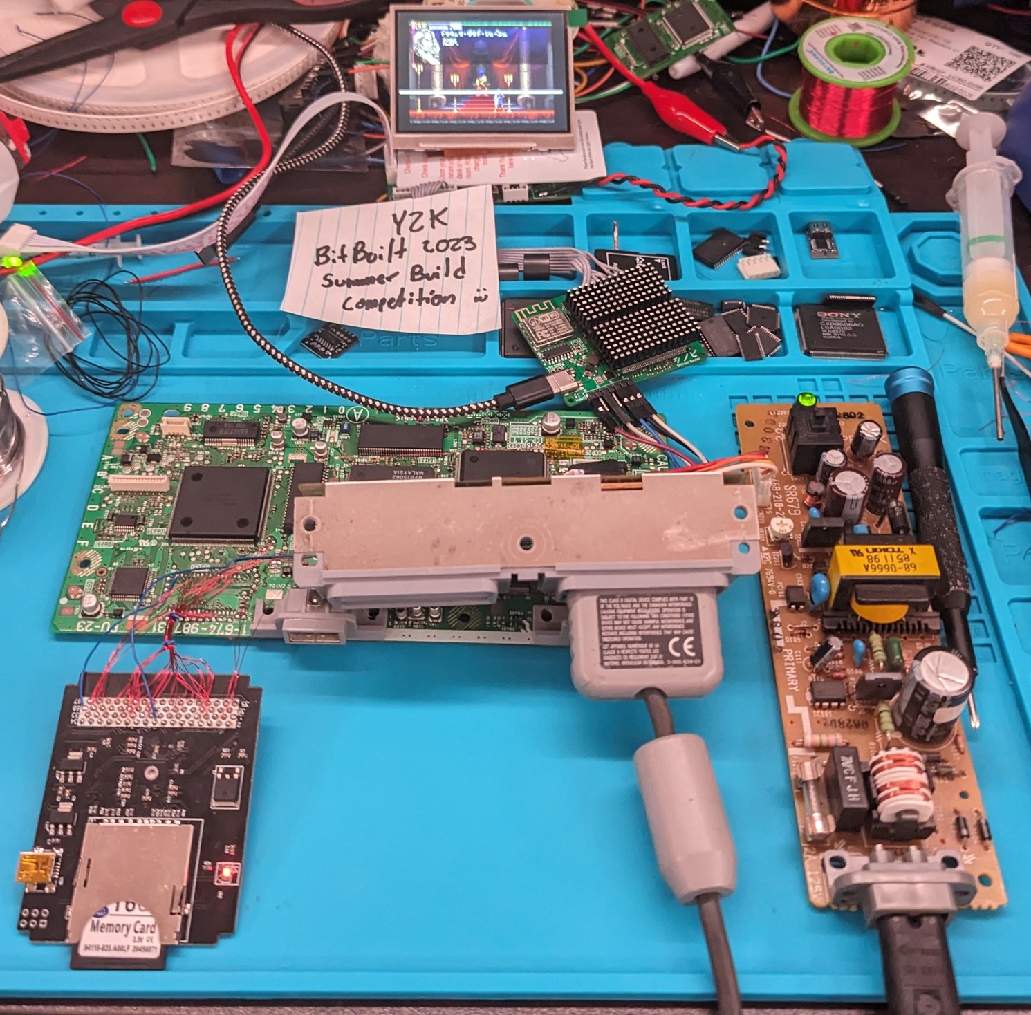

The PSIO arrived and I got it wired for testing!
Currently using the old BIOS footprint, since it's more convenient to use over trying to solder multiple wires to the main bus vias, which I will still have to do eventually, just trying to delay the inevitable hehehe... In any case though, it works perfectly and I was able to get some games running!
With the PSIO good to go, the next logical step would be to start pulling chips off the board that are allegedly unneeded, but I want to get the audio situation figured out first before I do some more deconstructive steps. The idea is to reprogram U-AMP 2 using the open source U-AMP firmware by modifying it. I've completed the necessary modifications and acquired a PicKit3 in order to program it, but have not gotten around to getting it fully working yet.

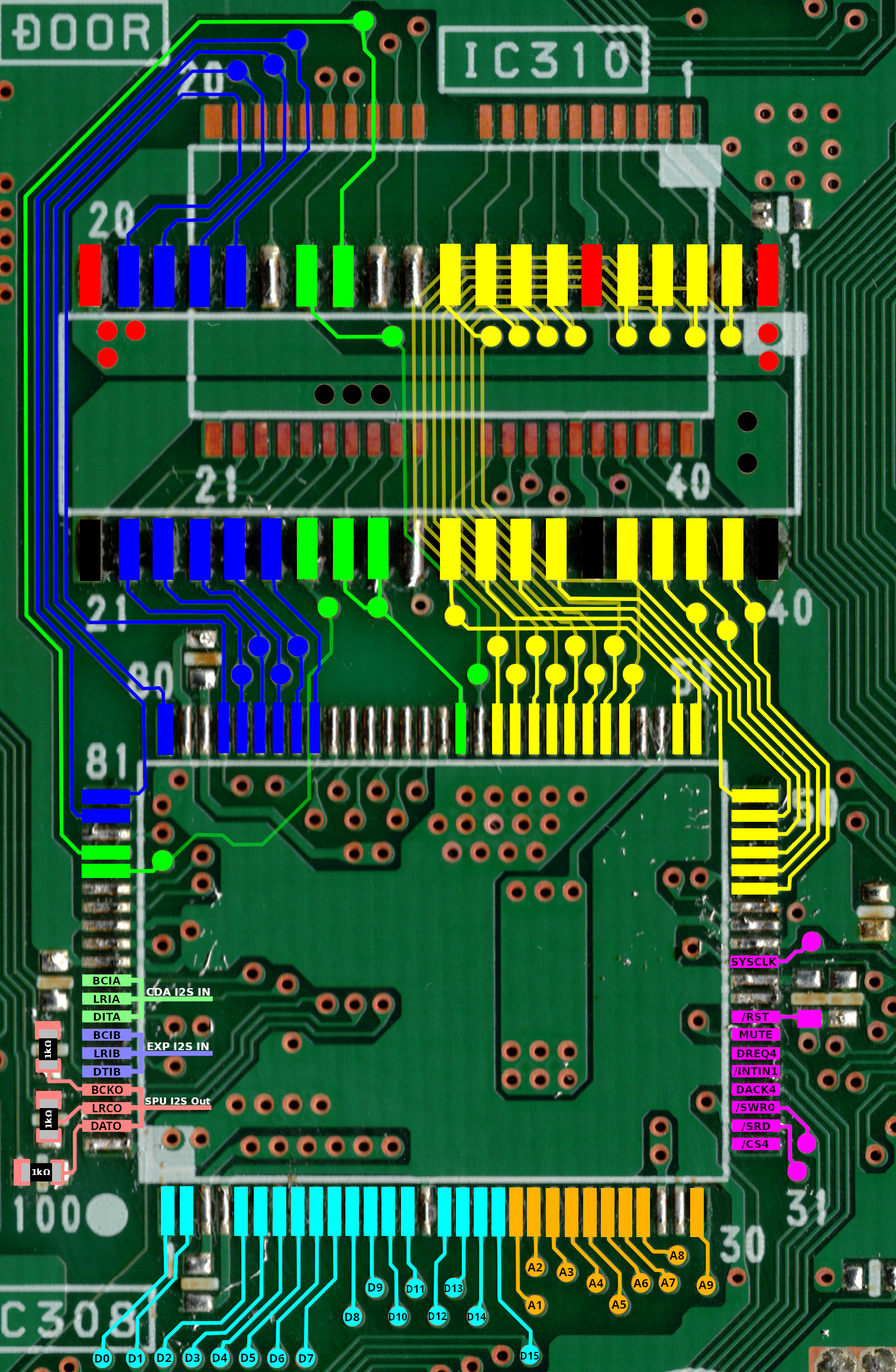

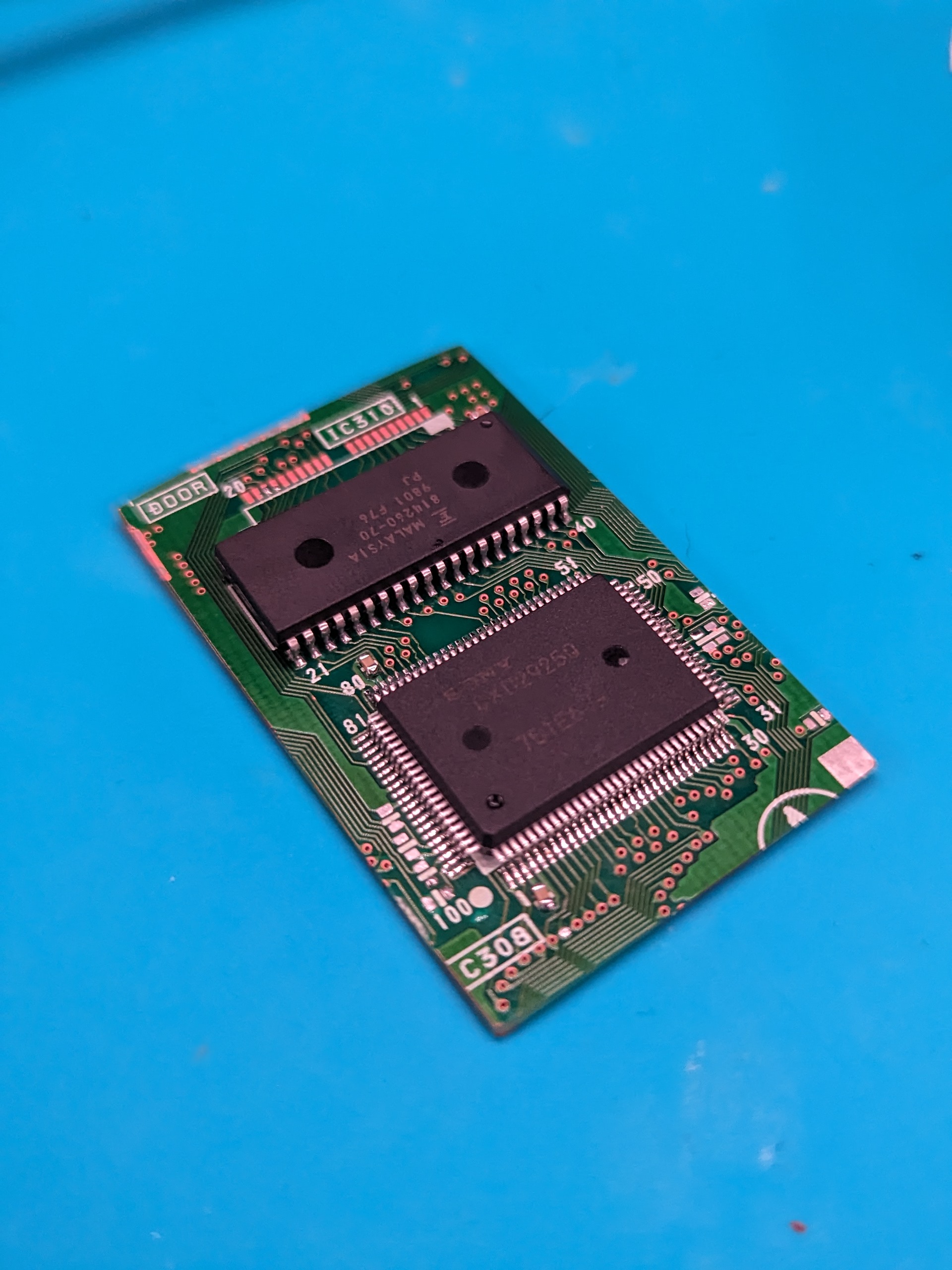

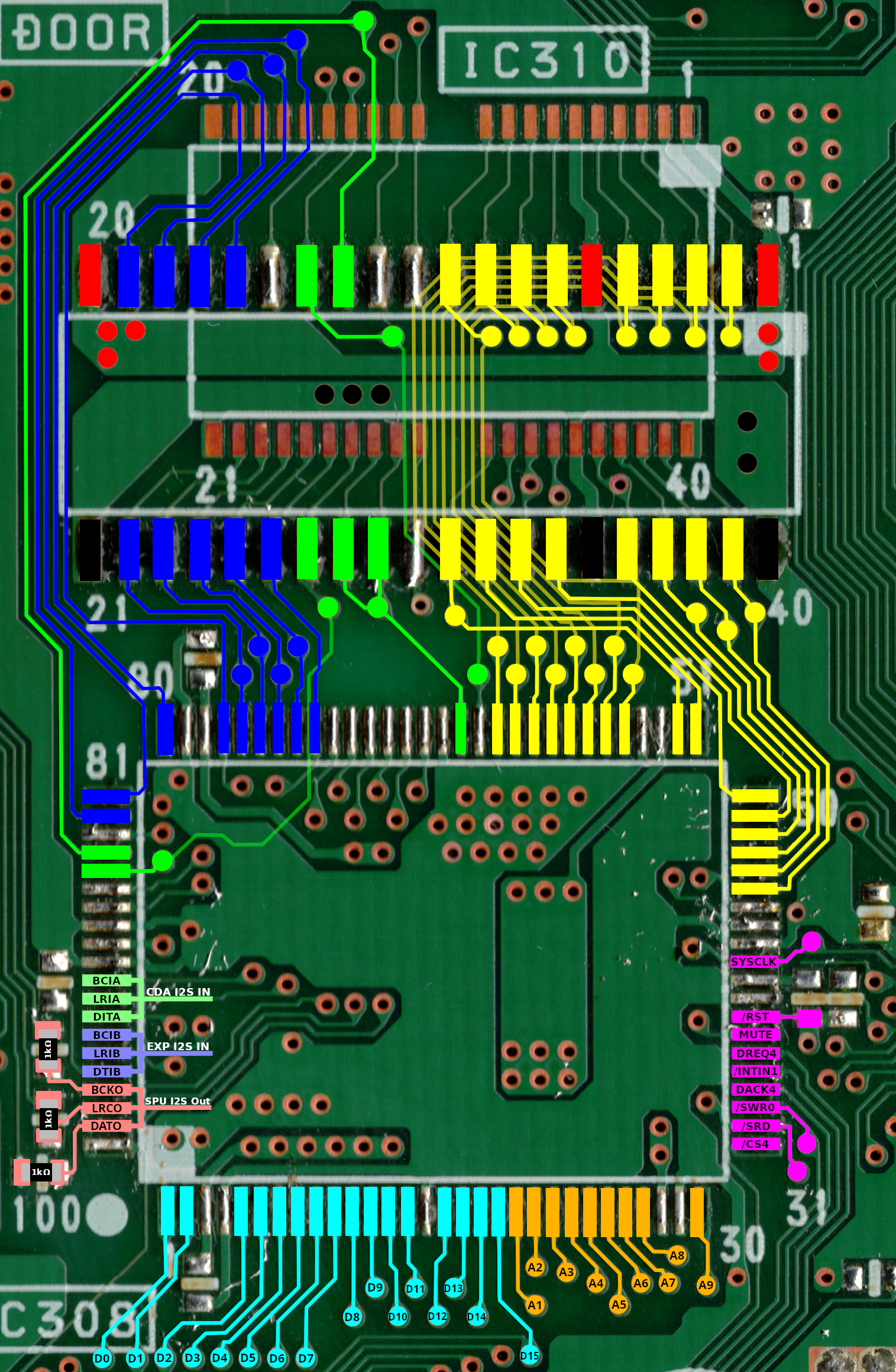

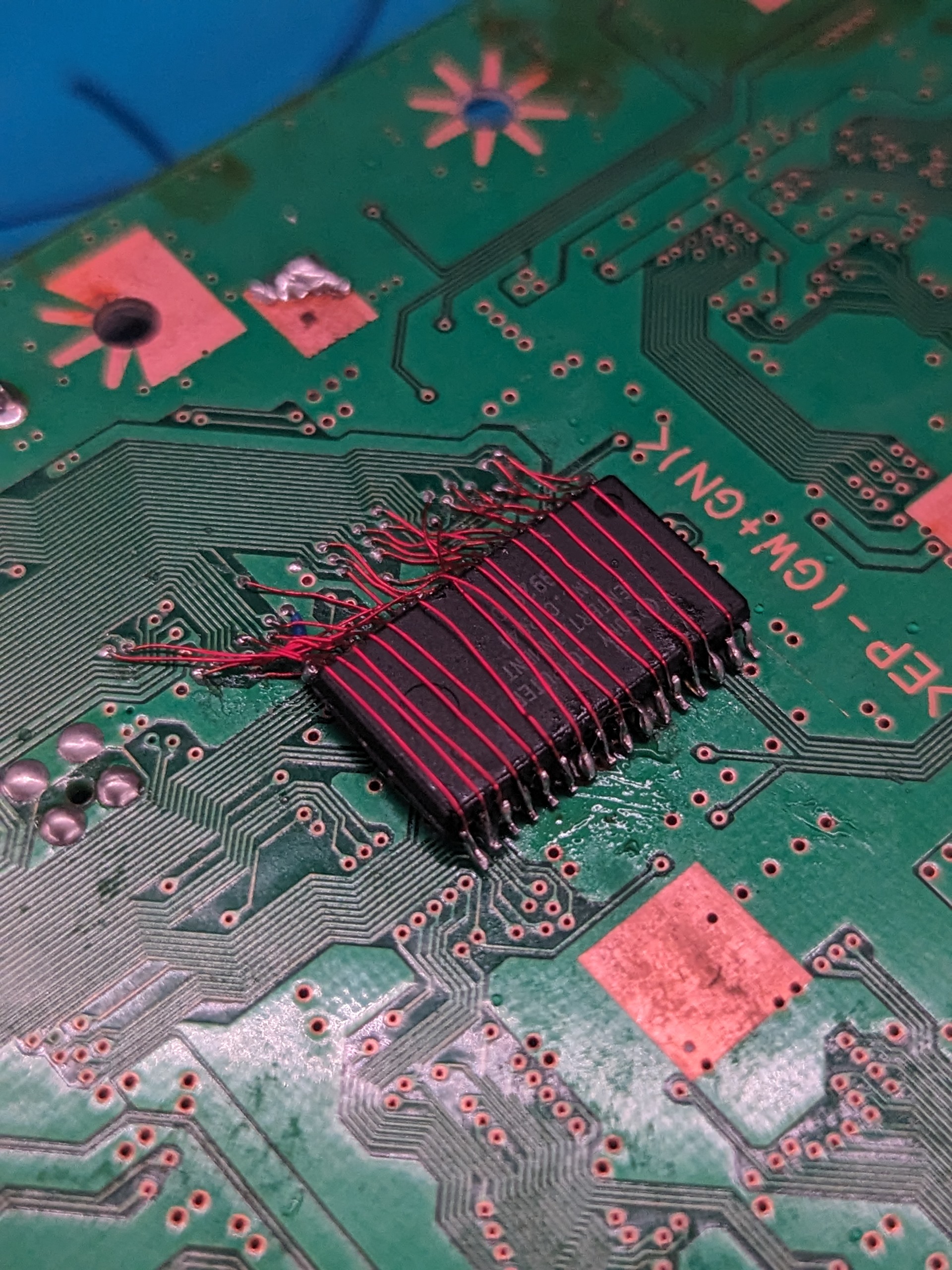

On the topic of audio, I learned pretty late into this project that the actual PS1 sound chip is combined with one of the big QFP-208 chips that also handles CD audio stuff. I do not want to keep this chip on my trim, so we're gonna need to take some... drastic measures here.
Yes, your eyes do not deceive you. That is a SPU + SPU RAM trimmed off a PU-18 motherboard! The PU-18 ended up being useful after all! I have absolutely no idea if this will actually work or not, but I don't see why not after spending a lot of time mapping out the pins.
Nice thing is though is that the SPU will handle mixing the CD audio coming from the PSIO with the main system audio, which means we just have to feed its I2S output into the U-AMP, which will handle the DAC & amp business. Quite convenient!

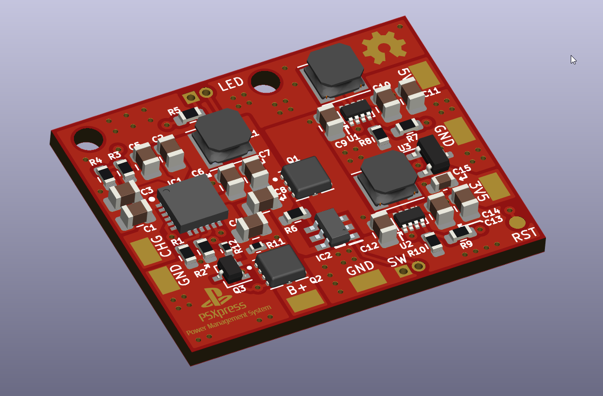

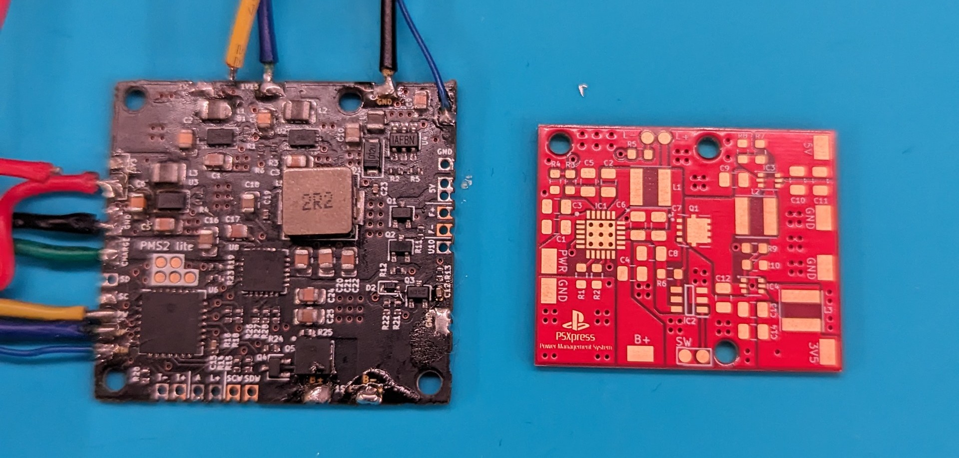

Say hello to the PSXpress Power Management System! This tiny little board is a full fledged PMS made specifically for PS1 PU-23 portables. It features all the bells and whistles necessary to power a PS1 portable & charge the system batteries safely!
Features are as follows:
- Fully standalone design: no MCU or firmware to program, just assemble and go
- 3.9 to 13.5V input - 3A max input & charge current - good for 9/12V @ 3A USB-C PD or barrel jack input
- High efficiency 3v5 & 5V buck/boost regulators
- 2A max output on output rails
- Charge & play support
- Integrated battery management & charging
- 1S Battery Setups Only! Recommended setup is 1S2P 18650s or 1 21700 cell - I probably wouldn't do a singular 18650 since this will always charge the batteries at 3A no matter what
- Reverse battery polarity protection (separate packside protection circuit needed, example: https://www.aliexpress.us/item/3256805302254769.html)
- Soft power switch using MAX16054 - use a normally open SPST switch
- Charging LED
- Dimensions : Aprox. 25mm x 30mm
I'm extremely proud of this design, and am super excited and hopeful that this will see some use by all of you! The nice thing about this is that with some basic modifications, this should be very usable in other non-PS1 related projects, such as N64 portables! All that would be needed for that is to change R7 and R9 to values that will result in the target voltage you're looking for for those regs, within the specs of the regulators themselves, of course. This makes the PSXpress PMS extremely flexible for whatever you want to use it for!

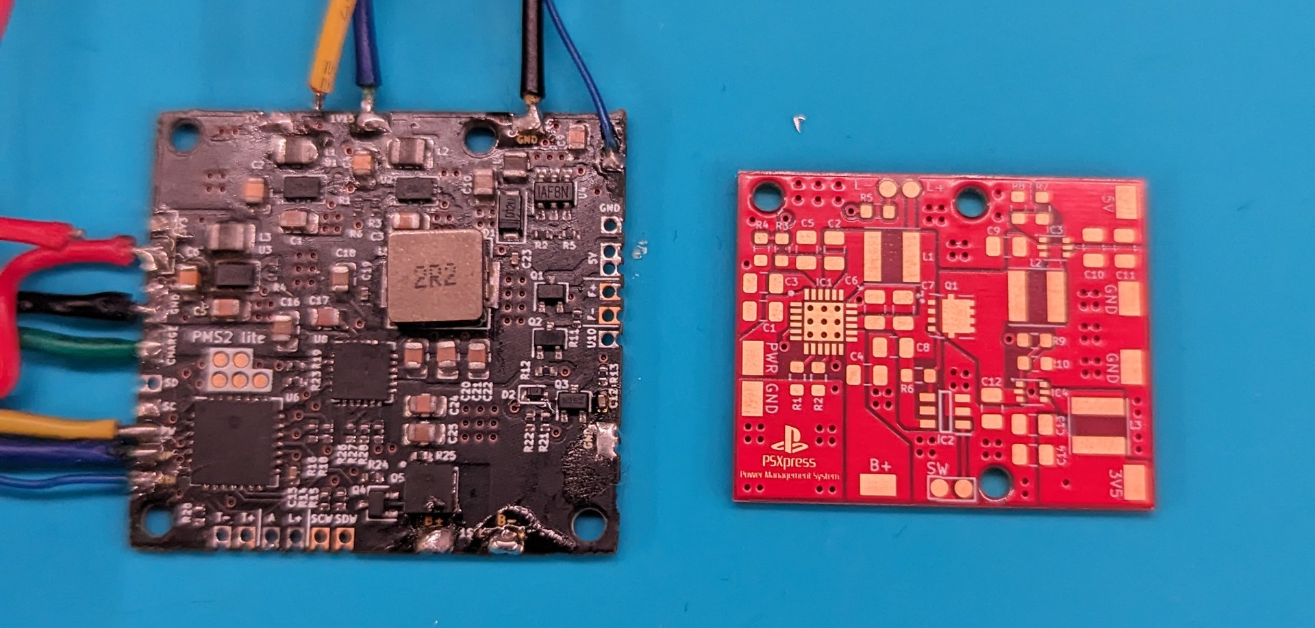

Here's a size comparison between the PSXpress PMS and an (admittedly very dirty) RVL-PMS Lite:
The board above is a older revision. I had thought I finished the design long before I was actually done. This board is the same overall size as the final boards, though. I used DKRed to get the boards fabbed, and I was pleasantly surprised by the results!
