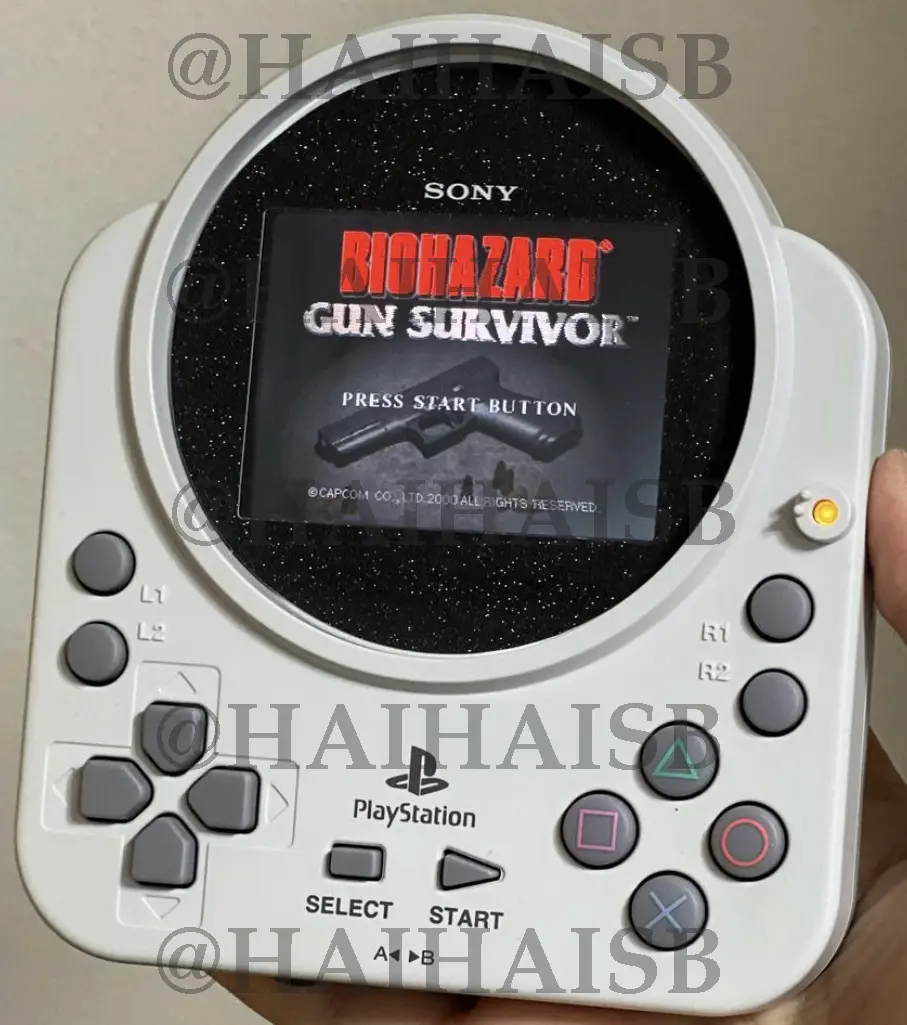

Taking inspiration from haihaisb's Takara portable, I plan to stick an actual PSOne console into the controller, with an original PSone motherboard, PMS (using a spare PS2PMS I had from my PSP2 project), perhaps the original controller board, and a small display that sits in place of where the spinner used to be!

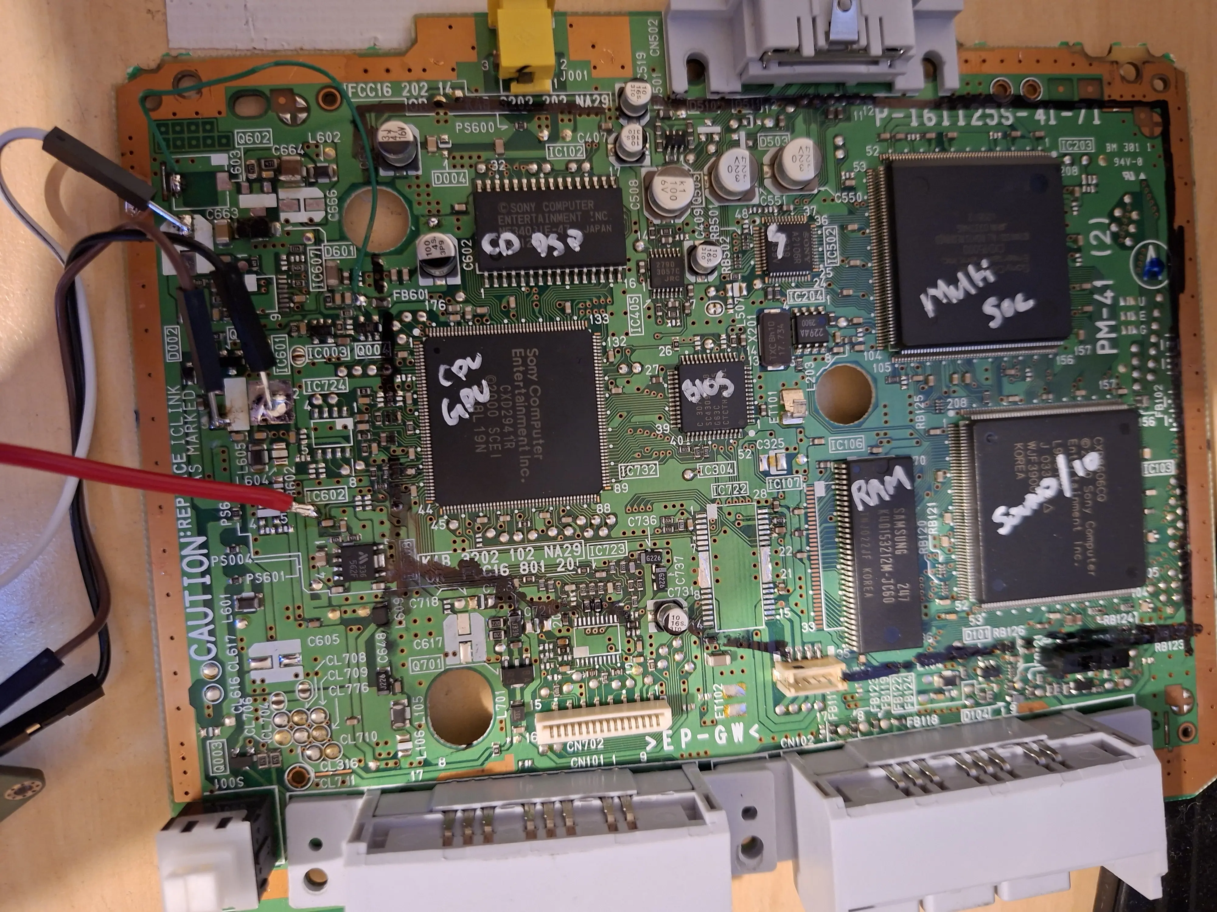

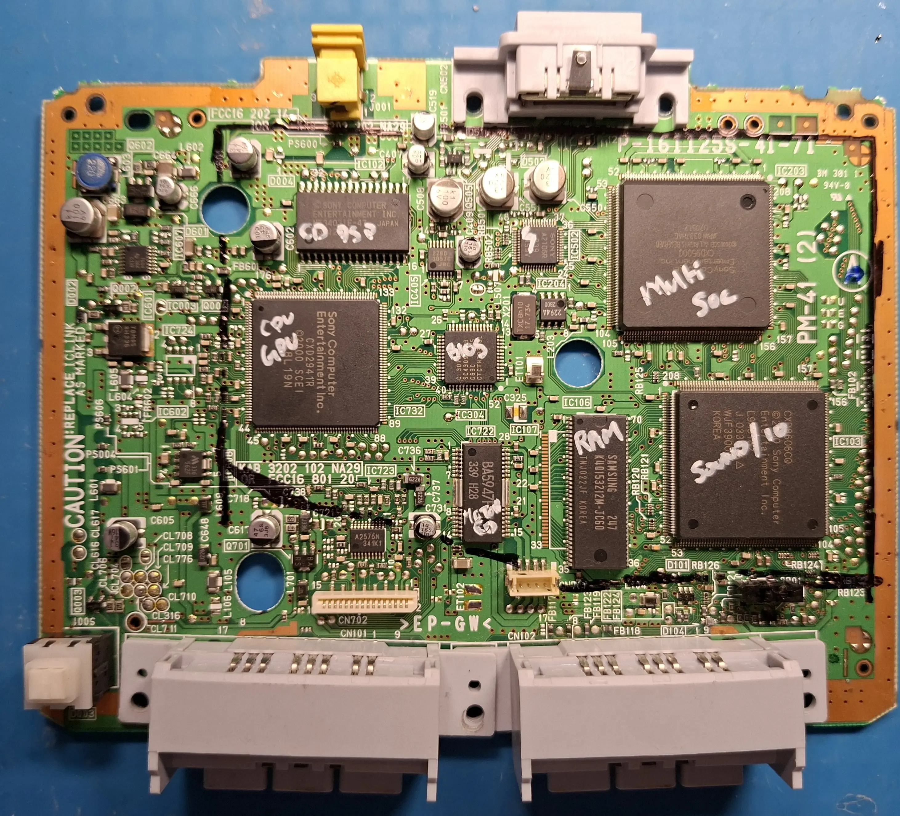

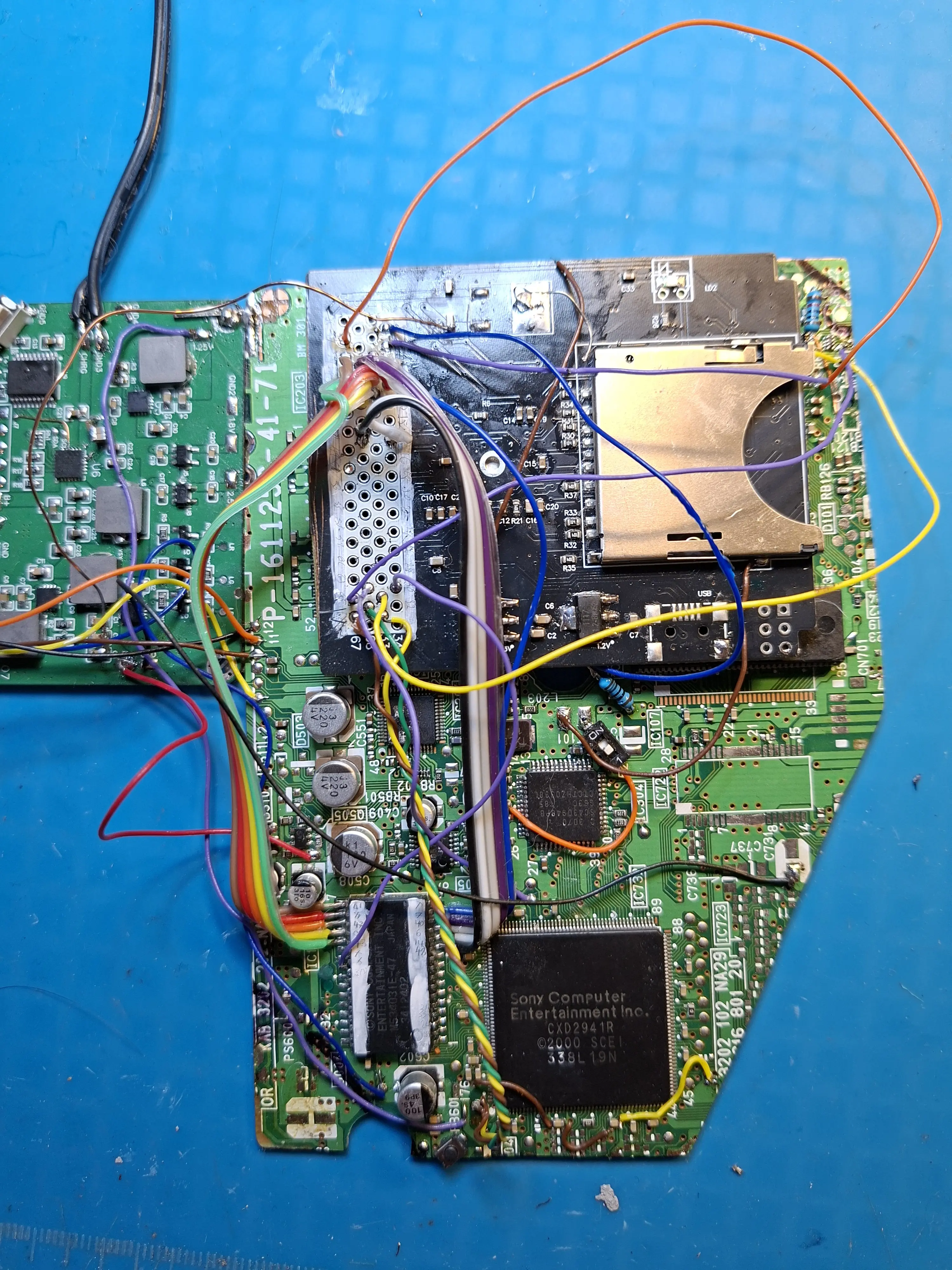

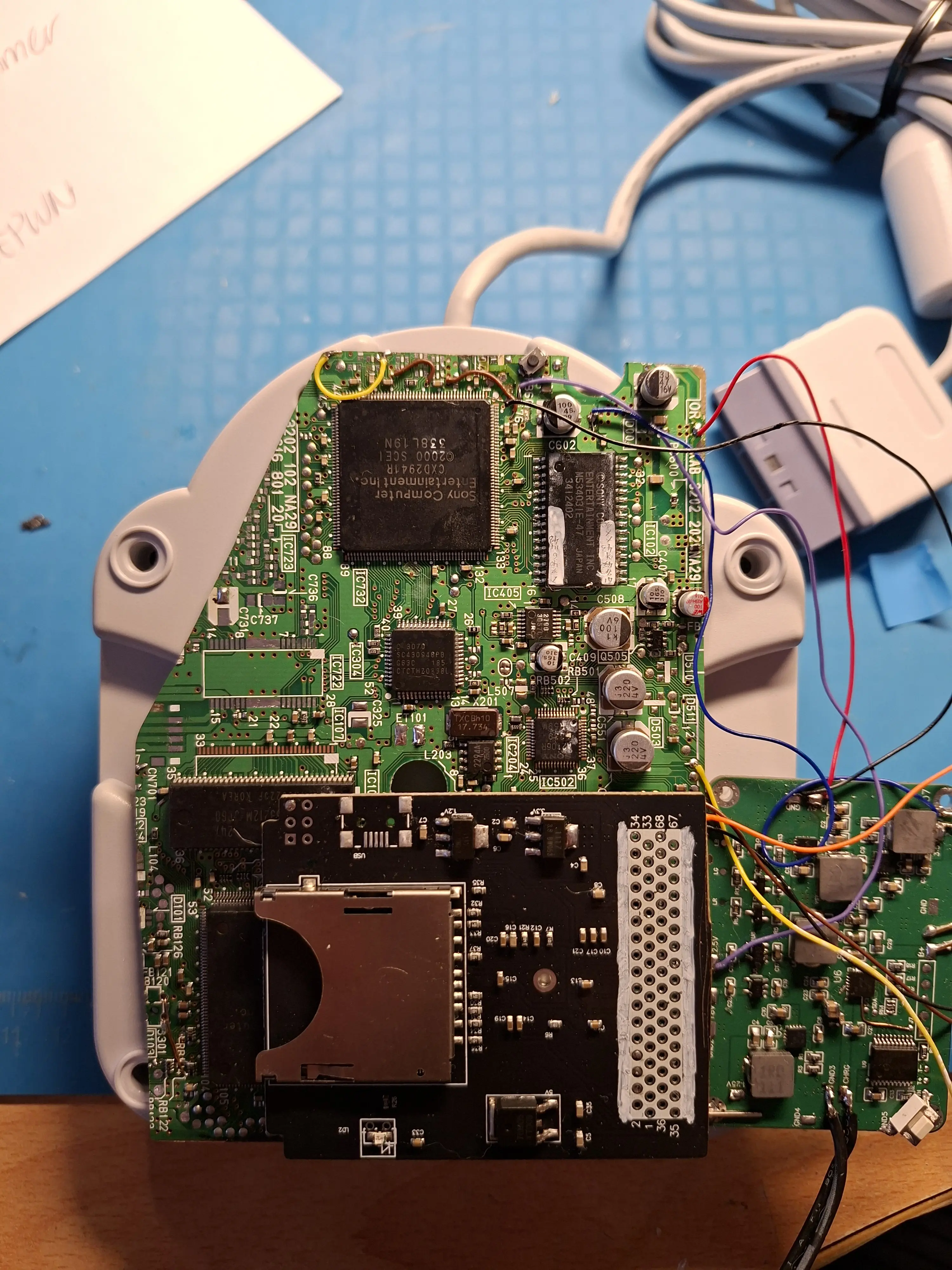

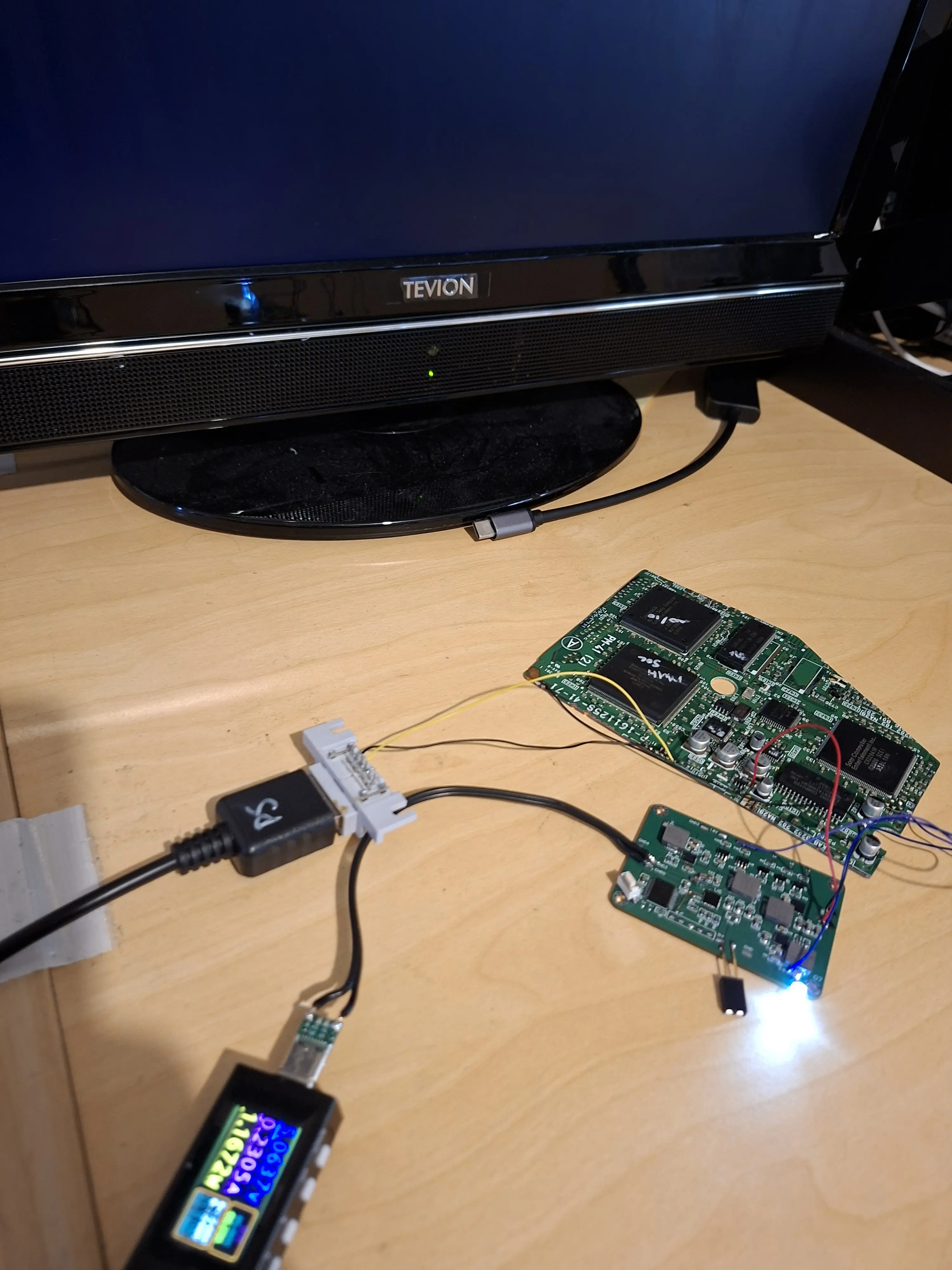

The initial test is always to swap out the default regulators and pump in your custom power, so that was the first thing I tried.
Once I confirmed 5v, 3v5, and 2v5 lines, I got to chopping thanks to @Stitches "theoretical trim".
I had marked it out, gave it a once over, and fired up the dremel.

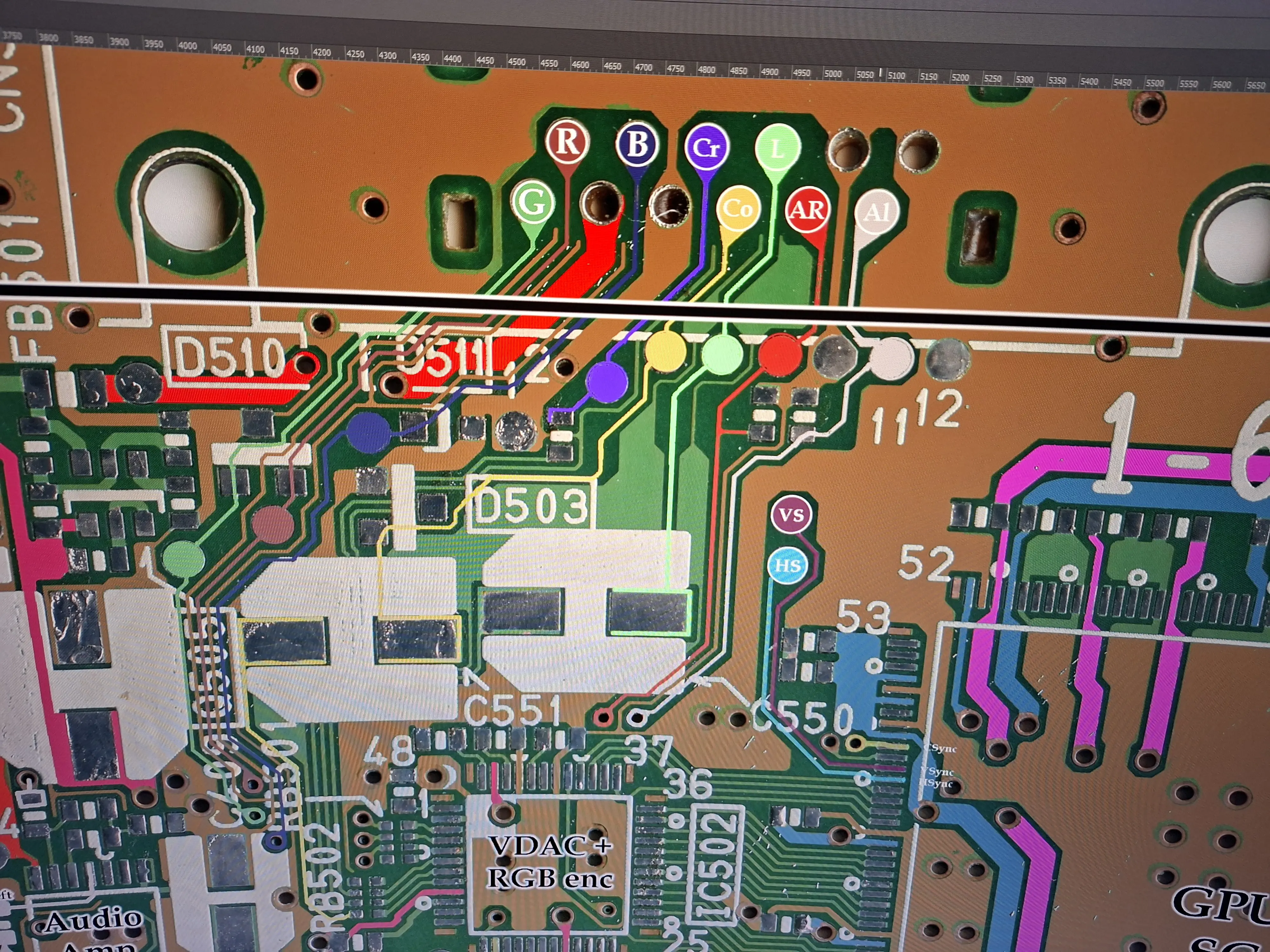

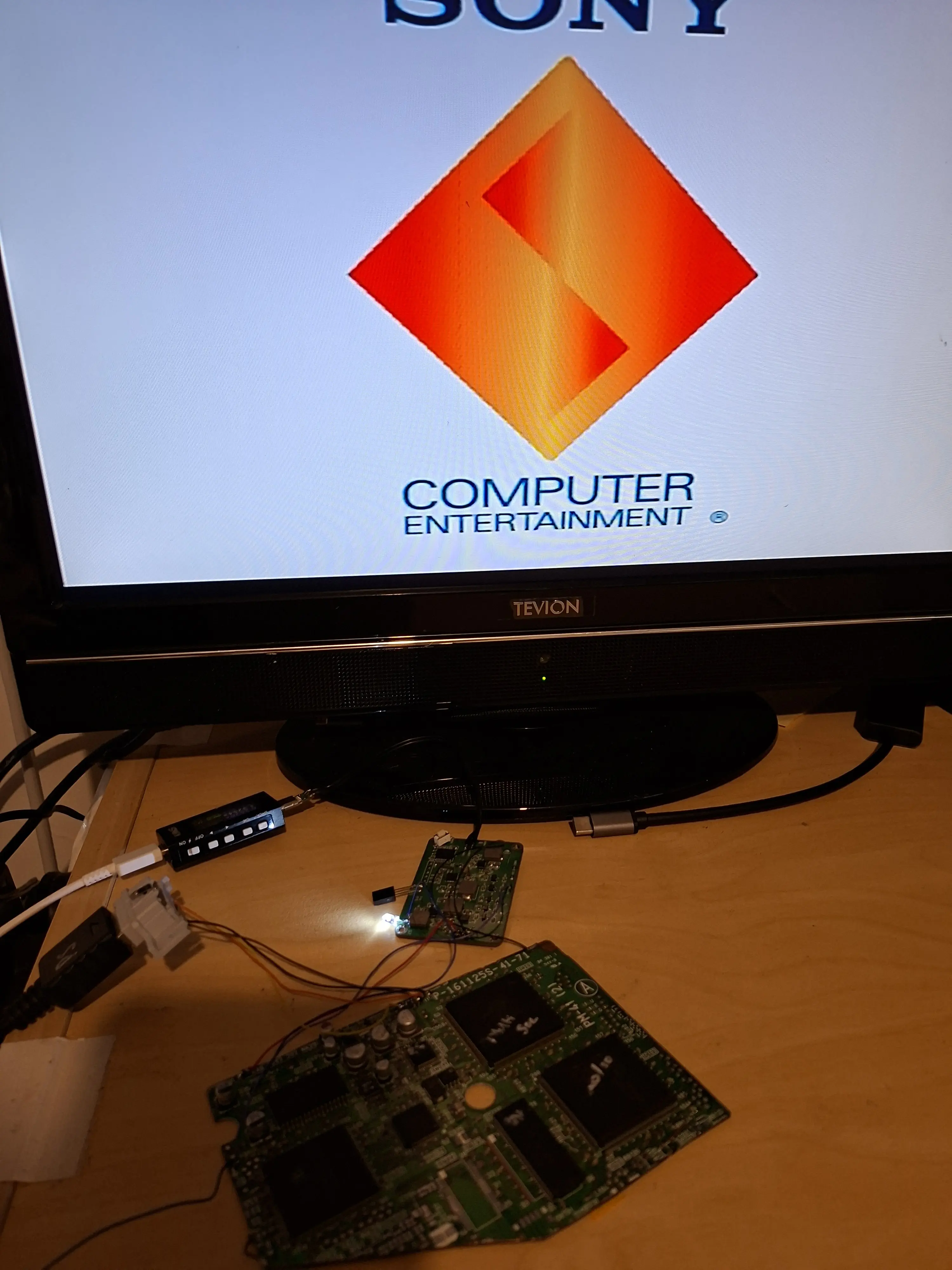

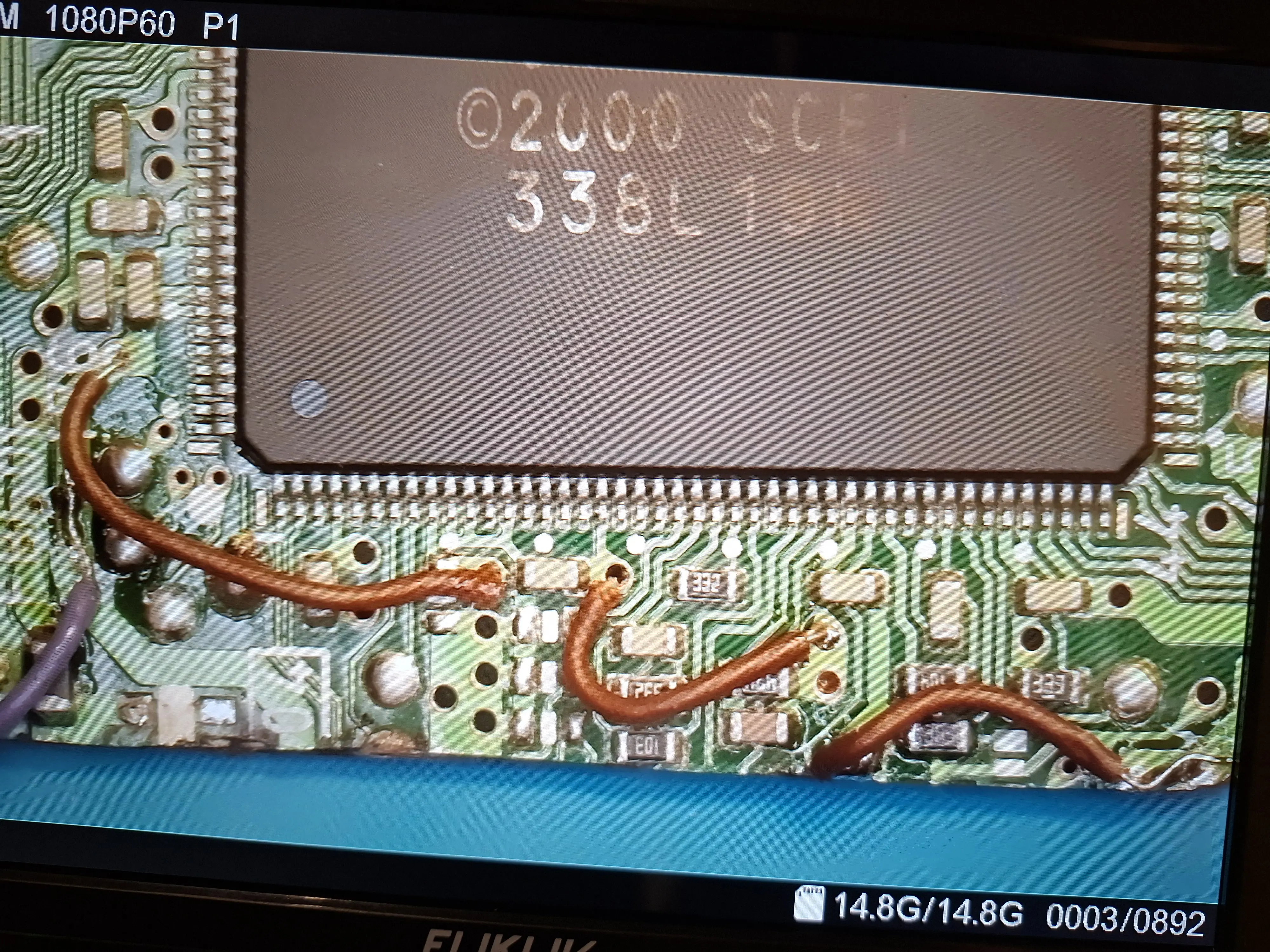

I started mapping out all the Multiout connections (and a whole bunch of other connections), wired it to the removed AV port, plugged it in, and.......
Black screen. Whoops. Turns out I had forgotten to restore some of the 3v5 lines to the SPU, and one of the ground connections.
Once that was done, I got the Sony logo! Hooray!
That was a bit short lived though. Turns out that I had also cut off about a dozen CPU lines from near the controller ports and had to wire them up manually.

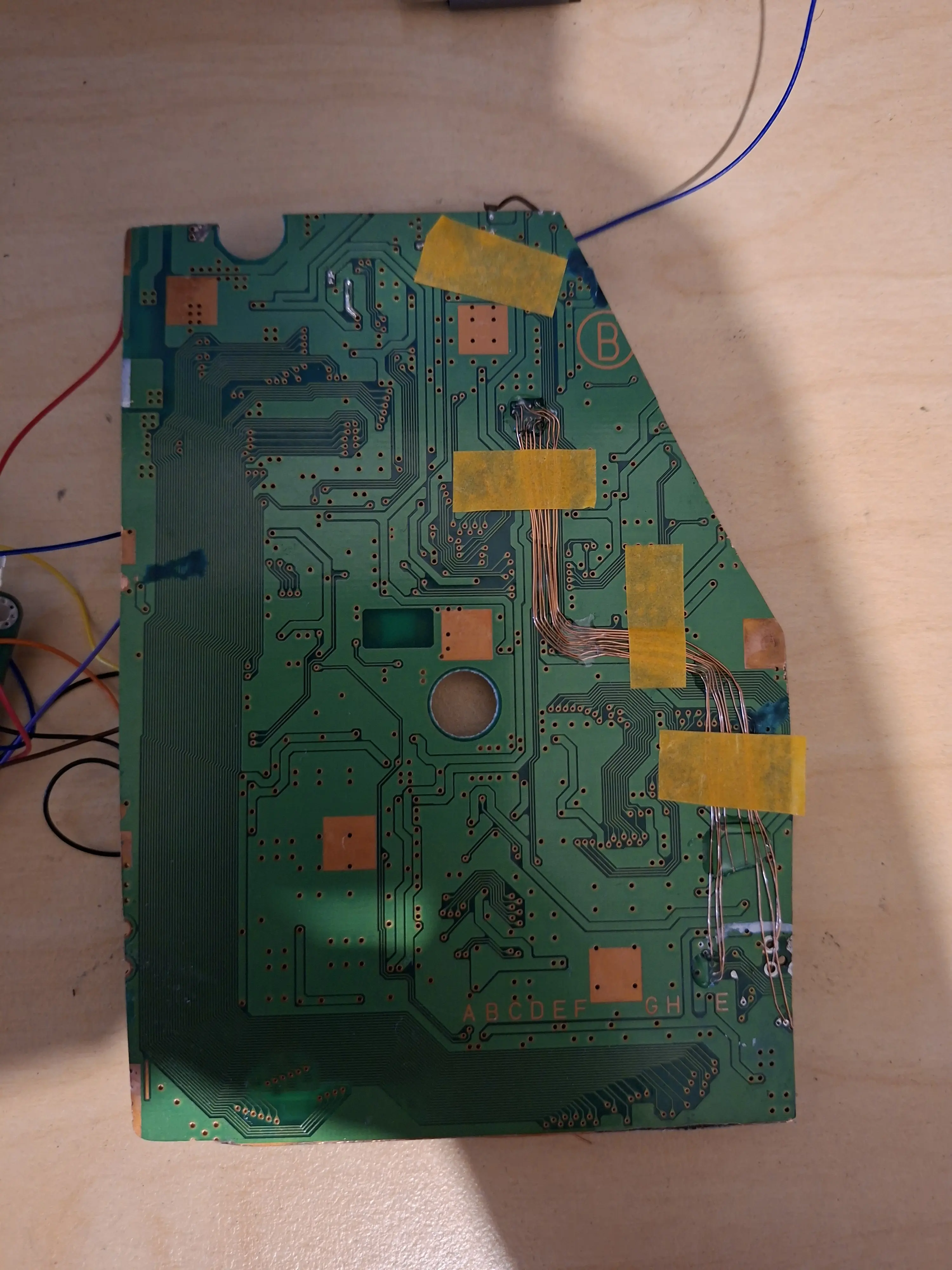

After testing that it booted to the memory card screen, I set out to wire up the PSIO.
I mapped out the connections on my guide, based on the information from tzmwx's github, and using the 18-wire minimum install outlined by @thedrew, started wiring up the PSIO. I made a rookie mistake and didn't confirm it was working beforehand, forgot to back up some of the SD card files for the PSIO, and went straight into pulling it apart instead. This was not wise at all.
In my search for a solution, I have hand-wired the PSIO connections not once, not twice, but three times; one of which was the full 37-wire install. No luck.
So right now, I have a console that boots up, a PSIO that I may or may not have fried (and no other reliable console to test it on), and a hope and prayer that I can figure this out.

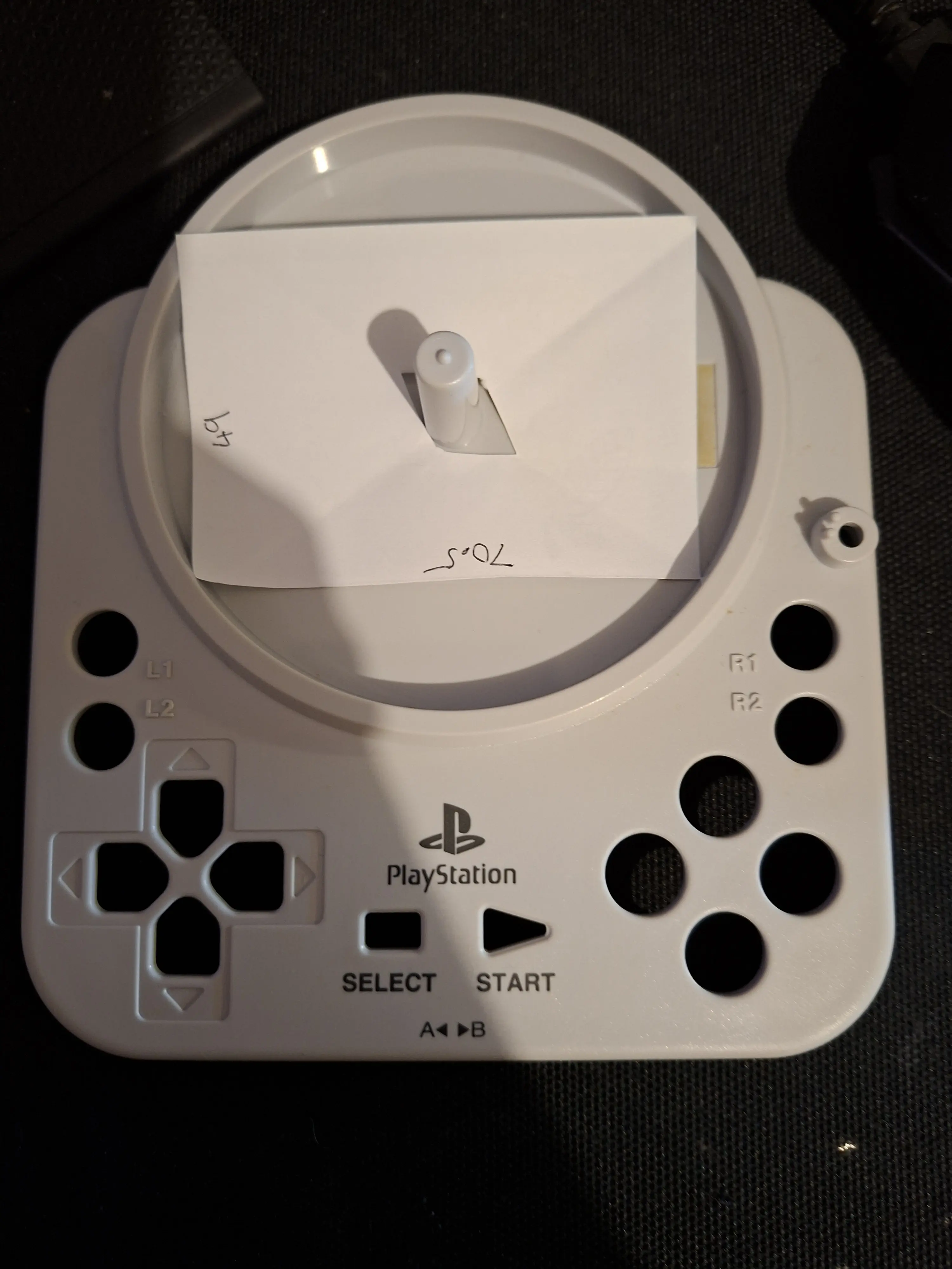

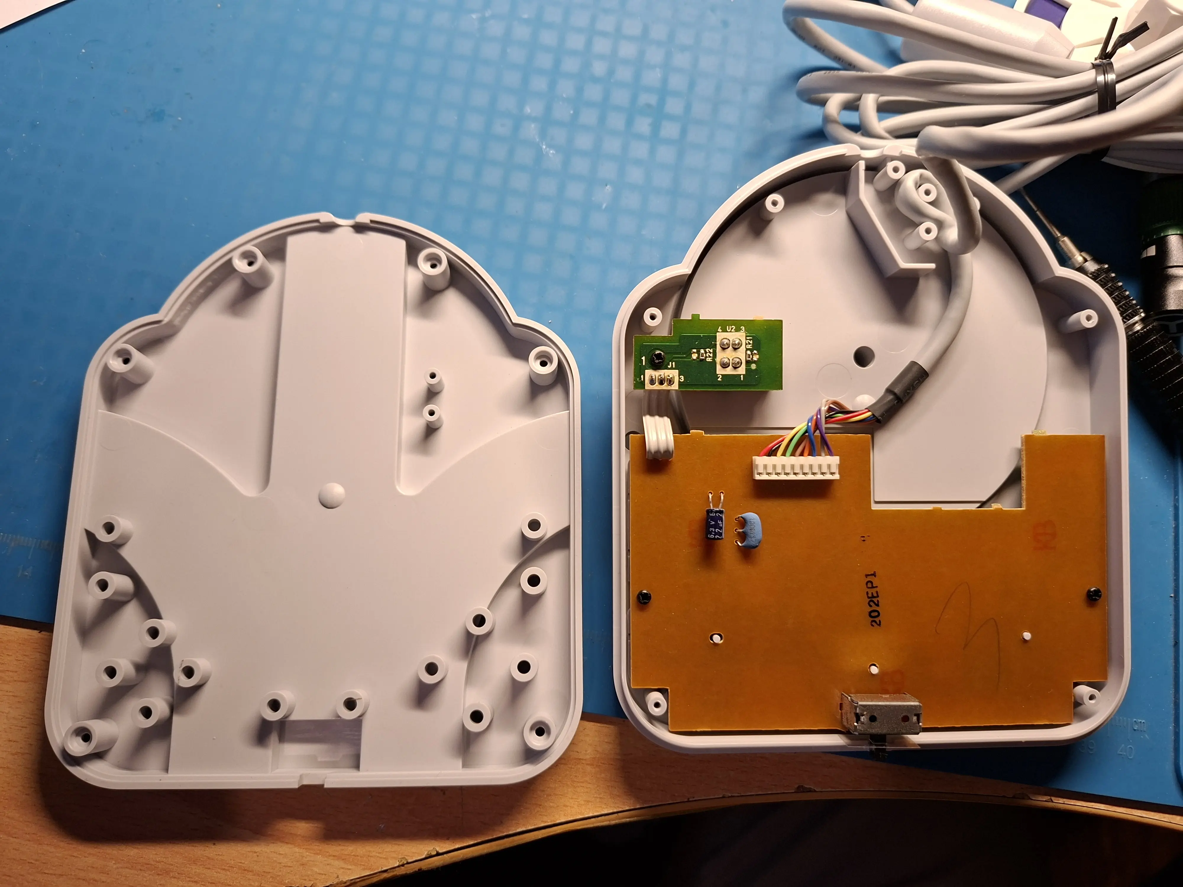

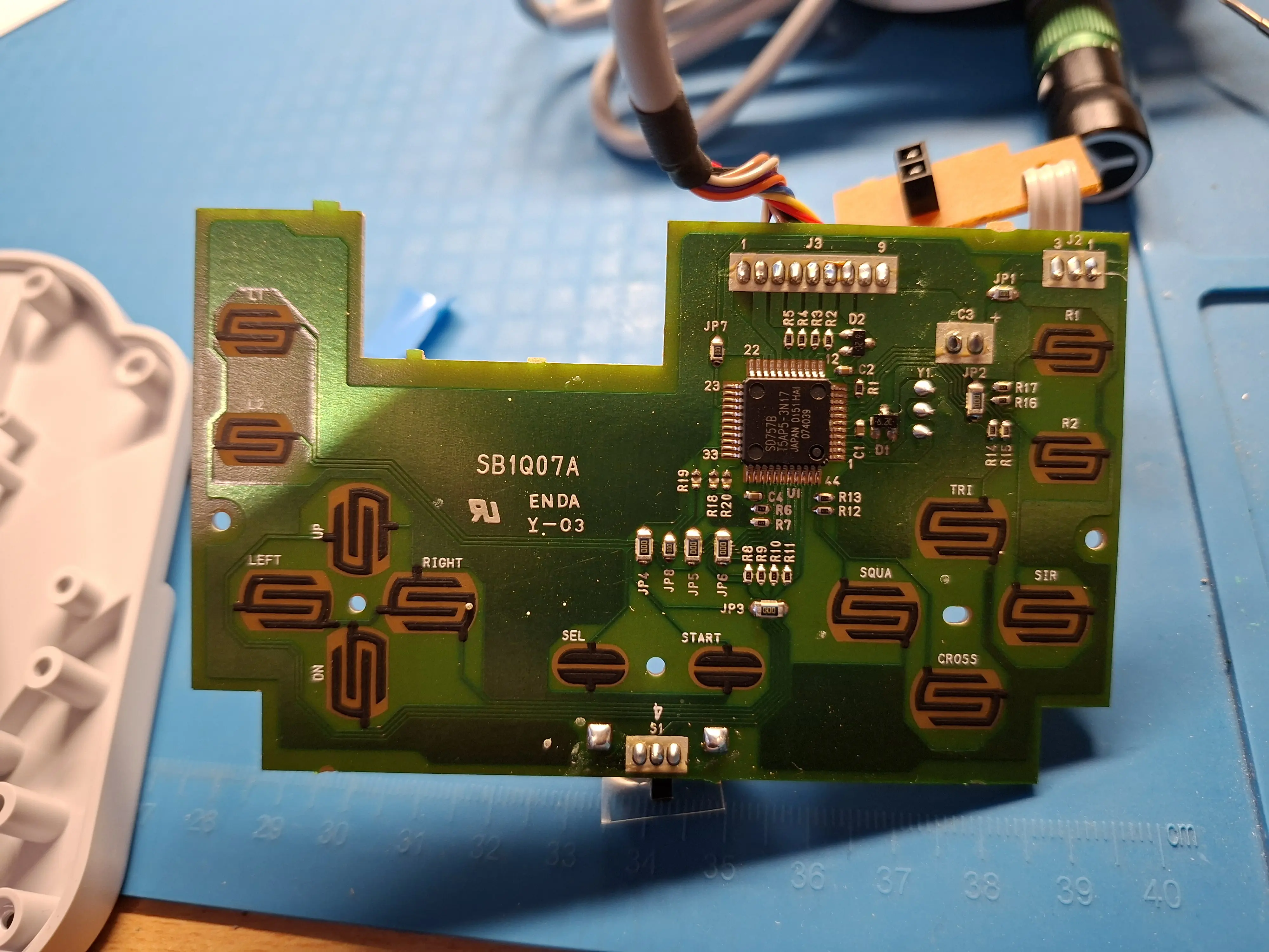

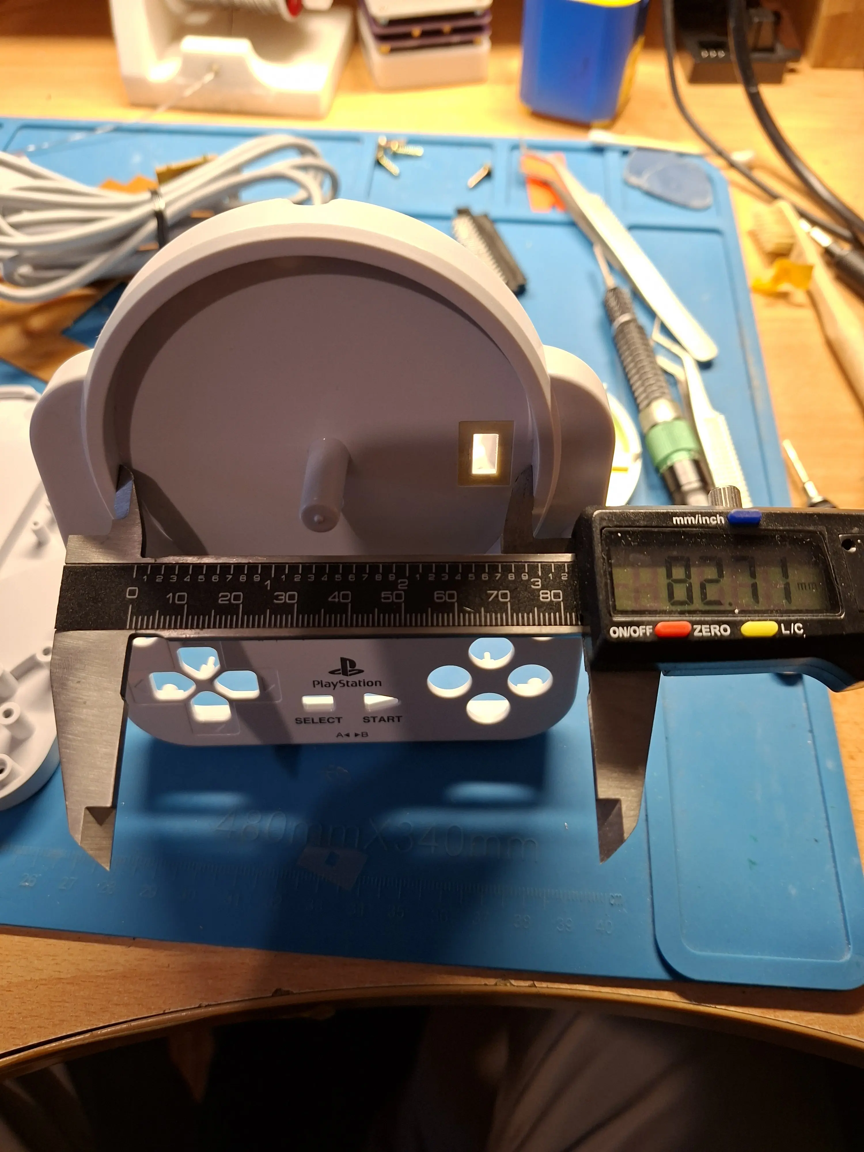

Speaking of, here's some pictures of the shell and PCB!

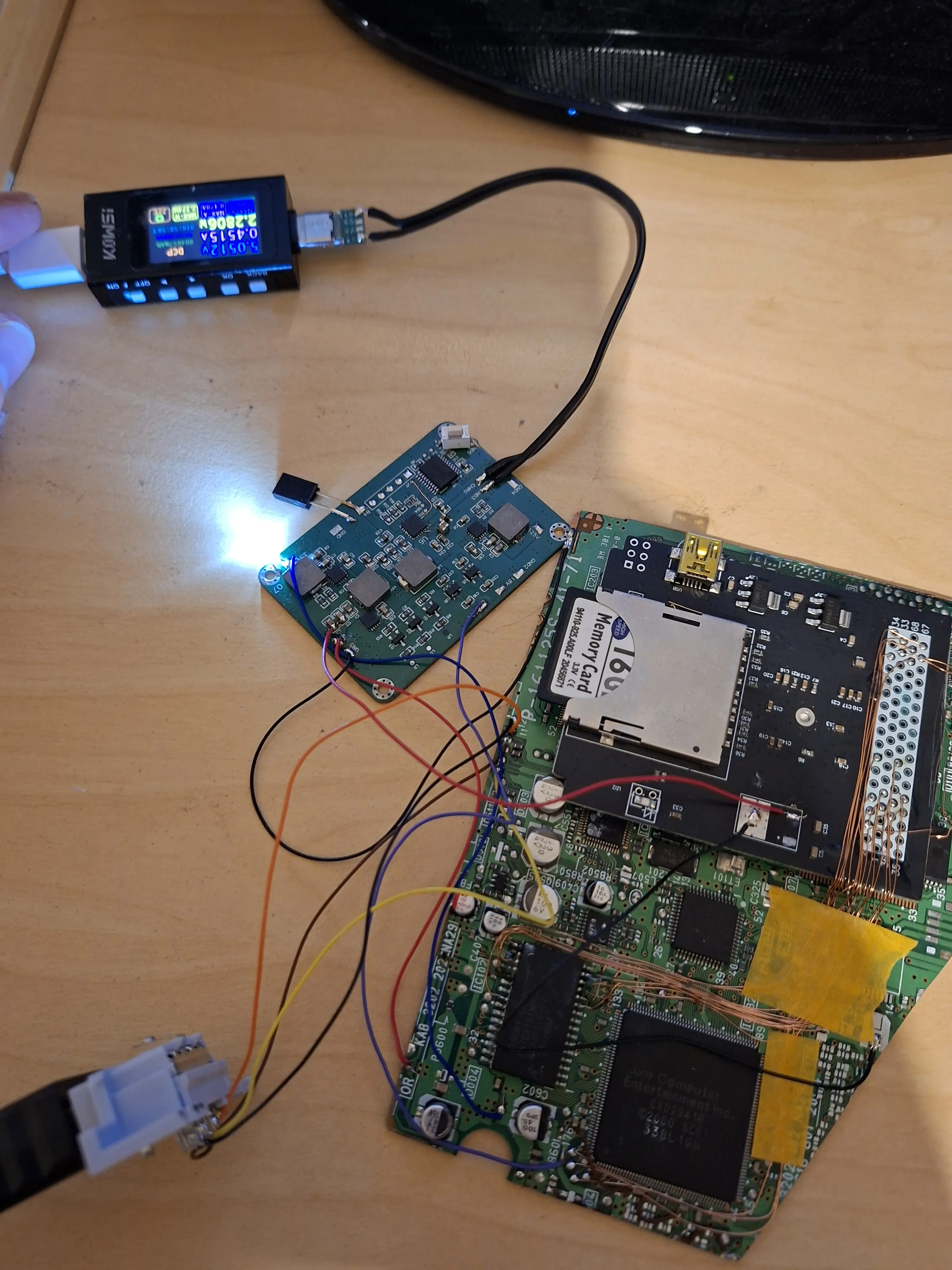

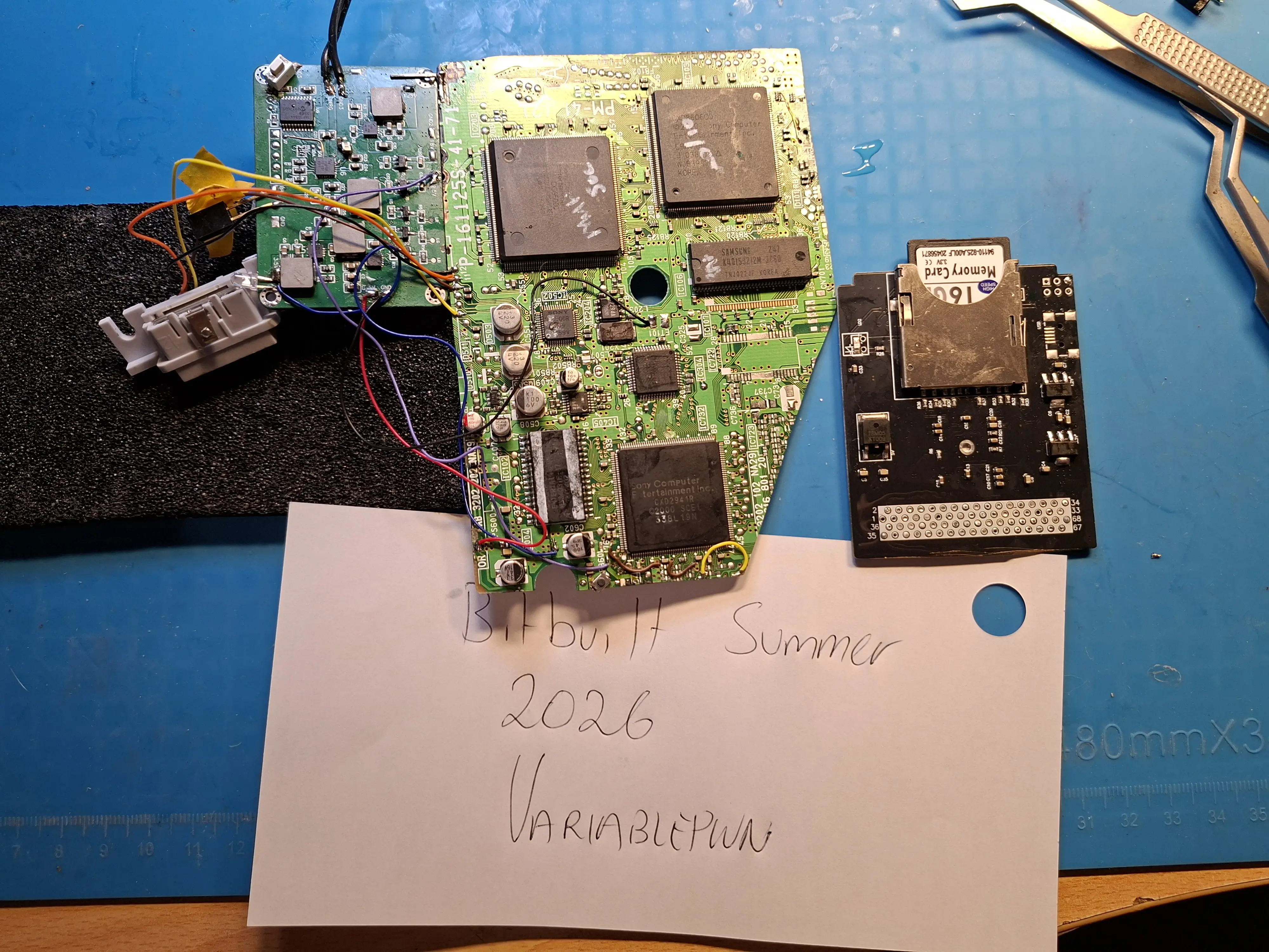

Hello all!
After taking a bit of time off, I finally sat down (in the last week of the competition no less) to have another crack at getting this off of the ground.
I managed to sort out part of the PSIO, figuring out that the clone that I had actually needed more than just the 18 wires that thedrew had figured out.
After wiring up all the wires, I was still having issues.

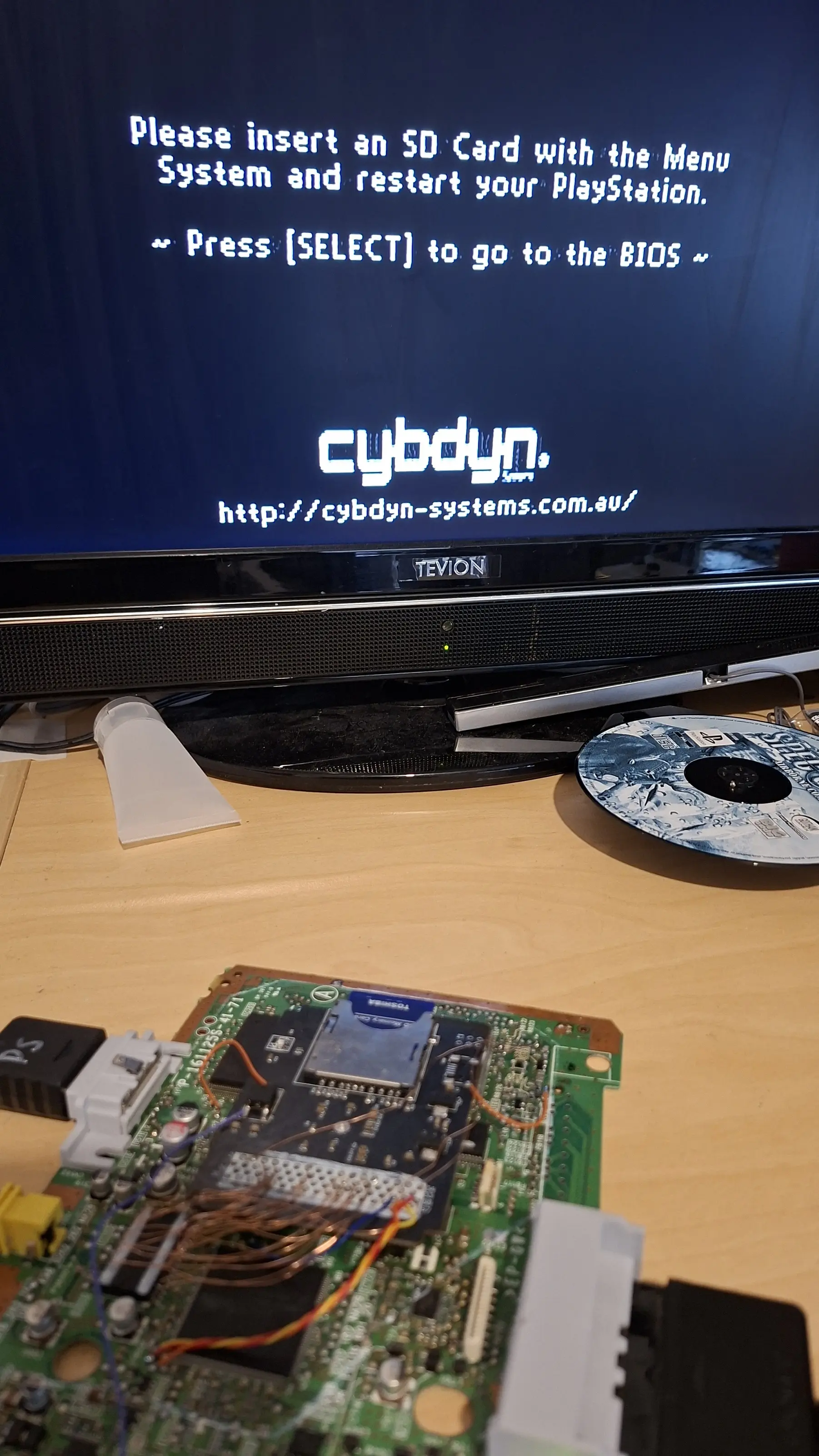

Decided that I might attempt to get the firmware on the PSIO fixed, which success! Managed to get some life into it!
Turns out that I needed to flash the "RECOVERY.BIN" (a renamed FIRMWARE.AFW) to get it to work, and even managed to set up my name and everything.
Once I took out the SD card to add some games, it all went downhill however. Since then, it has refused to load ANY SD card (including size, format etc). If it includes MENU.SYS, it boots to the Memory card BIOS. If it lacks it (including firmware files), it comes up with the same "insert SD with menu" screen.
*sad trombone noises*
Since I don't think I'll figure it out in the meantime, I'm resigning myself to a failed project (at least for now)

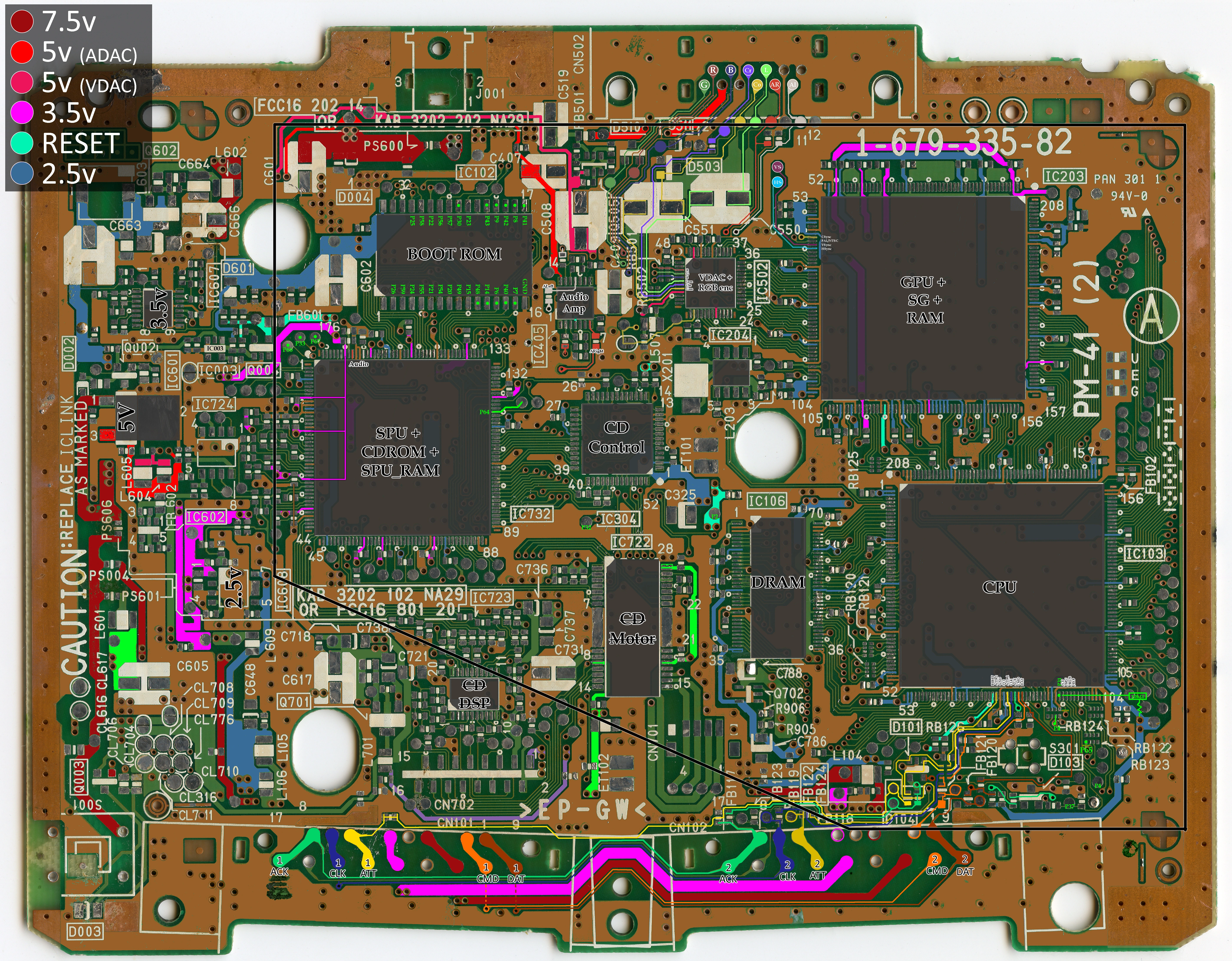

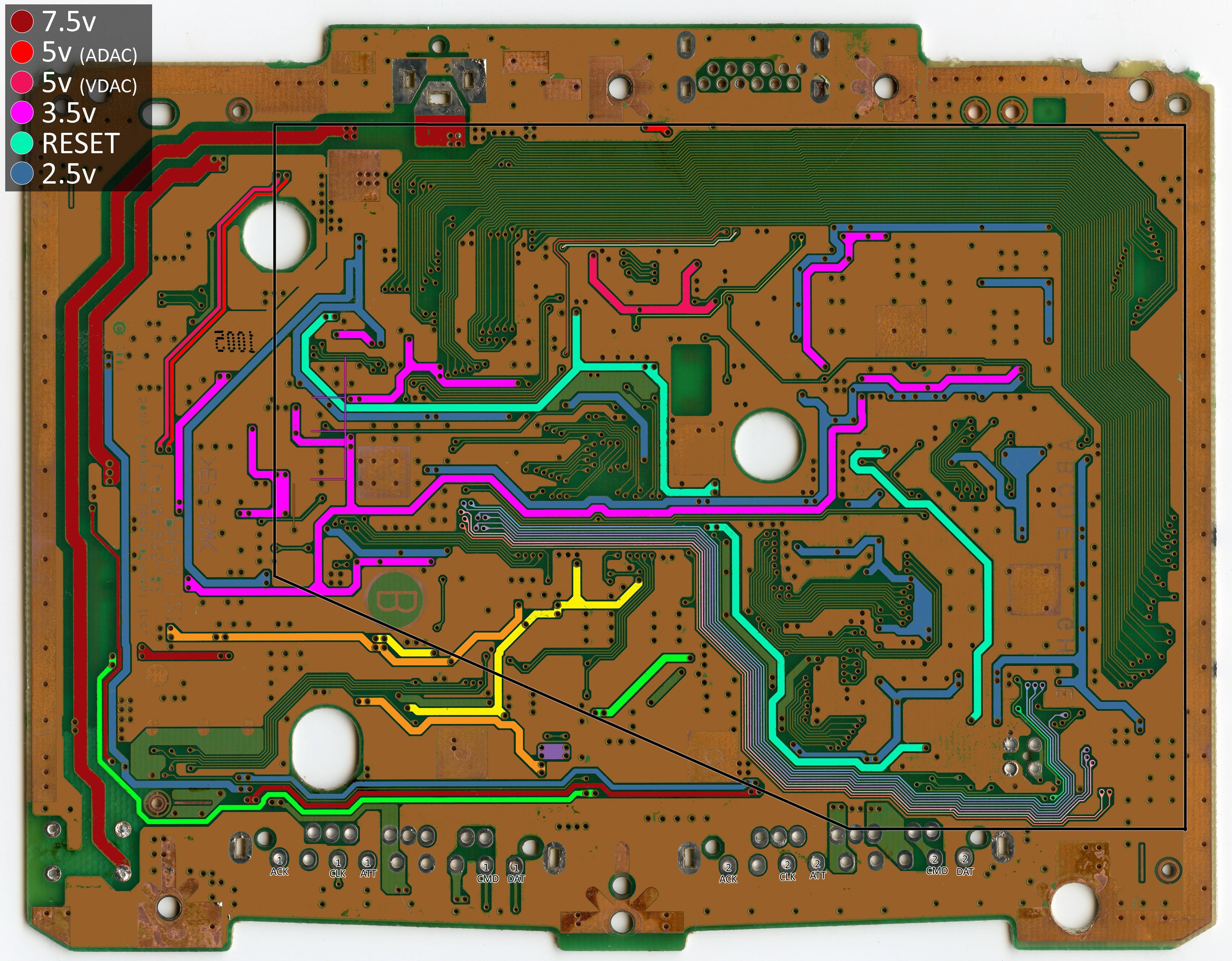

Because of this, I am releasing all of my diagrams (just note that the bottom scan is mirrored to line everything up correctly).
If anyone uses these in the future, I wish you luck!
