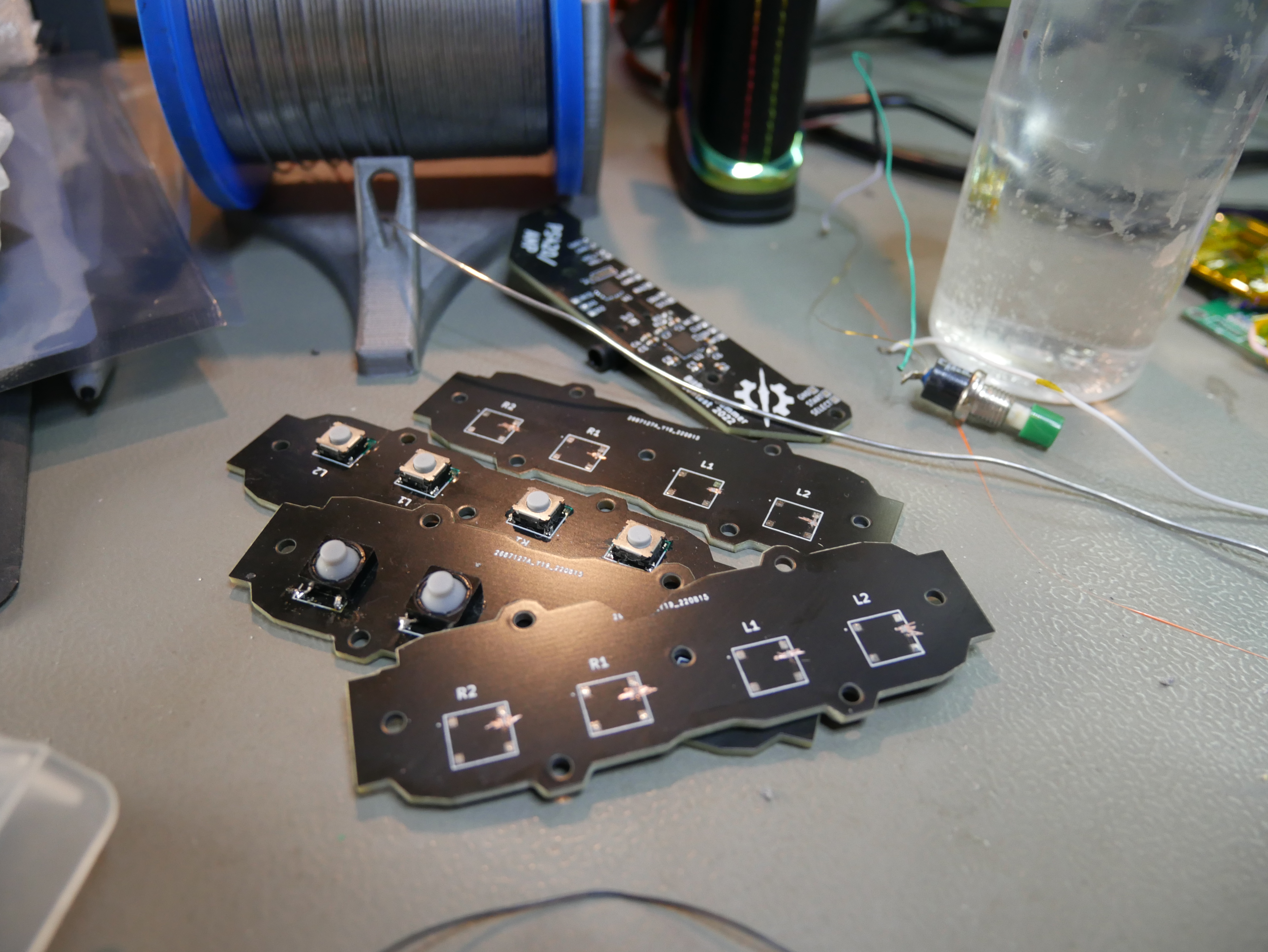

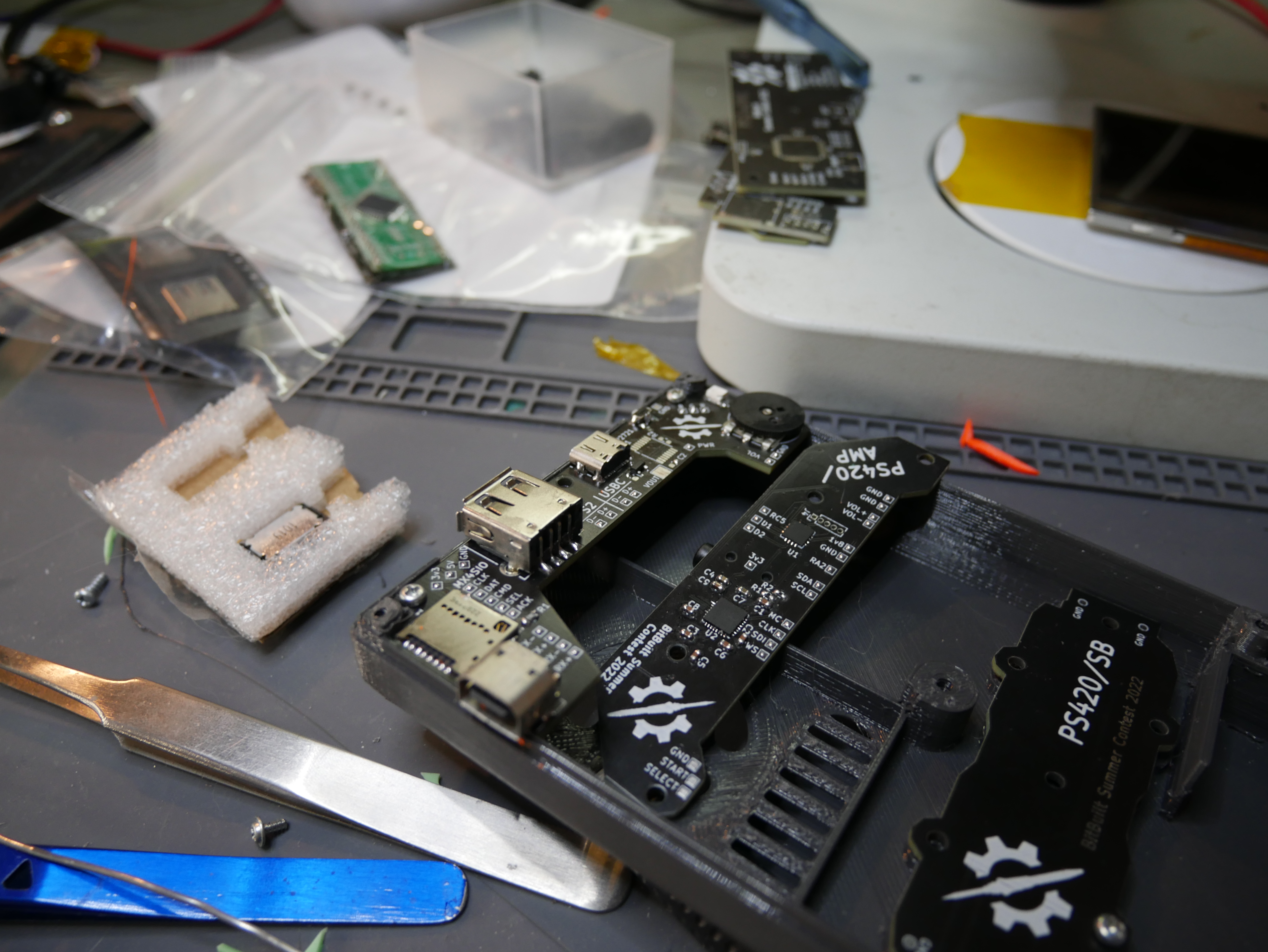

The components for the PCBs arrived, too. But i had to do a second revision of the button PCB, since i couldn't source the PIC for the PS2+ in the form factor i used. Anyways, that's ordered, too & should arrive soon.
Today i also picked up the IP2721, which currently only outputs 5V.. but hey, at least it didn't blow!
Once the new button pcb arrives, we can finally start the assembly.. :mrgreen:

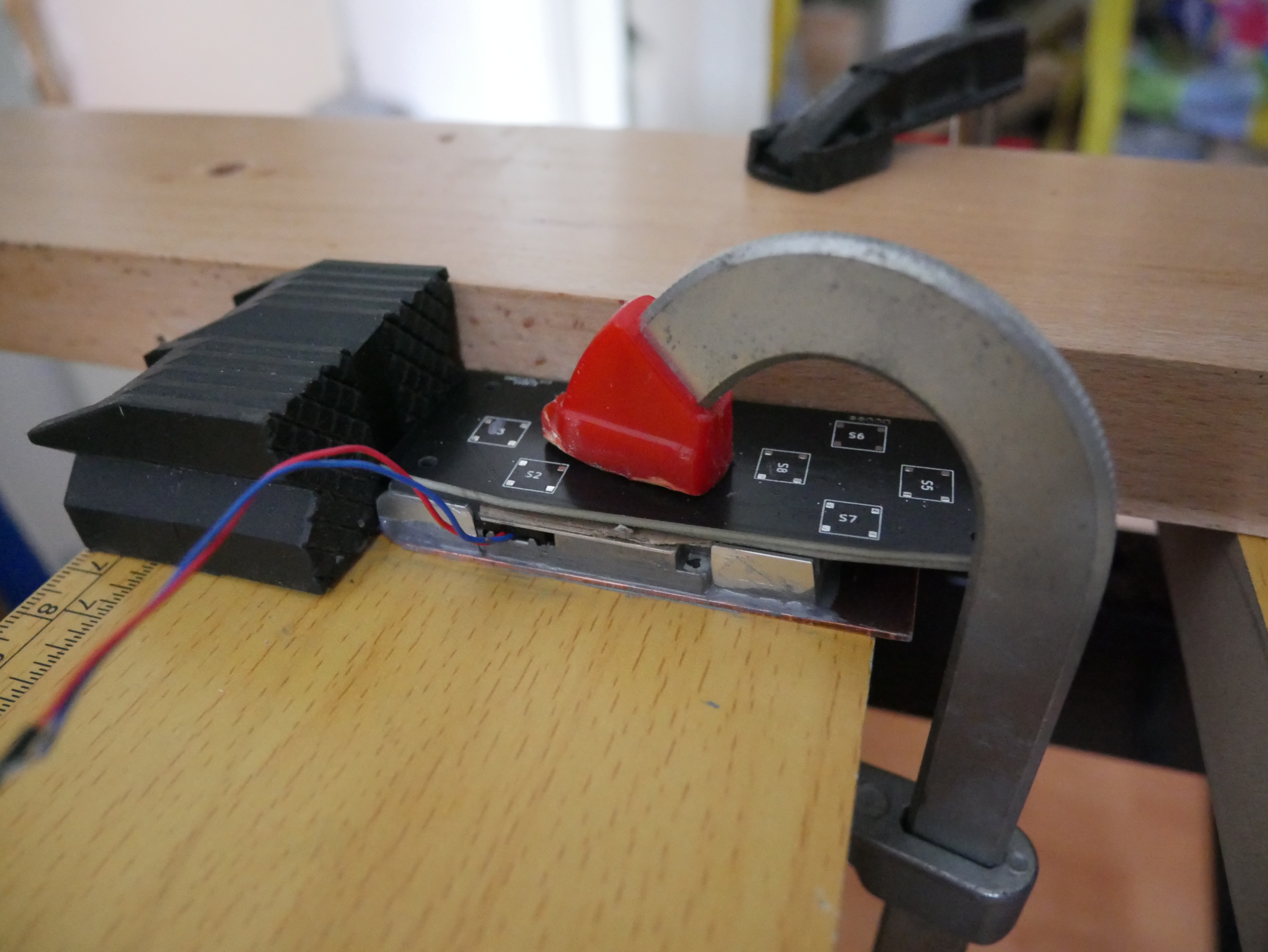

I did some tesing with different shoulderbuttons and the winner seems to be the classic squishy-tacy!
also if you do not modify your own custom pcbs, you're not a real modder B|

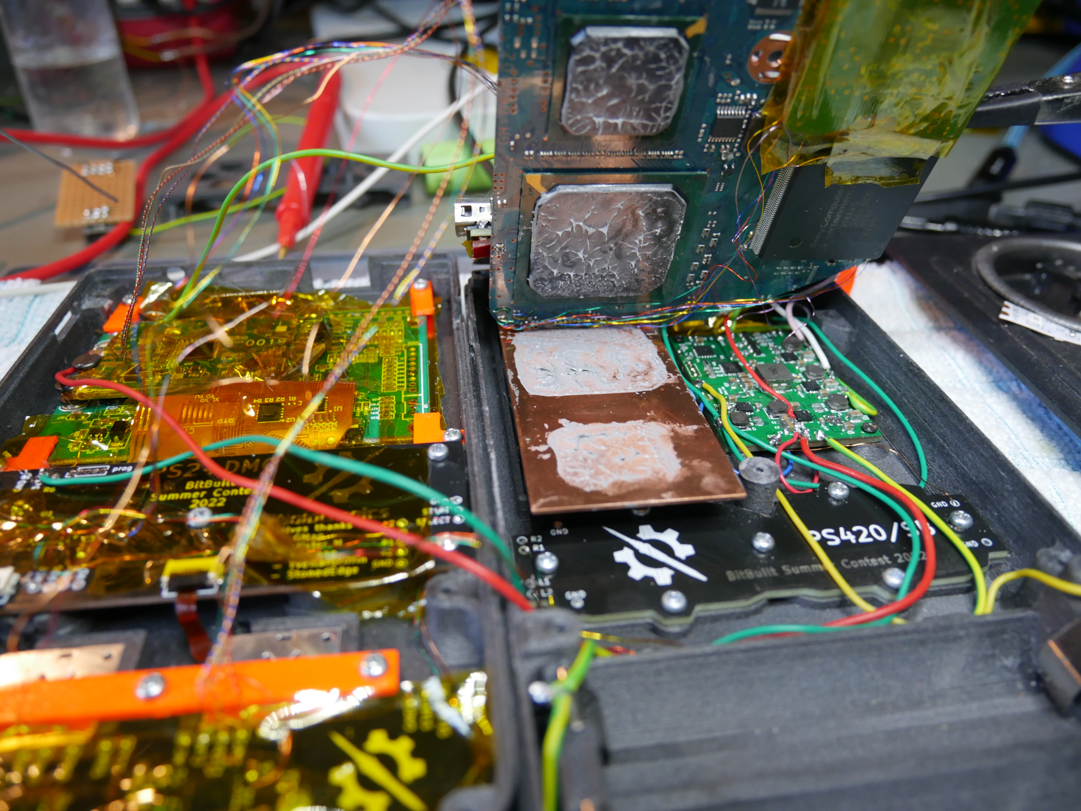

Today i did some more work on the bottom half of the case. Starting by gluing together the heatsinks, fan & copper plate.
And I did some test fitting. Even tho i have not much space left in the case, i also needed to fit a ps2hdmi into it. Cause my dispay driver doesn't support Component or interlaced VGA input. I think i'll also connect composite for the games that don't support 480p output. [which are sadly quite a lot].
Sadly i can't remember how i planed on fitting the ps2hdmi adapter :rothink: but i'll figure something out :mrgreen:
Since I didn't include any additional buttons for the display controls in the case, i'm planing on modifying the ps2plus firmware, to trigger the display control on a specific key-combination.
aaanyways i think i can make everything fit. Even tho i'm not sure if i'll put the PMS over or under the ps2 mainboard...

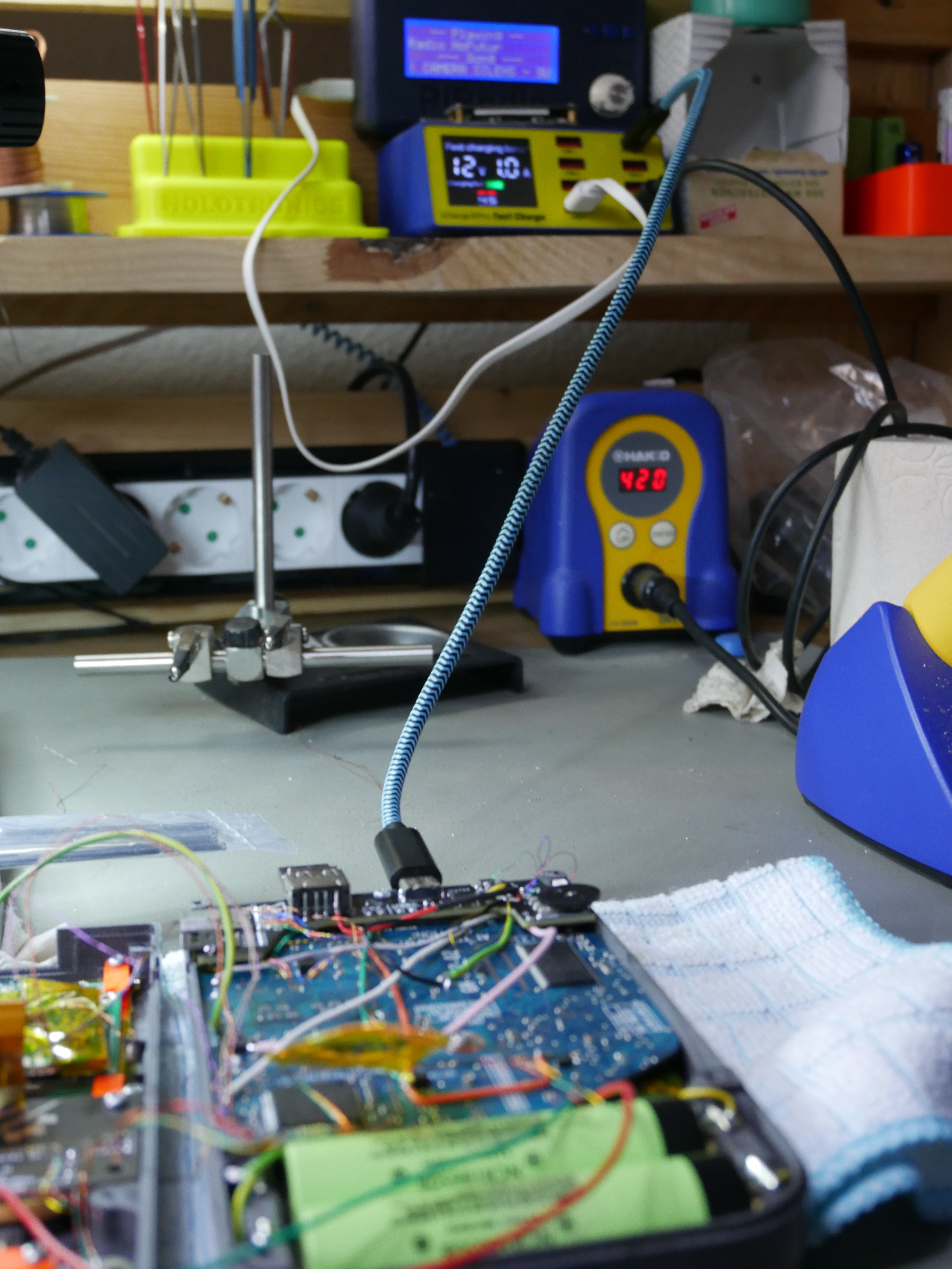

I'm so ready to finish this up!!1.. still waiting for the controller pcbs, tho. Hope they arrive tomorrow so i can do some testing.

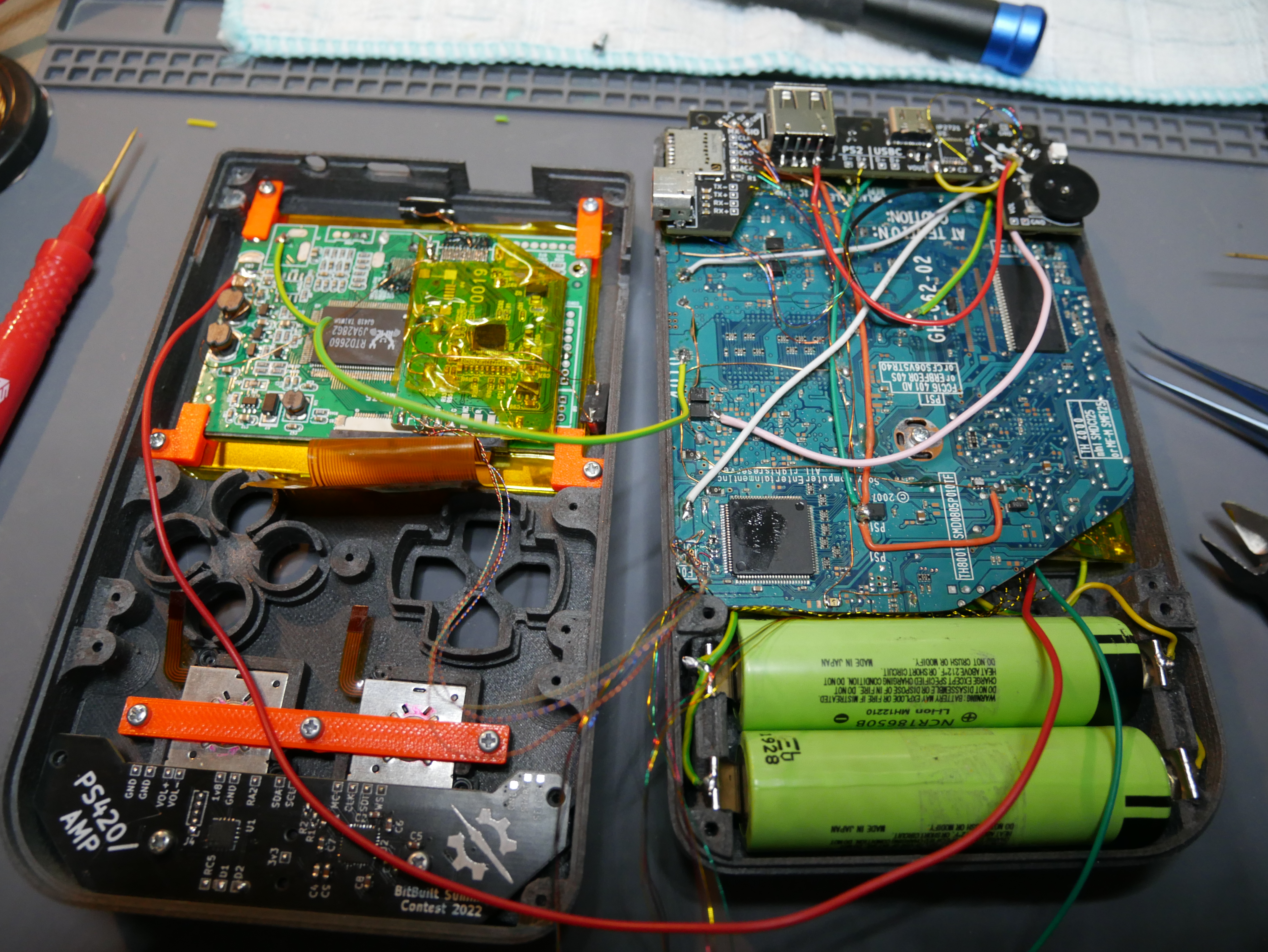

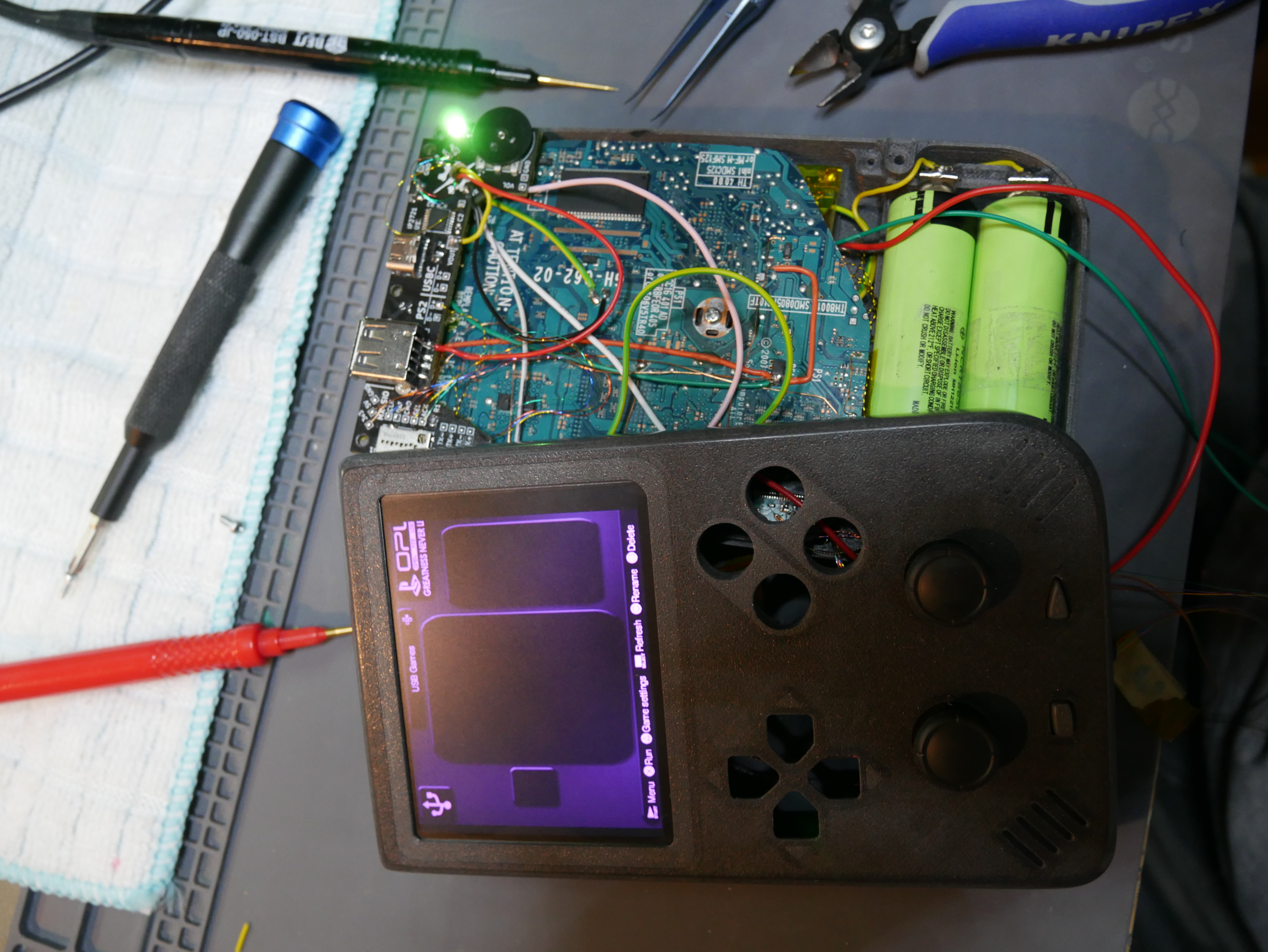

Meanwhile I printed the final case using the last rest of my classic contest carbonfil & spend some hours sending everything nice & smooth. Sorry for the messy wiring.
It's also kinda working!

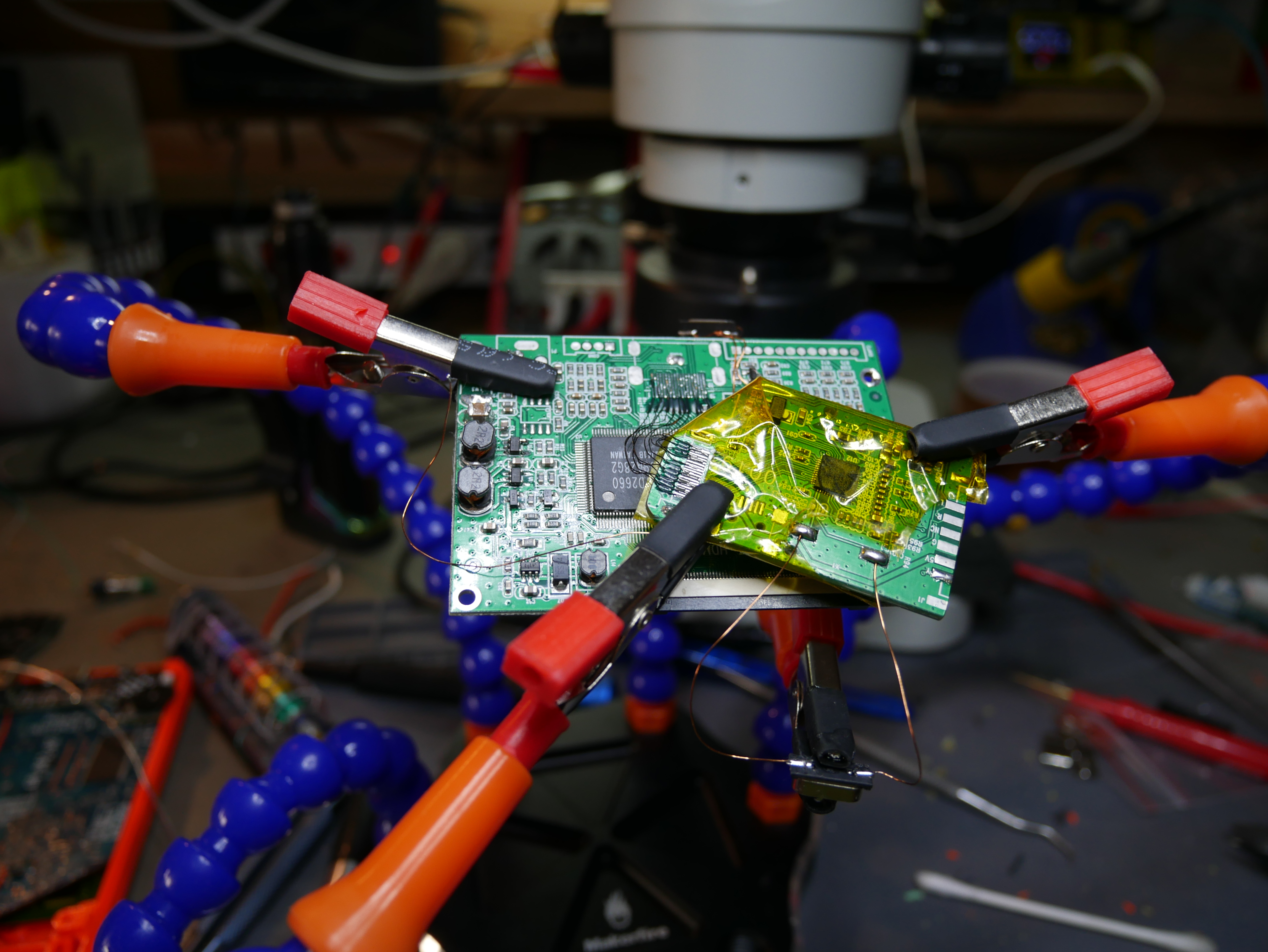

My IP2721_MAX12 arrived & is working properly :)
After some debugging i was also able to get the ps2+ controller and mx4sio working. Now i basically only need to get audio working.

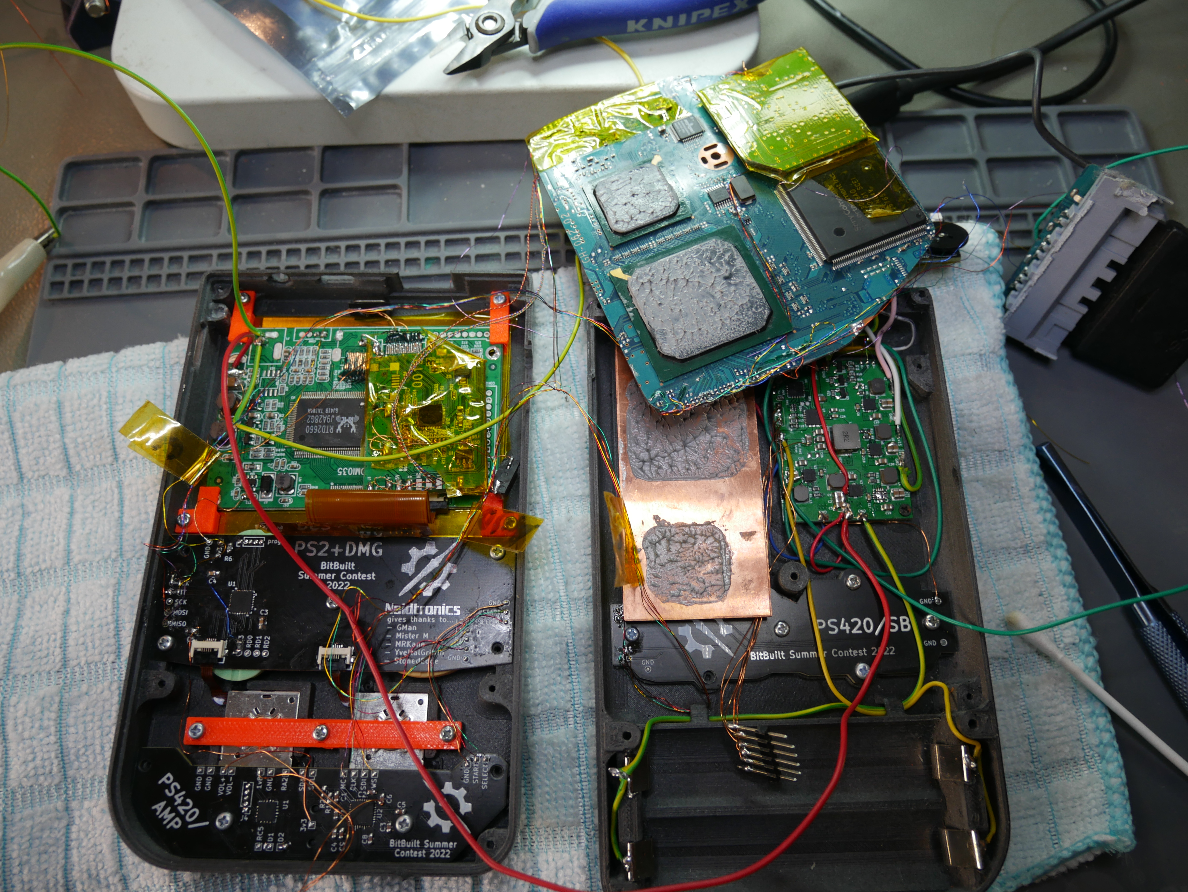

Until then, here is a spagetti nude:

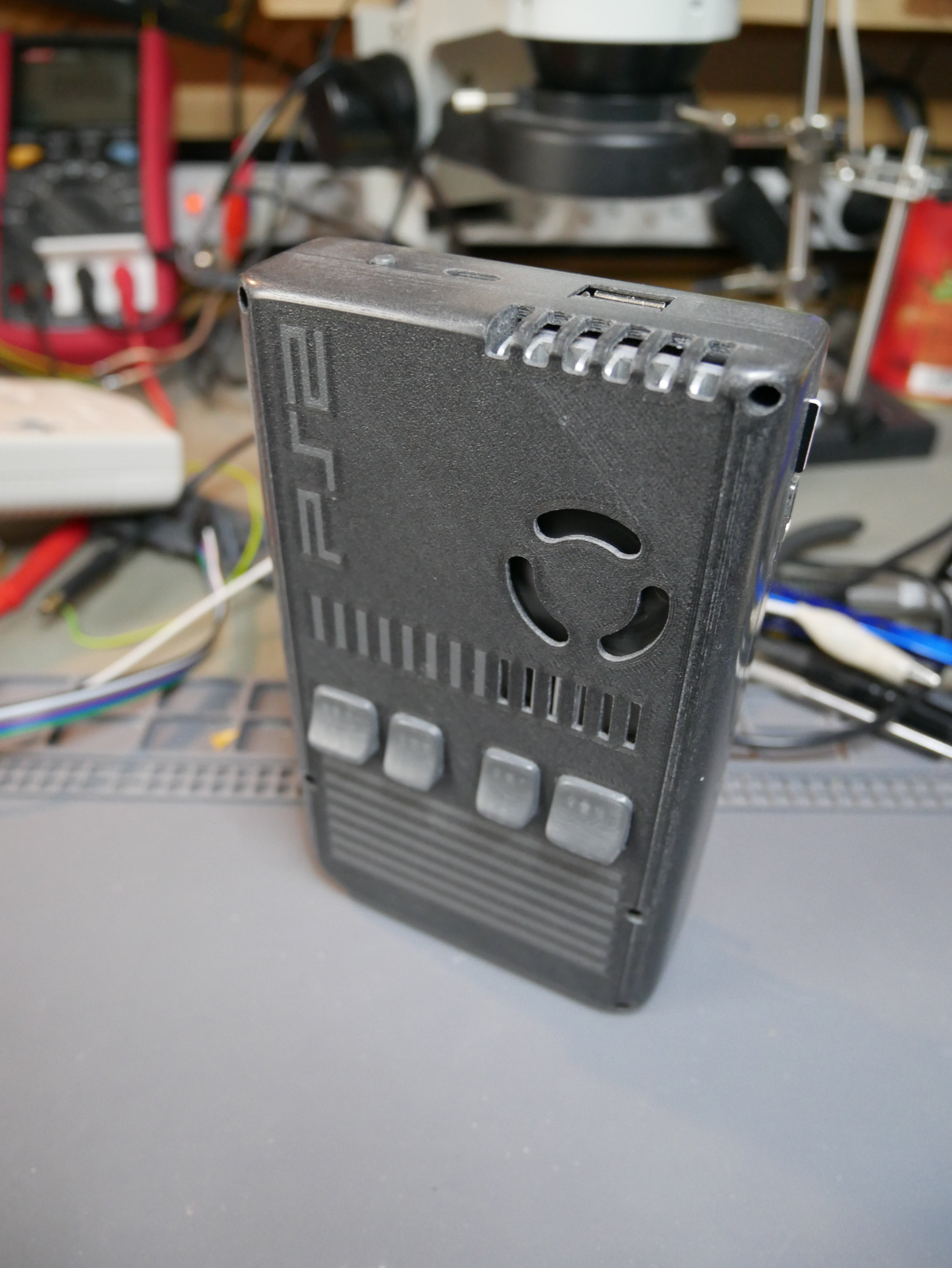

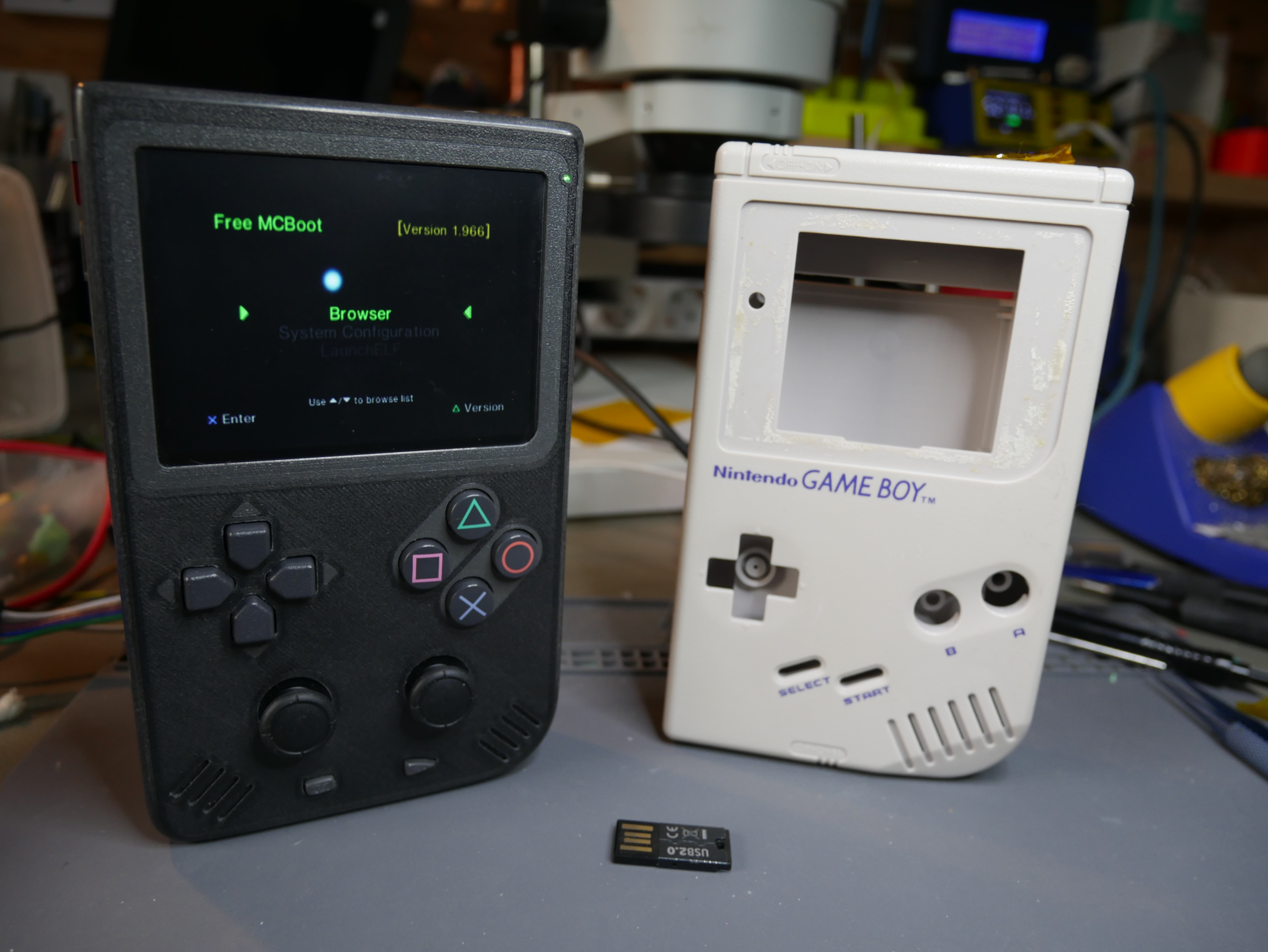

It has been done!

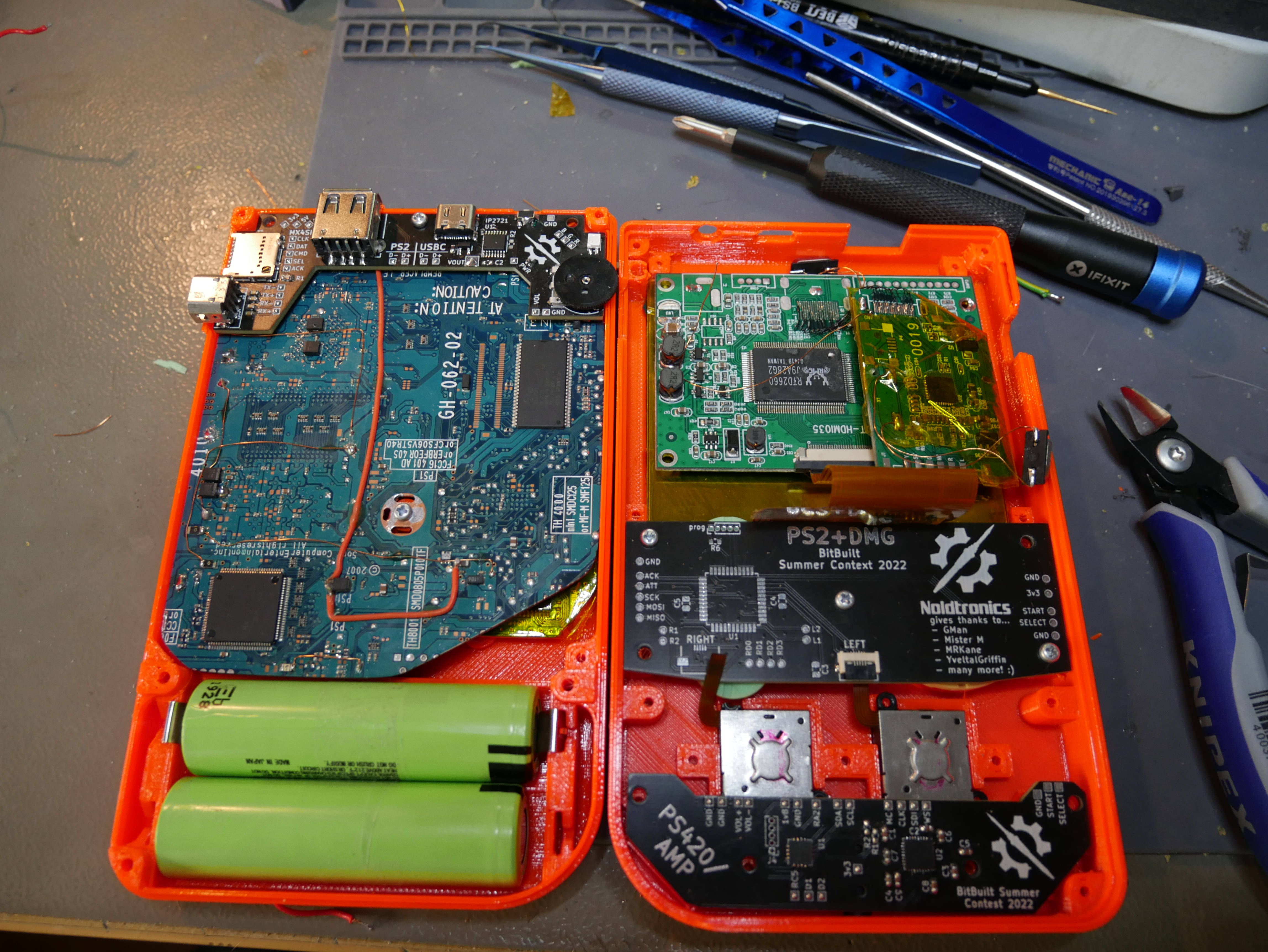

Since we all love nudes, here are some final ones:
Just some minor issues to fix & a video to make. But I'm closing the worklog for now.
