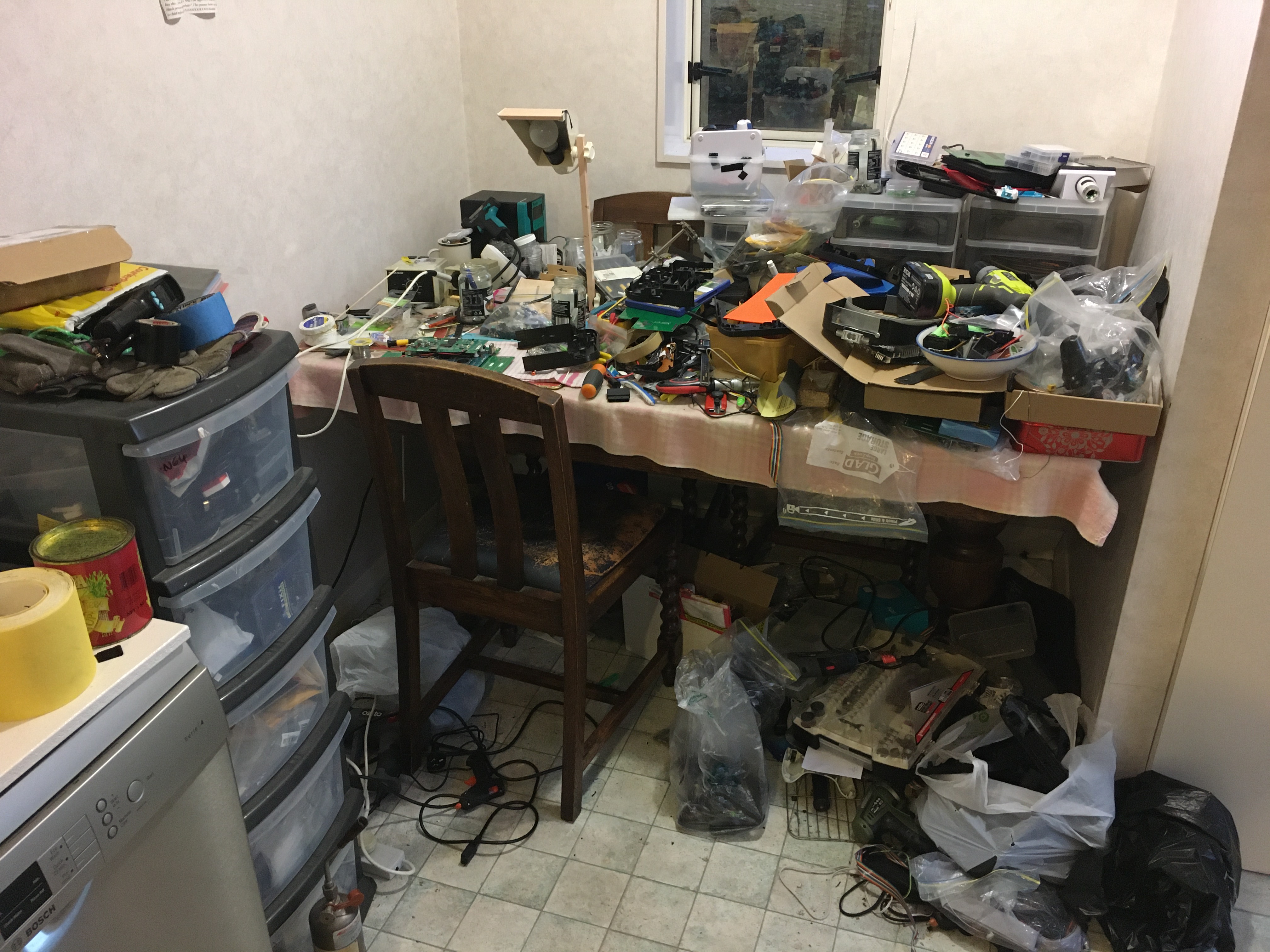

Ok, so it's not secret that I'm wrapping up electronics as a hobby so that I can move onto other things, but over the last decade or so I've accrued a collection of essentially worthless bits and pieces. This is something to light a fire under my ass so that I'll either make something with them, or make an awesome and stylish "completion video" involving me throwing things out. Either way it's also my little contribution to
There's an antique kitchen table under there, somewhere...

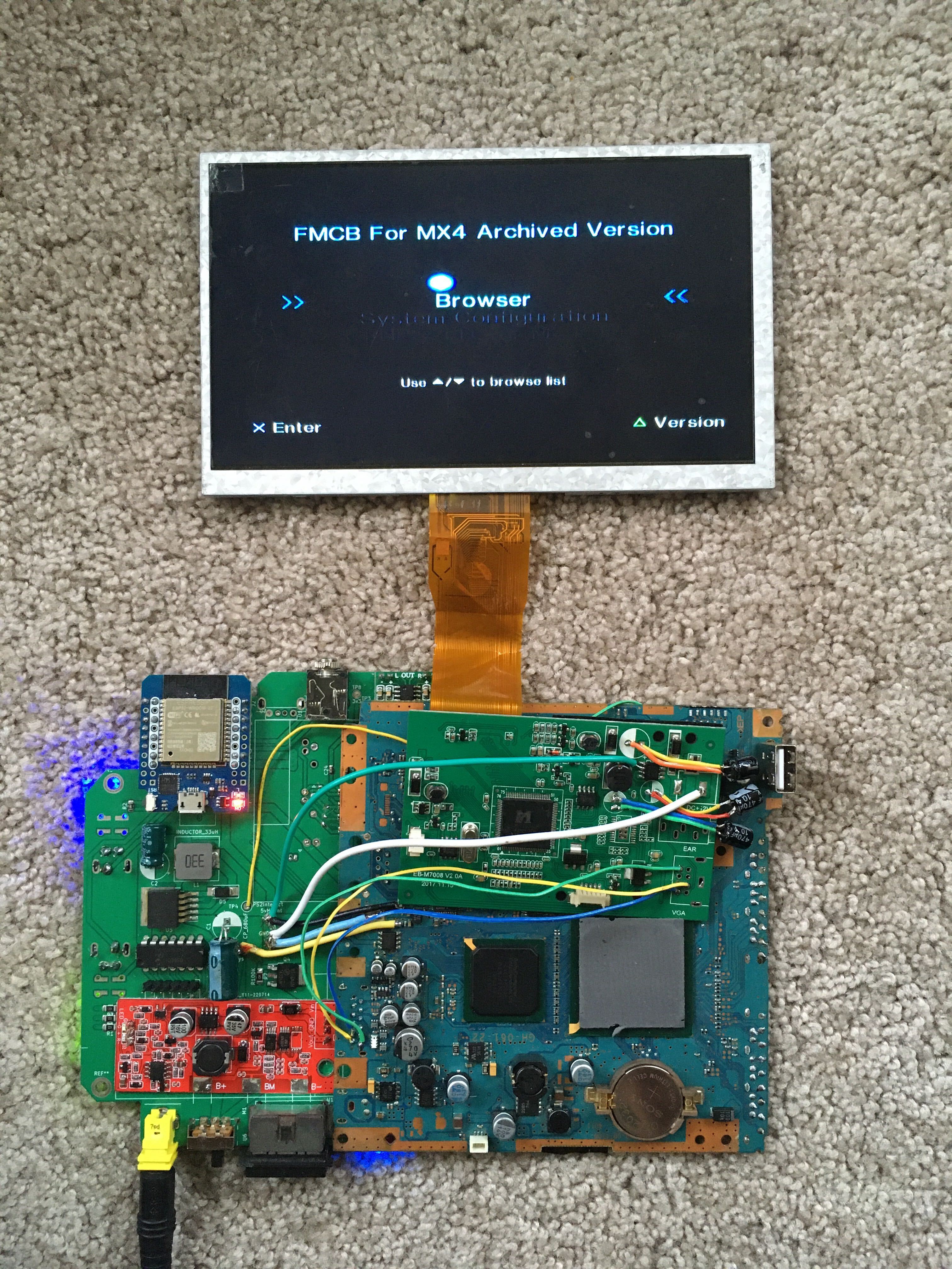

So after a few days of trying to assemble a lot of that junk, reading heaps of different things, coming to terms with the fact that New Zealand seems to be an unreachable wonderland in the eyes of the US postal service, I've finally actually got a plan. It's not pretty. Not pretty at all, but true to my mantra it'll be mostly assembled from things that I've got lying around.
Project Base:

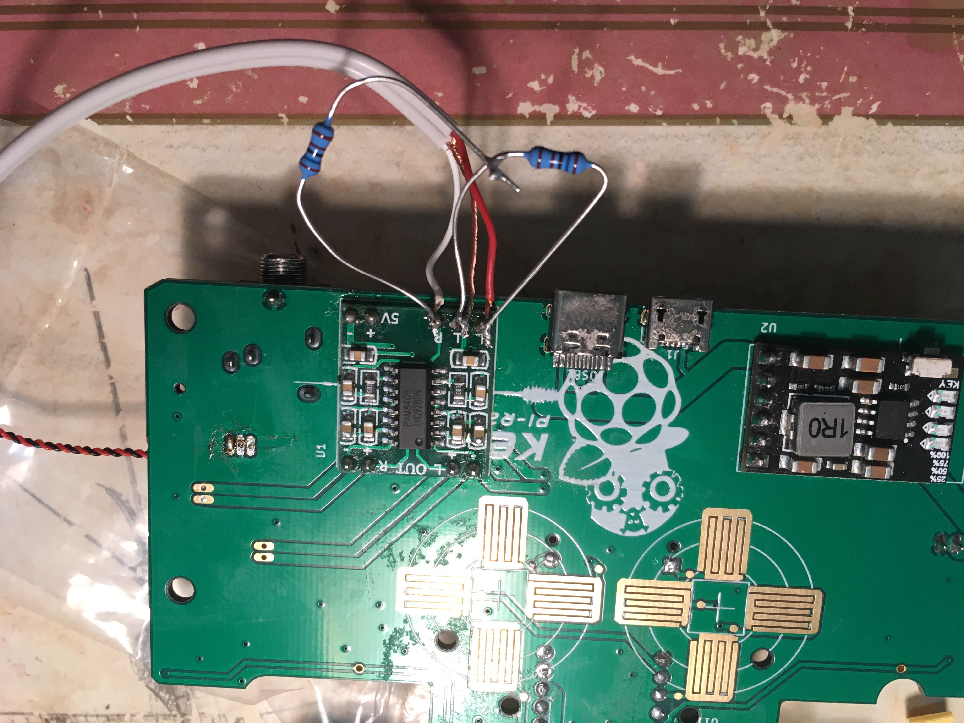

-Use PAM8403 amplifier boards with 1kR pulldowns on the import audio channels to denoise (or build into the board). This could have been a sexy UAmp but postal systems said no
-Use spare PIC16LF15324 long-bod chip as system controller
-Use spare redboard to provide power
-Mango for SMB loading with capacitive ethernet
-8"HDMI screen left over from another project
-Dirty cheap PS2 to HDMI board because buying the Analog to HDMI from Shepard had massive postal costs
-18650s to stick out the back of the unit, because I got them
-Include onboard 5v regulator to provide 3.5A (minimum of 3A) to cover Mango, PIC, Hailraiser, screen mod etc.
-Use WeMos D1 Mini ESP32 board for controller interface, with joycon holsters on side for "portable" and a stand on the back to have unit operate as a standing screen
-Slimmed down screen controller board
-Some sort of interface tacts for unit control
-Spare volume wheel for volume
-Spare switching audio-jack for headphones
-Spare speakers for...speaking

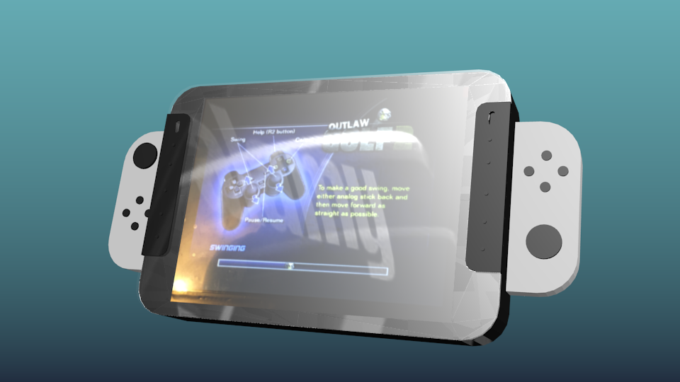

I also went about hitting up blender and doing a rough base design, where there's zero attention paid to style and only the function of the unit is considered, combined with my hell-bent desire to get an acrylic frontage, I knocked together what's best described as...an iPad. I feel dirty for this conceptual converge.
Please don't read into this image too much, the dimensions weren't measured or checked - it's something I threw together with maximum haste before Fluffy wanted to have pats for the evening. I understand that Fluffy is now a bit of a tradition for me in this competition according to what I've been told.
So a quick touching of base - no treble.
Around the 3DS overhaul and trying to perfect my prior PS2 portable I've had a little time to look into getting this project working. The BlueRetro adapter has been nothing short of amazing*, and naturally the controller I purchased for the Switch didn't work, so I've been discussing things with DarthCloud, the owner of the project, to see if there's a way to resolve this. Hopefully he comes through with something, otherwise I might have to sell off these cool third party Switch controllers!
Aside from that I grabbed an ESP 32 D1 Mini and have found that it preforms outstandingly also! I'm not sure which pin is "boot" so welcome advice here - there's a lot of chaff online, and this button might be necessary if I ever want to use two controllers with this project. Otherwise it's really early days here, and I've done a lot of arranging components I've got and pretending things will work. I spent a few days and sketched up a basic carrier board and am trying to squeeze everything down so that I waste lots of money after making a basic mistake to try and reduce the unit cost and perhaps set it up in a way where it'll be flexible for different designs.

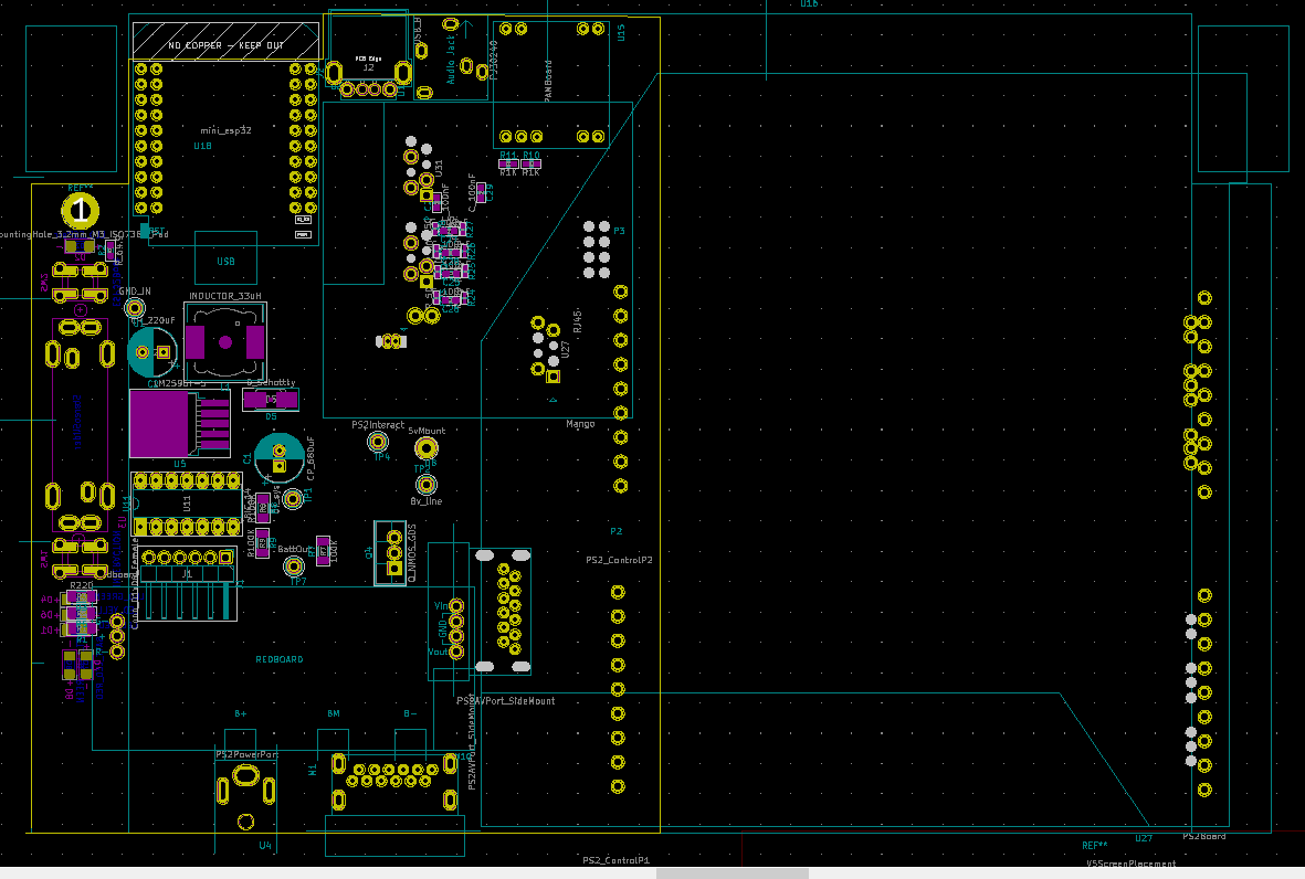

I'd appreciate eyes-on the PCB when I get closer to finalising things, and like last year I don't care about prizes so am unconcerned if this disqualifies me - I'm just happy to be part of this :)
*Amusingly I've actually been using my Wii U pro controller to play my PS2 since I got this up and running - it really is a pleasure to use and it's been virtually flawless so far!

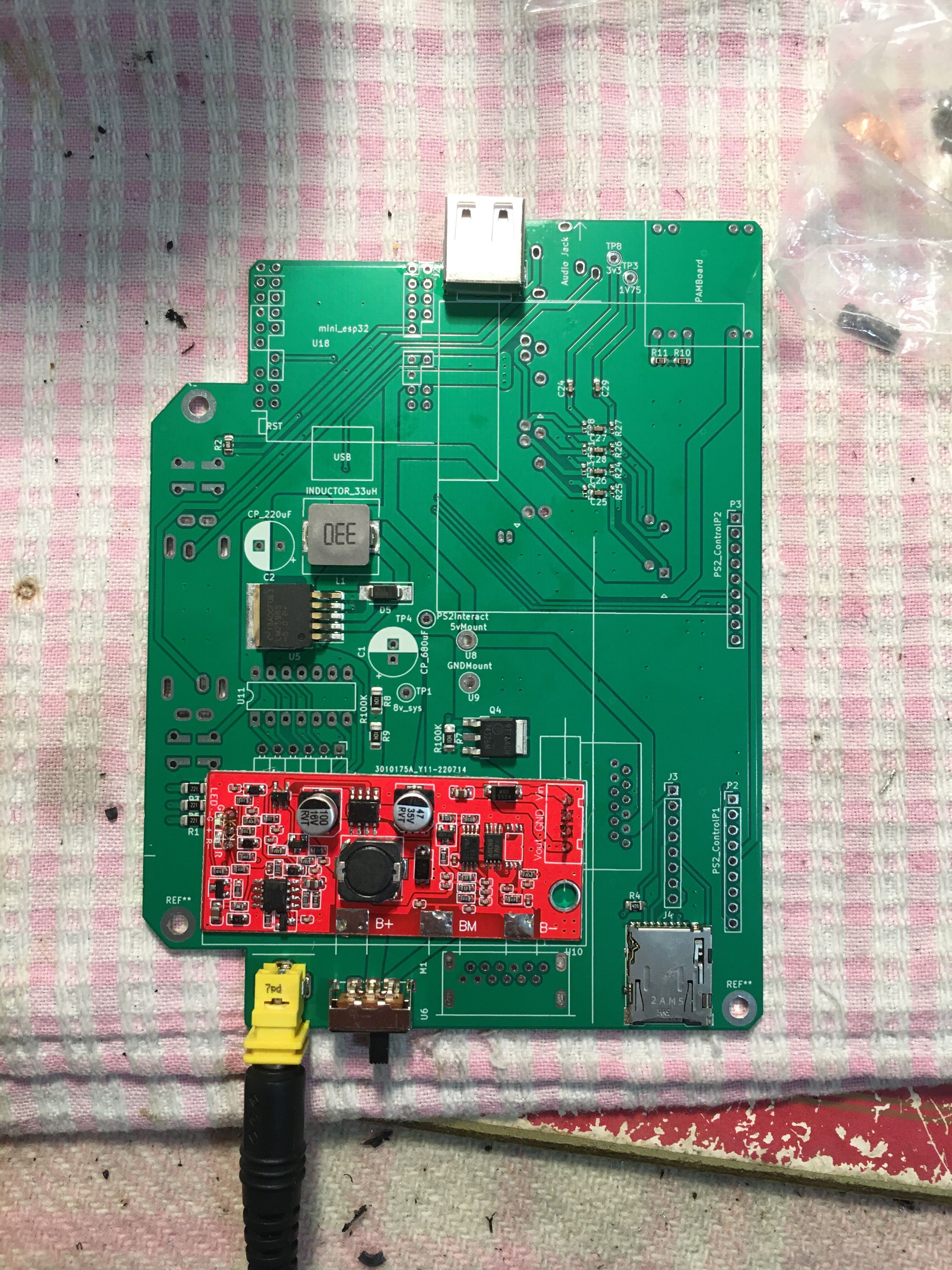

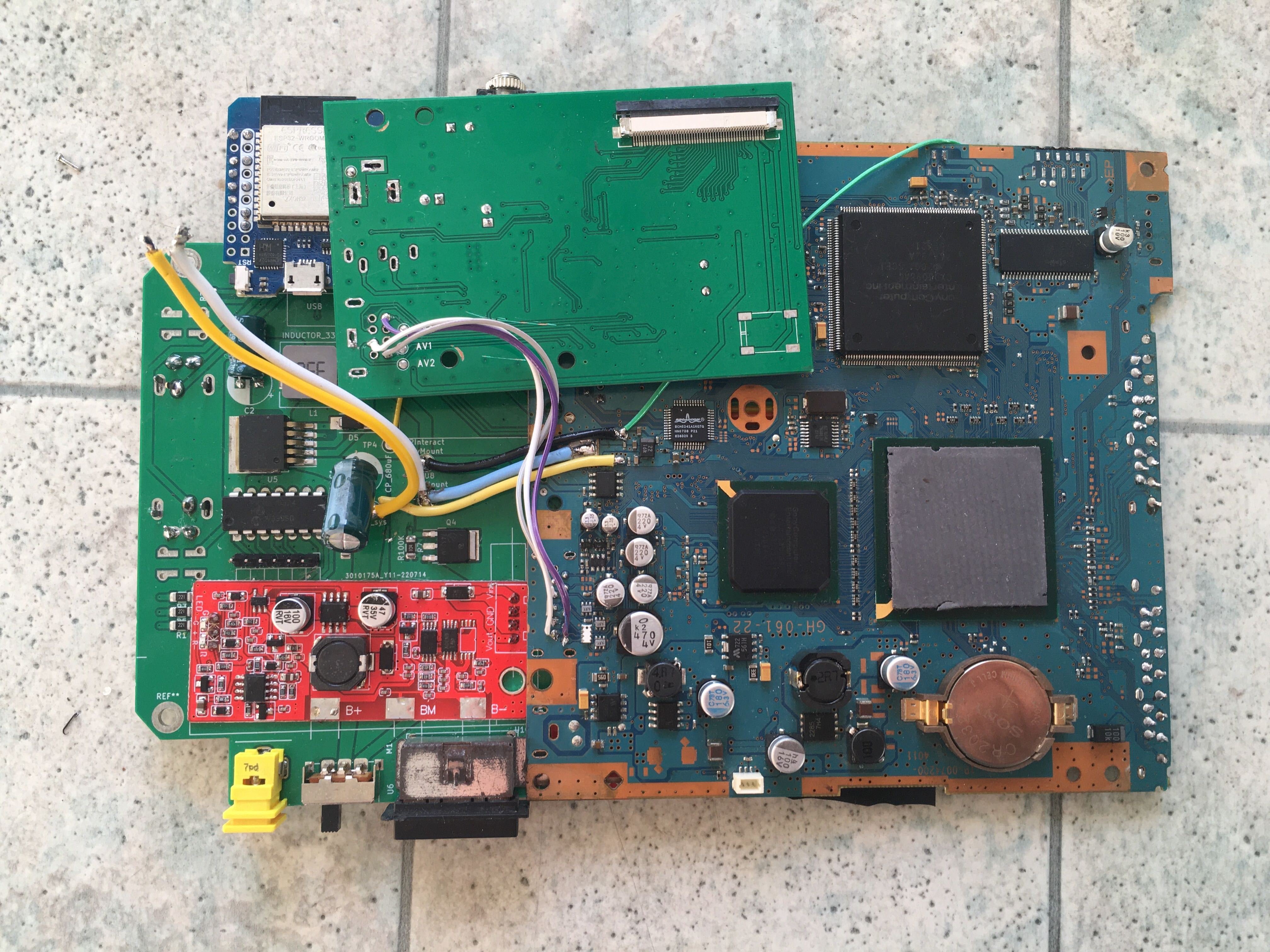

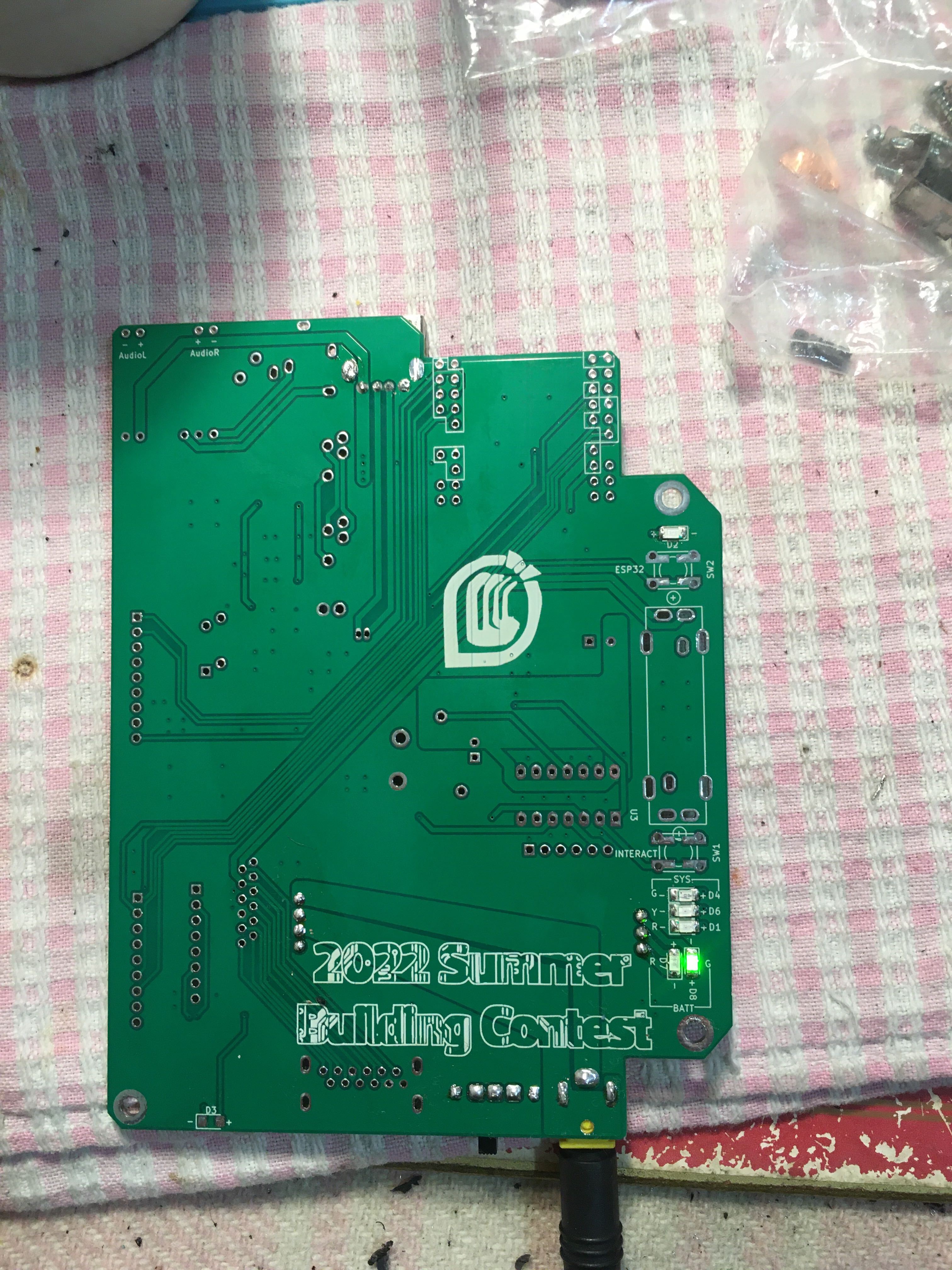

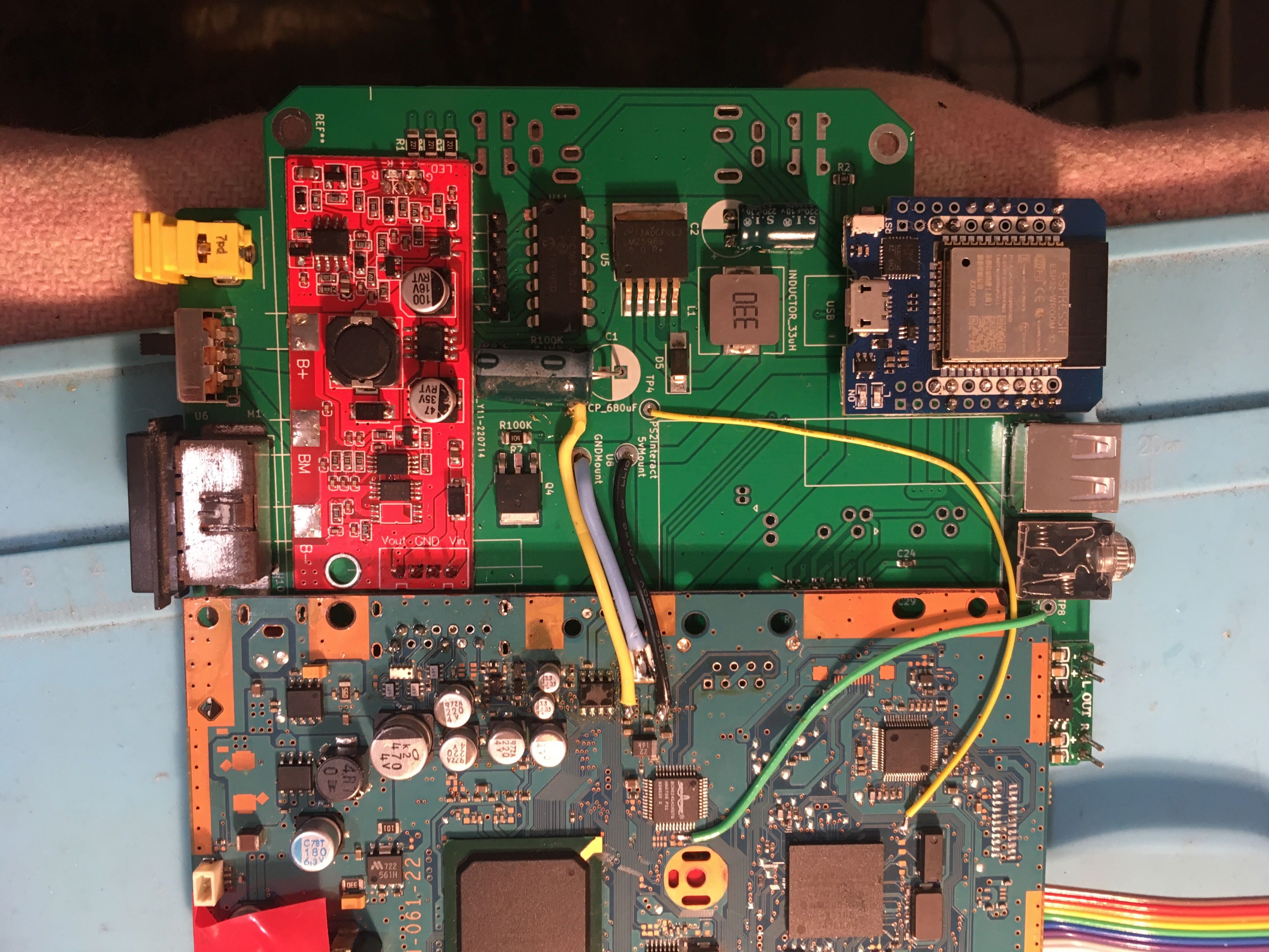

So the boards I designed with JLC arrived a couple of days ago and I've been sitting on them while waiting for the PS2 SX4MISO unit and the LEDS. As fate would have it both of these arrived today so I opted to try and do some assembly and see if the power system could at least be kicked over - and it appears to be working. So that's one part going!
I also appreciate putting the Bitbuilt competition logo on my PCB design because bits of paper always get lost.
Ye olde red board - you won't see many of these around nowdays! I paid to have JLC mount everything besides the redboard, front LEDs, and the PS2 power port as soldering is truly getting beyond me, but SMD heat soldering always works like a charm! Turns out my measurements on the redboard were slightly out of alignment. I'll bury it in the case so that I don't have to look at it because it kind of triggers my OCD.
So now I've got a bit of testing, and potentially some bodge wires to run if things aren't connected correctly (the SX4MISO is so that I can confirm my work), and then a little bit of setting sup with BlueRetro and the Mango before undergoing more assembly.

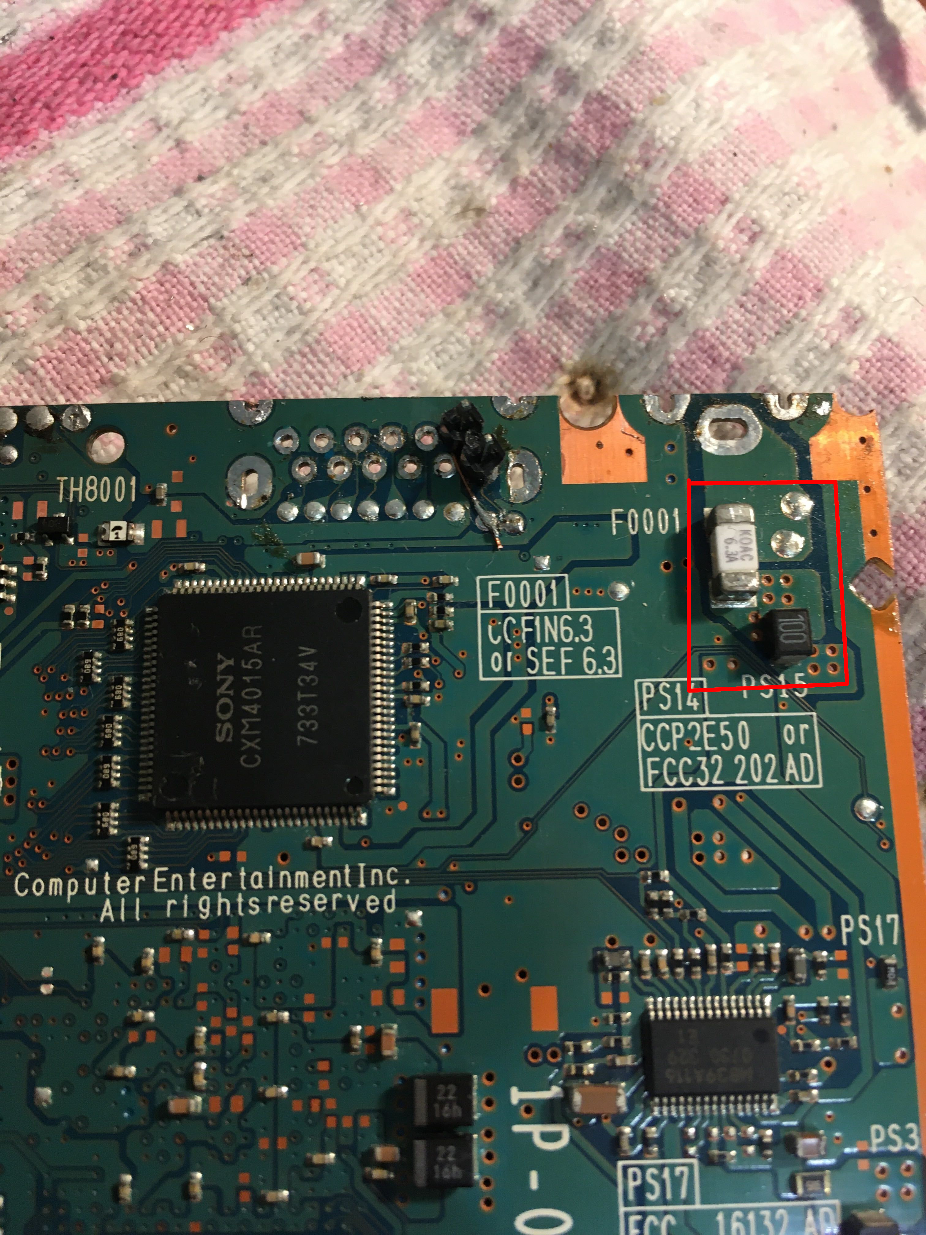

Then I discovered that I'd mis-placed the SD card holder and it was colliding with some components underneath. Judging from the trimming guide it looked like they weren't necessary for the standard trim, so I opted to remove them. They came off in pieces.

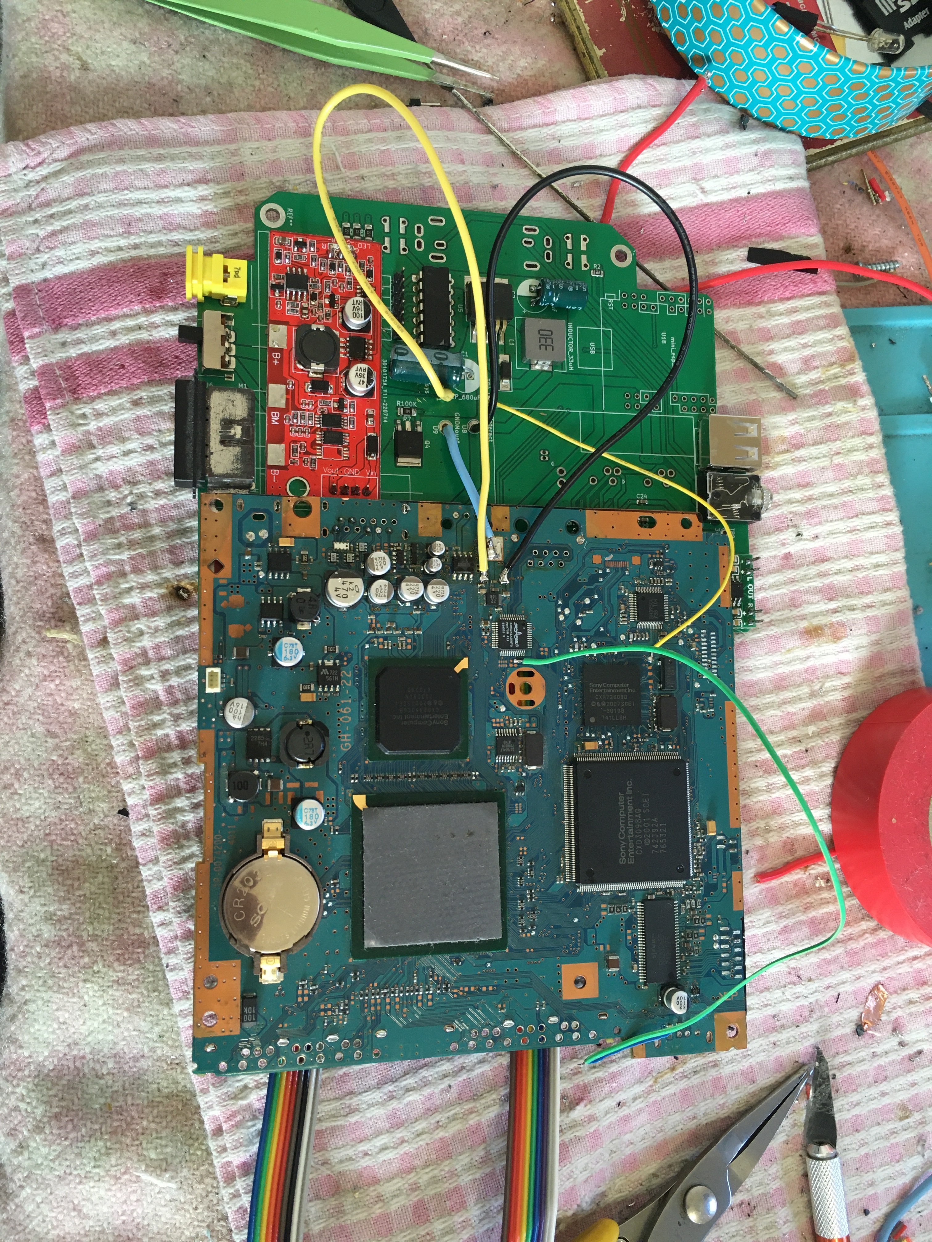

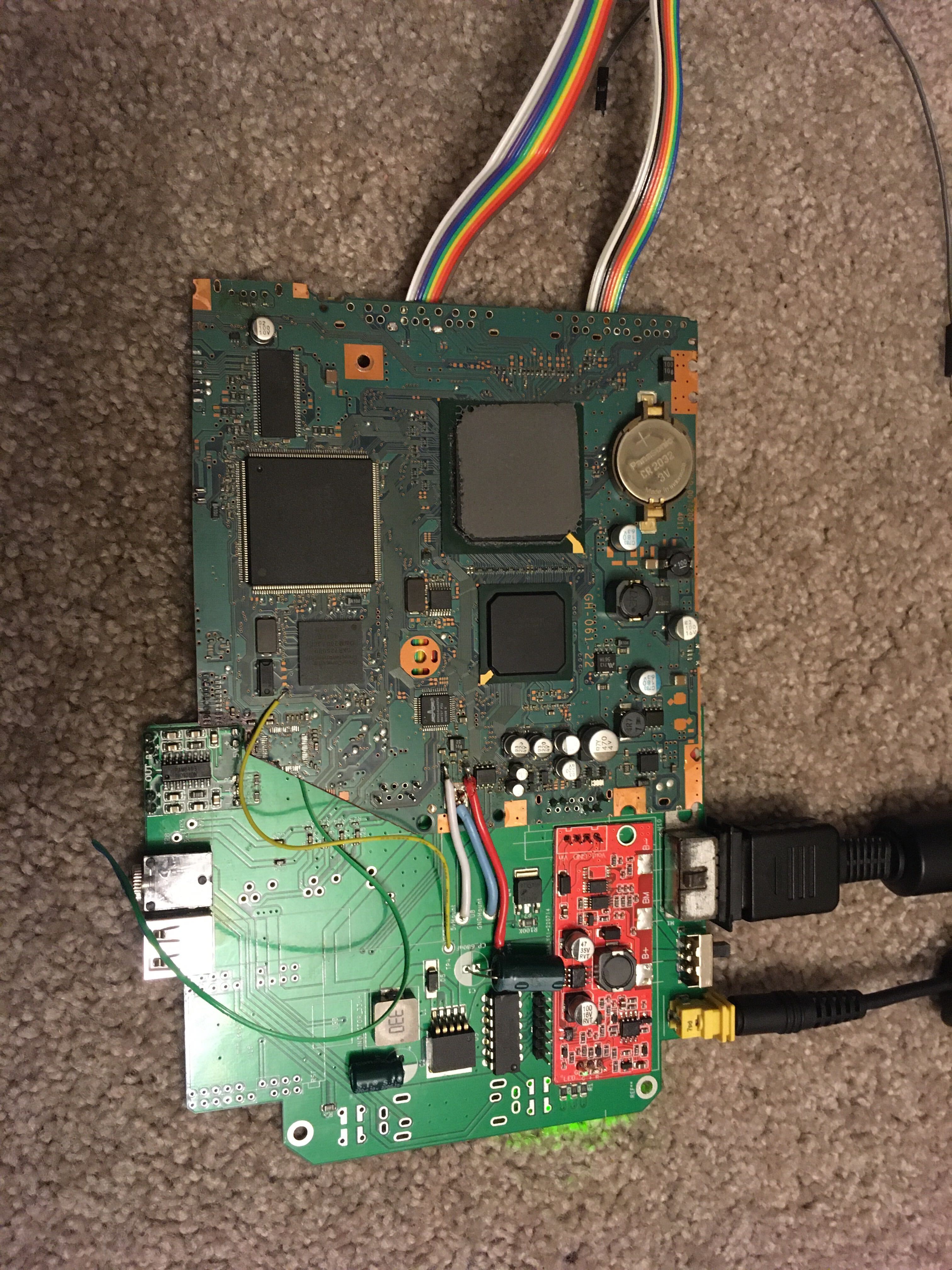

Then after lots more messing around it was finally time to fire it up and....nothing. Chips don't even get warm so I'd say that I've killed this board, be it from removing those components, or general MS-hands dodginess.
I'll see about coming back to it tomorrow, all advice welcome here, but I might just have to go about things more methodically and when the MS isn't kicking my ass as much.

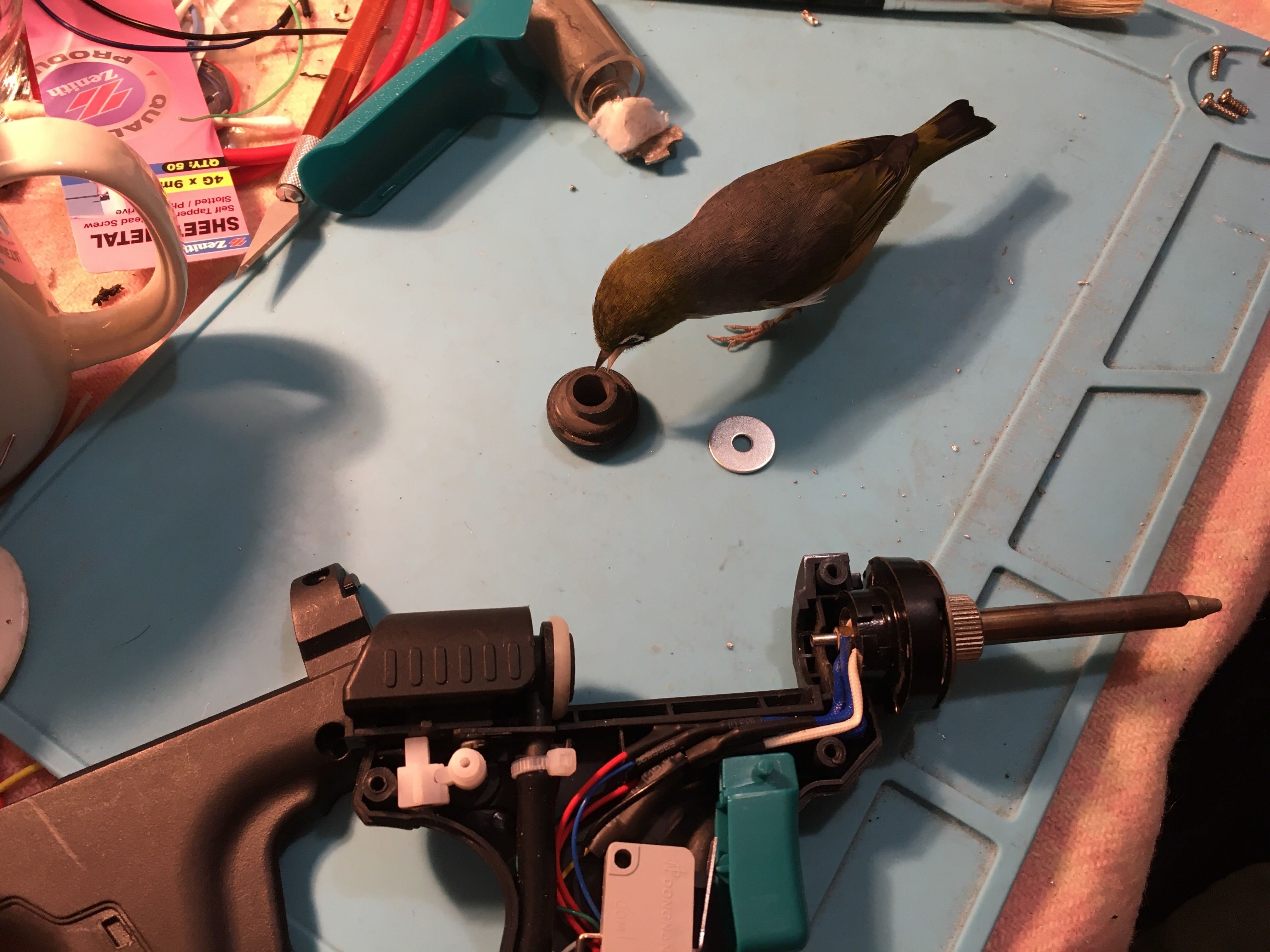

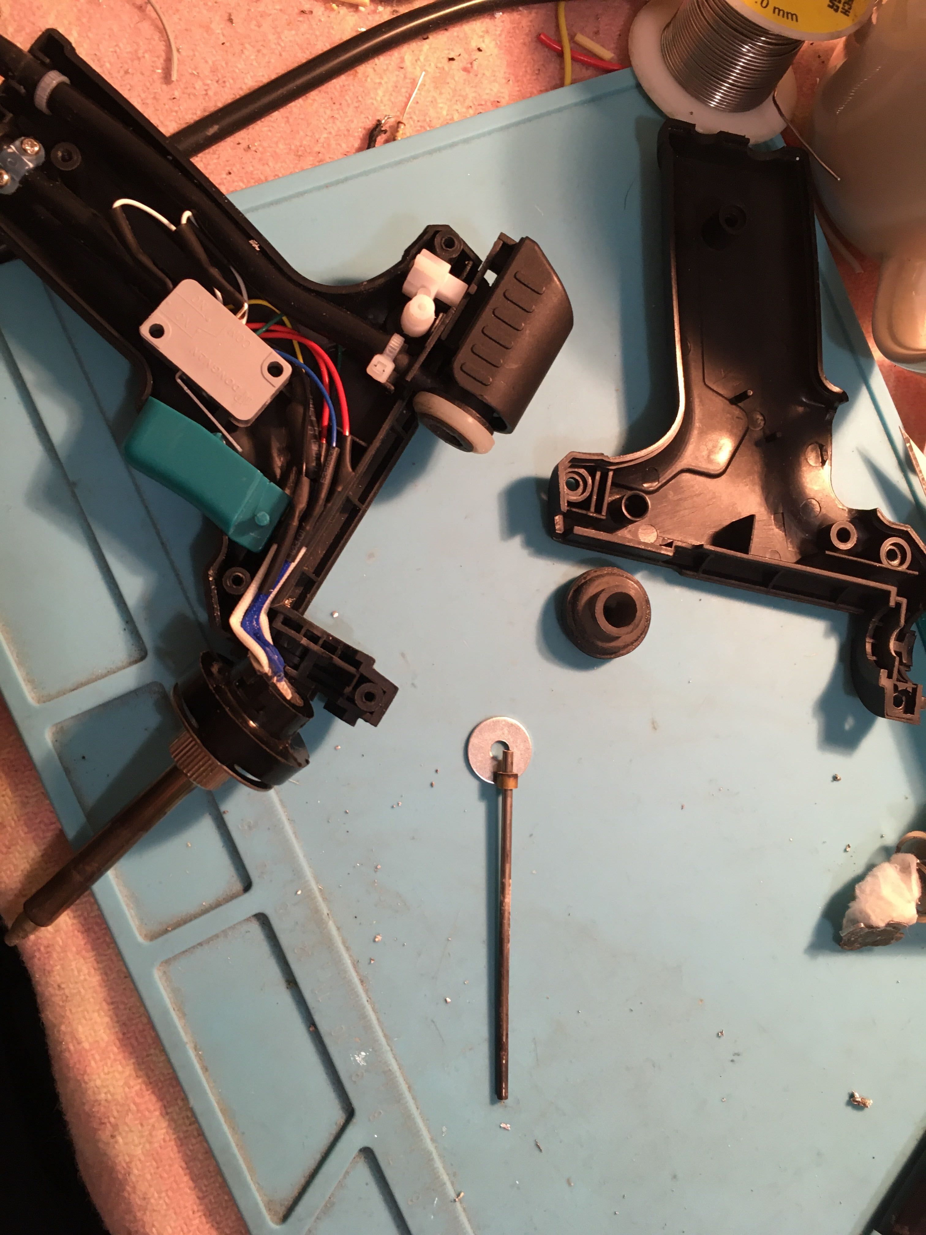

One of the big outstanding issues I've had is that my desolder pump has become increasingly unreliable. The little metal grommet had some loose from the back of the insulation tube. I crimped it in place and used a washer to stop it from pushing through so now it kind of works, and it's the upgrade I should have done in the beginning.
Fluffy advised on the repairs.

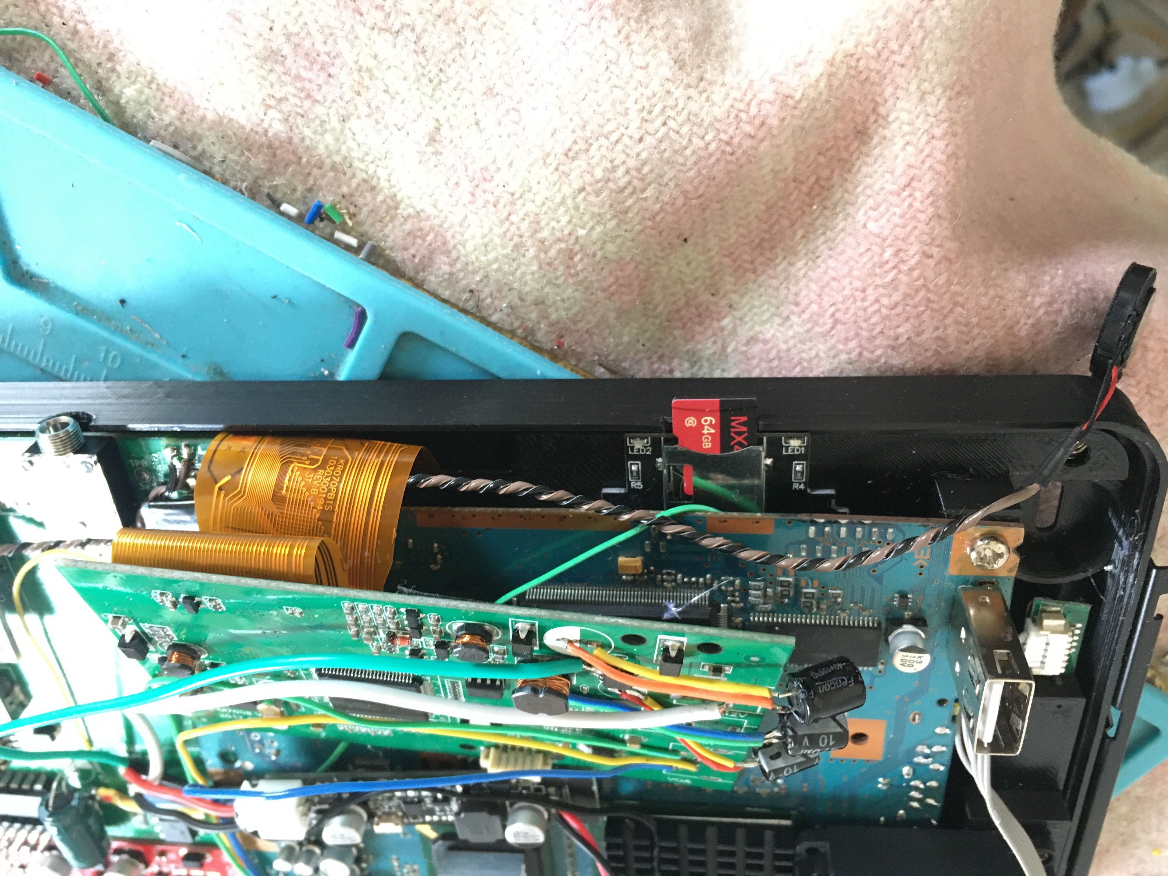

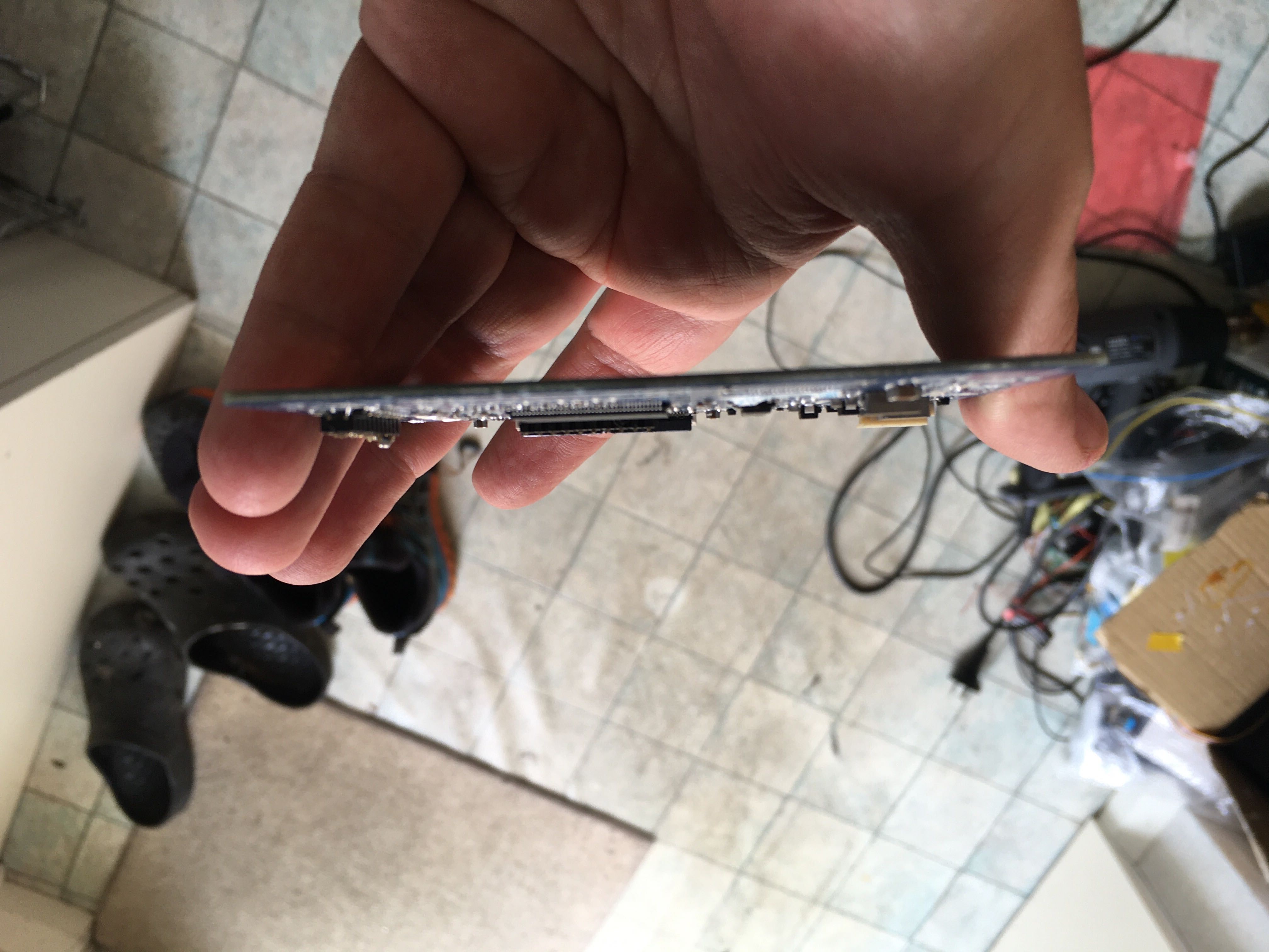

So the memory card placement was intended to be temporary, but we all know it's permanent now. I'm also not thrilled that it's only a 16mb card when I was sure I'd purchased larger. there should be sufficient play in the lines to swap it out in future if it proves too small.
So one of the last things I did was toss in the SD4MXISO as a micro SD port when I designed the PCB - it's more of an afterthought than anything else. As discussed on Discord the placement proved to be sub-optimal as it collided with some large components on the underside of the PS2 board, and I kind of had to wing it when it came to the wiring based off of what little I could find pertaining to wiring the port to a micro SD. As fate would have it, it worked! Amusingly the games however, don't always work but it's nice to have it as a feature.
I wonder if it'd be possible to piggyback an actual memory card port on top of this as I don't see why it wouldn't read if there's no SD card in place.

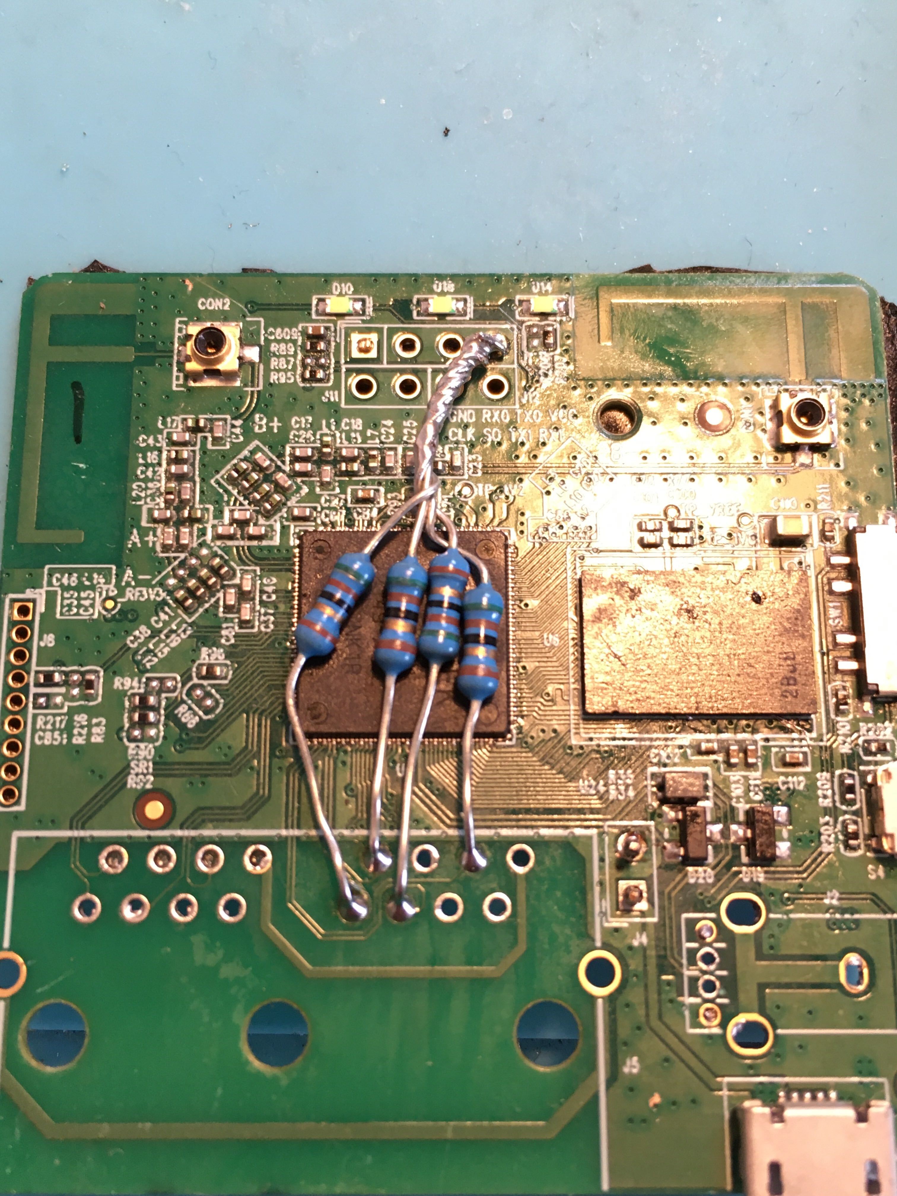

So after over four days of troubleshooting and trying to figure out why, I've been unable to get the Mango to talk with the PS2 board in this project. I found that the wiring was wrong, so steadied my hands as best I could to solder to traces and see if I could rectify the issue.
Short answer: Didn't work, but I'm 100% sure that this is the correct linage for the ethernet port now - still no love however.
I've had plenty of chatter on the unit lights and the USB, but I couldn't get it to connect. Unusually I couldn't even seem to get it to show up through a WiFi connection, so essentially ended up experimenting on it until the solder pads were properly buggered. I've concluded that I'll have to fall back on the MS4SIO which I know works, and it's a good plan B.

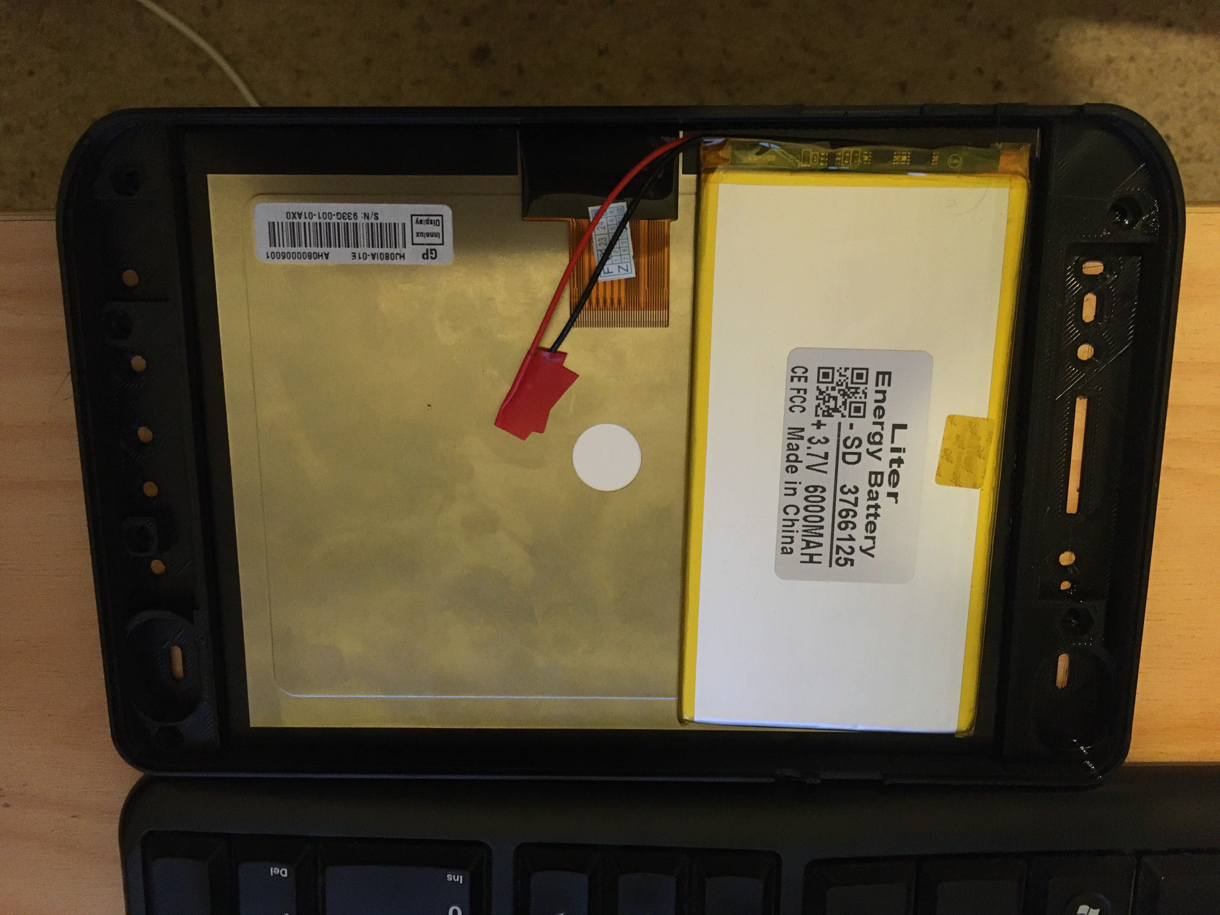

Anyway, I've kept pushing forward with the case design, and decided to cannabalize the Colossus for parts, including it's Eyoyo 8" crazy-good quality screen - which just so happens to be larger than the one I'd intended to use. Turns out it's large enough to cause problems for the design but seeing as it's the better quality one (and the harder one) that's where I'm starting!
The design has a 3D printed board sandwiched between the electronics and the screen to separate them and also hold the screen in place - I'm feeling a bit stupid for not taking a photo of that but we all know what those look like (broken from printing on low quality - that's what it looks like).

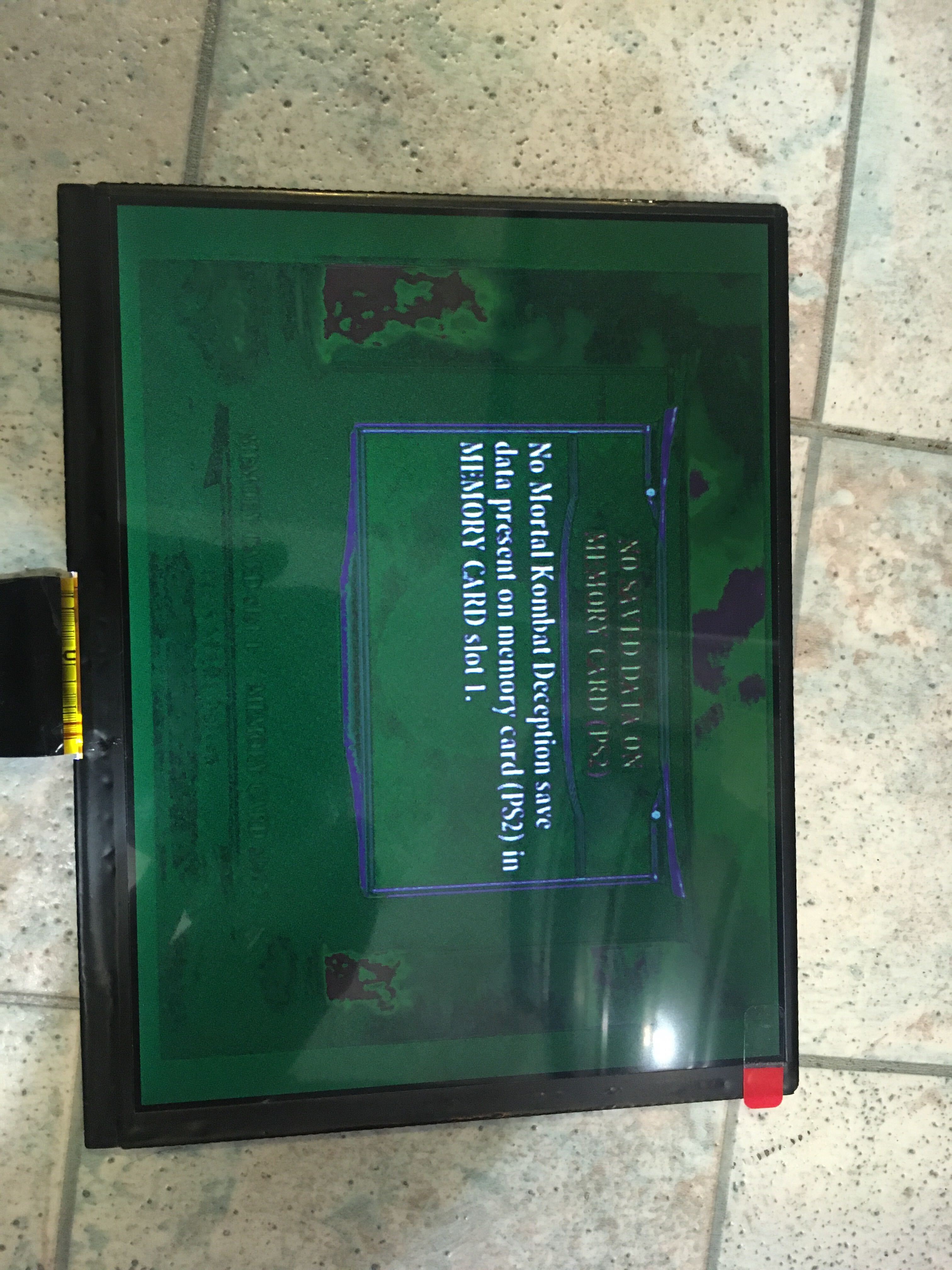

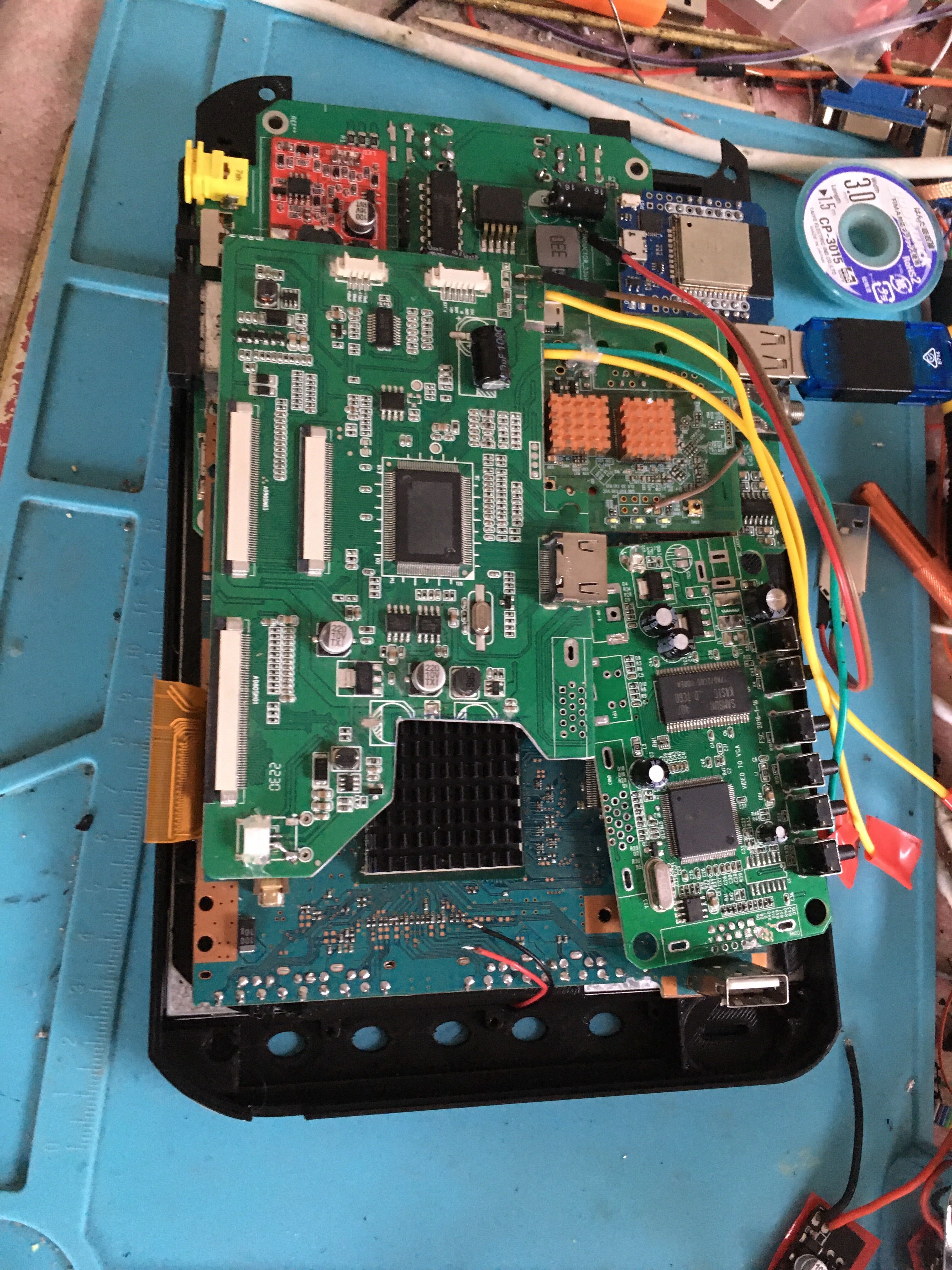

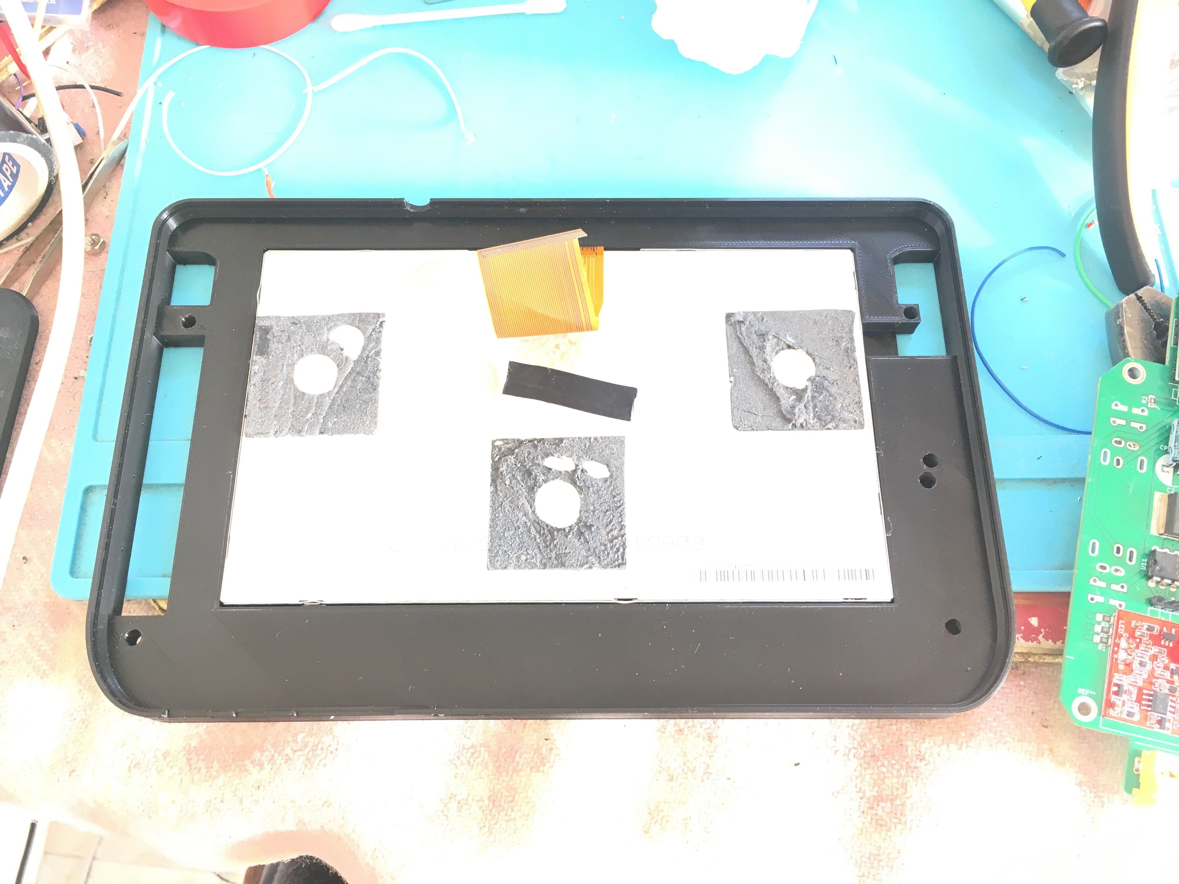

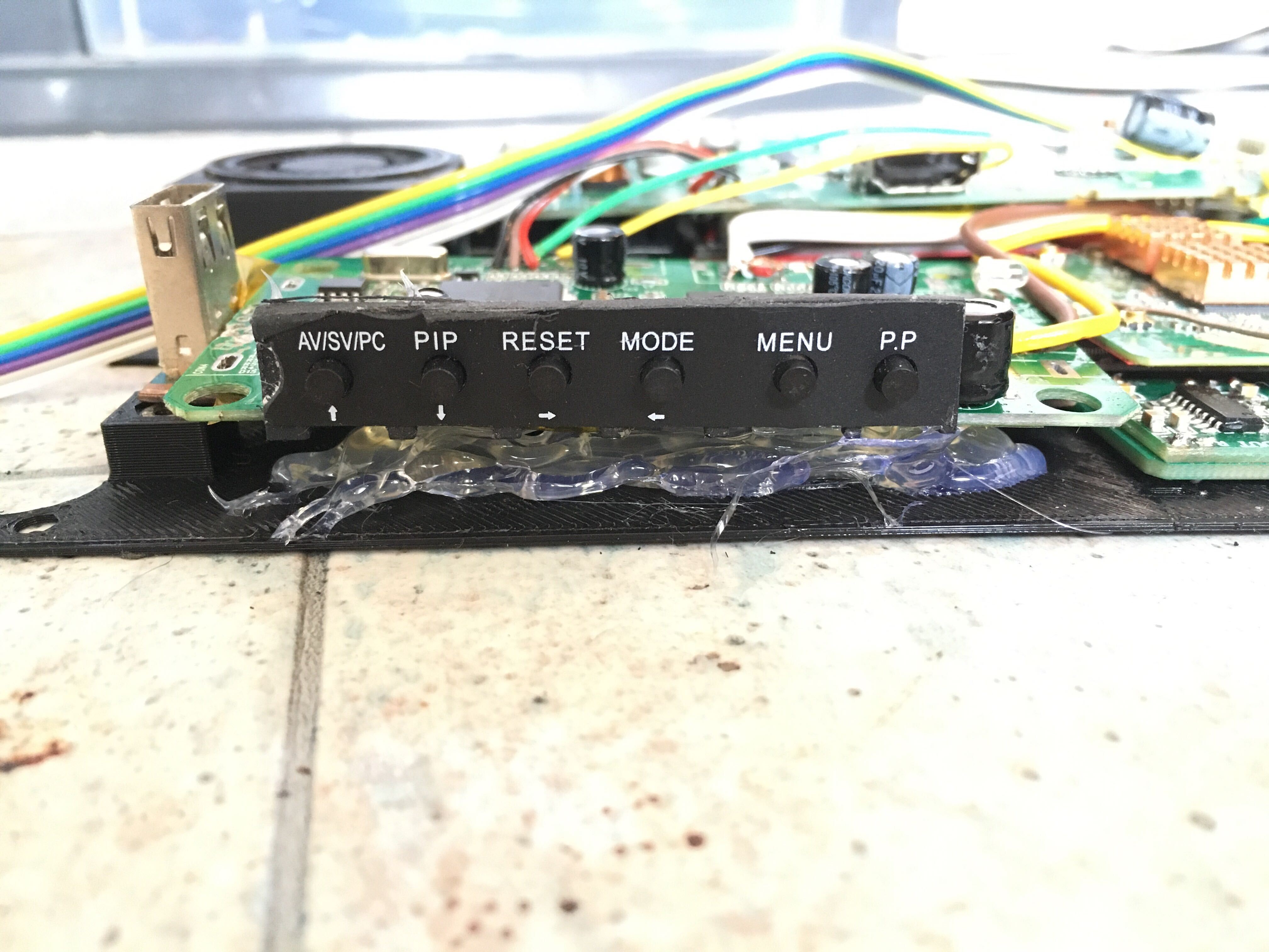

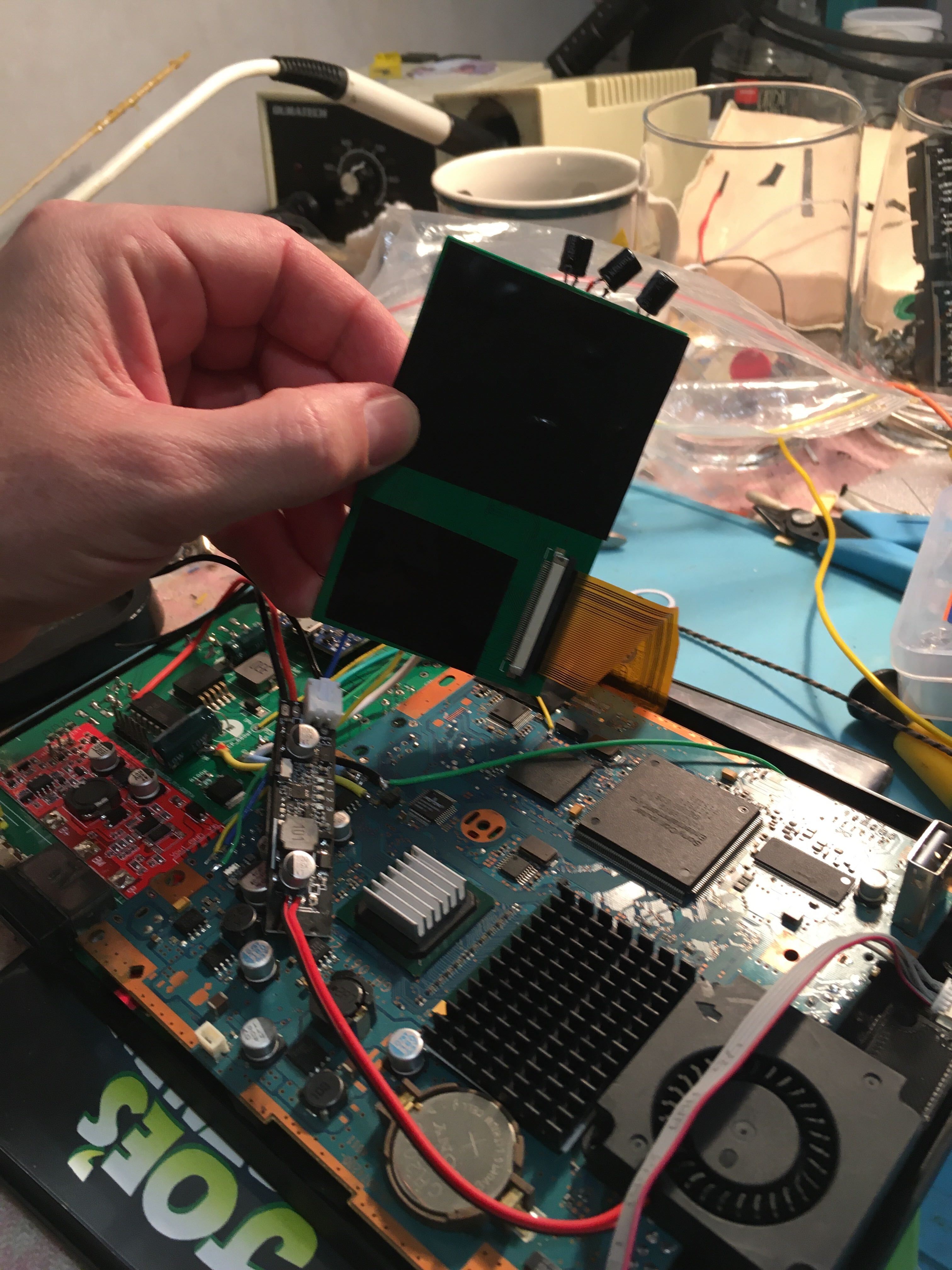

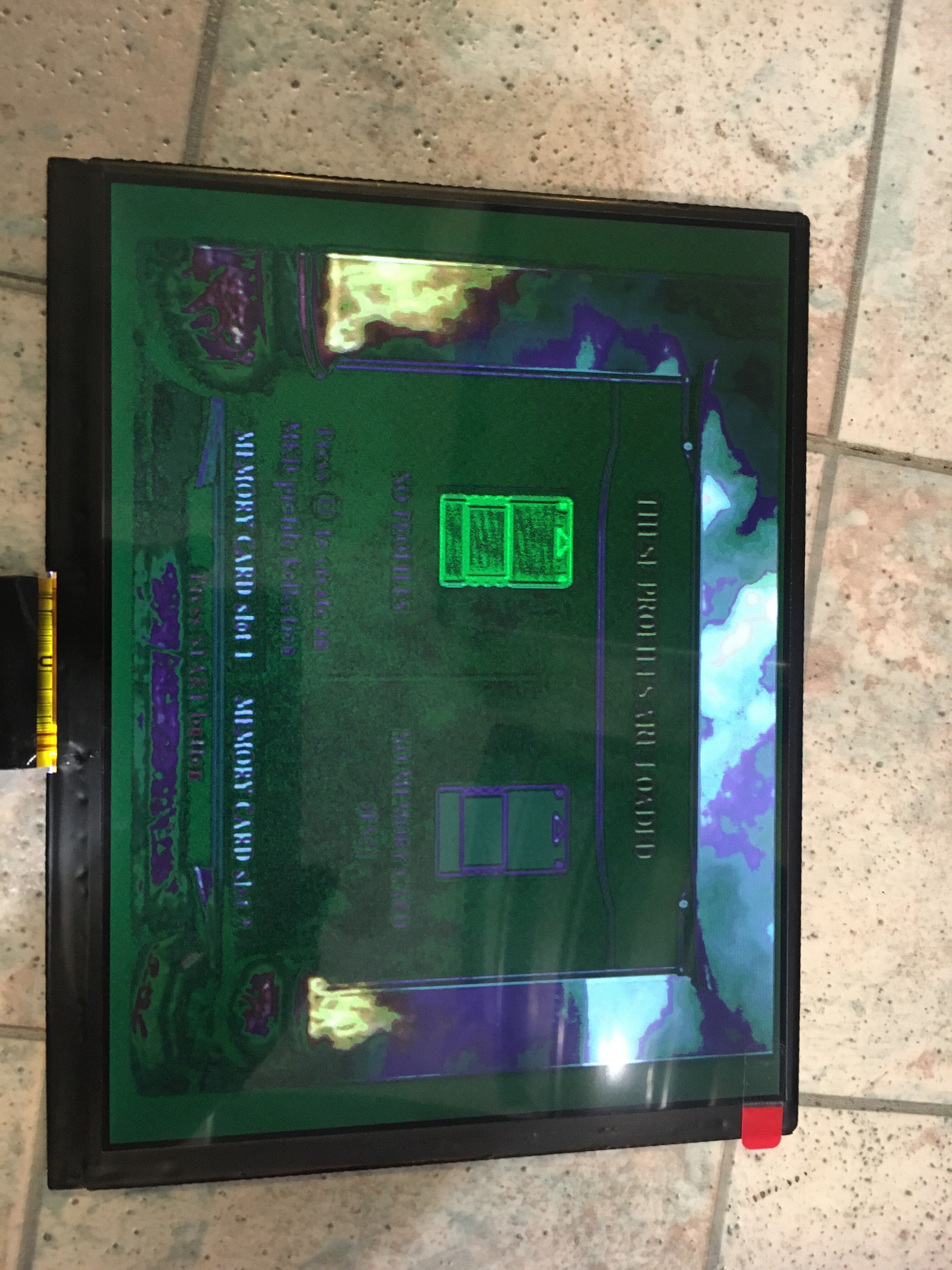

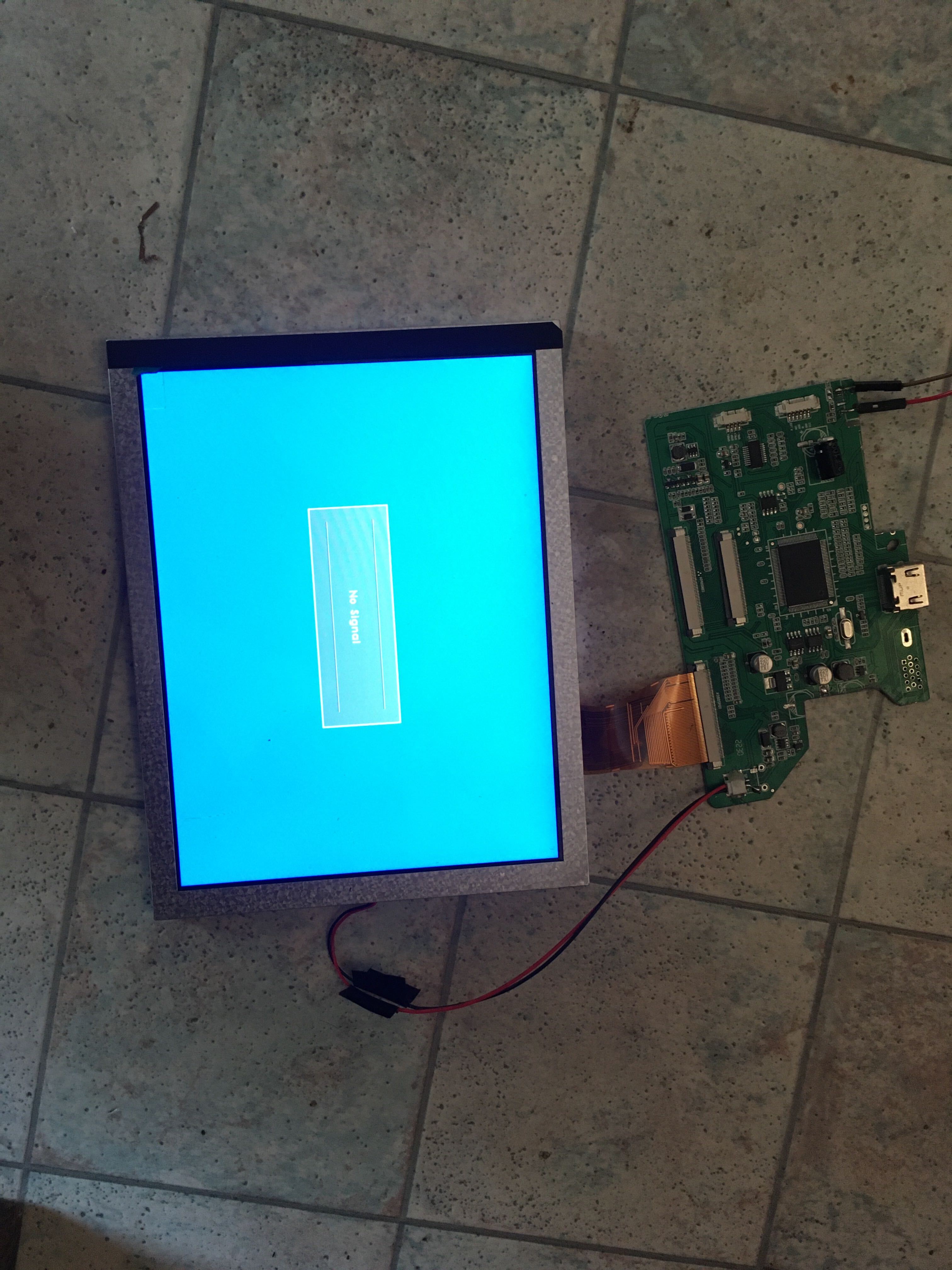

To kick off with: the screen. I can't remember how I came by this 7" 16:9 screen. I knew it was for something computer, for someone, years ago, and it did component. I sat down with it and did some dry tests to see what it's lowest voltage was and was pleased to find that it dropped out at 6v. Wiring it up it promptly didn't work, but would flash on and off intermittently. I checked the regs, and then the board serial and what would you know it was a L7009! Past me apparently only buys people the best for their projects!

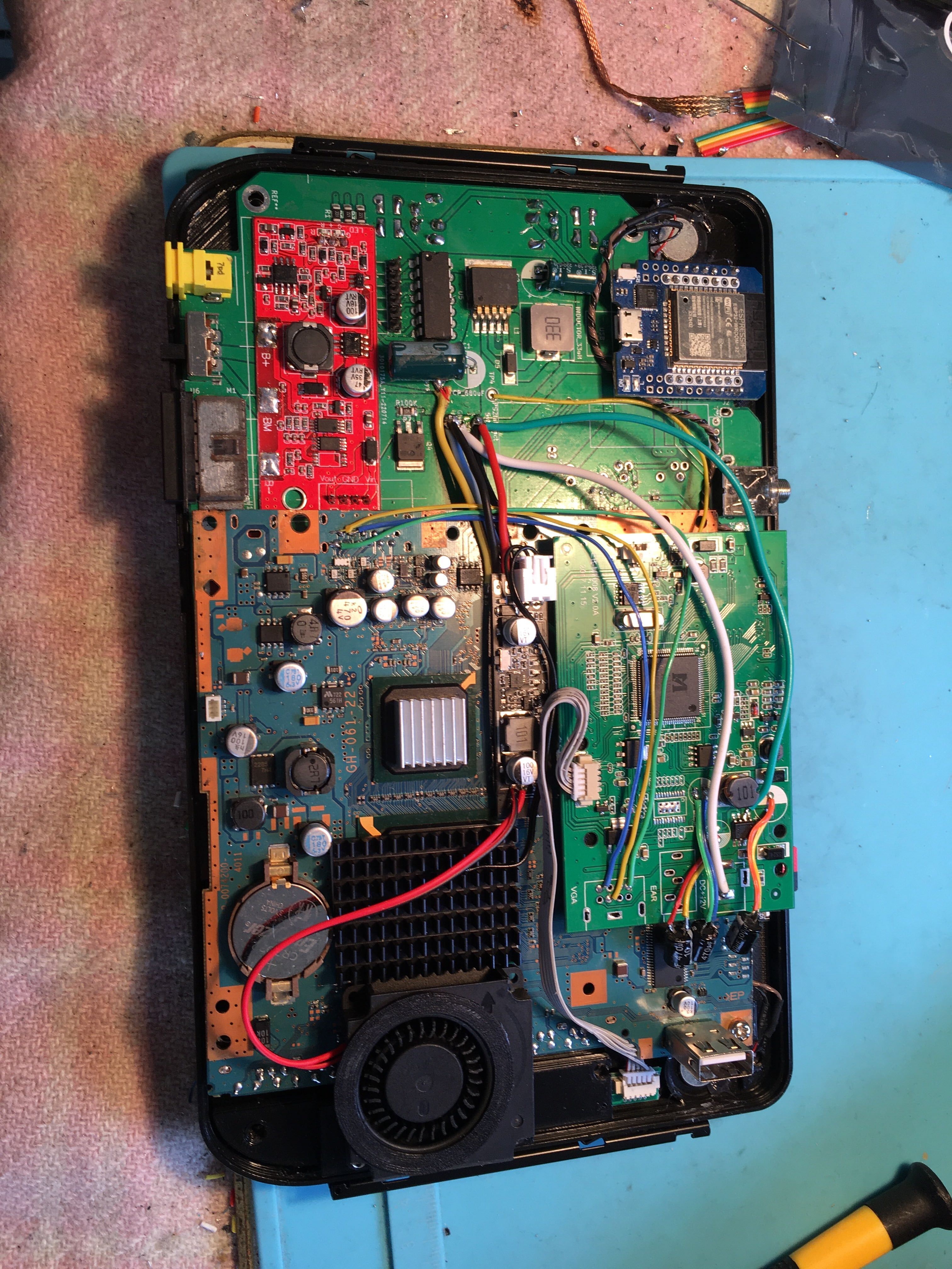

Semi-final internals assembly.
Would have been divinely thin had the screen board fit like this, but naturally it didn't and had to go up the other way.
Caps relocated, board wired up to the 5v line, screen humming along beautifully with a fantastic picture. Really thankful for everyone here who's done the yards to figure out how things worked because given how life is this almost made it into the fuckitbucket. With this orientation it might just end up taped down, and a little thicker.

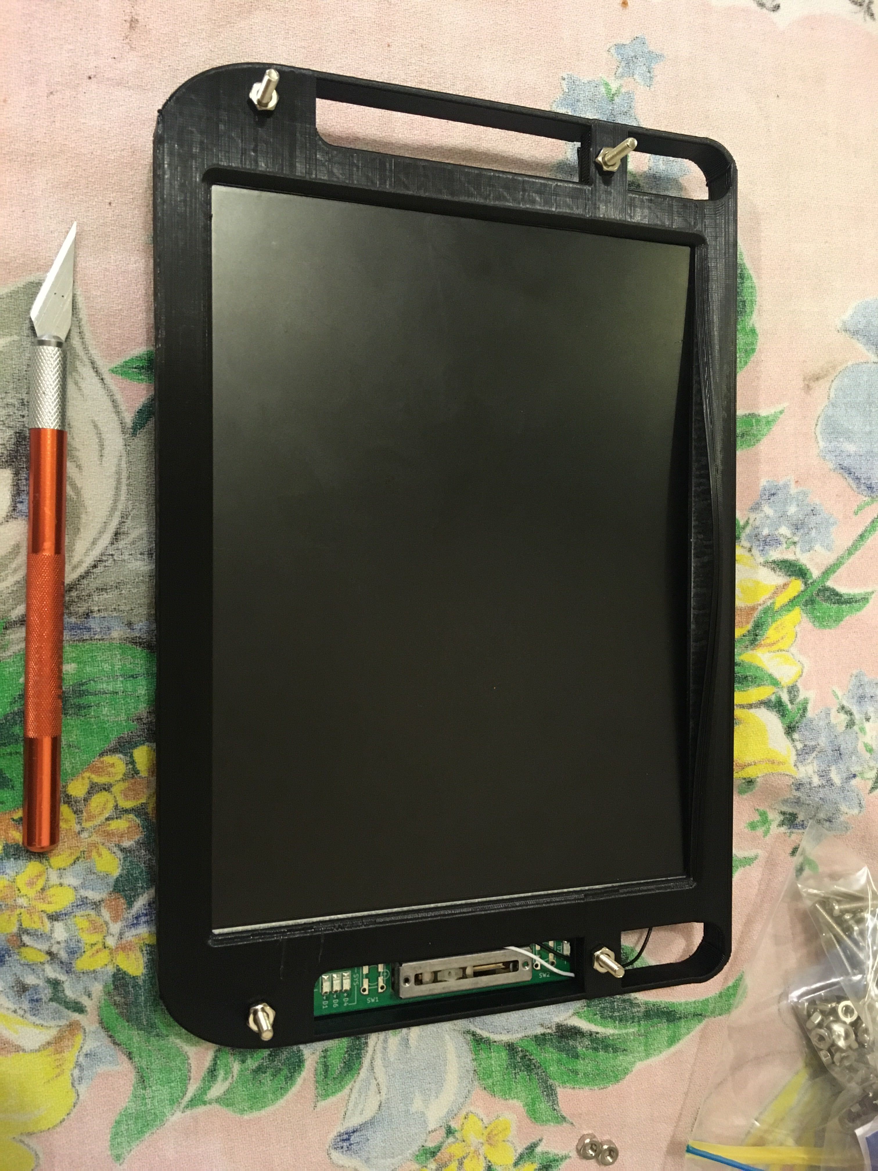

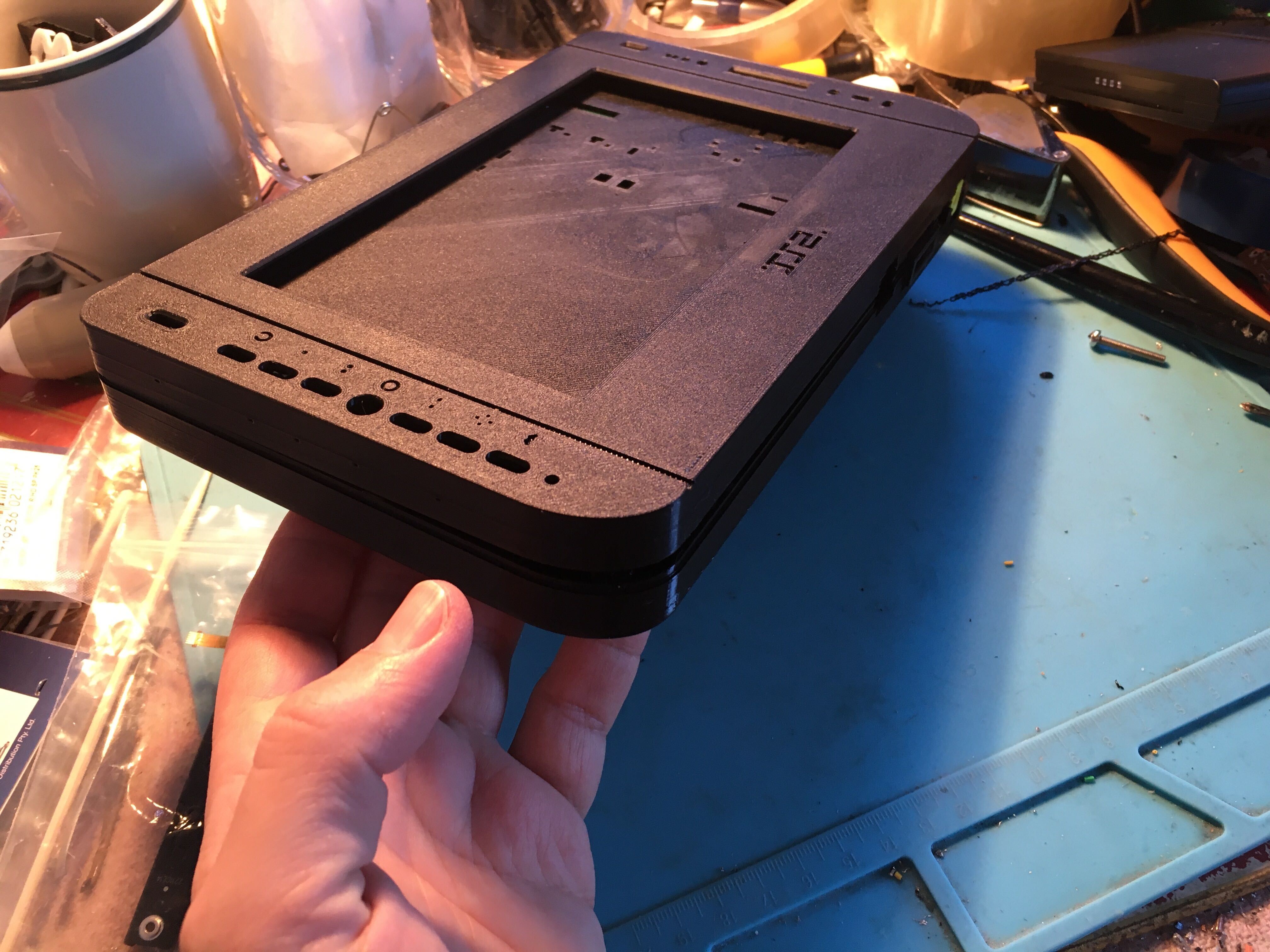

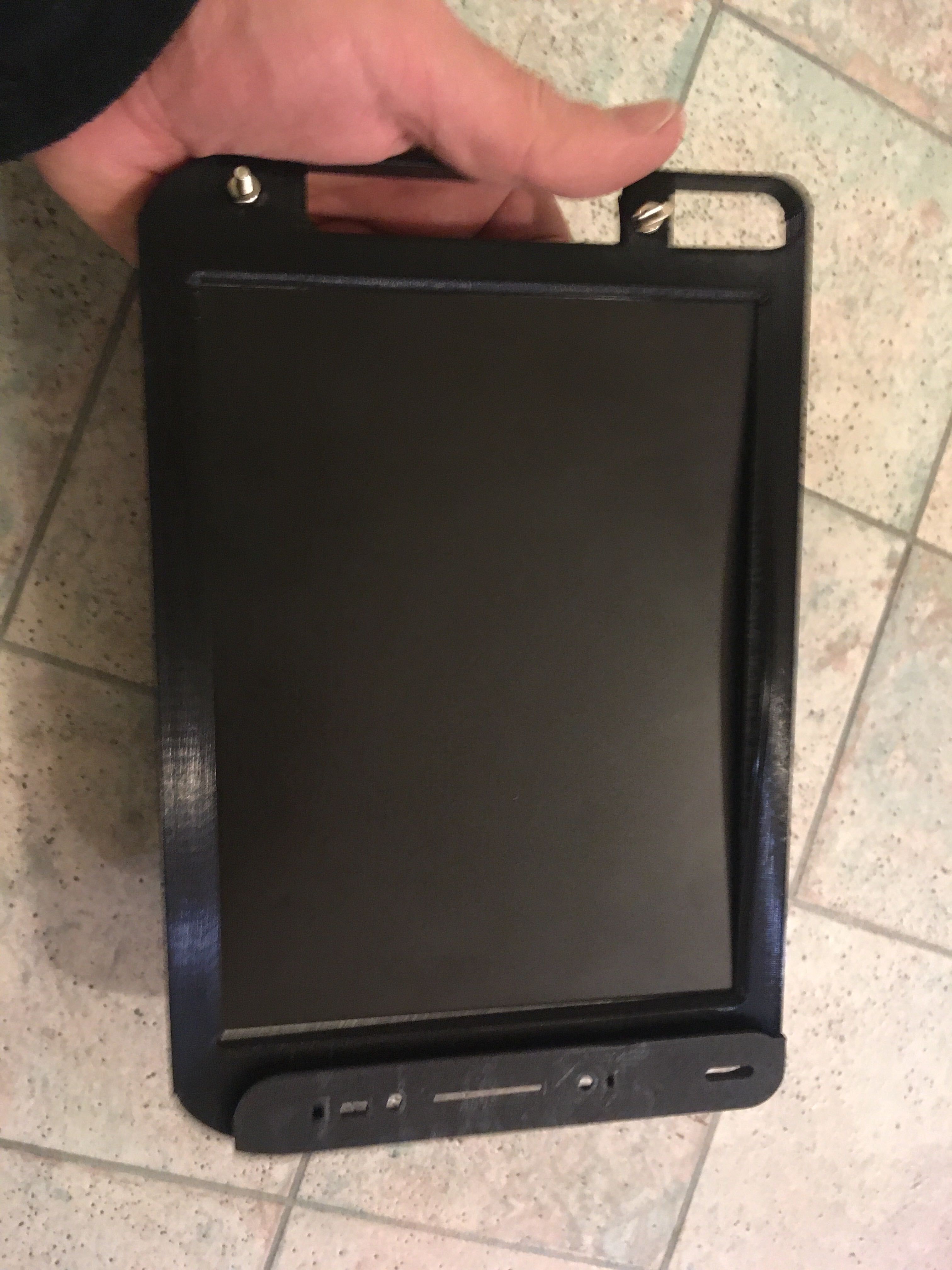

So about that case design...

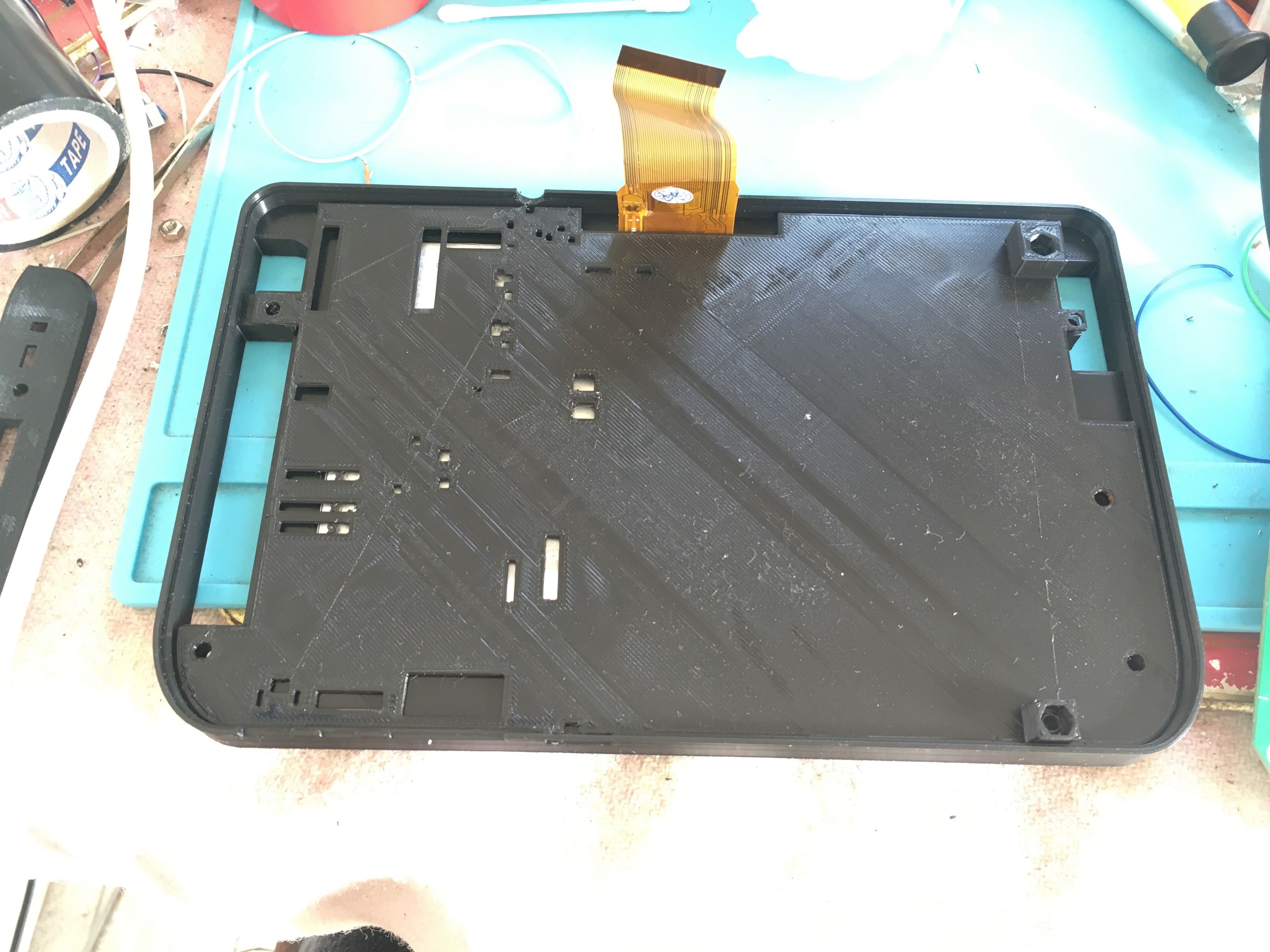

The case has been designed like a sandwich, mainly to make it easy as easy is the best I can do when it comes to fiddly things now.

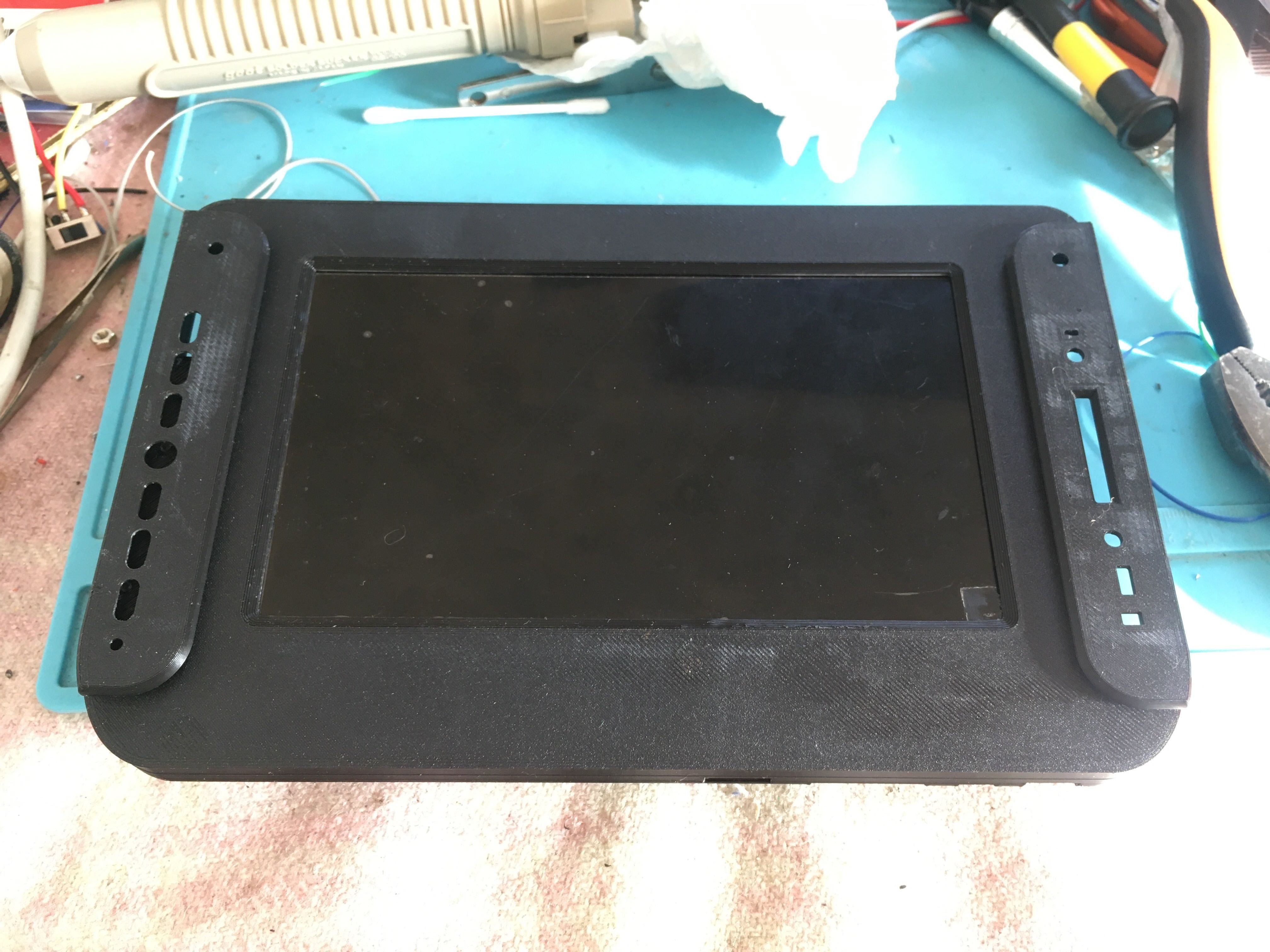

Screen in the top plate.
"Screen holder" over that (note the mounts to fix the PS2 board on the right there)
PS2 board fitted neatly in place.
And the front. I'm intending to cut a piece of acrylic that'll be held in place by the two "castle mounts" either side of the screen here:
And everything is run through with some 20 to 50mm M3 bolts, that attach to what I feel is my greatest achievement in this hobby: super-gluing nuts into my case designs so that nothing threads and it always has a tight grip!

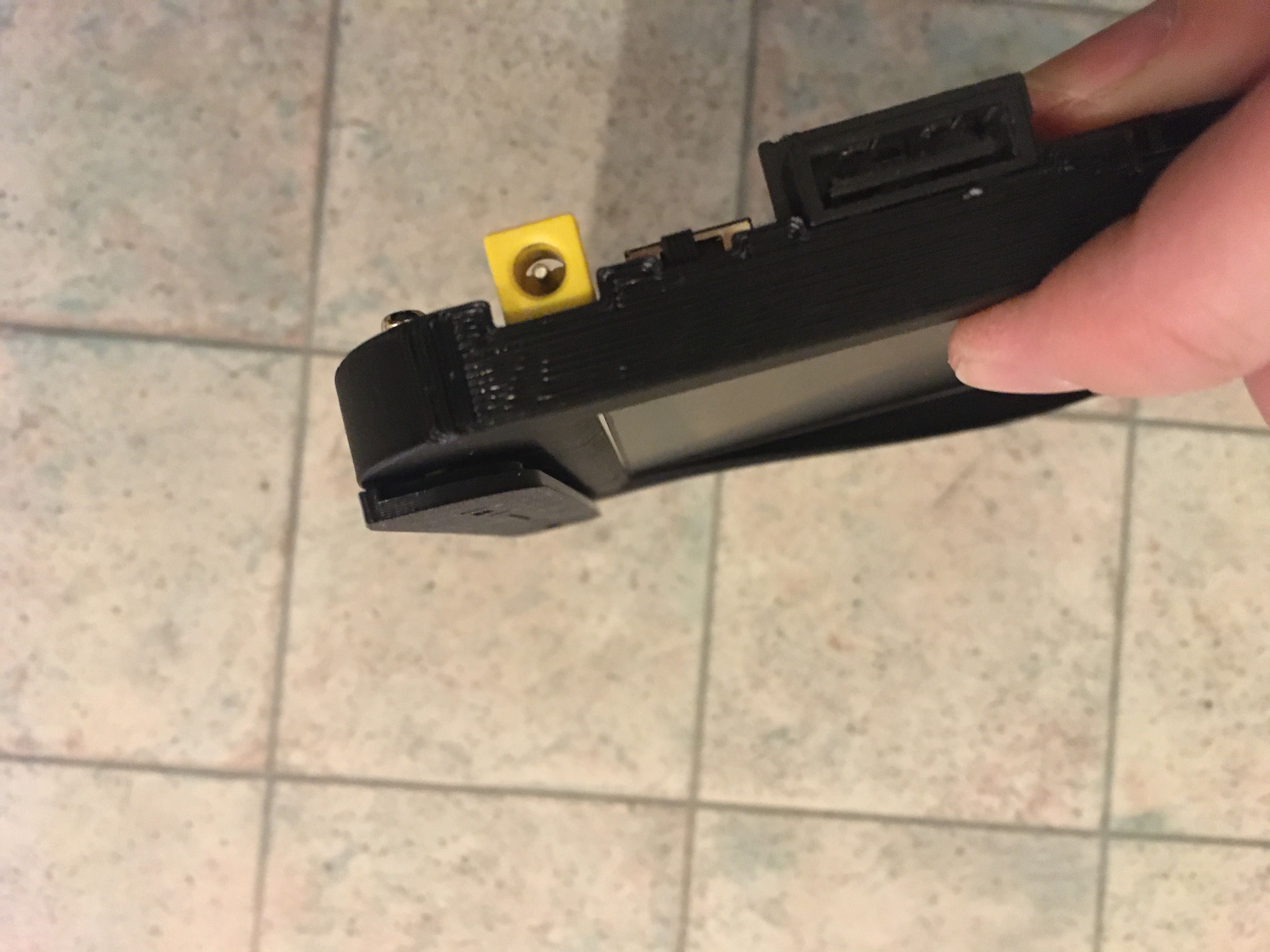

Well this was cool, but we all know that sometimes we just can't have awesome things. I got the acrylic milled today for the front screen, and underwent a horribly fiddly assembly process to do a test fit. Suffice to say: it looks really cool. Period.

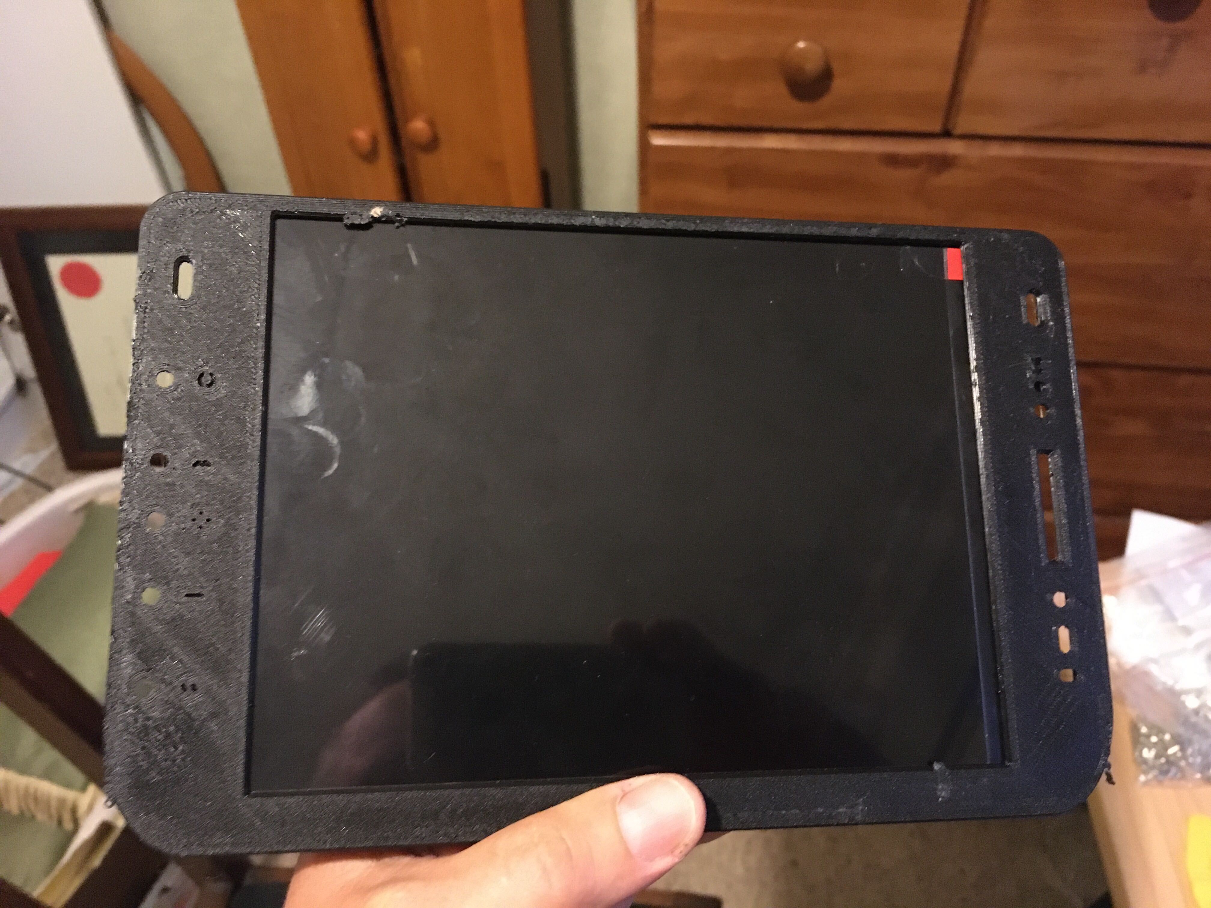

The acrylic frontage is held in place by the side "castles" and is cut with a recess around the lip to make sure everything is snug with the fit.
But here's the rub - the tallest tact switch I can get is 13mm which means that I'll not be able to make controls that can actually be used. Add to that that the whole assembly is held together with through-bolts, superglue, and wishful thinking. It felt surprisingly solid albeit being finger tight.

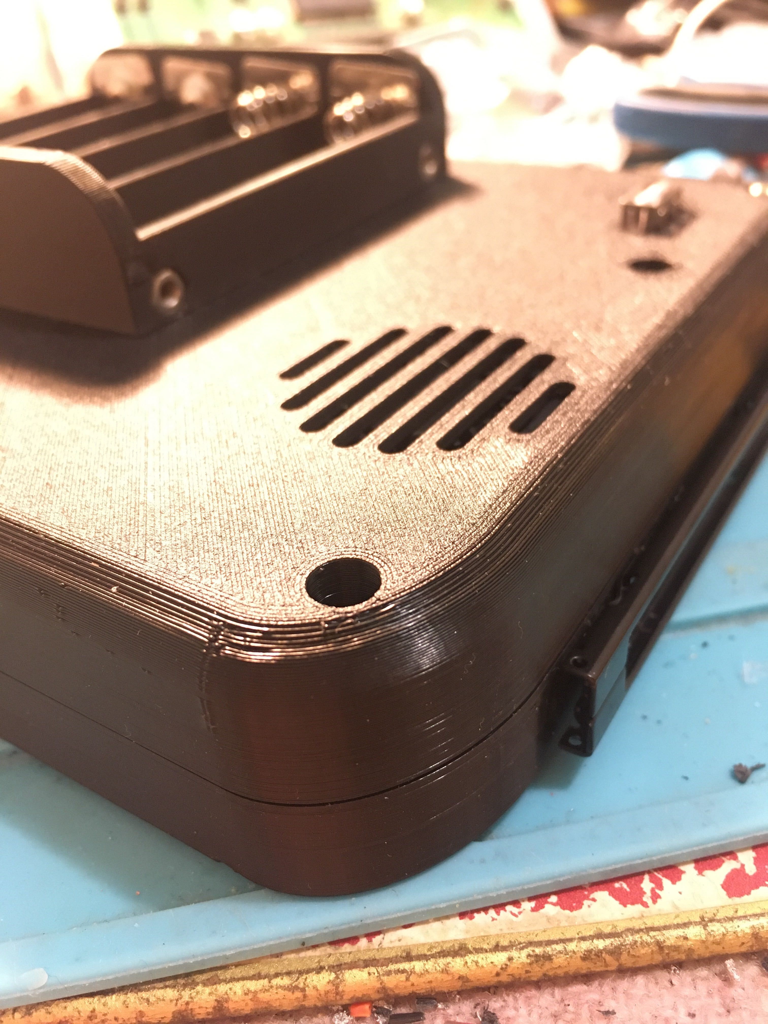

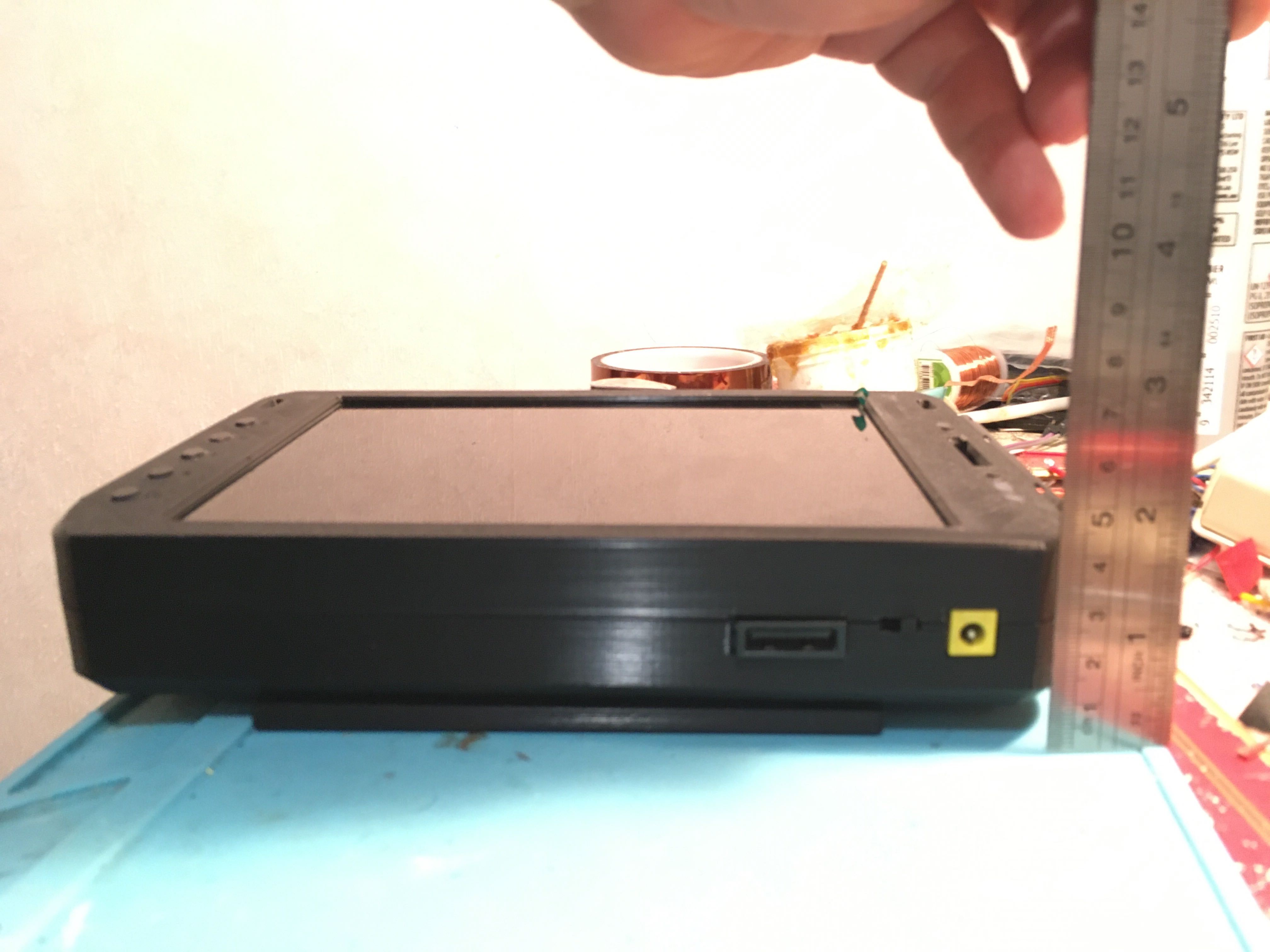

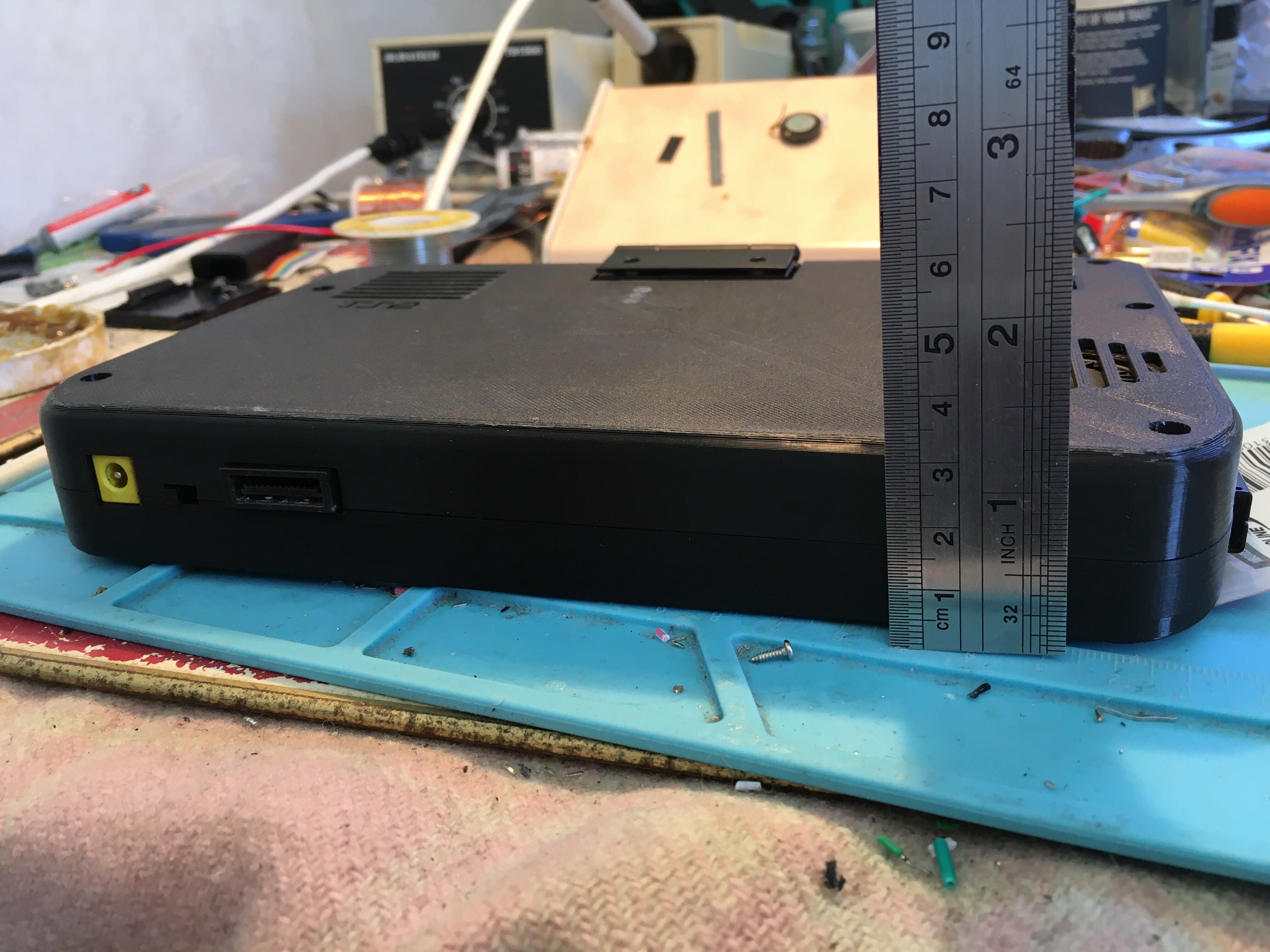

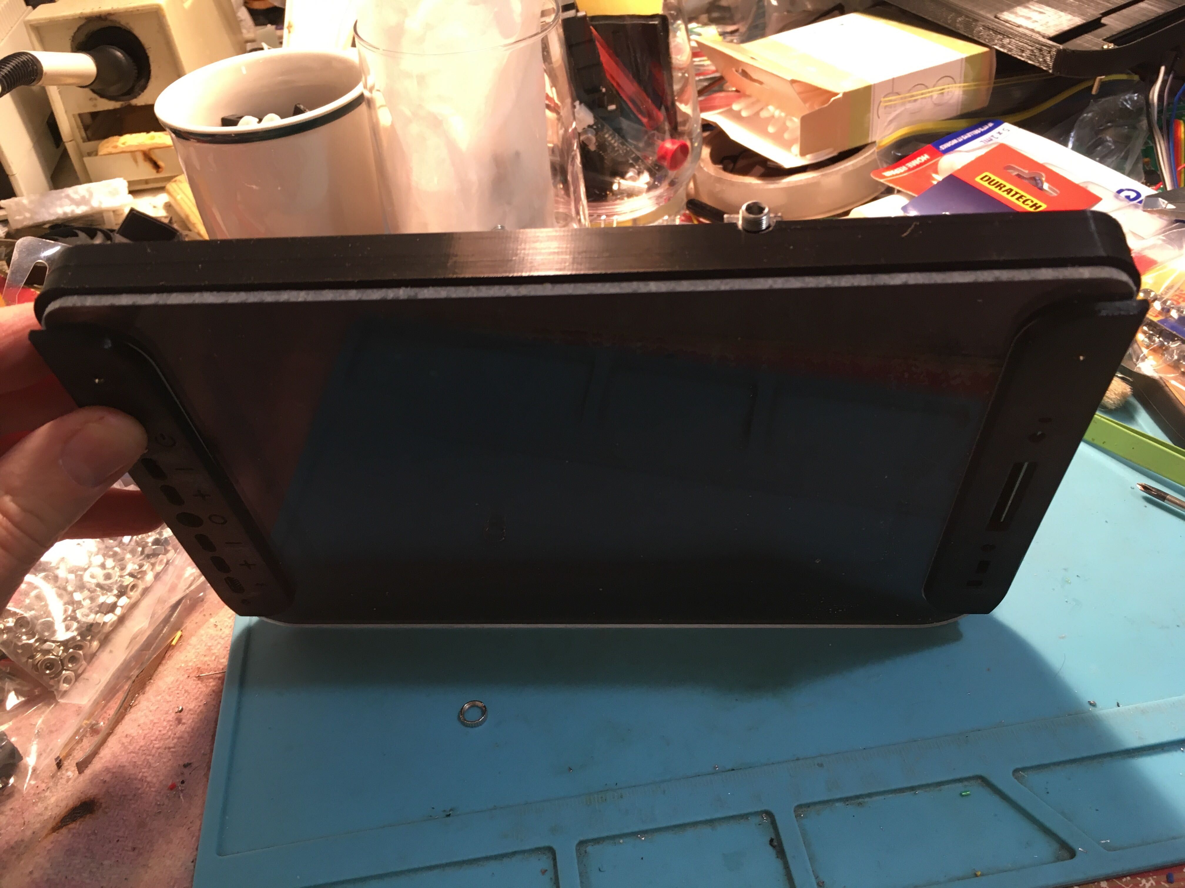

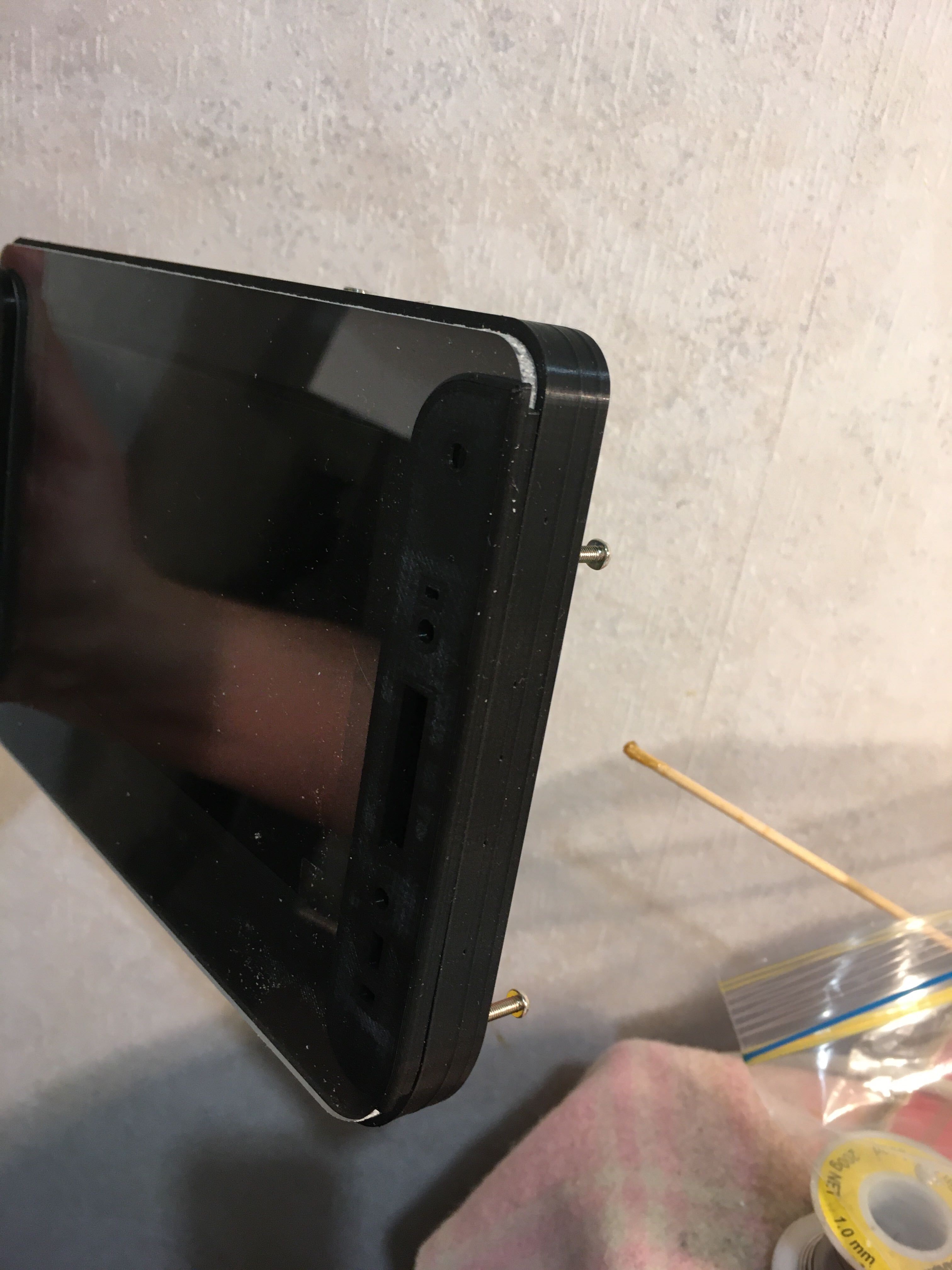

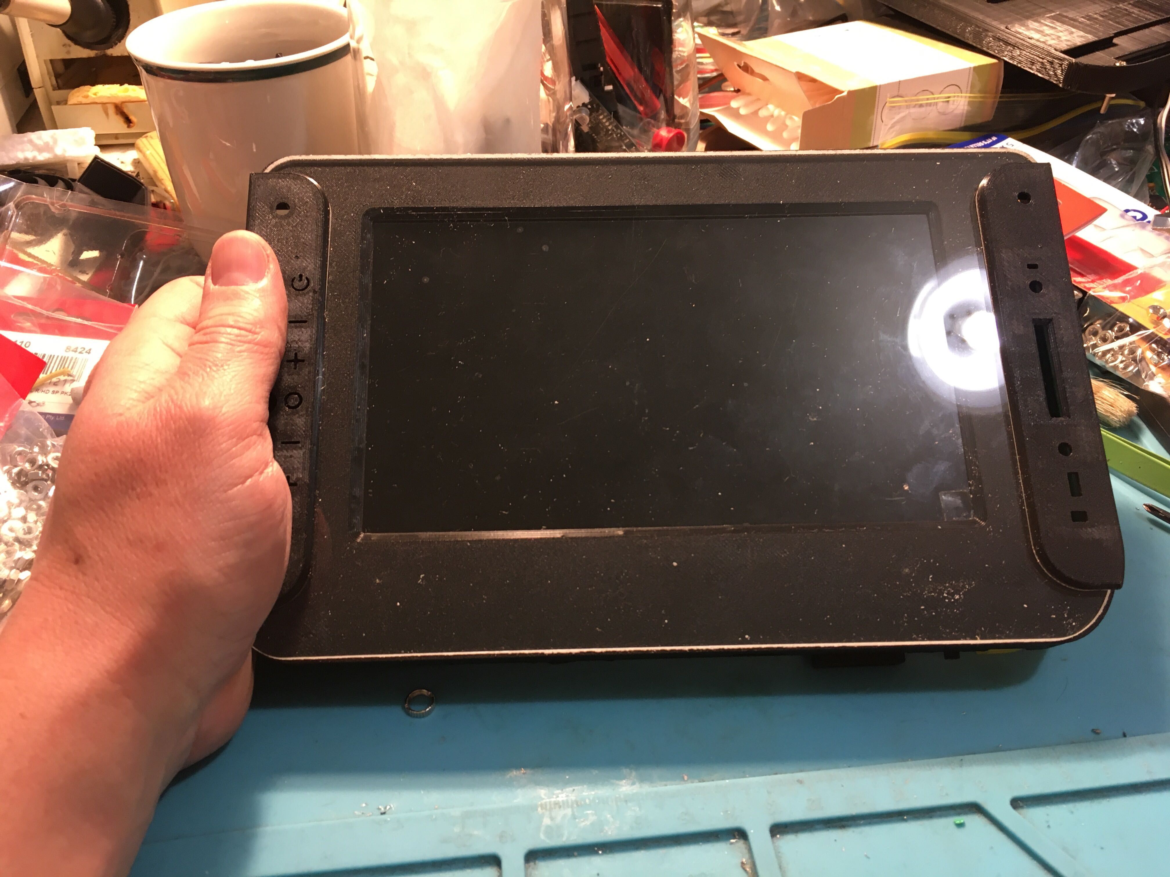

I took to my case design like a loose propeller and really drilled it down to "just another box" with little regard to assembly or how things went together. My theory here is that the first revision is never going to be perfect so I may as well start making failures to step off of. I was surprised when it didn't turn out as thick as I was expecting, being only 28mm from top to bottom. Of course that's without the batteries, which will be mounted in a holder on the back. I happen to have this battery case lying around that just might get glued onto it with a fancy aesthetic cover.

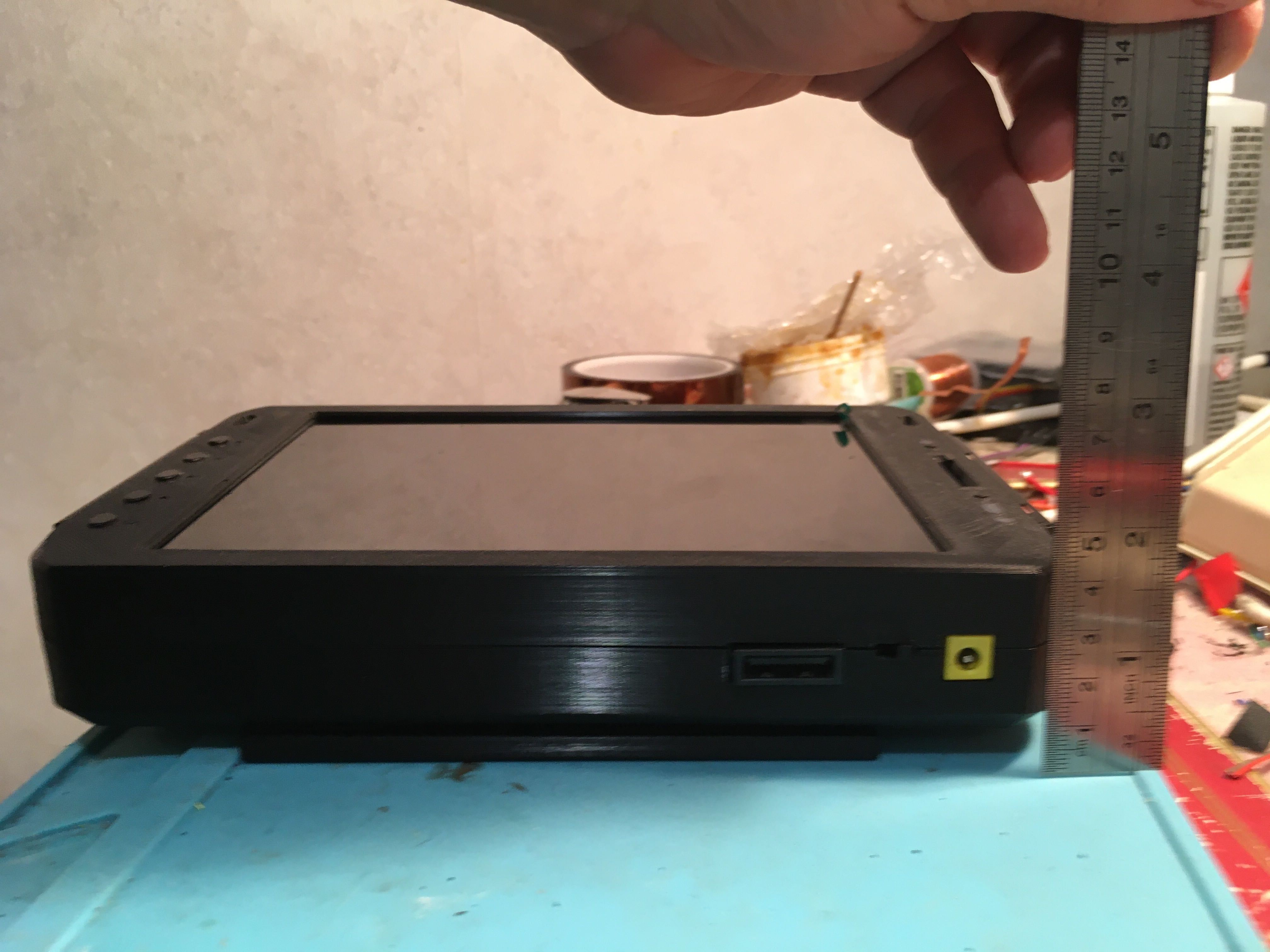

So the benefit of dropping the acrylic screen is that it's trimmed over 4mm off of the overall thickness, and now the tact buttons for the controls will fit. At this stage I'm more interested in getting it working than getting it pretty.
I'm also ever wary of ventilation, which I'm sure will mean I make another case back as what I've got at present probably doesn't have sufficient airflow. I was reminded of this a few days ago when our FireStick decided to overheat. Now I see where the name came from...

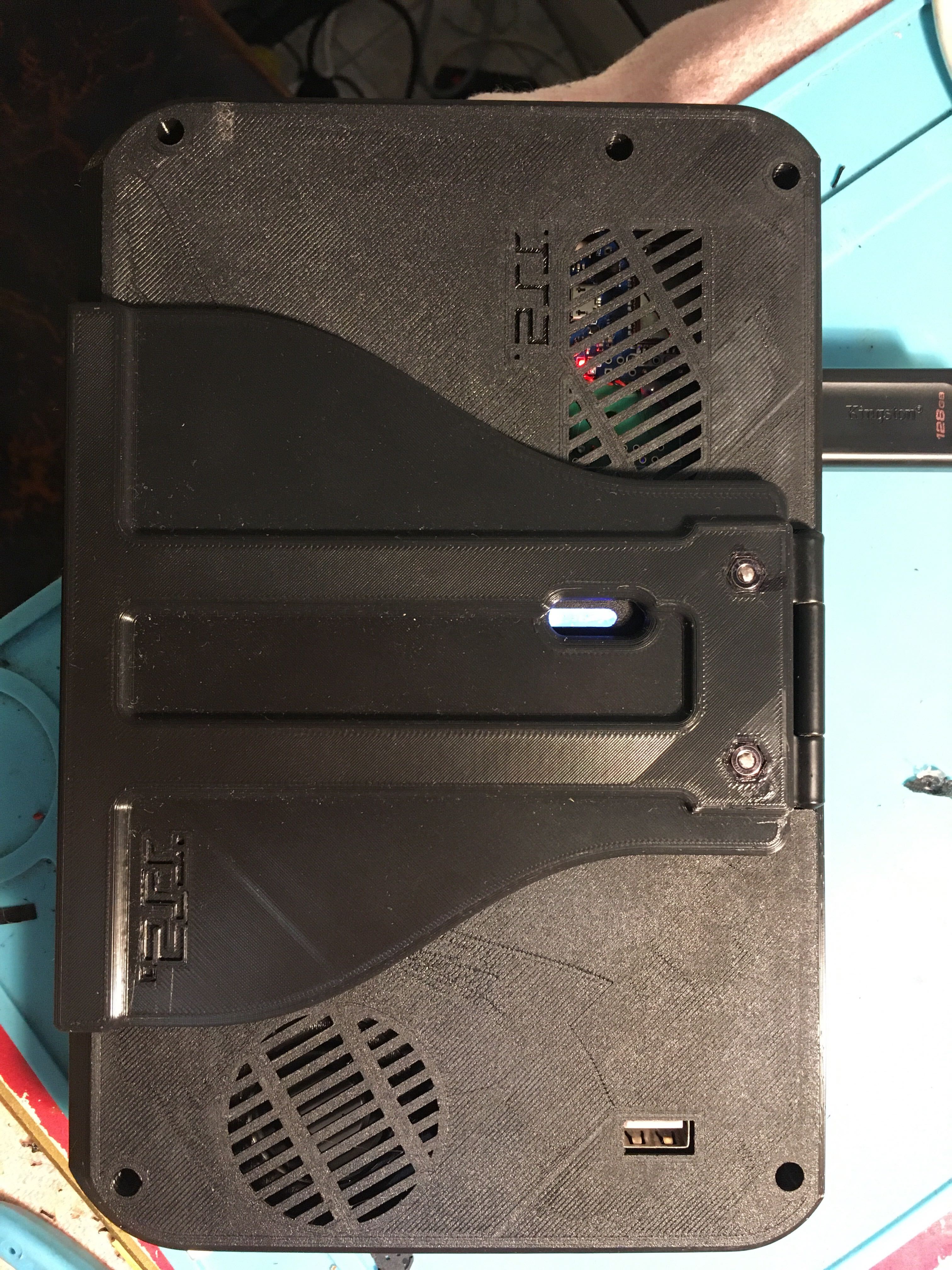

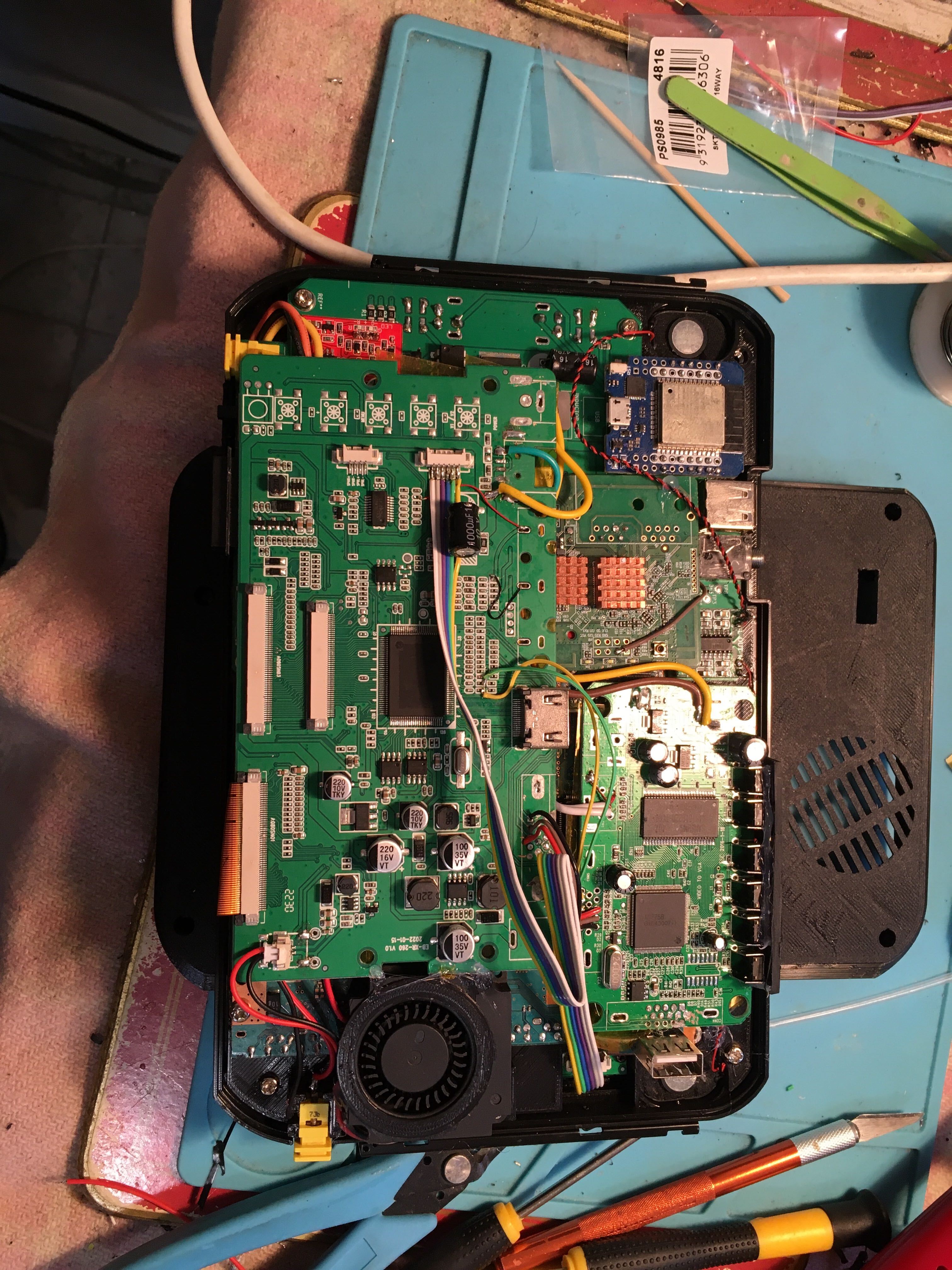

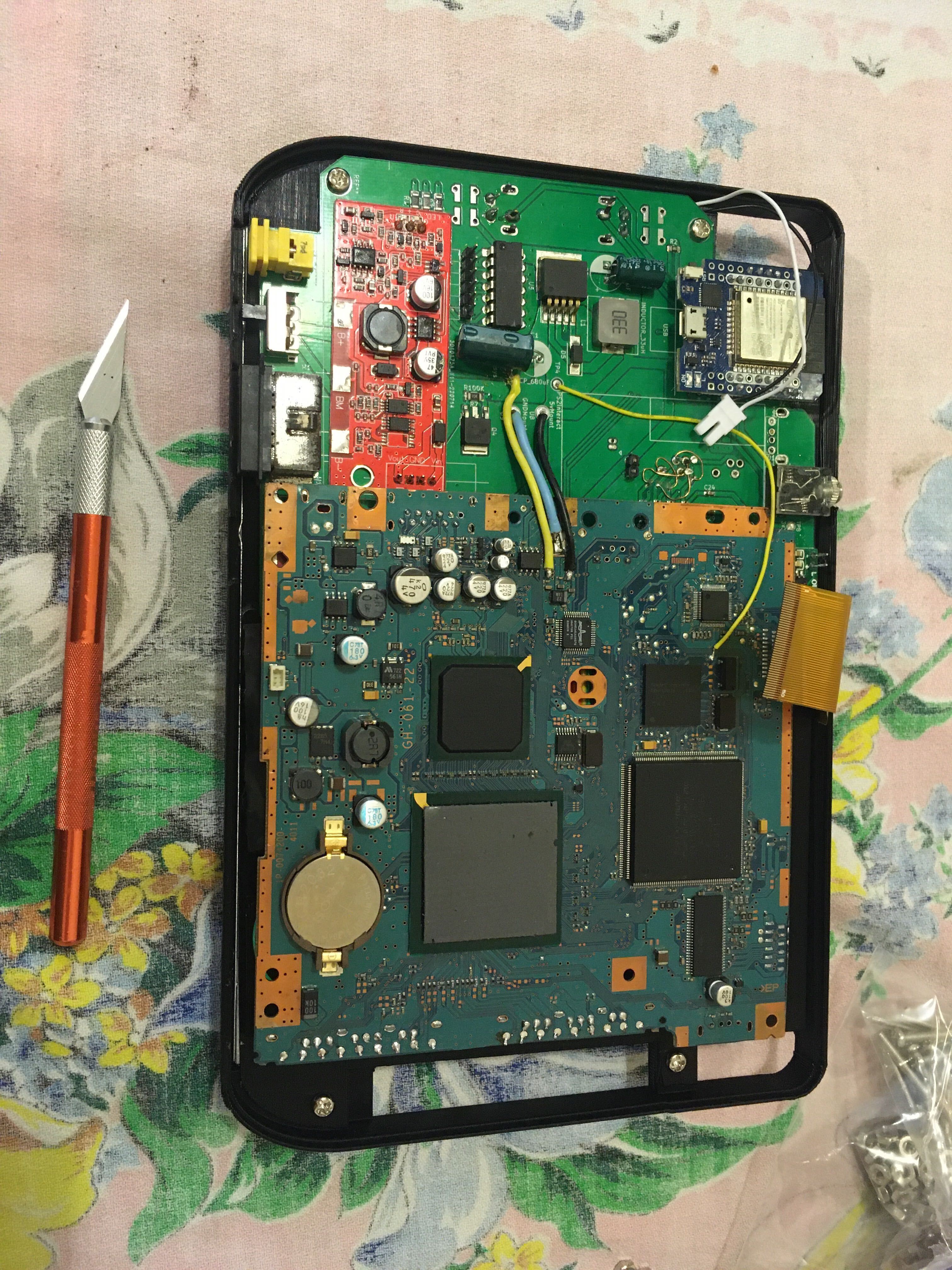

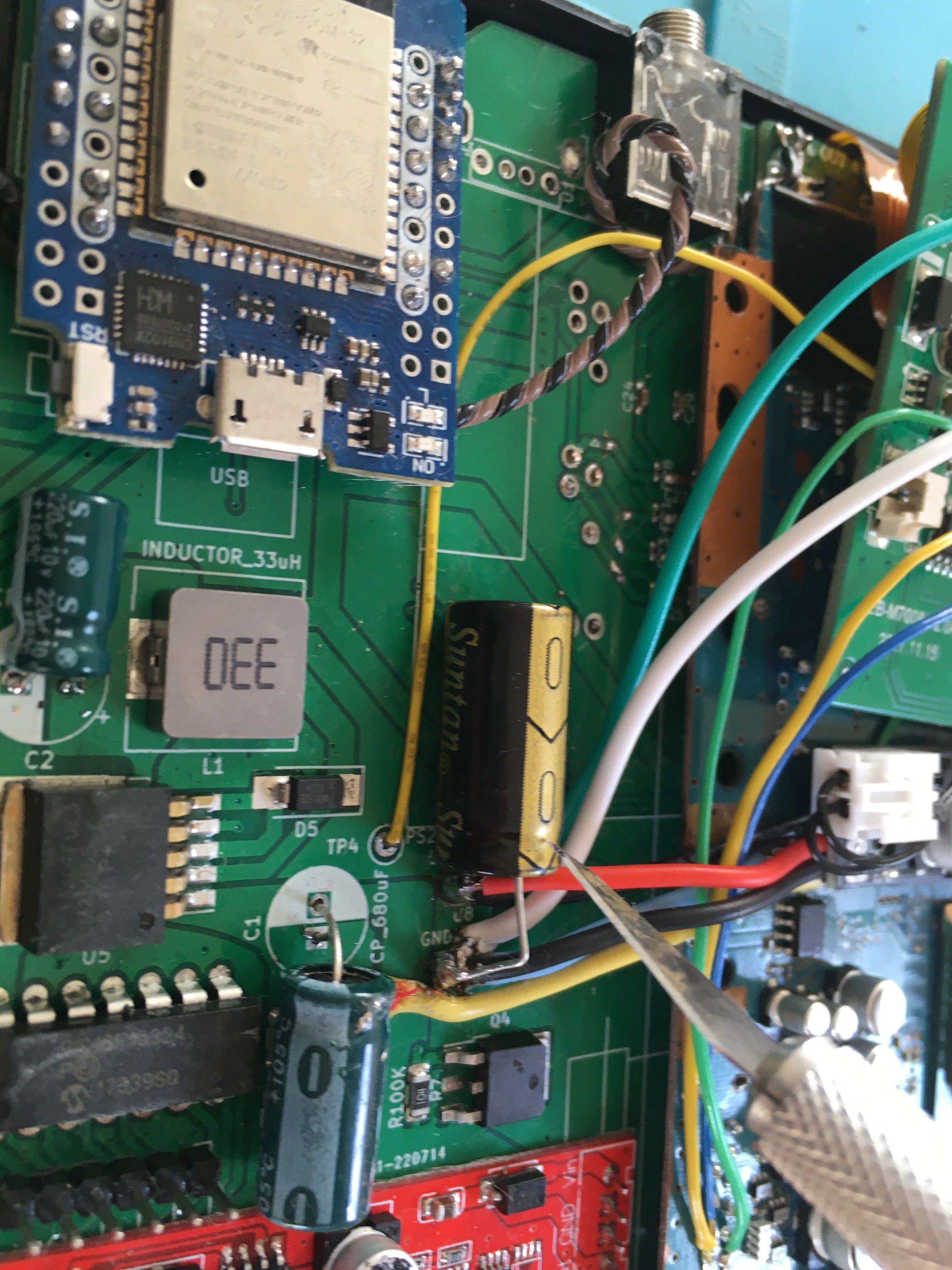

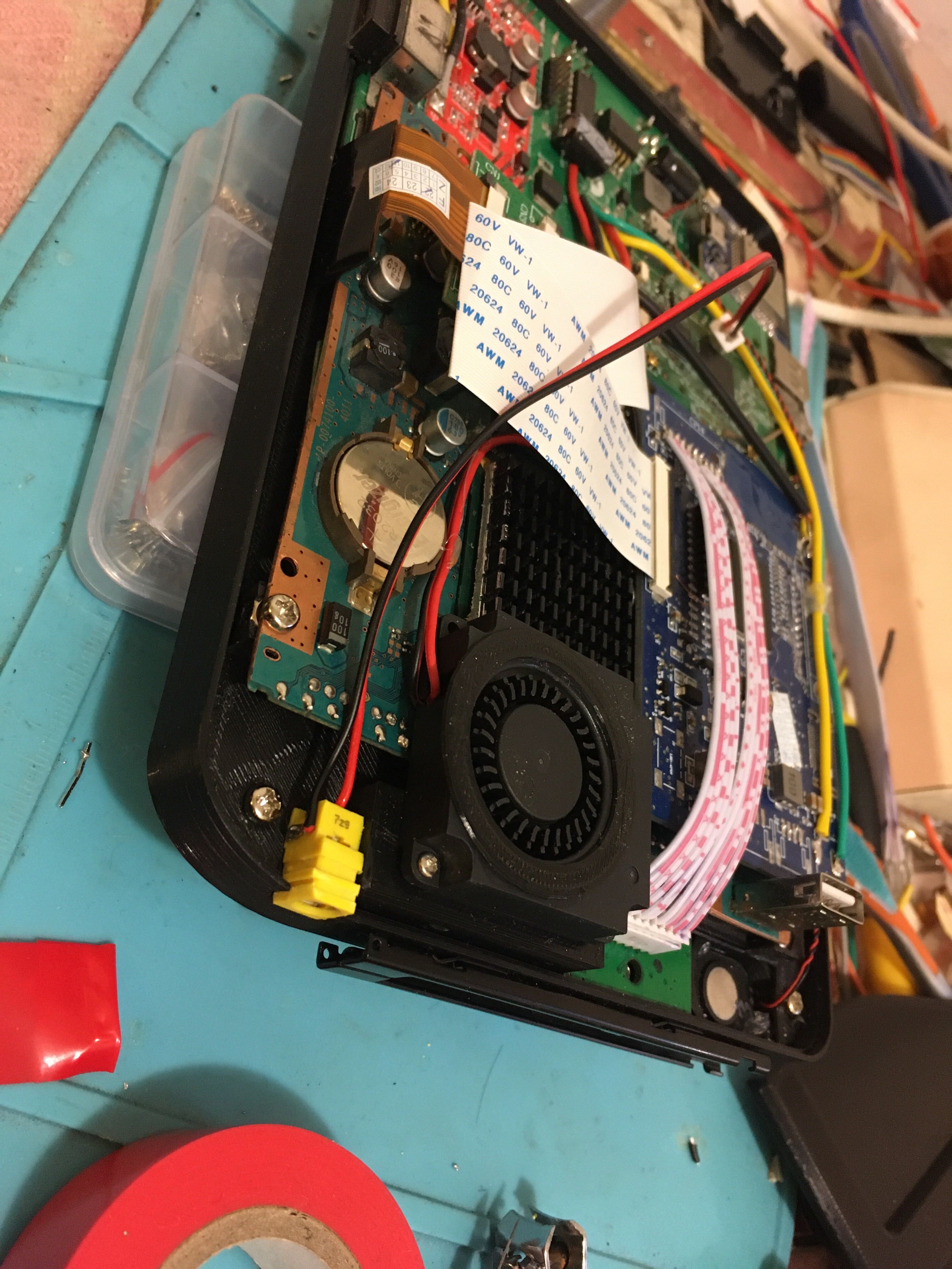

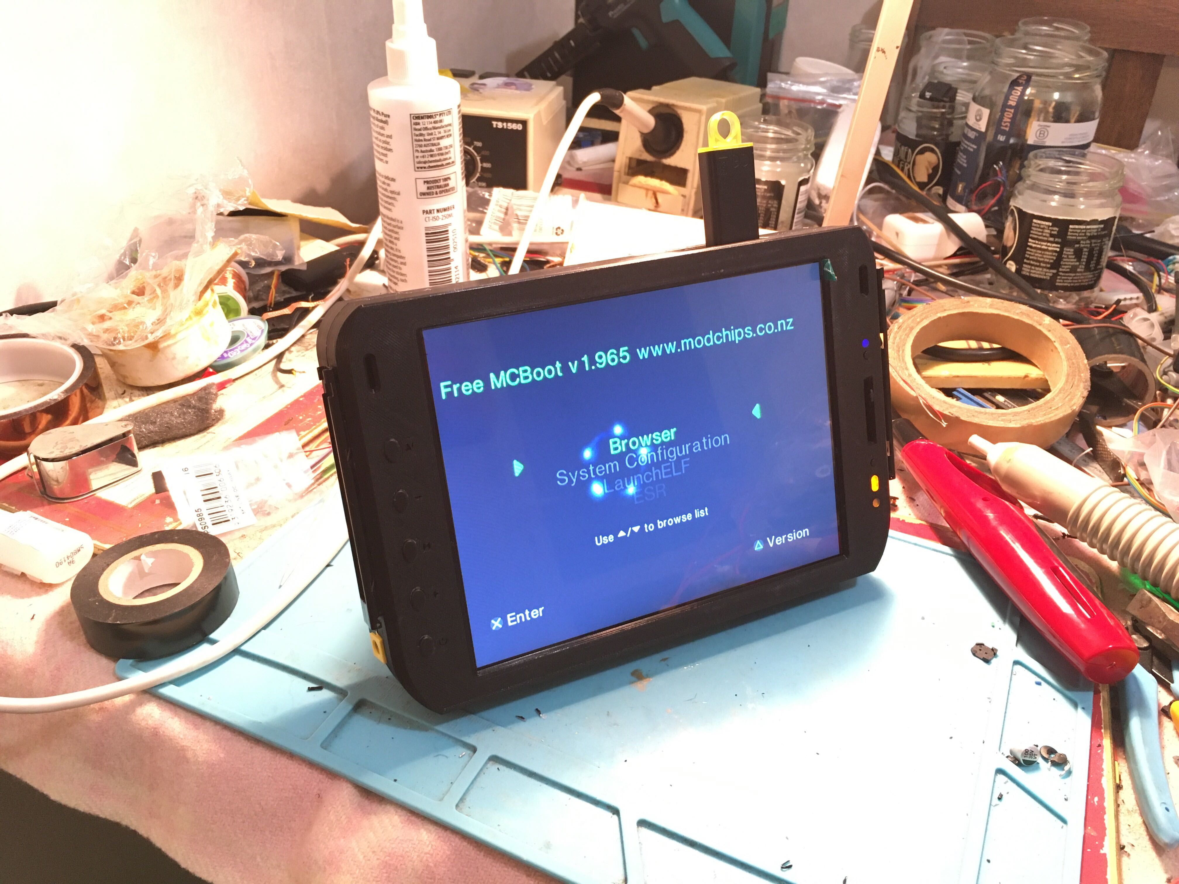

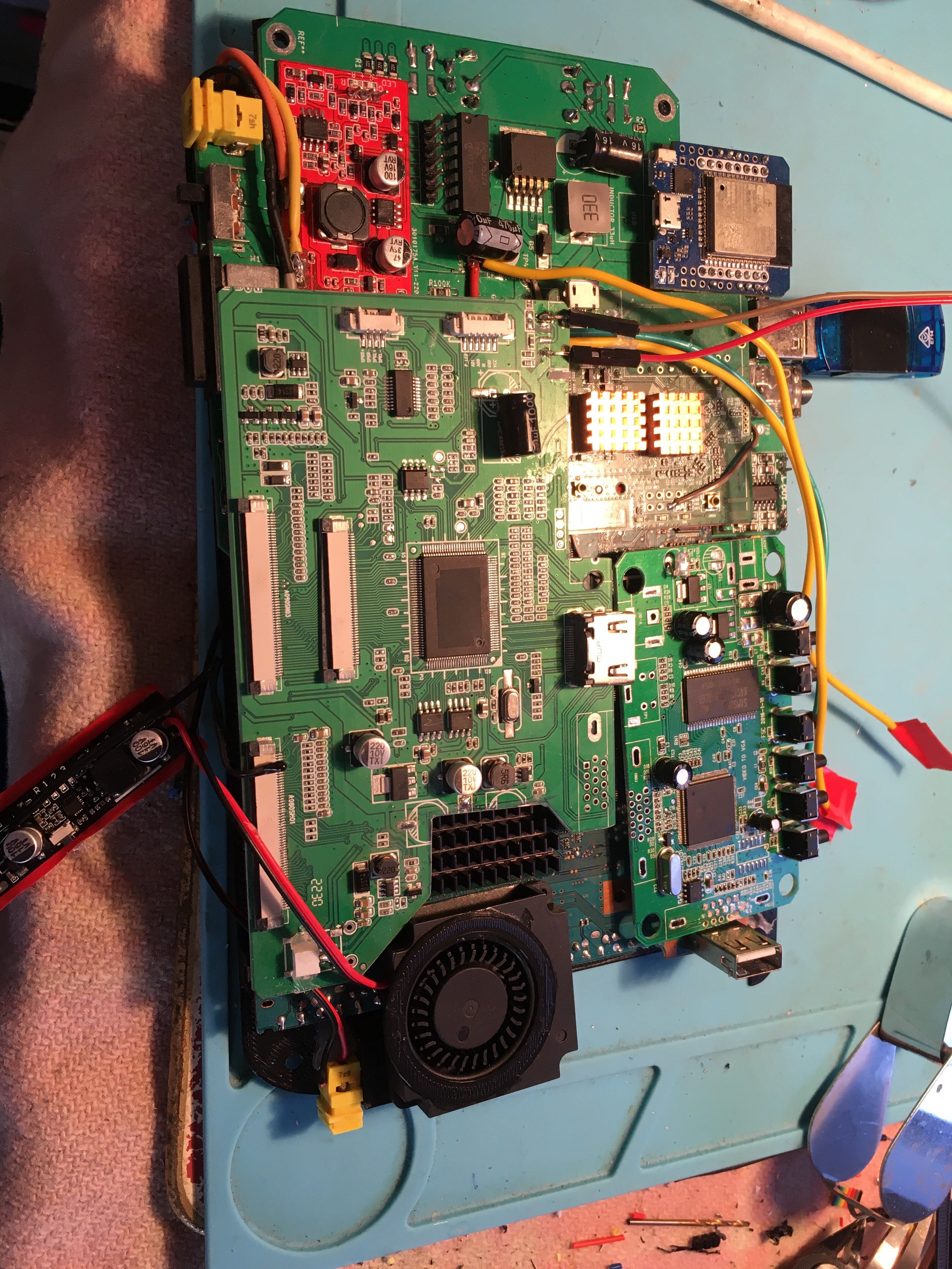

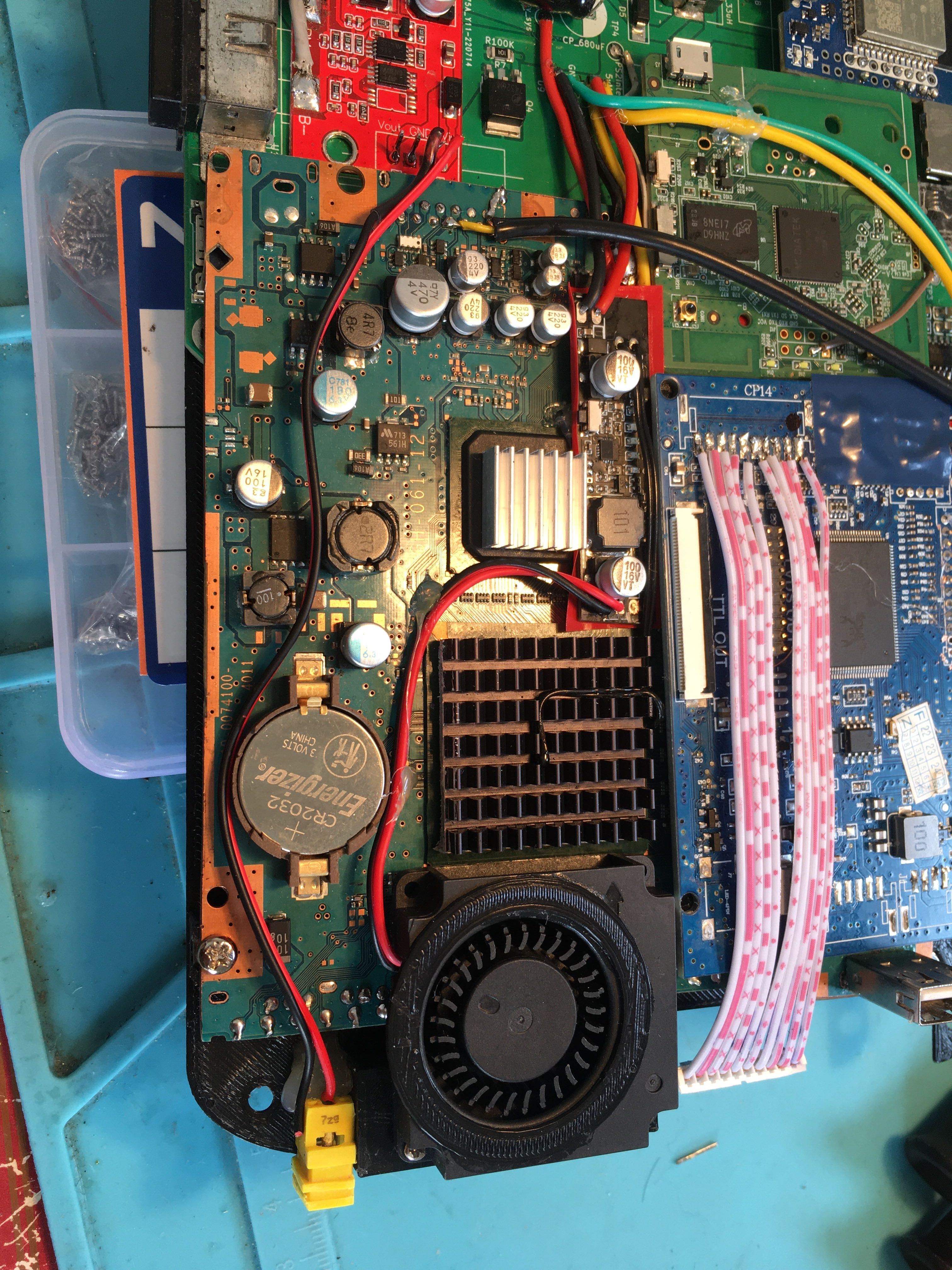

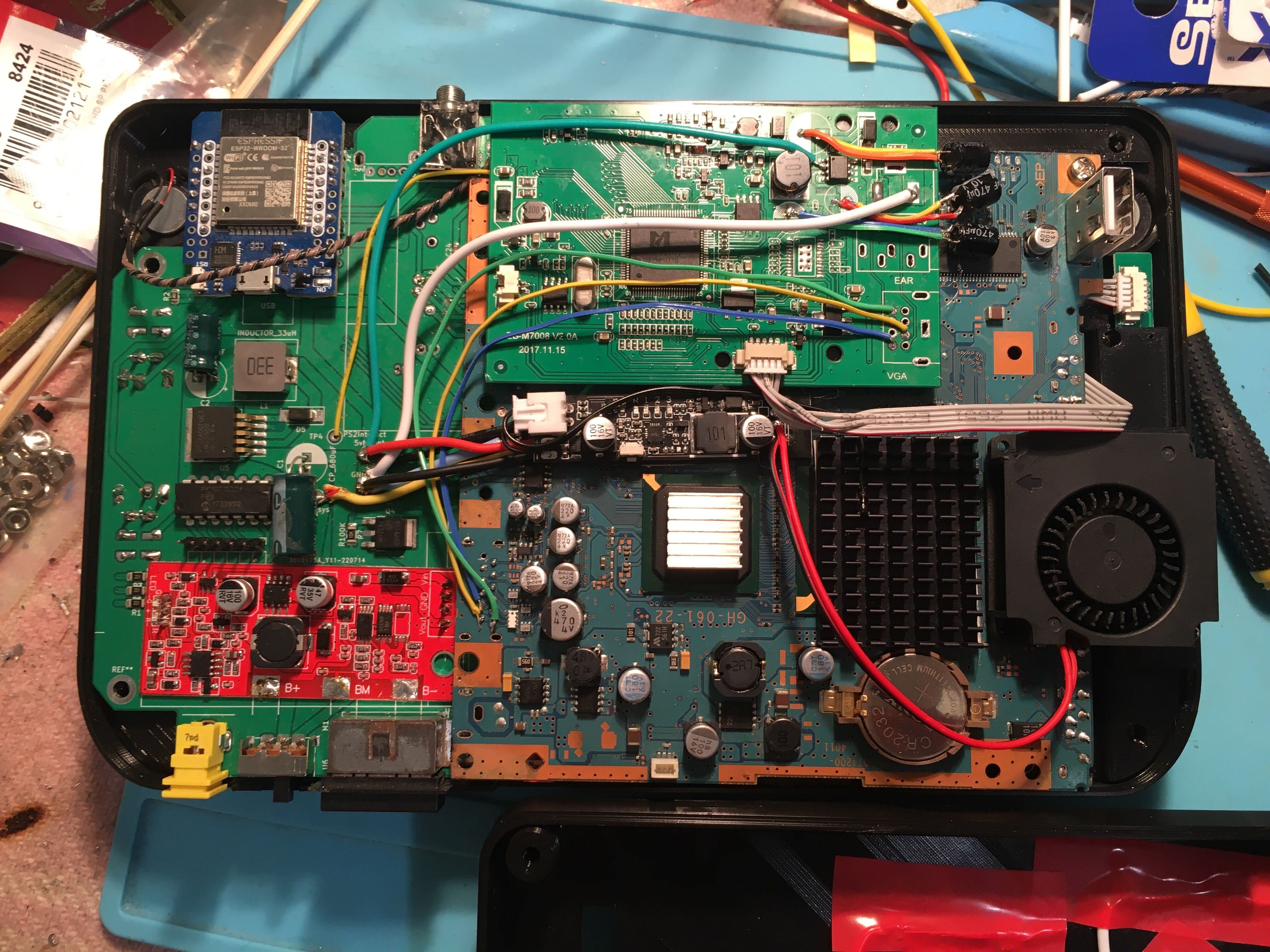

It's done. This was quite a task to get everything in order. I guess I'd better start with the internals.

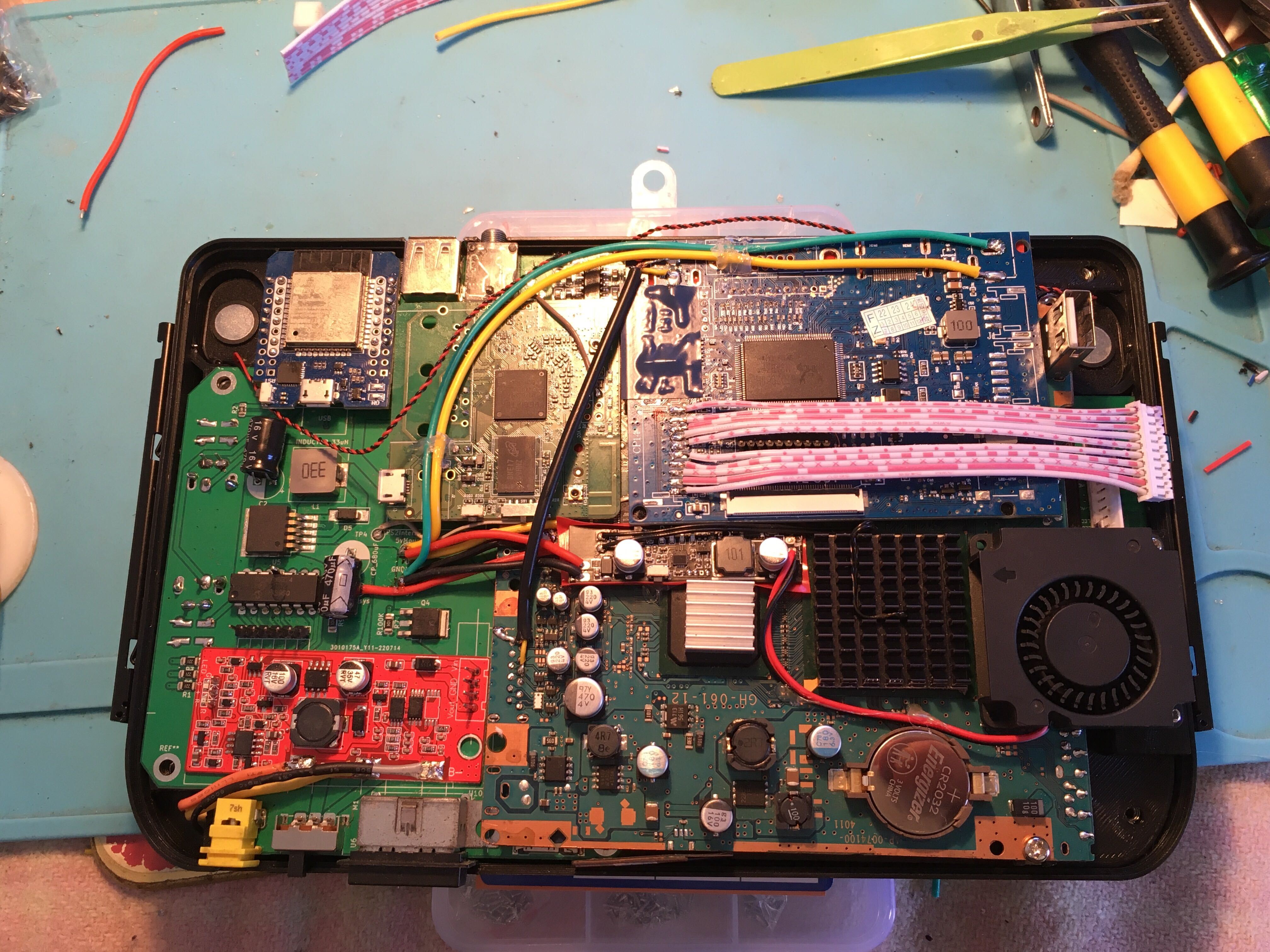

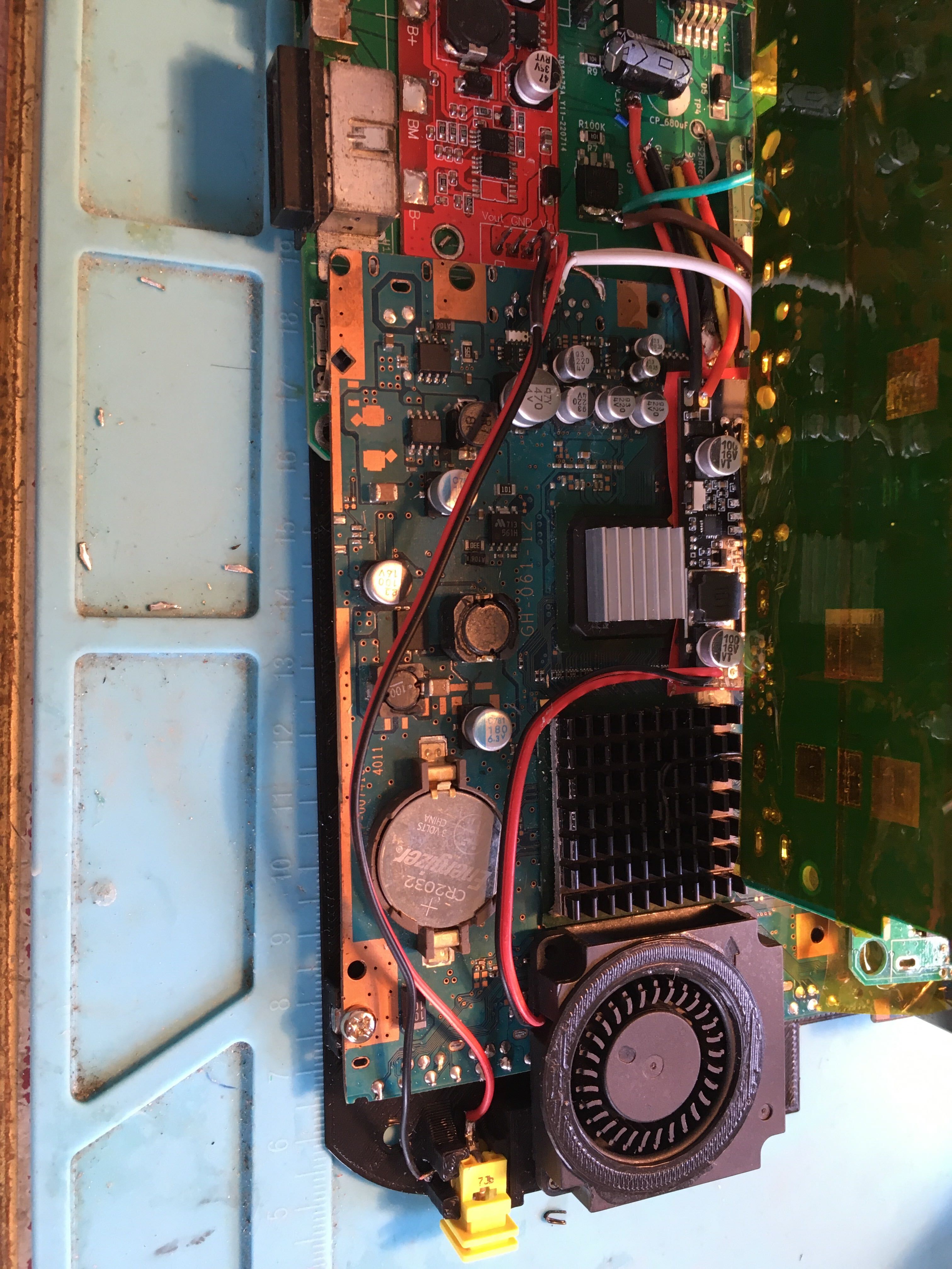

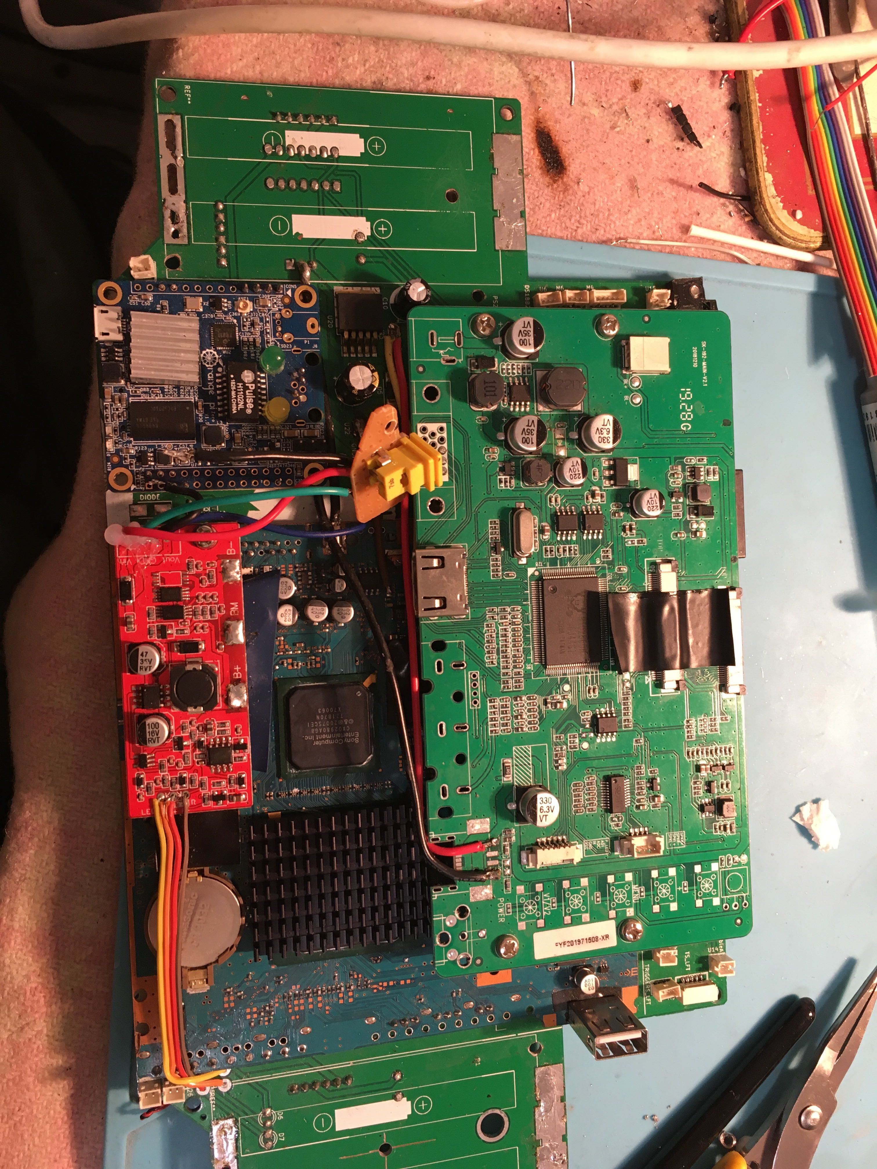

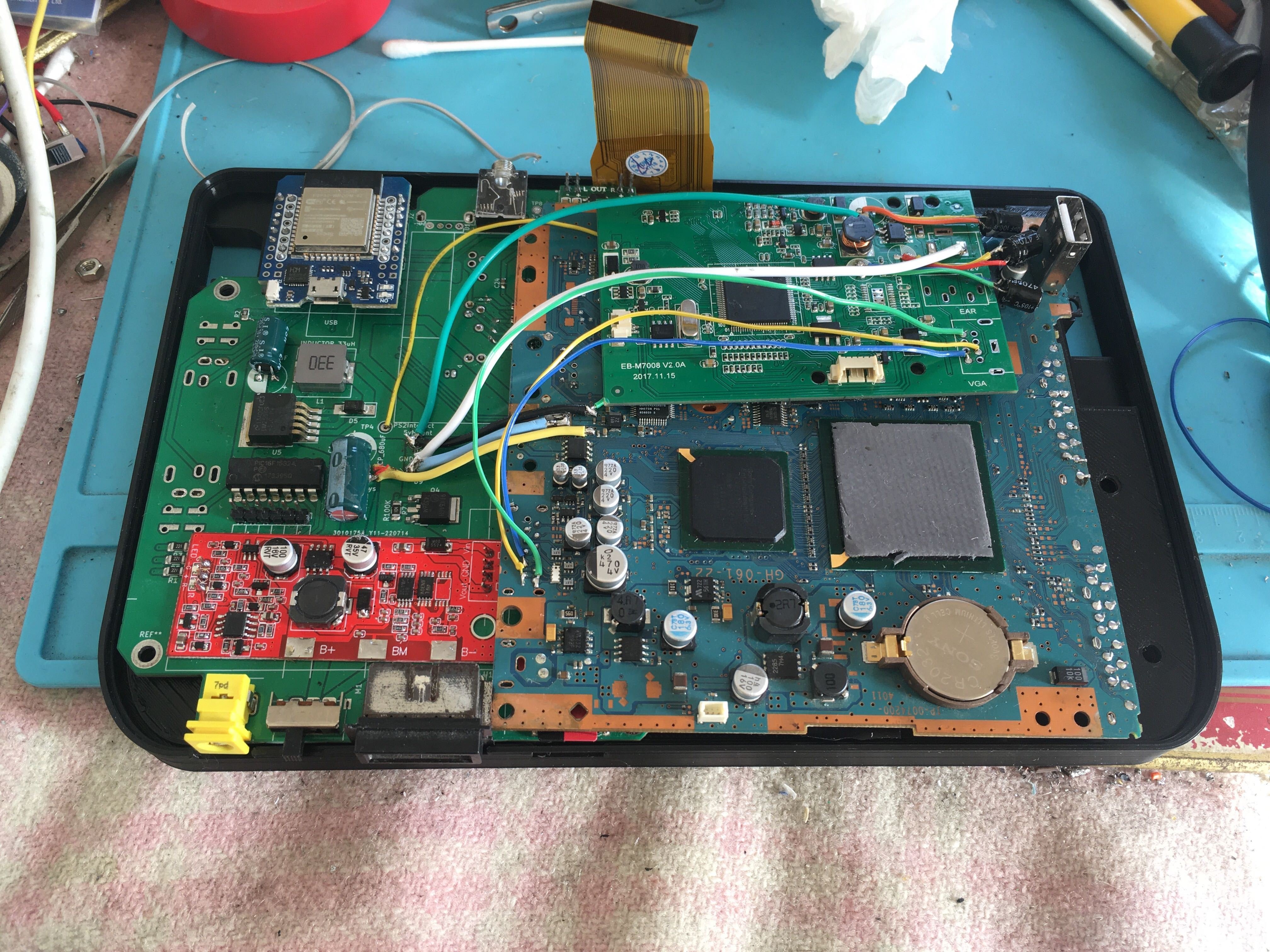

So wrapping up the internals for the Junkstation was supposed to be a straightforward operation: add the extra bits in, put things in place, walk away laughing. Oddly enough the audio started giving me issues so I put everything down and came back to find that there were no issues. Weird.
A final shot of the internals before putting the housing down, which naturally didn't go as well as I'd hoped. See I left about 1mm worth of play in the case and promptly found that it didn't fit! Put it down, had a break. The problem there was solved by actually pressing my snap edging closed all the way around, and then magically it fit.

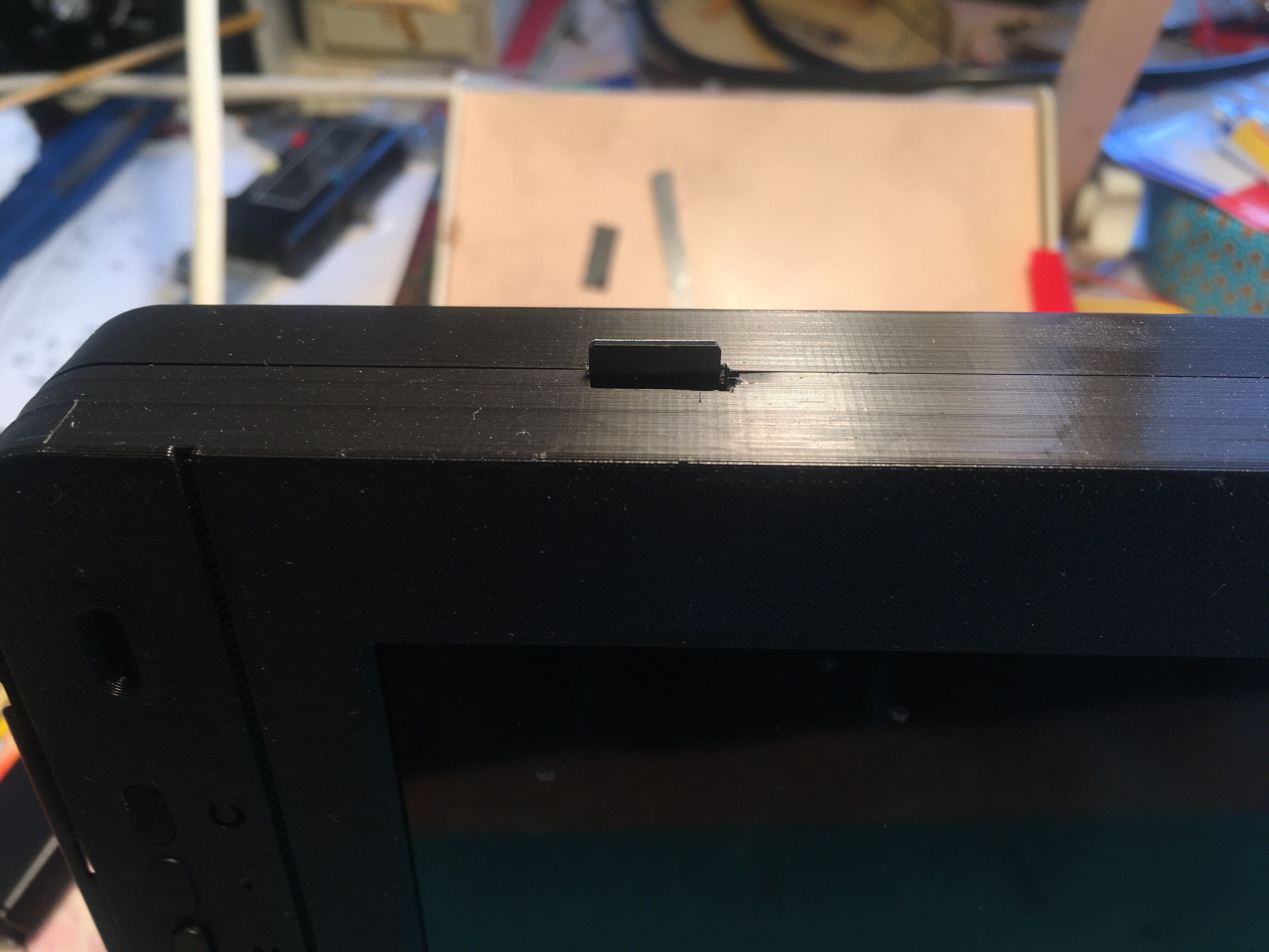

One thing that I feel I'll really appreciate is the PWM controlled fan which will hopefully only make noise when it's necessary. Because of how the screen was arranged getting the 7" L7009 to fit correctly was a bit niggly, and you bet it ended up hot glued in place.

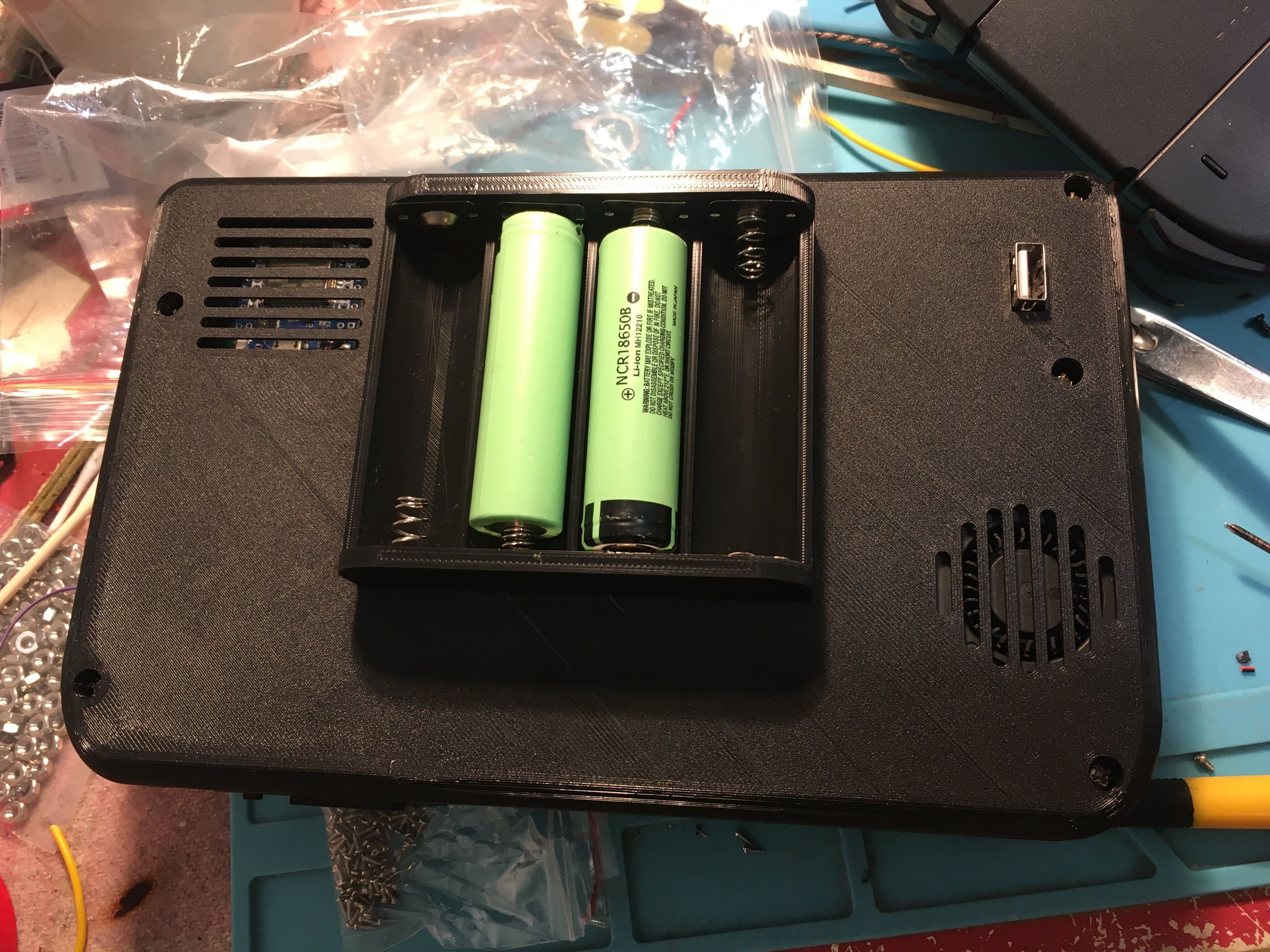

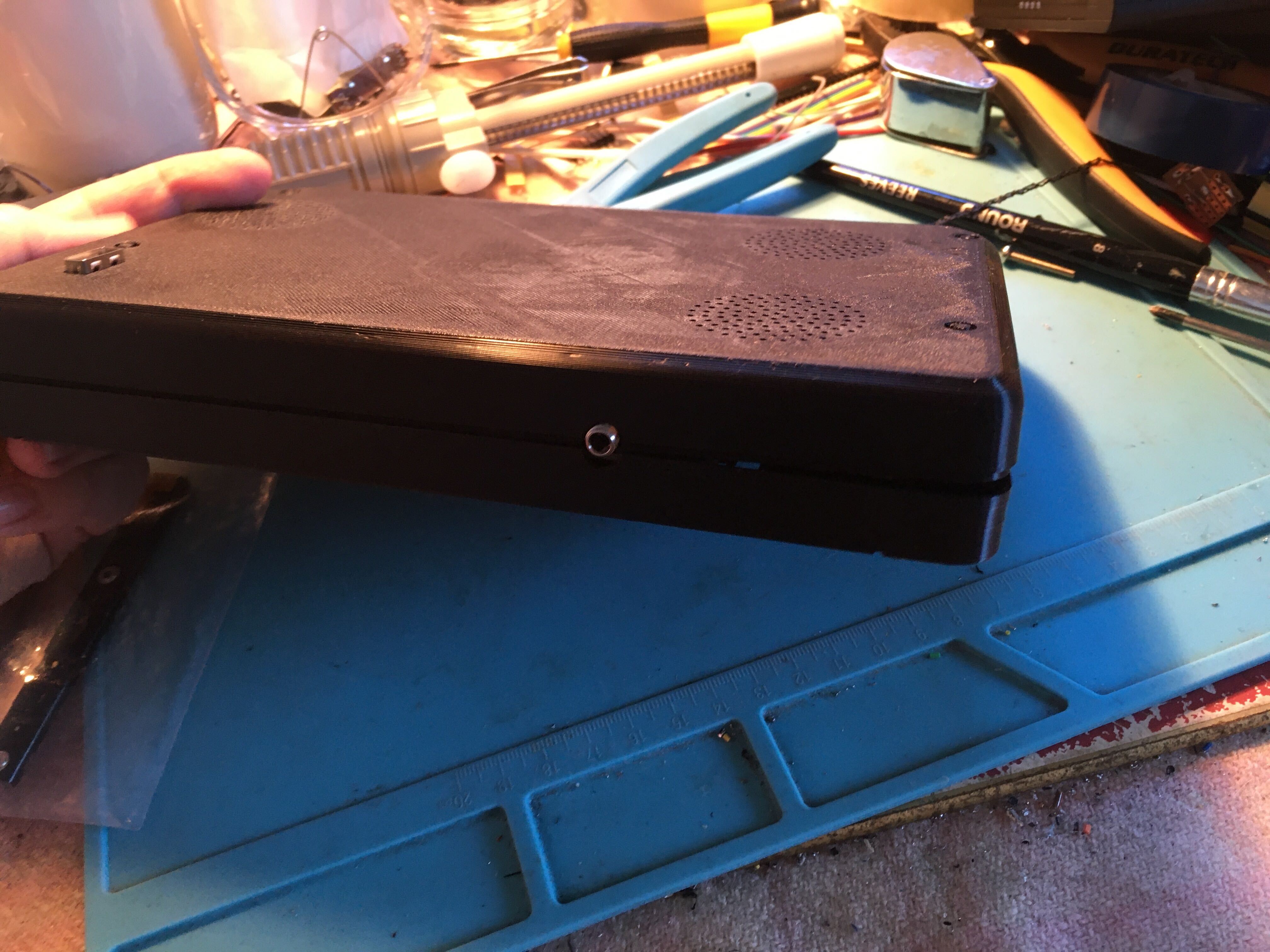

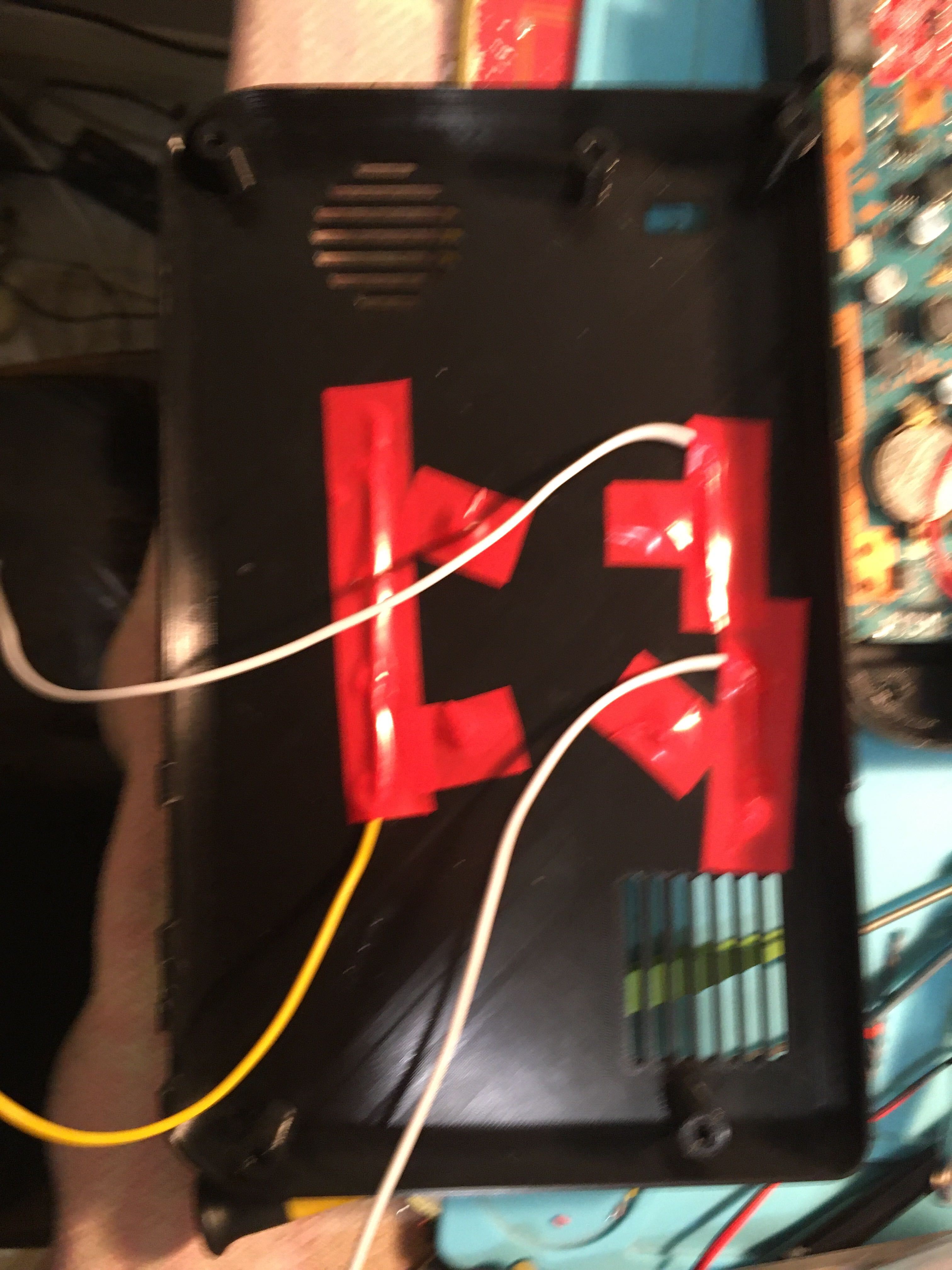

A few quick shots of the back of the case before assembling. The red insulation tape makes it go faster.

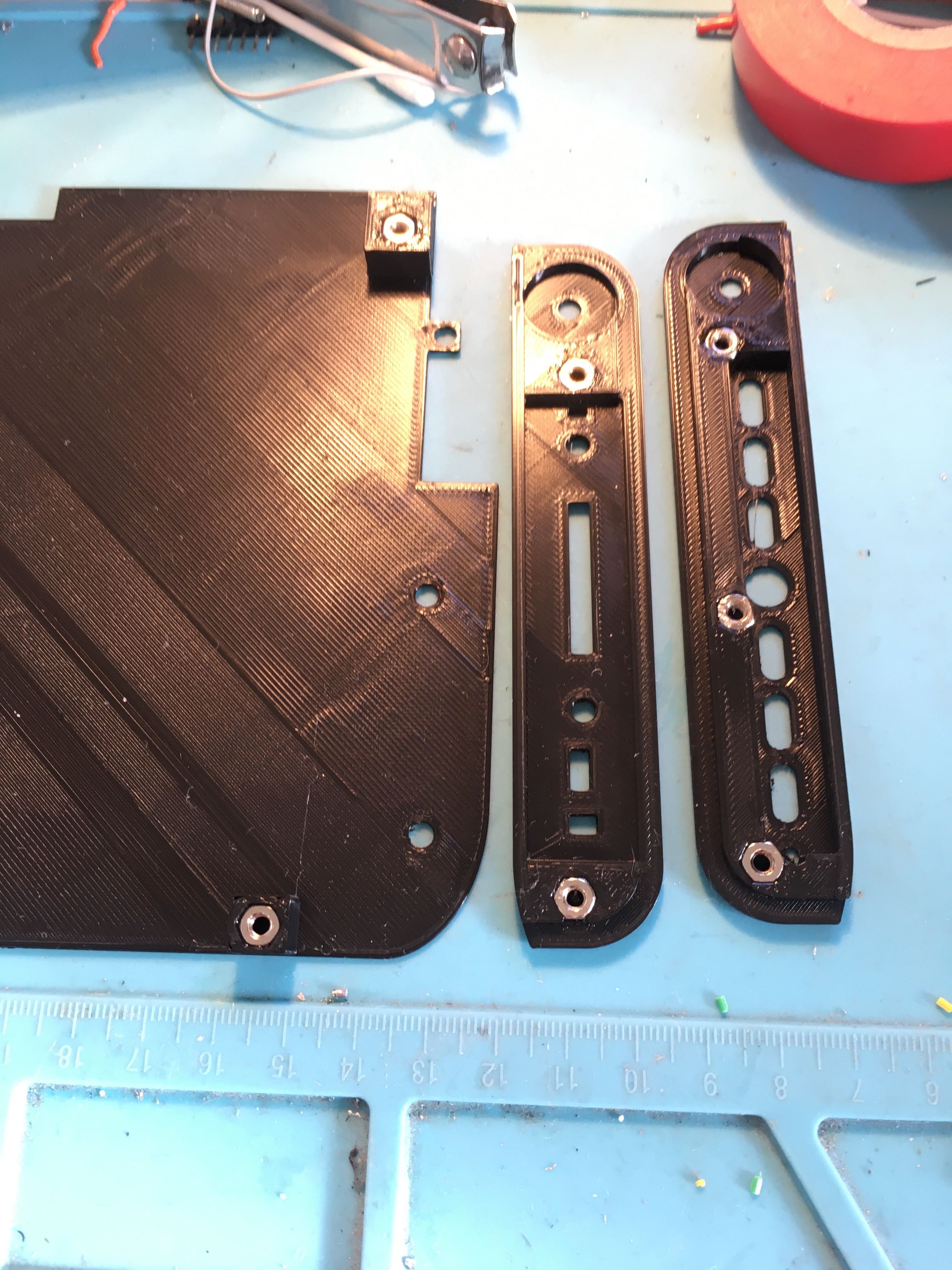

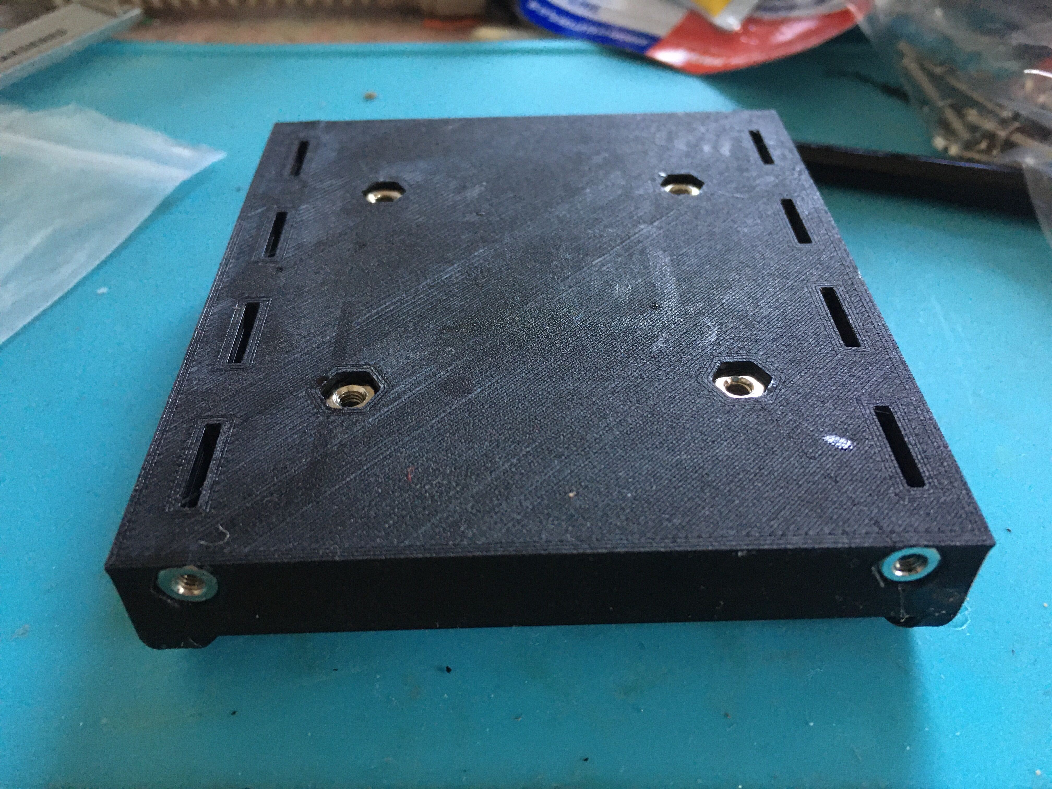

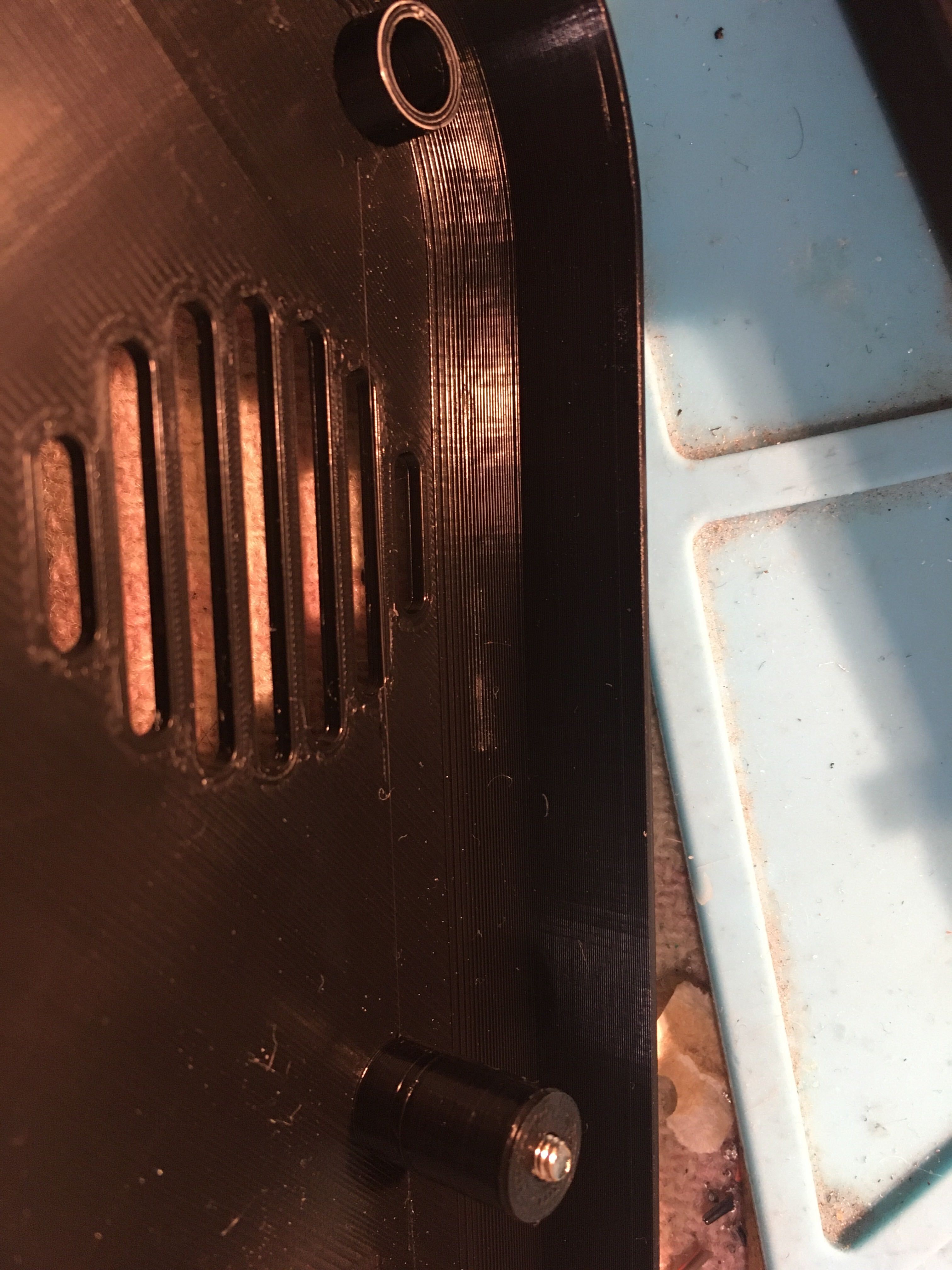

So something I wish I'd thought of sooner is using nuts glued into the print to give a good seating for the bolts. It works really well, and now I use it liberally everywhere. This is the underside of the battery holder for instance.
And a quick shot of the battery holder, showing the luxurious spring terminals!

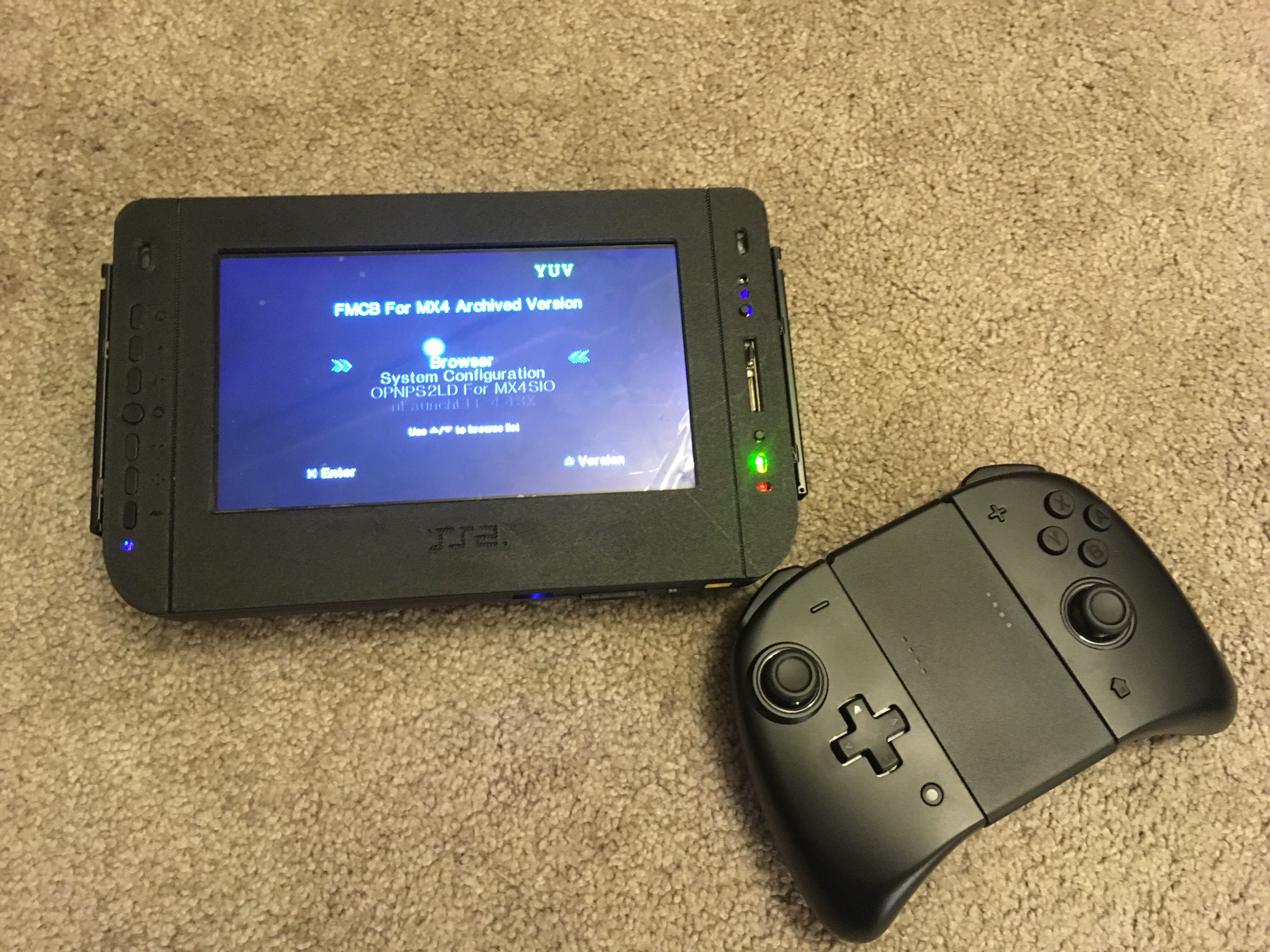

And finally a shot of the unit assembled and running! You'll notice that the controllers aren't slotted onto the side, because I used the wrong screws with the dome heads instead of the recessed ones, so after spending a half hour getting my MS-hands to put in f*cking tiny screws that always fell off the screwdriver and vanished I found I couldn't slot them in. I screamed silently inside and decided that this was a problem to fix tomorrow.
So I guess all that remains is swapping out the screws, and getting some sort of video assembled, before sitting down and burning hours playing PS2 anywhere I want!

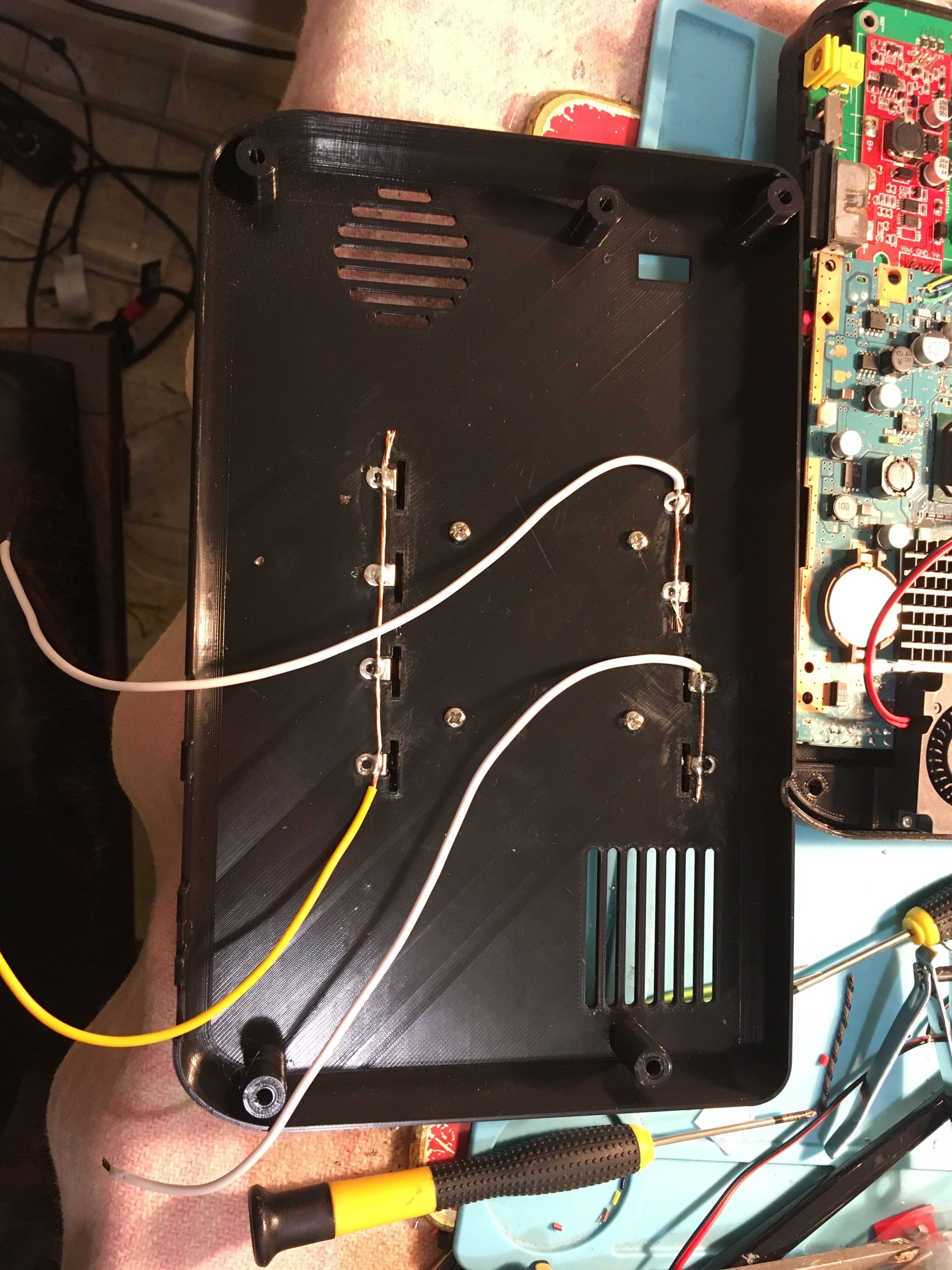

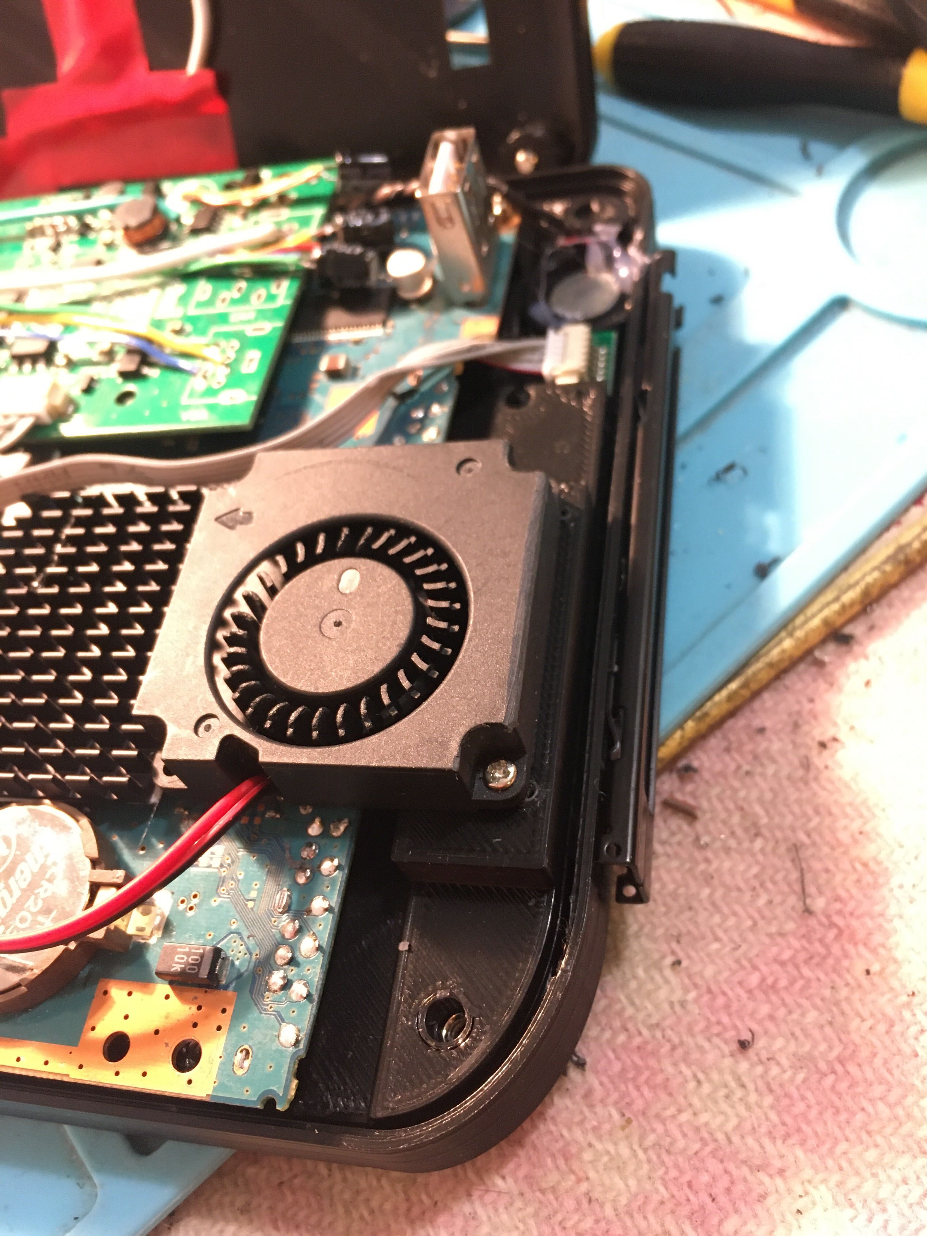

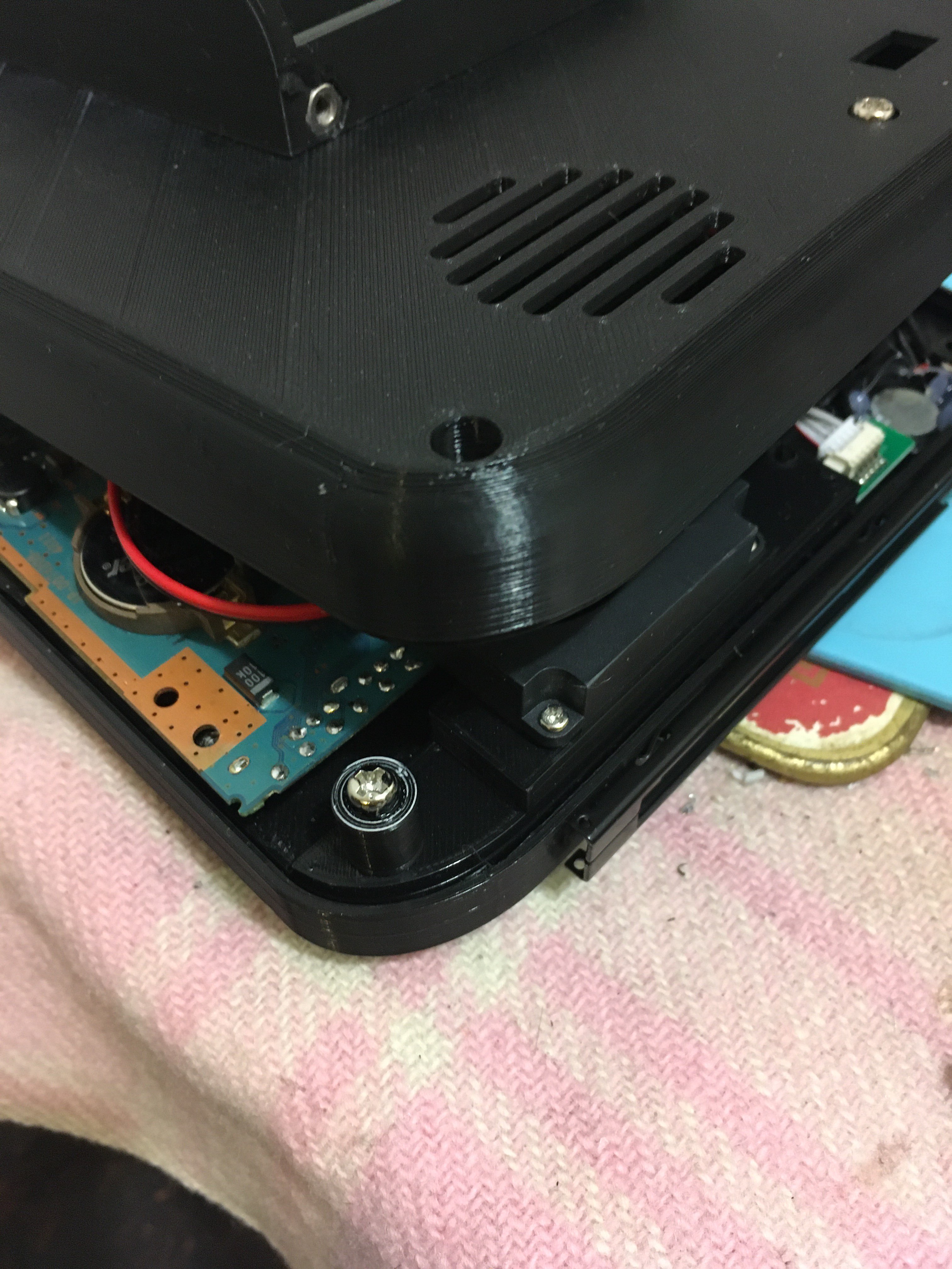

Sometimes it feels like there isn't a hot minute before something goes wrong. I was cooking in the kitchen when I heard a faint "plink" sound on my bench. Thinking that I'd left the iron on I investigated and found that the case on the portable was lifted at a corner. Turns out it had broken a screwpost while I had been standing beside it.
Pulling the top off, AGAIN (it involves soldering lines because there's zero space for a 'fold open' design) I found that the issue was the internals had shifted ever so slightly when I dropped it, and the fan was now putting too much pressure on the inside of the case. While my design was snug it'd appear that it was just too much (look for the faint white marks in the corner).
After I'd finished scowling at it I figured that I'd try moving the fan and chamfering off the edge as much as I could get away with. Turns out it fit like a glove!

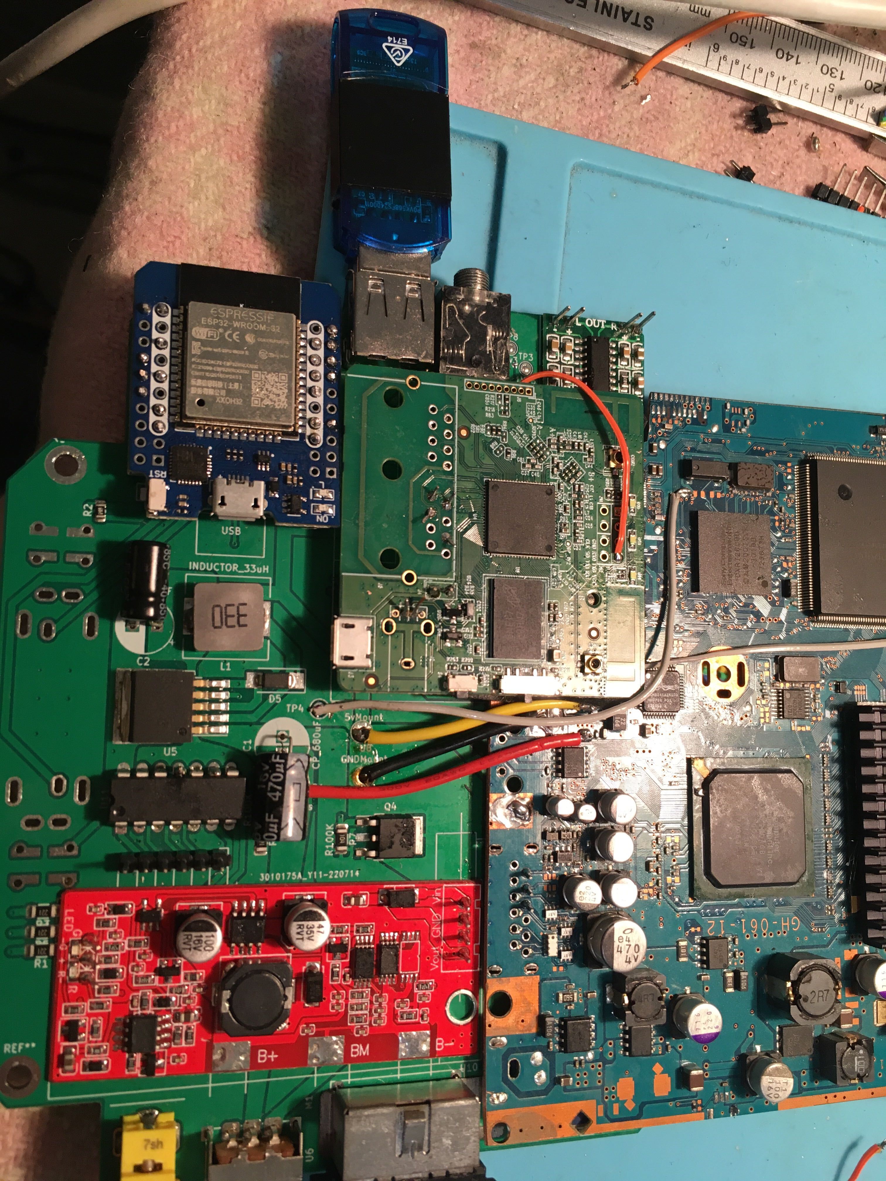

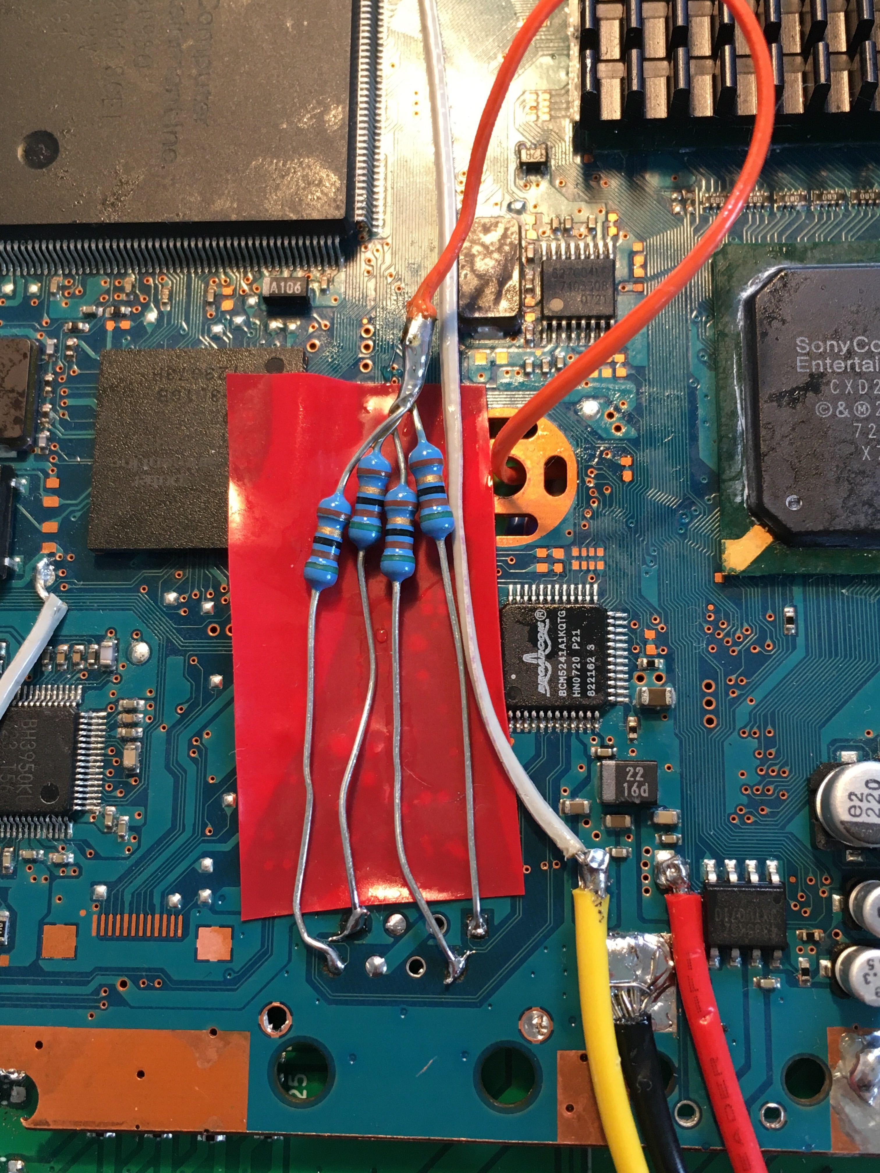

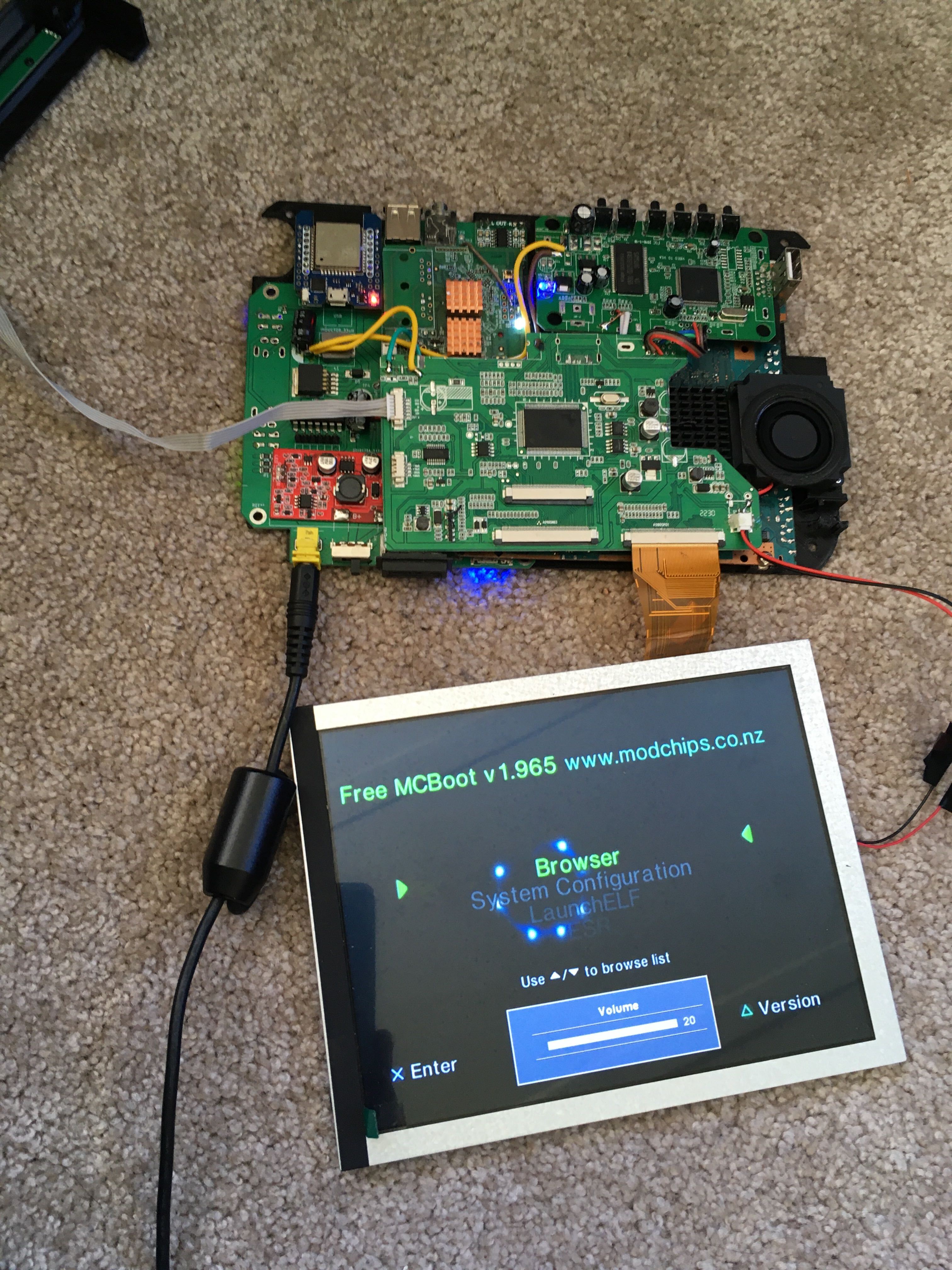

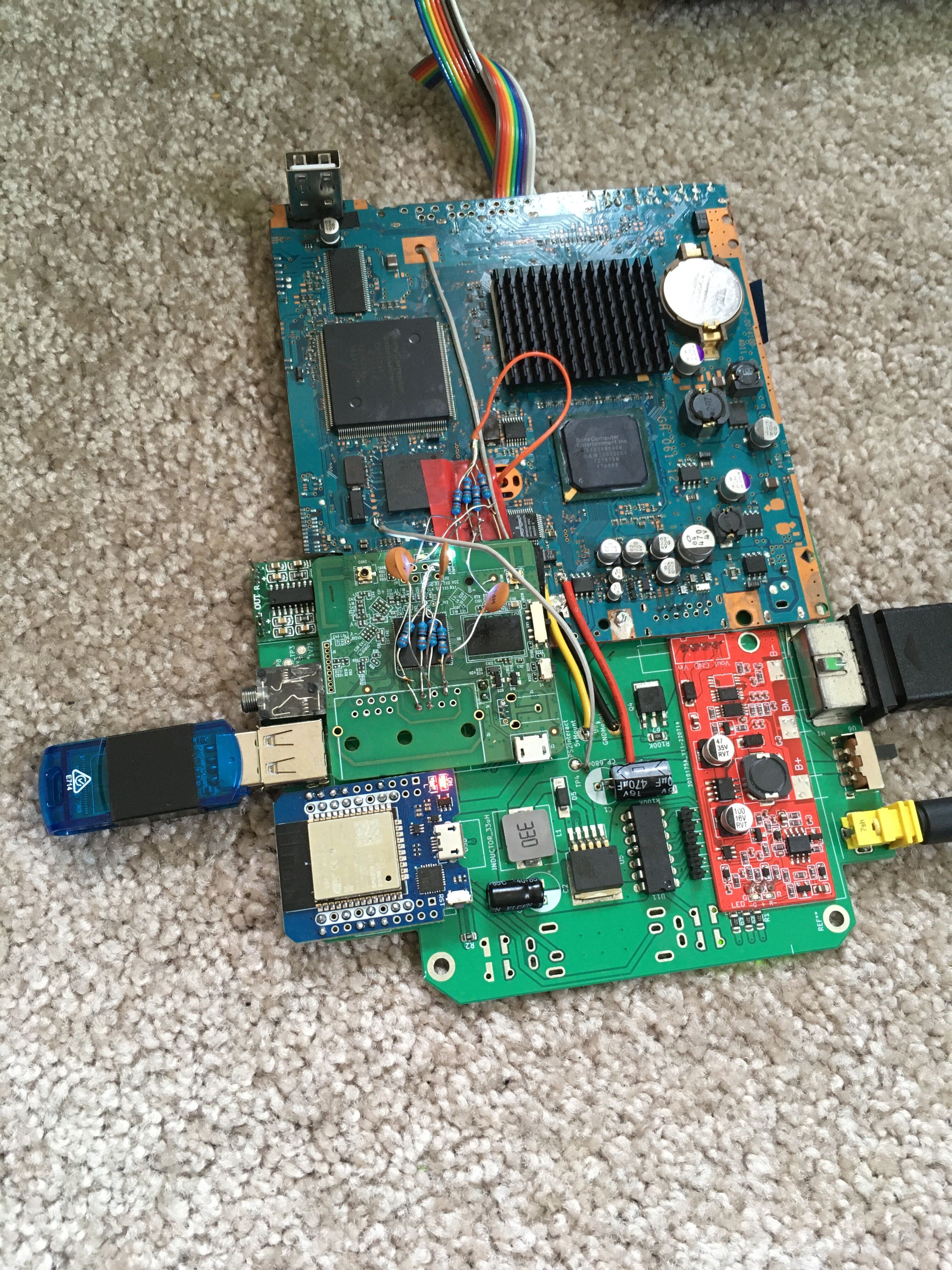

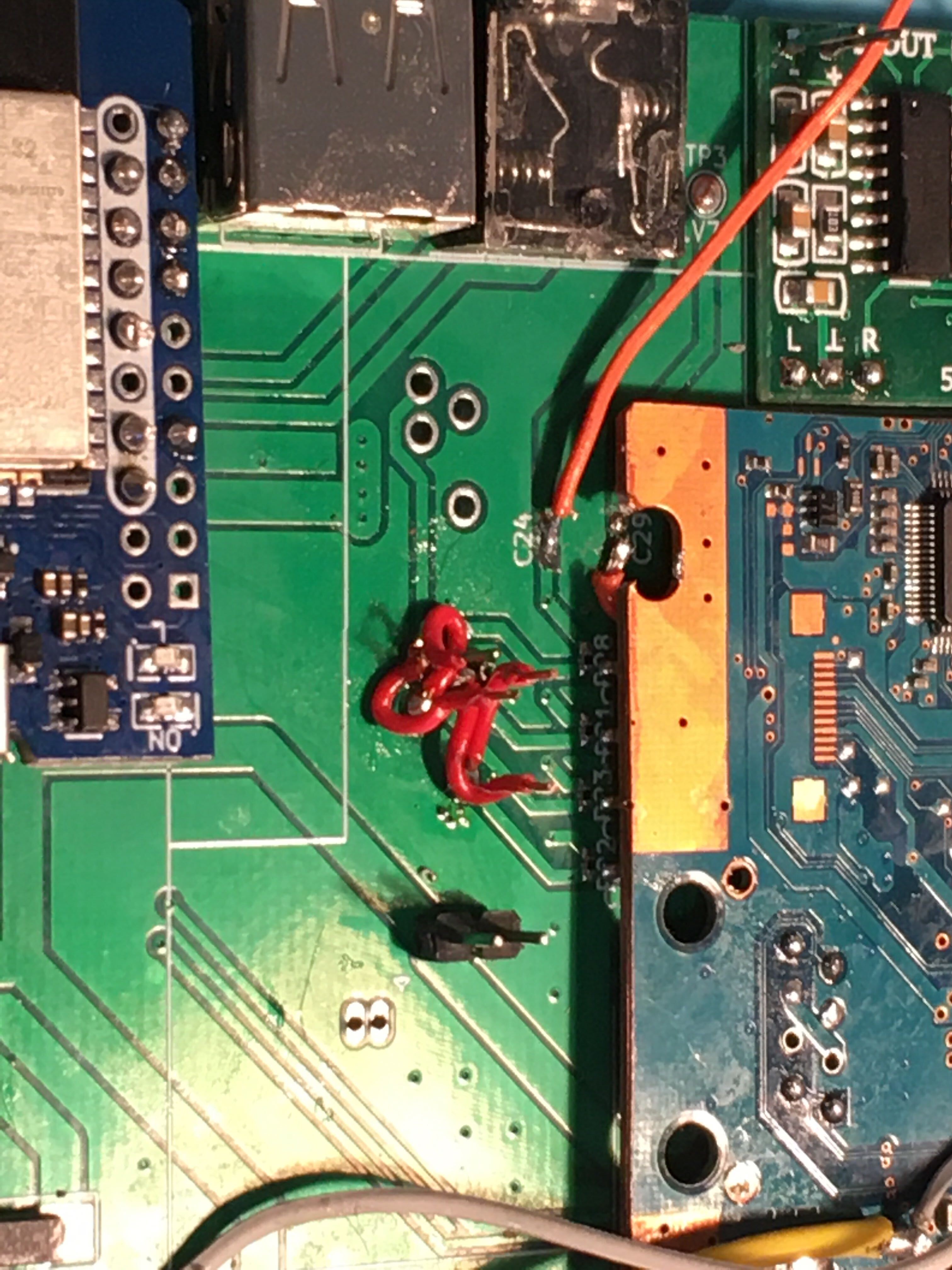

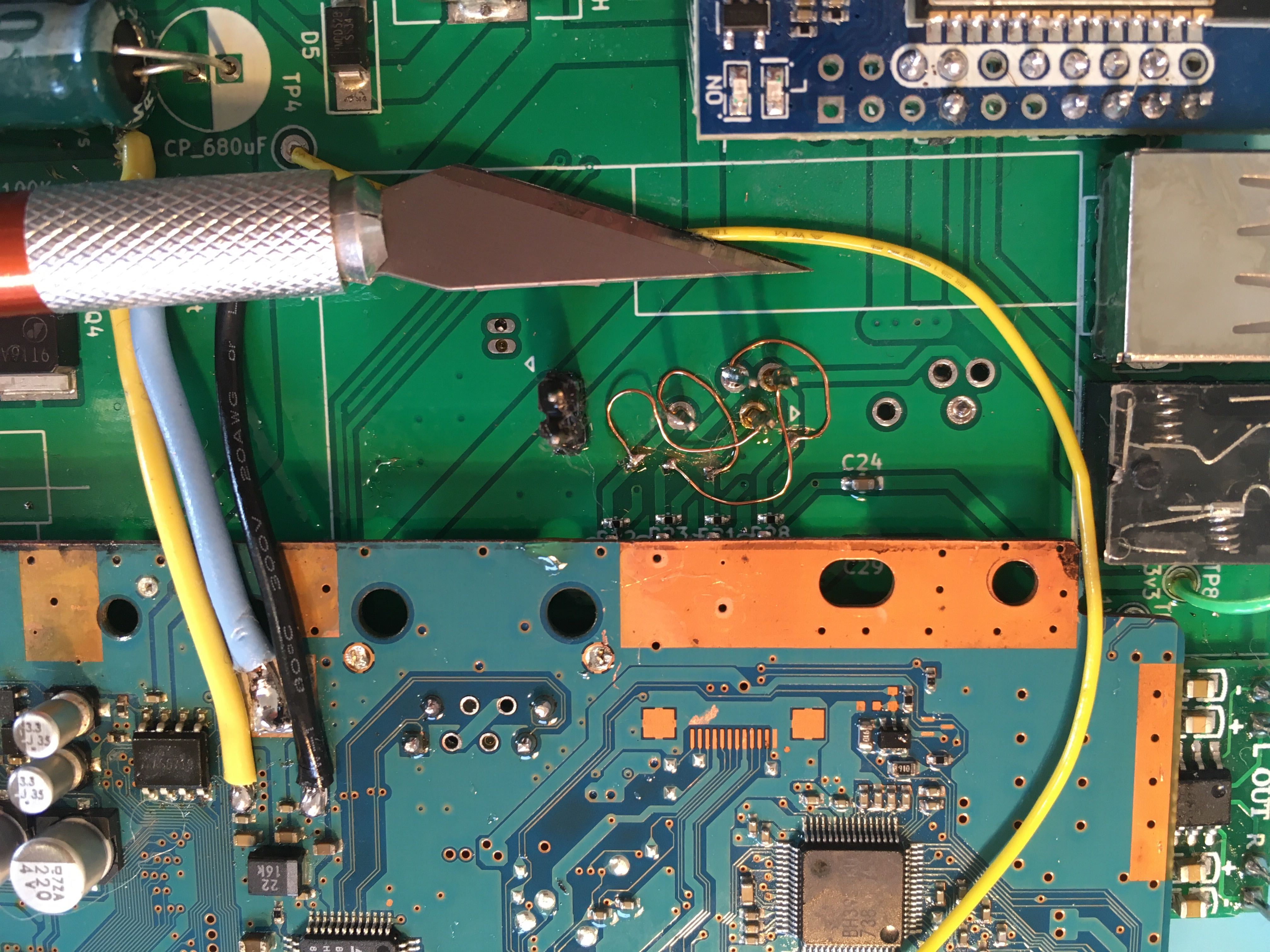

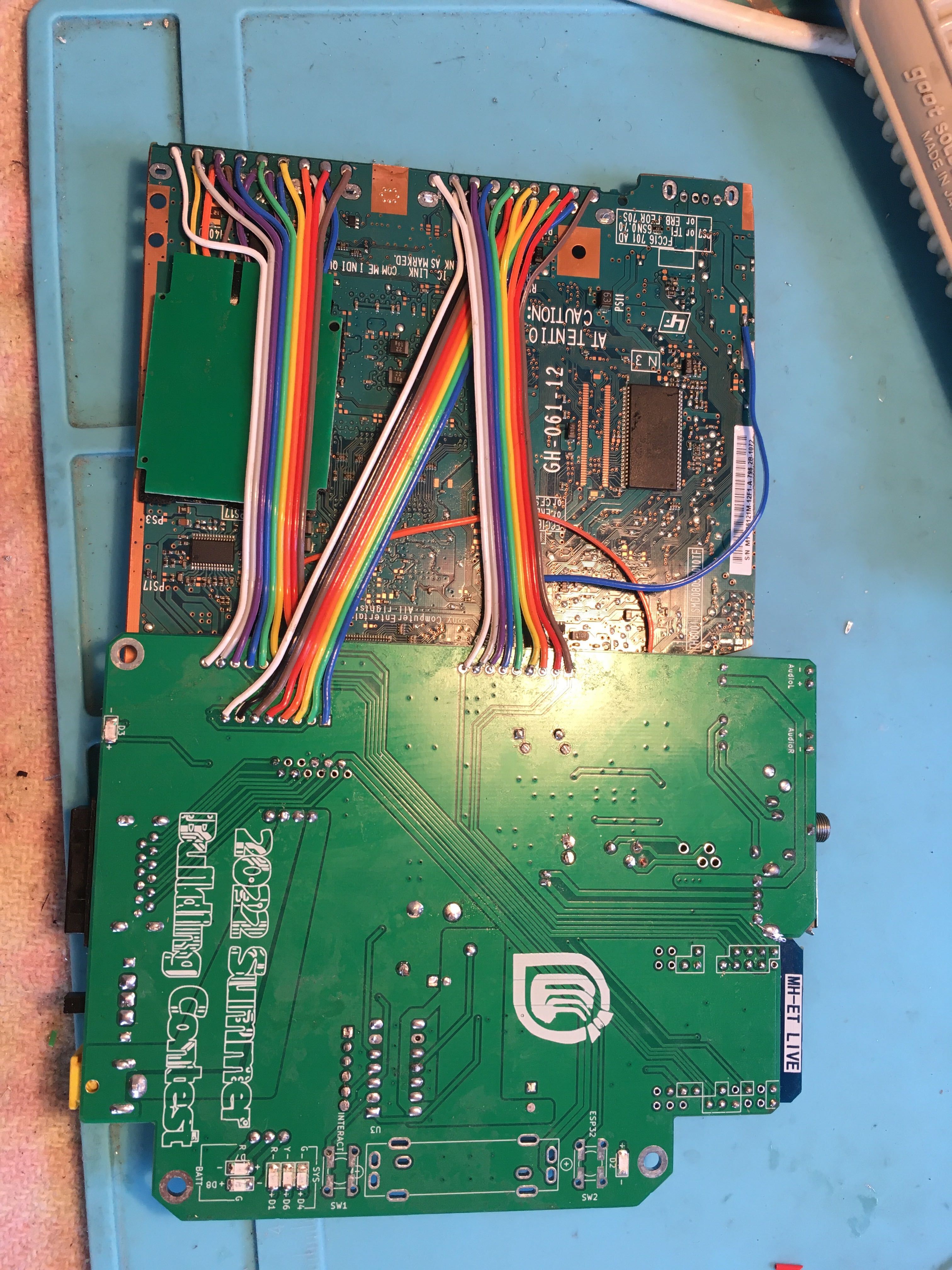

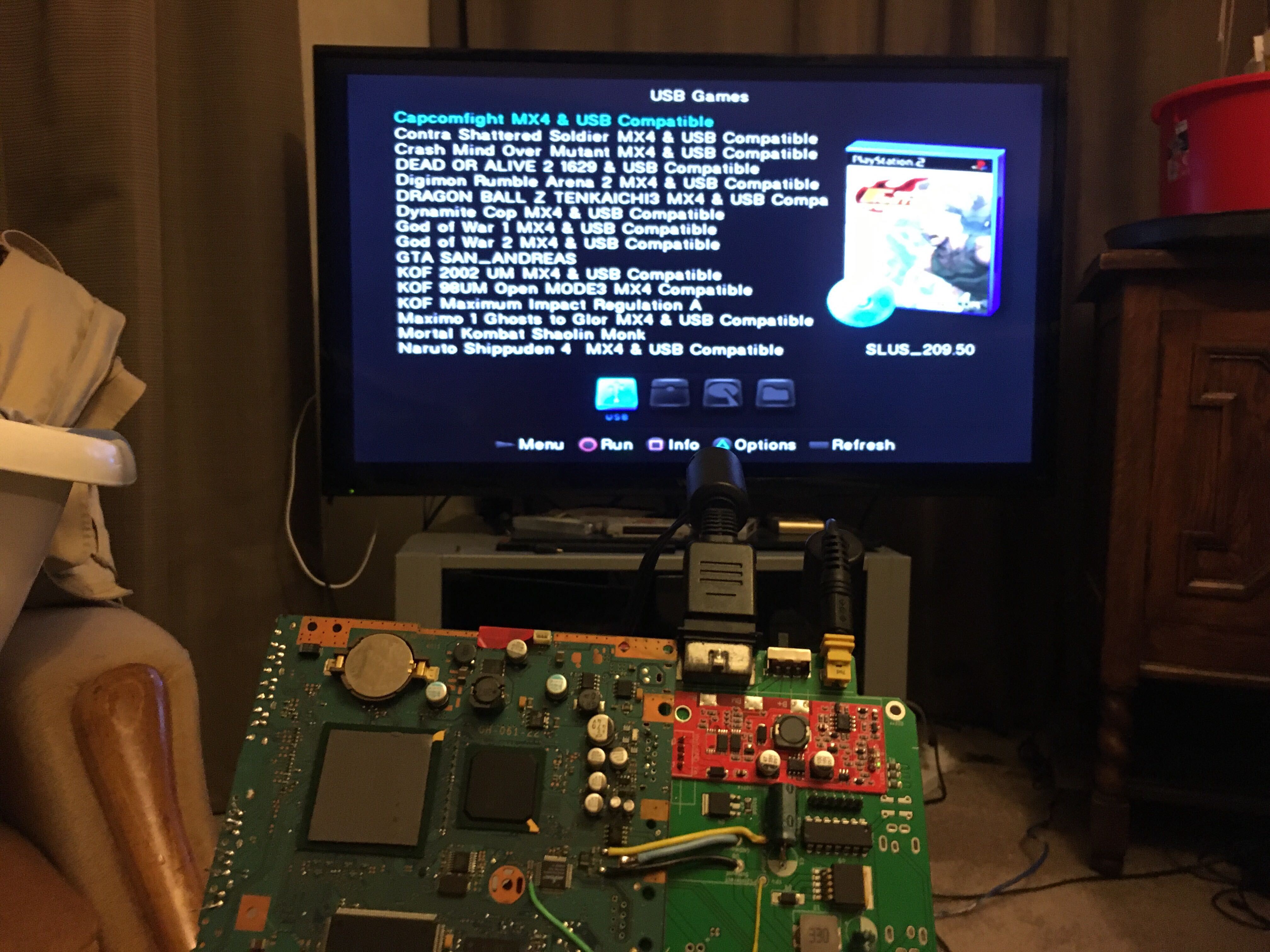

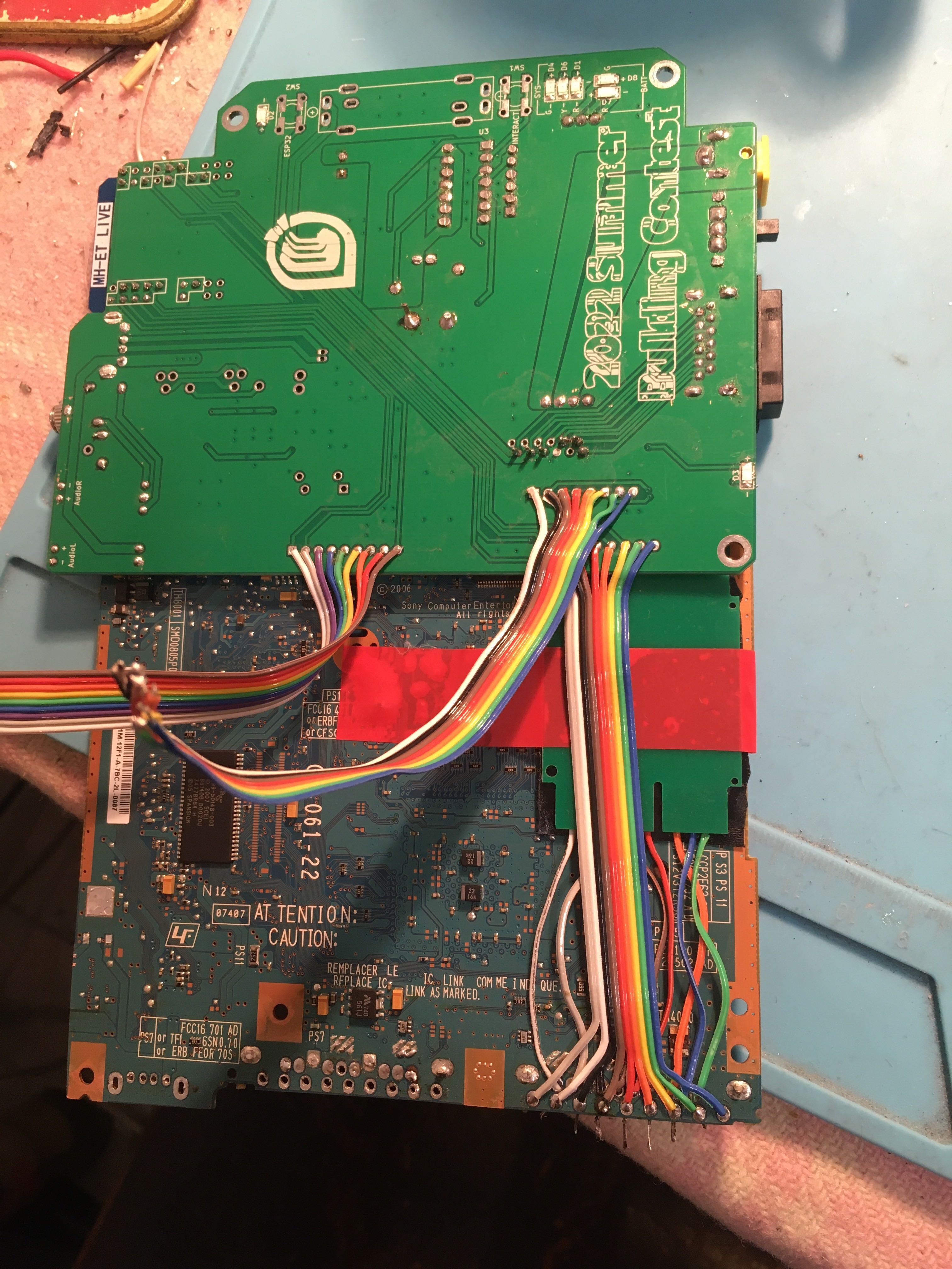

So one of the core issues I had with this build was that the MX4SIO was intermittent, and it really felt like it depended how you held your tongue when it came to getting it to work. Naturally I stripped a large part of the portable trying to figure out just why this was and eventually found that the issue was a broken trace on the PS2 board. So after muttering "I hate trace repair" and having ruined my ability to wire up the original SD port I just wired in the MS4SIO memory card and screwed it onto the back-plate that I had in the unit. It now sticks out the top slightly - in a hole that's slightly too large because I measured twice, cut once, and then changed things around on the inside.
But I've also been trying to figure out just what was wrong with the Mango loading over ethernet, and after far too much searching, experiments, testing multiple PS2 and Mangos to death I finally discovered that the problem was because the pull-up resistors on the Mangos ethernet needed to be connected to RX0 and not 3.3v. I'll need someone to explain why this is the case because I can't figure it out, and it also means that the first time I did this was a seriously happy accident.
So Armed with that knowledge I also had to figure out what my wiring was, and I made the noob mistake of flipping things upside down while constructing the PCB, which was another issue that had to be resolved. This lead to a prolonged struggle getting tiny bits of wire to line up with the holes in a freshly shucked Mango board.
And it works! The second unit that I've built out of frustration now correctly loads games over ethernet off of the mango, running at full speed from a NTFS USB drive that's connected to the attached USB. Of course the question I've got now is: Is this second build a new work log, or a continuation of this one? ;)

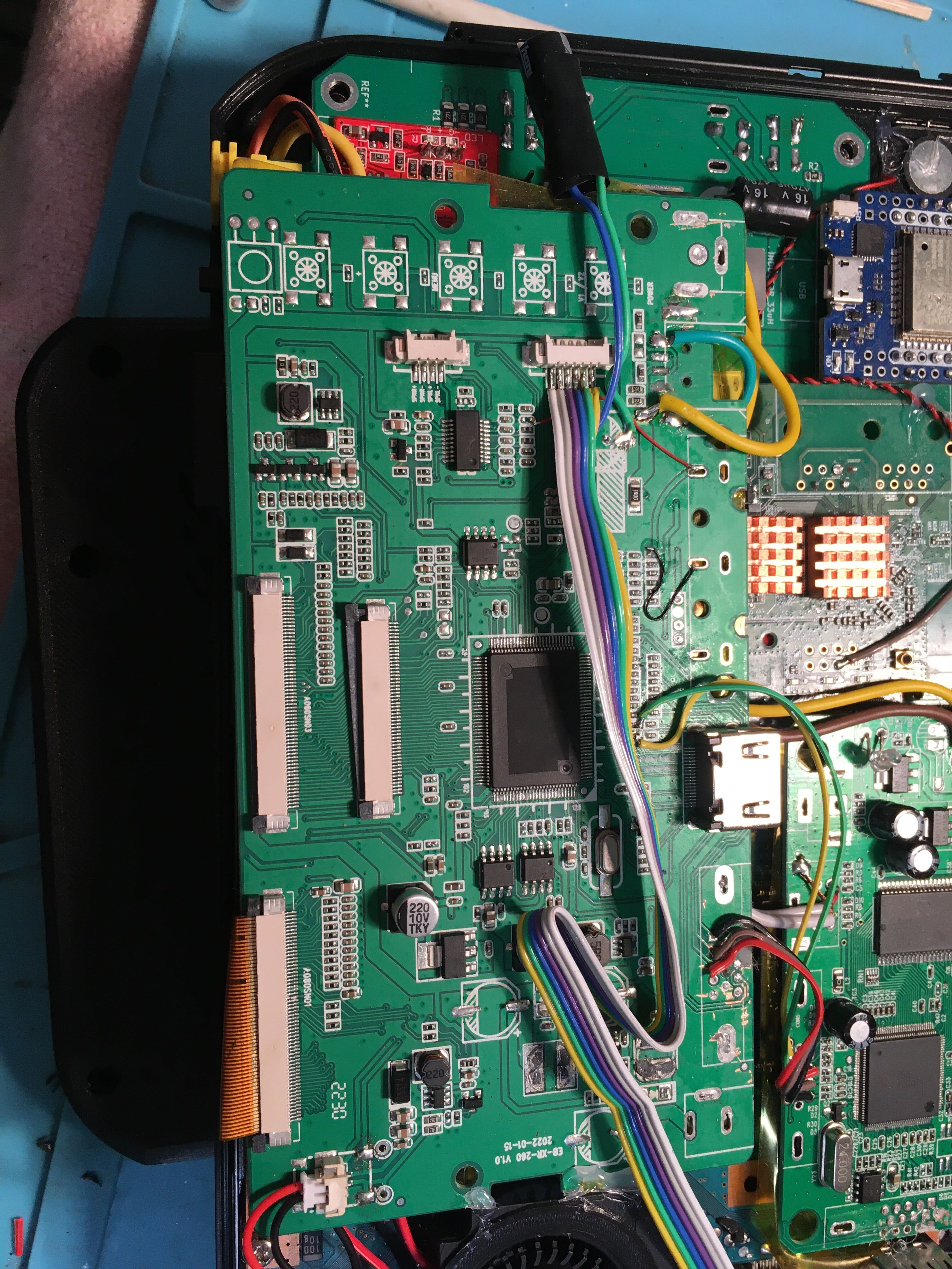

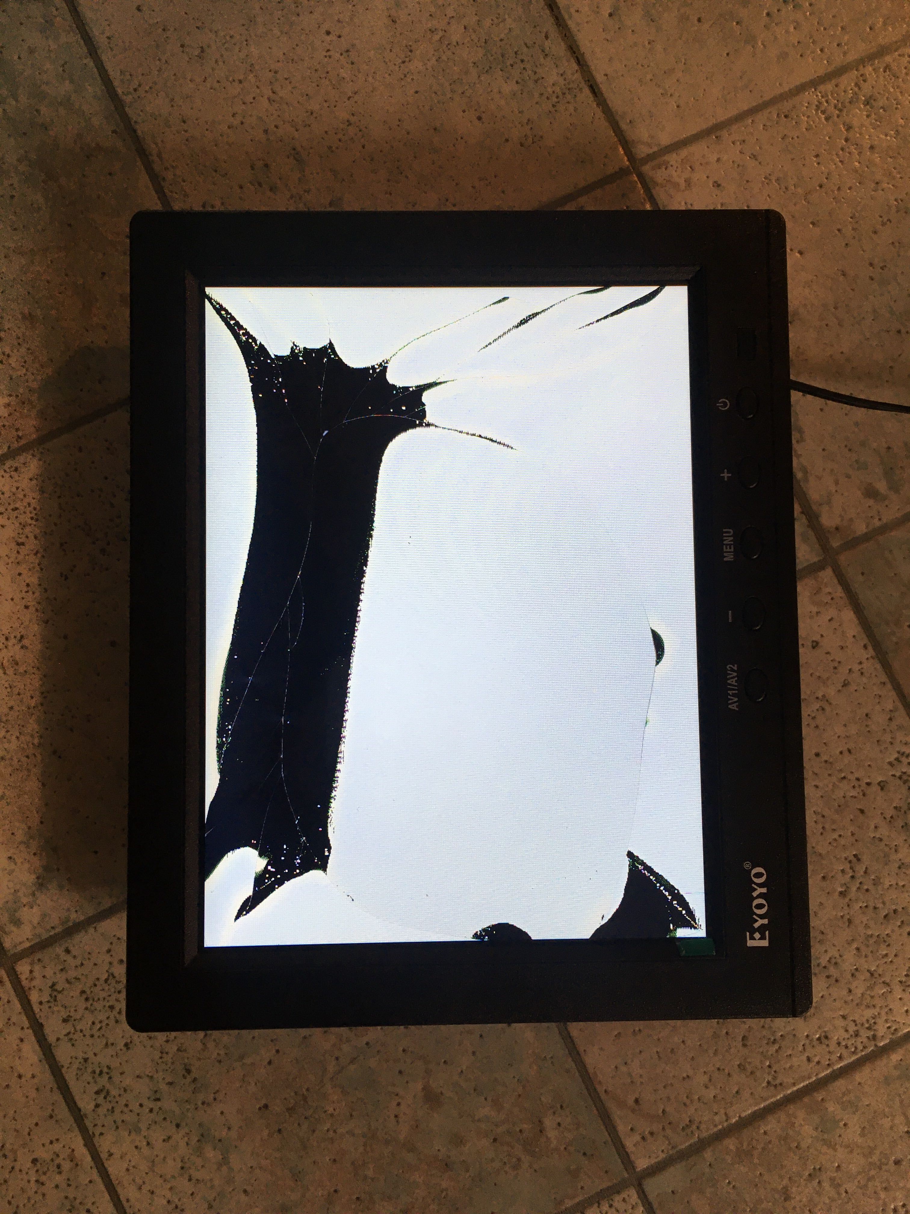

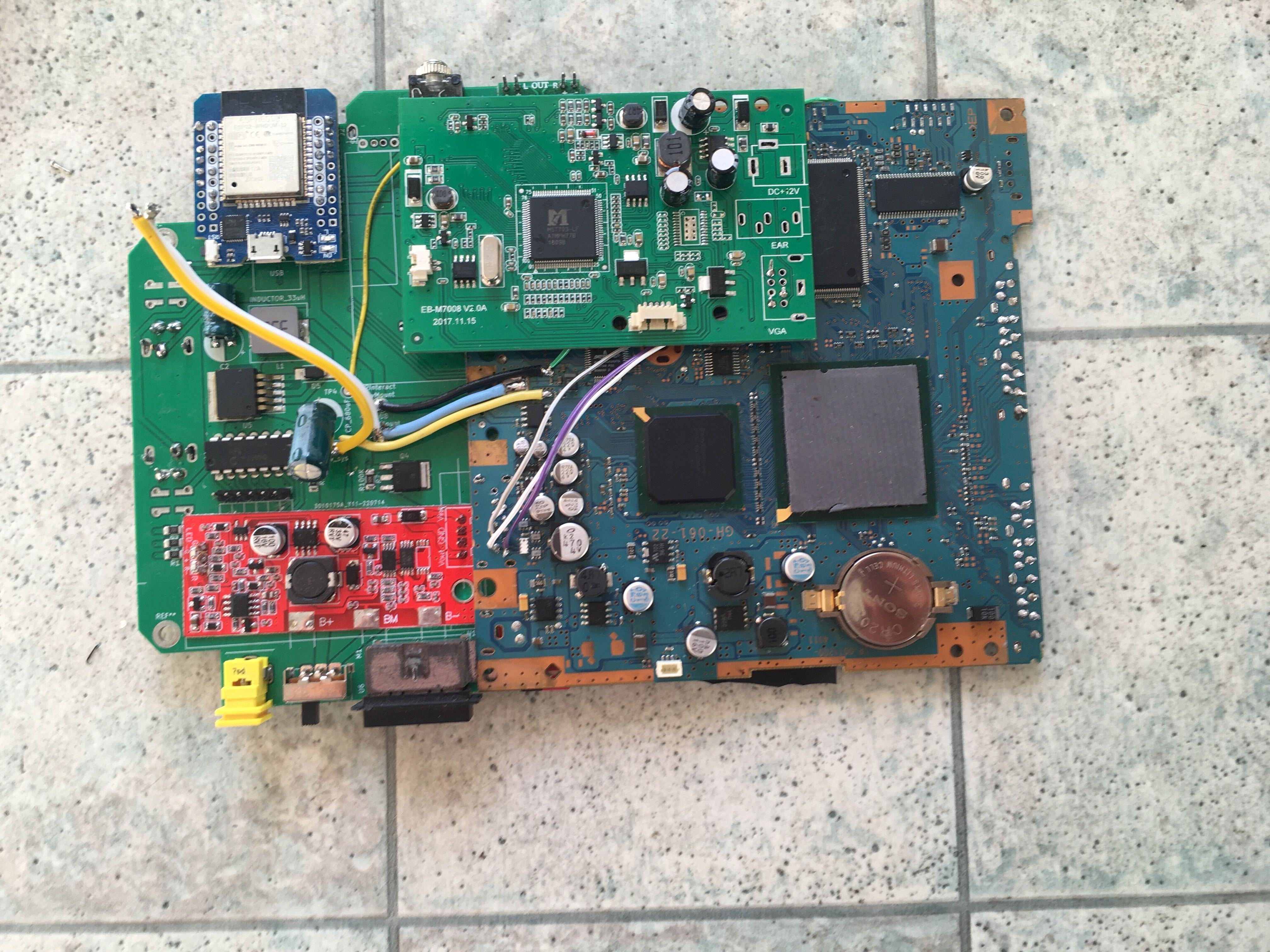

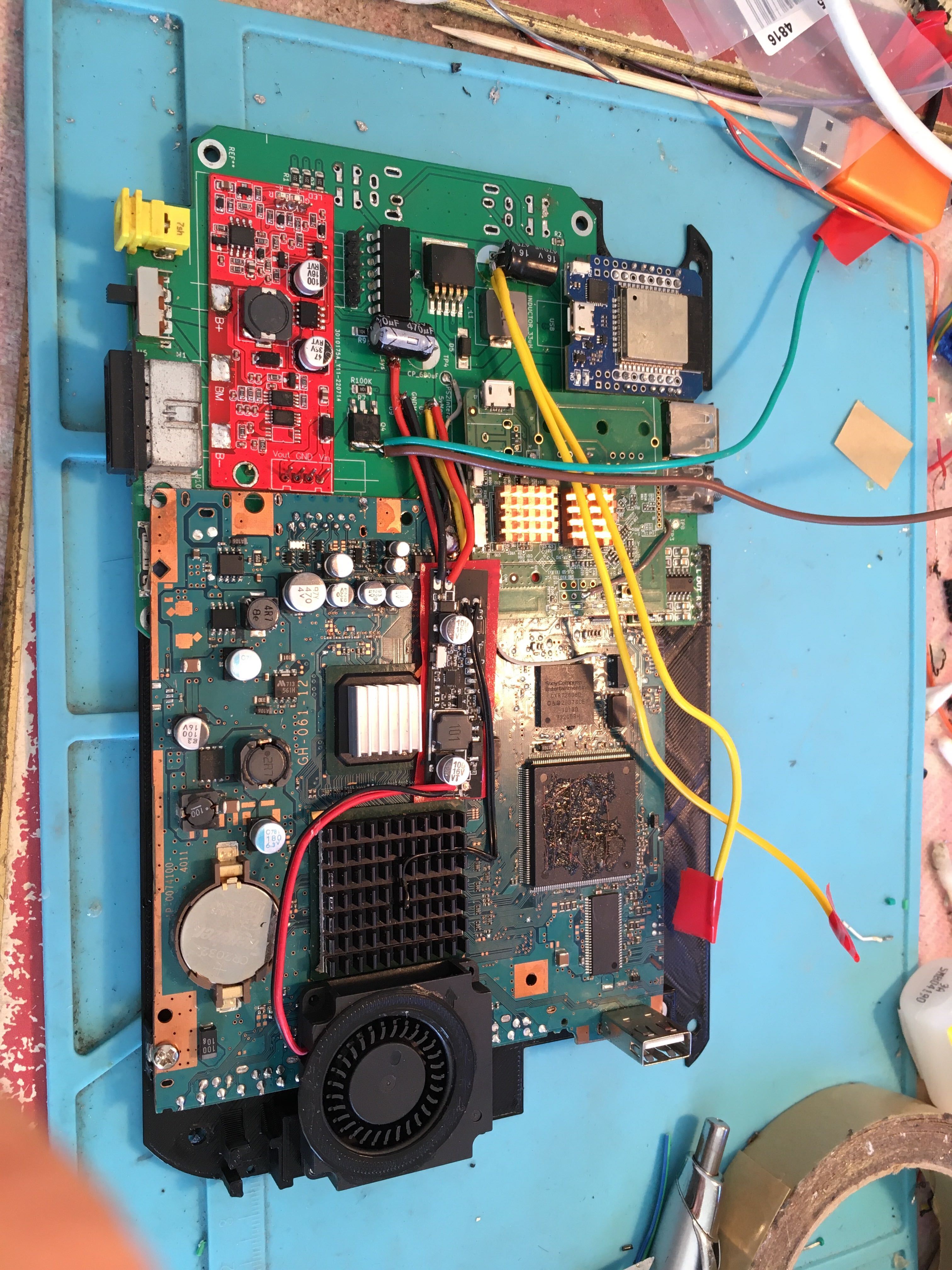

Back on the warpath with the project(s) and my latest bugbears have been the interference "musgrave" lines that I've been seeing on the screen. I spent a lot of time trying to track these and eventually concluded that it was electrical noise coming in from the 5v line. I found this a bit surprising as the caps I had used weren't far off of the ones recommended by the datasheet for the 5v step down chip, and in the end the solution for minimizing the issue was putting a cap across the 5v and GND and making it as BIG AS POSSIBLE.

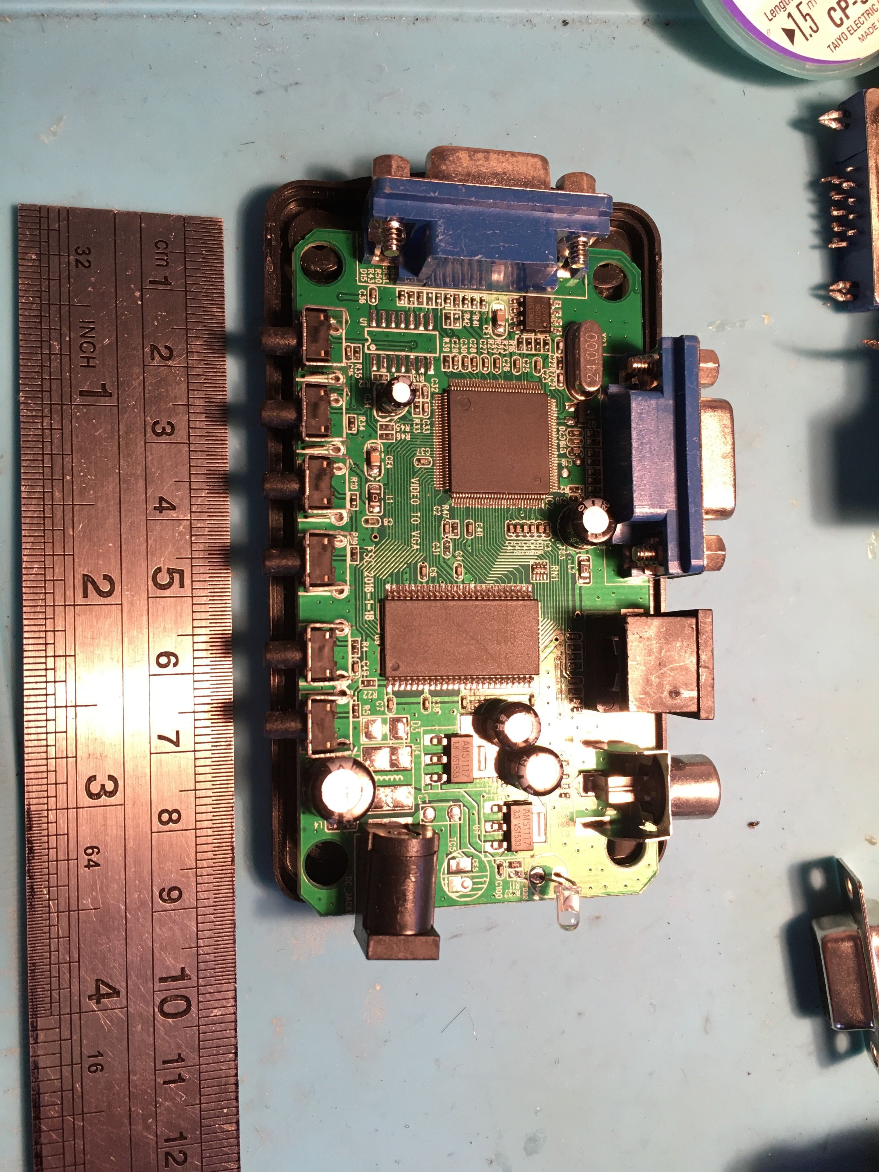

Having got the 7" unit about as good as I felt I could get it I decided to give up waiting for the screen driver I'd purchased from Taobao as I now feel it'll never arrive. My two options were to use a board I had lying around and transplant a chip from the Eyoyo 8" screen, or to use this really shitty driver board that I had which would do the trick using composite video.

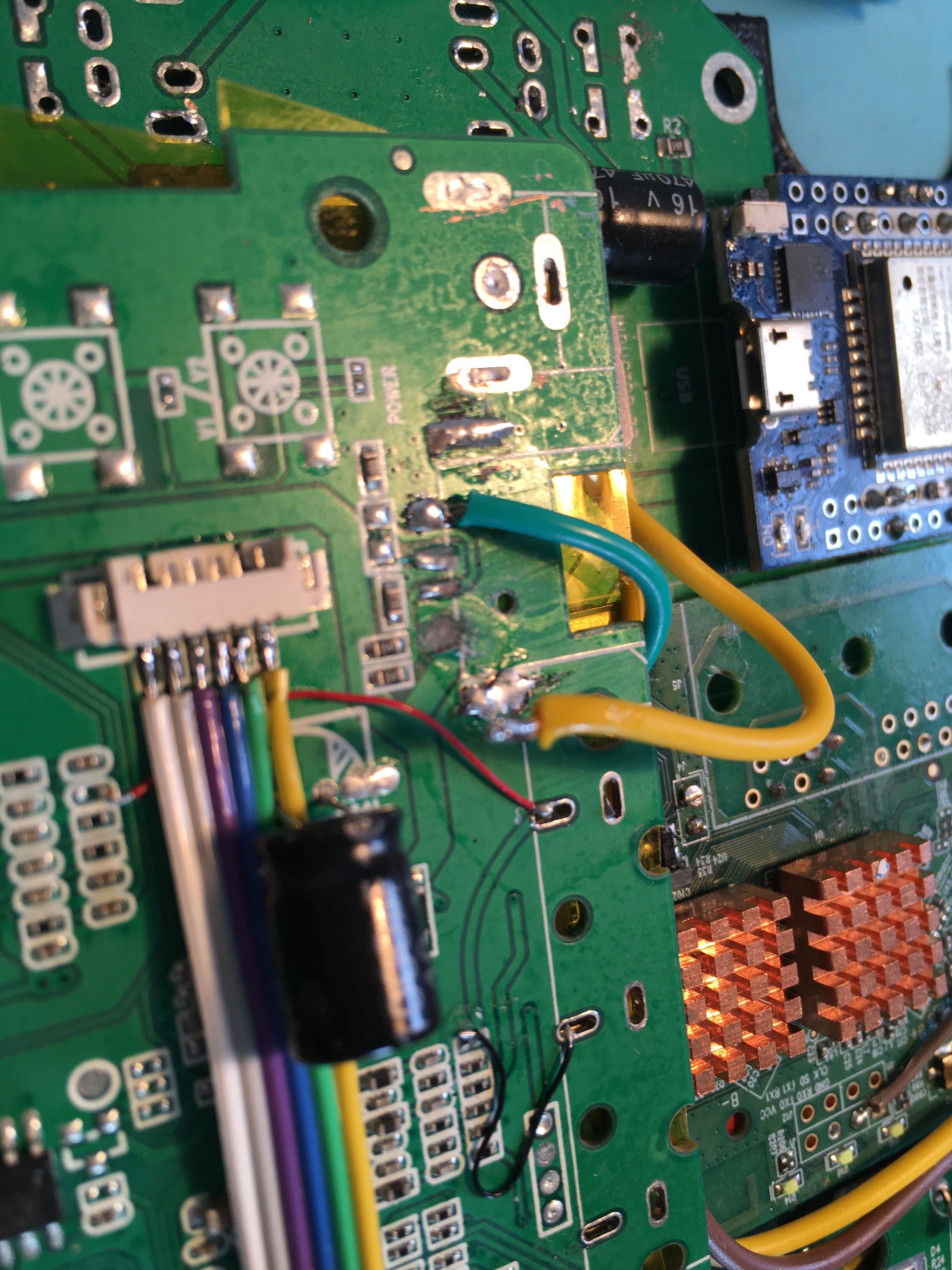

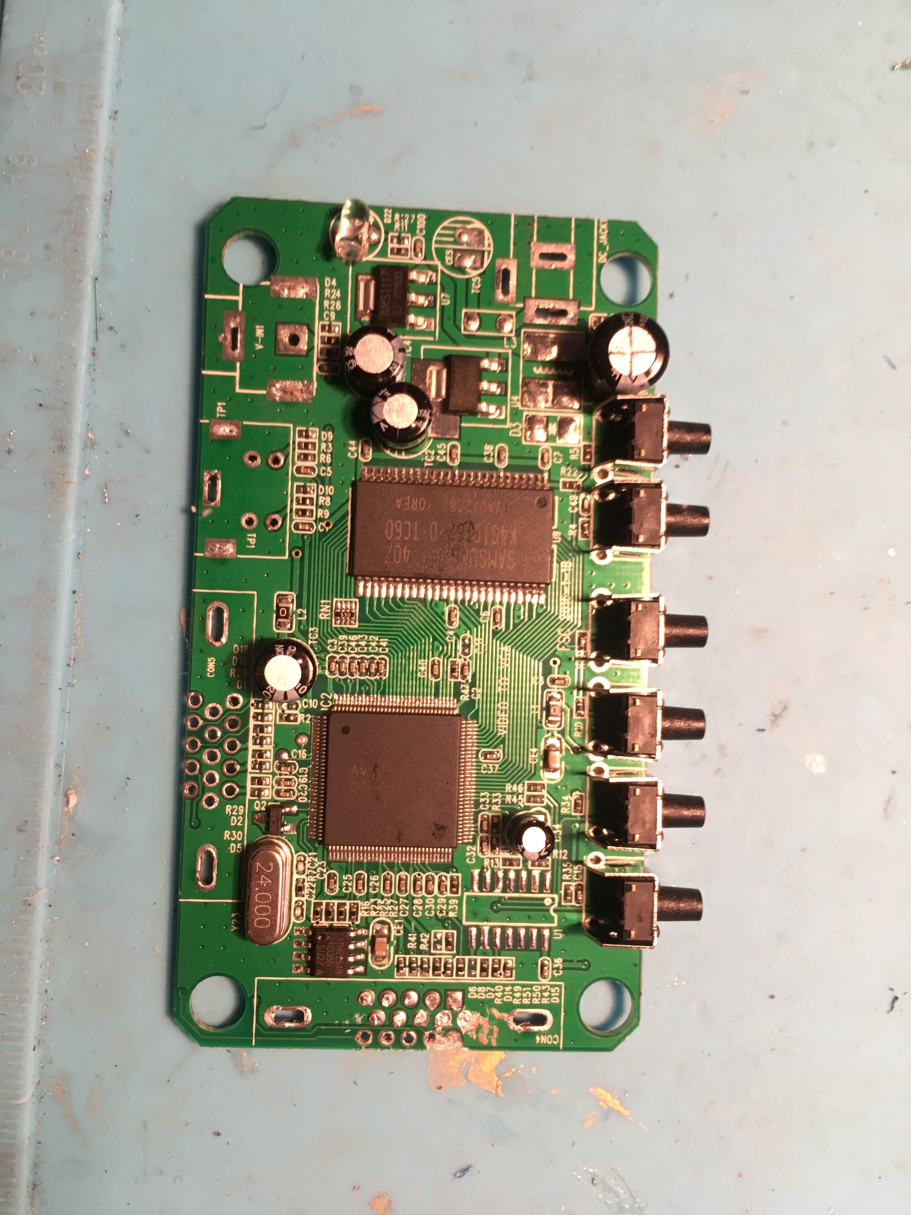

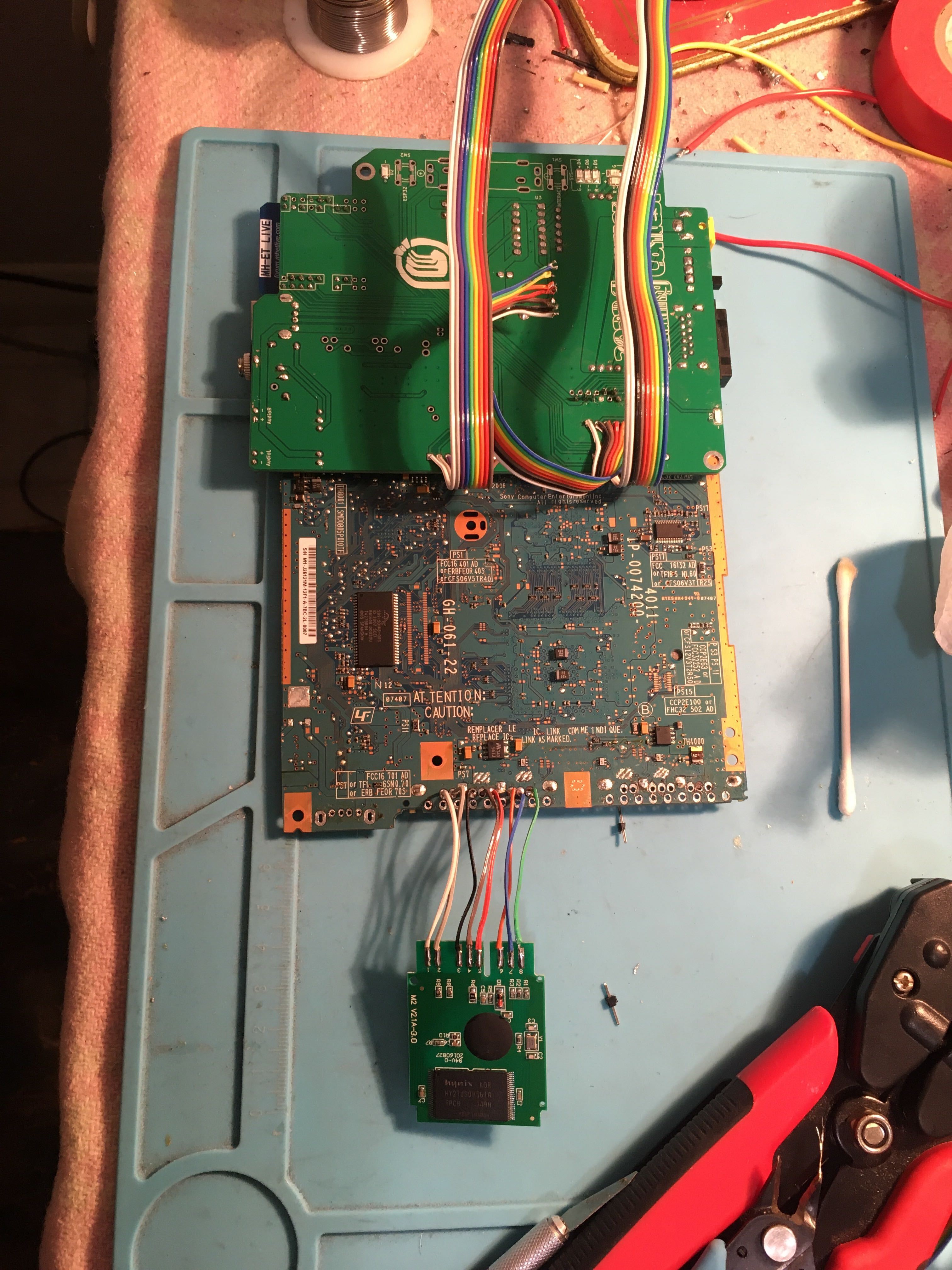

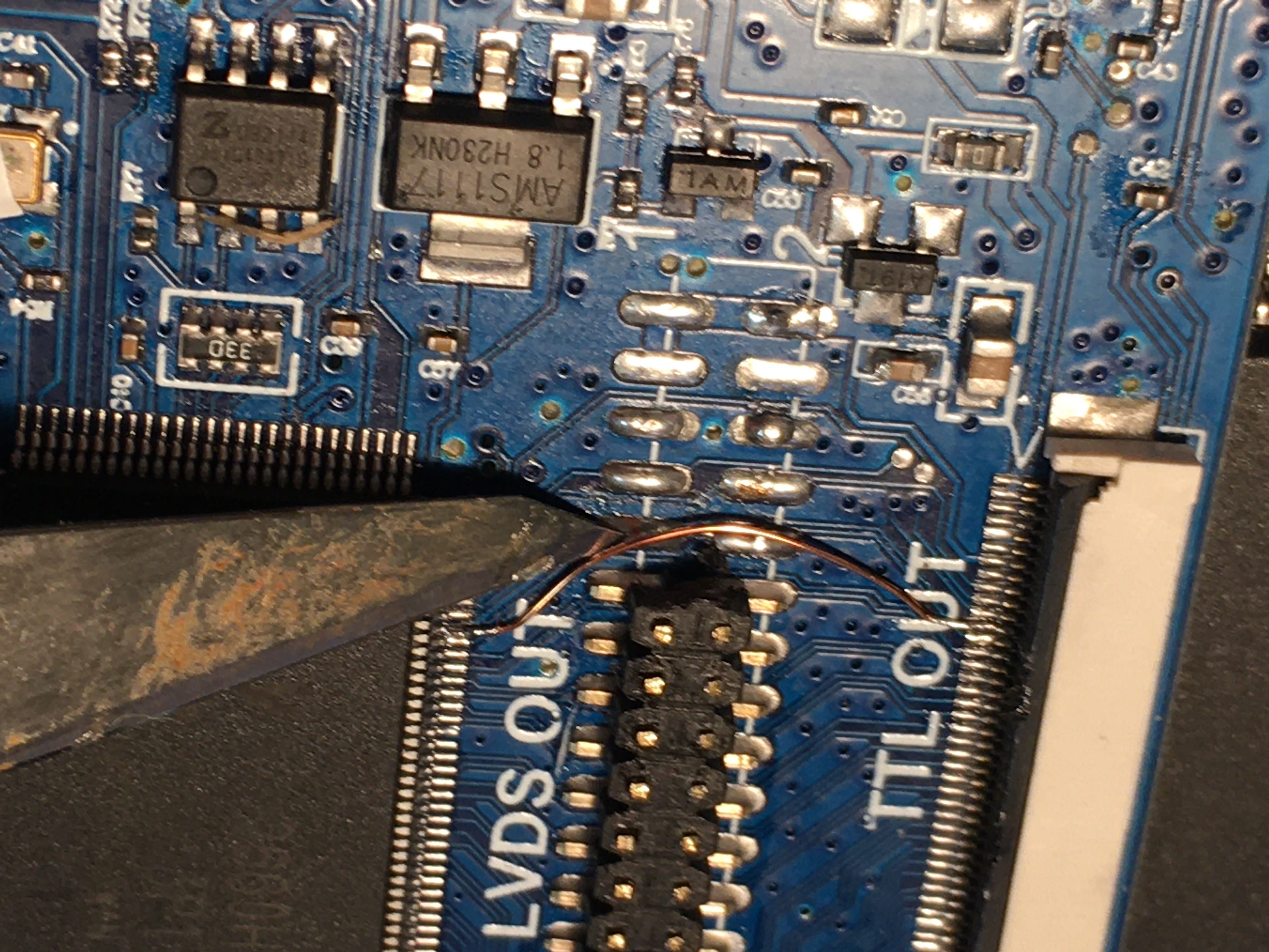

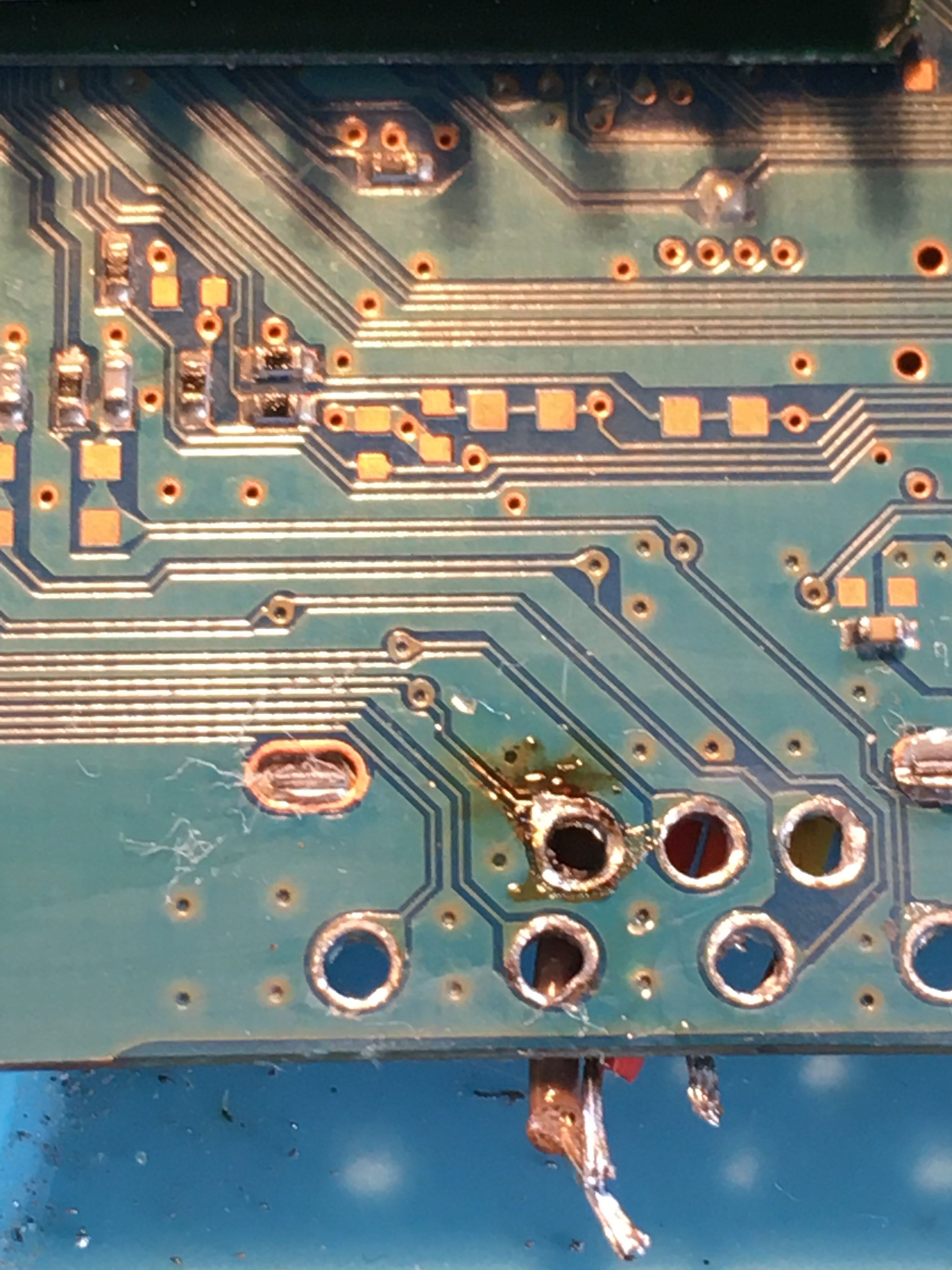

The transplant really didn't go well, I can't solder how I use to, those things are never going to work again.
So this crappy driver board - really it was so junk bits were falling off it with minimal assistance from myself:
Sill, it's pretty thin now.

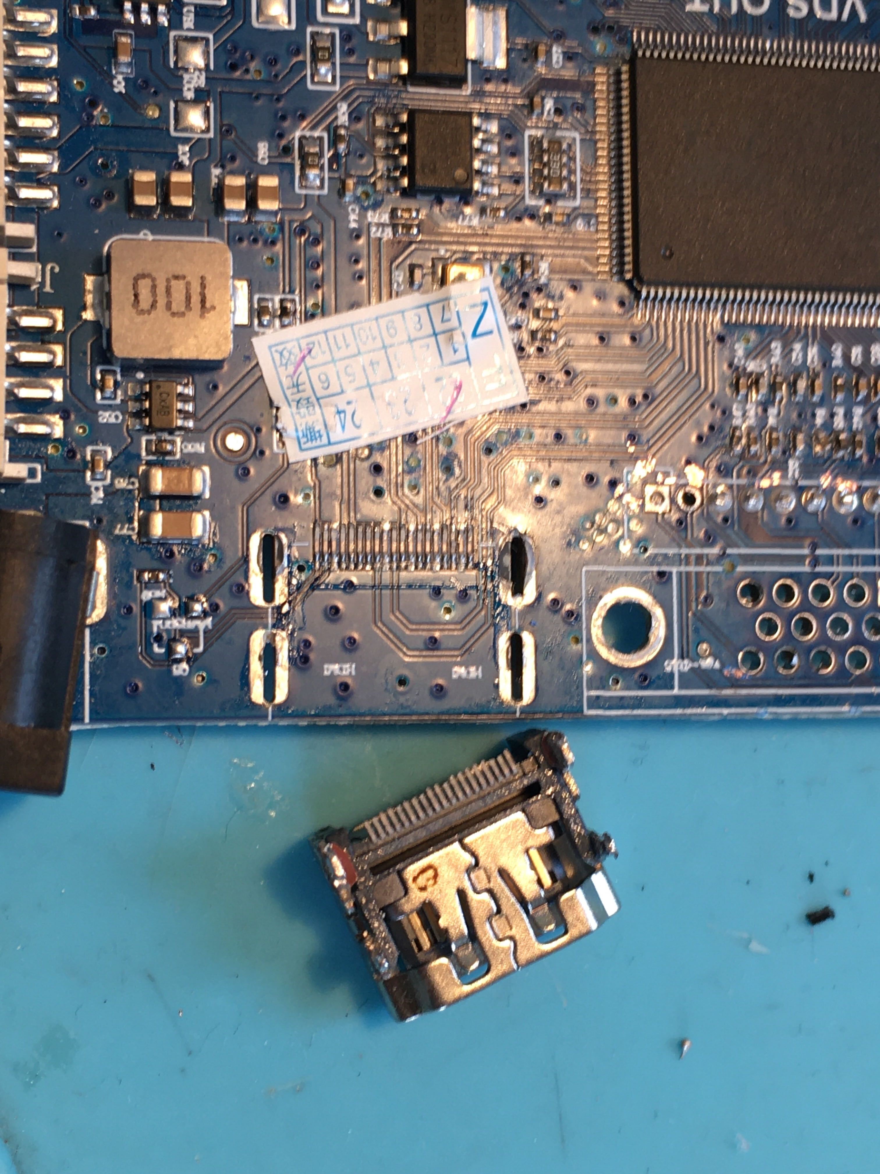

I managed to minify it down a lot however, but did accidentally lift a pad which according to the datasheet was unused, so I pushed on only to find that it was necessary and that I'd obviously counted incorrectly. The screen colours were all out of whack and I just couldn't figure out why. Fixing this damage with magnet wire was right on the edge of my ability and keeping focus through the operation proved very taxing (in a bad "this is going to take three days worth of recovery now" kind of way).

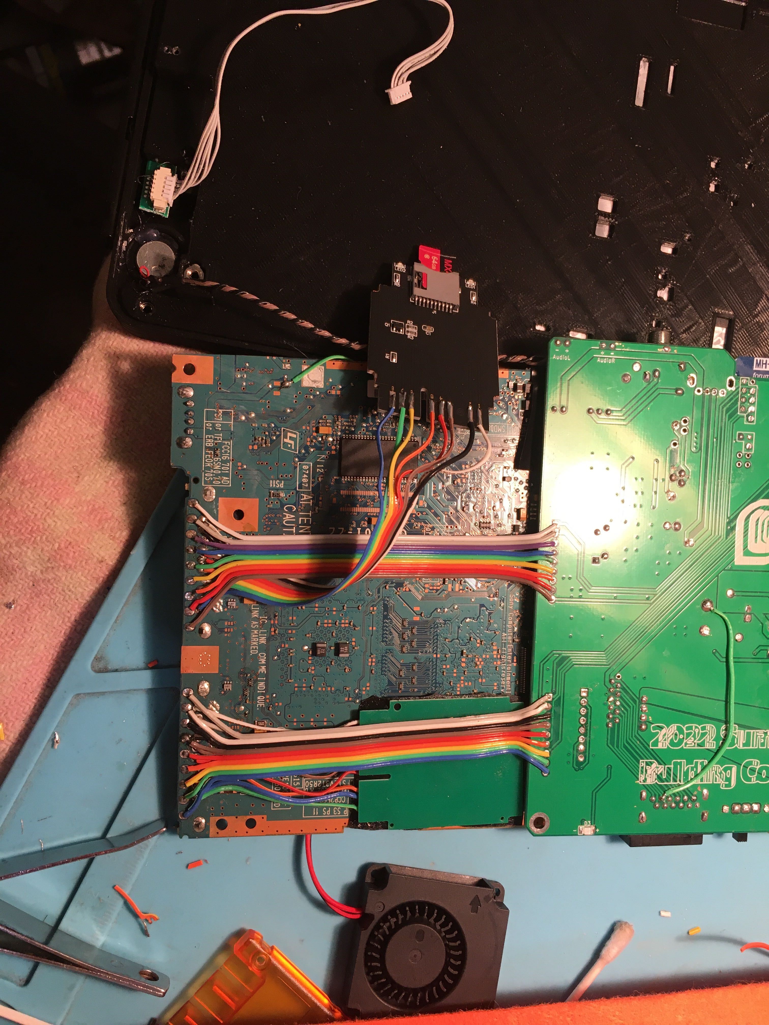

Next up I had to complete all the wiring for the carrier board into the PS2 main board. I'm proud of all of this, and even wired up the SD card just in case I opt to add in MX4SIO sometime down the track (but with a router serving over ethernet I strongly doubt I'll ever bother with that).

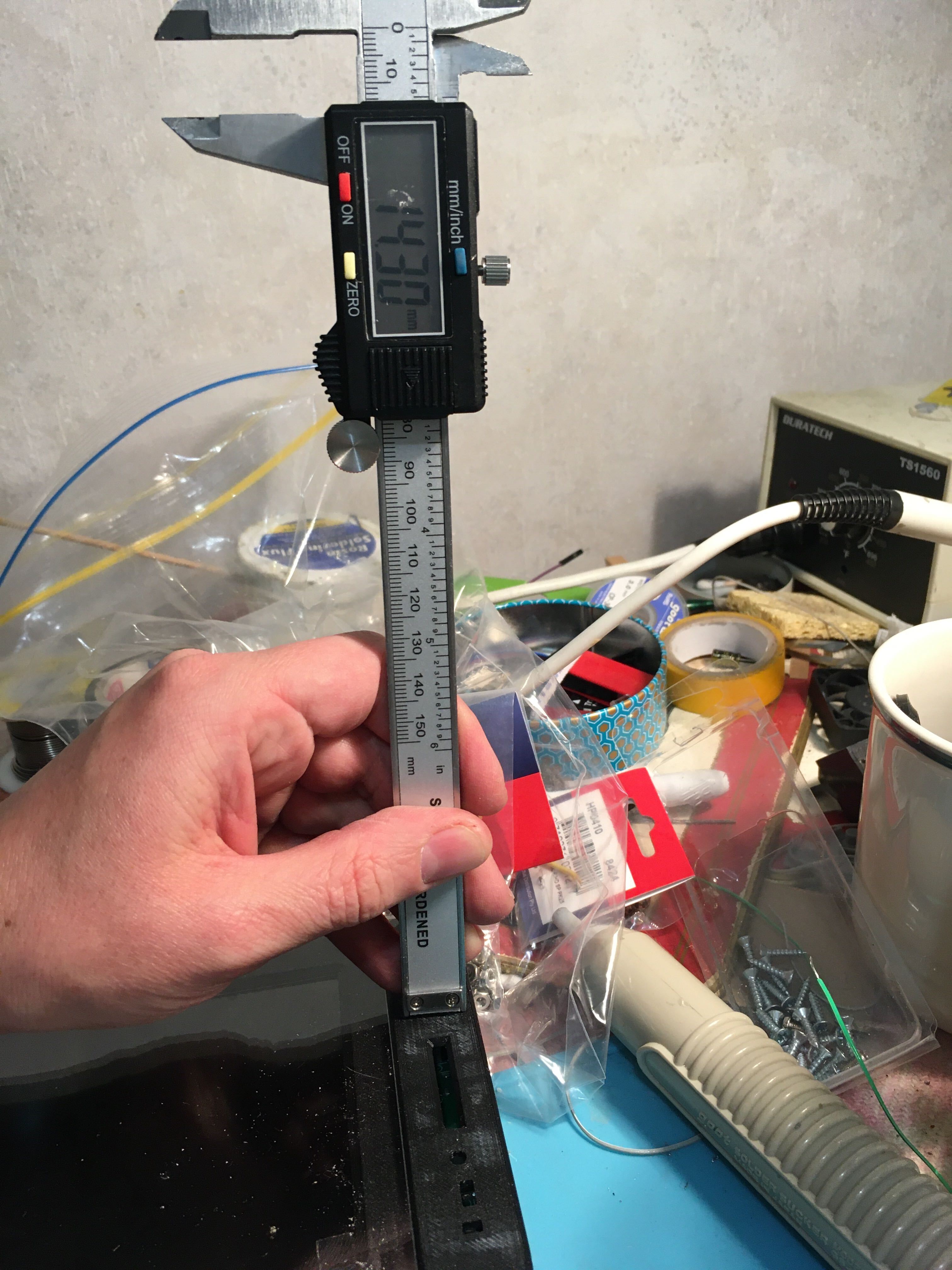

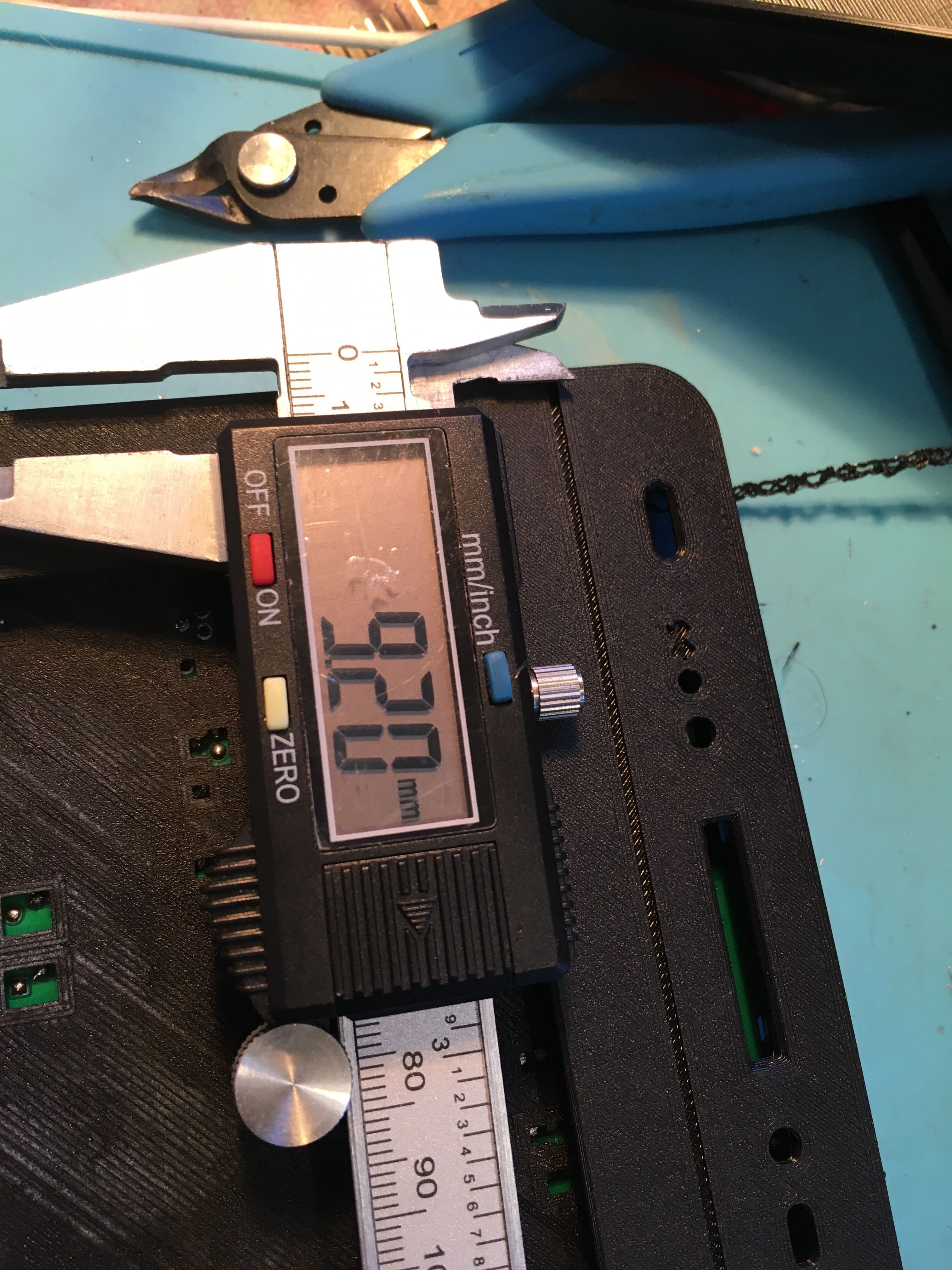

Finally I managed to grab a bit of time over the last week to see about modifying the original case for the 8" screen I'm using. My plan with this build is to have two 6000mAh batteries behind the screen itself, meaning that it won't have the xBox controller battery cover when the case is finally made. Batteries fit in place behind the screen with touch precision (kind of surprising given I've misplaced my proper calipers and so have been using some kids plastic ones).
But apparently I've got to go back to school to learn how to measure things because I really screwed up the screen, and have the left and right sides reversed. I guess this is why we do tests!

Because I had experience with Eyoyo screens and found that they were great in the past I figured I'd go with another Eyoyo 8" screen. It got wrecked in the post.
Concluding it was now spare parts (and I still haven't got a refund from the postal service) I got one of the same, and then promptly found that the yPbPr video didn't want to work (despite it working with one I'd had years ago), and opening them up they were wildly different boards to one I'd had prior. This left me a bit at a loss as to how to move forward, because it was a lot of board to stuff under the hood, and I'd spent more money than I was happy with getting to this point. After lots of investigation, some crying in the shower, a couple of long meandering walks in the moonlight, and some "cleaning of the soul" by biffing things out I chanced upon an old s-video to VGA adapter. Now I had considered using the Shinobi scaler but found that the screen just didn't want to play nice with any video signal that wasn't 1024x768@75hz - weird, but this cheap little upscaler could do it! Naturally it got stripped and minified, and I figured I could just fit it under the hood. I felt it was important to keep the buttons just in case something got reset.
So the screen driver board turned out to be...shit. Traces would just lift with the slightest pressure (one while I was watching and it only had the weight of a wire on it), and I minified it as much as I possibly could (knowing that I had a spare if this failed).
...I've lost that photo of it mounted, but here's one of it free.
But simply put: the driver board keyboard stopped working for no apparent reason I could see, and I only discovered this AFTER I'd put everything together, so time to pull it apart again, strip everything back, and use an untrimmed driver board. I knew I was going to have to take a hit in thickness, but at this stage I was sick of it.

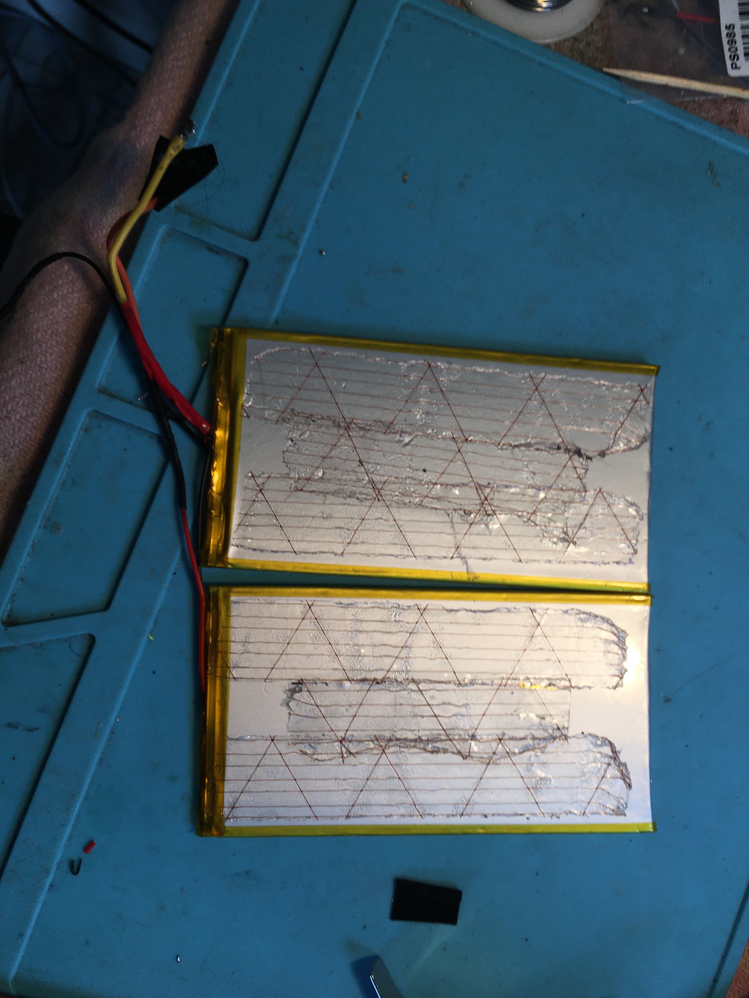

The batteries broke too and needed some minute repair work done.
So it was still really thick, and I opted to try to squeeze everything down further using my wirecutters zealously on things like caps and inductors (which I was pretty sure that it wouldn't need), along the way I dropped it and broke some tiny wires so had to spend ages poking things with zero access (and trying not to yeet it out the window, which would be gratifying all things considered), and just an hour ago I trimmed the 3D printed case to fit, broke some parts of it off (a few by accident), and tightened the screws up to assemble it for the final time. The final measures for thickness are here in the photos, it's not brilliant, but it's not terrible, and it does run off batteries although it's got two power ports for use, and it's brimming with indicator lights and helpers - the kickstand at the back really is my vibe for how to use this thing.
So what now? Well I've a heap of people around her to thank, almost too many to list and I'm pretty shot-through and tired so know I'll not remember all the names, but as fate would have it I've lost my USB with the games on it so this thing'll be getting a cooldown period on the table until I manage to find them! Thank you all so so much for the support and assistance over the years! Odds down I won't have another electrical project of note ;)
