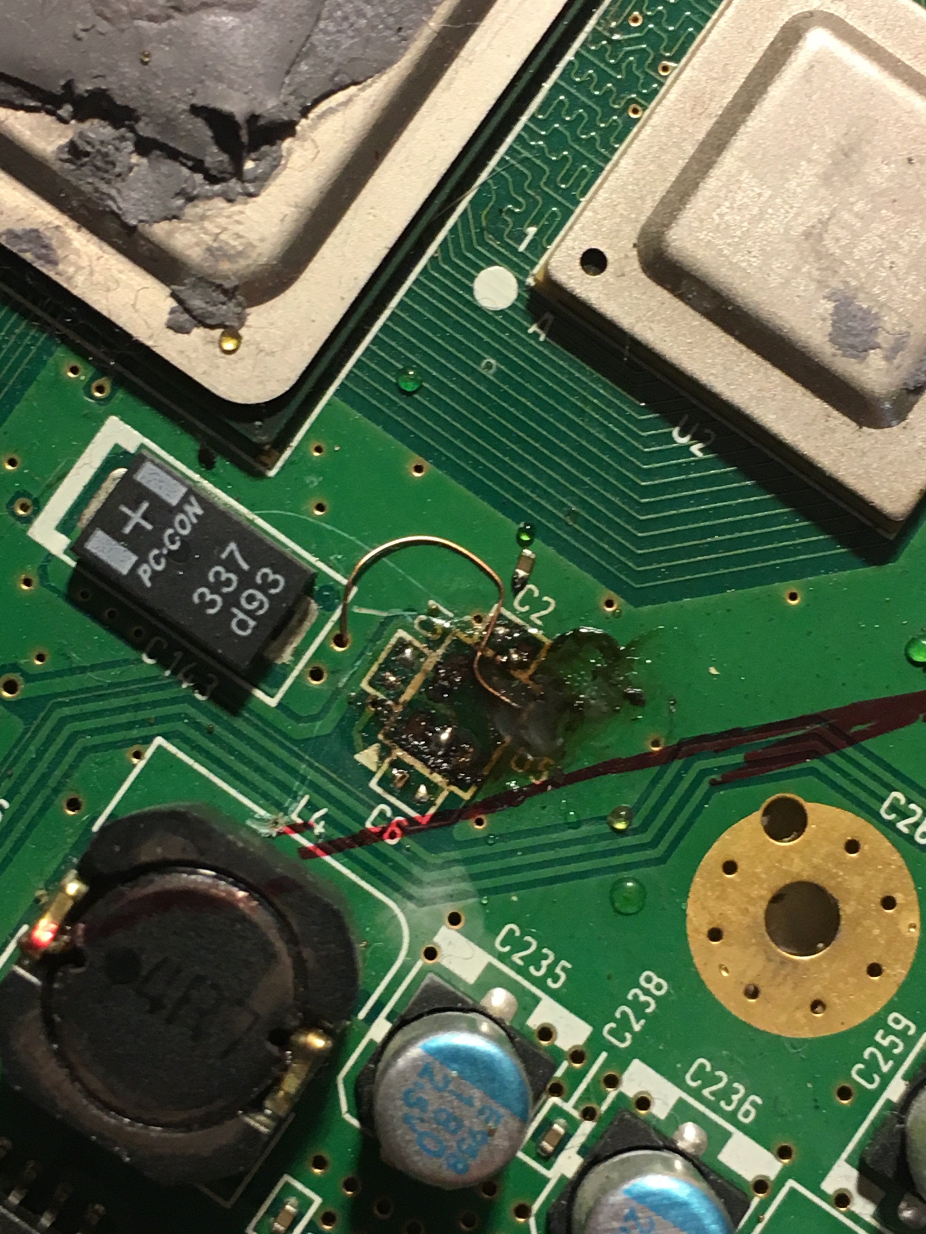

This is destroyed isn't it
I tried doing the u10 relocation
AND FOR THE LIFE OF ME
I COULD GET NO SOLDER TO STICK ON THE DAMN BOARD
It's because you lifted all the pads except the bottom middle one... You could probably get away with gluing the U10 down and connecting all the pins floating
