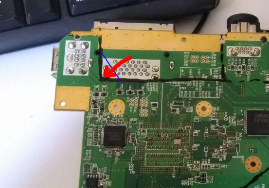

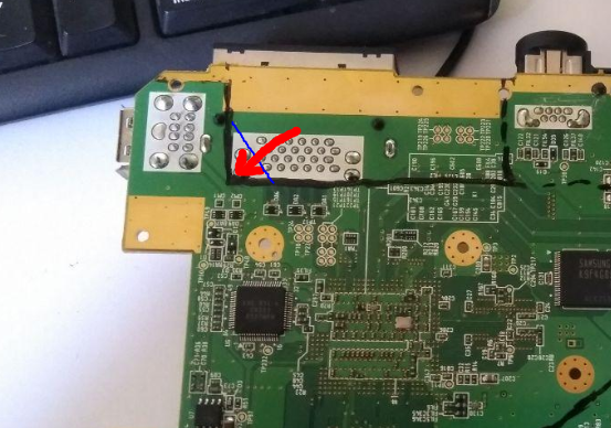

Hello everybody, this is my first thread, its about some questions regarding to what kind of electronics i must to use compared to the actually that i buy on my country (México) cuz i cant find some that is published here, also i got some questions about how to trim my wii MB, cuz i want to conserve the video & usb ports (maybe the chargue port too).
What do i have to do this?
-4 layer Wii MB

I attach the images of how I would like to trim the wii, It is possible to make this type of trim to keep the ports?

You can keep the AV and USB ports no worries if you use the lines you drew on the underside. The top side lines are too blocky and have way too many short inducing right angles. You'll just have to tweak this corner a bit or you'll hit one of the USB data lines.
