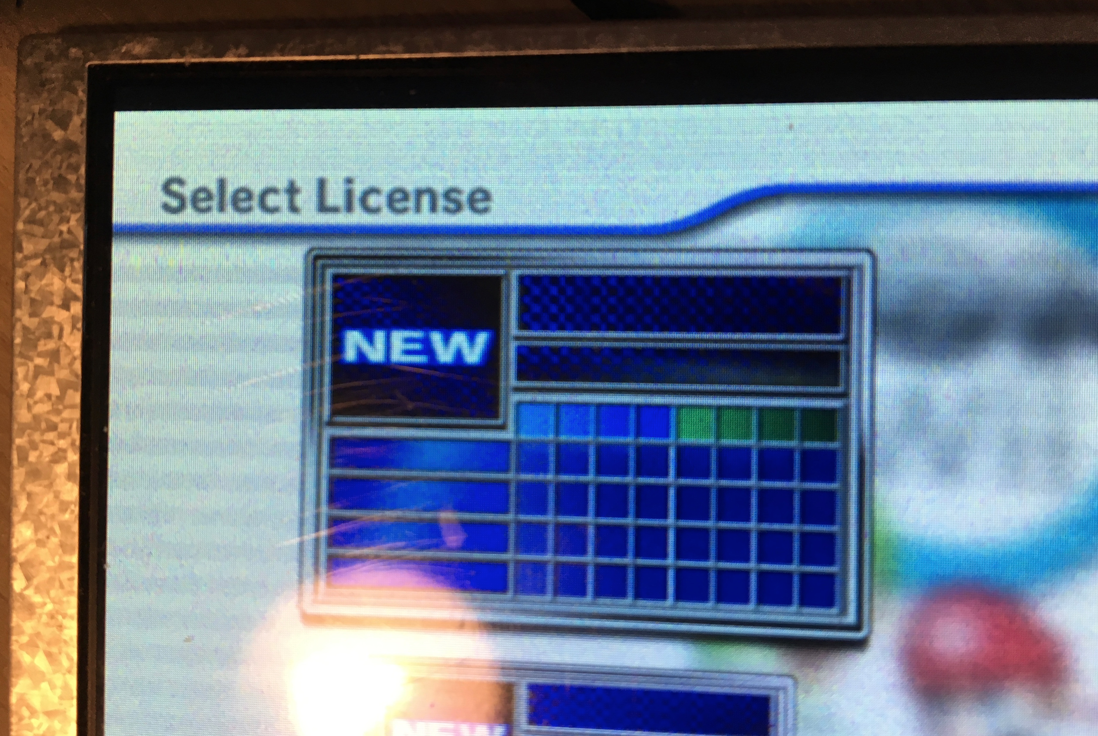

Obligatory video:
This demonstrates the VGA H/V position adjustments on a scaled VGA input. That panel is broken btw, it has a few fucked lines in the FFC and the lcd is broken as well, so the image is less stable. It looks really good on the panel I'm using in my portable:
