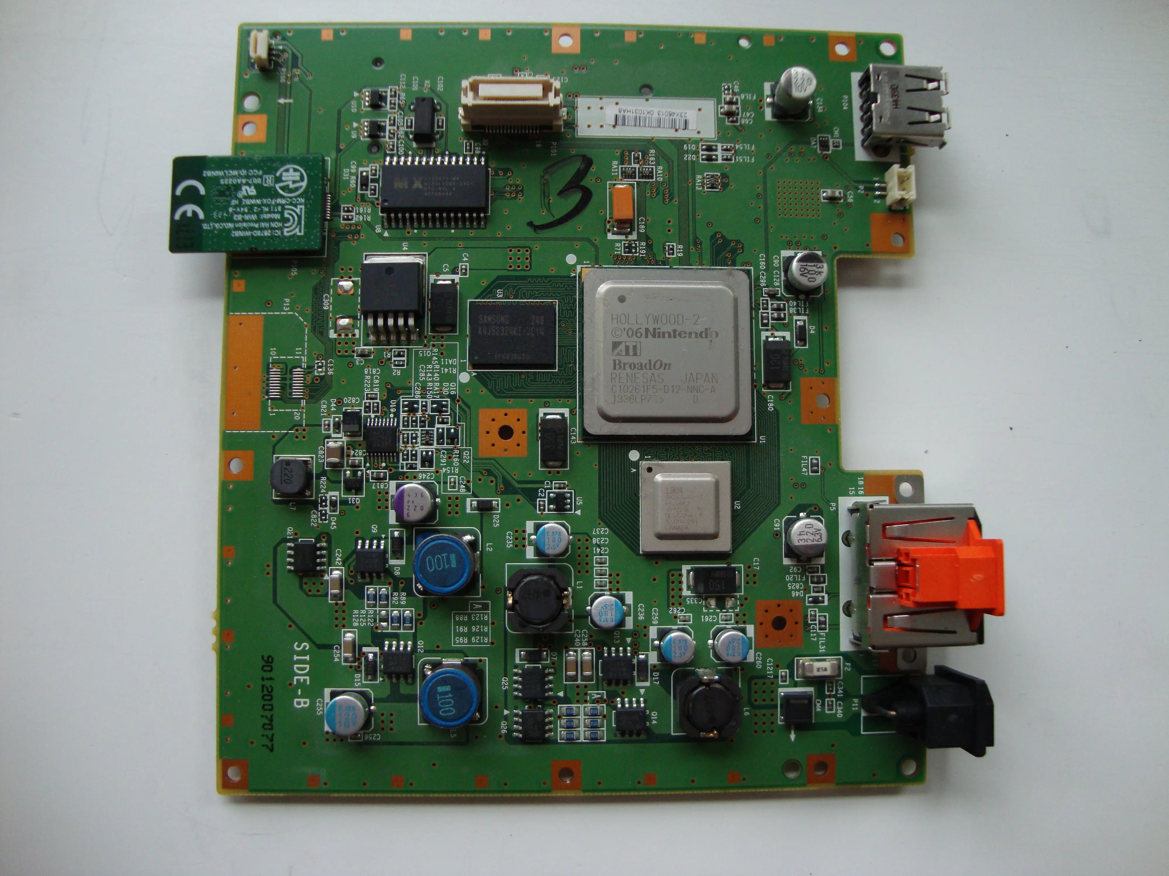

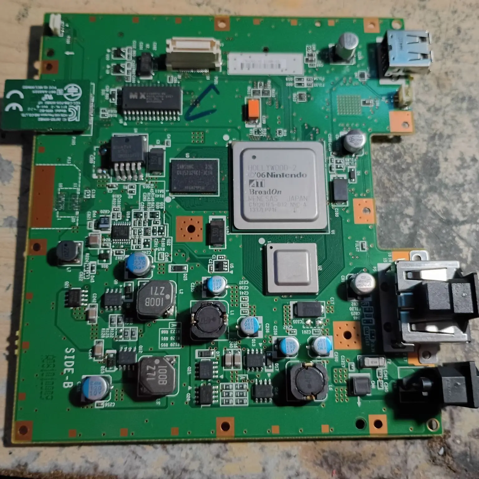

Wii Variant: Mini - RVO-01
Serial Number: HW200763972
Hollywood Datecode: 1307 (7th week of 2013)
Board Datecode: 13273 (Some time in 2013)
Pics:

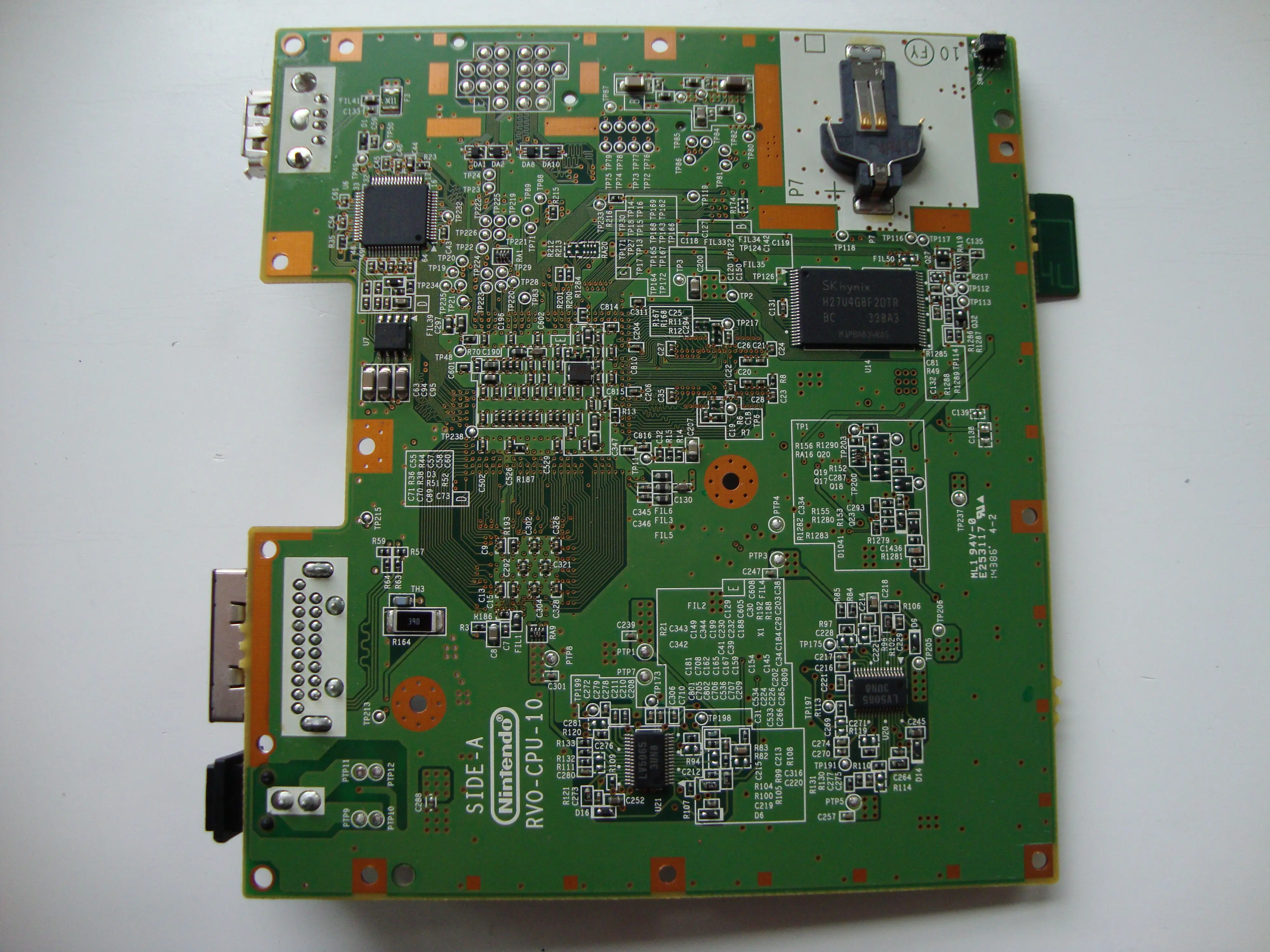

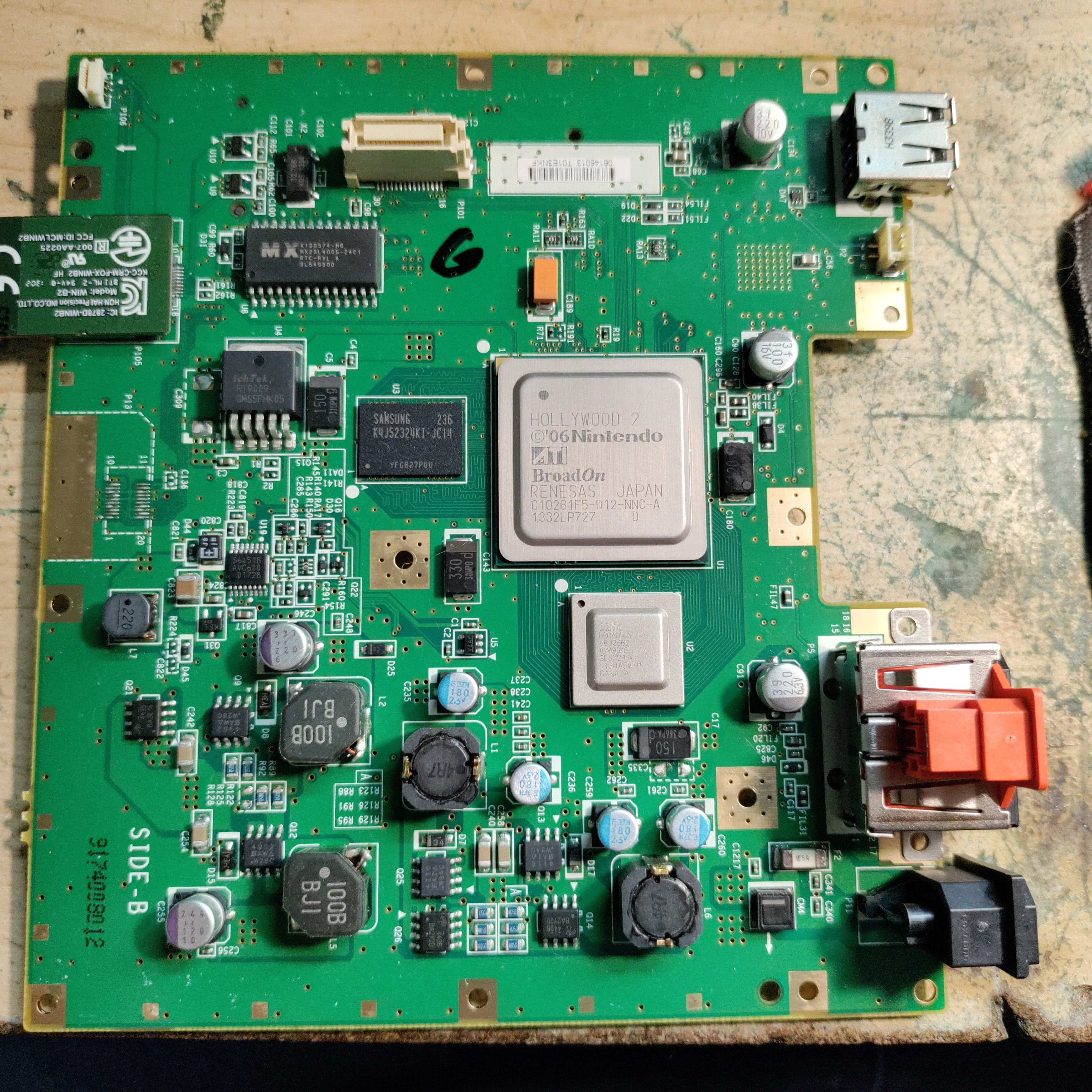

Wii Variant:
Mini - RVO-10
Serial Number: HW204044275
Hollywood Datecode: 1328 (28th week of 2013)
Board Datecode: 14133 (Some time in 2014)
Pics:

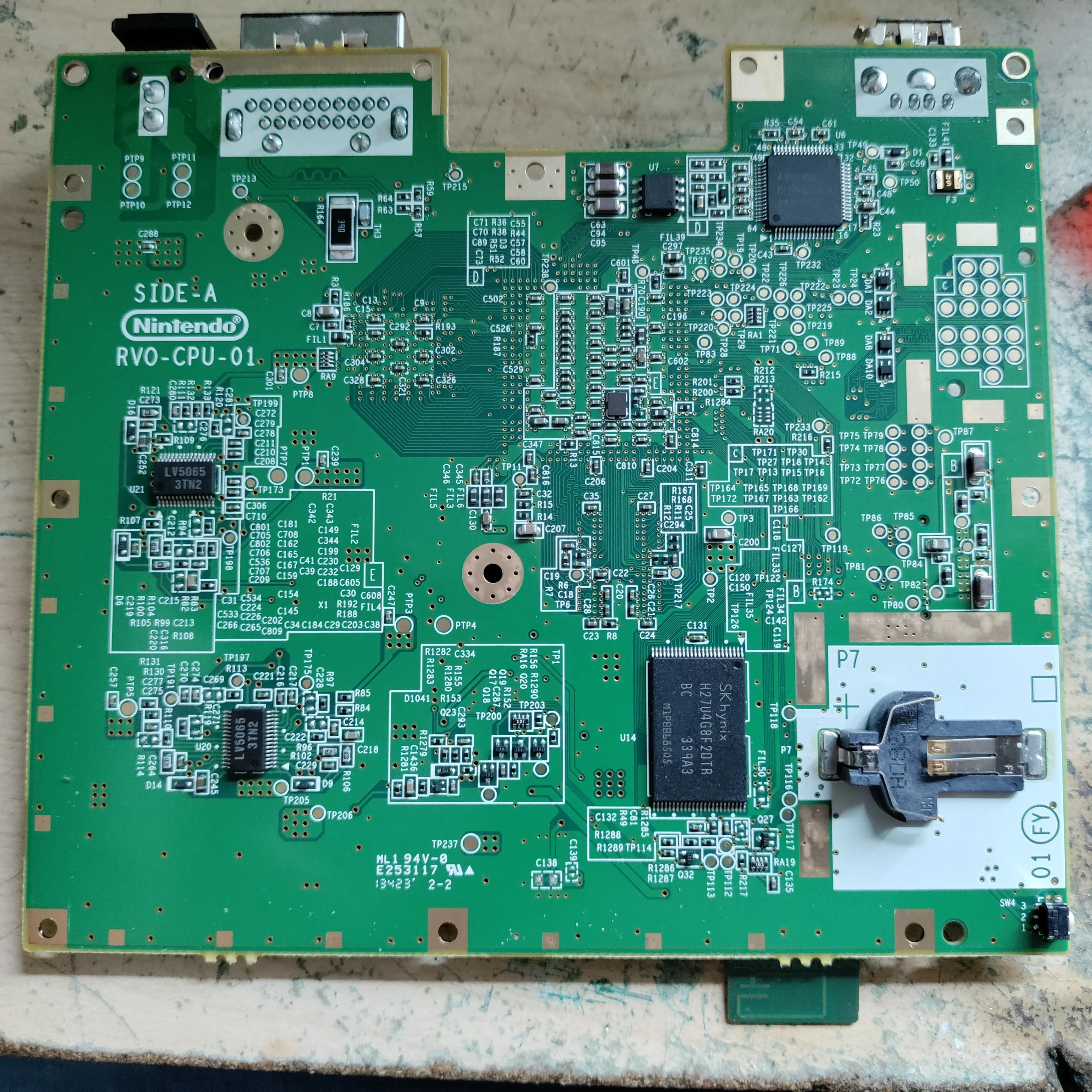

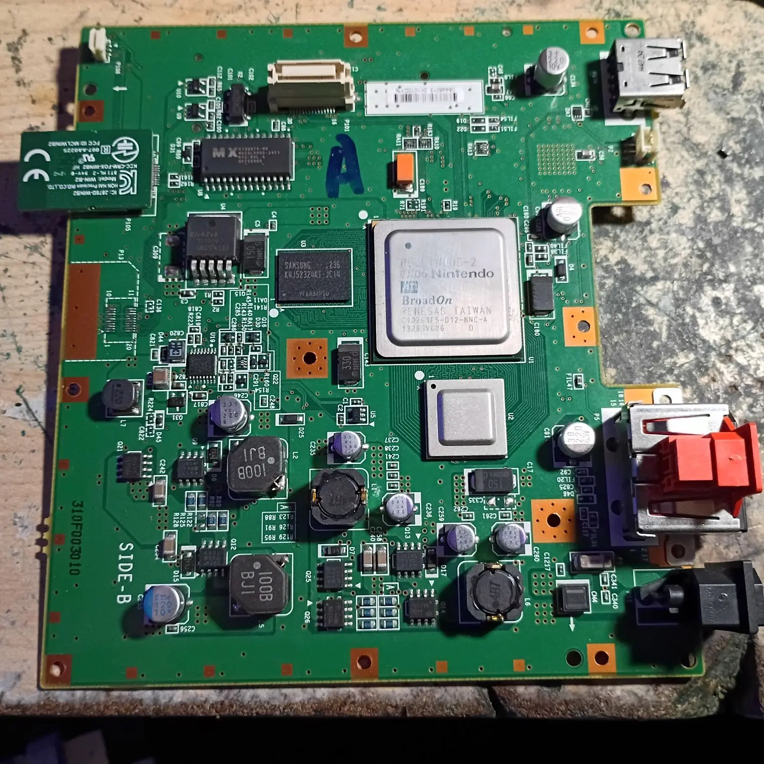

Wii Variant:
Mini
Board Revision: RVO-01
Serial Number: HW203335664
Hollywood Datecode: 1332 (32nd week of 2013)
Board Datecode: 13423 (Some time in 2013)
Pics:

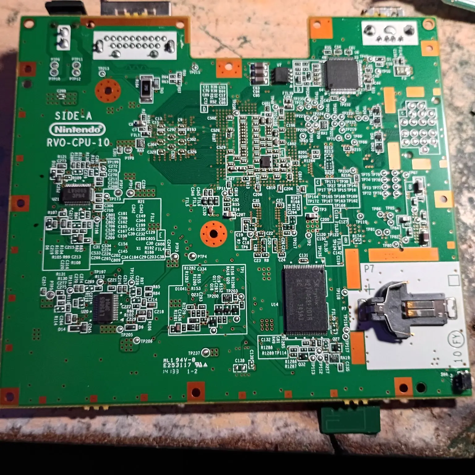

Wii Variant:
Mini
Board Revision: RVO-10
Serial Number: HW203879267 (ahahaha)
Pics:

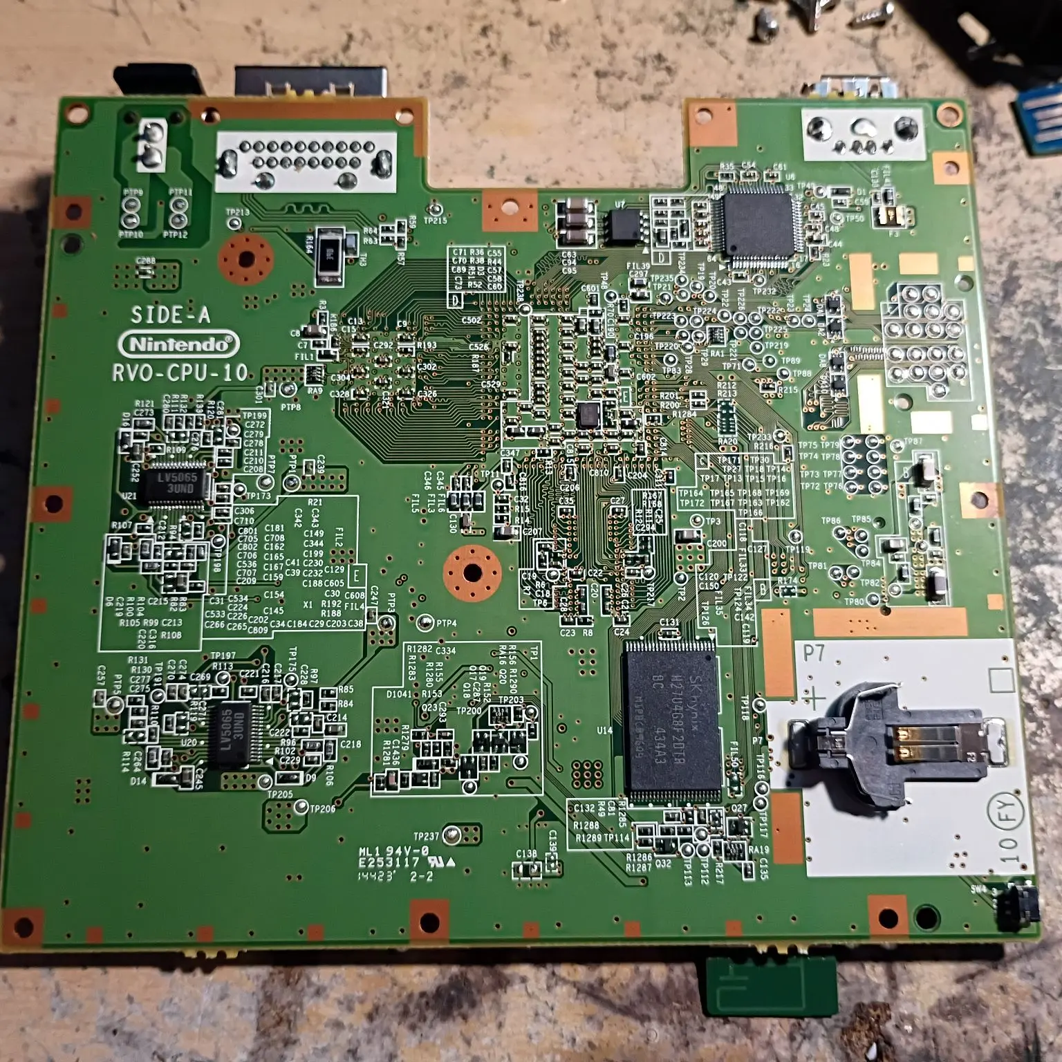

Wii Variant:
Mini
Serial Number: HW205337277
Hollywood Datecode: 1337 (37th week of 2013) (elite)
Board Datecode: 14423 (Some time in 2014)
Pics:

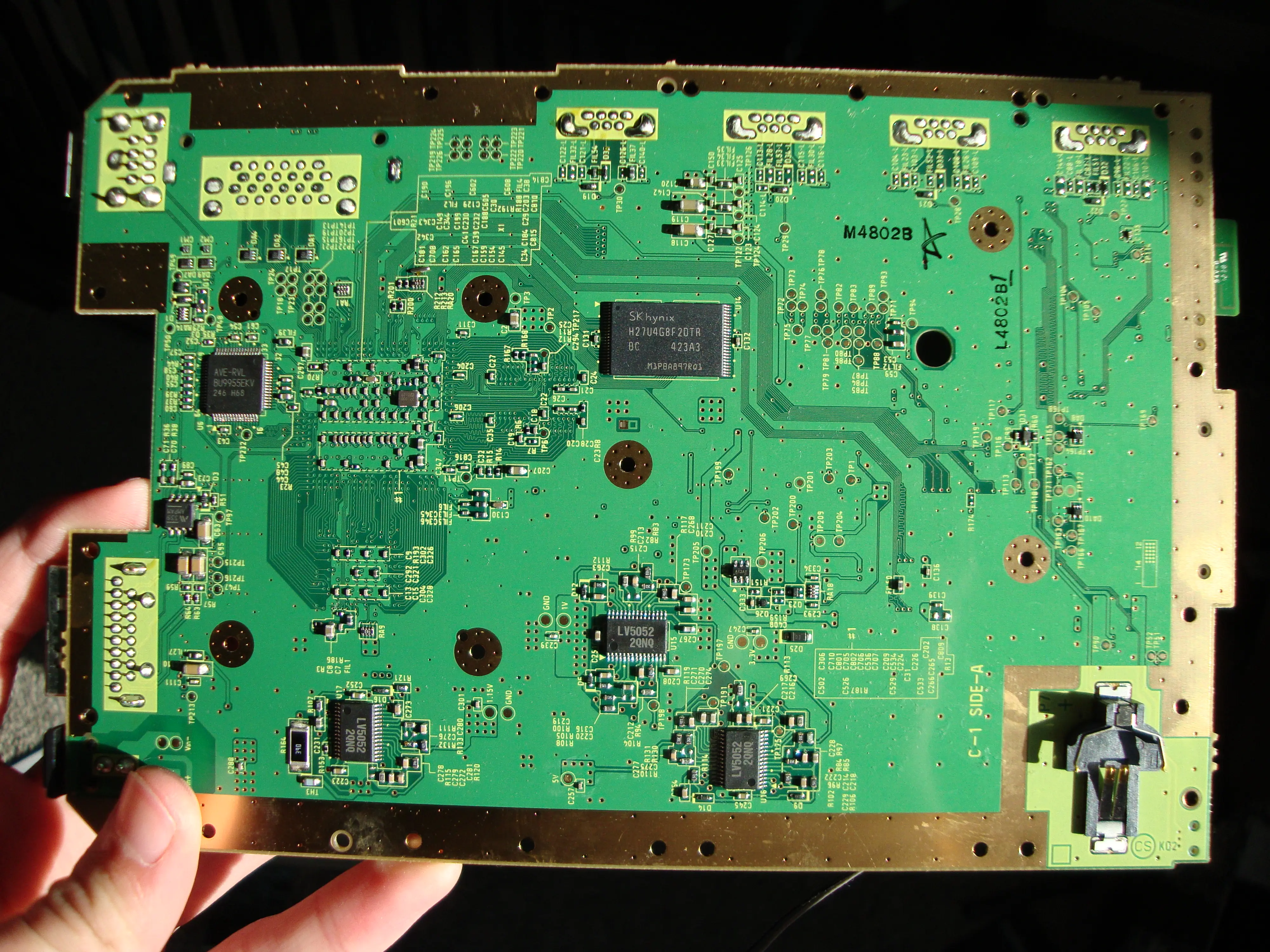

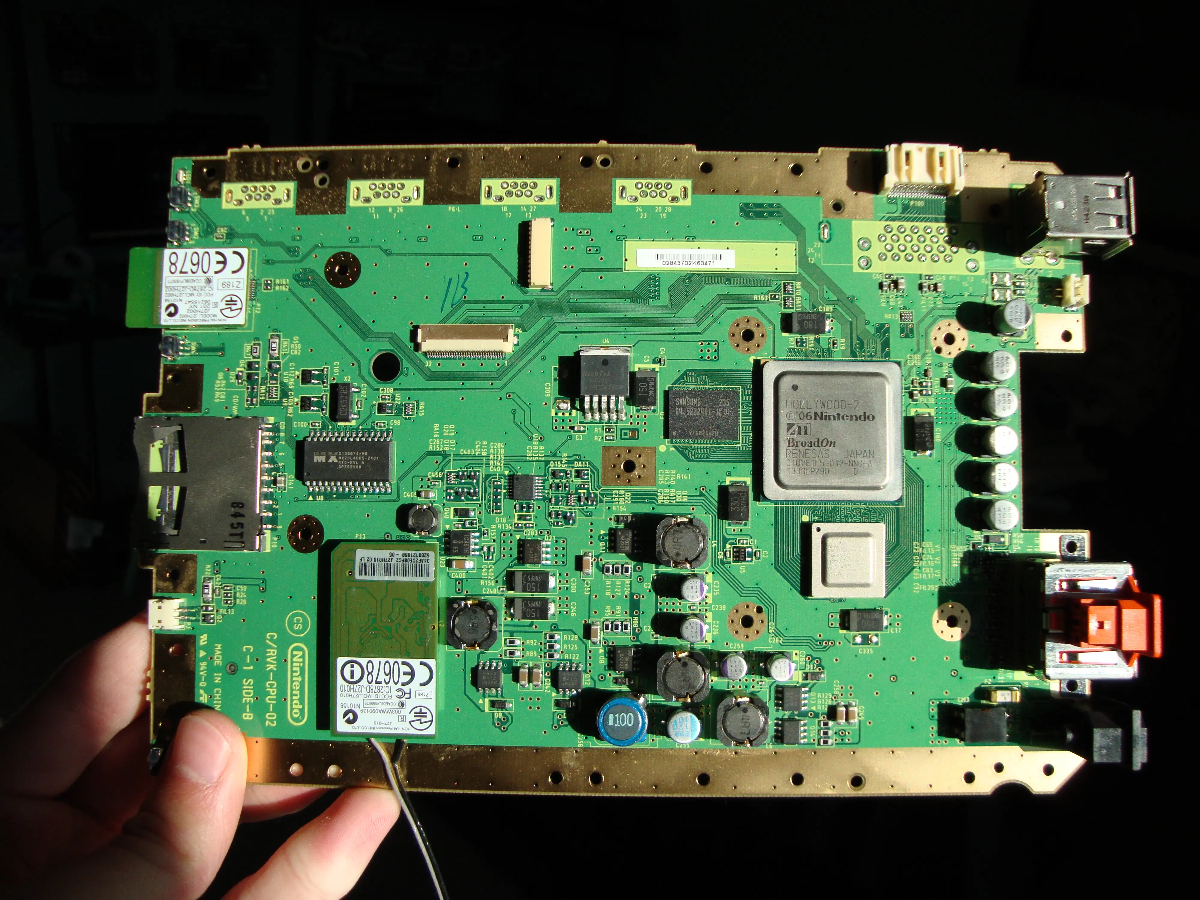

Wii Variant: Family
Board Revision: RVK-CPU-02
Serial Number: KMH70009615[0]
Hollywood Datecode: 1333 (33rd week of 2013)
Board Datecode: 1 '14 12 (26th or 27th week of 2014, determined from dot grid)
Pics:
Got this one a while ago, just completely forgot to post it here lol. If anyone's curious, I have a bunch more high quality photos on the Discord, I posted them sometime in January 2026.
