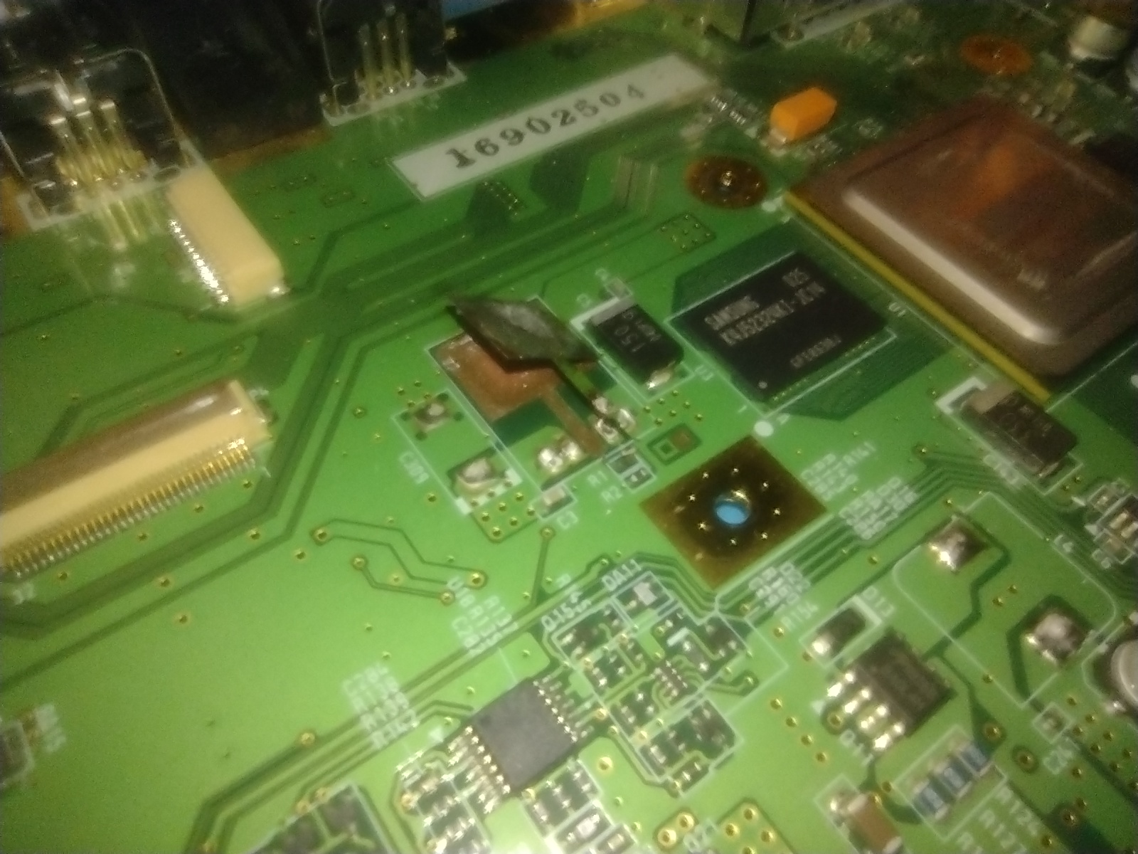

ToxicBananaFish . . Joined Dec 27, 2019 Messages 48 Likes 26 Location North Carolina, U.S. Portables 1 Oct 22, 2023 #1 The pad that the built in 1.8v regulator decided to come off of the board with the regulator itself, pulling up a resistor labeled "R1" with it as well. Will my board still be able to work after it's trimmed? This is the best picture I could get.
Stitches 2 and a Half Dollarydoos Staff member . . . Joined Feb 5, 2017 Messages 4,646 Likes 3,592 Location Banana Bender Land, Australia Portables 6 Oct 22, 2023 #2 Yeah it'll work fine. You just need to run the 1.8v supply wire to the black tantalum capacitor instead of the LDO footprint
ToxicBananaFish . . Joined Dec 27, 2019 Messages 48 Likes 26 Location North Carolina, U.S. Portables 1 Oct 22, 2023 #3 Alright, thank you so much! It's late (where I am) right now but I just finished trimming the board, I plan to do some testing tomorrow!
